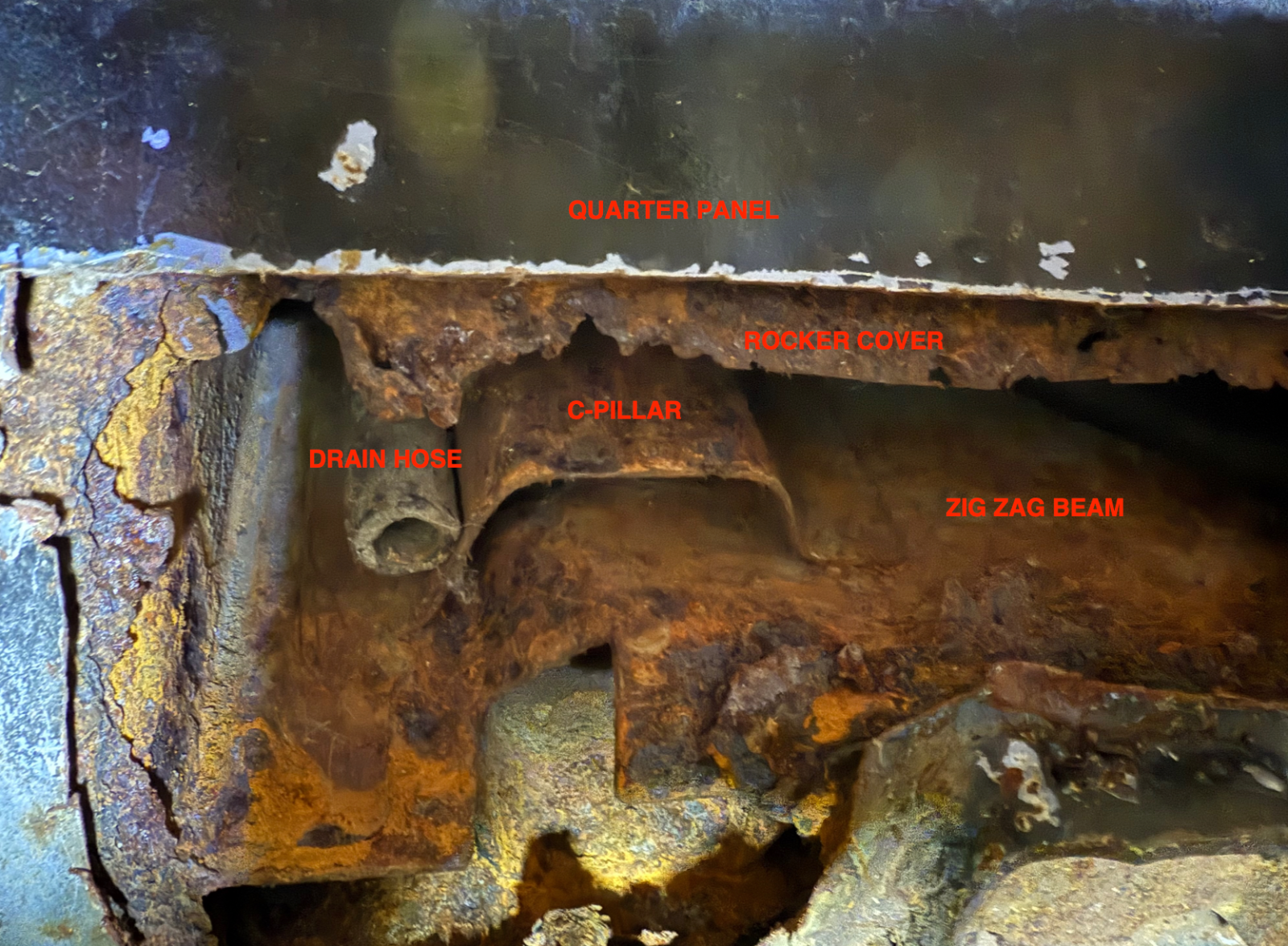

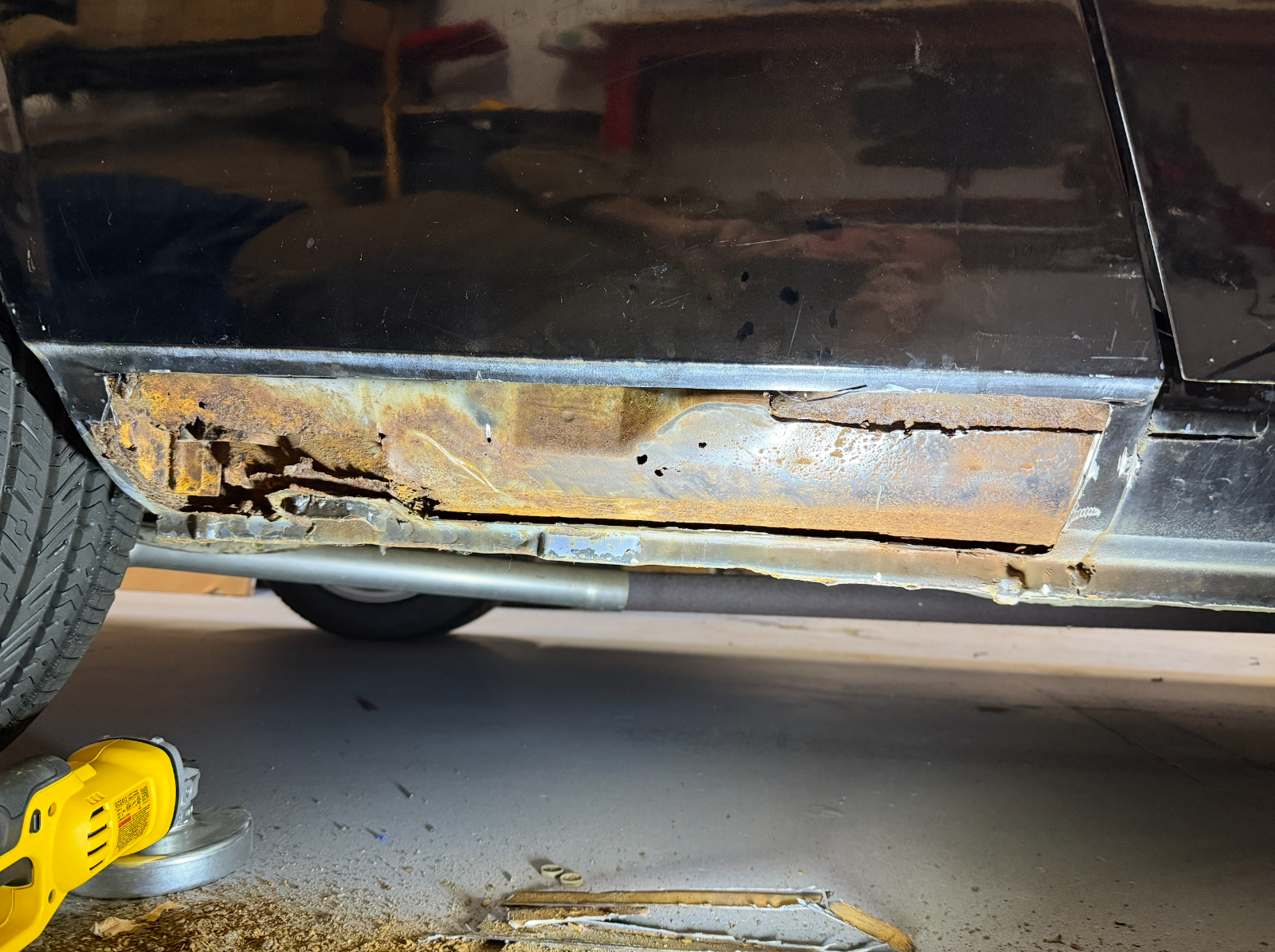

I took a few more photos of my rear rocker assembly, and sorted out what is what in the tangled rusty mess. The right rear rocker had a small rust bubble, that I found once I took the crusty rocker trim covers off. That was nearly 20 years ago, before life and jobs, and multiple other home and boat projects got in the way of car restoration projects.
Here is what I found back then:
I decided to cut into this to see just how bad it was. At the time I did not really understand the structure of the car, and specifically the complex structure right around the A, B, and C pillars.
The rocker has three primary components: Inner rocker (which the floor is attached to on the sides), what I call the "zig zag beam" (which is a flat piece with perforations and zig zag indentations), and the outer rocker cover (this is itself covered up by the rear quarter panel in the back, and the fender up front). Together these three parts form a tubular beam that runs from the back of the front wheel well, to the front of the rear wheel well. At the pillars there are pieces that attach to the zig zag beam to form the vertical elements of the car (front door pillars, door latch pillars and rear wheel arches (which eventually become the C-pillars). .
Here is what was under this rusty spot at the back end of the right side rocker (some of the really crusty stuff has been removed in this pic). Since it is a bit hard to tell what you are looking at, I have labeled the components.
Here is a better view from the bottom looking upwards:
Fortunately the zig zag beam and the c-pillar are actually solid, just rusty on the surface. The rocker cover is another story.. nearly totally gone at this area. It gets stronger as you move forward. You can also see the culprit in this show, which is the drain tube from the C-Pillar roundel vent. I am surprised how much water comes in there, but I guess it is from road mist blowing around the car in the rain, and maybe from overly aggressive washing. At any rate, the hose drains into this area, which is supposed to drain out of small weep holes in the bottom of the rocker assembly. I have not checked these yet, abut I suspect they are clogged.
I also found a surprising amount of dirt and grit, mixed with rust flakes lodged in crevices in this area. I am not totally certain how this gets in there, but it is possible that some of it comes in the drain tube, and some falls down the hollow c-pillar. 50 years is a long time to accumulate a few tablespoons of grit. I think I had at least 3/8 inch of similar grit up in the "shelf" in the front wheel well.
Fortunately for me, I think I can cut the quarter panel back below the lip where the rocker trim cover goes, so the repair should not be visible. It will involve removing the lower 4-5 inches of the quarter panel from the door to the rear wheel well, removing the rusted rocker cover, cleaning the beam and everything else I find in there, treating everything with POR 15, and then welding in a new section of rocker cover (shown in a post above), and then welding on a replacement section of the quarter panel.
The other side is not as bad from the outside, but given how bad this side was, I'll at least open that side up, and probably do a similar repair.

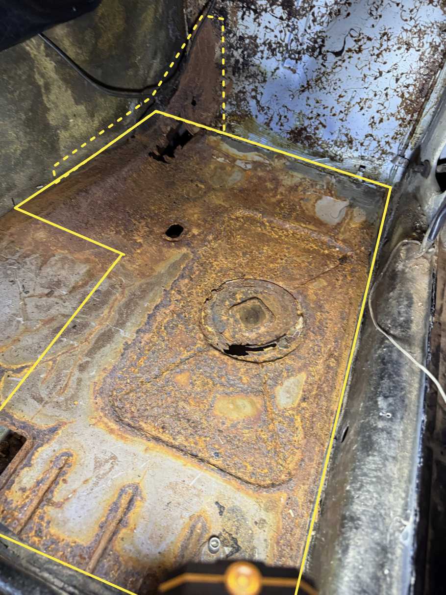

The driver's side should be a pretty simple cut and paste job, since the rust is mostly located in the recess in the middle of the floor. The passenger side is much worse. Mike suggested that the location of the inner corner close to the exhaust down tubes tends to heat and cool the floor metal, accelerating its decay.
Here is a shot of the passenger floor with the approximate outline of the section of pan I'll be using (solid yellow line). The dotted line shows the part I'll have to fabricate, probably from the unused portion(s) of the floor pan(s).

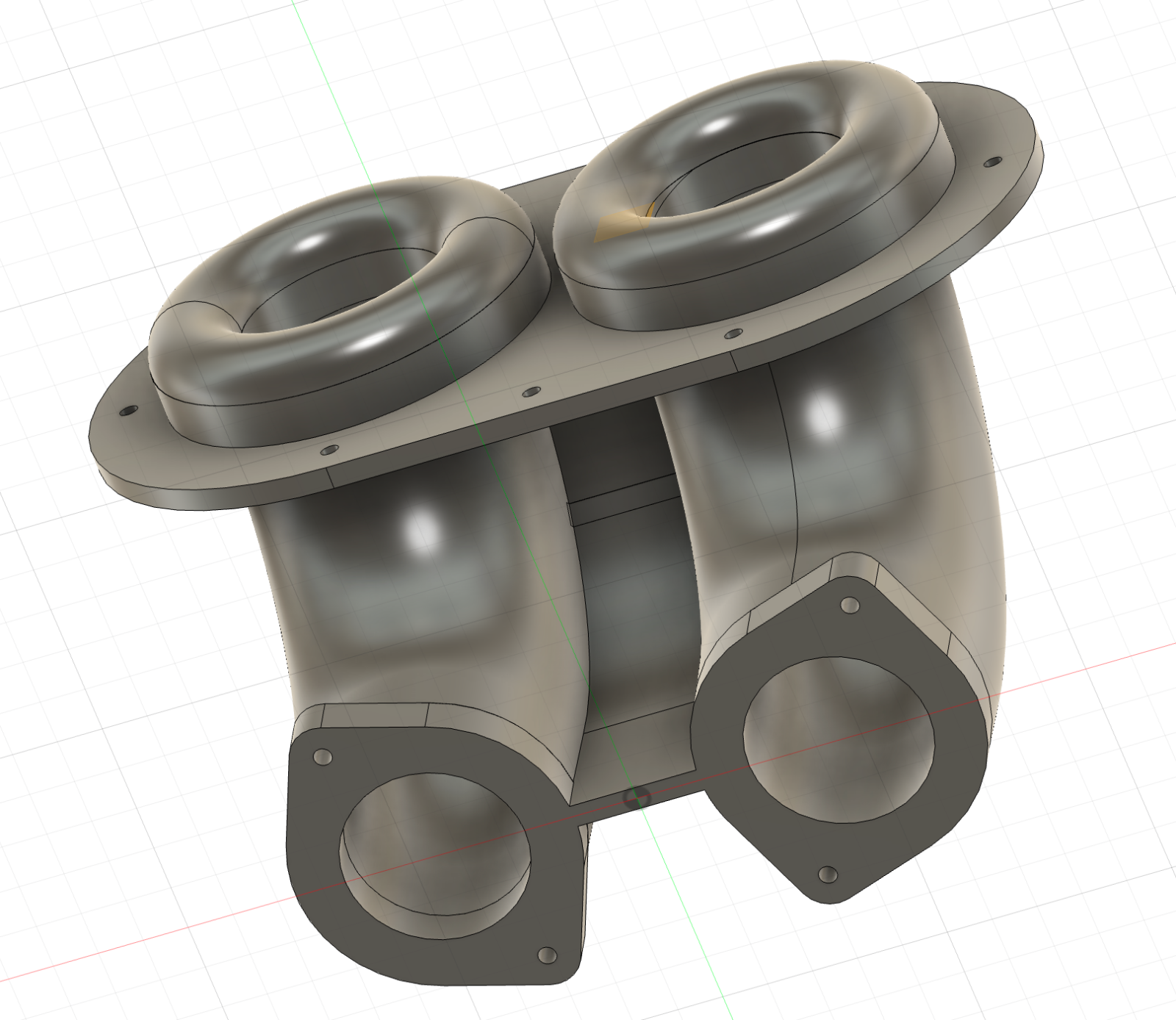

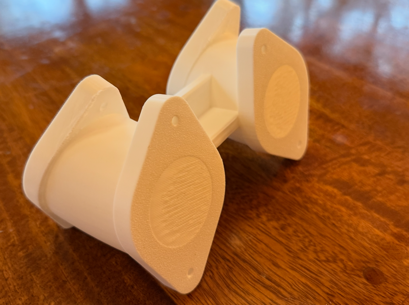

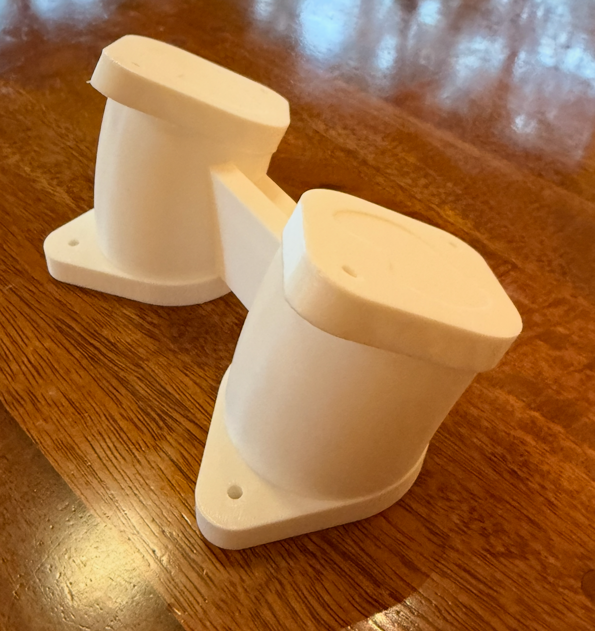

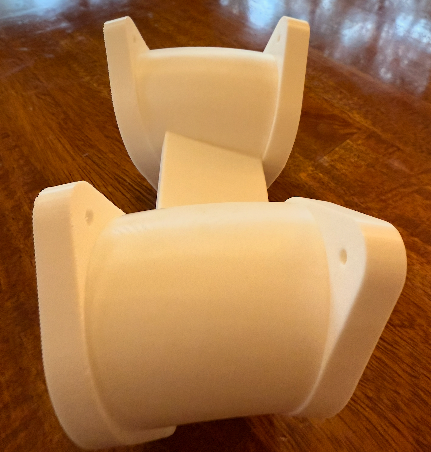

So here is the very first 3D prototype manifold. This is a 30 degree unit made from my initial model, which I messed up, so the primary flow tubes did not render as tubes in the print (I knew this going in). I have since modified the design to a 25 degree bend, which gives a slight tilt toward the engine for the carbs (recommended by Weber), and also fixed the rendering issue.
I am very impressed with the surface quality of these parts! I had them printed by a prototyping company called Xometry. This one was printed in the US and cost about $50. The 25 degree units are in print now. The off-shore print cost for those was $70 for three units. Can't wait to see those!

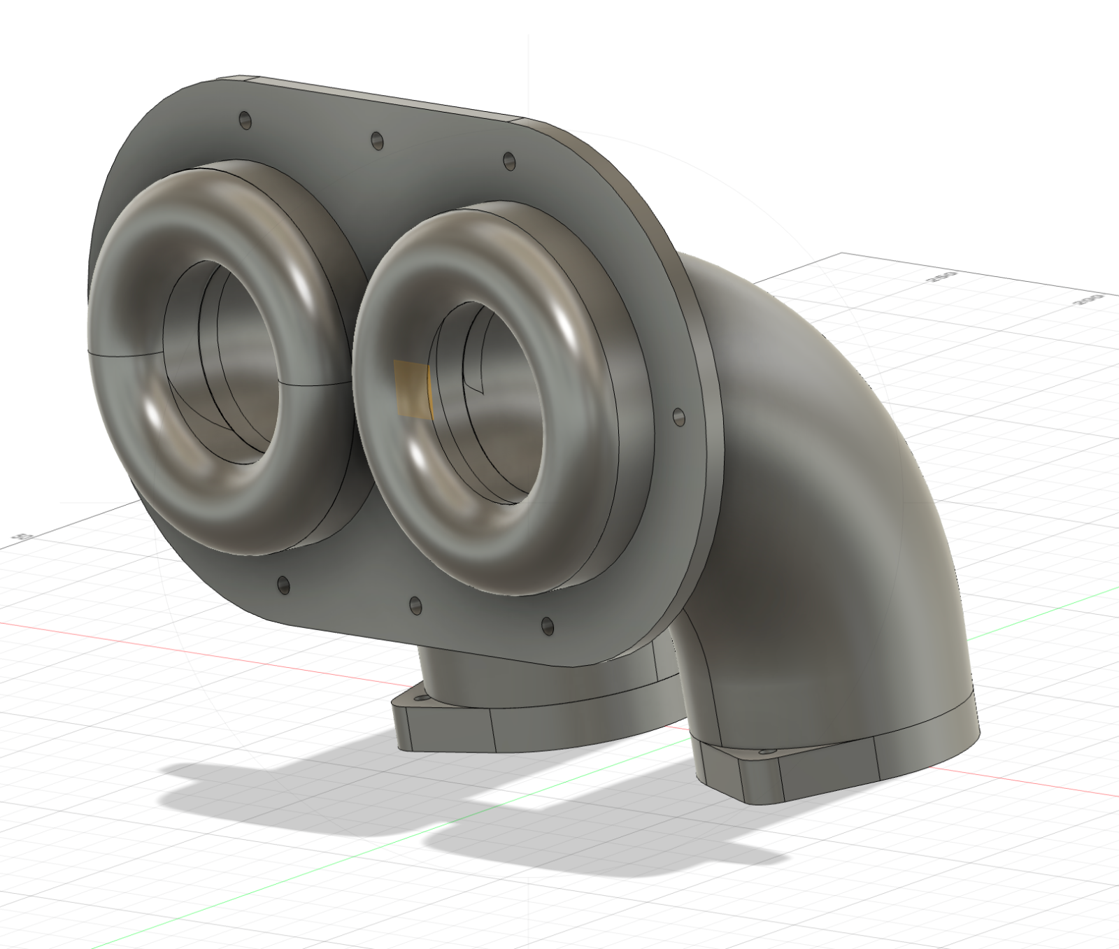

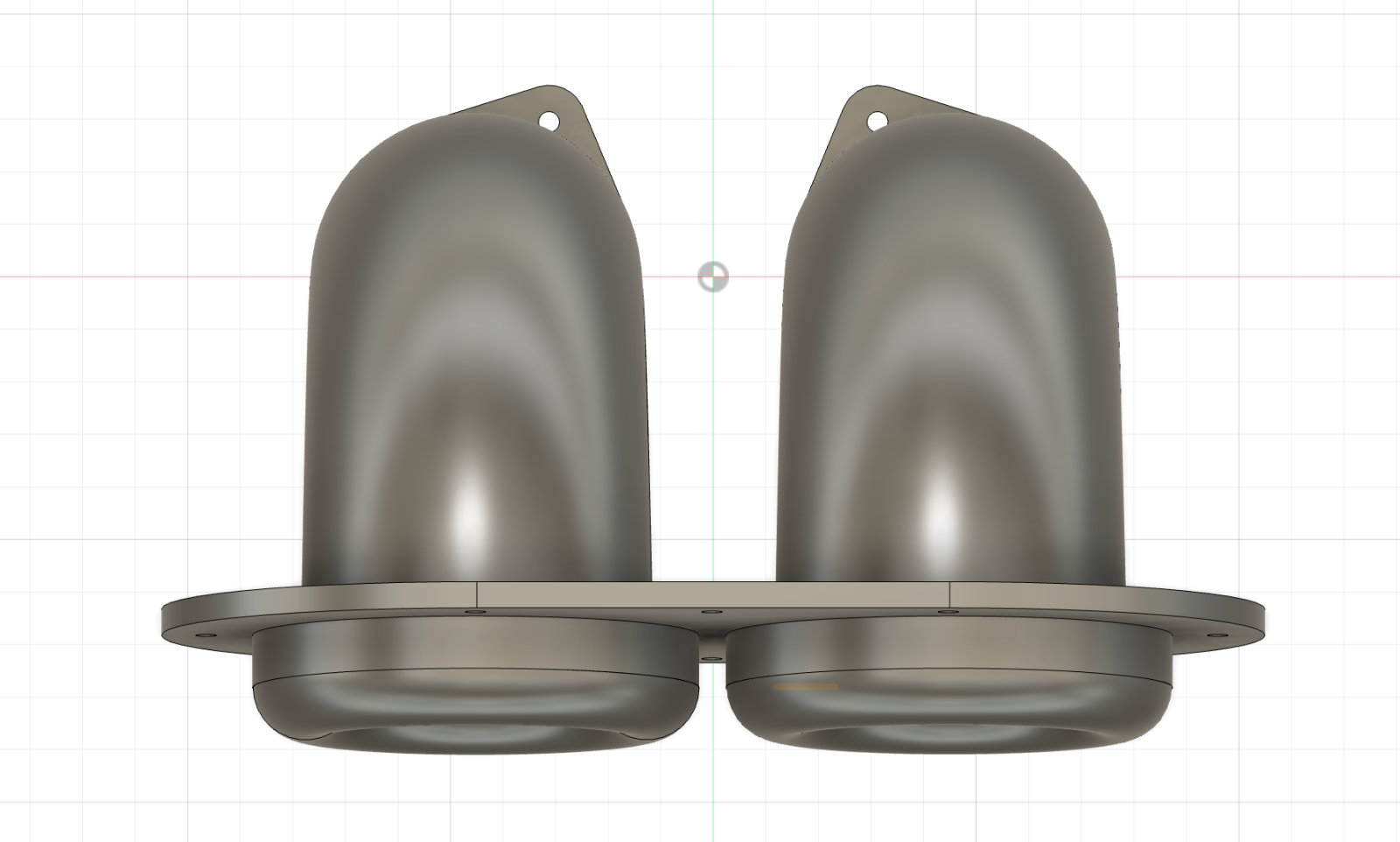

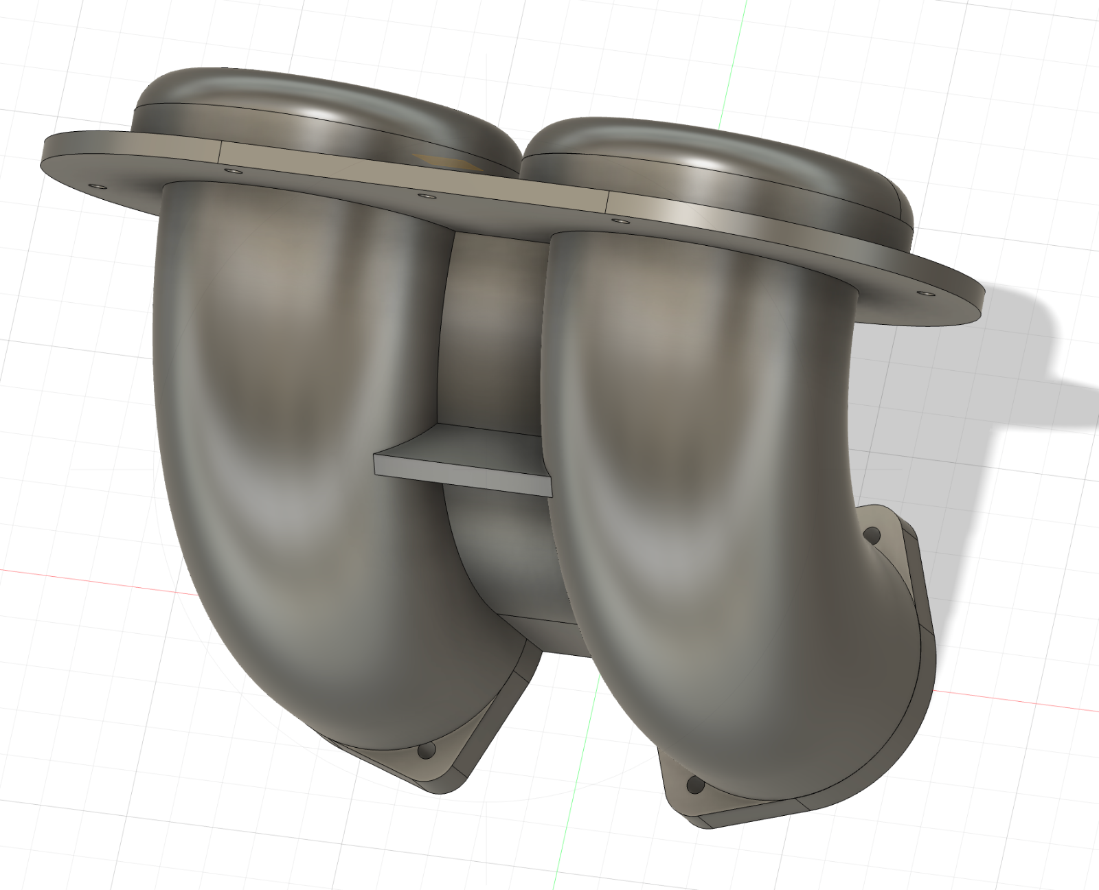

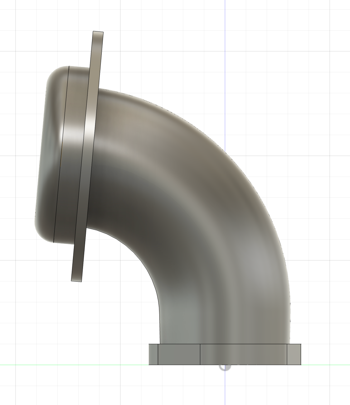

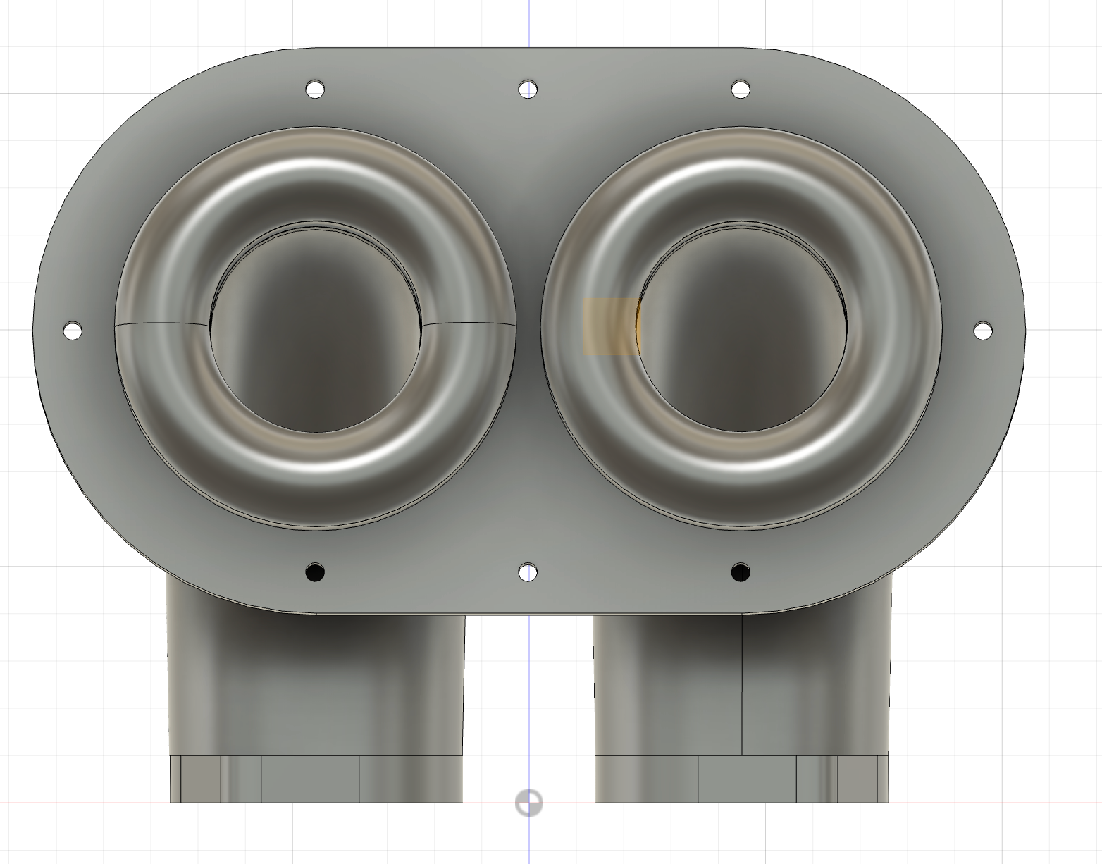

OK, first pass at the carb trumpet elbows. These are 85 degree bends with a bell mouth trumpet. The idea is that an air filter will sit atop the bell flange, and with the carbs tilted 5 degrees, the 85 degree bend will place the air filter horizontal.
This was a fun exercise in 3D modeling. I'll check the dimensions, and add some webbing for strength, and then print a set of these too...

Are you sending/paying to have these prototyped in PLA or something else? I can throw these on my printer if you want. Super easy to do. Very cool looking!
Yeah, I sent them to Xometry that printed them in some ABS material. The finish is very good! These are really just templates for checking overall clearances in the engine bay. Once I confirm the fit I'll either have them cast or machined in Aluminum.
Thanks for the offer! I may take you up on it if I need to modify anything.
Definitely! I can print abs/asa/whatever pretty much in the plastic or plastic/cf realm..it would fun to do for those intakes. No charge.

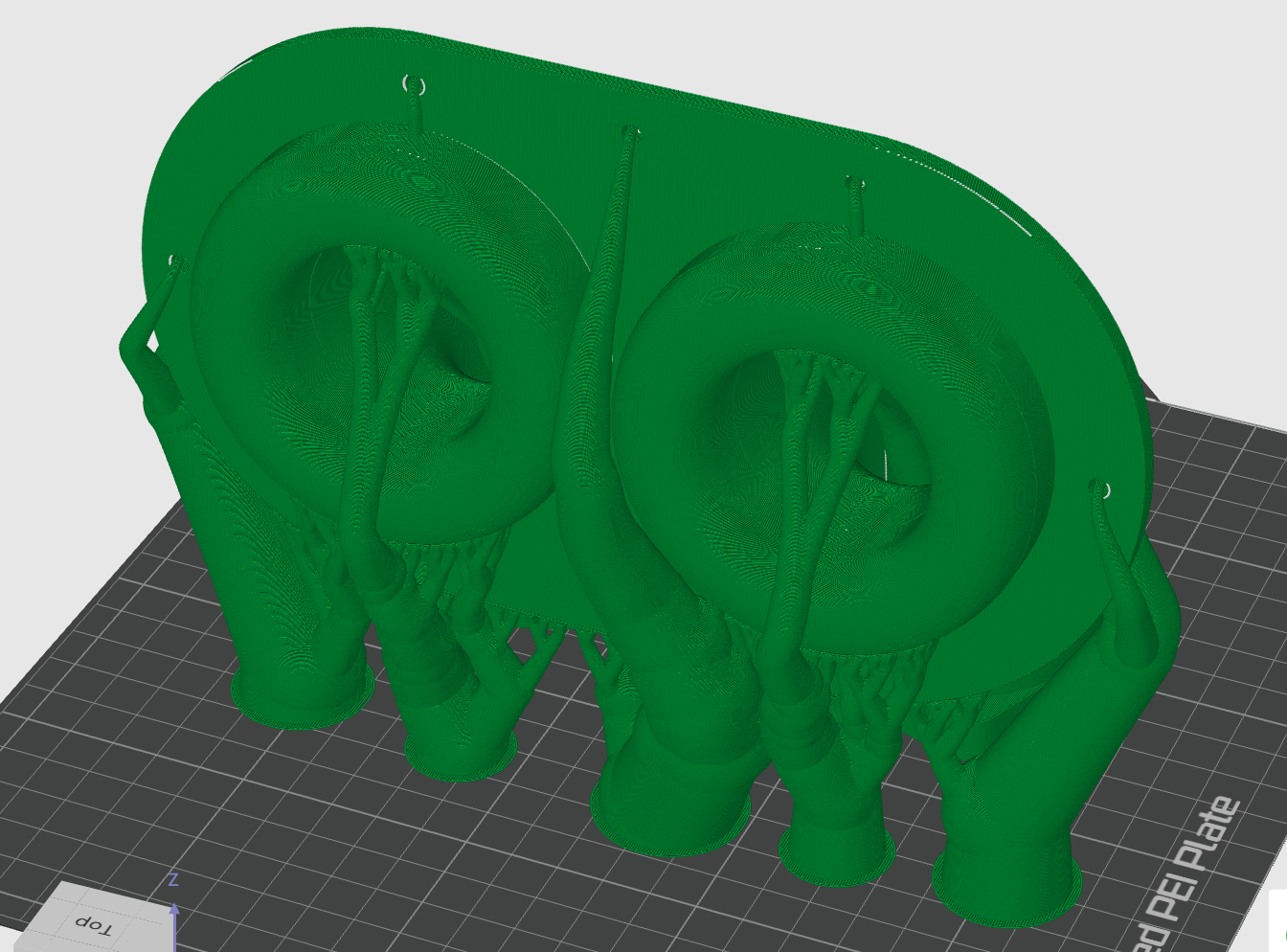

I checked them with the Bambu slicer and they sliced OK with tree supports. Are you referring to the elbow trumpets? I will need to re-run those with a smaller mounting flange. I had not figured on the pair to pair spacing, and the 15 mm flanges I used will just barely clear one another. The new version has a 10 mm flange. But I'll wait to see if there are other changes.
