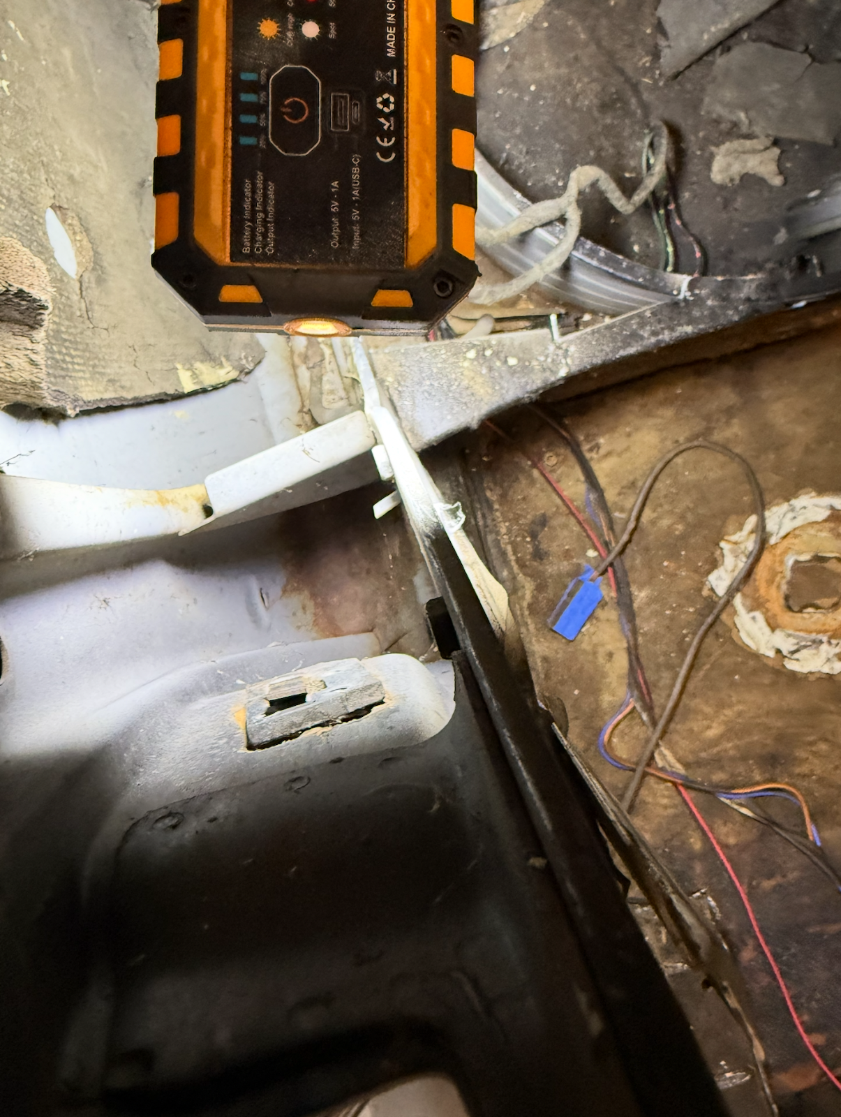

I did discover what appears to be some wonky wiring up near the battery. There are a couple of sections taped with plastic electrical tape. These have terminals that look like they are supposed to go to the battery positive terminal, and a set of inline blade fuses spliced in... Odd... But I was planning to redo the entire harness anyway..

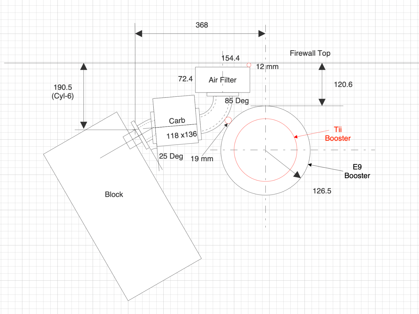

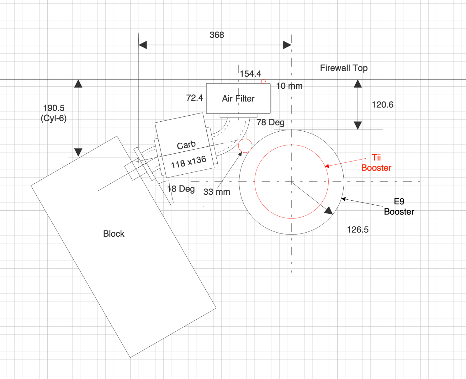

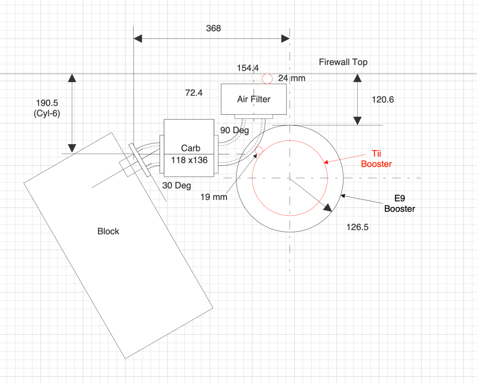

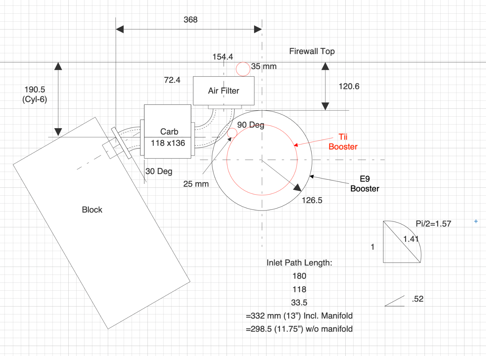

So I have been doing some measuring on my coupe, and exploring various options for intake manifolds using triple Weber 40 DCOE carbs.
The core issue with these, as most of you are aware, is interference with the brake booster. I am not super keen on having intake trumpets that almost interfere with the booster and the inner fender, and that are somewhat problematic relative to any sort of air filter.
My journey started when I bought a set of conversion manifolds from Pierce Manifolds. After measuring these, it appears they are about 18 degrees. They seems to be the same as those available from others (all made by Karsuntpartz), and I must say, they are really not very well finished.
I went over to the shop and set up a laser level to provide a datum in the engine bay. In this case I used the top of the firewall, which, while it may not appear so, sits even with the fender flange at the hood, right about where the shock tower is. Measuring down from there, I came up with a rough cross-section of the engine at cylinder 6 (the aft most one). The engine tilts up from there, rising about 31 mm from there at the front.
I then took dimensions from one of Tim Mason's beautiful billet air filters, and some rough measurements form the carbs, and tried various options and positions.
Using the 18 degree manifolds does not seem like a great idea. First off, since the engine sits at 30 degrees from vertical, the carbs are tilted 12 degrees back. While the carbs can tolerate some tilt, this is pretty extreme, and is outside the 5 degree limits that @Stevehose suggested. I can make it work with custom 78 degree elbows leading up to the air filter, and just miss the standard brake booster, but this approach seems to have a lot of compromises.
I then tried a 25 degree manifold. This places the carbs at a 5 degree tilt toward the engine (better). This also works using elbow trumpets and a standard booster.
It is pretty obvious that the critical points are: 1) the clearance to the under side of the hood, 2) the clearance between the air filter and the carbs, and 3) the clearance to the brake booster. This last one is very tricky because, since the booster is round the clearance is affected by both the vertical rise of the assembly, and the later al extent.
Some observations: The lower the angle of the intake manifold, the greater the tilt of the carbs (obvious), the more the entire assembly moves vertically, which helps limit interference with the booster, but it also starts too create headroom issues with the hood (if you are using an air filter instead of trumpets). The higher the angle of the manifold, the less the carbs are tilted, but the more the assembly moves laterally, which may cause interference with the booster. So, there is a complex non-linear relationship between the manifold angle and the three clearance points (hood, carbs and booster).
I also found that there are some 90 degree trumpets made by Kooglewerks, which seems much cheaper than making special 78 or 85 degree trumpets. Those seem to really only work with a 30 degree manifold unless you are OK having the air filter tilted sideways.
I finally caved in and tried a design using the 90 degree elbows, a 30 degree manifold, and a Tii booster. That seems to be the best solution. The beauty this approach is not only do the carbs sit flat, but there's relatively little vertical rise, so the vertical clearance is easier to manage, and the 90 degree elbows work. I will still need to account for the fact that the front of the engine is about 30 mm higher than the back (it rises by about 6 mm per cylinder), so to keep the front of the filter from hitting the underside of the hood, I'll need a tad more vertical clearance.
I think once I get the dimensions nailed down more precisely, I'll make up a solid model, 3D print a prototype for fit testing, and start looking at casting my own manifolds...
Here are some diagrams representing these three options. There is a bit more to do in terms of precision measurements, but I think I am homing in on an optimal solution.

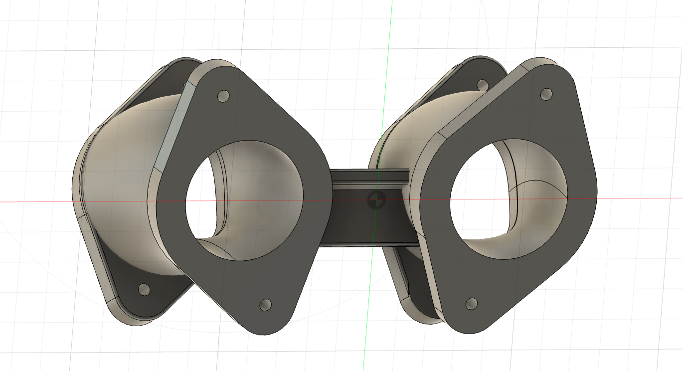

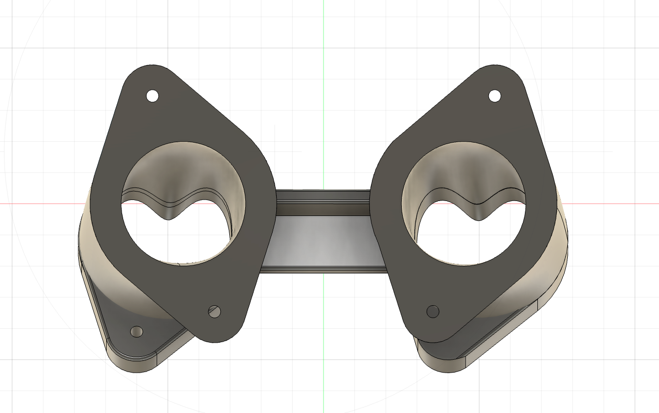

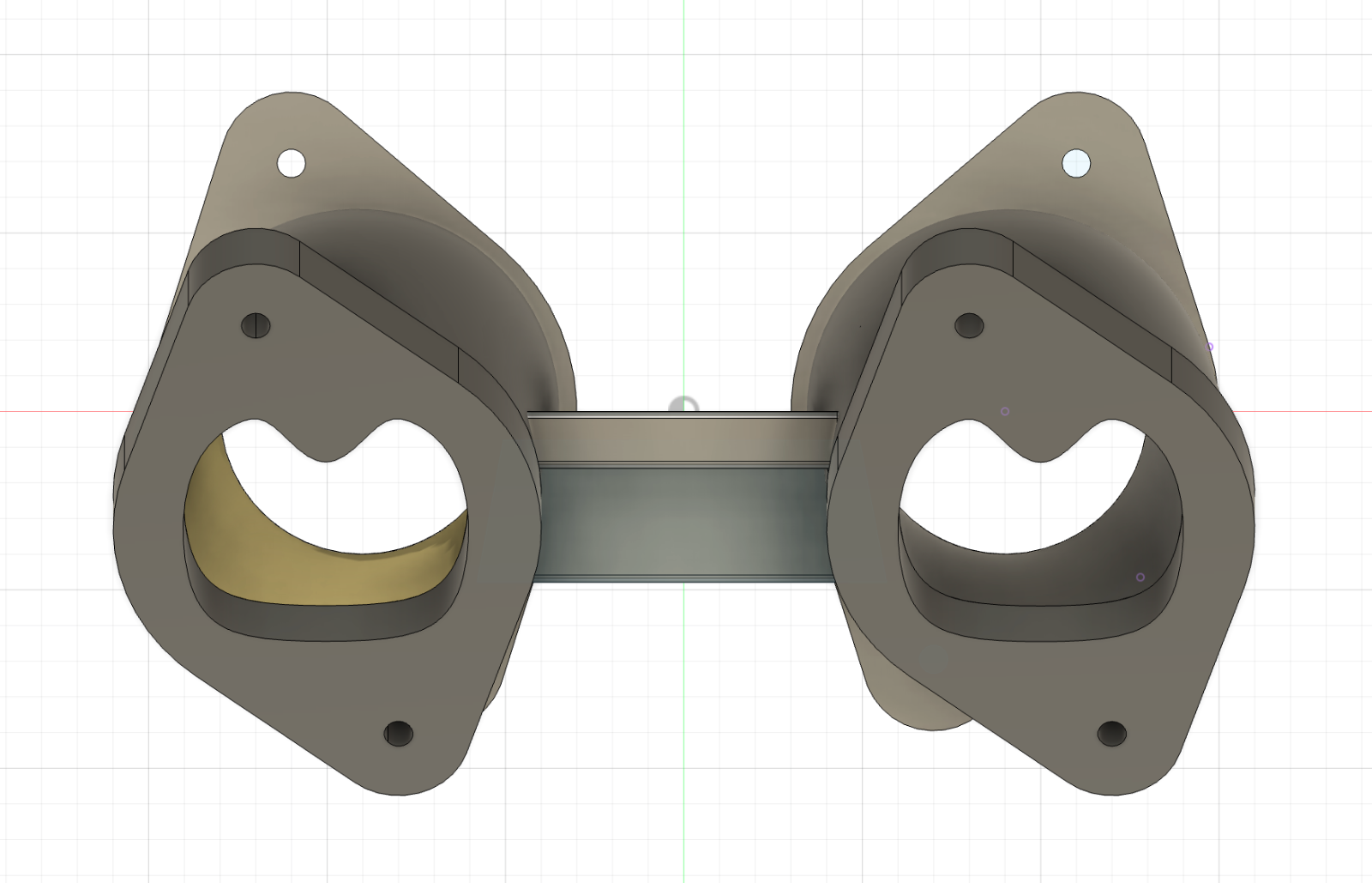

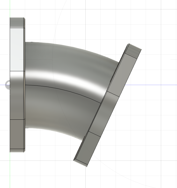

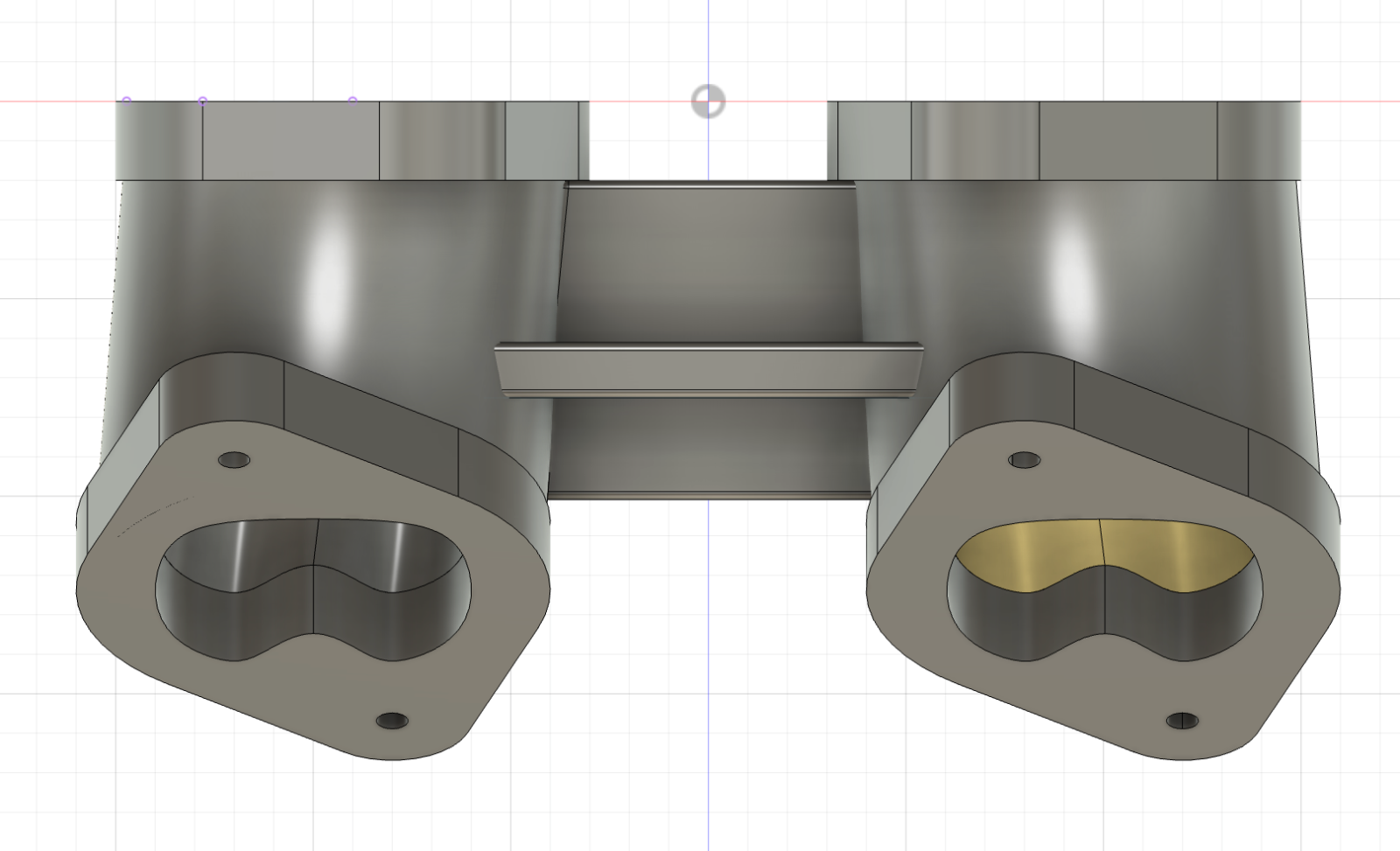

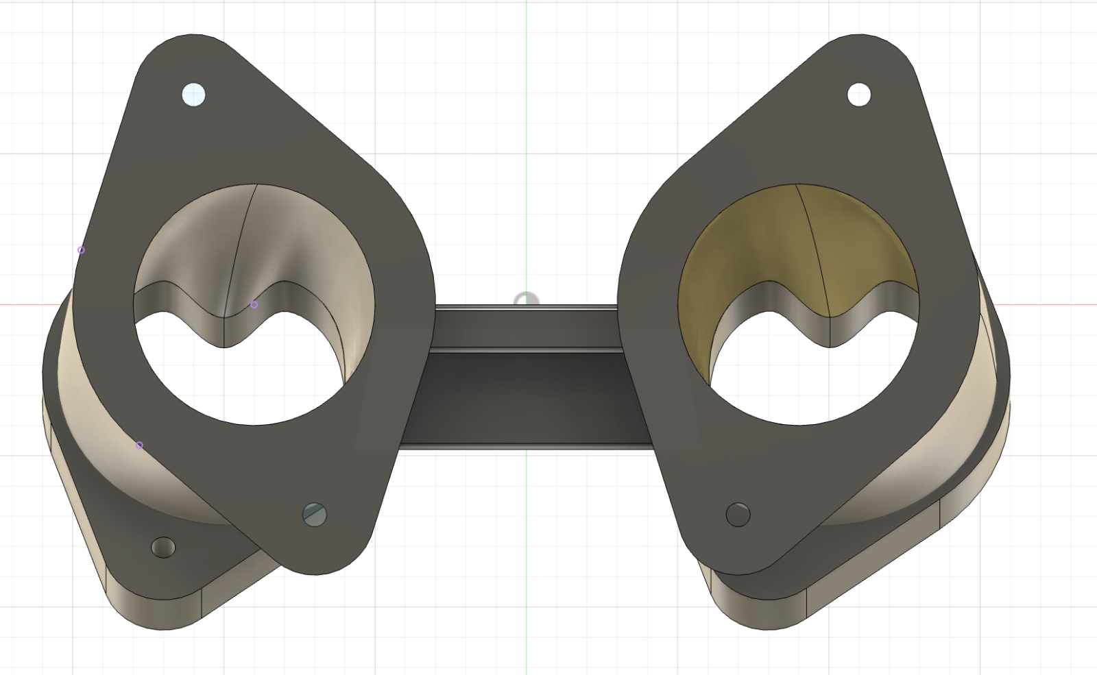

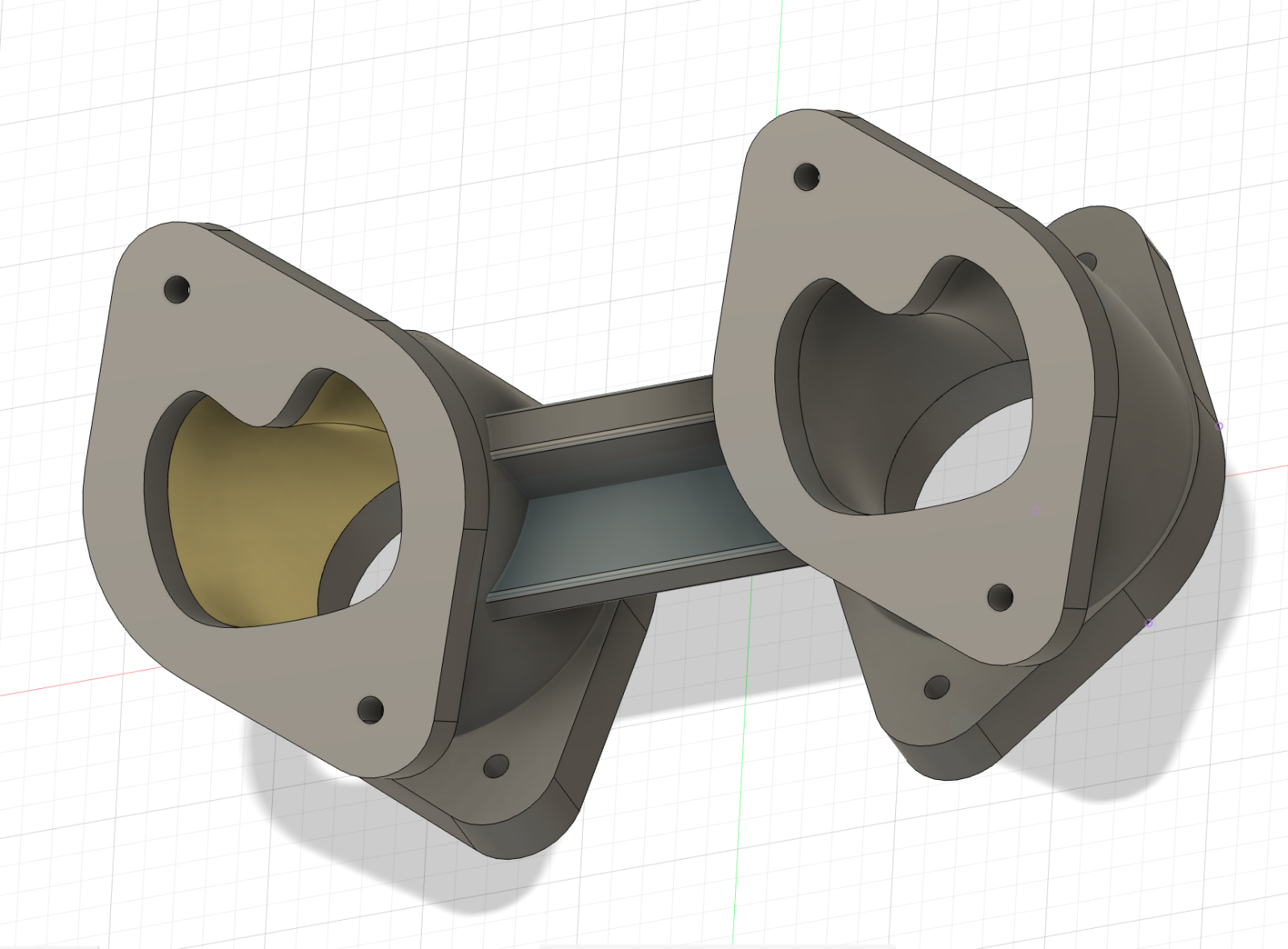

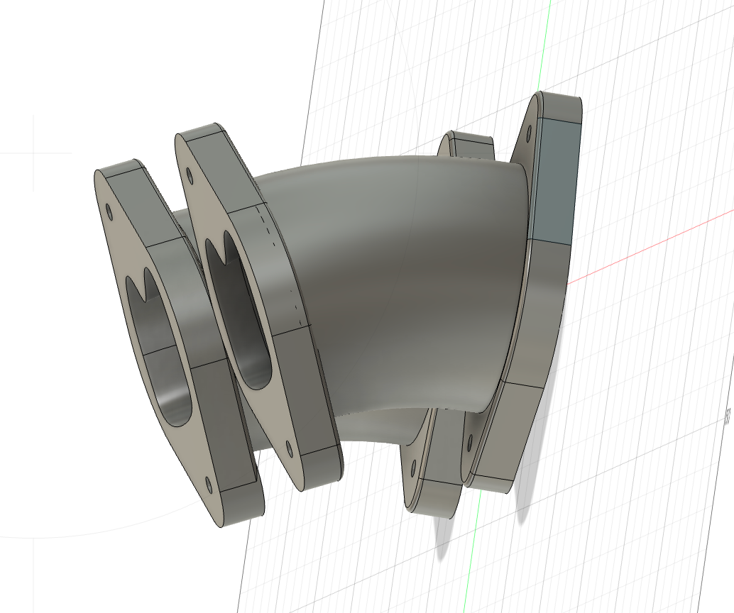

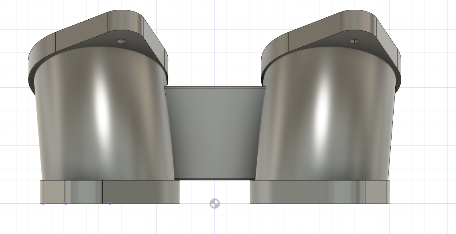

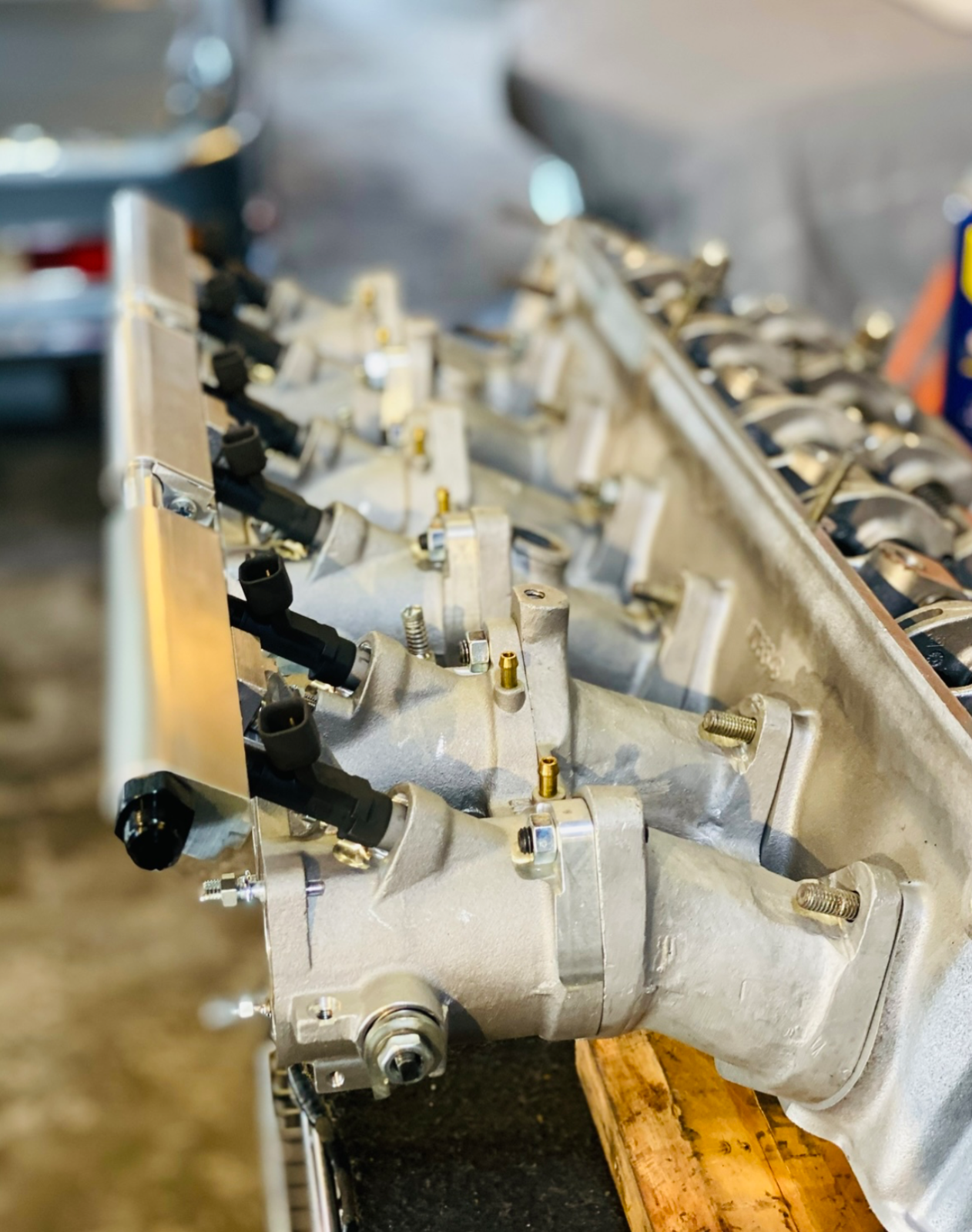

Based on my post above, I whipped up a quick 3D model of the 30 degree manifold. Seems pretty straightforward. Need to figure out how to cast this. The flange holes are pilots. I'll also have to taper some of the bits and add fillets. Next step will be to 3D print this and check for fit. I may need to print it in several parts and glue them together.

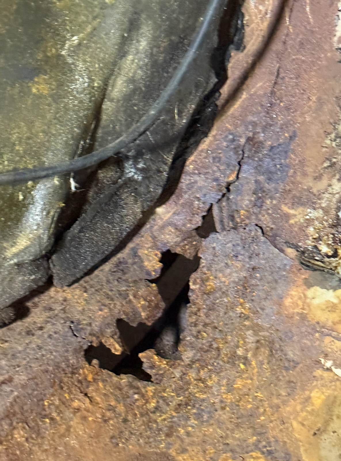

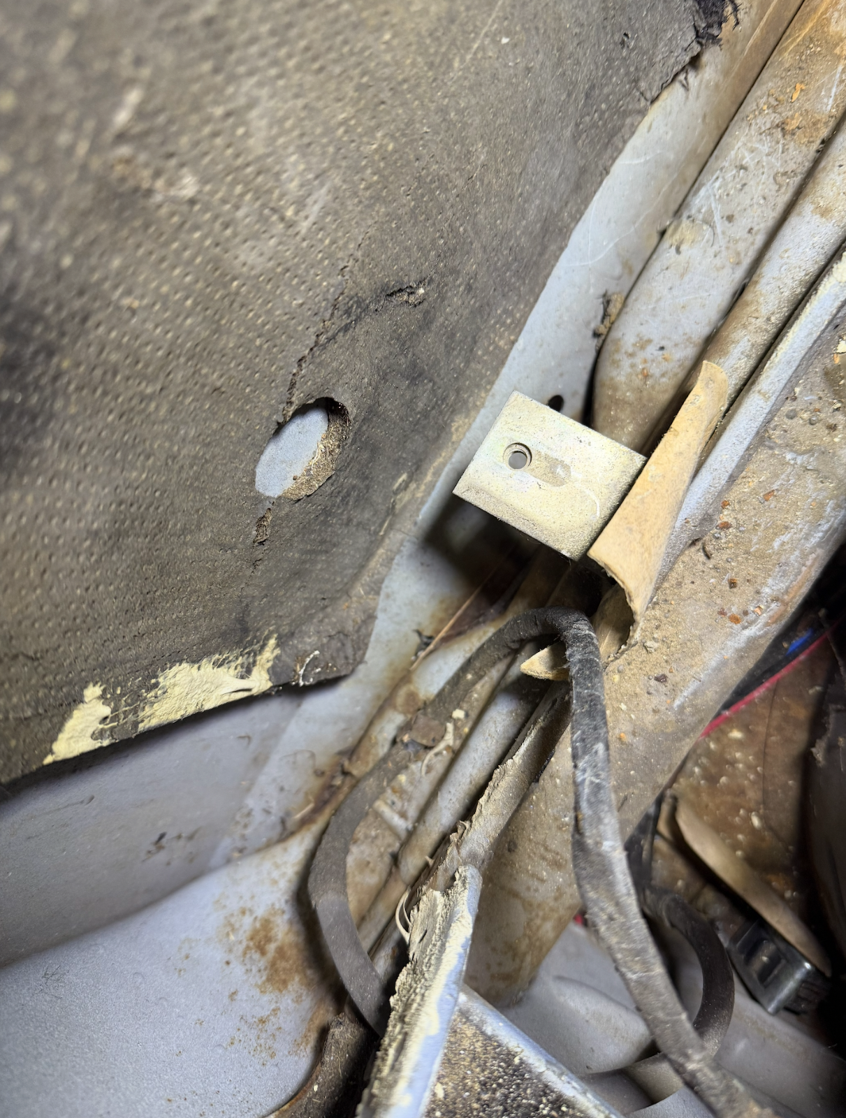

Spent several hours over in the shop working on the coupe.
Spent quite a while with a borescope examining the wheel wells and "the shelf". Other than a TON of dirt that I scraped and vacuumed out, the rust there looks to be just some surface rust. Nothing serious, although accessing it to clean it more and coat it to keep it from progressing will be a challenge. I'd post pics, but they are a bit like looking at your embryonic kid inutero via ultrasound.. more weather map than image..

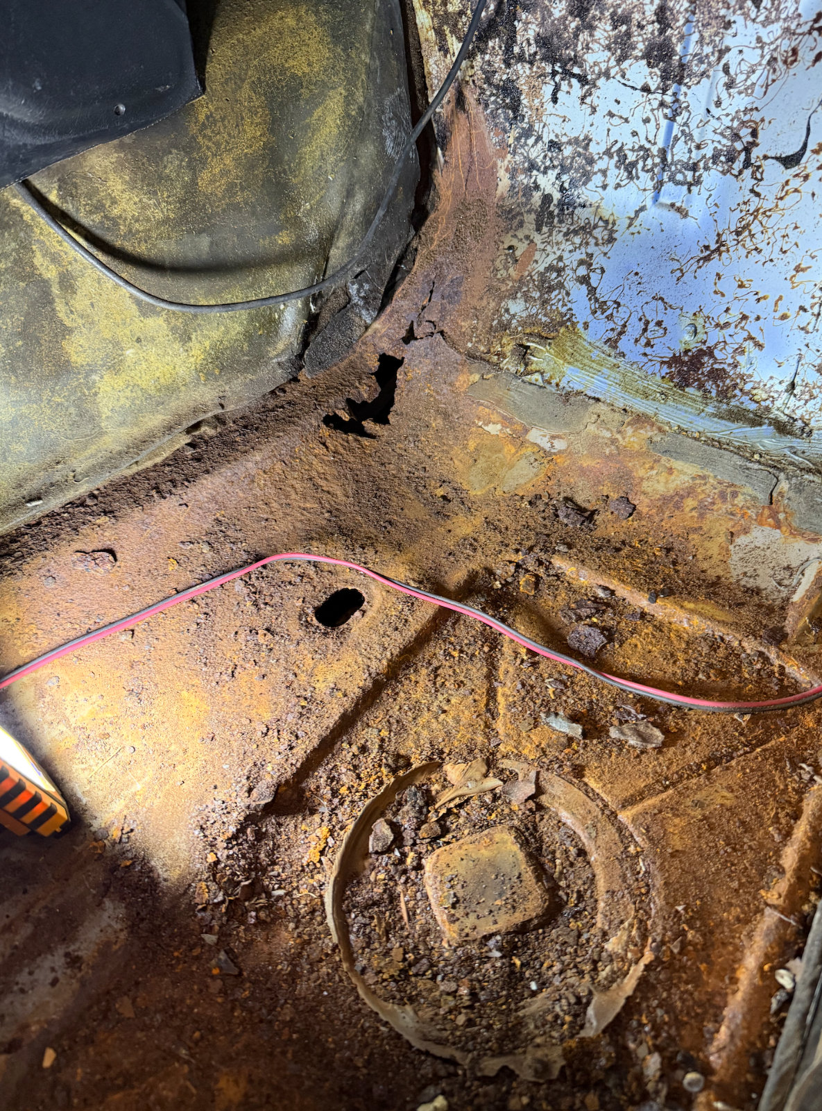

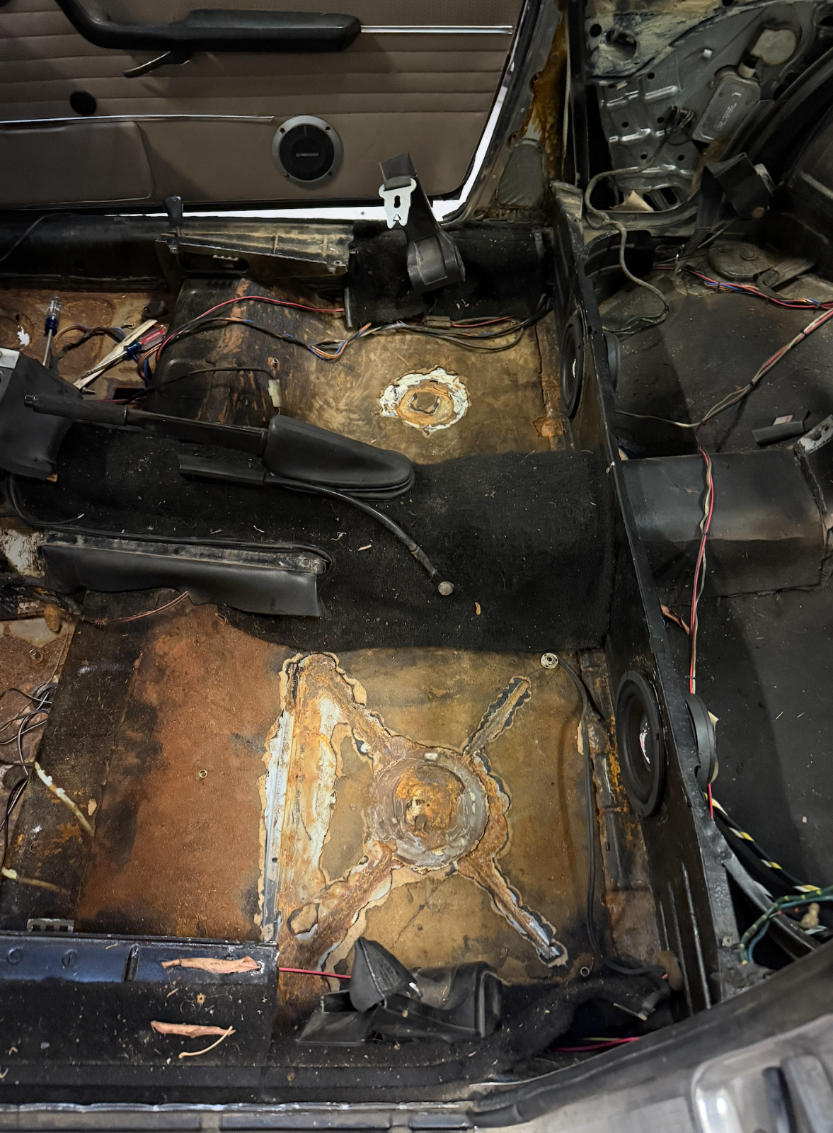

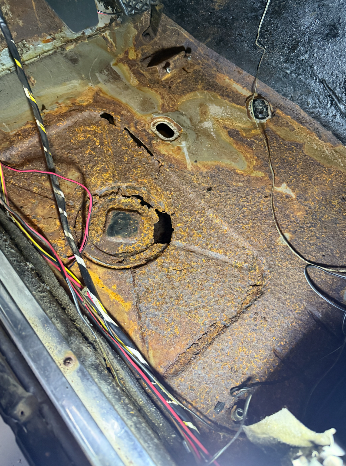

Next I pulled the front and rear seats out, and pulled up the carpets and floor insulation. Looks like @Breiti was spot on about rust under the "tar panels". The fronts were rusty enough that the tar stuff just lifted off in sheets and bits. The passenger side is worse than the driver's side. I think this may be from condensation from the AC. Here are the ugly pics.
Passenger side:
The floor panel seems easy to replace, but I am concerned that the replacement panel may not reach far enough inboard or forward to fully patch this. I can't find any other trans tunnel or firewall patch panels on line, so I guess that means those areas will need to have patches fabbed. Looks like a small-ish section about 2 inches wide and about 5 inches past the firewall/floor joint.

Notice that some joker cut speaker holes in the lower rear bulkhead (SMH...). I'll probably patch those..
a lot of coupes have speaker holes there. not unusual. consider putting a passive radiator in the holes and mount a subwoofer under the seat.
2002s have a similar bulkhead. Out of the four 02s I owned, three of them had speakers in the same spot. I like Scott's idea.
Very nice 3D renderings from Solidworks or a similar CAD program. Instead of casting those intake manifolds... why don't you have them milled out of T6061 billet by a shop like ProtoLabs or an equivalent machine shop? There are lots of web-based machine protoshops that will bid based on IGES files...
Yeah, I may do that. I also found some prototype shops that do 3D printing in sand (!!), for complex castings. So, several options seem to be available.
I did the drawing in Autodesk Fusion 360. Nice free version is available for personal use. Pretty steep learning curve, I have found. The drawings above would not render in a 3D slicer program because of the way I did the "tubes" (they were basically two meshed sleeves, with no solid material between the inside and outside surfaces...). I have since reworked the approach, and have a rough design that properly renders. I will do that with more precision over the next few days, and post the results. Fusion shows IGES files in the export menu, but they are greyed out. I have been exporting STL files for printing. I'll explore what's up with the other file formats.

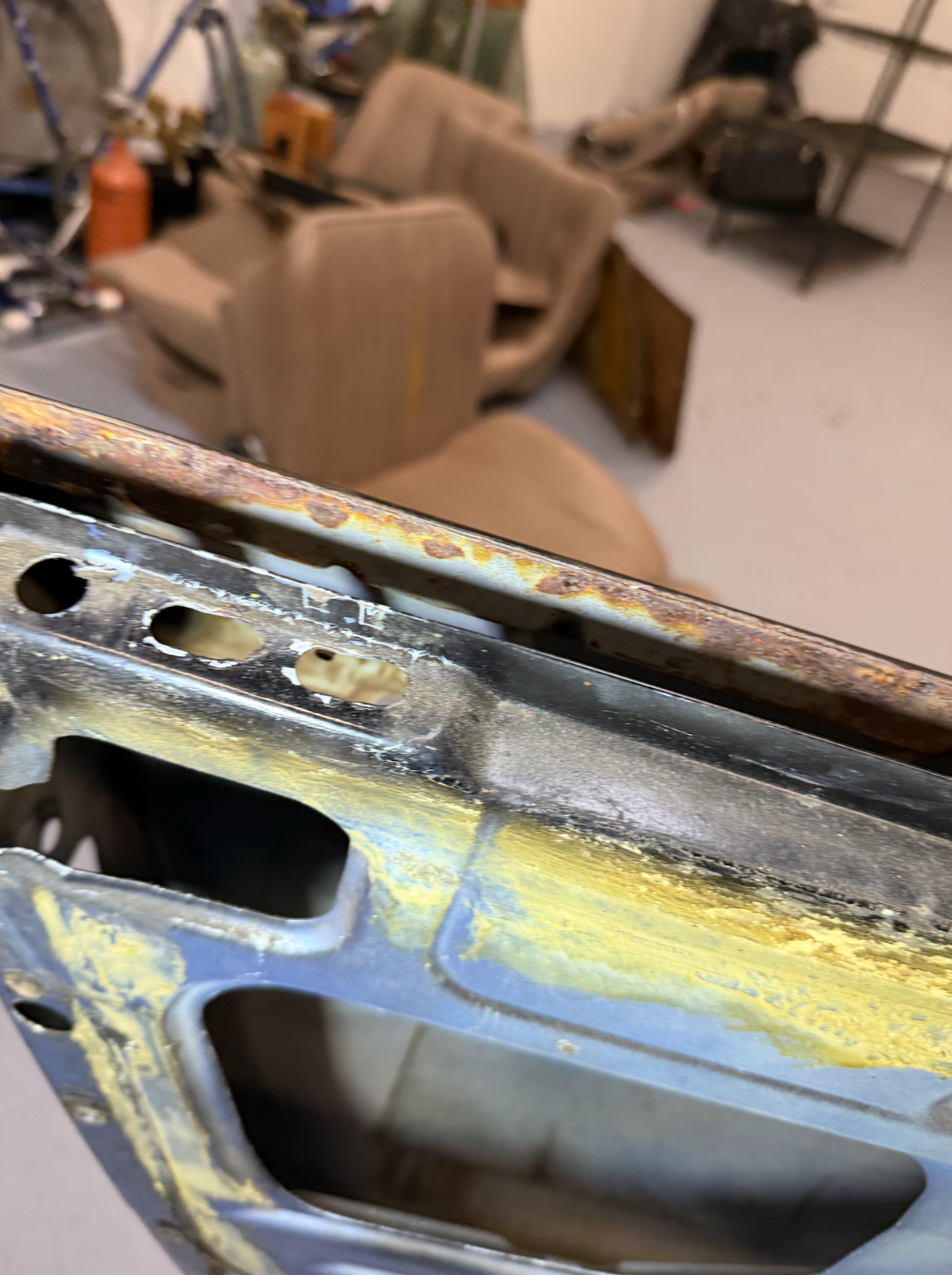

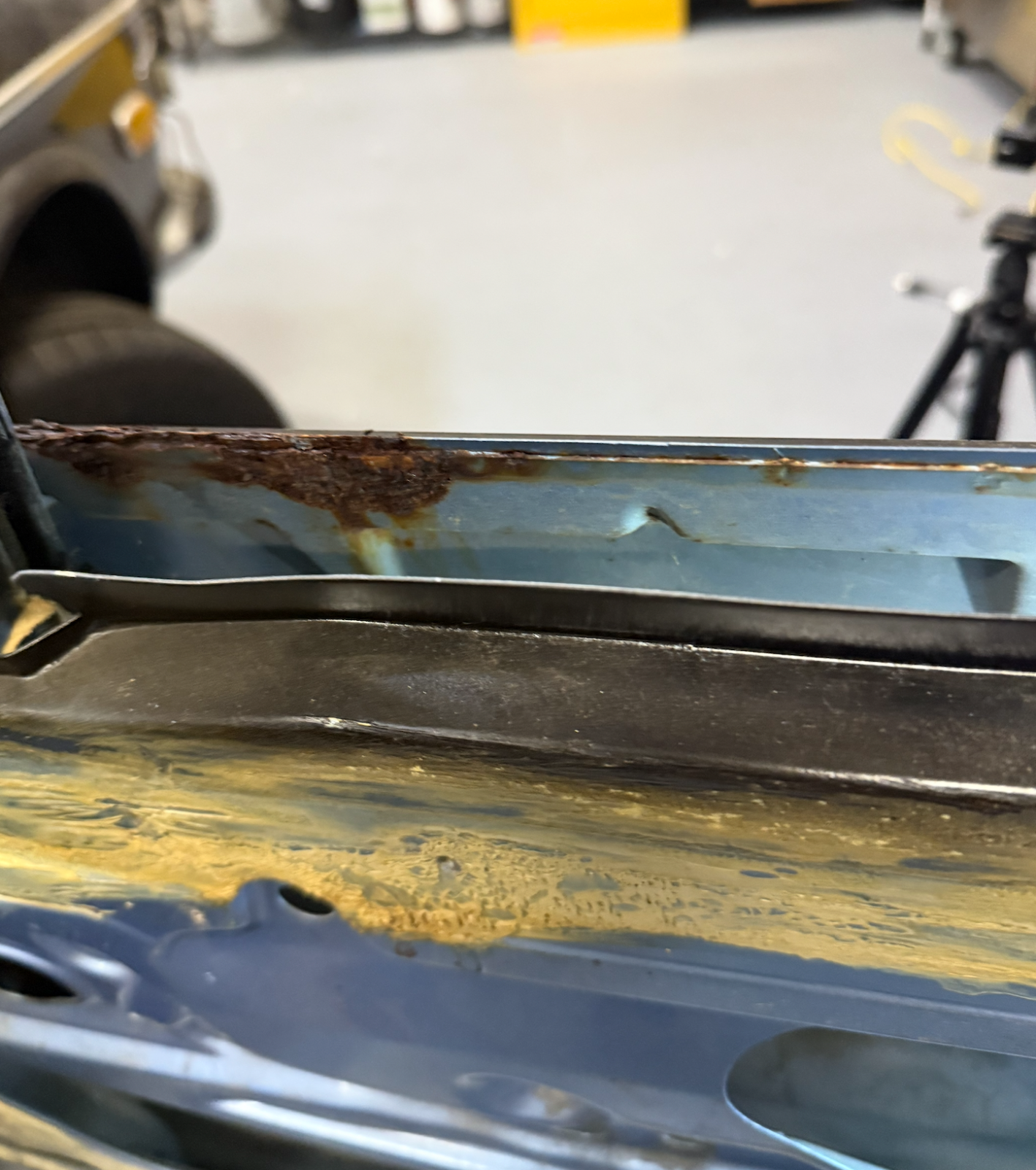

Made more progress on the coupe disassembly today. Managed to work out how to disassemble most of the passenger side door. I am currently a bit stuck on how to remove the vent window handle. As I recall @rsporsche provided the trick in a recent post, so I'll go find that.

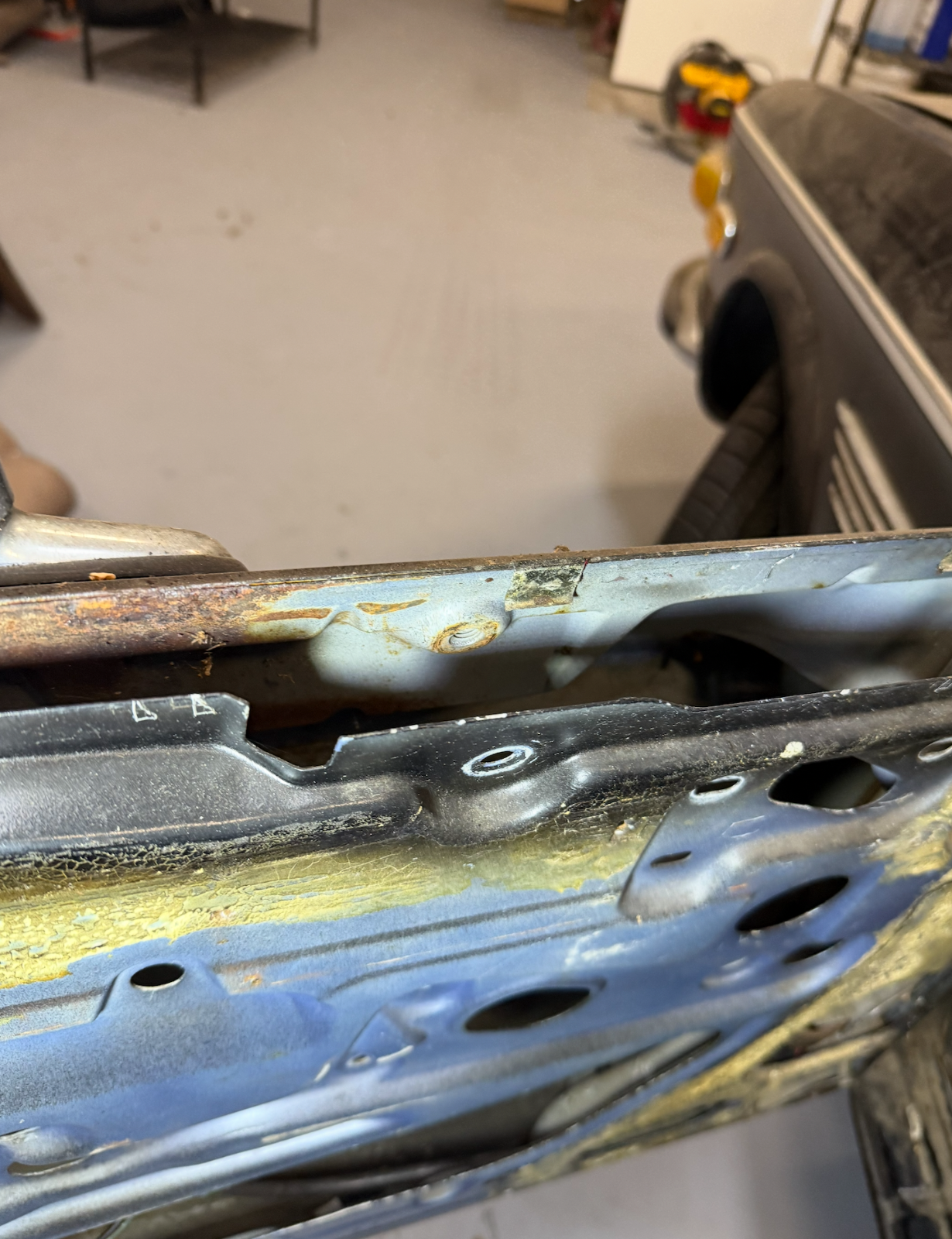

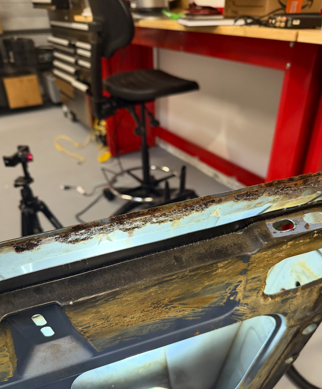

The door bottoms have no rust, which is good, but I did find some rust along the upper edge of the door, where the window trim strip slides on. The sandwiched joint where the outer and upper inner shell join has several fairly substantial rusty spots. All of these are on the inside piece, and do not perforate to the outer shell. Not sure if these are structural, since the rust scapes off, but it is a lot more than typical surface rust. I'll probably scrape and file it clean, and then see what's left
Here are a few pics.

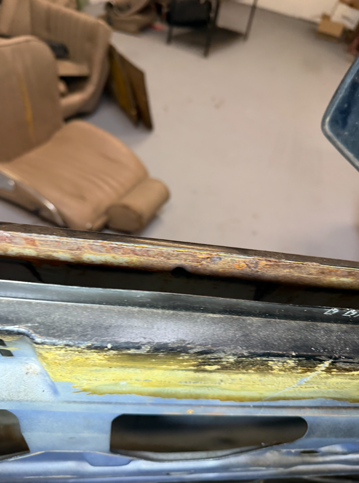

I then moved to the rear windows. Once I sorted out how to remove the trim strips, that was easy... I am pleased to have found no rust on the window sill area, and peering down into the rocker, it appears that the rust I found on the outside is only on the lower edge of the rocker, and only in the outer and middle rocker panels. So, that repair should be fairly easy.
Here is the rocker from the top side (inside the rear window area).

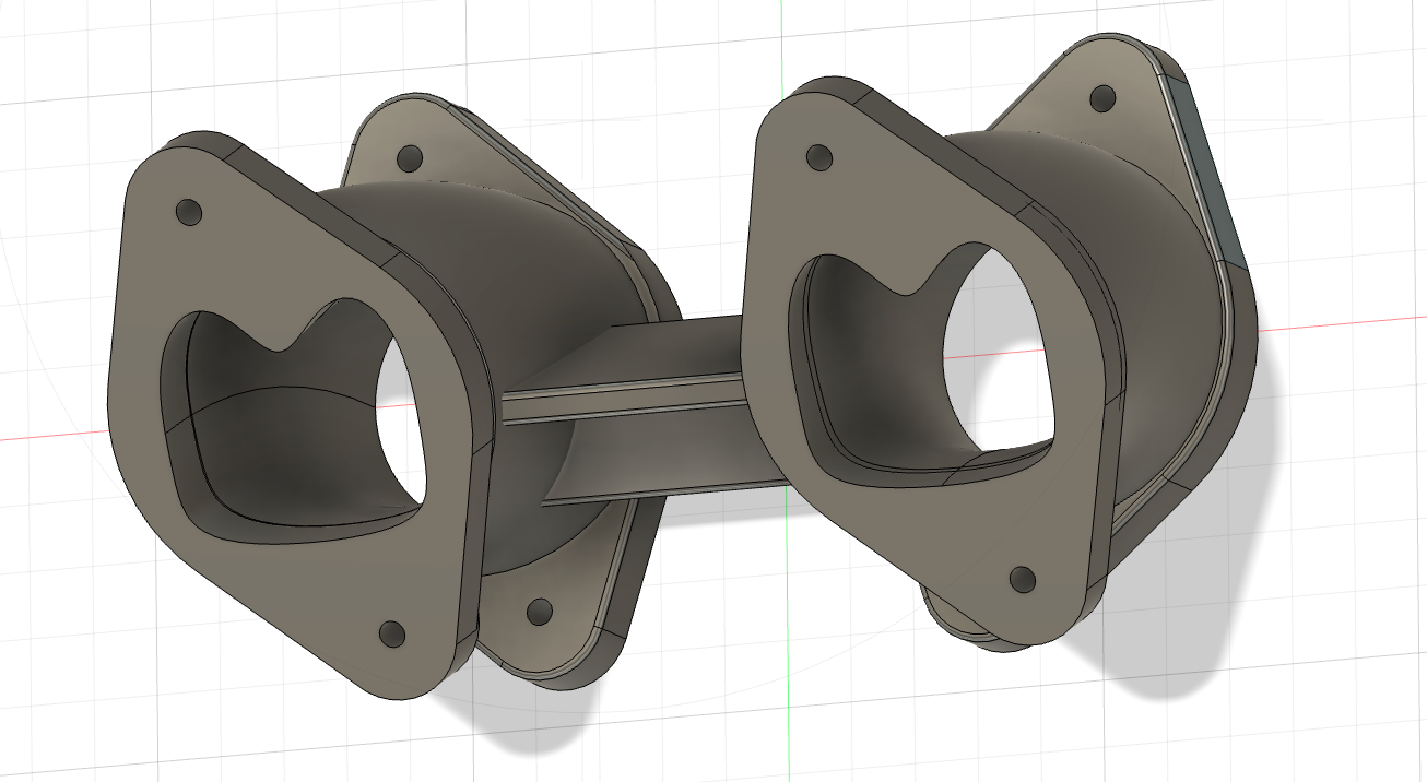

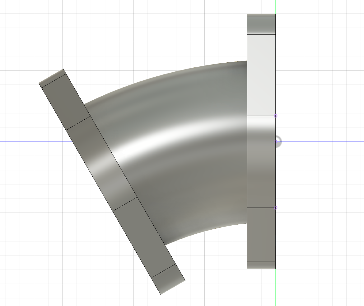

OK, so after reading through the Weber books that recommend some small tilt to the carbs (5 deg), and learning a new modeling software package (Fusion360), I think I have finally settled on a manifold design. This is a 25 degree unit, that "should" clear the brake booster. Not yet sure about clearing the thermostat. This one is properly designed so it can be fabricated on a 3D printer. So I'll have some prototypes printed (these are about $50 each) to check the fit. If that's all good, then I'll have some aluminum ones cast.

Great plan! 3D print the prototype in plastic, do a fit-check and iterate until you're satified with the final design. Then it's off to the machine shop...
I was pretty surprised. $75 for three of them, printed off-shore. US printing would have been about $180. Still pretty inexpensive... Great way to make sure you have it right, before committing to real fabrication.

Got the other rear window mechanism out. Had a few minutes of consternation when the window would not roll down and it was in the way of the one little screw that holds in the upper window trim.. I gave the motor a little nudge while holding the switch and miraculously the window rolled part way down before stalling. So, dodged a bunch of work there.
I also did more rust assessment, and had a discussion with Mike Pelly, about floorpans, so that's now in process. Looks like the driver's side will be an easy fix. The passenger side will require a bit more surgery up at the front left corner, at the trans tunnel.

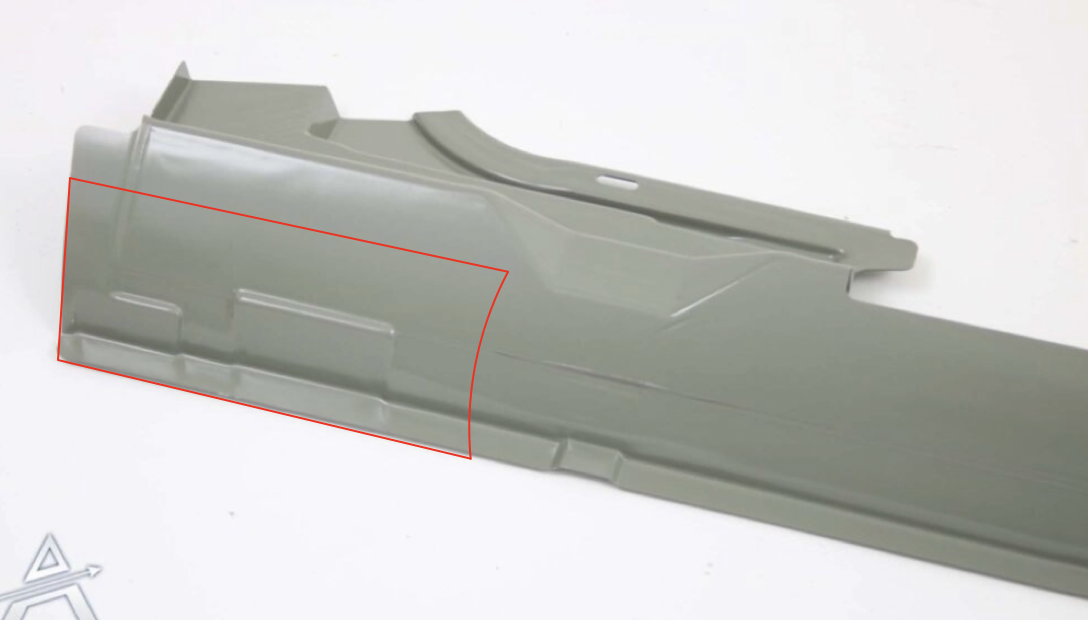

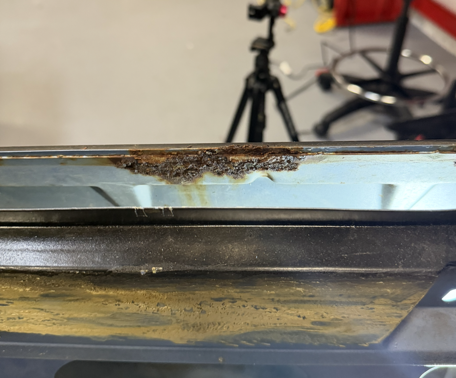

I took a long hard look at the rusty area in the rear right rocker. Having studied several threads where folks replaced the rockers, I finally understood what I was looking at from below (via a section of fender that I cut out years ago) , and from above (through the now open rear window area. The issue is the outer covering piece, which in that area is covered by the lower section of the quarter panel forward of the rear wheel. Turns out this is rotted only about an inch or so up from the bottom. The inner rocker is a bit rusty, but it is solid, and the top portion of the covering panel is fine, so it looks like I will be able to cut the quarter panel away below the lip where the outer rocker cover sits, cut a section of the rocker cover (the one inside the quarter panel) out, and weld in a new section of the inner cover. I have the entire inner cover, purchased new from BMW back in 2006, and will use a small portion of it (about 8 inches from the aft end and about 2 inches up from the bottom. Then I'll weld in the lower quarter patch panels (also bought back in 2006), and clean things up. The patch lines will be hidden under the outer rocker covers, so this seems like a pretty easy repair. I'll probably do the other side too, just as a precaution. Now that I have a template, I may just fab the inner rocker cover section from scratch, since it seems like a lot of extra expense to buy the entire long piece and only use a few square inches of it. Here is the section that is rusted.
So, I am a little dismayed by the floor rust, but that seems easily repairable, and the rocker rust is much simpler than I thought.
I was really surprised at the amount of grit and sand hiding in the rocker panel. I guess it gets thrown up into the rocker drains, and over time just accumulates..
