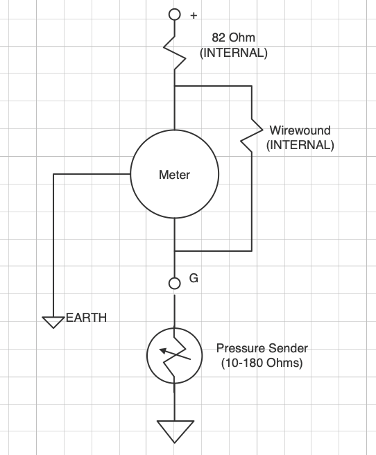

Hi Lance. The oil pressure gauge is also a bit odd. It is expecting a resistance at the G input. So put 12 volts on the + terminal, ground the case, and put a resistor to ground on the G terminal. The resistance should go between 10 ohms and 180 ohms

Here is the Oil Pressure setup. To test the meter, you have to connect it to 12 volts and ground, and then connect a variable resistor between 10 and 180 ohms to the G terminal..

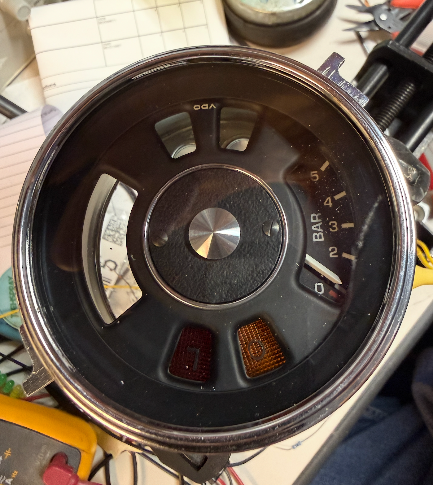

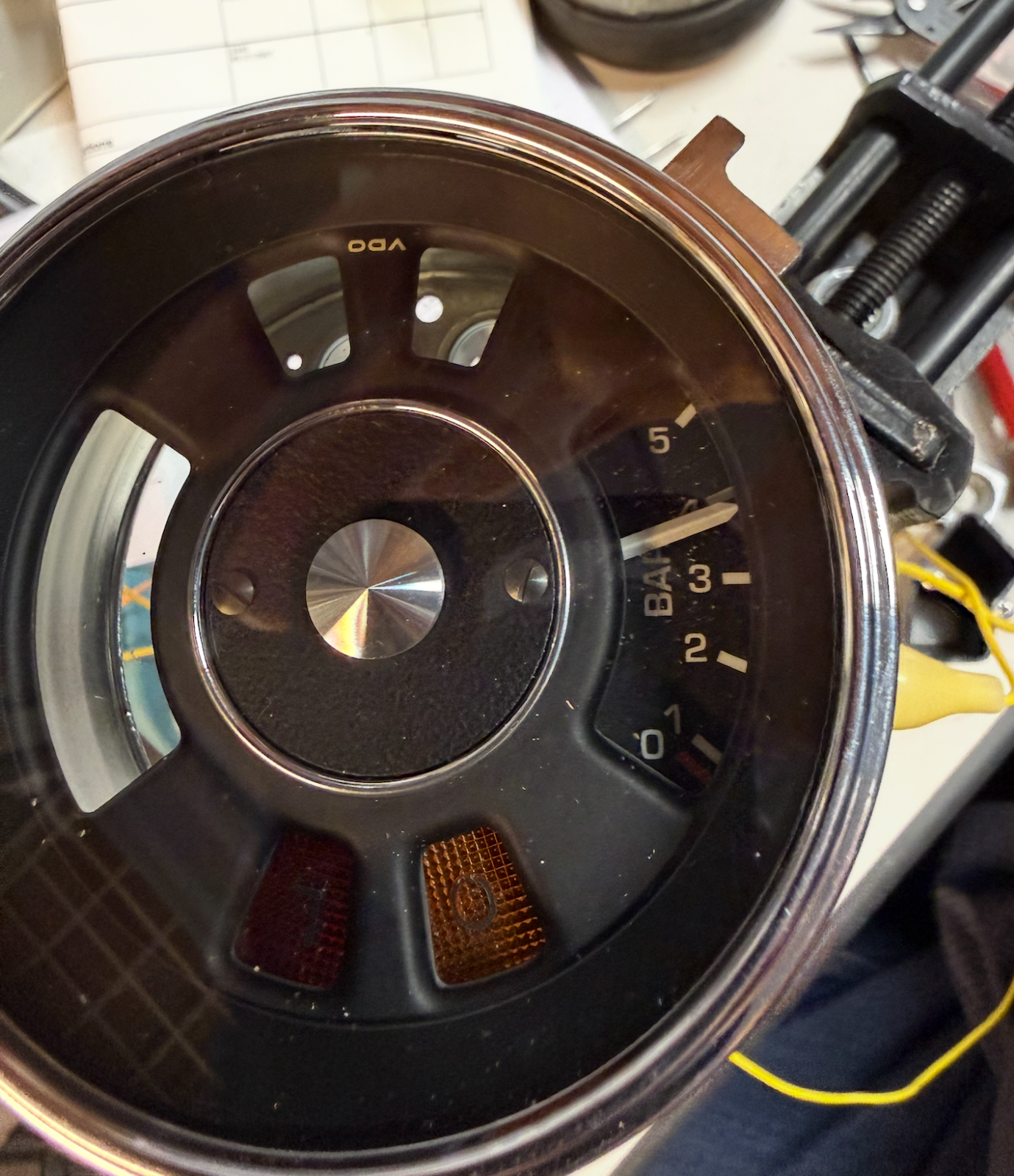

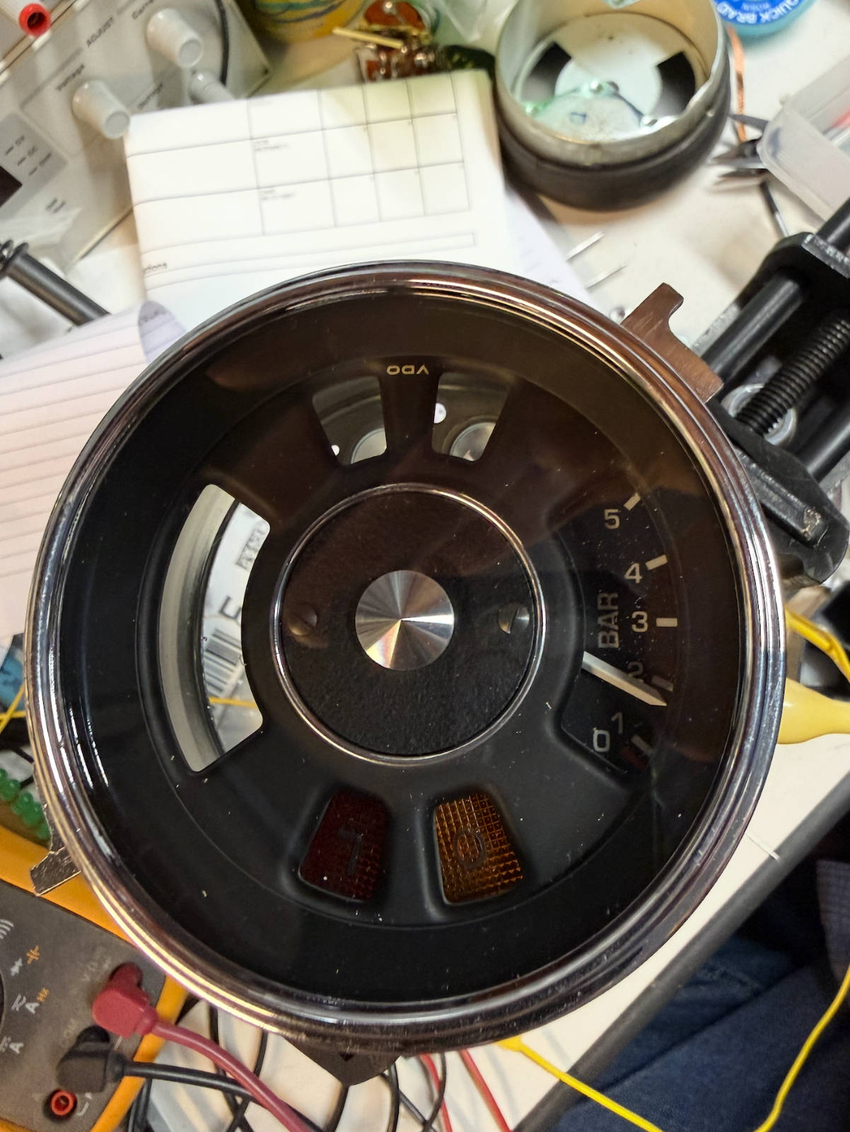

Here are some pics of my 911 meter in the BMW gauge withthe revised gauge face. This is using the above test circuit with resistors connected between the G terminal and ground. And yes, I recognize that I have the gauge pod upside-down...
10 Ohms
32 Ohms
100 Ohms

See the circuit above. The only change between these images is the value of a resistor between the G terminal and ground. This mimics what the pressure sender does.
So I am basically just simulating the pressure sensor with various resistances to gound.
So just hook up 12 volts to the + terminal, ground to the little metal spade with the ground symbol (see below), and put a 100 ohm resistor between the ground terminal and the G terminal. The needle should move by about 2/3 of the scale.Screenshot 2026-09-03 at 7.35.55 AM.png

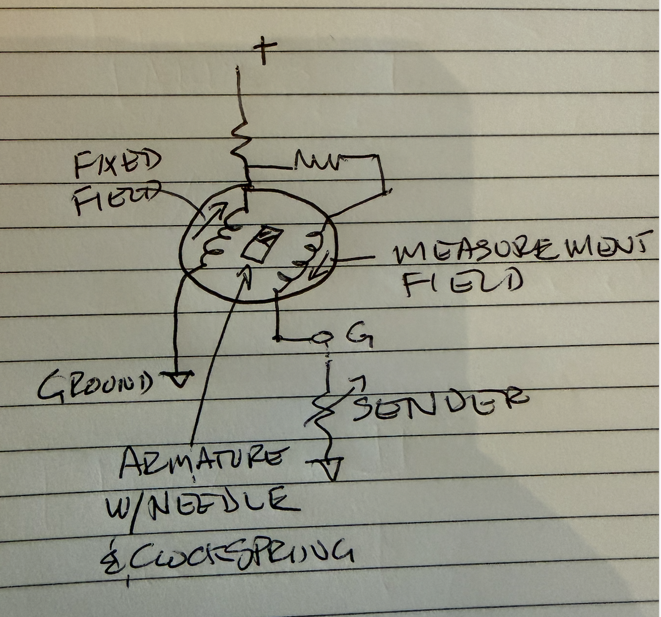

To better understand how this works, let's look at the circuit again...
Here we have the meter with its internal resistors. The meter movement is pretty much like all meters, a small electro magnetic motor, only it doesn;t rotate continuously. There are many ways to make this, but the simplest would be to place a small magnet on a spindle that is connected to the needle. A fixed coil is wrapped around that armature so that it is close, but doesn't touch the armature. The armature has a small clock spring that causes it to sit at the zero position (stopped by some barrier, like a small pin.
When current passes through the coil, it creates a magnetic field, and this causes the magnetic armature to move in order to align with the field. However, this alignment is stymied by the clock spring so the armature and needle only move to the point where the force from the magnetic field is equal to the force from the spring. Add more current, you get more force and the needle moves farther. Add less current and the needle moves back toward zero.
The key observation here is that the thing that causes the meter to move is CURRENT.
So, since the 12 volts applied to the top of the above circuit is fixed, we need a way to control the current. That is done by changing the resistance value at the G terminal. If that resistance is low lots of current flows, and if it is high, little current flows.
Now, I can read your mind and you are wondering how, if low resistance cases higher current, then what is low resistance causing a small meter movement, and higher resistance (lower current) is causing a higher meter movement.
I believe what is actually happening here is that there are two current paths. One is fixed, and causes current to flow though the main coil to ground. The other goes from +12 through the wire wounds resistor and, I believe, through a second coil that is wound in the other direction from the main one. The result is that as more current flows in the external resistor, the second coil creates a magnetic field that CANCELS THE PRIMARY ONE. And this reduces the force on the armature. Like this:
I think they do this for two reasons:
First, the opposing fields tend to damp out any motion on the needle, since the armature is sort of trapped in a low spot between two fields. This reduces meter jitter as the car moves.
Second, it is easier to calibrate the meter this way. The wire wound resistor in the meter is clearly adjusted by adding or removing turns on the spool, so they can apply a fixed resistor in manufacturing, see where the needle goes , and the adjust that by adding or removing wire to get the needle to the right spot. This negates any variation in magnetism in the armature, and any variability in the clock spring from unit to unit.

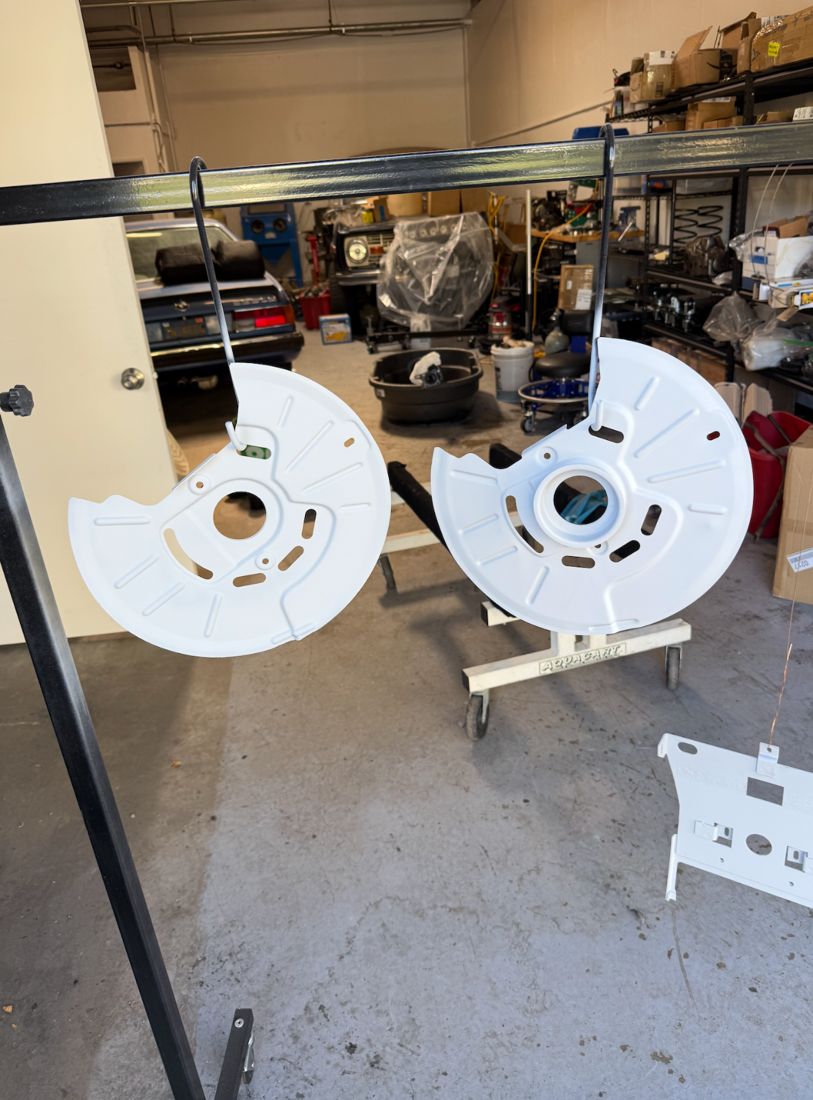

OK. All my chassis stuff is off at the powder coaters. Will be done next week.
Subframes, struts, trailing arms, etc. Then I can finally start re-assembling things!
Plan to do some 2K epoxy painting of the small parts this weekend.
