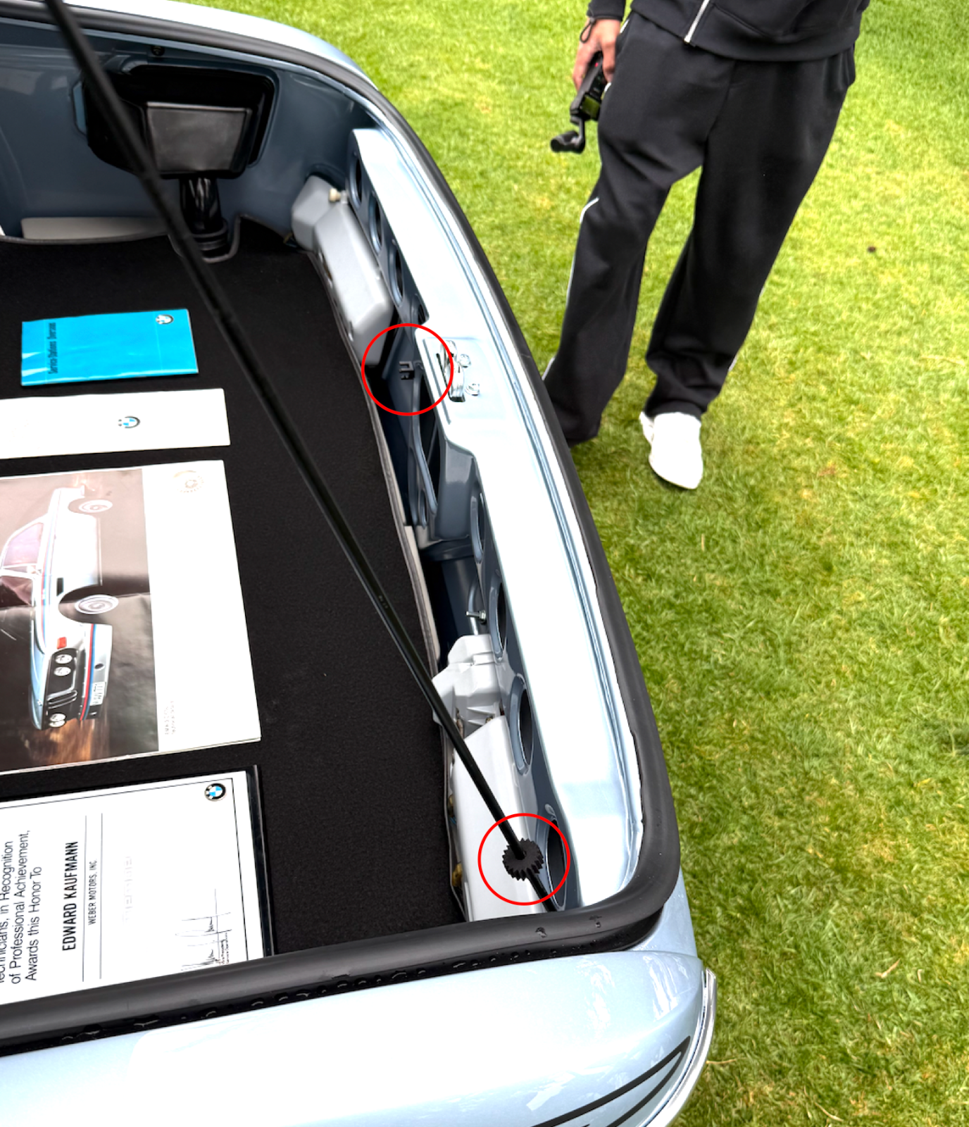

And I am proud to have contributed two eensty weentsy little parts to this effort.
Truly a beautiful car...

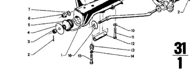

I had the front sub-frame powder coated and really had only two areas of concern on re-assembly. The first was the rubber mounting for the tension strut (#5 in the picture below). I did not ask them to tape the area and had a hell of a time getting the rubber back in. It is notoriously difficult and I could not get it installed, I ended up with a polyurethane / Delrin bushing instead and while I try to stay away from them it has been fine.
The second area that caused an "issue" was the spreader (#12) in the picture below. The clearance was too tight and I scratched the finish on installation. I was concerned that the tab for the sway bar was going to be too tight, but it was fine.

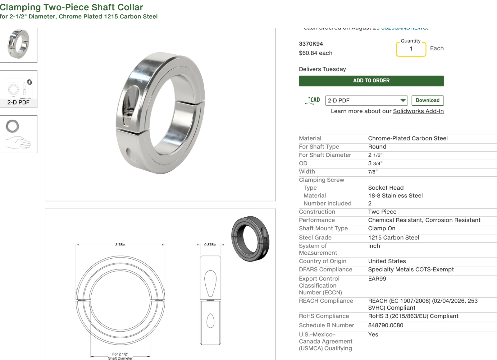

Trying an experiment. Like many others, my inner CV boot flanges (the ones that attach the half shaft side of the differential side CV joint) are all mis-shaped from many years letting the wheels droop down when jacking the car.
I got some new boots that came with the flanges (Rein), but as others have pointed out, these have the raised dimples, requiring the dog-bone shaped bracing pieces, instead of the flat ones I have.
I decided to take a whack at re-shaping the originals. They are otherwise in good condition.
So, I purchased a two-piece shaft collar with the same ID as the flange OD, and a short bit of tubing with the same OD as the flange ID.
I plan to put the tube inside the flange, and place the collar around the flange and tighten the two halves of the collar, probably while moving the collar around the flange a bit at a time. I am hoping this re-rounds the flange, so it can be cleaned and re-used.
I may need to start with a somewhat larger collar.. We'll see...
I'll keep y'all posted!!
Well, my idea above sort of worked. For the flange that was sort of out of round, it straightened it up fairly well. Not perfect, but much better than better than it was. The other one is heavily distorted, and I did get it to look better, but it is not only out of round, but also crooked, so the axis of the CV side is not aligned with the axis of the boot end. It is better, but not really usable...

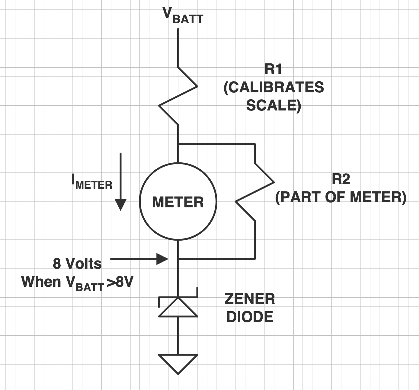

I am still not 100 clear on how these meters work, but they appear to have three wires coming from the movement. In the original application (fuel level) the + side of the meter was connected to the battery voltage, one end was connected to ground, and one intermediate wire was connected to the variable resistor in the fuel level sender. So rather than sensing voltage, they are set up to sense resistance.
Converting this to read volts from the battery was something of a puzzle. I could get it to respond by connecting the + terminal to the battery voltage source (variable so I could tests the meter), and connecting ground to the G terminal. Connecting anything to actual case ground had no effect, but you had to have one of the tiny meter movement wires connected to case ground, or the meter would not work.. Don't ask me why...

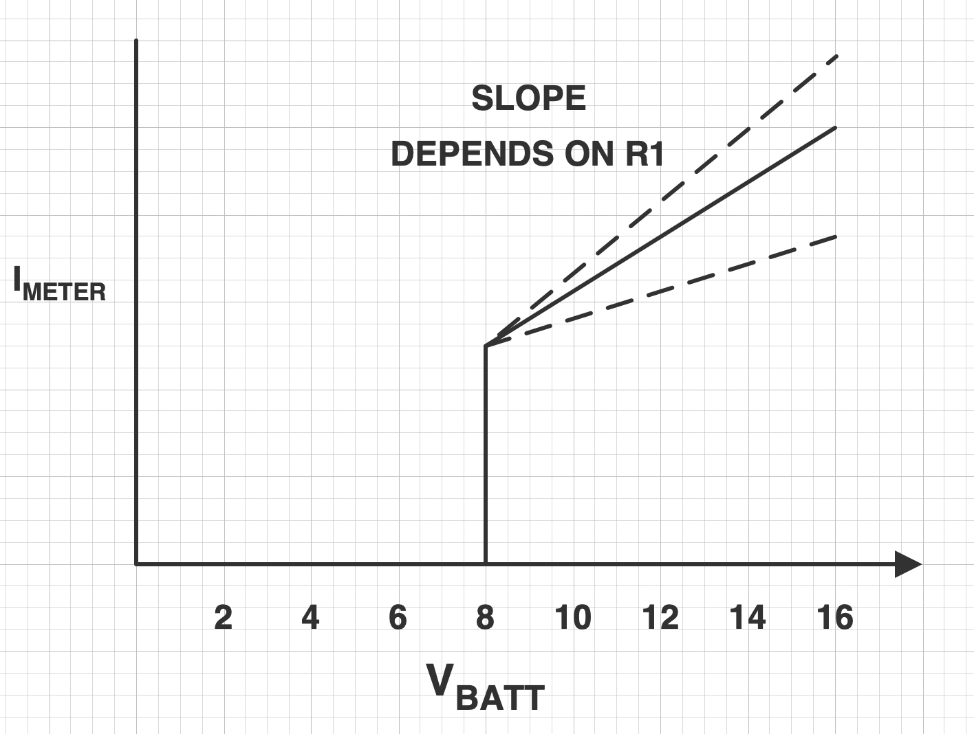

The core issue I faced was that the meter was actually very linear. I could put a resistor in the battery line that would just peg the meter at 16 volts, but then the scale was from there to 0 volts at the other end. In a car any battery below about 8-9 volts is effectively useless, so having a volt meter that told me that the battery was between 8 and zero volts was pretty useless, and then the difference in pointer position from 12 to 14 volts (the range we really care about) was minuscule.
So, how to create a nonlinear drive for the meter movement? Normally with a solid power supply, this would be easy, just make a circuit that bends the voltages in the way we want.. But in this application the basic idea is that the battery voltage in what is being measured, so we can't design a circuit that depends on a known and fixed battery voltage to function, because that will not be there when we need it..
After dinking around with various diode circuits to try to either steer the current through different resistors to change the range , or to create a nonlinear circuit (both of which ended up requiring negative resistor values), I realized I could simply shift the scale of the meter to the relevant range using as zener diode.
A zener diode acts like a regular diode, except in reverse bias it breaks down and conducts at a specific voltage. So, when the applied voltage is above the zener voltage the diode conducts to set the voltage drop at whatever the zener voltage is (this is a selectable value depending on the diode chosen). Below that value, the diode acts like regular reverse biased diode, that is, it doesn't conduct any current, and the meter goes to zero.
If what we really care about is voltages above, say, 8 volts, then we put an 8 volt zener diode between the meter movement and ground. This means that as long as the voltage applied to the meter is above 8 volts, then the zener will conduct, and a rising applied voltage will cause the meter to move higher, but when the applied voltage drops below the zener voltage the diode does not conduct and the meter will go to zero.
The circuit looks like this:

And the behavior looks like this:

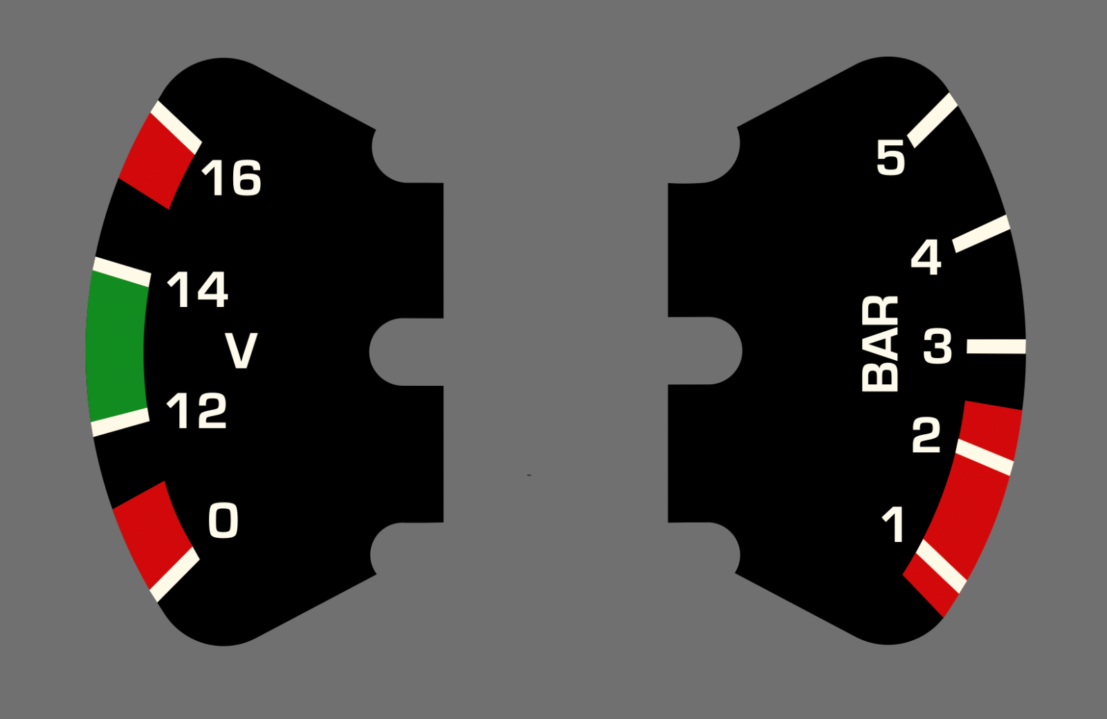

So, I need to redo my gauge labels to support this new scale. Here is what I am thinking:
