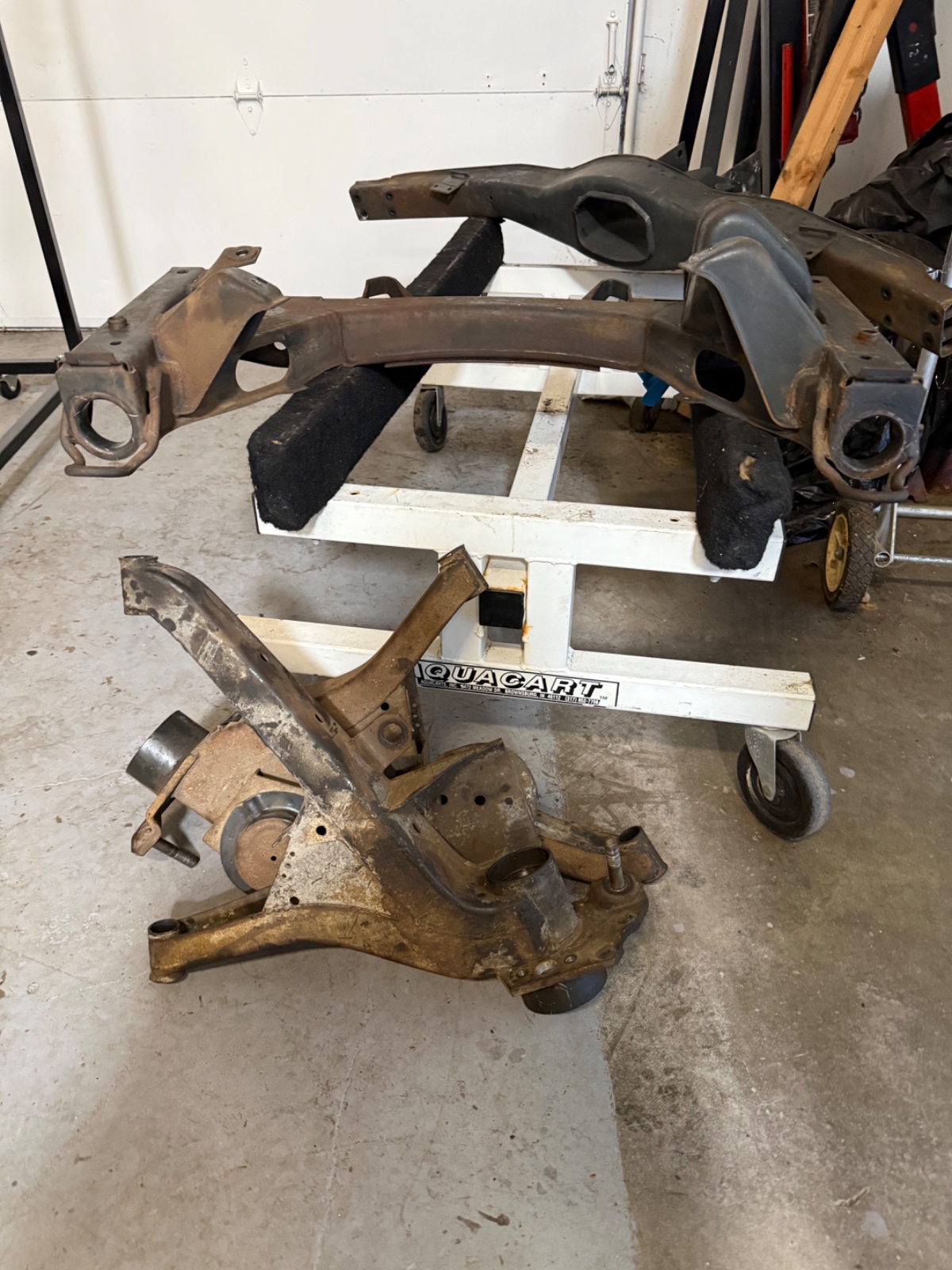

Welded on and dressed the last two Garagistic rear camber and toe adjust brackets. Need to elongate the holes tomorrow.
Blasted the other front brake backing plate. Still not sure I will reuse these, but I am going to paint them just in case.

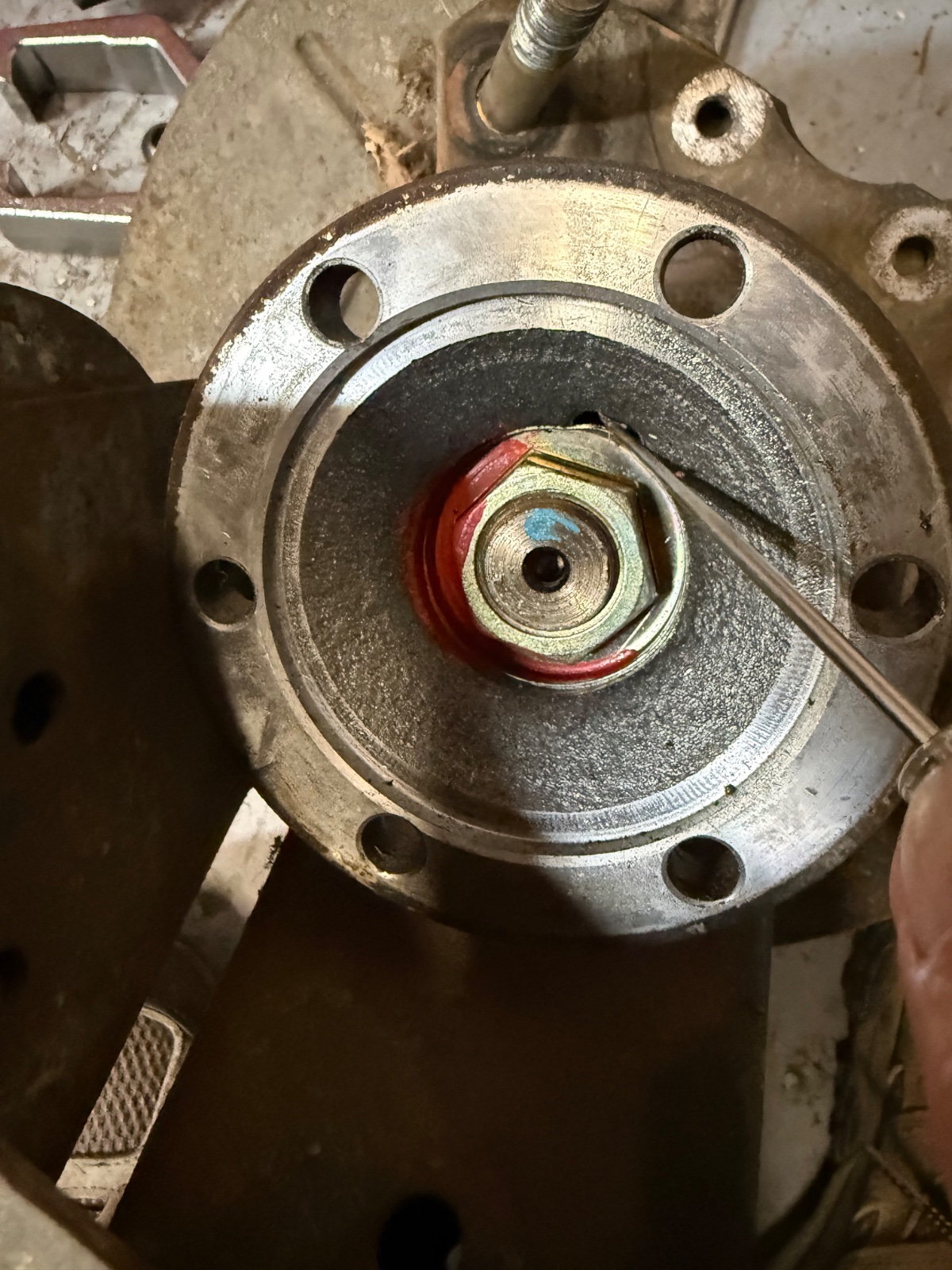

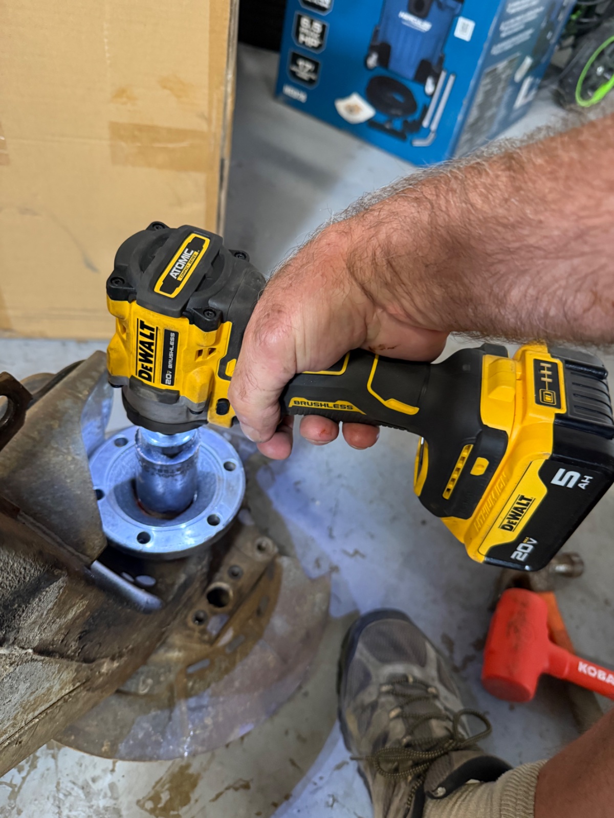

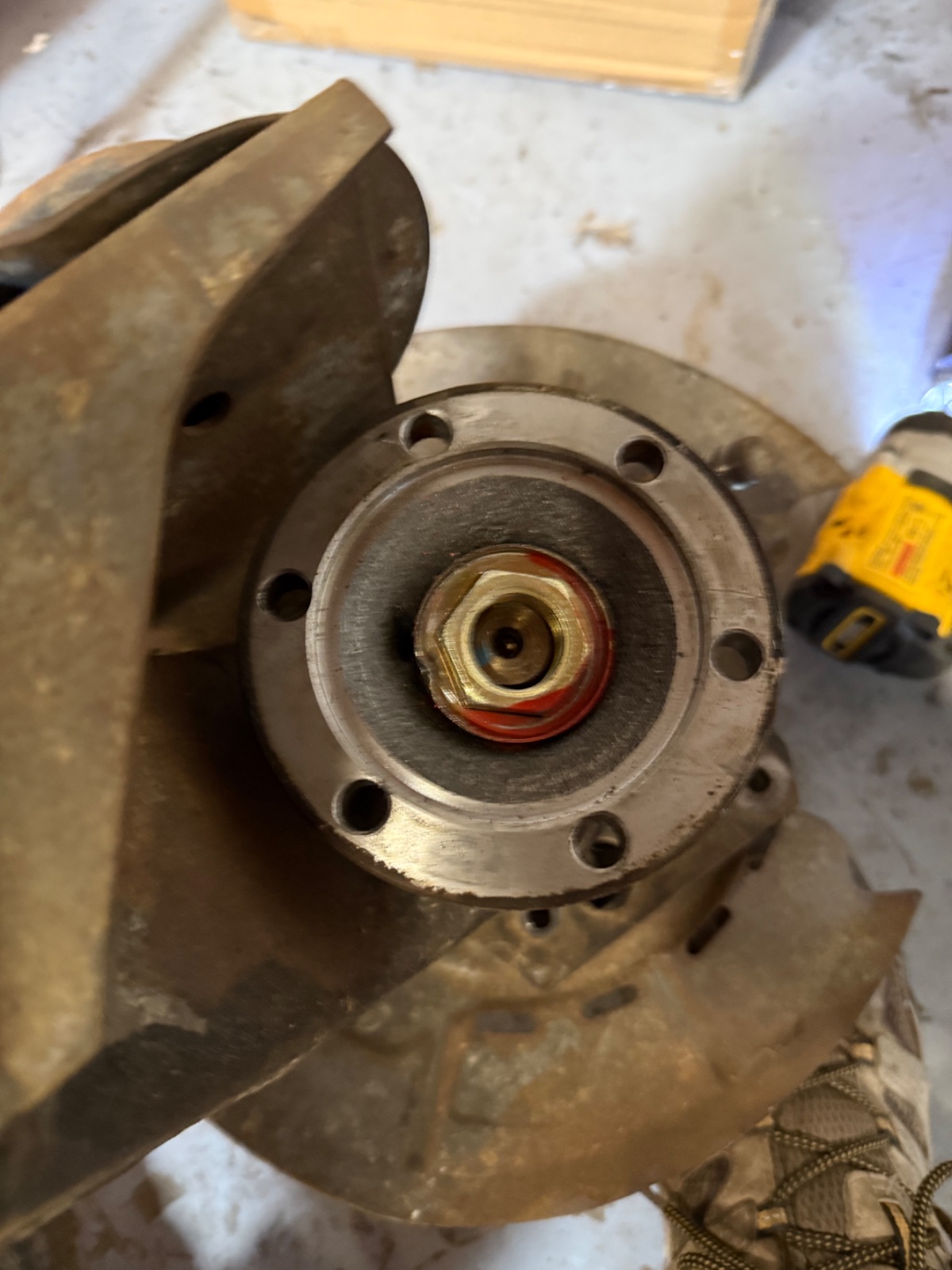

Dis assembled one of the the rear hubs. Once I removed the locking washer, the impact gun made pretty quick work of the nut. I used a puller to get the inner flange off. So now I am off to peruse the threads (primarily @eriknetherlands ) on this to determine how best to press out the stub axle. I suspect I am going to need an assortment of tubes for the press. These bearings were not tight, or loose, but definitely somewhat gummy feeling. Mostly I want to replace the backing plates, and the bearing seals, and I can powder coat the trailing arms together with the subframes next week.
I also picked up a rebuilt 3.45 LSD diff. I'll paint that tomorrow along with all the other cleaned up parts I have. Using Eastwood 2K epoxy satin on these , so I figure I'll set them all up on the paint rack (obviously not the diff), and spray them as a group.

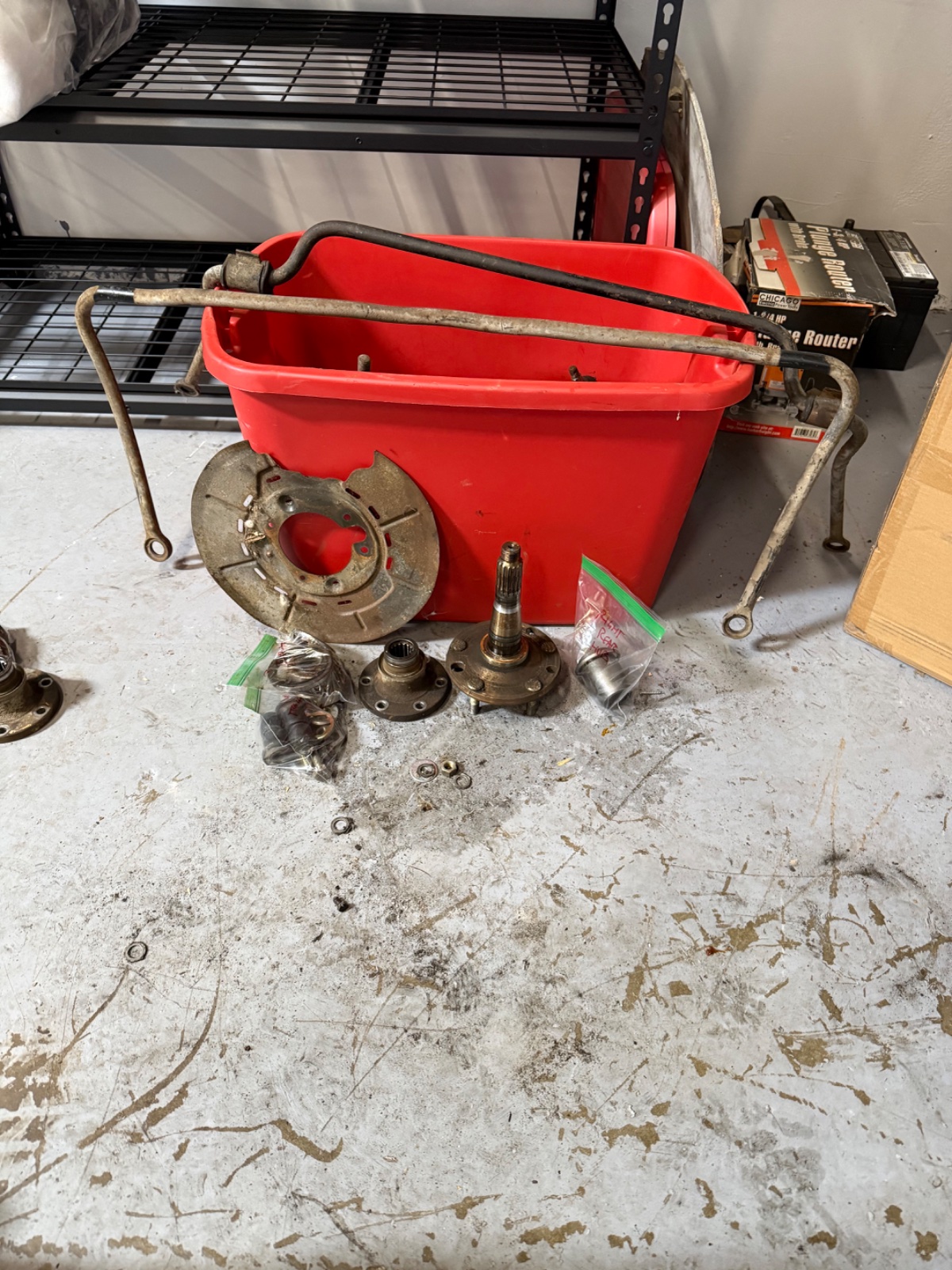

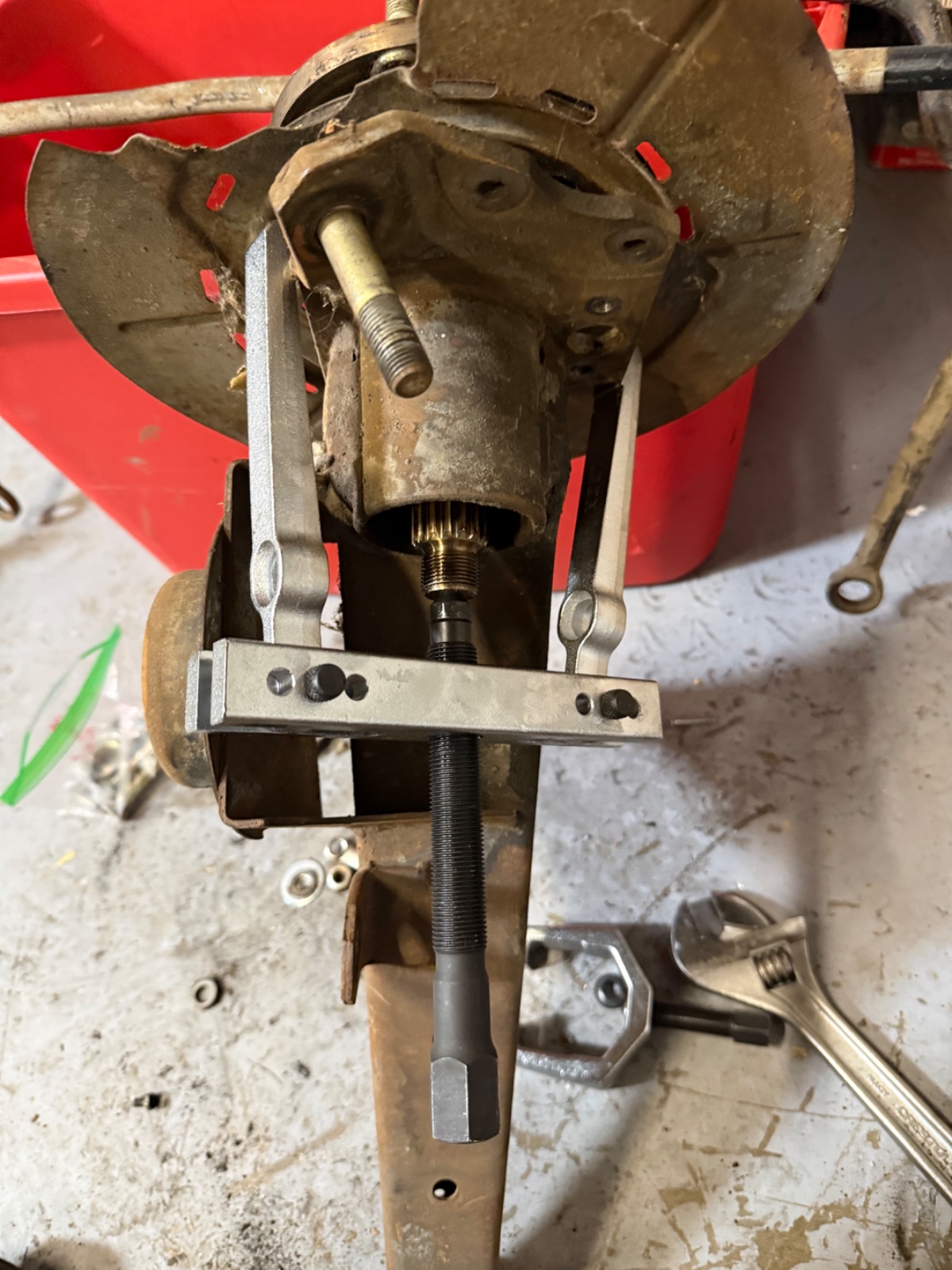

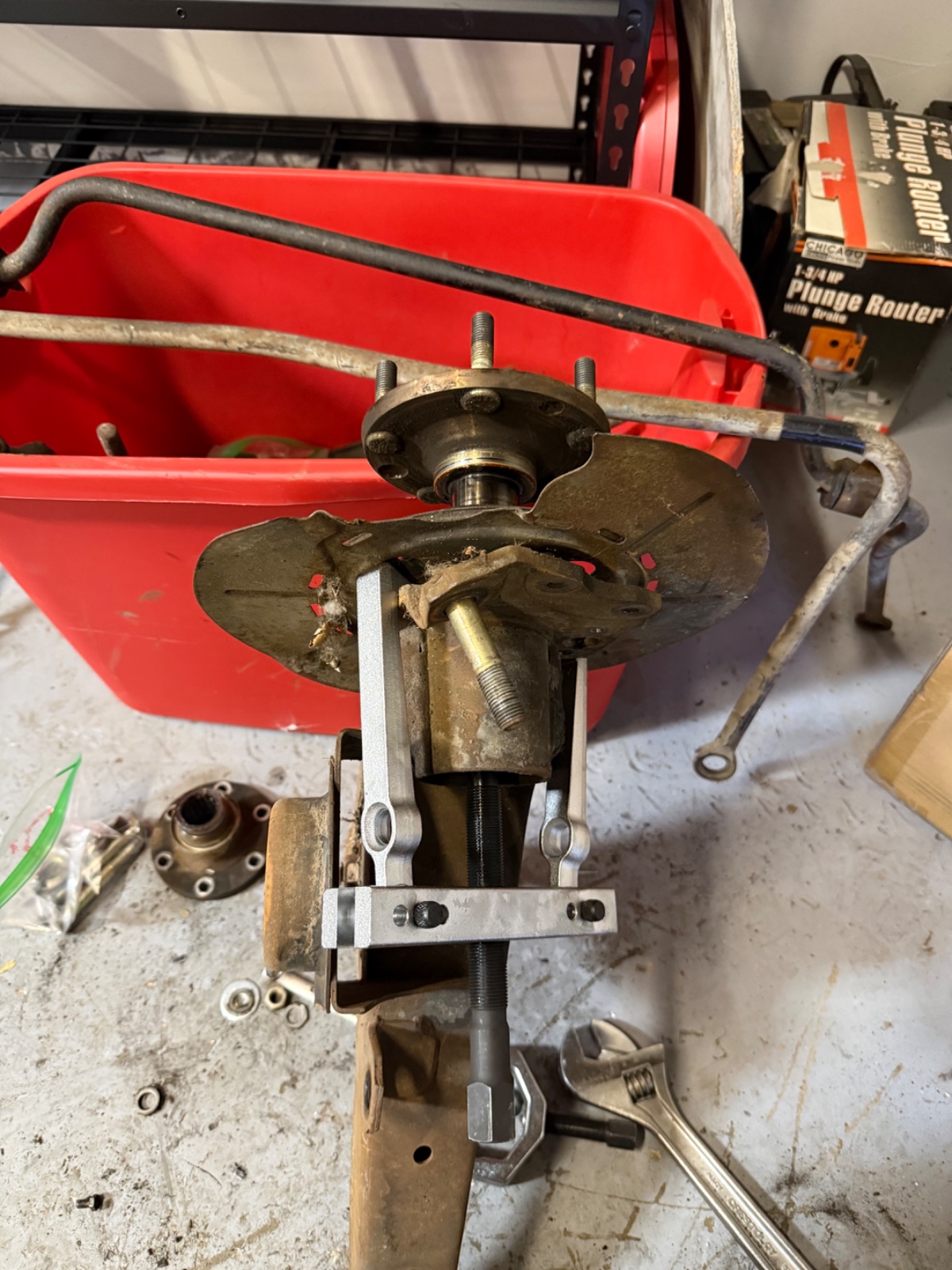

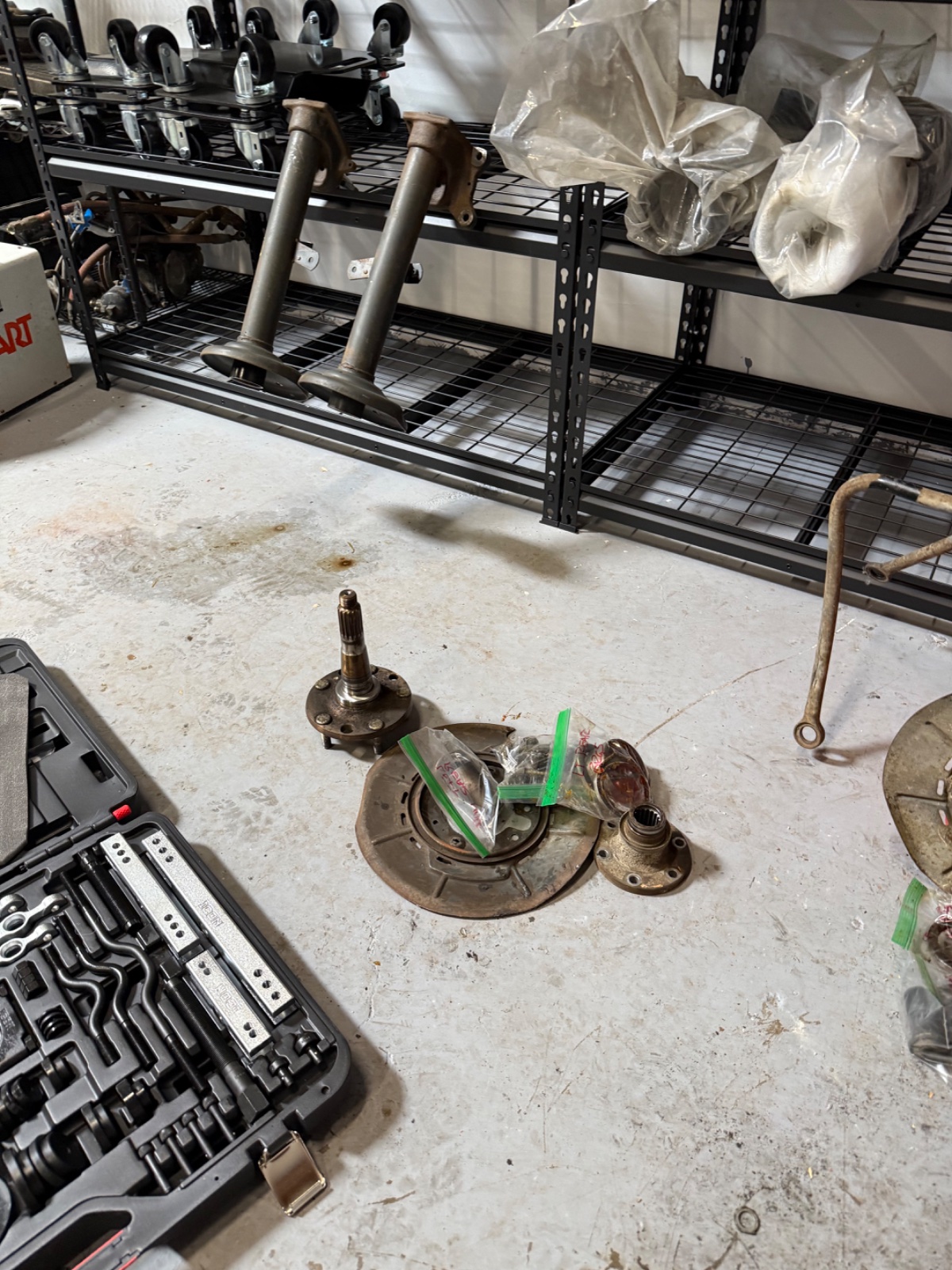

Well, that was an interesting morning. I managed to disassemble both rear hubs, but they came apart quite differently. On the first one I had to use a puller to get the stub axle out, and the inner bearing came out with it.
On the second one, the stub axle just fell out, leaving the bearings and seals in place. I had to use @eriknetherlands tapping technique to get the large bearing out ( tried a dead blow hammer to no avail. Switched to a metal hammer and finally got some traction on it). Once the big bearings were out I used a steel disk that turned out to be the perfect size to push the small bearing out using a long armed puller. Interesting note the puller gets VERY tight and then there is a loud snap as the bearing breaks free, and then it slowly glides out. I’ll use my press to reassemble them.

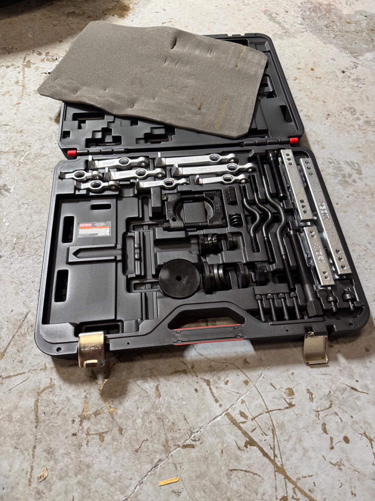

I also used a really nice puller kit from Harbor Freight (never thought I would hear myself use "nice" in the same sentence as Harbor Freight.... Has numerous puller bars and arms with different lengths, disks, spring pins to change arms quickly, etc. Comes in a nice organized case too. worth every penny of $229. I used a smaller fixed ball joint puller to push out the rubber bushings. That was easy after all the bearing stuff.

It isn't THAT bad.. The first trick is to bend in that little bulge on the locking ring. If you don't do that, you will never get the nut loose. I used a Dewalt impact driver and a 30 mm socket to loosen the nut. Takes a few seconds before the big dog eats..
As I noted, in one case the stub axle just fell out. That was sort of easier, since then I used the puller and the disk to press out the other bearing. Getting the big bearing off the stub axle was a little challenging because the seal is inthe way. I just crushed the seal with the puller hooks and the bearing came out. You cannot reuse any of these bearings after removing the because you are generally pulling on the floating race, so the bearings will brinell.
@eriknetherlands describes the "tapping" method to pound out one bearing if they are both in the trailing arm. There is a spacer between them, so you have to slide it from side to side to get a purchase on the edge of the inner bearing race. I would not characterize my method with the hammer as “tapping" ;). You need to hit it pretty hard to get it moving. After that it is just a series of round robin taps...Be ready for the greasy lump to fall out the other end..
I am glad I did this. The backing plates are a mess, the bearing grease was a gelatinous waxy crud.. clearly done after 54 years...
I have a 12 ton press, so assembly should be fairly simple. although I suspect getting those rubber bushings back in will be a trick.

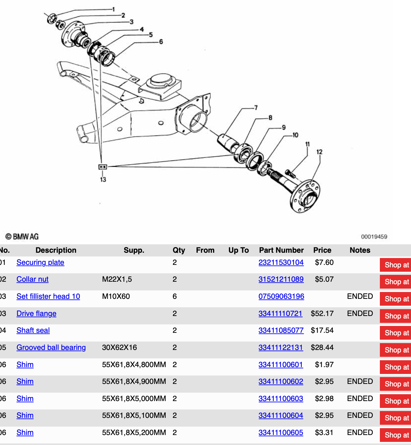

There is a spacer inside the setup. According to Don's mechanic Ed, it is important to use the same spacer on the same side. On mine the spacer was inboard (relative to the nut end of the axle) of the smaller (inboard) bearing. It is #6 in the RealOEM pic below.
