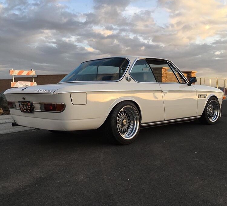

Look pretty close to mine (just different rotor color), i think we got similar taste;)
yes Wladek they are a nice wheel.............are yours 16x9 and 16x7 ??....they look to be. Exact same color silver all round with BMW centre cap. I got mine from Paul Ehrlich in NC.

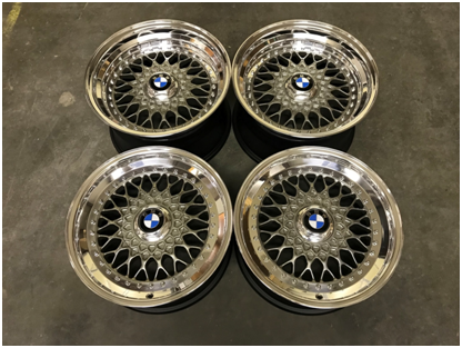

Mine originally are RS 005 (7") & RS 022 (9"), but i upgraded them with wider lips - front RS005 have 2" lips from, instead 1,5", so now they are 7,5"; rear have 3" lips, instead of 2", so now they are 10". Didn't put them yet on the car for fitting, but if some mods will be required in future - i still have 1,5" front lips & narrower barrels on my second set of RS's.
I thought I was running close to maximum widths ............man you are cutting it fine. My offsets are +11 front and +8 rear.............I believe they should fit without problems:) fingers crossed.
when are you fitting yours?? I am about 3 months away.

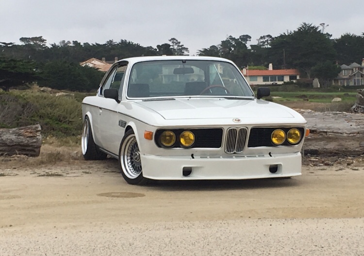

That’s a great looking car Stan, I think you got the stance just right, she just looks like she wants to fly.
Did you move your door mirrors forward?
John
John
Went very Euro: Moved the mirrors forward, removed side markers, added Euro rear fog. Retained 14" Alpina wheels.
