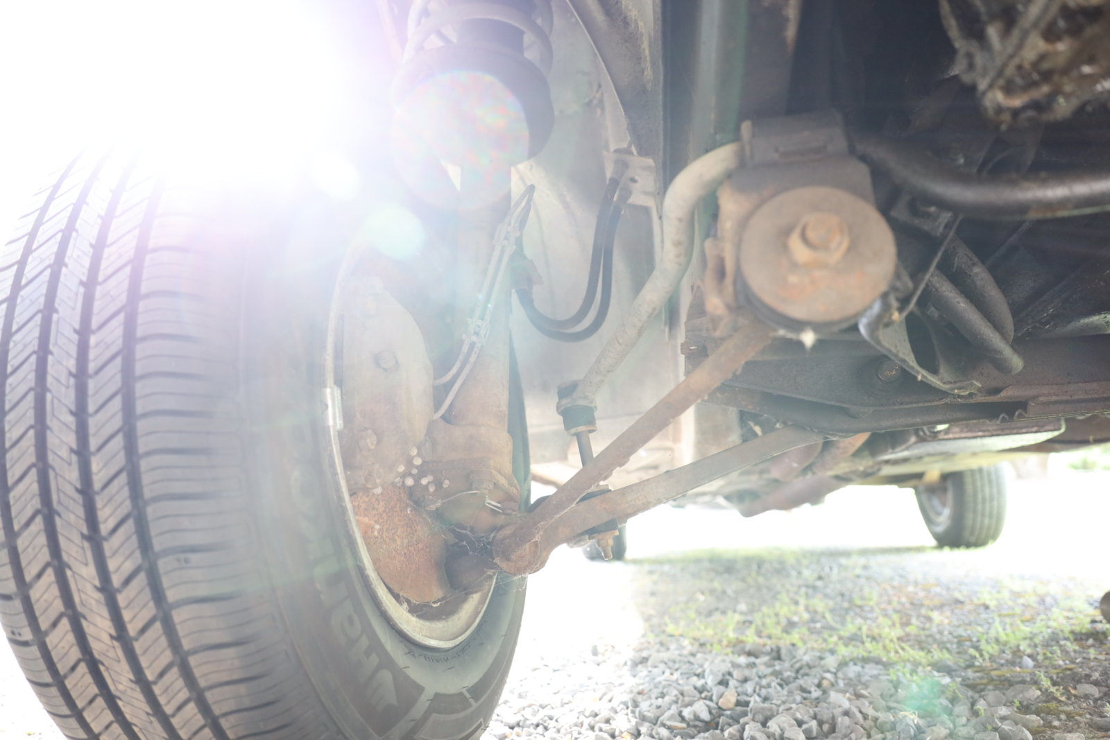

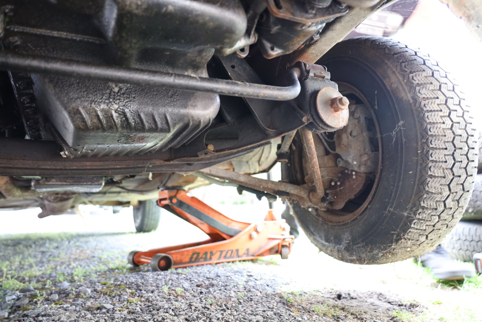

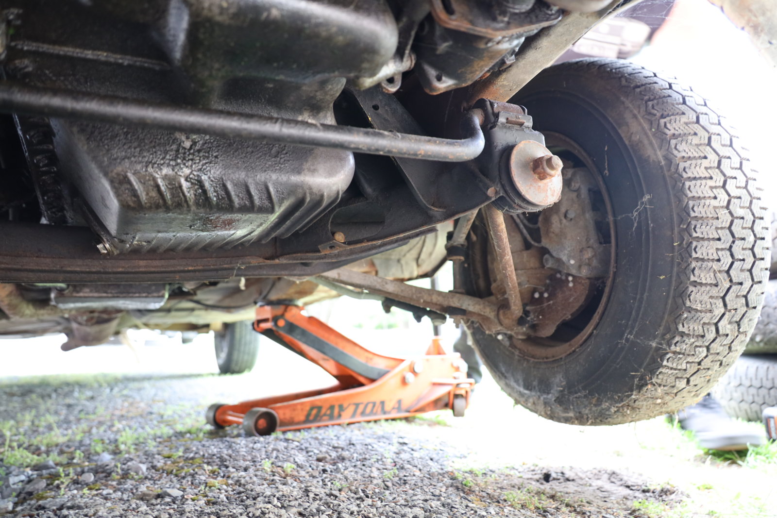

Brakes: Rotors heavily corroded. We dragged her out of the garage with a tow strap. No longer seized, but clearly need some TLC/resto.

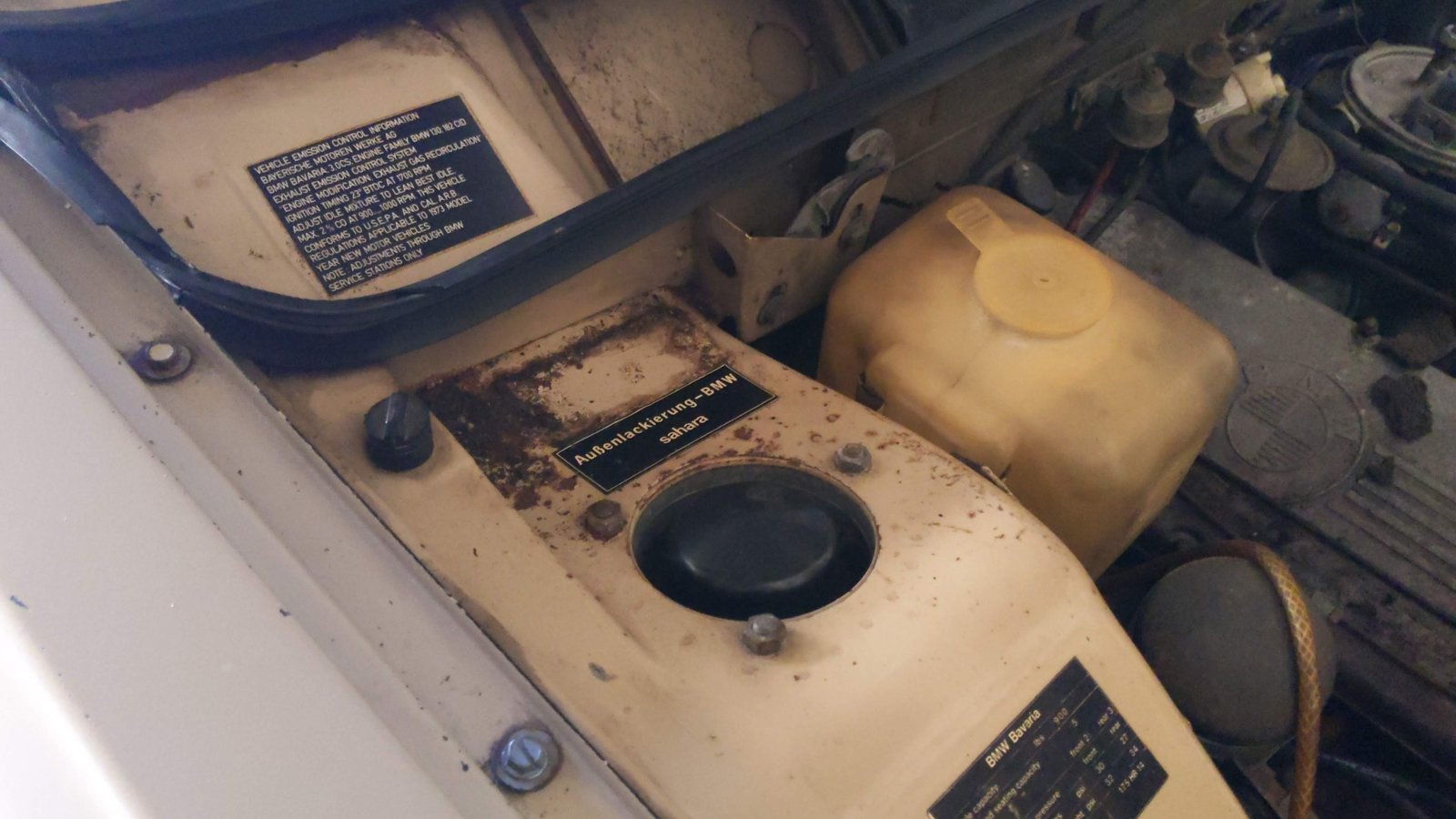

Did you receive the VIN plate with the car, or did you remove it yourself?
It was located just above the Außenlackierung sticker in your photo (above).

Please do not jack up the car using the engine support bracket. Often rusted from the inside, may collapse and hurt you and the car!
Unfortunately, no. The vin # I've shared is based on the title. Are there other locations to look for the vin on the chassis/body?
