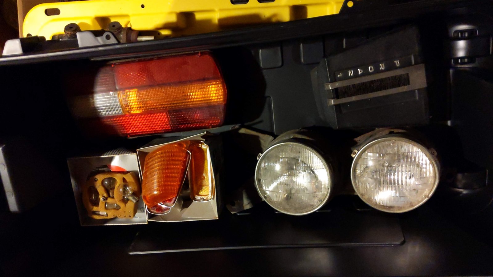

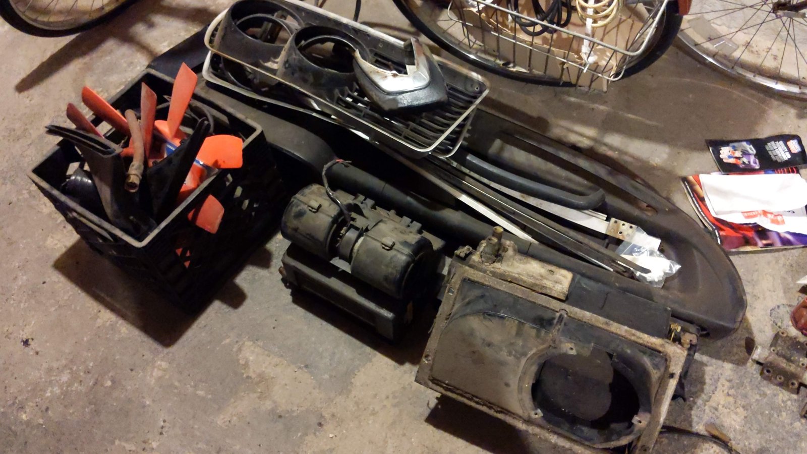

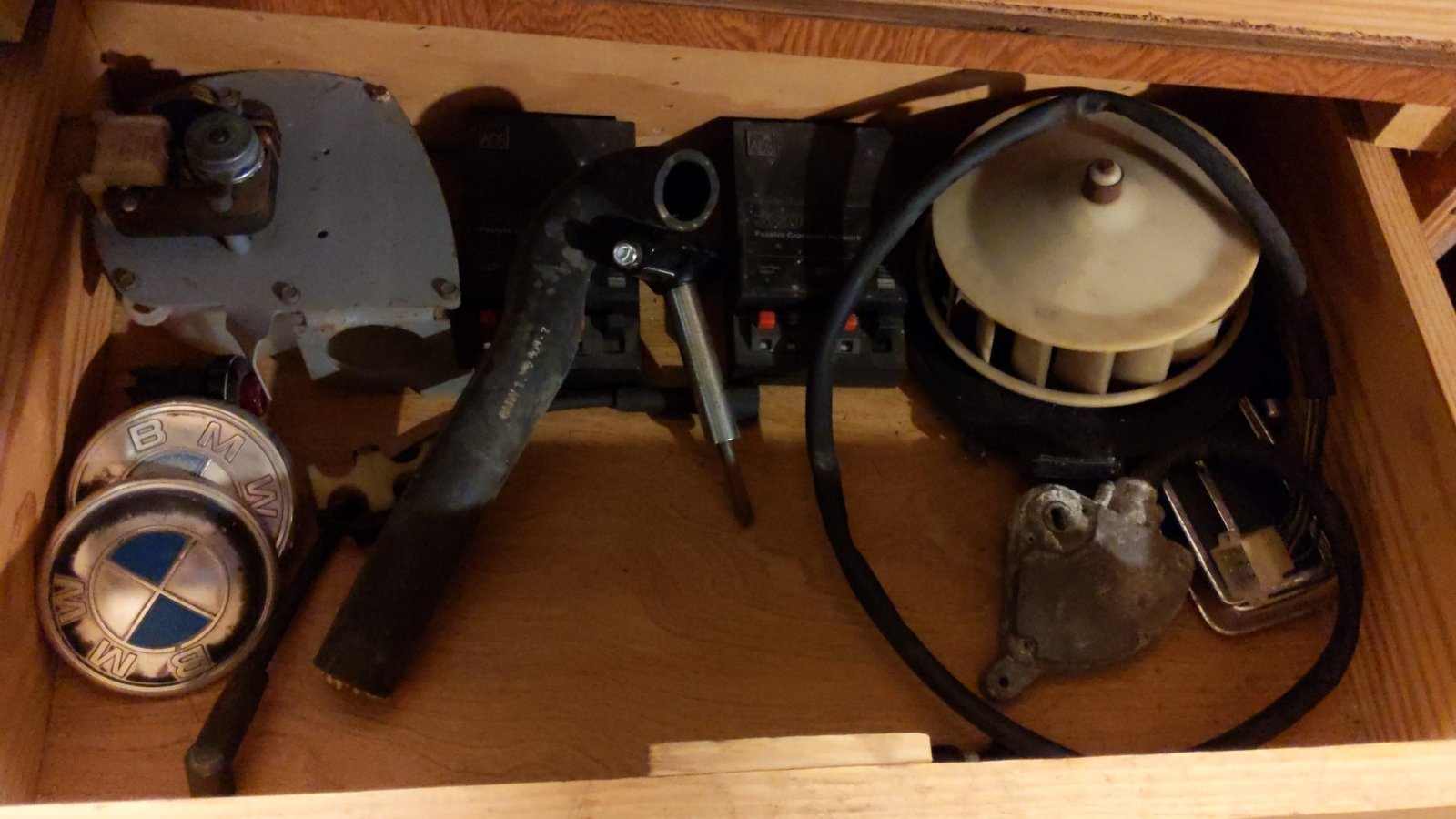

Here are some shots from some parts discovery/organization and transport on Wednesday.
Along with about 10 headlights, a drawer full of coolant hosing, and one, if not two wiring harnesses, I came across two front calipers* that look like they are barely used, with new pads inserted.

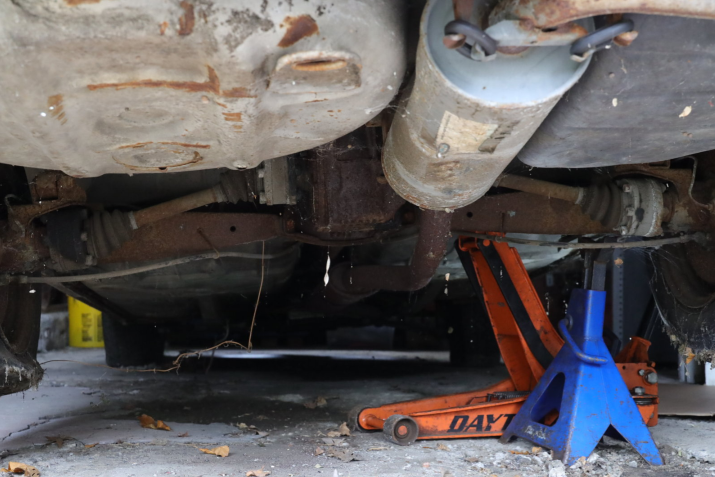

Is it the original BMW sticker on the silencer?
I like the colors on this photo.

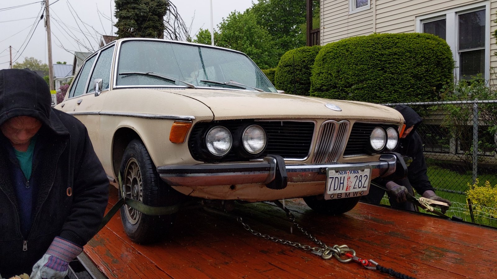

It was! Although I'm not sure it survived the flat bed trip (in the rain, unfortunately). Good news there is that I only found one small leak along the inside of the drivers-side rocker after an hour in the elements and under motion.
The car also came with a separate/spare bosal midpipe setup .. anyone ever run one of these?

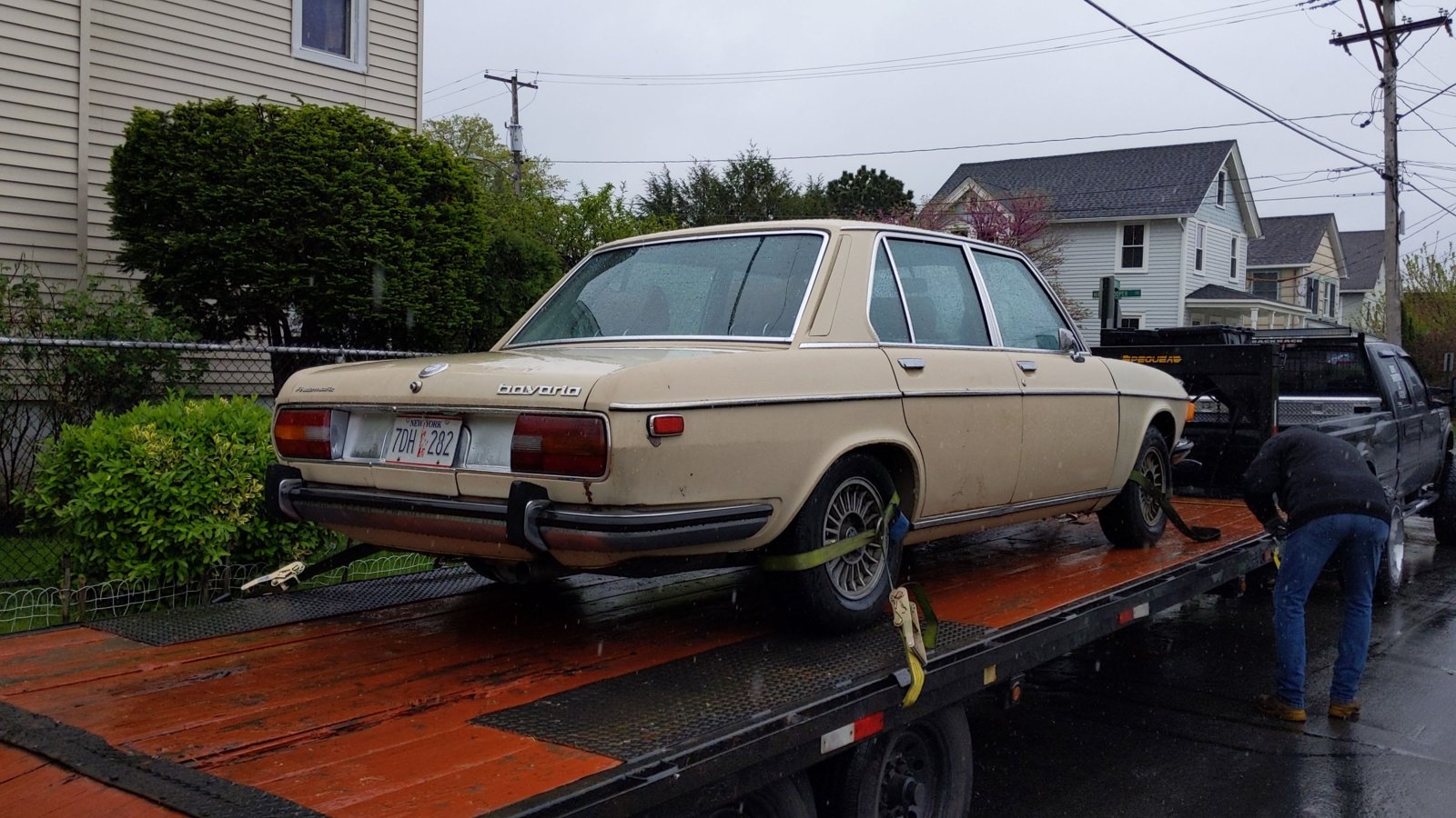

I think your front bumperettes are on upside down (either that or mine are :) ). Your rear bumperettes look a little strange. I don't think they are upside down, but the face should be flat. Maybe the bumper itself is tweaked some? Odd that the front side reflectors have been shaved, but not the rear marker lights. A good thing that they are gone, however.
It is great to get all those spares with the car. What you can't use will be good trading material. The front turn signal/marker lens and the tail lights are getting to be unobtanium. Parts that also fit an E9 are gold...like the front grills, headlight buckets, Engine parts.

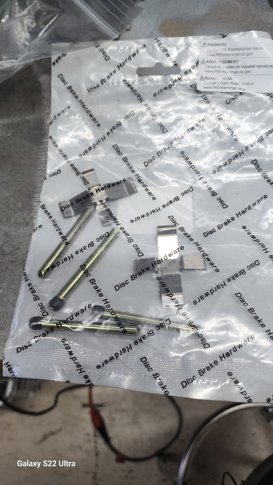

Recently rebuilt front and rear brake calipers. In search of the front cs/csi front caliper pins. I installed the cs/csi spacers in calipers that allow me to run vented rotors. Now the hardware kit I have doesn't work because the pins are to short. So far I can't find the correct kit. Anyone know where to source these???
