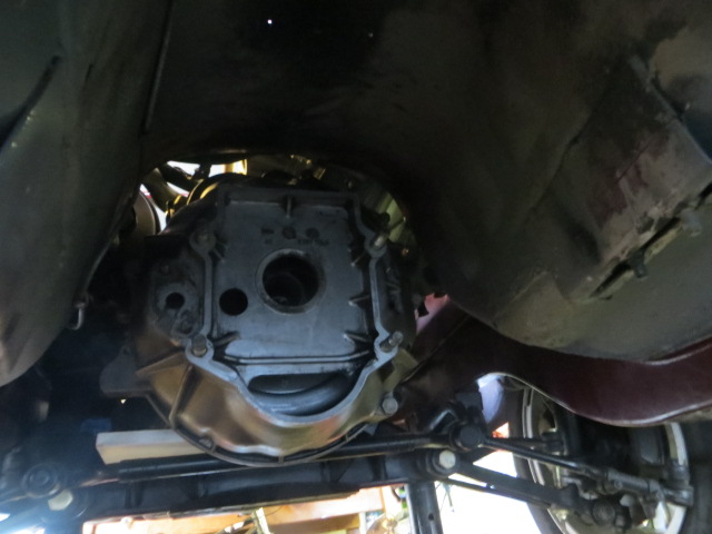

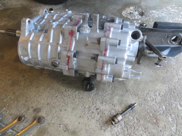

Installed pilot bearing, clutch, pressure plate and bell housing. Not much fun as a one person job. Bell housing bolts tough to get to. Tranny pic shows removable gear to drive the speedo.

the right tools.
Pilot Bearing: why not install this BEFORE you put the motor into the car?
Very LONG 1/2" extensions with flex sockets and a helper to guide the socket onto the BH bolts. That's always worked for me on 2002's, E3's, E21, and E12's
Sounds like having a lift so the engine could go in from the bottom (with transmission attached) would've been a nice option.
Great work Chris.
HB,
I cut the ends off a 19 and a 17mm box end wrench and welded them onto flat bar stock about 15" long. Very handy for removing bell housing bolts and guibo bolts among others.
Doug
Pilot bearing was a piece of cake, two 8mm bolts below the head don't like universal joints :), don't have room for a lift and I won't be doing this again, the 17mm bolts near starter weren't bad as long as engine is tilted back, long 17 bolts below have dowels and weren't a problem either.

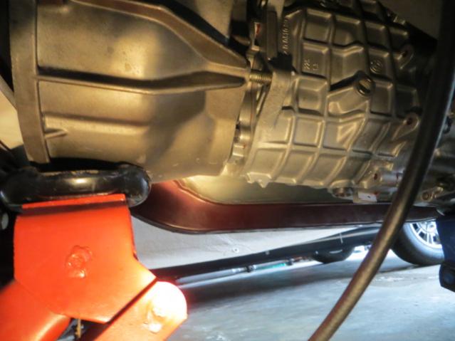

After four hours under the coupe I give up. Tranny is on the bell housing studs but not far enough to install nuts. I am 5/8" from bell housing. I have no leverage, I have pushed, wiggled, shoved. Splines are engaged on clutch, I must be at the pilot bearing which I did a trial fit so I know it's good.
I had that same issue and it was at the pilot bearing.I kept wiggling it around and it slowly slipped on,if I recall I put a little pressure with a floor jack and than wiggled it?
Maybe the clutch disk is not centered enough? There is some wiggle room on centering this when using the plastic centering pin, so it could be off a bit.
Could the pivot arm inside the bell housing be hanging up on something?
