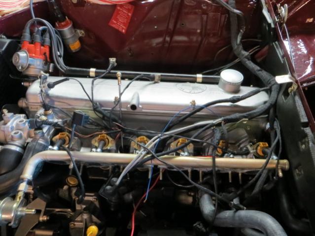

Thanks Tom. Worked on the ECU harness, distributor wires and downpipes. As usual, got downpipes installed only to figure out they need to be loose to slip onto center resonator which is hanging under the car, will tackle that tomorrow. Tightened guibo bolts/nuts, check, also installed radiator. I have room between it and fan but not much. Got my distributor all set up after having it locked/staked, had a fun time getting wires through my wire tube but it has to look correct. The harness is through the firewall but getting it situated behind the head will be fun, it looks like a spiderweb.

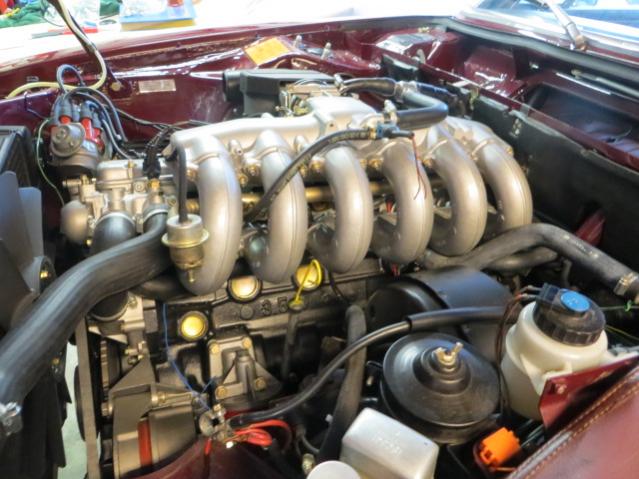

It's finally starting to look like a proper motor again. Got the harness fitted, installed the intake runners/plenum, barn door, and new short dipstick housing so I can use the old style M30 dipstick. I need to install heater which I'm not looking forward too and fuel return line plus mount ECU.

Looks incredible, better than new, one day my engine bay will be that clean. Where are you putting the ECU?
wow Chris, you have outdone yourself. looks amazing! so are you using the air filter housing from the b35 car ... or something else? if its the b35 housing, would like to hear how you are mounting it.
A friend made those covers a couple years ago. I am using b35 air box but will paint grey D-jet style even though shape is very different. ECU will be above the glove box, that will take a bit of work.
Very cool. I don't think my engine bay will ever be that clean; I'll have to enjoy Chris' instead. Hope to see it at LOTA one day.
