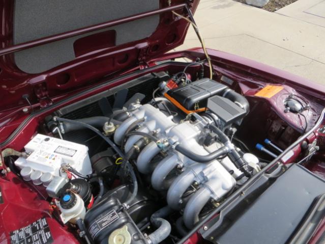

Oil leak fixed, reverse light tranny switch fixed (I just pulled one of the spade connectors out slightly as it had constant continuity). Took it around the block but I need to get the O2 sensor bung installed for it to run even nicer. I will follow conventional break-in philosophy for 300-500 miles and also change oil then. So far so good, guess I shouldn't have worried so much before turning the key the first time. And thanks again to Mike, couldn't have done it without him. Or Don either!

wow Chris, you have done an impeccable job. it looks great. would love to look closely at the way you did some of the wiring ... to change some of the way mine was done.
now go enjoy the coupe ... get it broken in quickly so we can hear what you really think of the new engine.

Amazing look and job Chris. A testament to the blood, sweat and tears of coupe ownership. And in your case, a good investment of your own sweat equity!!
