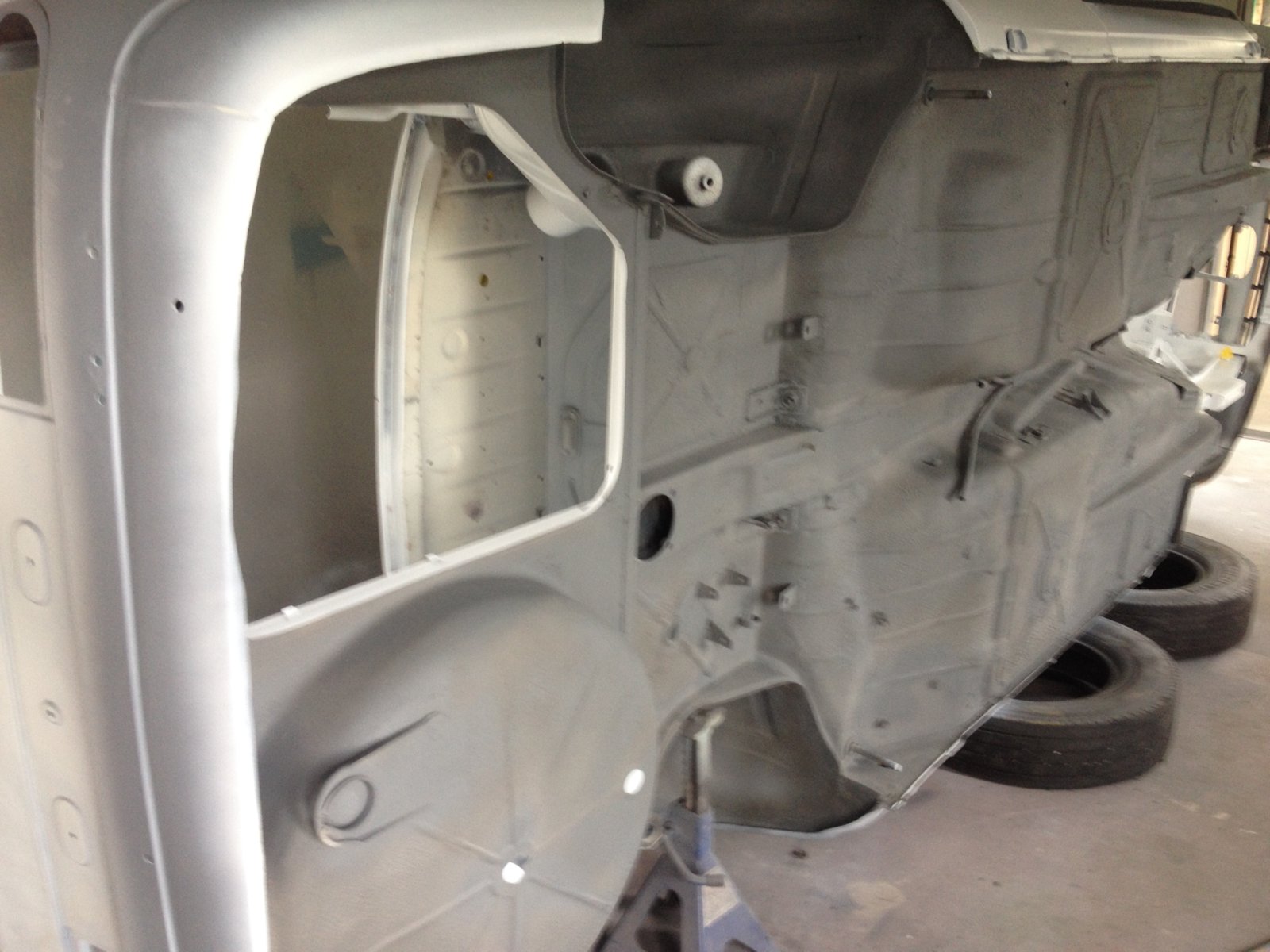

Take a look at this though. You'd almost say this car has never seen a UK road, there is almost no rust under the car. I thought this may have been the case when I first inspected it but you never really know with these things until you tear them down. The stone guard finish has started to de-laminate and there's some surface scale here and there but that's it. My paperwork says this car has been in storage since 1983 and I guess this confirms it.
Simon will keep on working his magic on the body work for a few more days before we rotate the car onto its side to start the fun process of removing the stone guard paint. Not sure the best way to get this off. Our thinking is either heat gun or wire wheel?

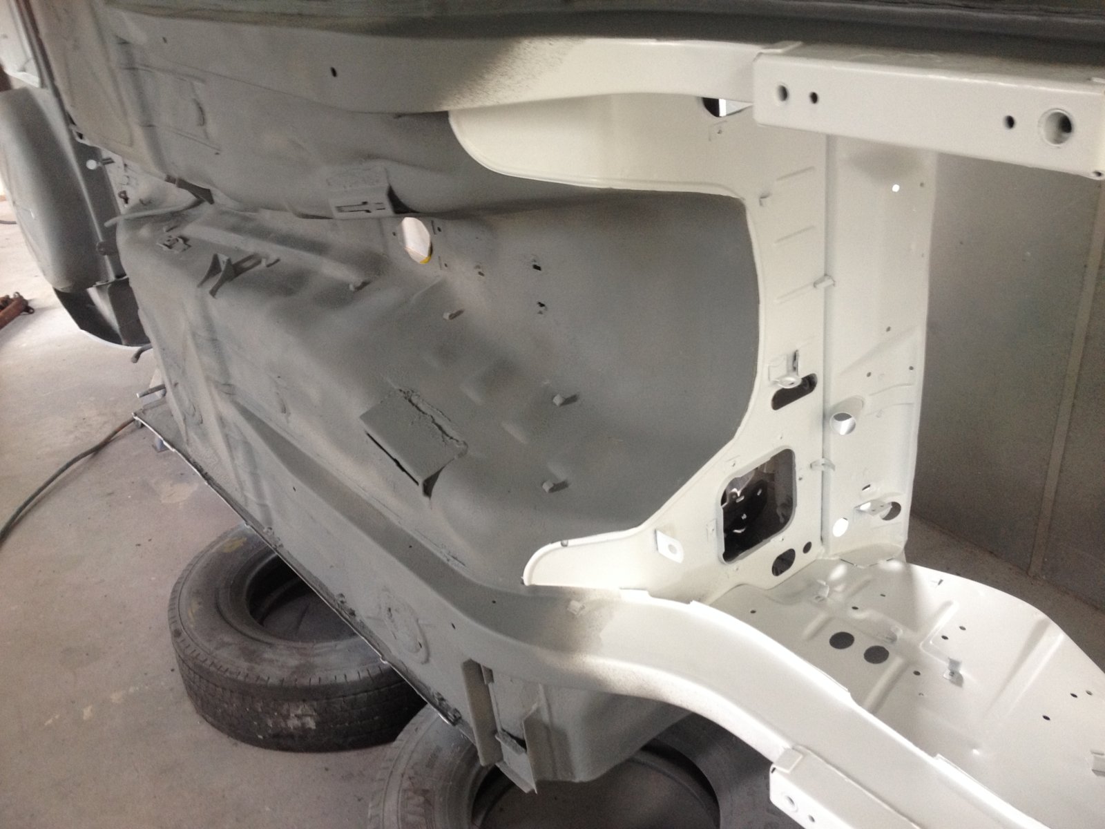

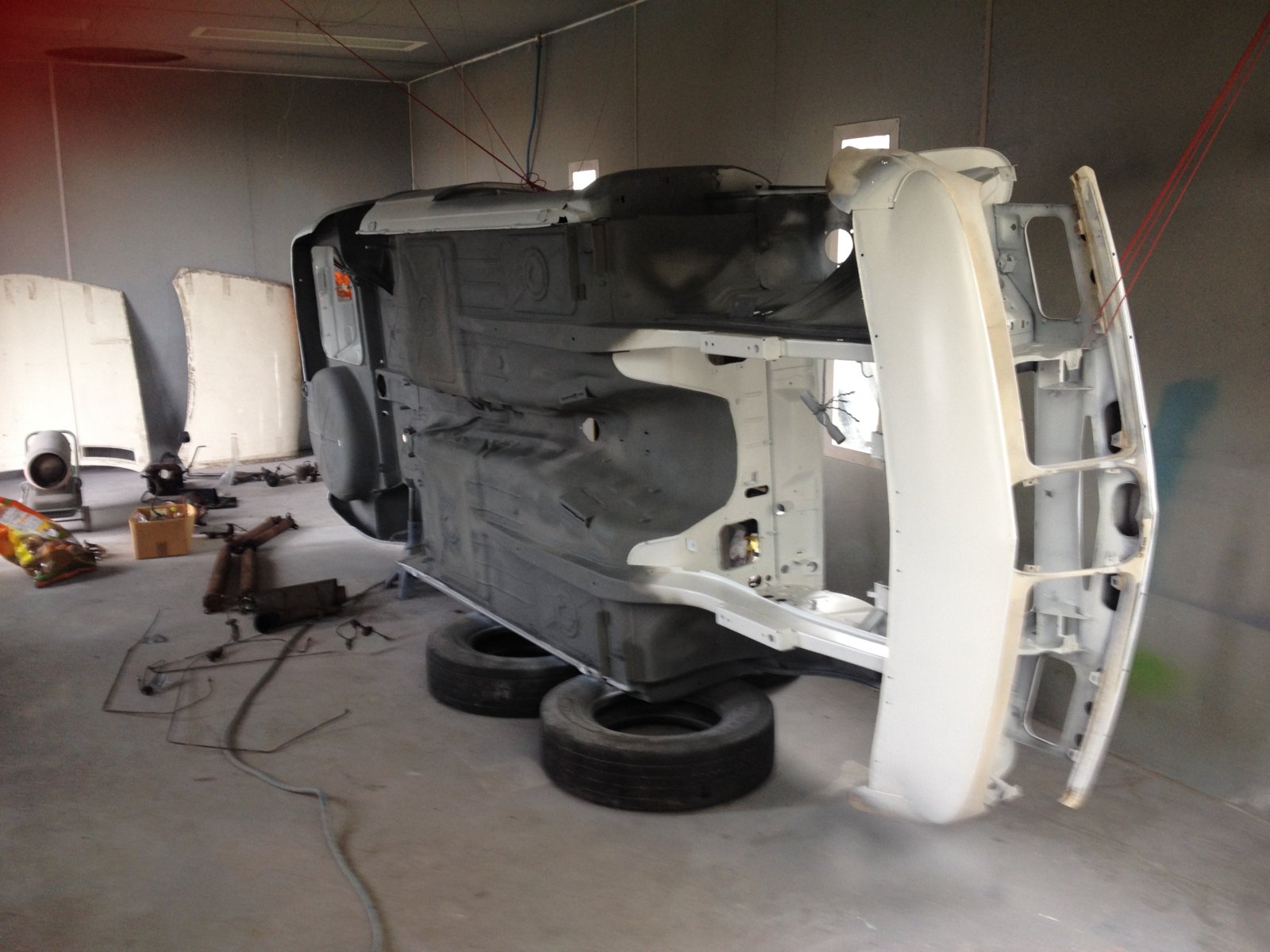

The lower body work has now all been done and this morning we rotated the car to gain access to underneath so that can also be restored.
Before you all jump in the car is actually resting on the metal cage we installed to give some strength while did some structural work. The cage is resting on a series of truck tyres so none of the panel work in anywhere near contact with the ground. Only took 4 guys to pick her up and roll her over.
We've now tied her off against the roof and wall to stop any movement.

Down at the shop there's been a load of progress. All of the underside of the car has been finished and now under new rubberised paint. This stuff is a dream to remove - not..
We've blended in where the tow finishes meet as that's our understanding of how it was done in the factory and what we removed.

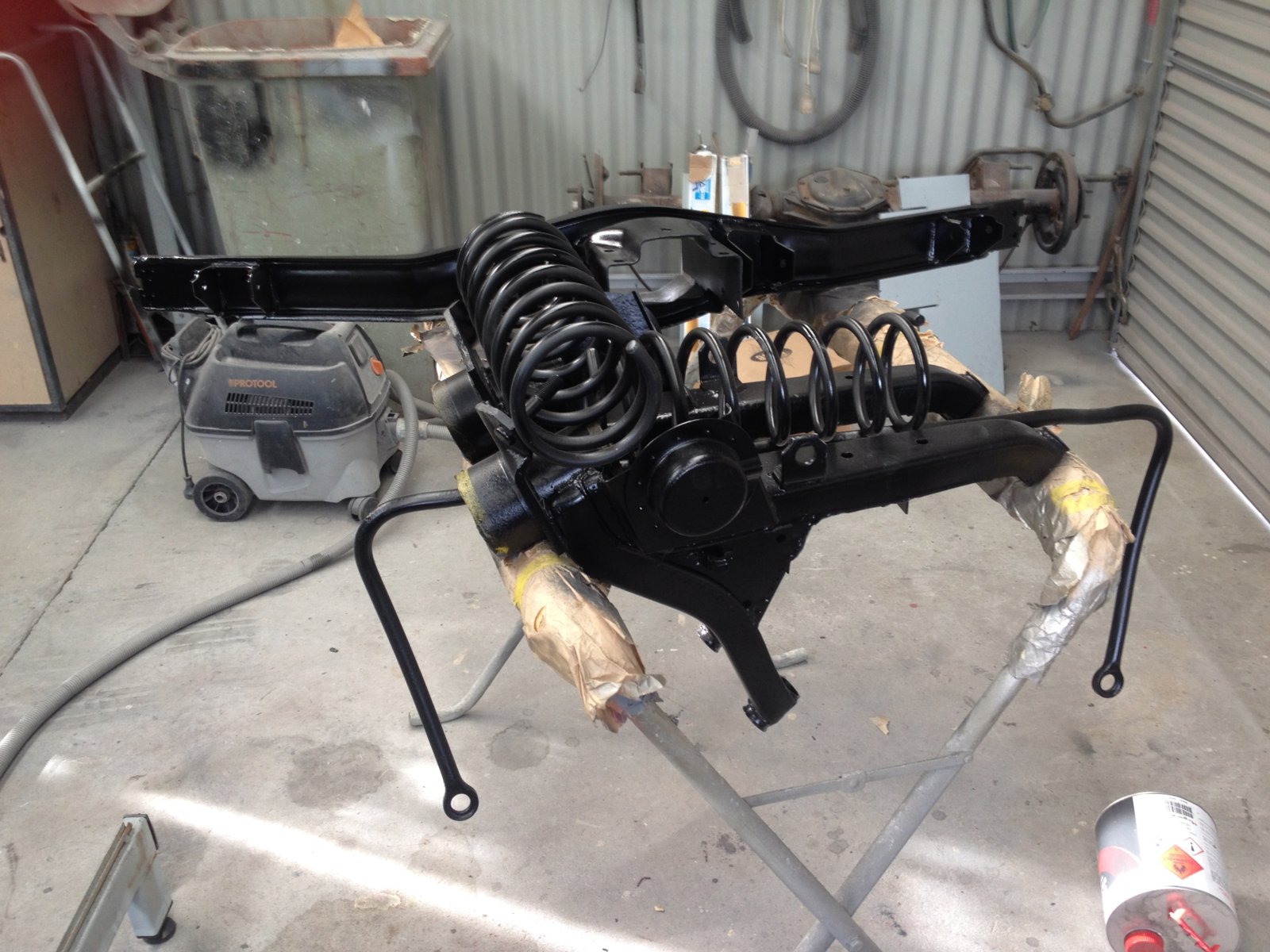

Rear sub-frame all cleaned up and ready for reassembly once the diff and axels come back from their re-build.

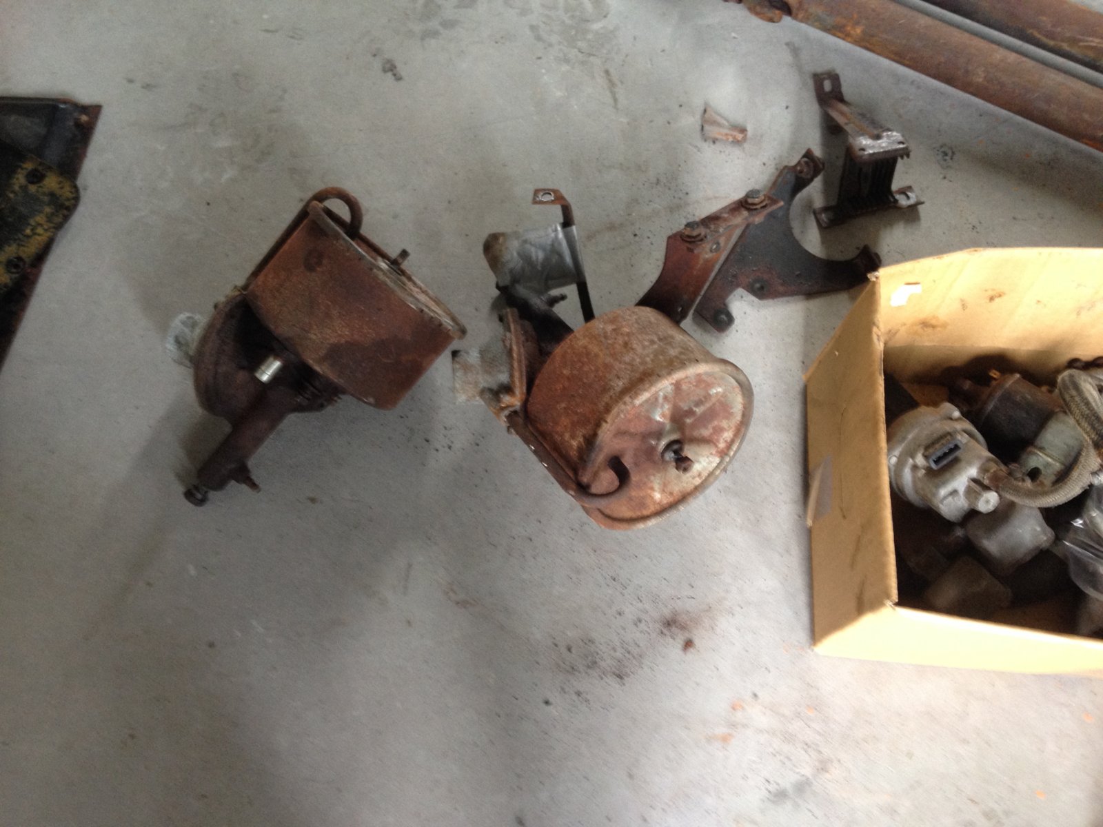

Next job is to send get the boosters sorted out. I've looked on W&N and cant seem to see a re-build kit. Curious to hear what others have done with this.

My re-conditioned boosters arrived from Jaymic, I'm really happy with them. Also received back my rebuilt brake master cylinder. We've also made all new brake lines that can go in after we've finished painting.
My captive BMW mechanic has nearly finished the rear sub-frame work. He was quite surprised when he cracked open the diff it looked like new inside, so less work than we though. Nice when you get a win.

just got my booster and master back from White Post, have not installed it yet
Guarantied for life
