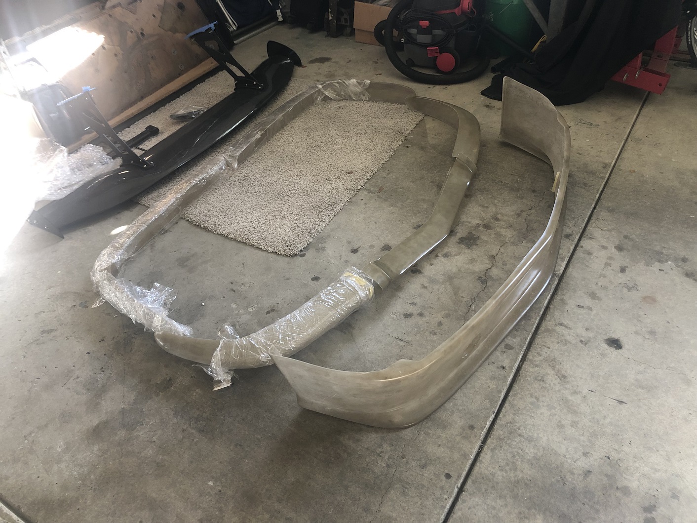

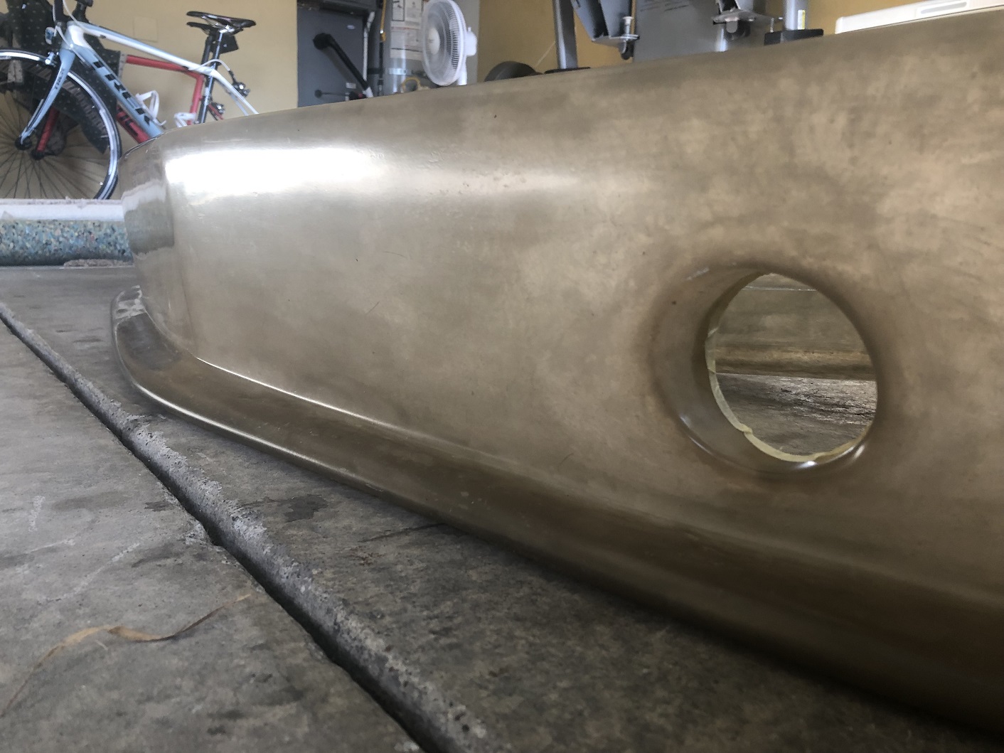

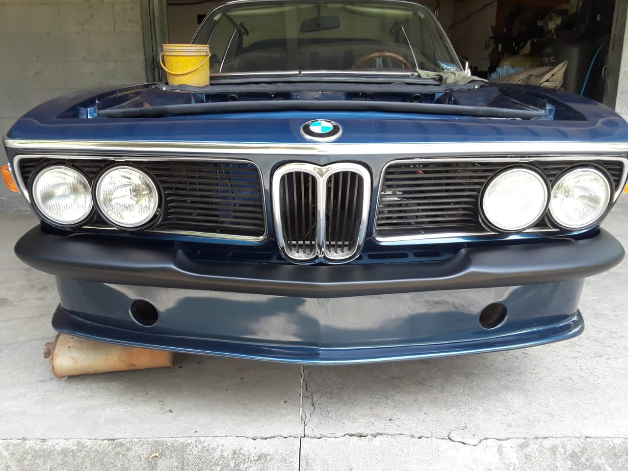

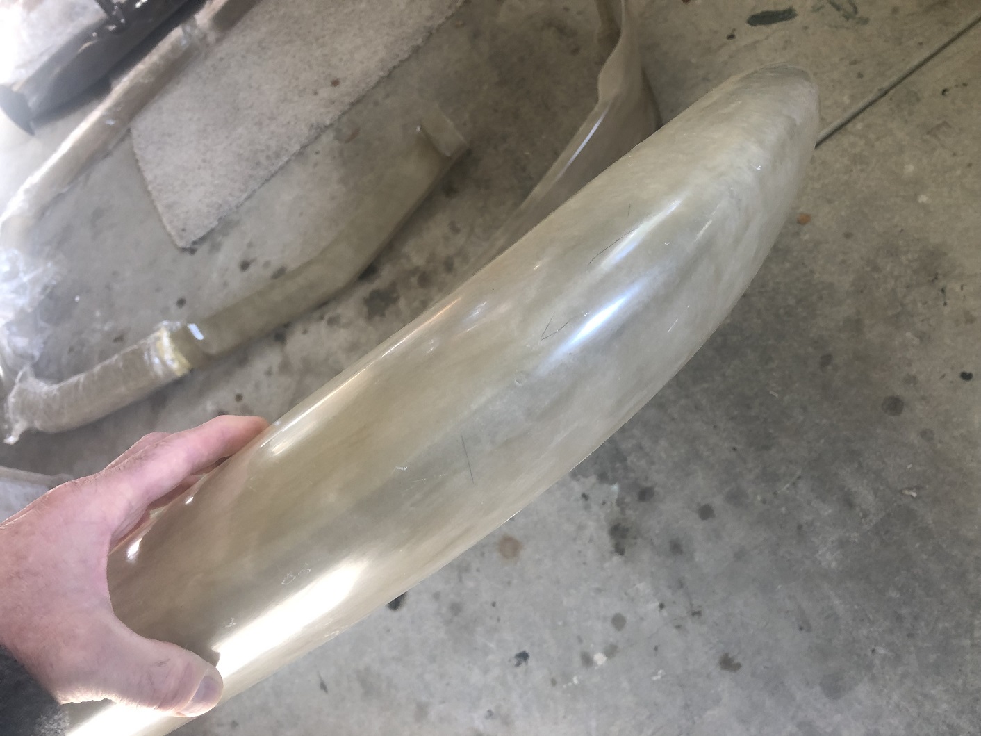

We have been making parts in the same fashion
for over 20 years, and not one issue. If we were to use black, some may object to the shade, matte, semi, gloss, etc.
We use gelcoat for very large parts as the 2002 trunk bins, and on boats, we do use it also.
For this project, 3 layers of glass works very well.
Then, when it comes to joining 3 pieces for the front bumper and 2 for the rear,
one would have a very difficult time in the fairing of the parts.
When I made the ones for my car, it really was the best option.
Thank you for the kind remark.
Regards, Alberto

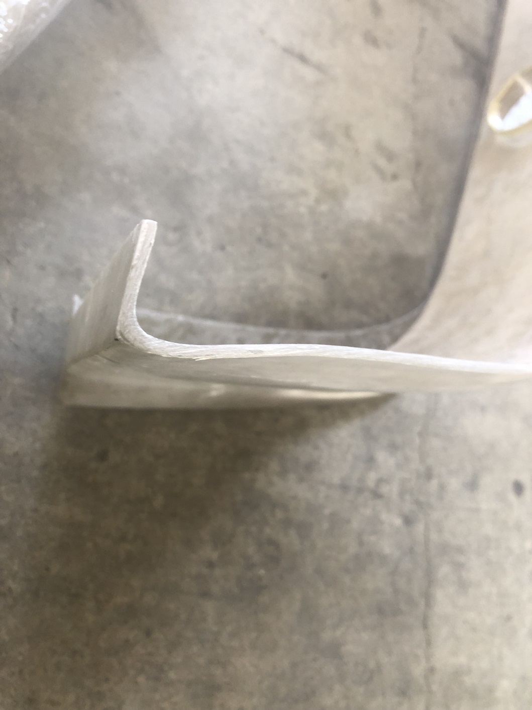

PS. As far as strength, please see a photo of a Dino side, dimension: 1:1 scale.
Zero cracks.
Please see below.
