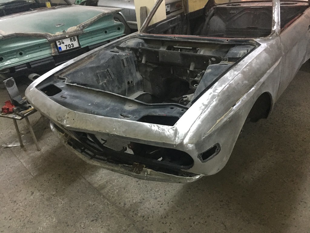

CSL restoration beginning
Second day

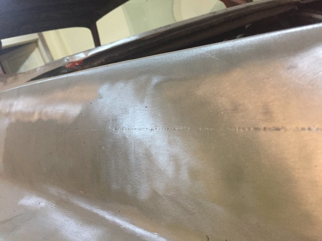

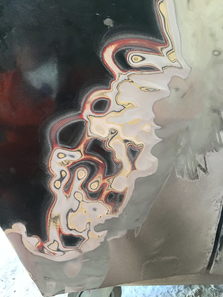

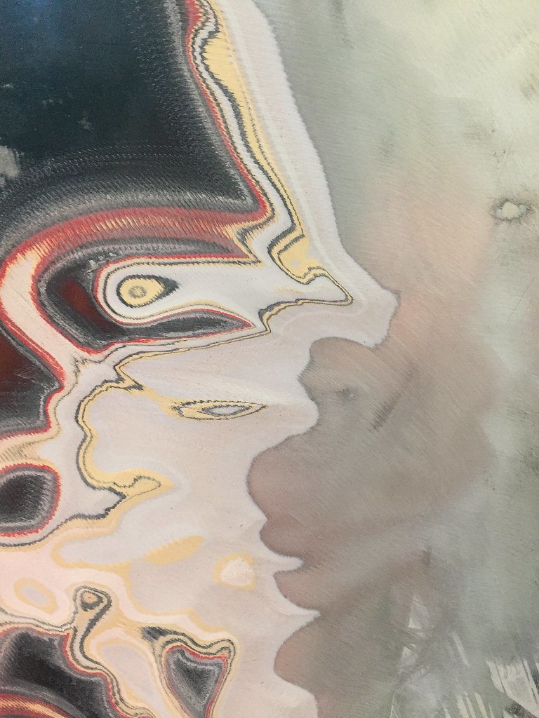

I counted 14 layers on one panel

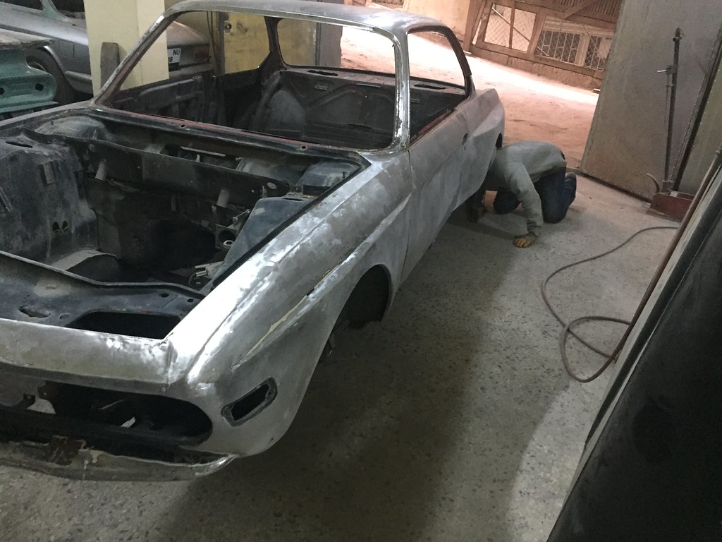

Almost done with the exterior paint removal. just a little at the front and the back panels
You should take the pic of those layers of paint and put it on a canvas for the garage for art! Amazing!
Good luck with the build :)
I did the canyons deliberately and took the picture because I enjoyed the look but making it into a poster didn't cross my mind. Great idea.
Good luck to you too on the build. It's one of the threads I am following with excitement.

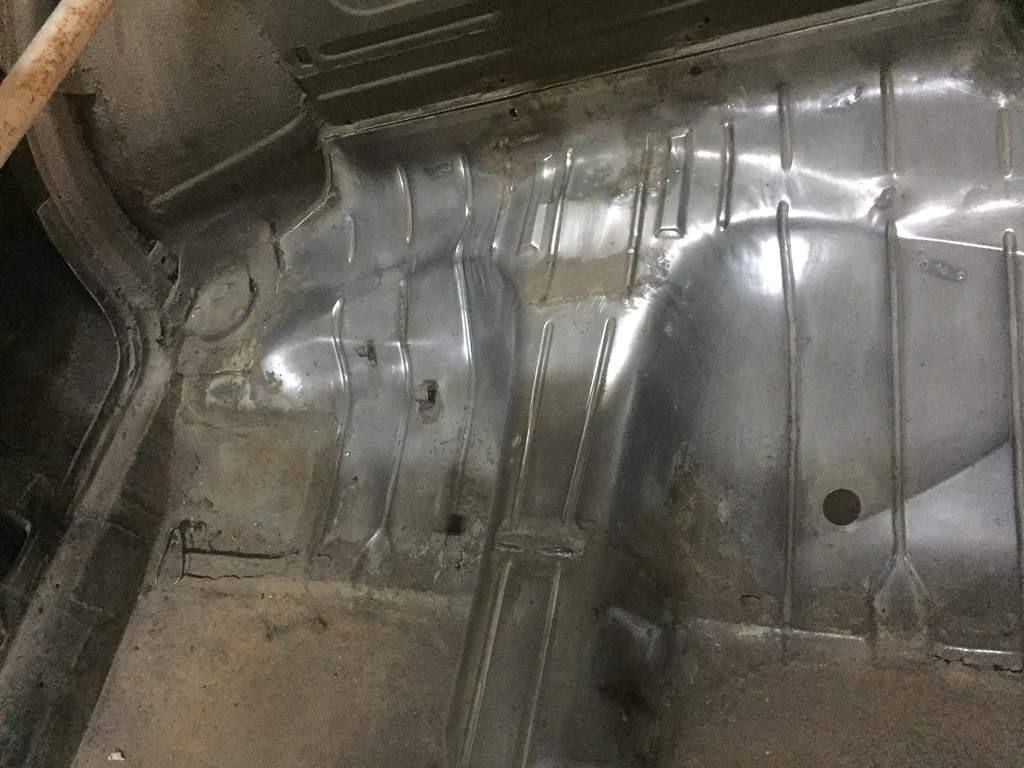

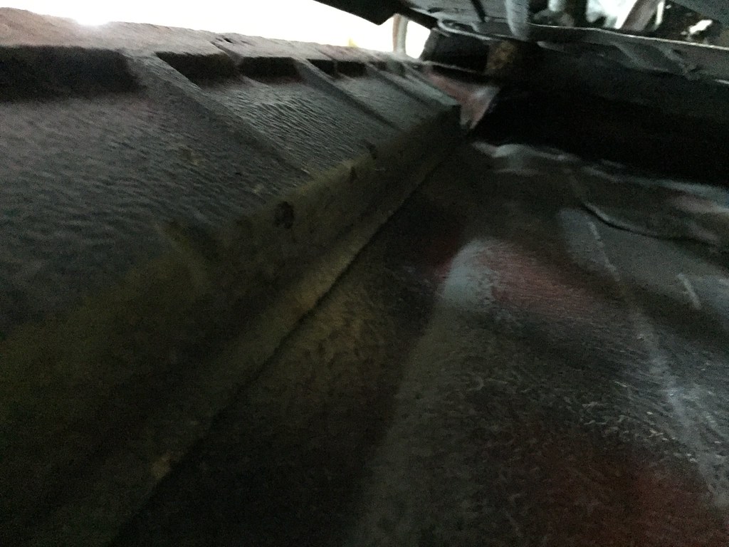

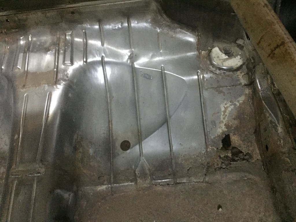

The interior floor pan is for sale in sections from Walloth & Nesch, they sell them in 4 seperate "quarters".
A new seller recently popped up making half floor sections. Located in Poland I believe. recognisable by the baby blue colour of their panels. I tried to dig up some pics from the web, but haven;t found a link. I know that one member here used them on his car, but I fail to remember who.....
Neither of the 2 suppliers have floor panels that are exact copies. They all miss one or two depresssions, ridges, folds or openings. But the good thing is that at least something is available, and you can modify them if you are looking for that authentic look.
Thanks Erik, but the problem with being in Turkey is every part I order for my cars get stuck at customs and takes a long time and money to get through. on the other hand advantage is you can get things done with very good craftsmanship and cheap if you find the right guy. so I'd rather have a go at these than buying from Europe. the originals have caps that you can open I guess but none of the repro ones have those. we might even try to make those. :)
Day 3 update

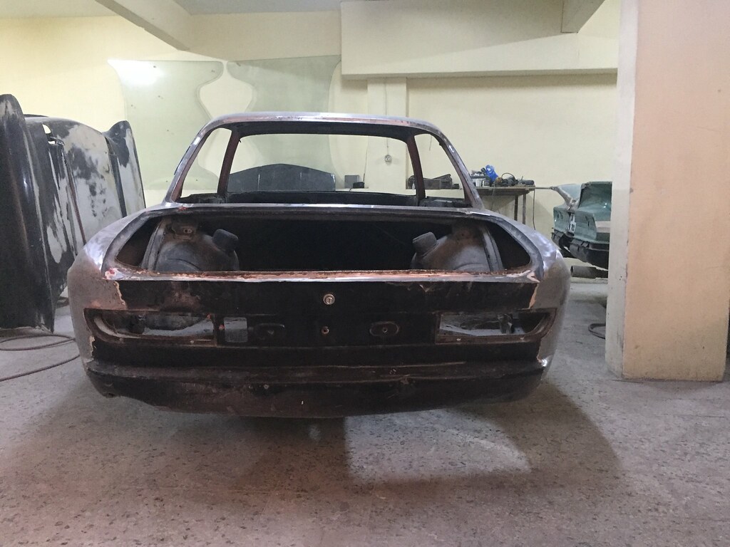

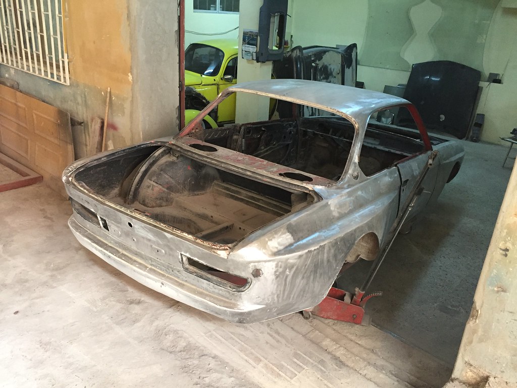

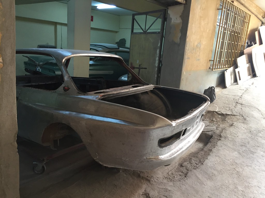

the rear is cleaned.

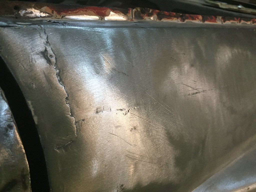

I will keep the bumper but fix the banged up parts also the curve will be the same with the boot lid
I don't know when it was done or by who but it is unique and I like the way it breaks the flat back side
Wow, there was a lot of work that went into those flared arches at some stage, are you keeping them or going back to standard

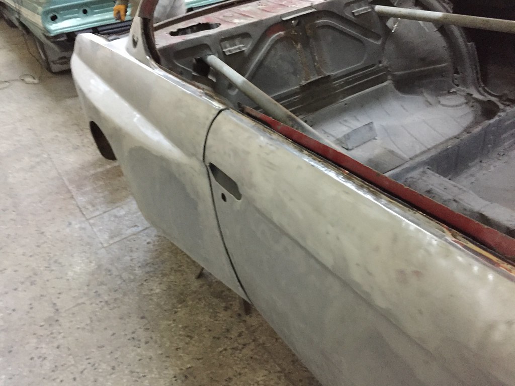

todays updates.

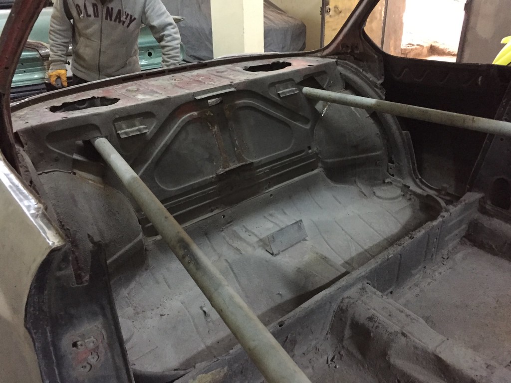

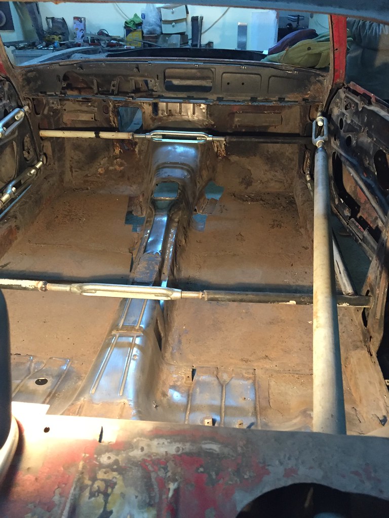

Braces to keep the car square

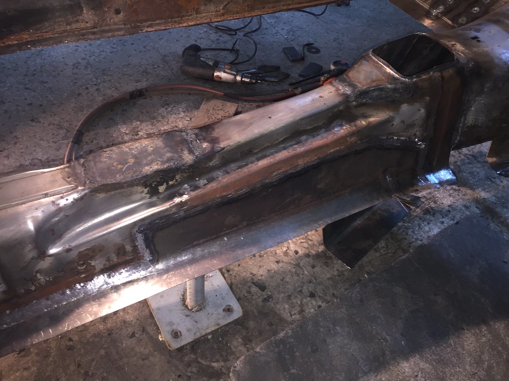

I am trying to figure out which part to start first. changing the floor panels or the rockers?
I am guessing rockers first so that I have a strong new piece to connect the floor panels. any suggestions?
We replaced the rockers first and did the floor panels later for the reason you already mentioned, better to have fresh rockers before you weld in new floor panels.

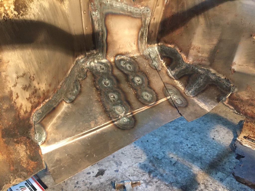

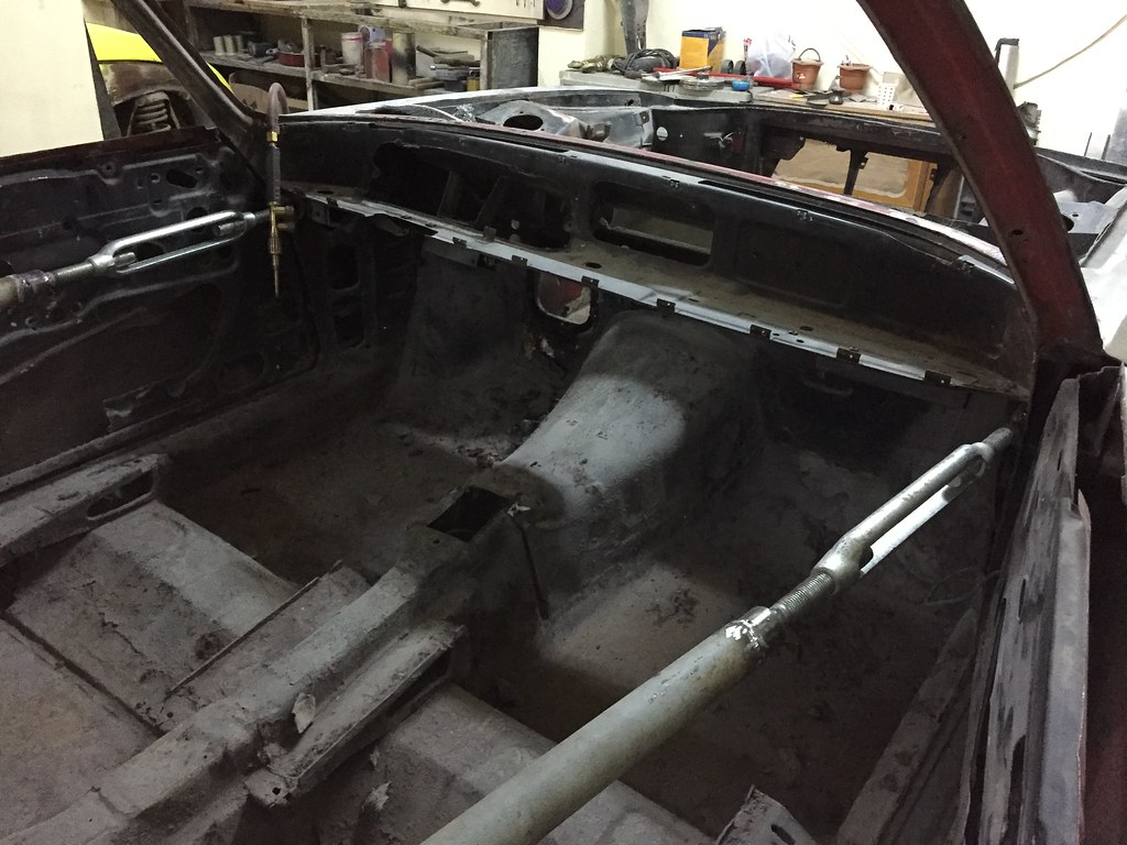

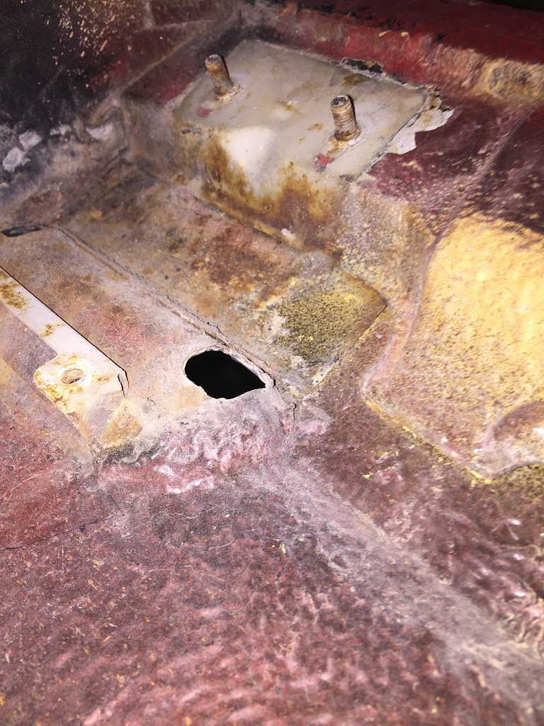

We have put the braces in the car and started the body work with the transmission tunnel.
we will strengthen the rear suspension connection points and then put the car in a rotisserie which i made with a friend.
there are many points with stress fractures since the structural elements are in bad shape.
I will ad more support to differential mounting point as it seems to have damaged it's surroundings
Where else does the E9 needs strengthening? I remember seeing something between the front chassis arms and the fender and firewall.
I would like the car to be able to handle a little more horsepower than standard if I choose to play with the engine a little bit.

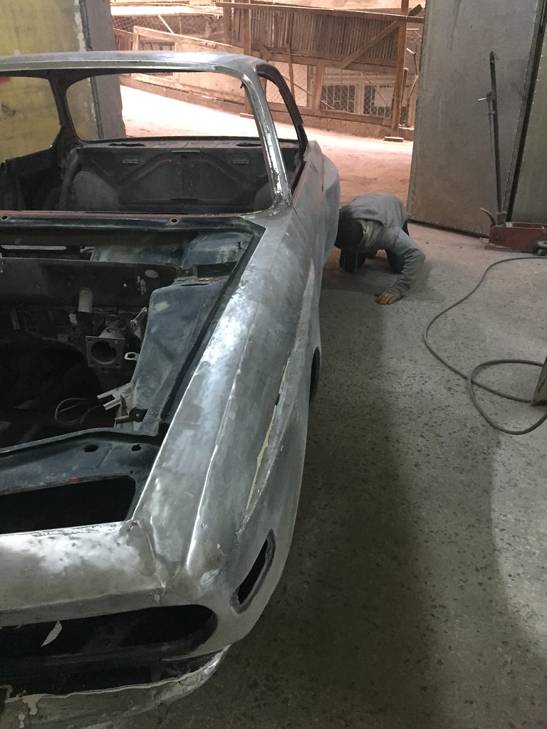

there was some previous repairs made to the car very poorly. flat floor panels are one of them.
also we do find some nice original panels in good shape as we dig more.
On the outside the difference between the original body modifications done in the 70's and the poor rust repairs done later can be seen easily
