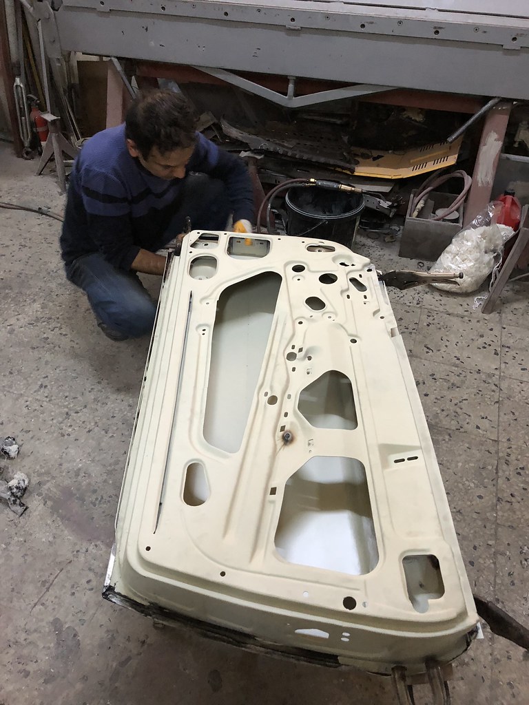

After months of inactivity (and me going nuts at the body shop) we are making progress again.

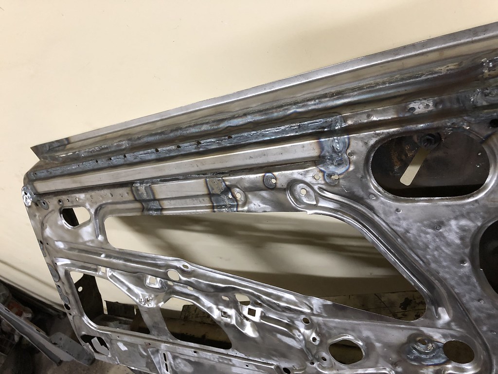

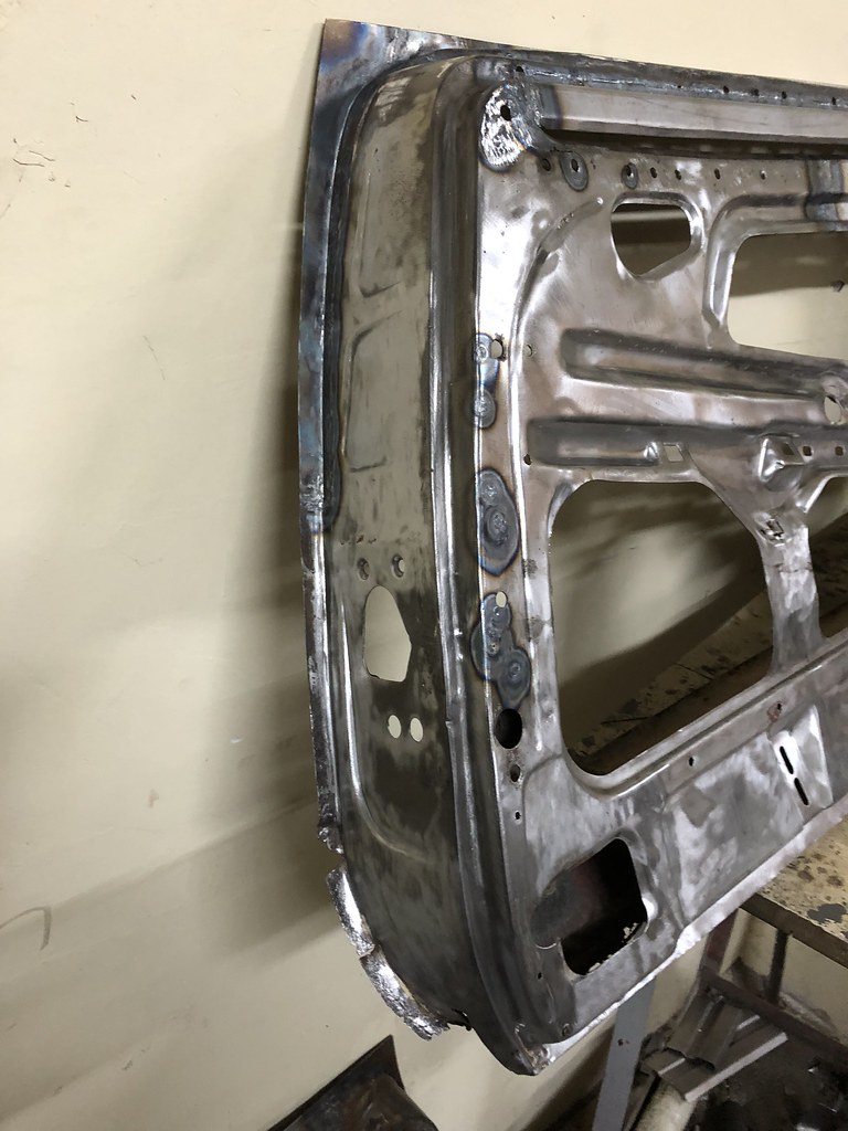

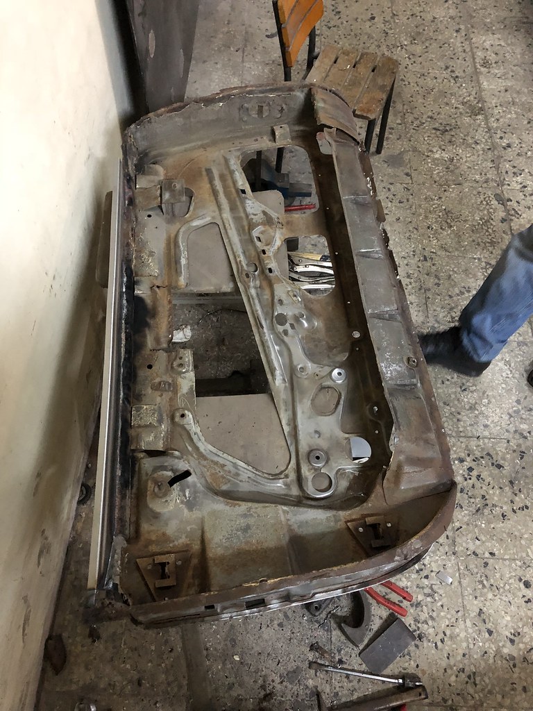

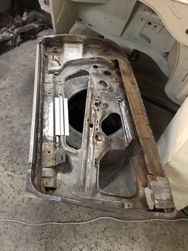

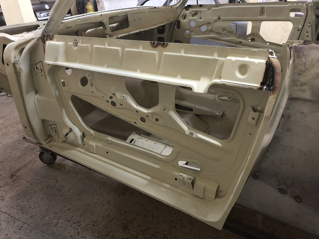

first we fixed the brutalized door frames

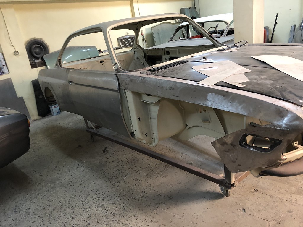

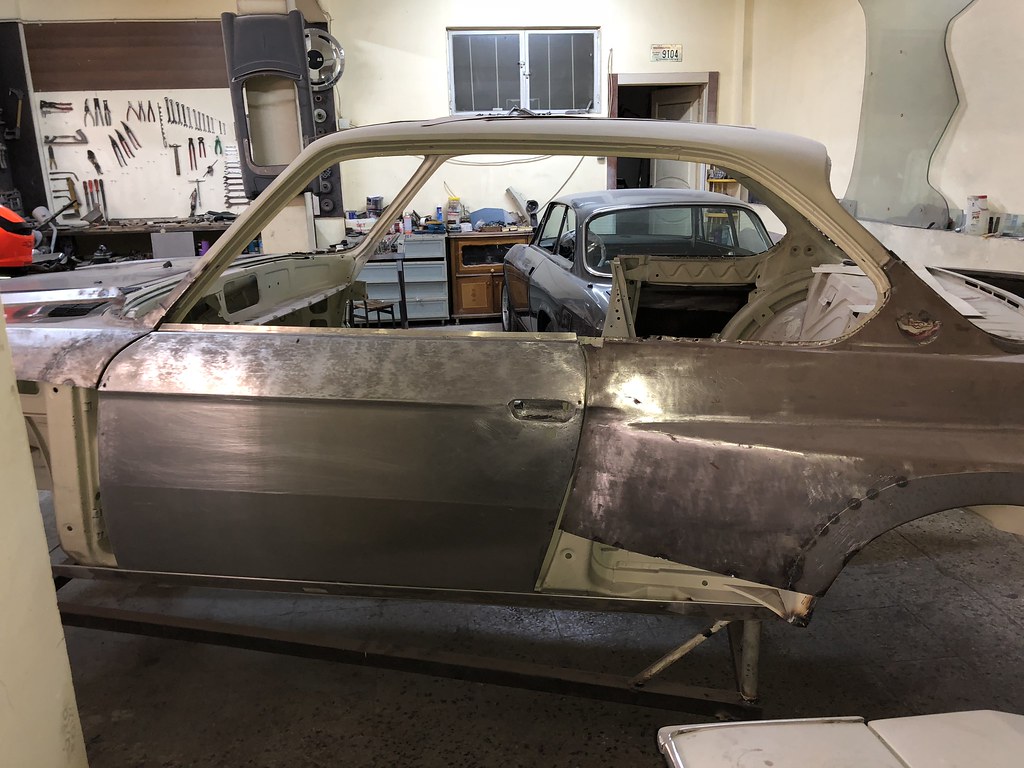

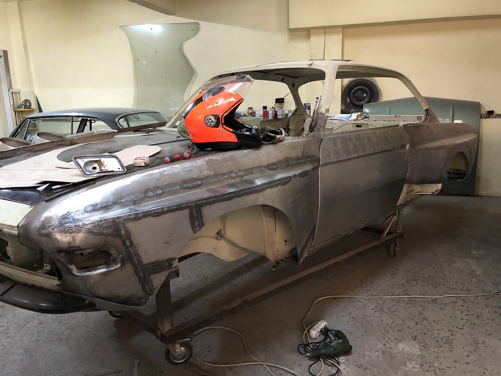

Then we added the aluminium skin

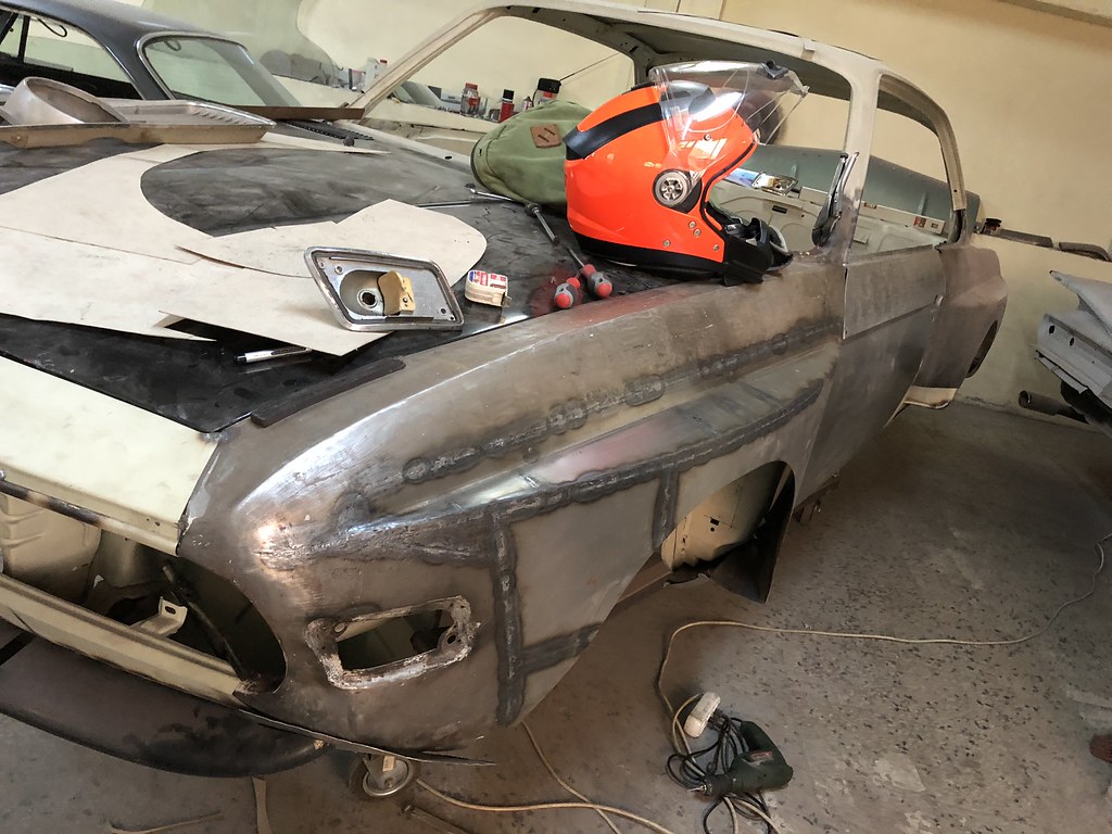

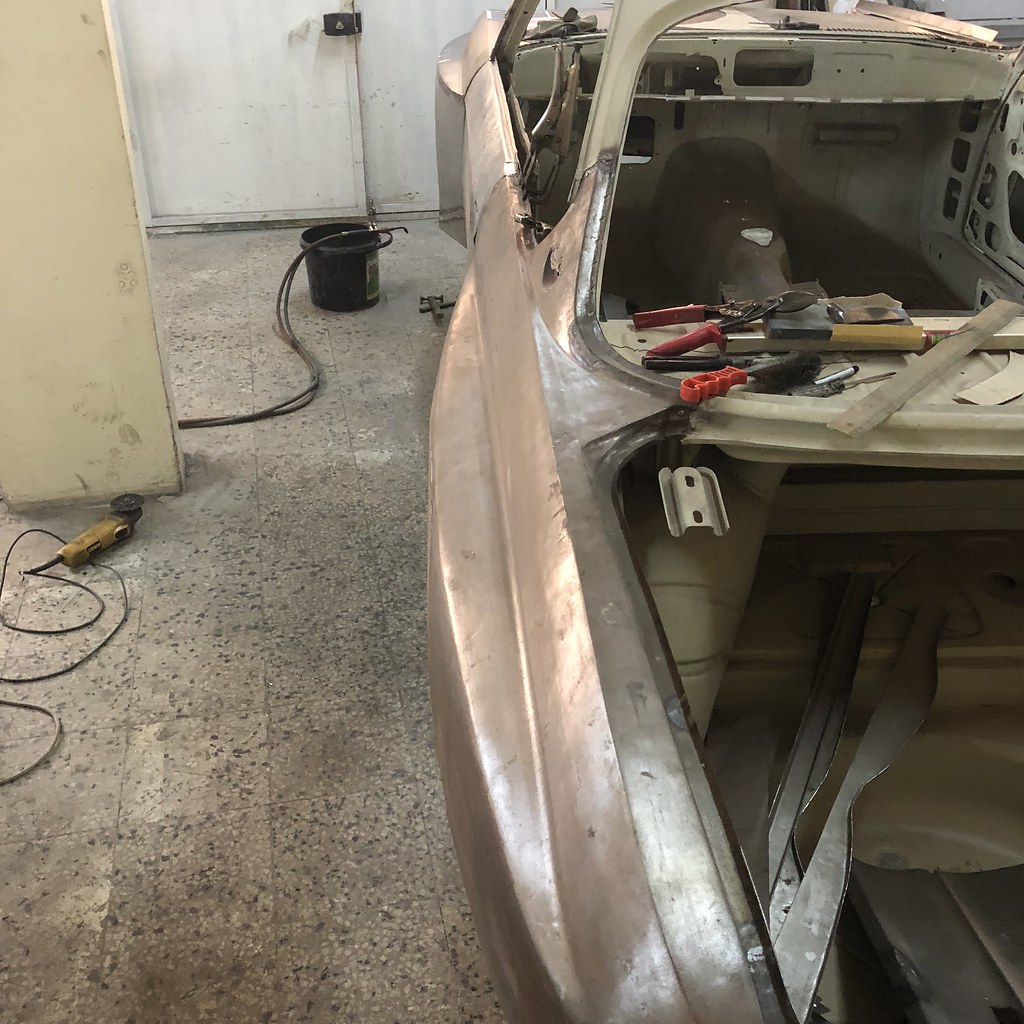

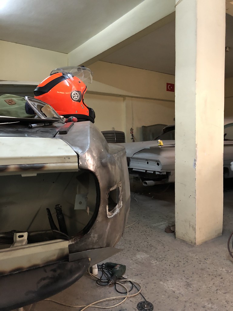

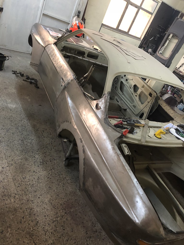

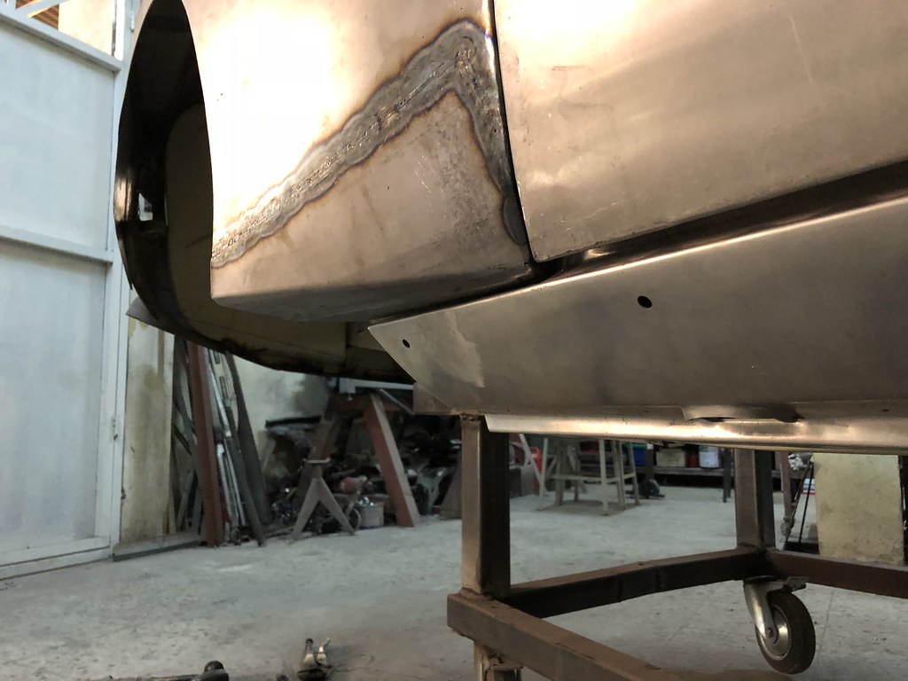

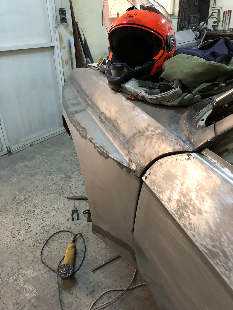

And we started the fenders
this is their raw form, there will be a lot more shaping.

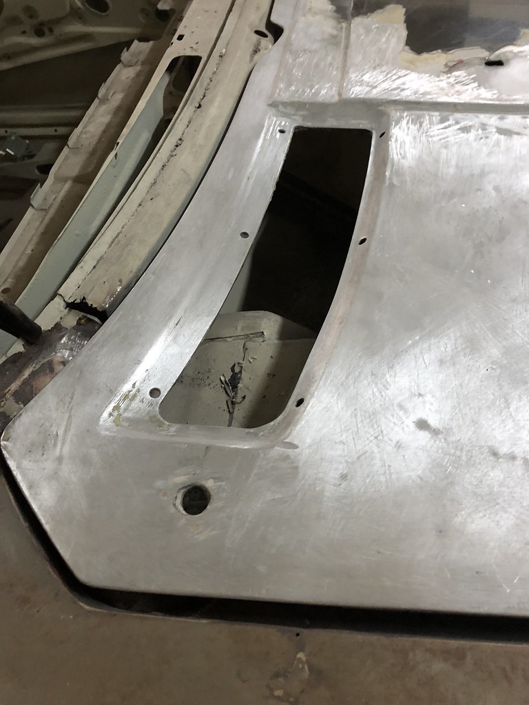

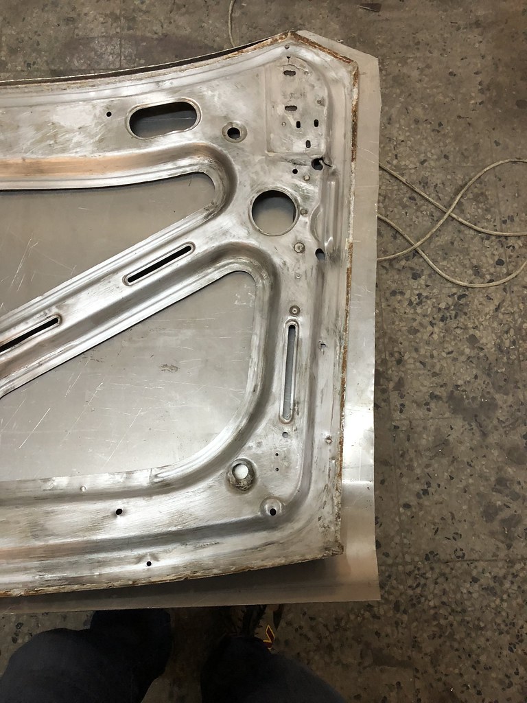

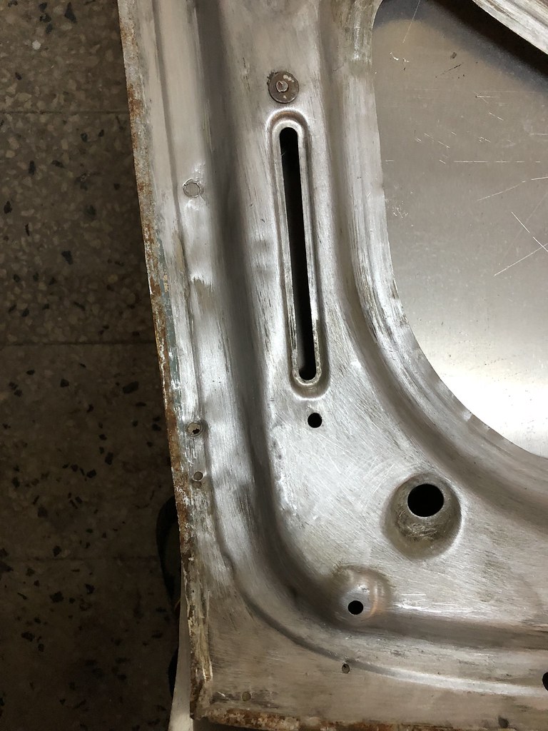

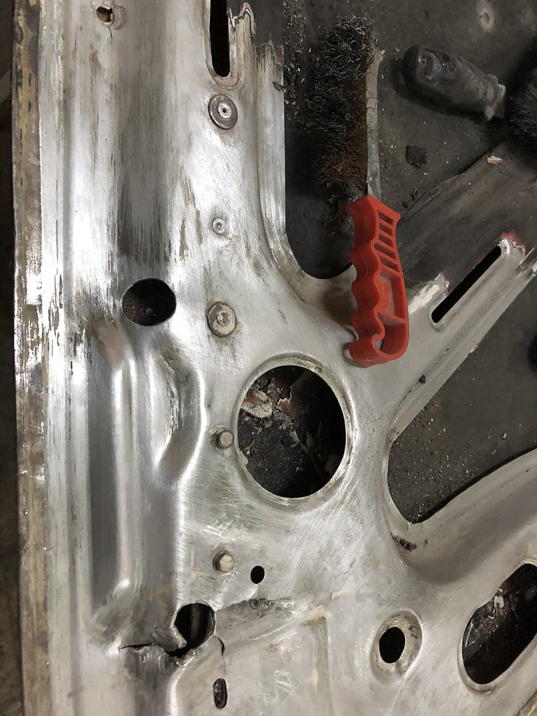

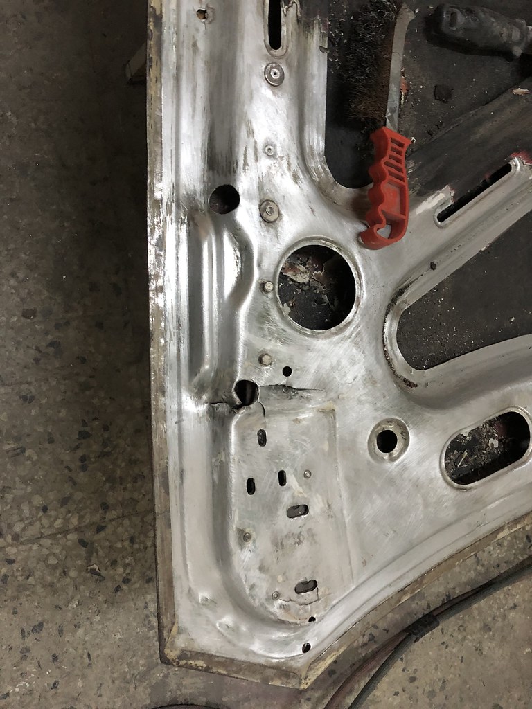

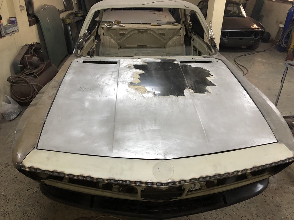

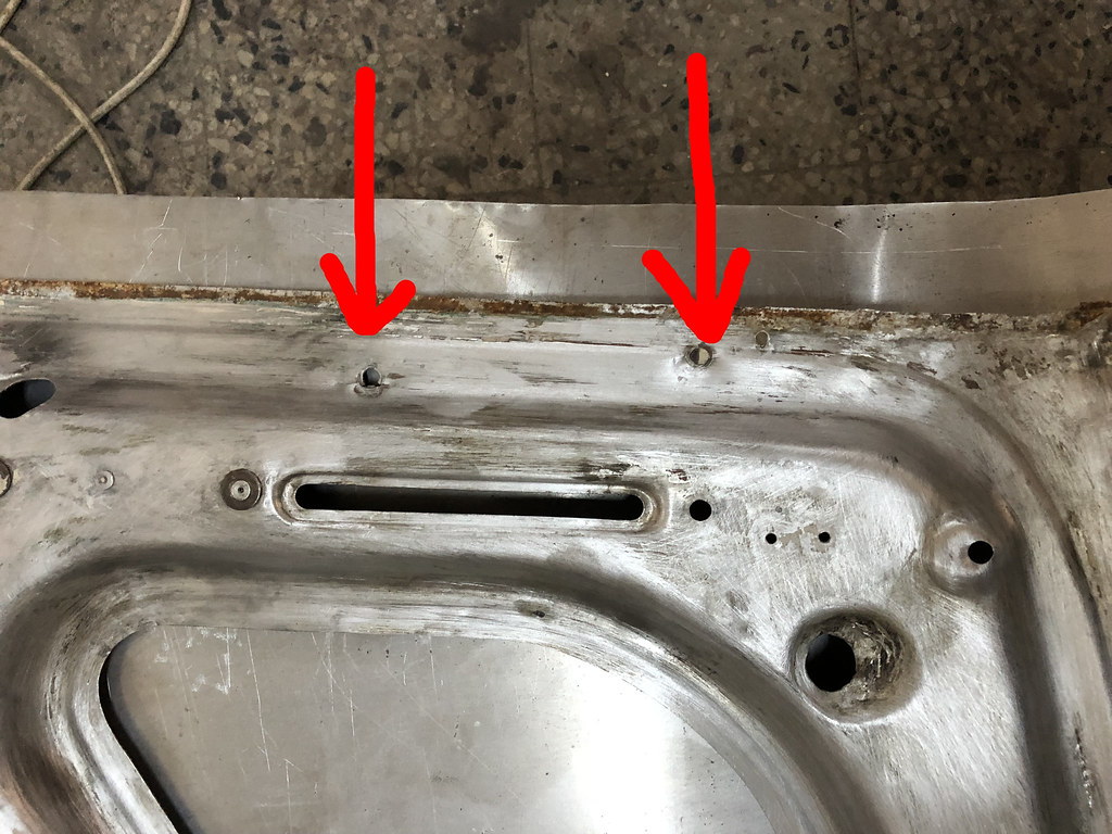

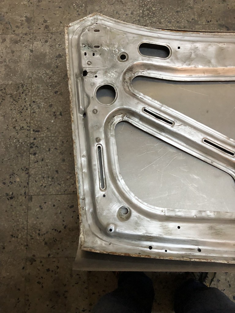

Found some new surprises while cleaning the aluminium hood and boot lid.
like holes for locking pins and cracks at stress points
all will be fixed.
I am not sure if I will keep the locking pins
I am guessing these are the holes for the wing.

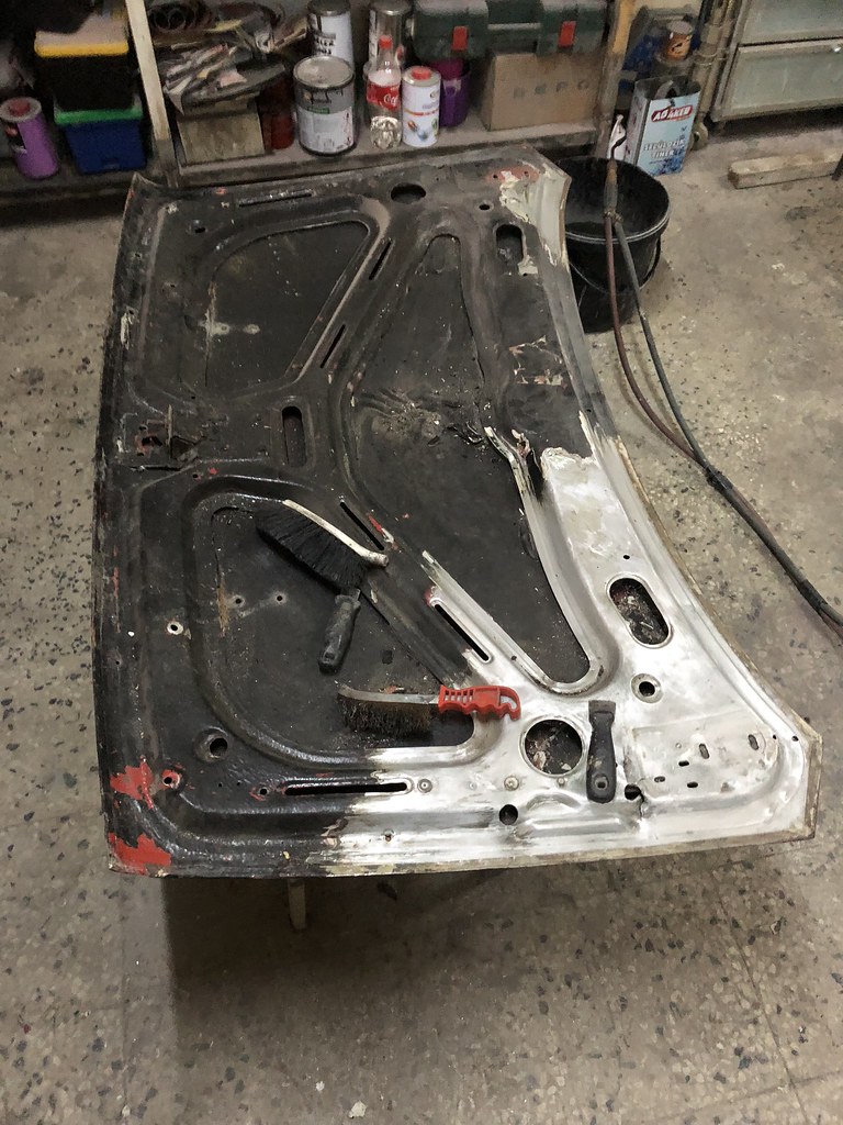

someone at some point replaced the aluminium skin of the boot lid with a steel one and left the inner piece aluminium. that was too much weight for the inner piece.

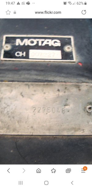

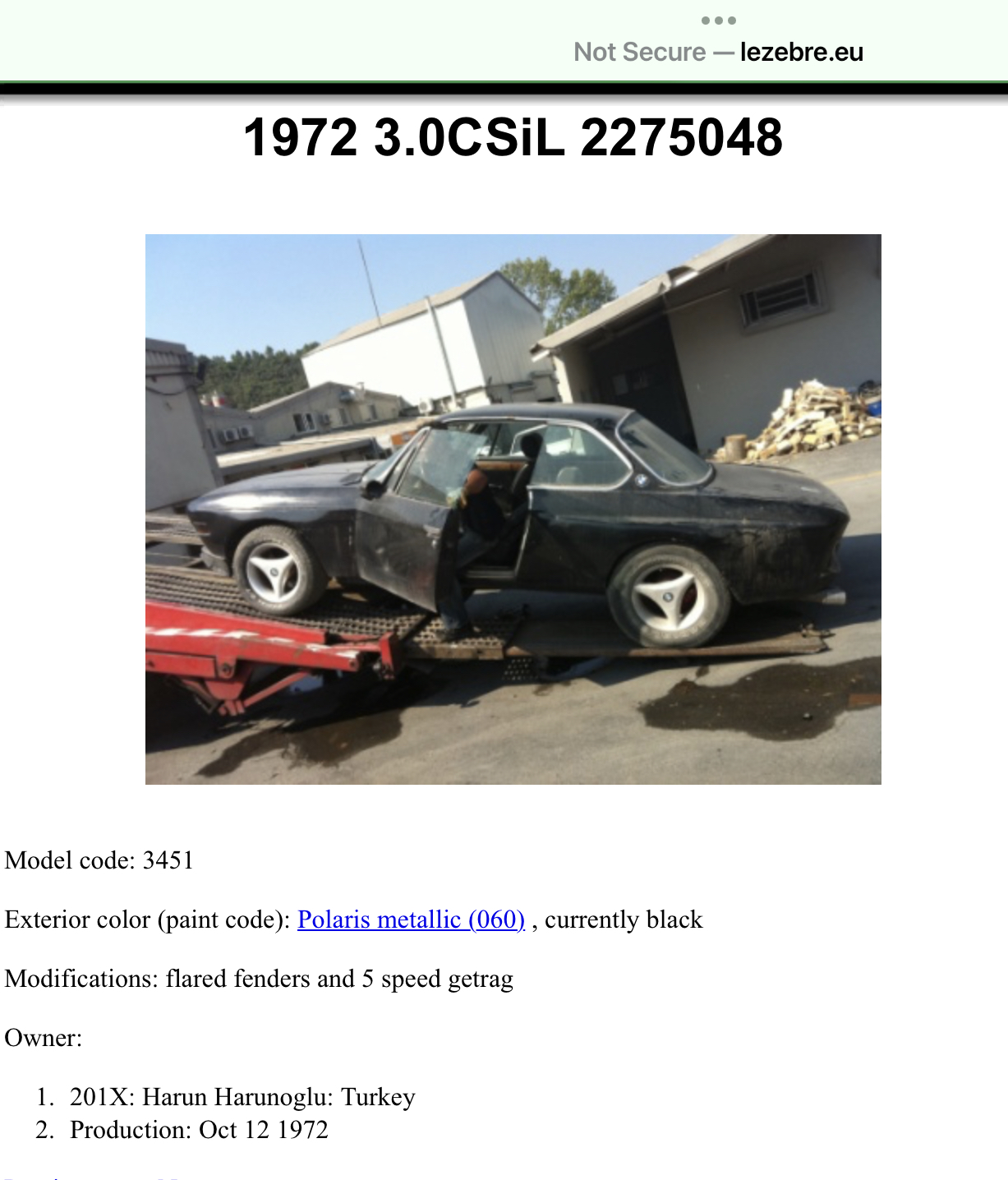

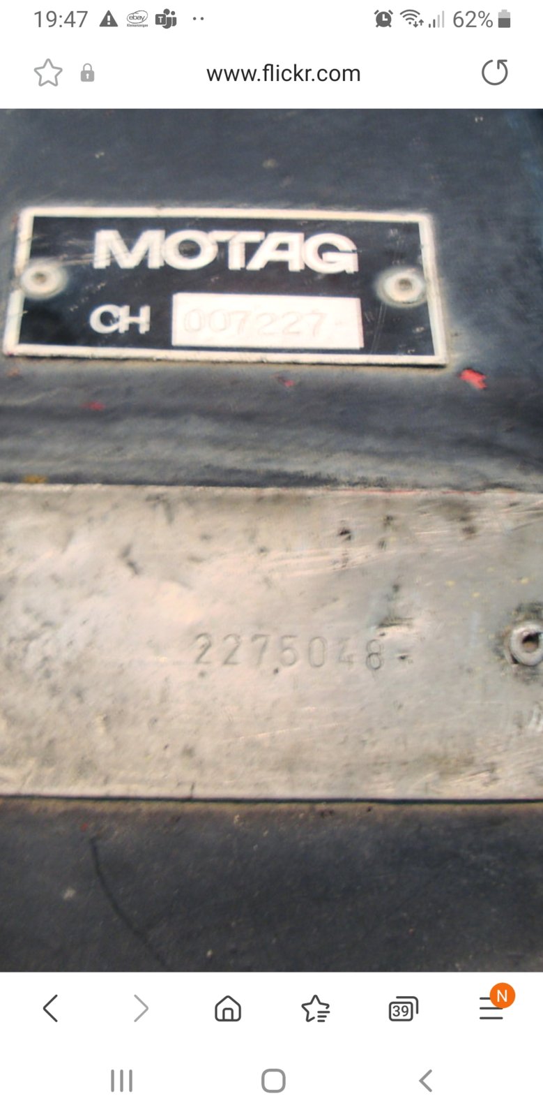

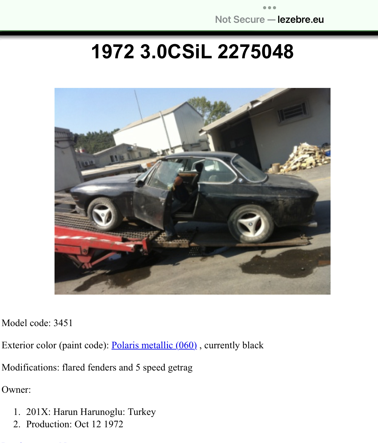

If the Karman number is 8789 it suggests the car was built in September / October 1972 which would fit with early 2275*** LHD CSL`s. Do you have a photo of the chassis stamping in the heater bulkhead ?
Many years ago I bought a car with similar history and many Alpina parts including a 300 KPH speedo....
Clicking back and tracing the flick'r foto's i found this chassis plate: indeed 2275048, Motag 7227
The OP also gives some history in the link in his primary post.

Erik has got it right per LeZebre Info limited to current owner
Why all the heavy flare work? There was/is correct glass grp 2 flares that would be so much less weight, easier and more accurate to in-period race cars (if that's the goal). Does anyone have any idea when this was done?
@Kizilsakal is regularly on line, hopefully he can enlighten us with the very valid question from Tyson.
