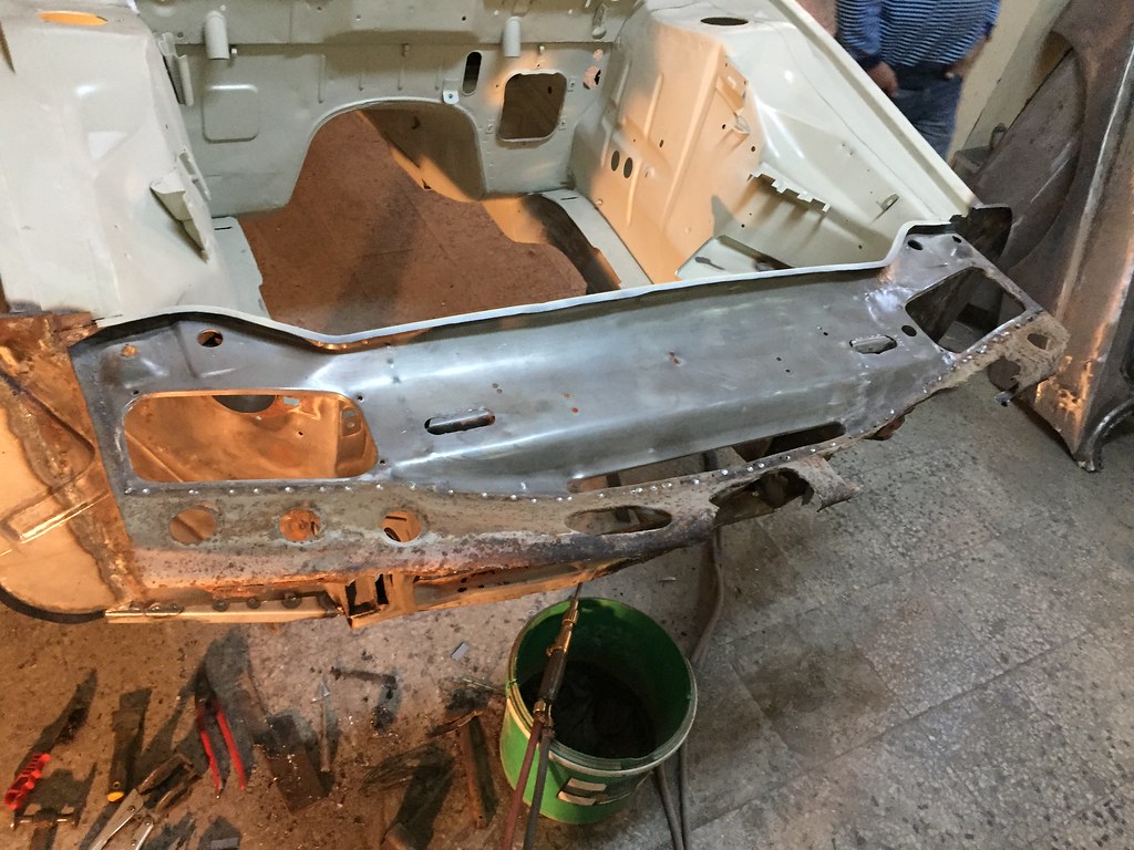

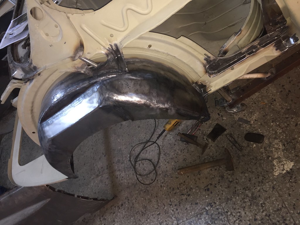

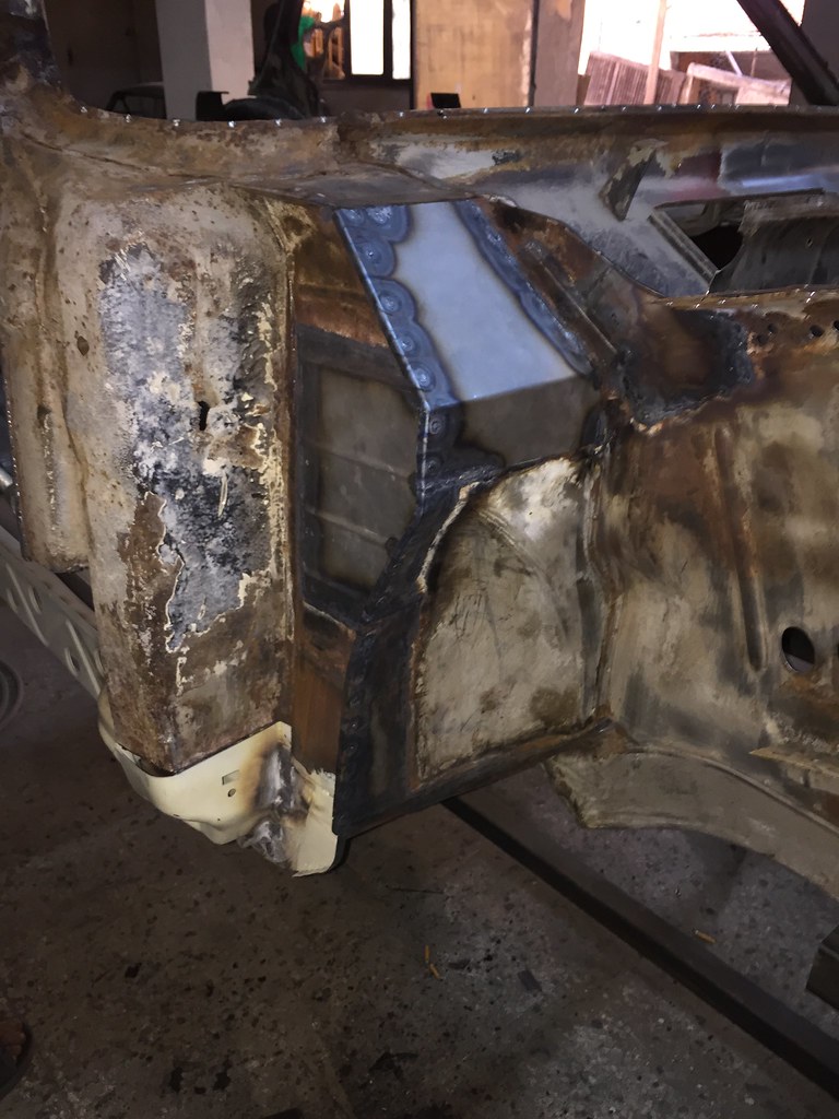

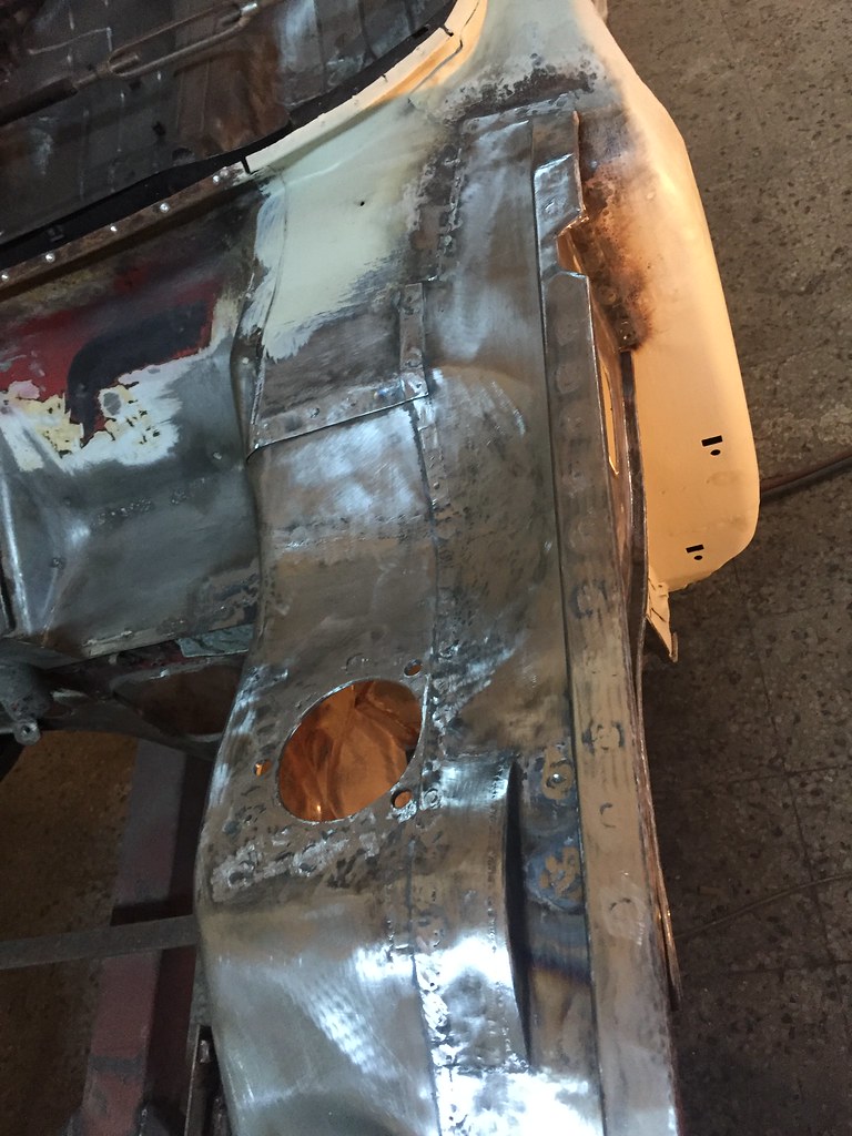

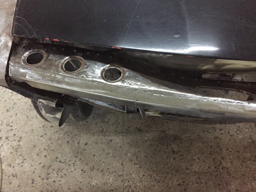

I haven't been able to post the updates for a while but the work continues.

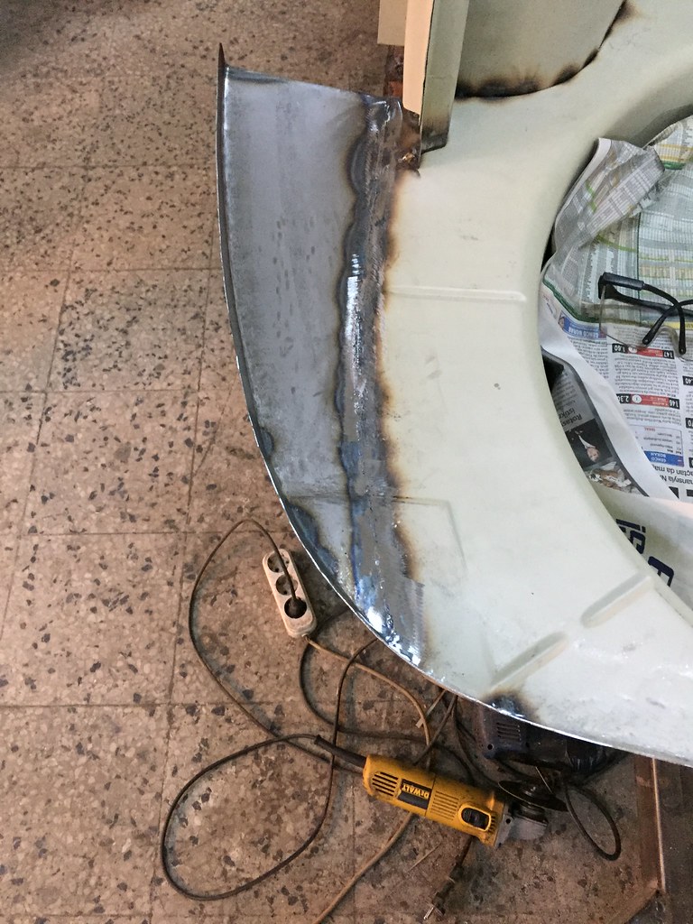

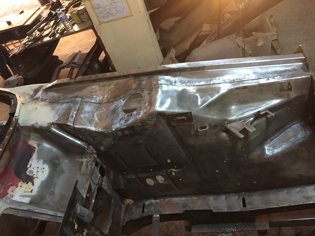

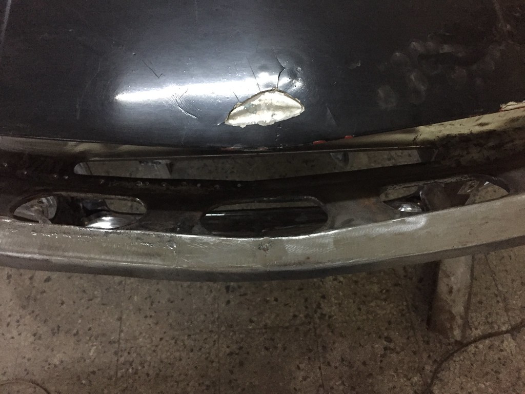

did you form this piece yourself? do you have the dimensions by any chance?
I dont have dimensions on paper
that piece was formed by side by side comparison with the piece that came out. but I can measure next time I am at the body shop if you are looking for a specific dimension.
if it wouldn't be too much to ask, that would be great thank you!
Hi,
I am sorry, I think I got this post wrong. I was thinking you would tell me a specific side of the part to measure. the whole part is quite complex to measure because there are curves with changing radius. and the part is on the car.
but if you want the whole piece I would do my best to make some technical drawings with dimensions.
let be know.

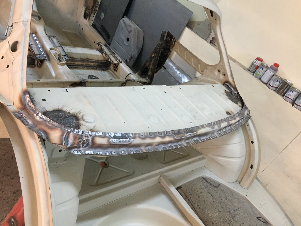

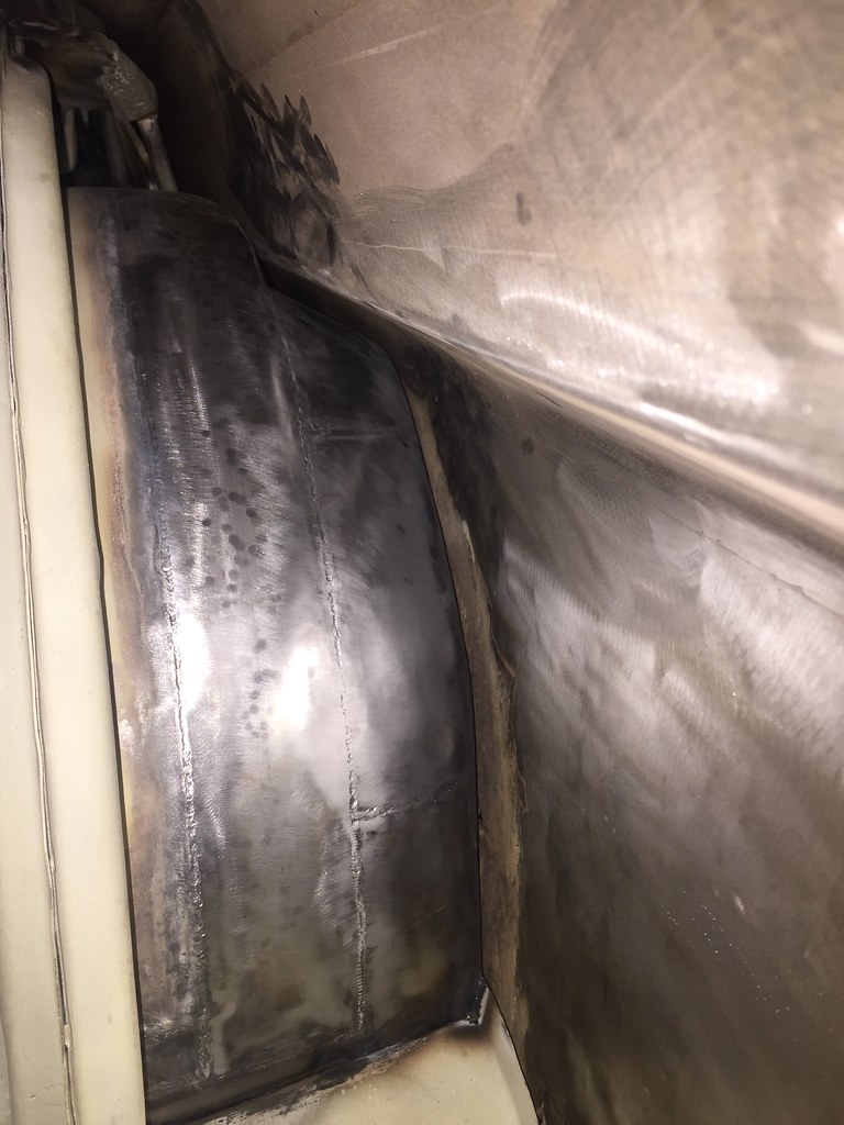

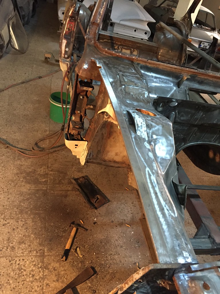

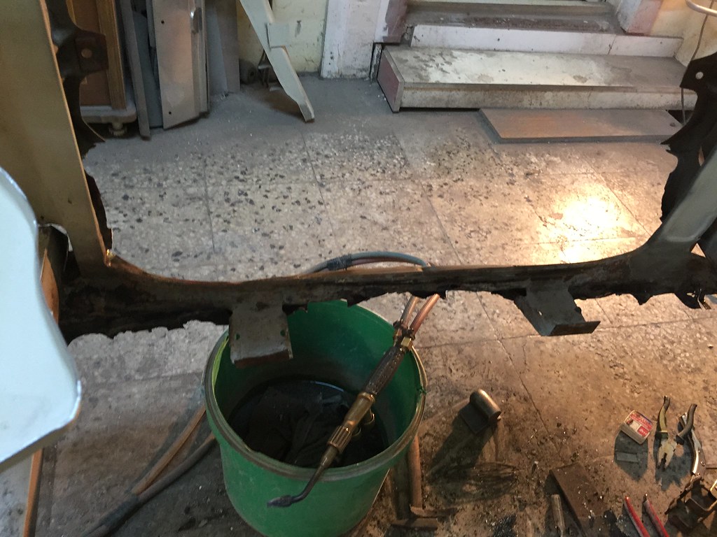

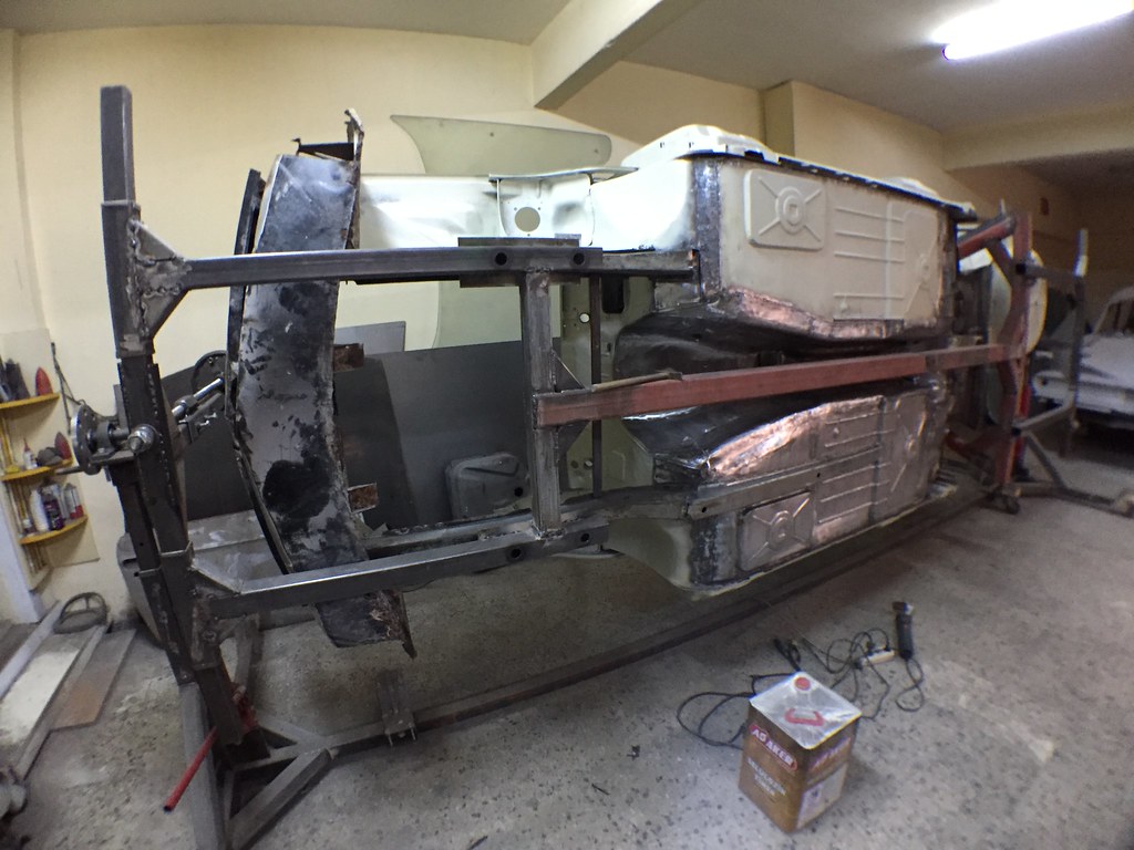

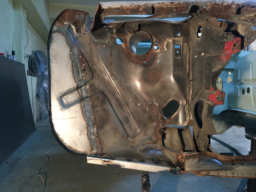

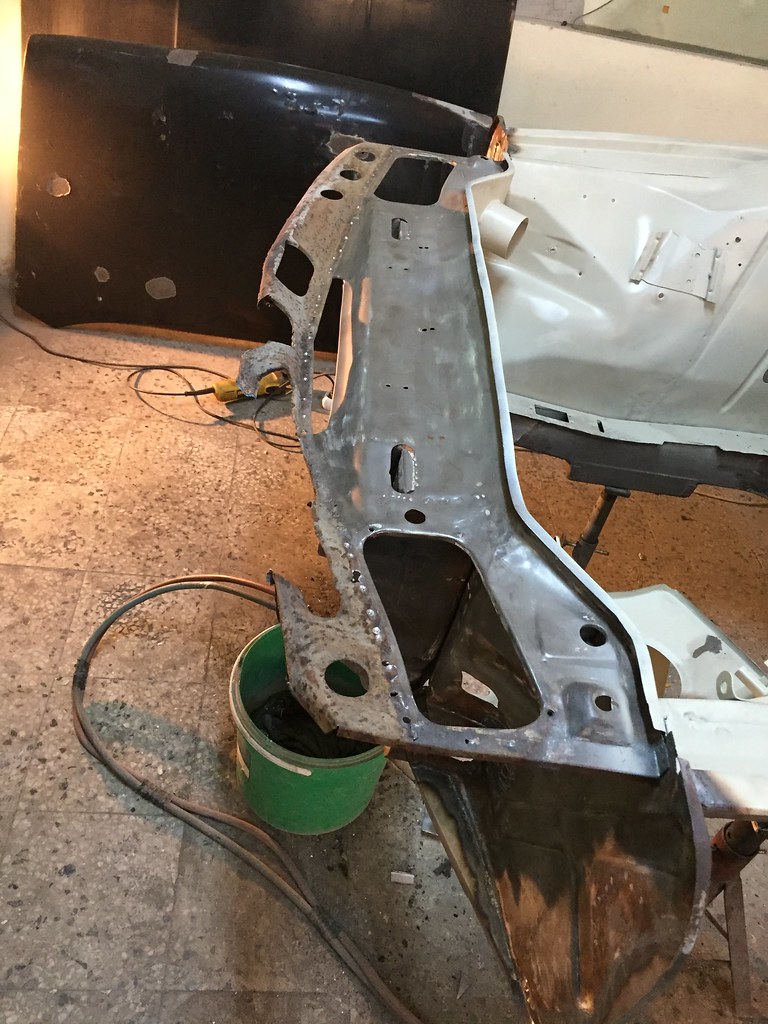

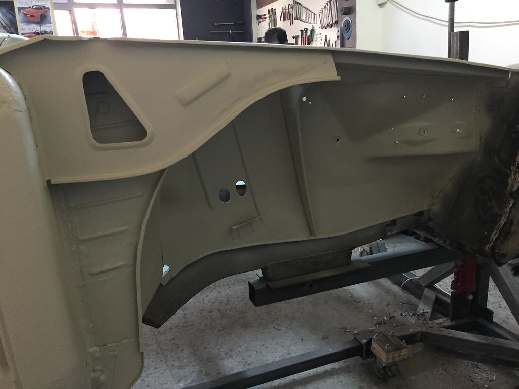

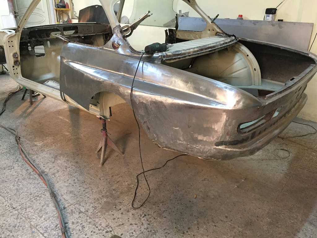

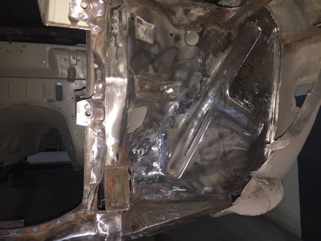

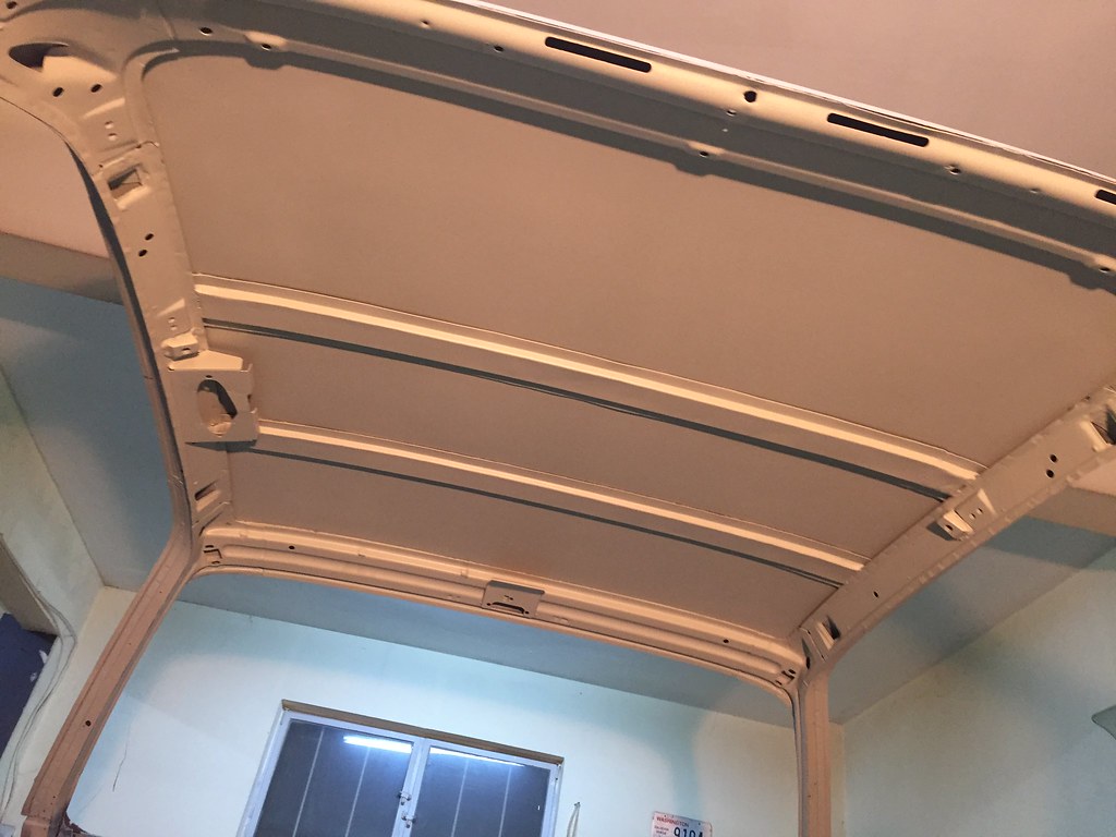

updates

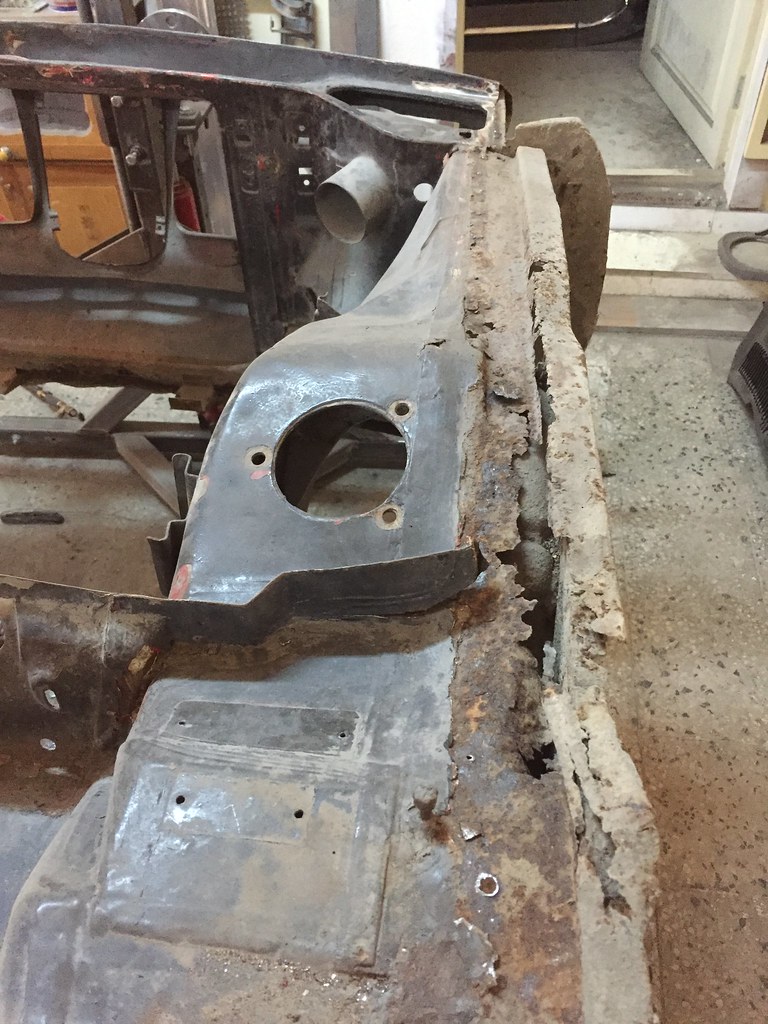

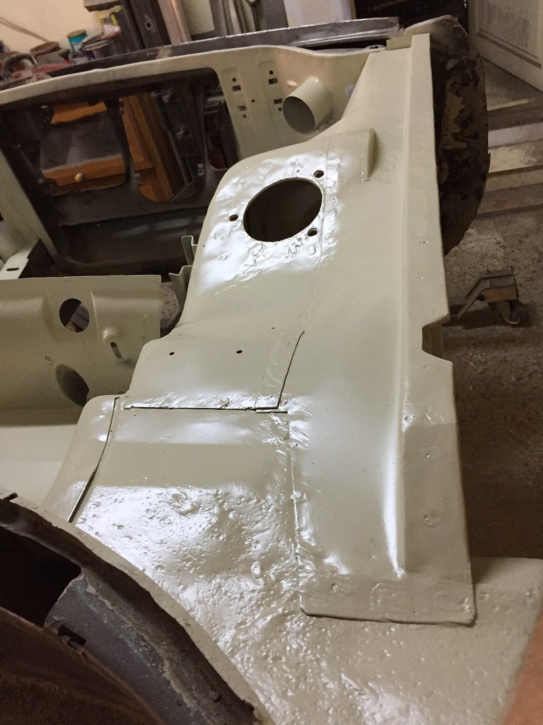

before / after

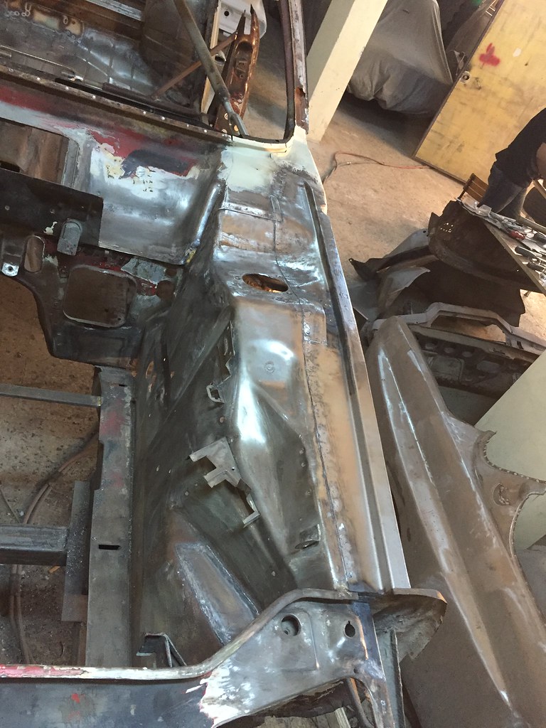

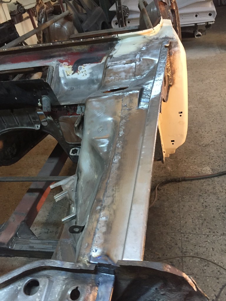

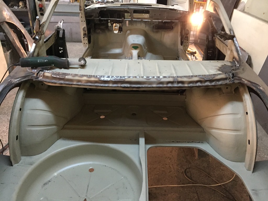

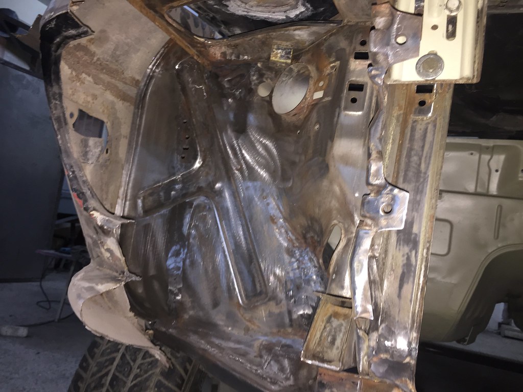

you may notice that the base of the A pillar is also removed. it seemed that there was accident damage.
and some more

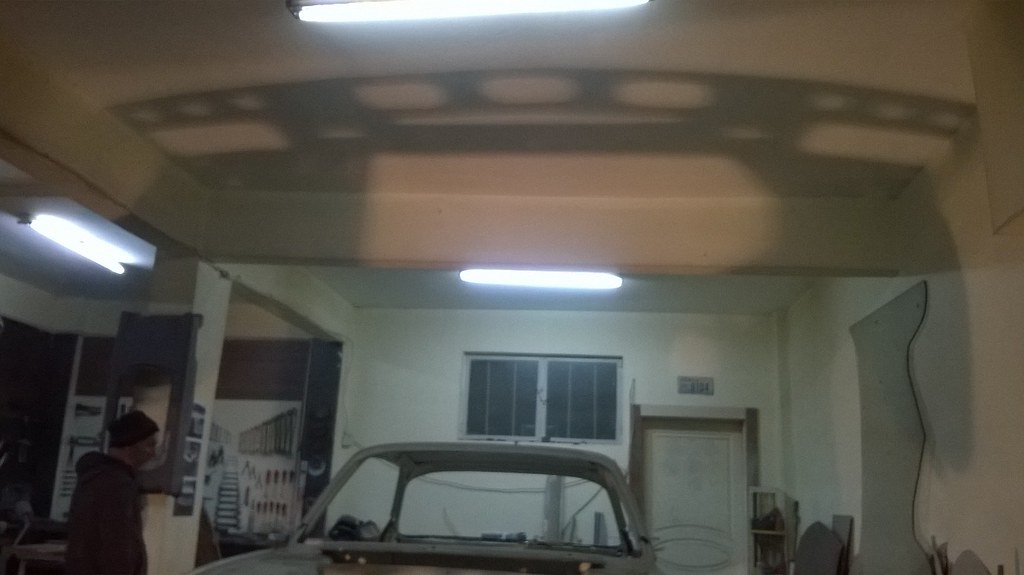

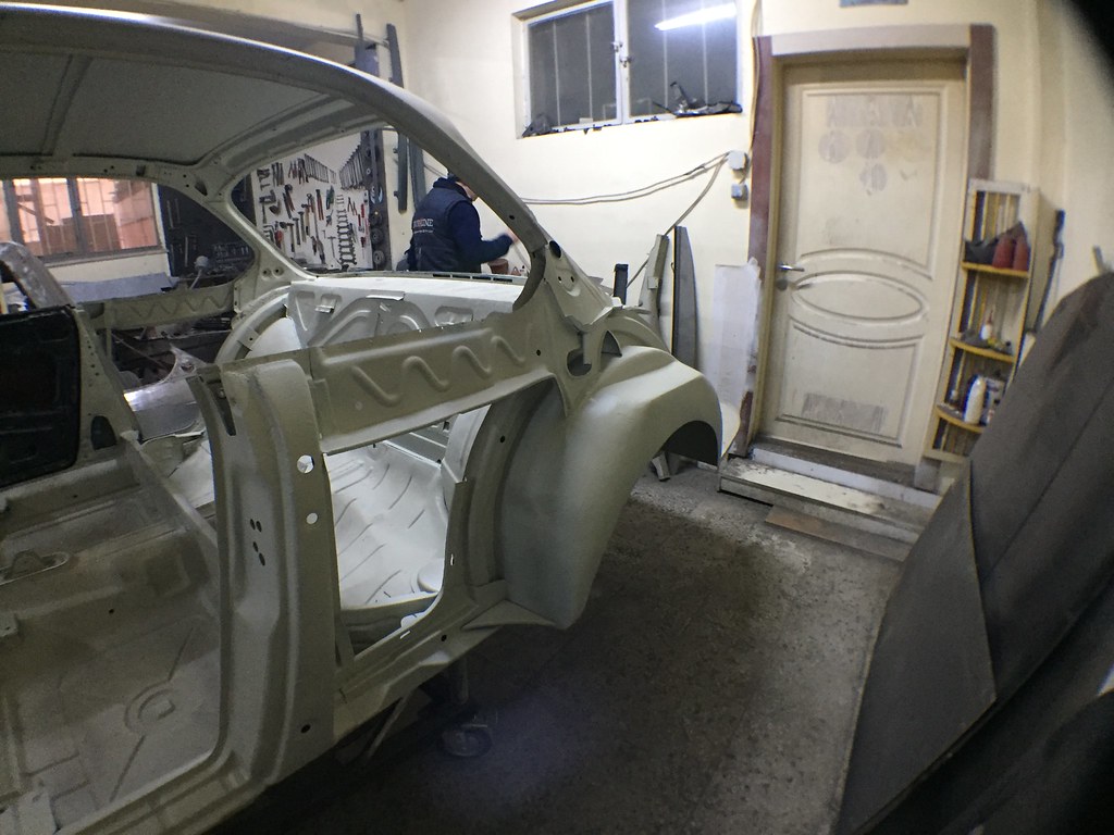

"good morning beautiful."

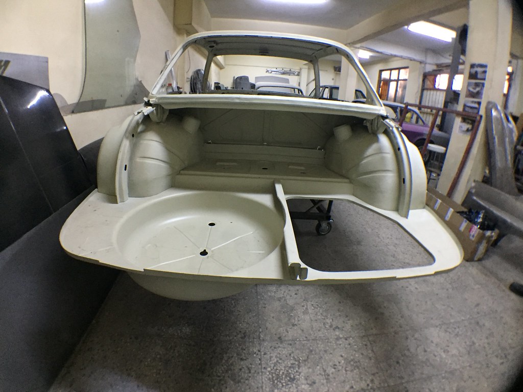

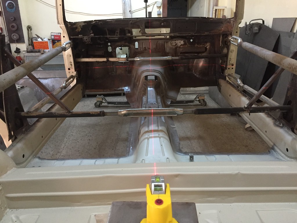

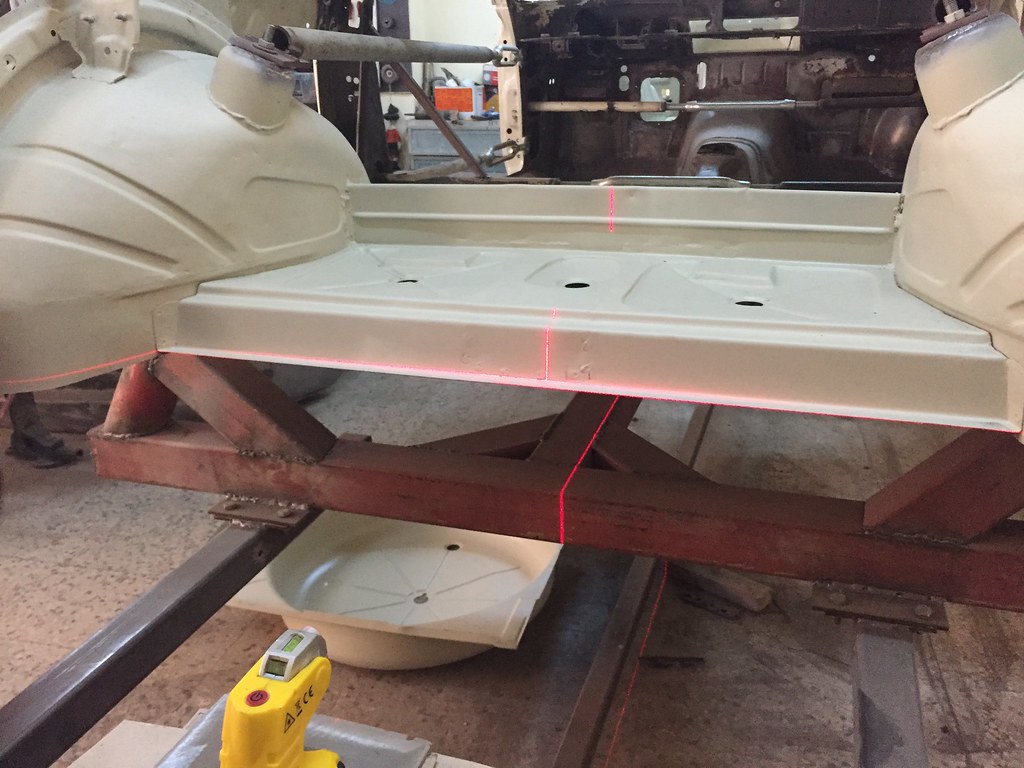

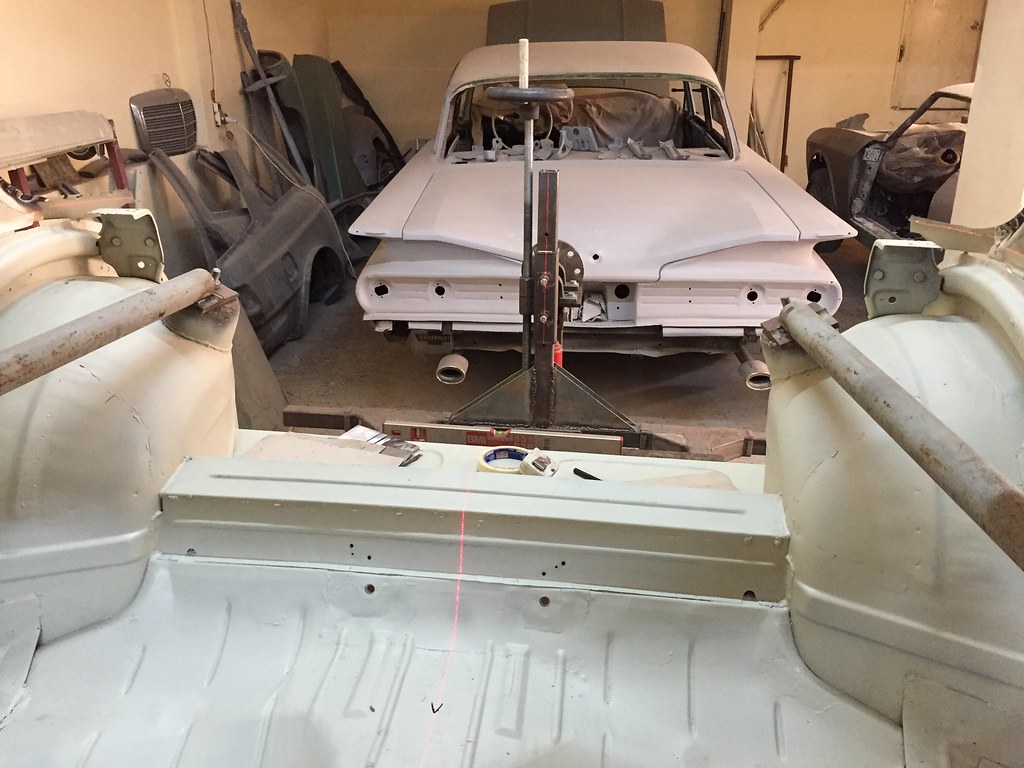

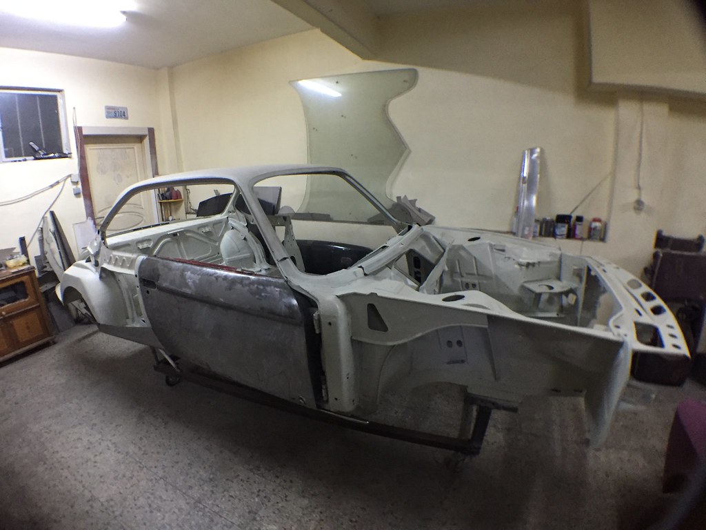

A 1960 Biscayne, an Alfa GT, some fiberglass M3 fenders and Merc Grill. also the laser lines. checking everything is where they should be.

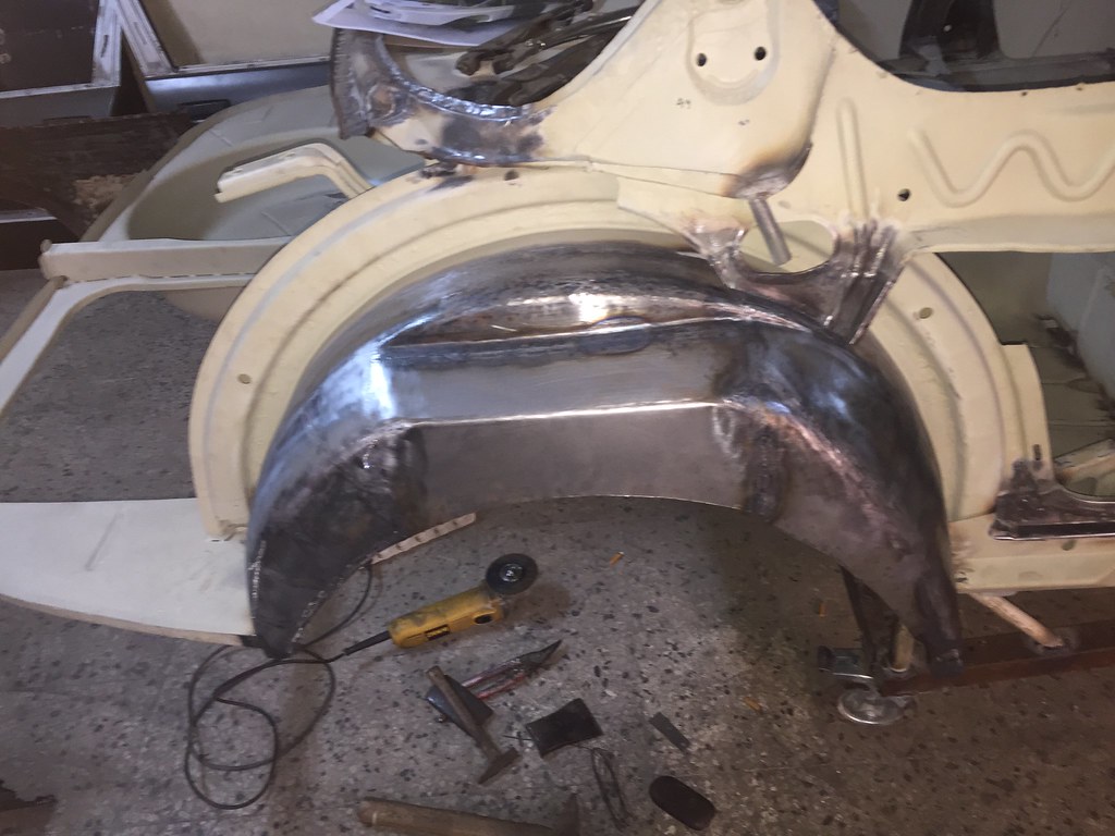

standard part just doesn't cut it :)

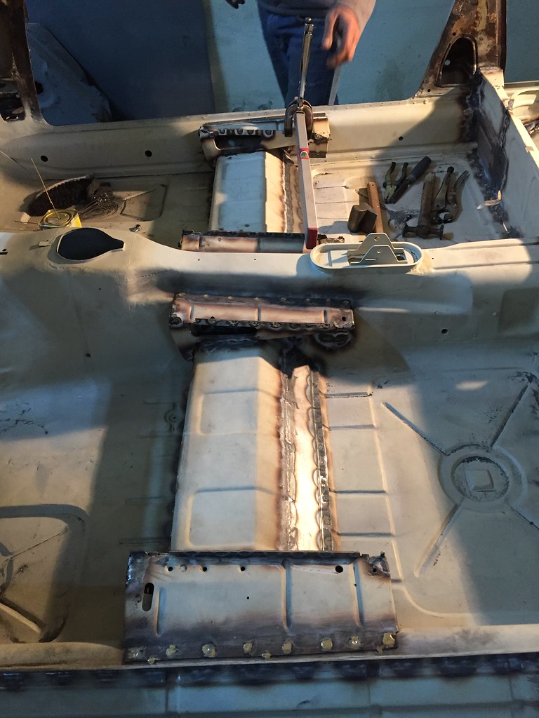

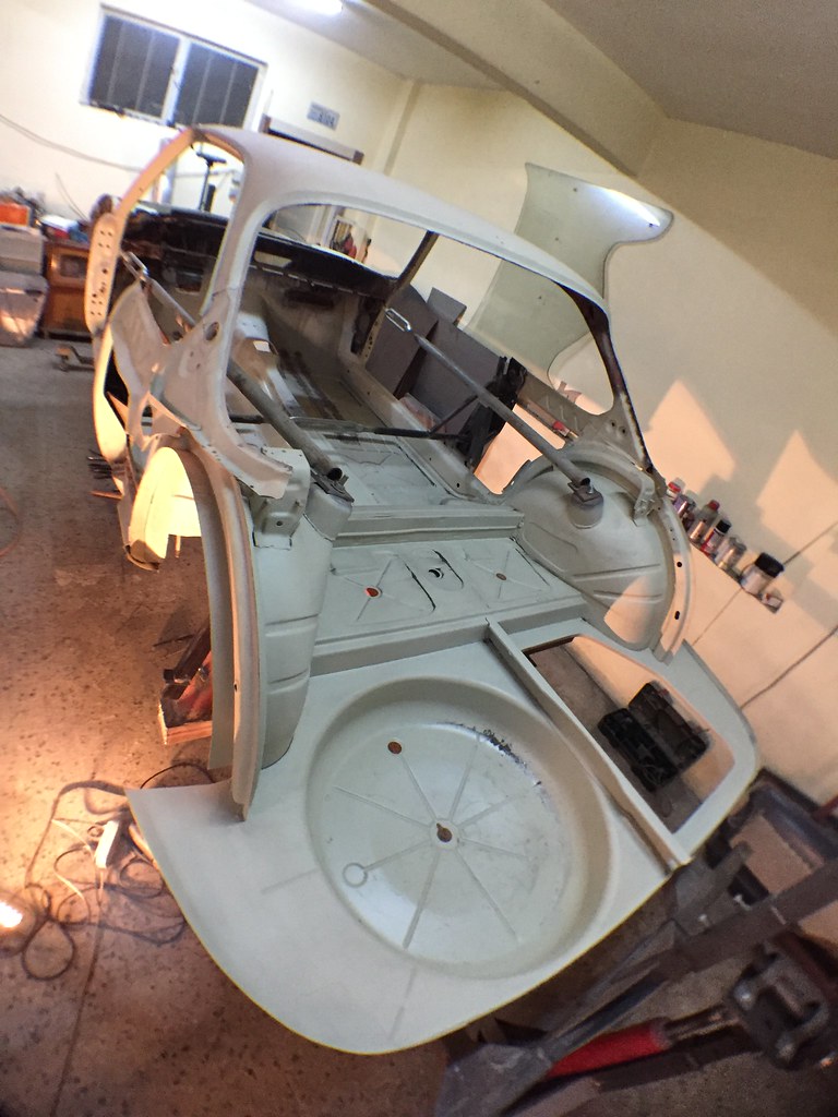

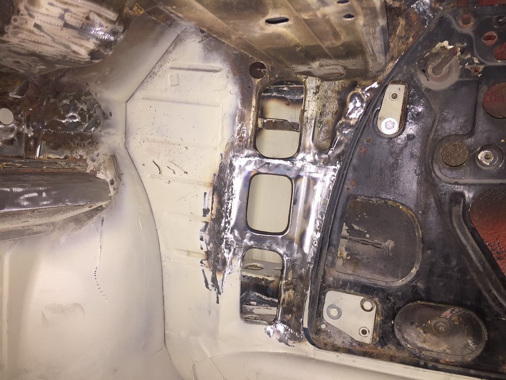

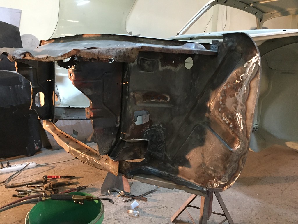

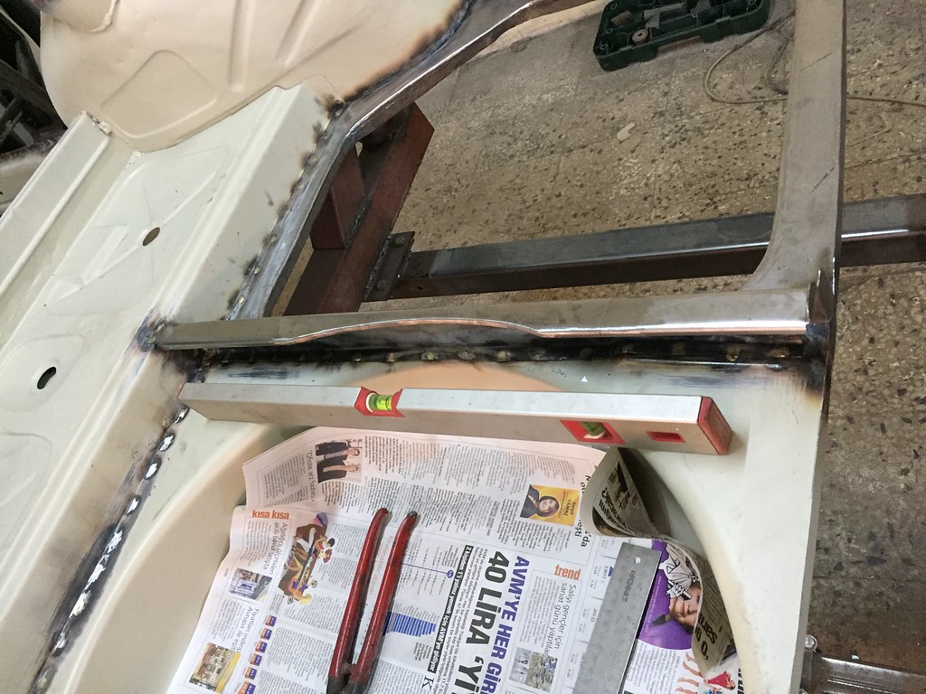

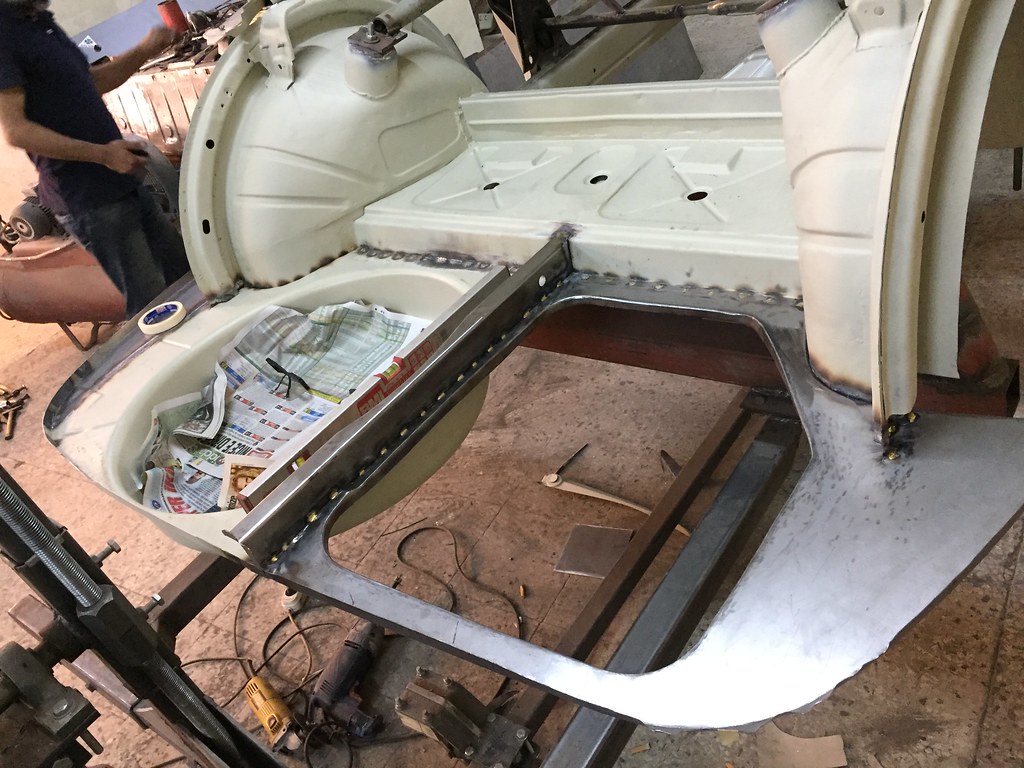

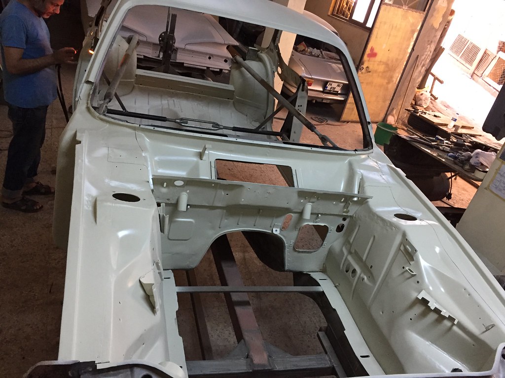

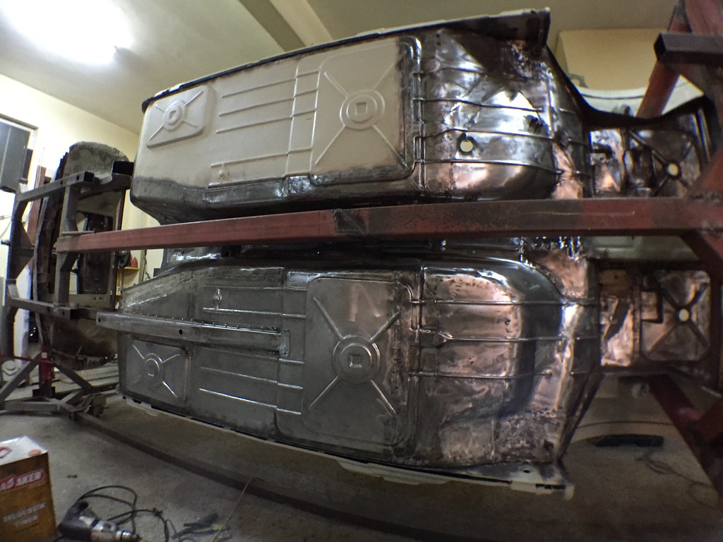

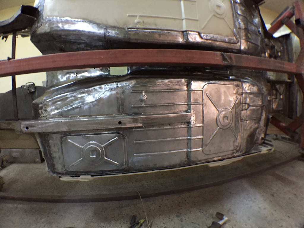

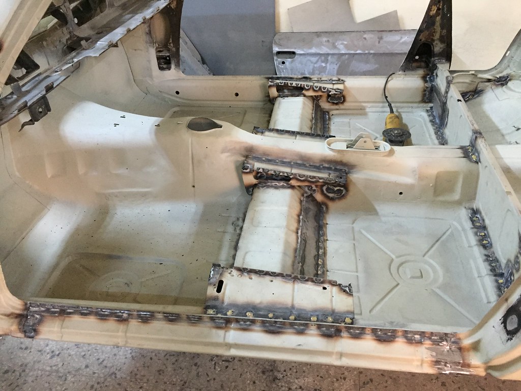

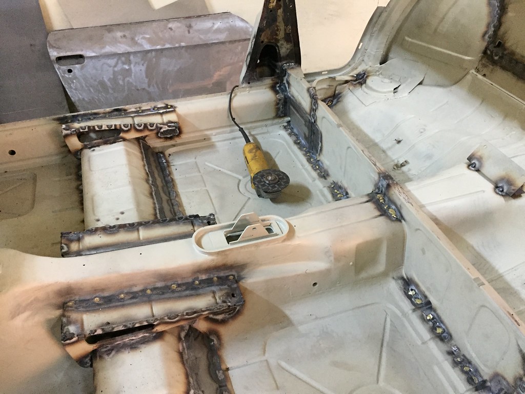

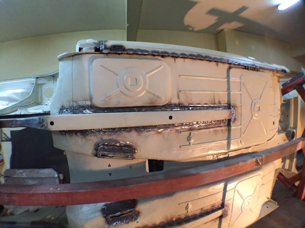

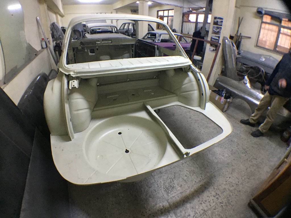

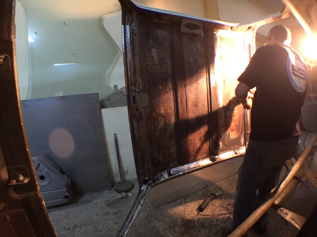

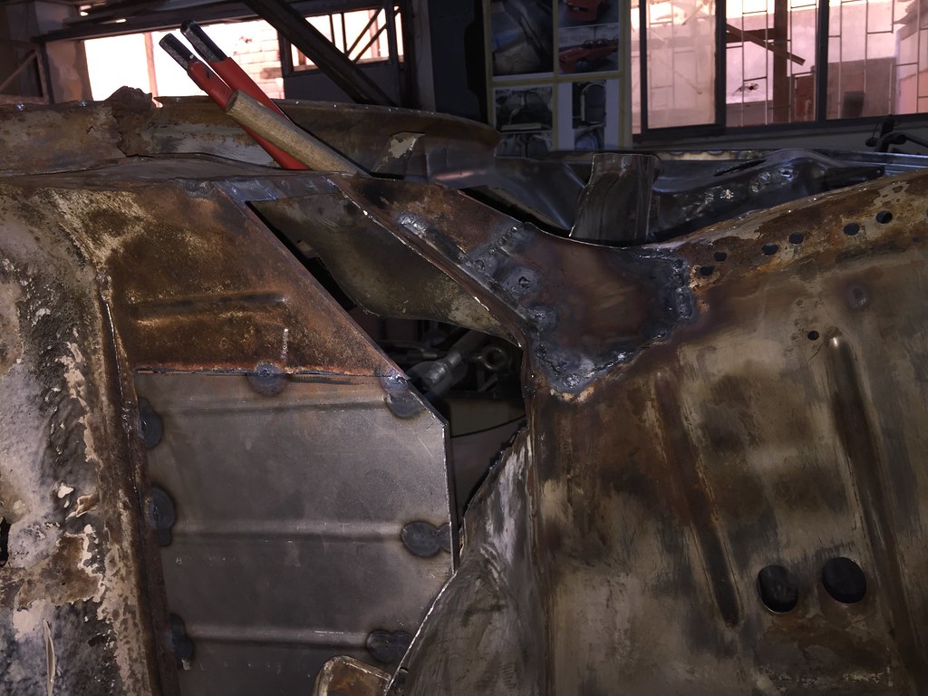

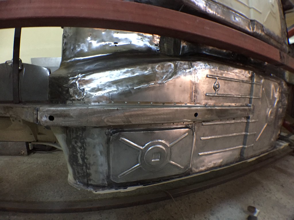

floor pans are in.

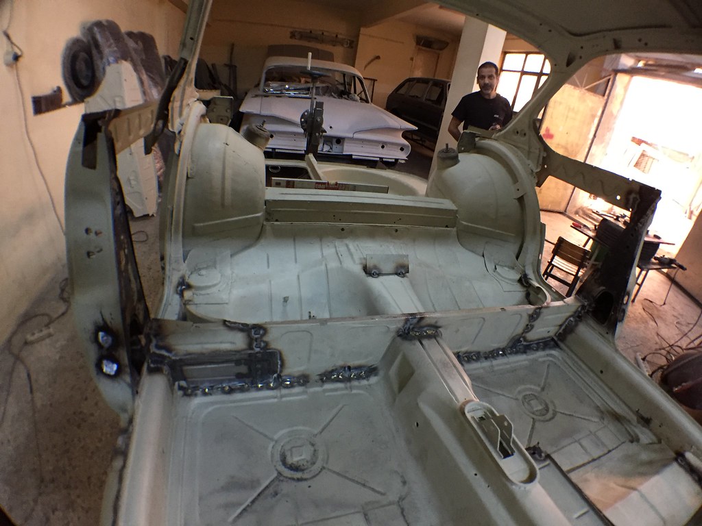

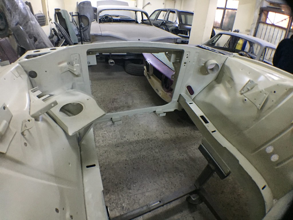

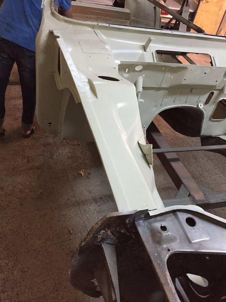

chassis legs are getting ready.

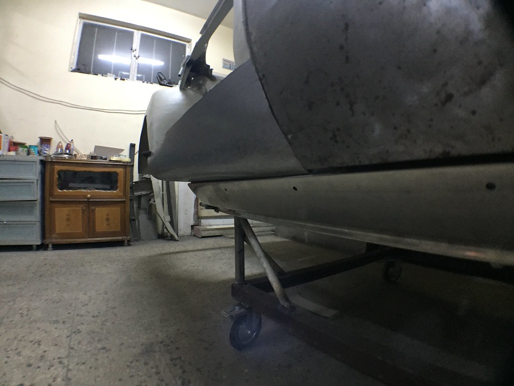

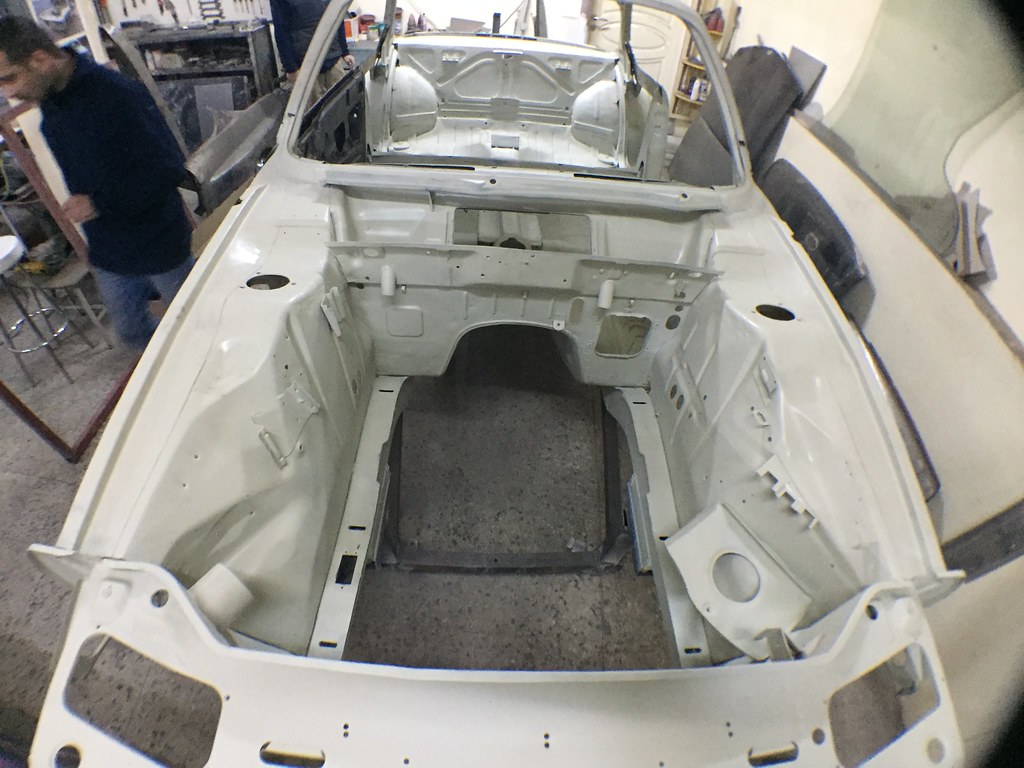

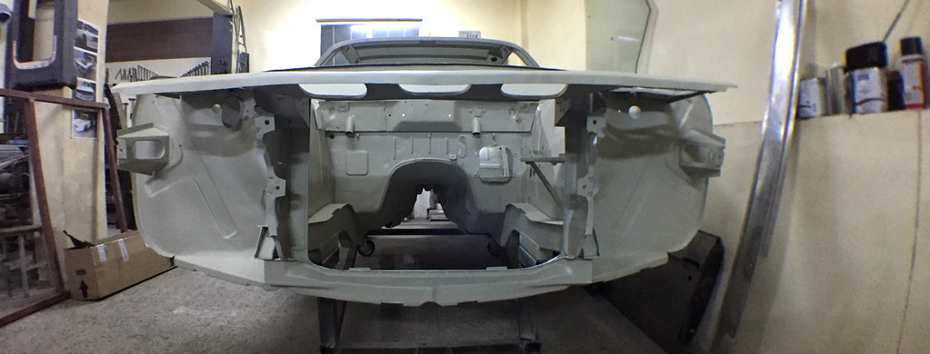

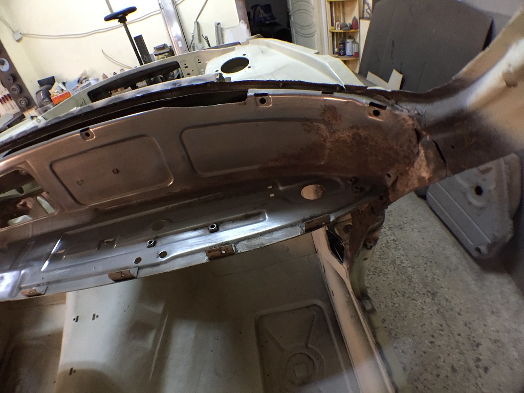

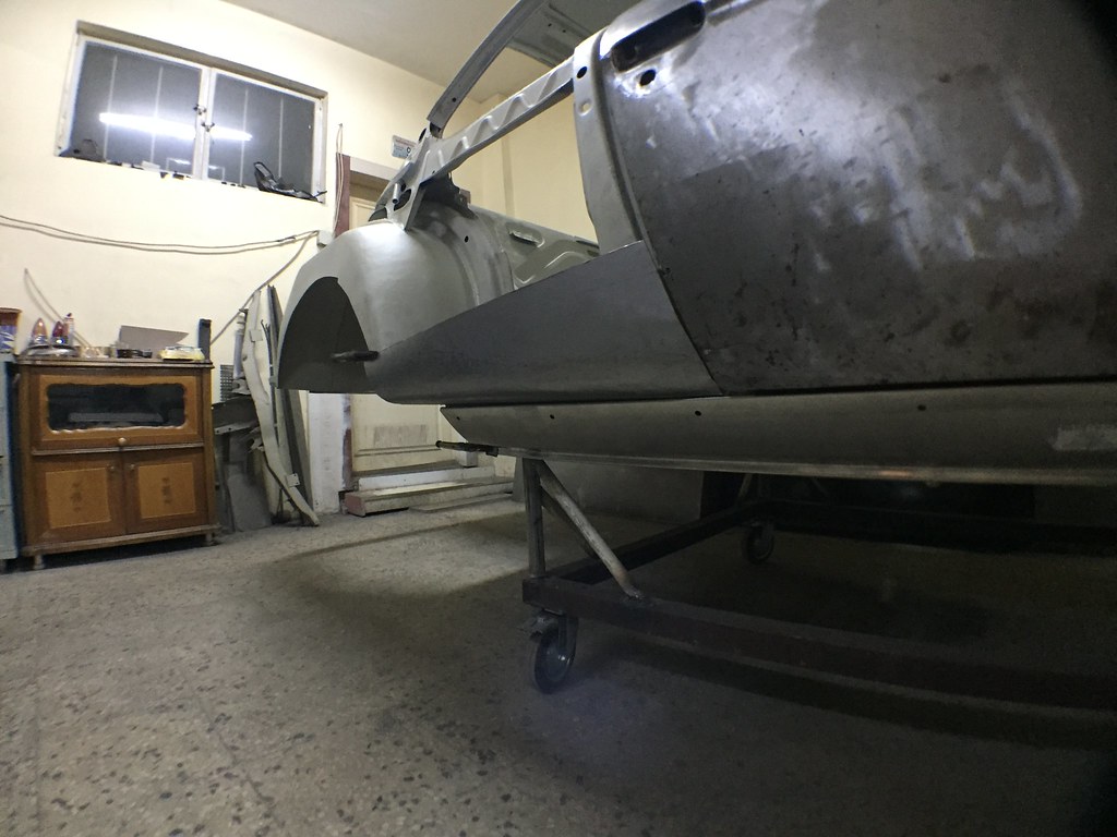

also I have a wide angle lens for my phone

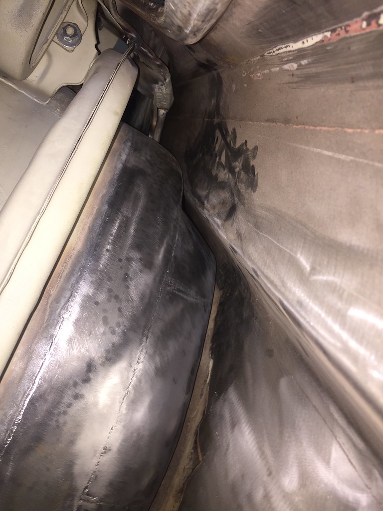

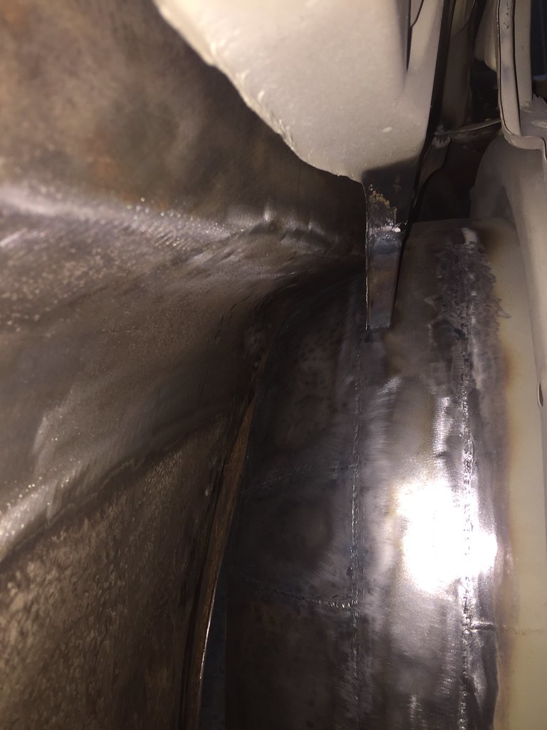

the reflections change according to the way the sander was used. picture doesn't do justice to how smooth that metal is.

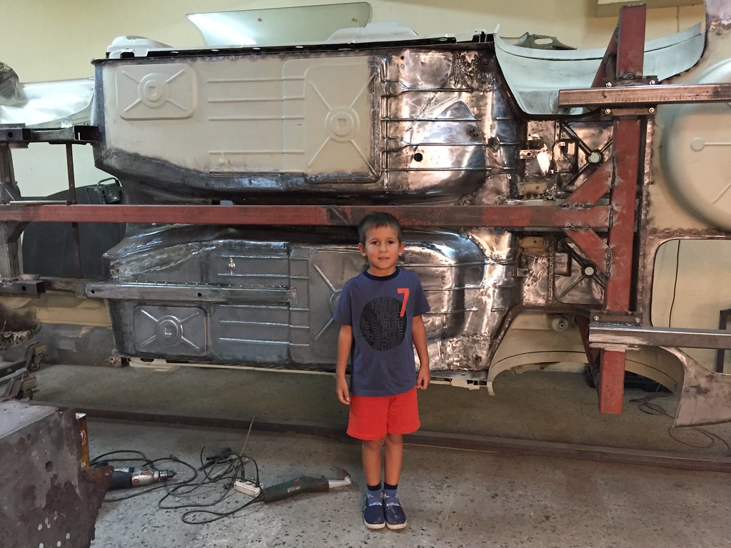

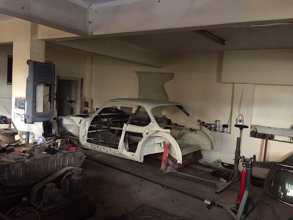

and here is the future owner of the car inspecting
awesome stuff!

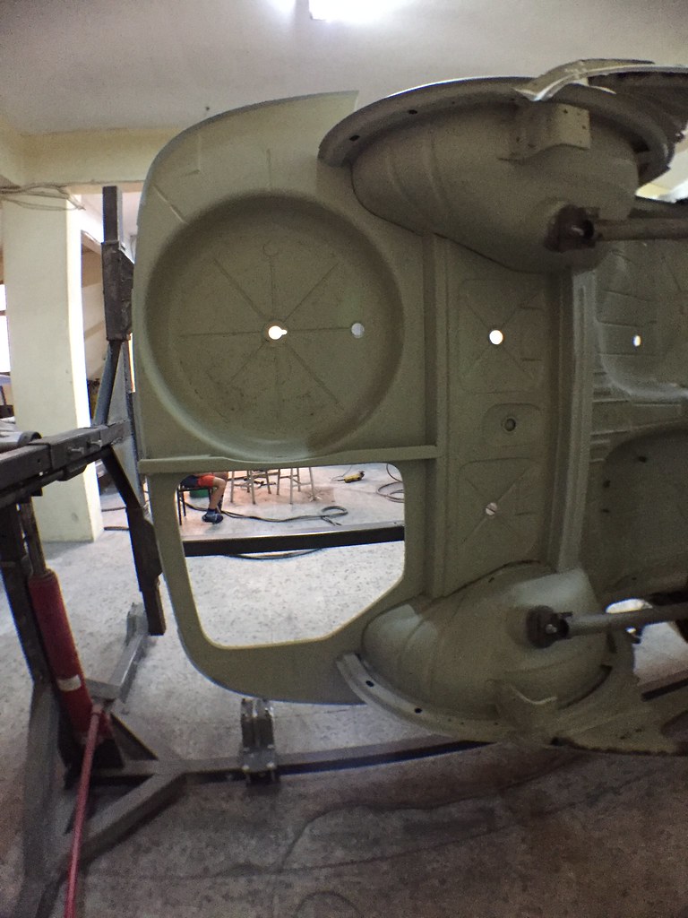

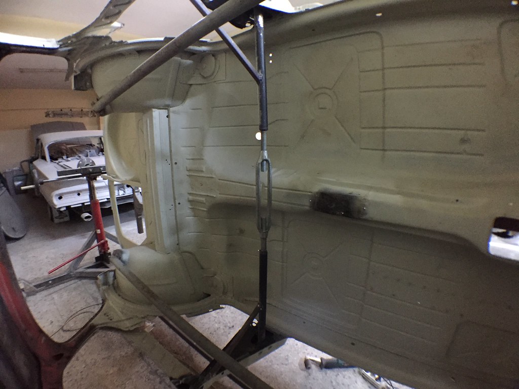

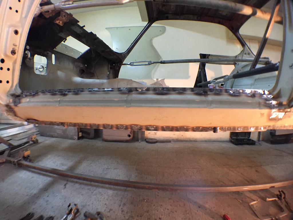

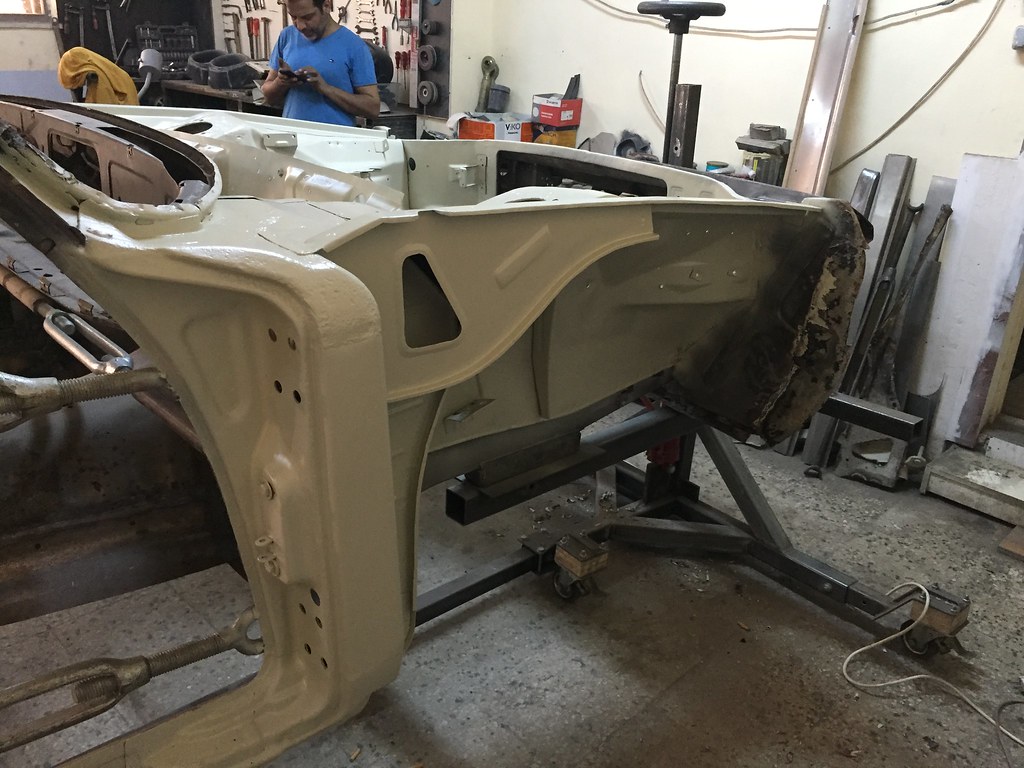

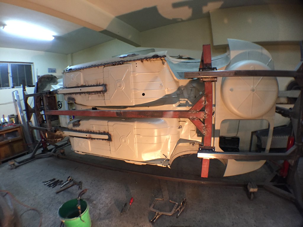

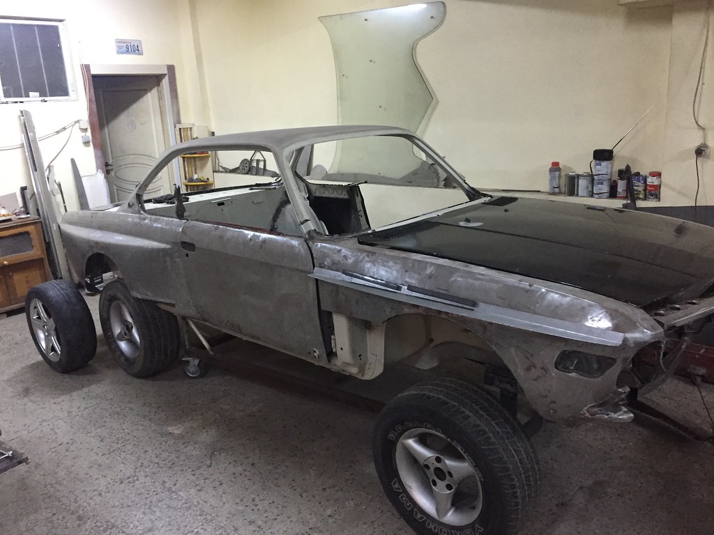

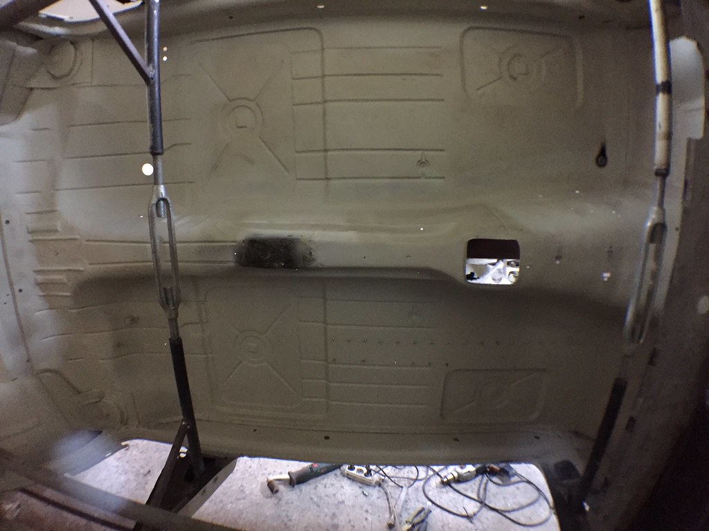

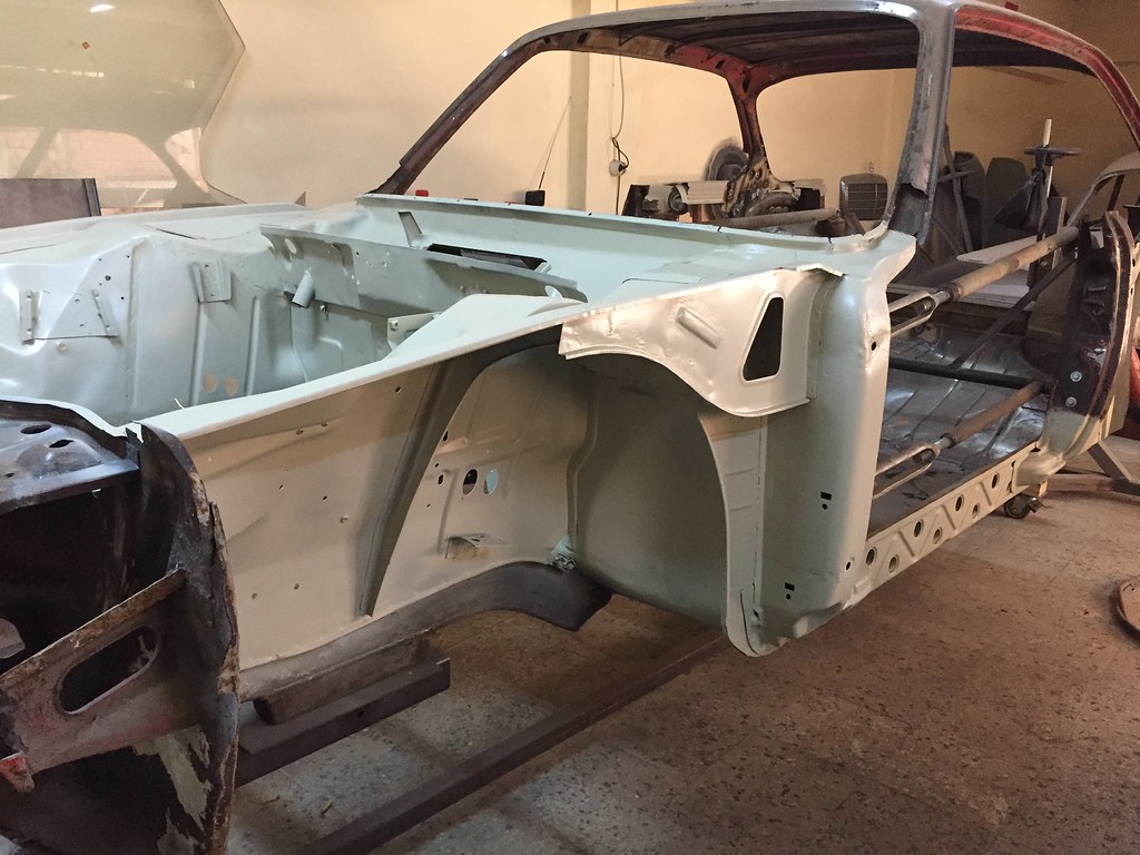

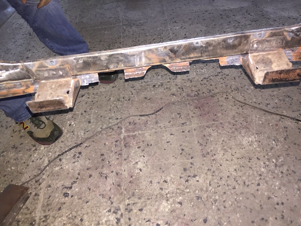

I've been thinking about hot to mount a rotisserie on an E9. Some do it w/o a long 4x4 down the middle underneath, some do it with like you.
Keep up the great work!
awesome stuff!
I think the piece down the middle helps keeping the car straight especially if you are going to remove all the strength from the sides while replacing the rockers.
by putting it in there you have the car just resting on the frame with out stress. or at least that's what I was aiming for. Still, the braces inside are also very important.
when we removed it all the sheet metal that we put back on was still fitting perfect.
cheers

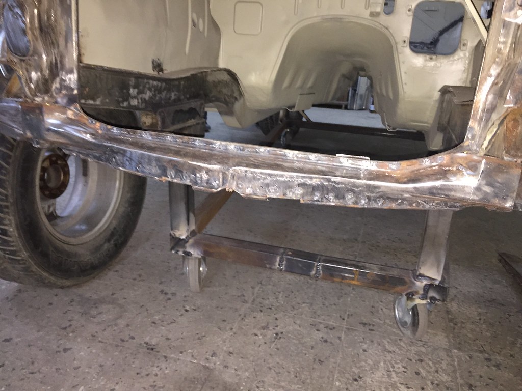

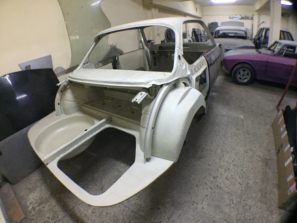

Granted I am no expert but I have never seen the flares made from metal.
Very nice workmanship!
Thanks Stan
the original flares were metal, so I am just restoring them the same way. This car never was a race car but just a crazy street car of a playboy.
it also has the built in bumper at the back which is not practical probably :)
