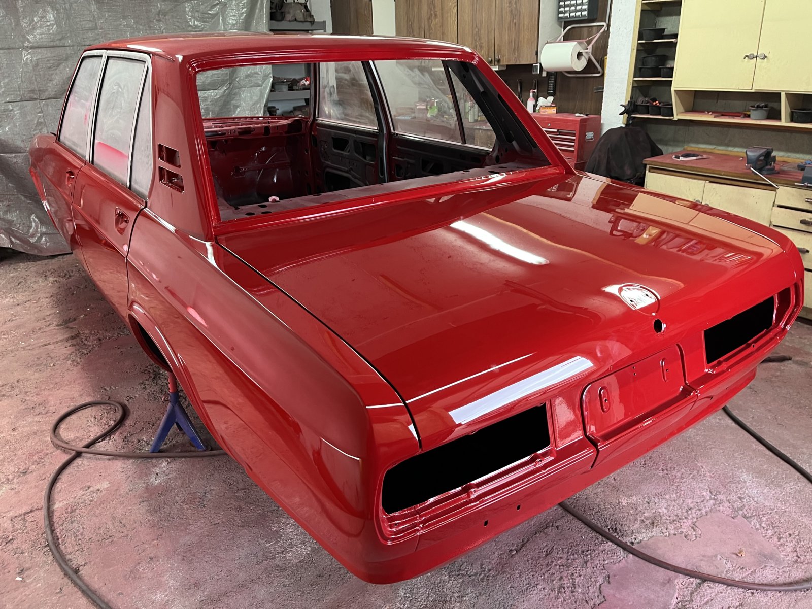

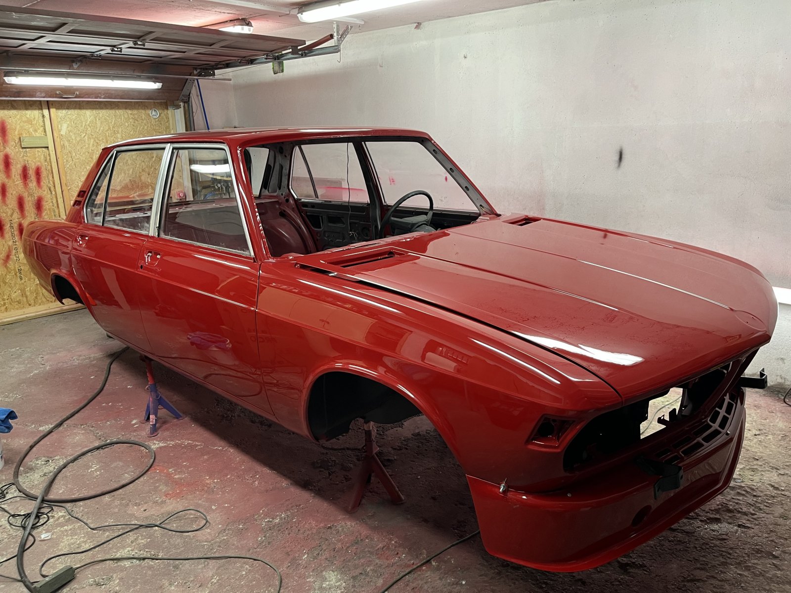

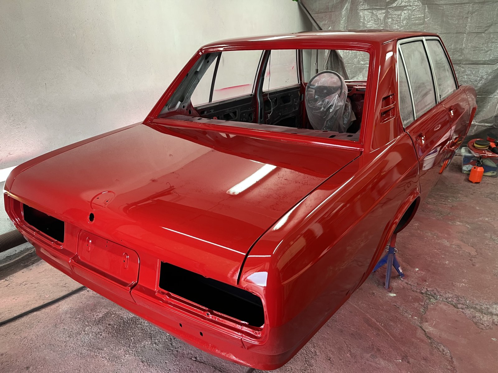

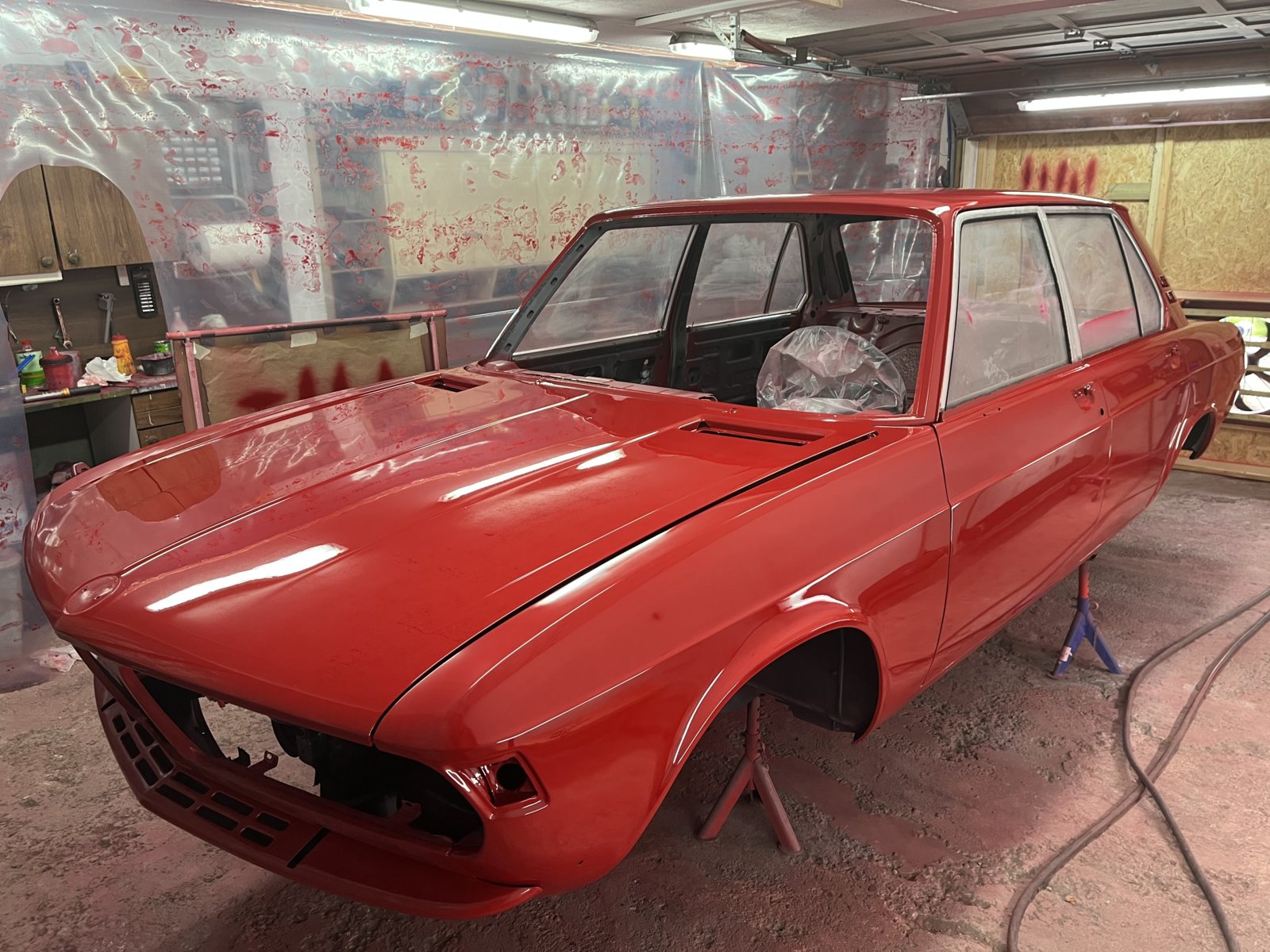

Slow progress. After cut and buff I decided to clear coat the whole car. The single stage paint kind of lost its glow. Now after cutting and buffing getting the clear coat, getting rid of some of the orange peel, the color has a much better shine to it. Not so easy to tell the difference in pictures, but in real life..

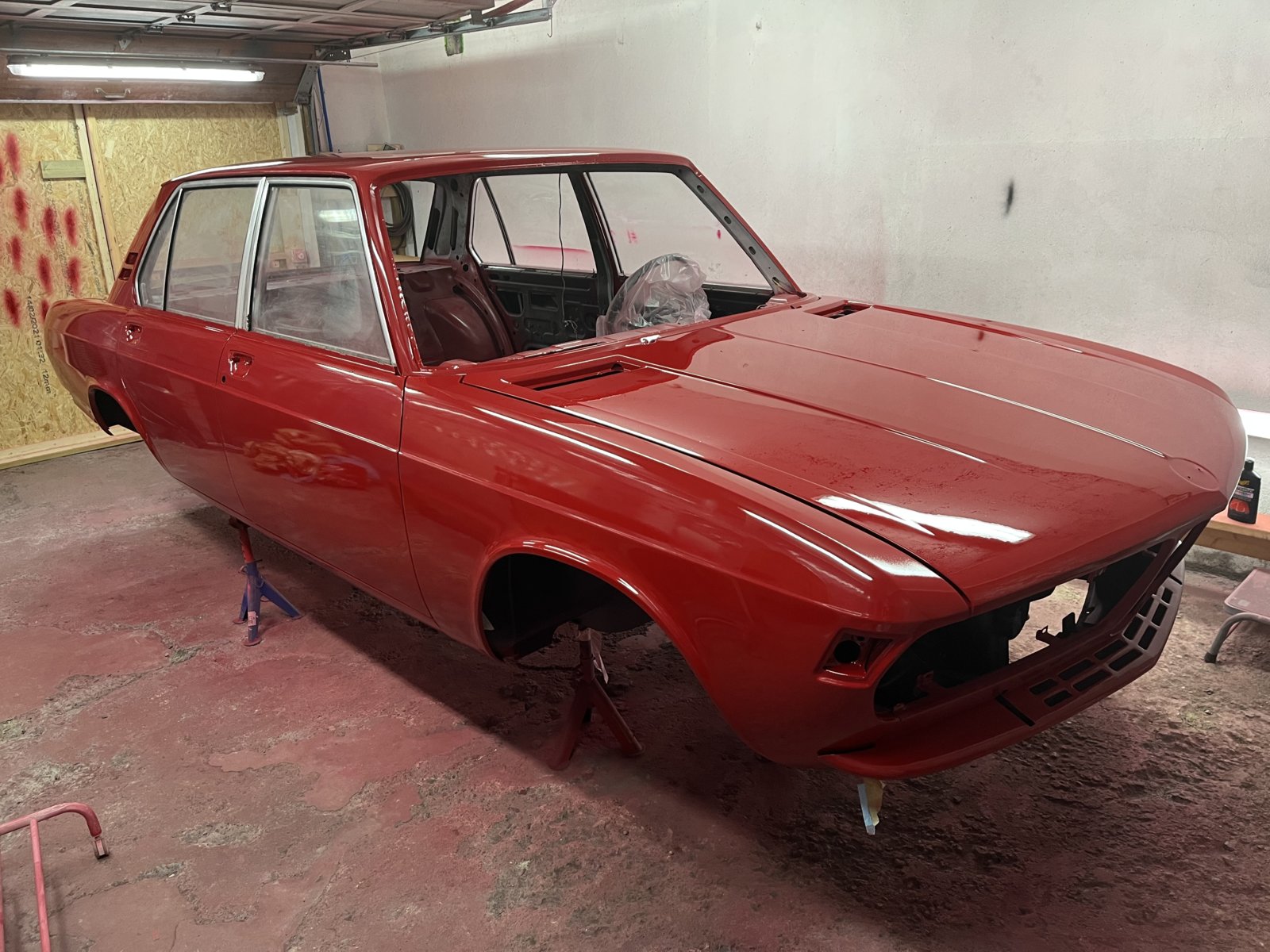

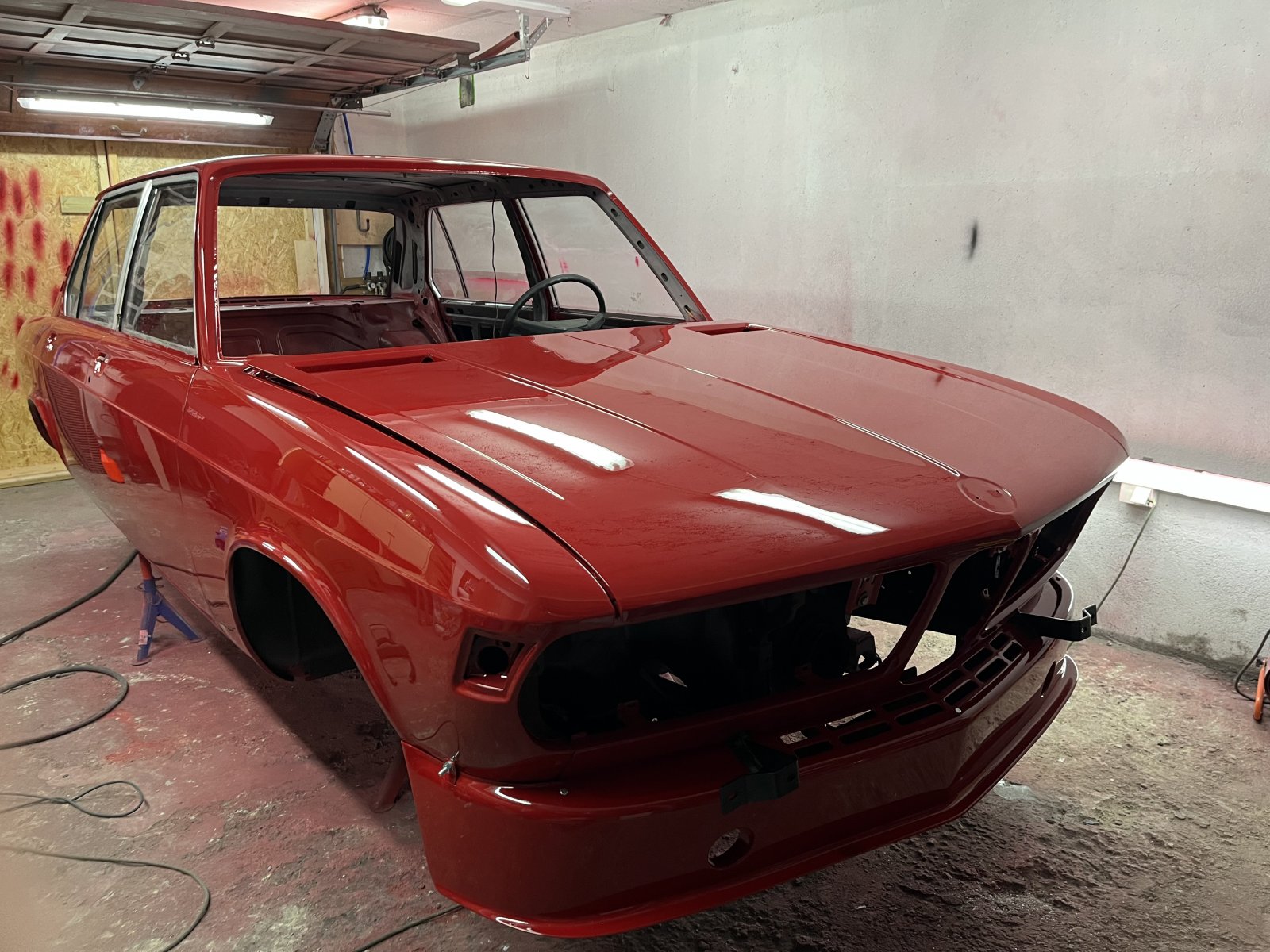

CSL air dam painted and fitted as well.
It's always a little disappointing to me when after you spray it on it looks REALLY shiny, but since I always have some dust in the paint and want to sand the orange peel down it never seems to get as shiny as it is untouched. I have a macro lens on my phone and have taken super close-up photos and there's always a little bit of scratching that never seems to go away.
Car looks great. Once you get it out in the sun it will really pop!

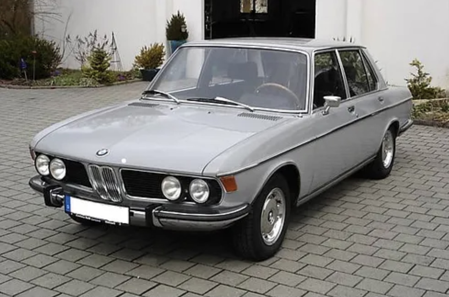

Yes that is an early 3.0 S in Bristol. That very car was for sale with this picture in the south of Germany some 15 years ago.
Exactly. I stored the pictures on my hard drive, then: 2009 May 5. We talked a lot about that car and everybody said: "Brilliant car, instant buy". But nobody of the E3 Club did. Since then, it has completely disappeared. No sign where it is now. It is a pity, an unmolested 3.0 S from early June 1971 in Bristol, Blue fabric interior. Sigh.
