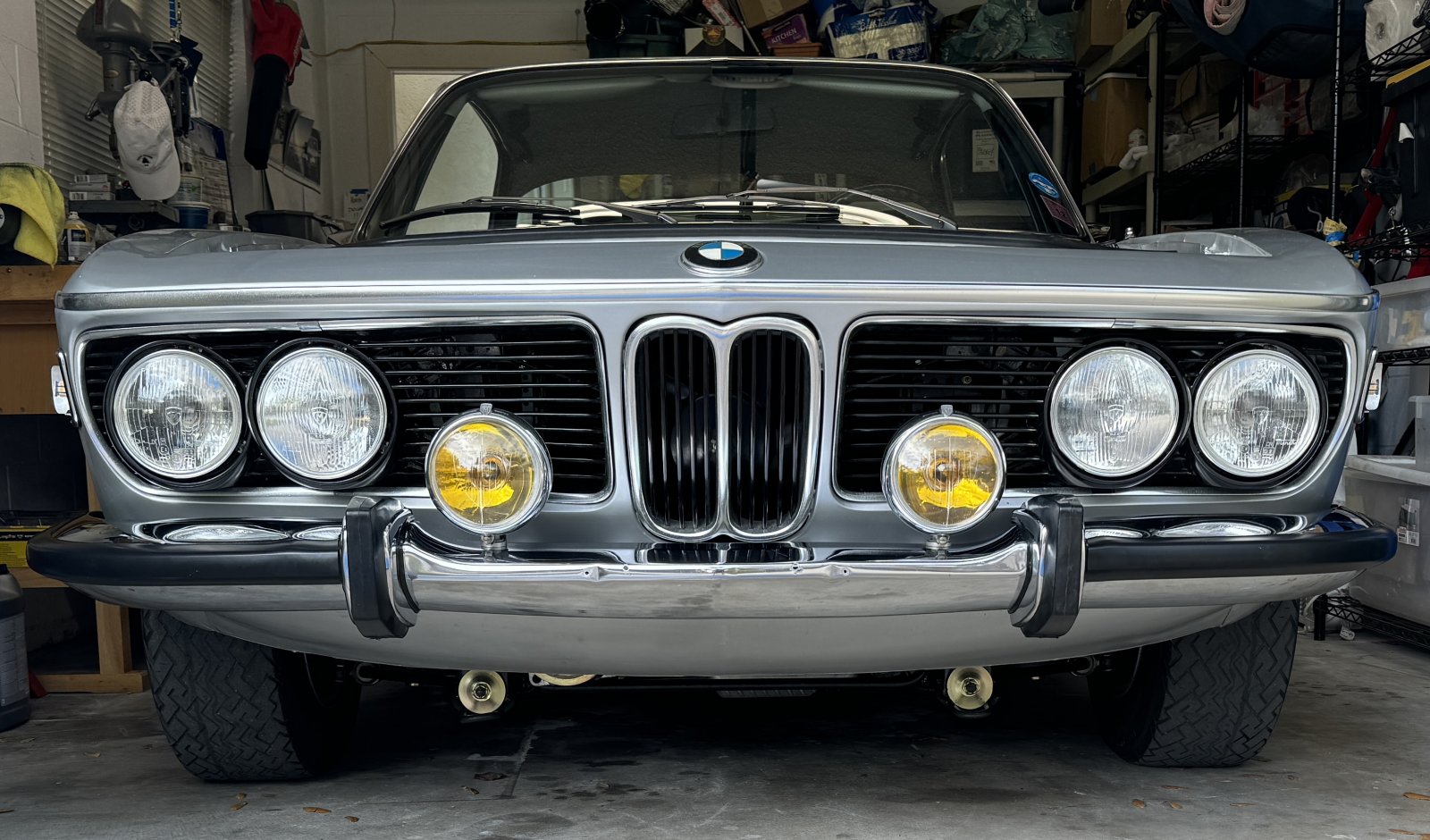

Bumper on, new rubber, headlights, grilles, and driving lights back on. Starting to look like a car again.

Front end looks awseome Steve!

The quality of the work you have done is amazing .
Well done !!!
Is it just me , but it seems a shame to have to hide it all with the hood .
It looks too nice as it is :)
