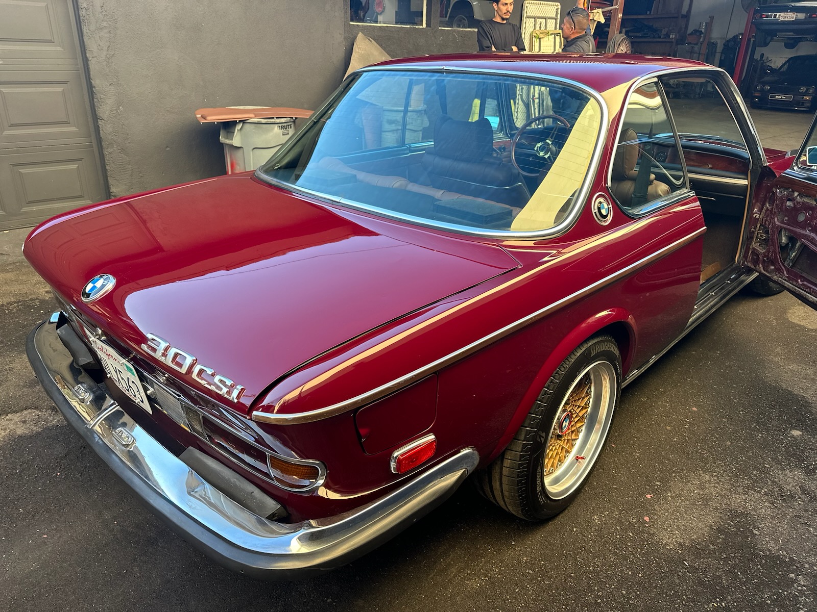

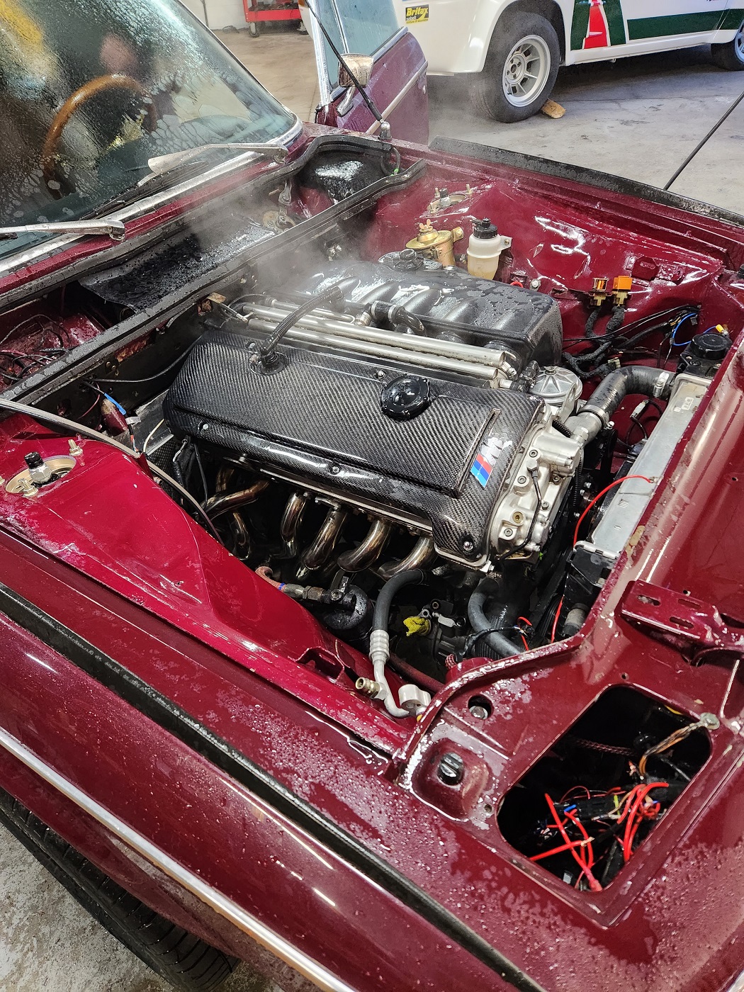

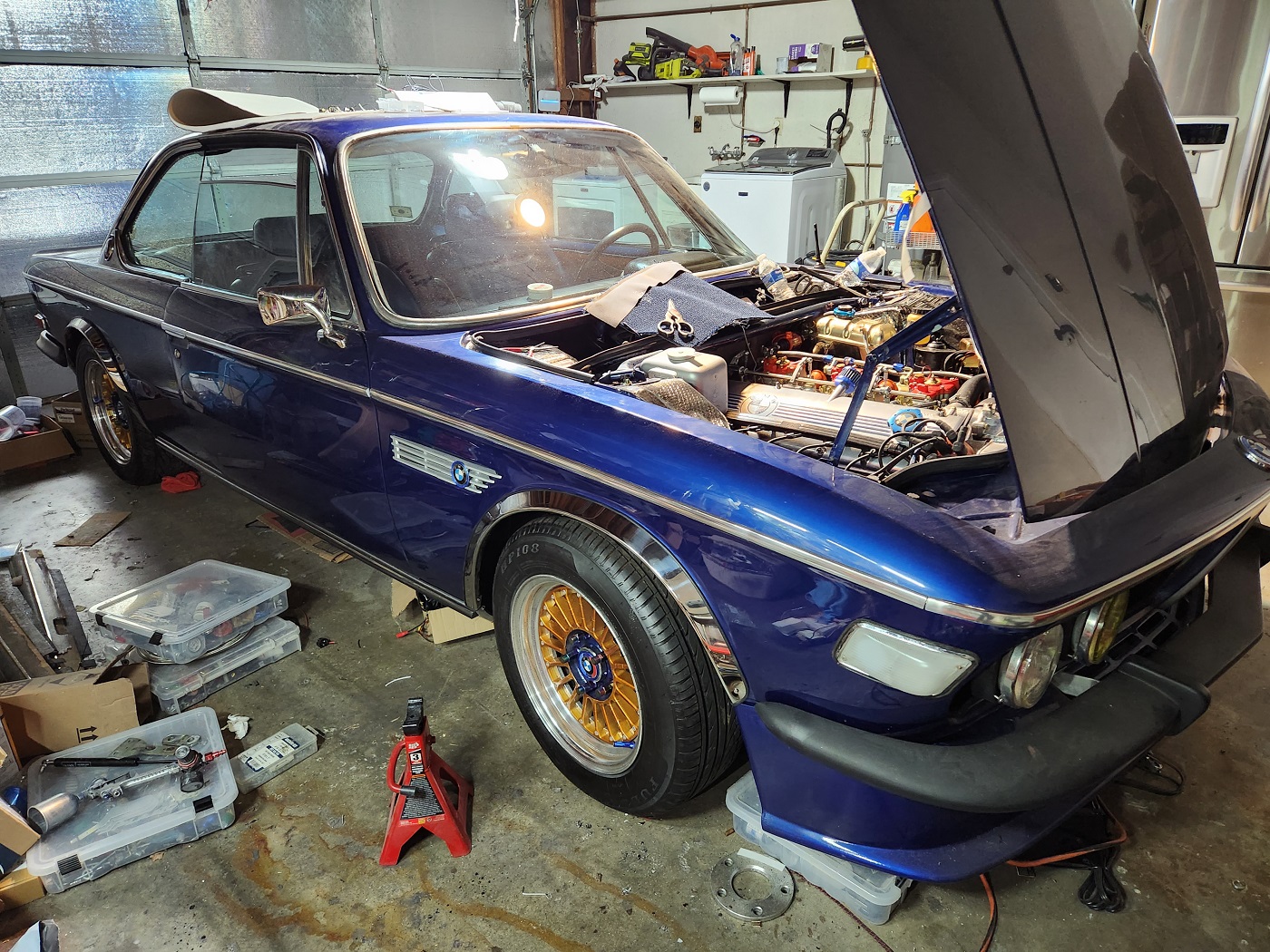

the Blue E9 on BAT is not mine this is what I have, the blue 2800 that I am working on it, in my garage and Malaga 3.0 that is completed.

Who is the seller? You posted a pic of that car here with your others.
Hi Chris, He is a friend and his name is Chris he is a professional retire driver he is very nice guy, he have many supper car but this is a only E9 that he have.

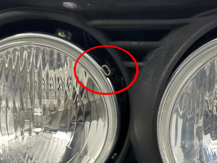

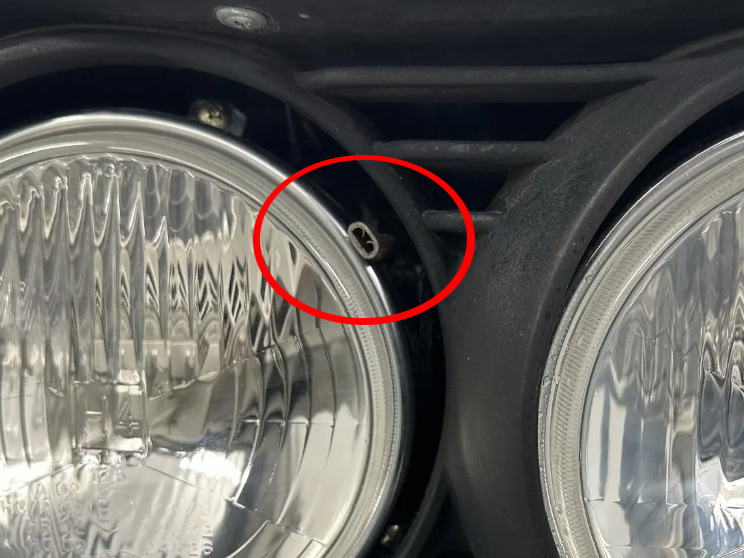

Most optimistically, it might be a terminal for a trickle charger. I once tried to route mine through the grill before deciding it was too much trouble.
I love your optimism, and I'd try to optimistically agree. But it would be on the other side then, nearer the battery.?. ;) Sorry, my glass is half empty on this one.
Yeah, I optimistically/indifferently didn't bother to check which set of headlights that was coming out of.
Then again, since the fuel lines are run on the wrong side of the car, maybe this is for a trickle charger. :D
That's way too small for a trickle charger...plus it would need a positive and negative that is separated somehow. Still can be one plug but that is not a trickle charger end. I'm 99.9% sure. That looks like a female Baomain end.

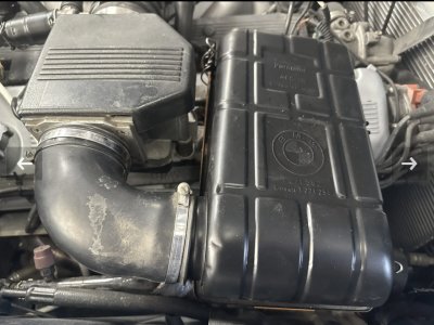

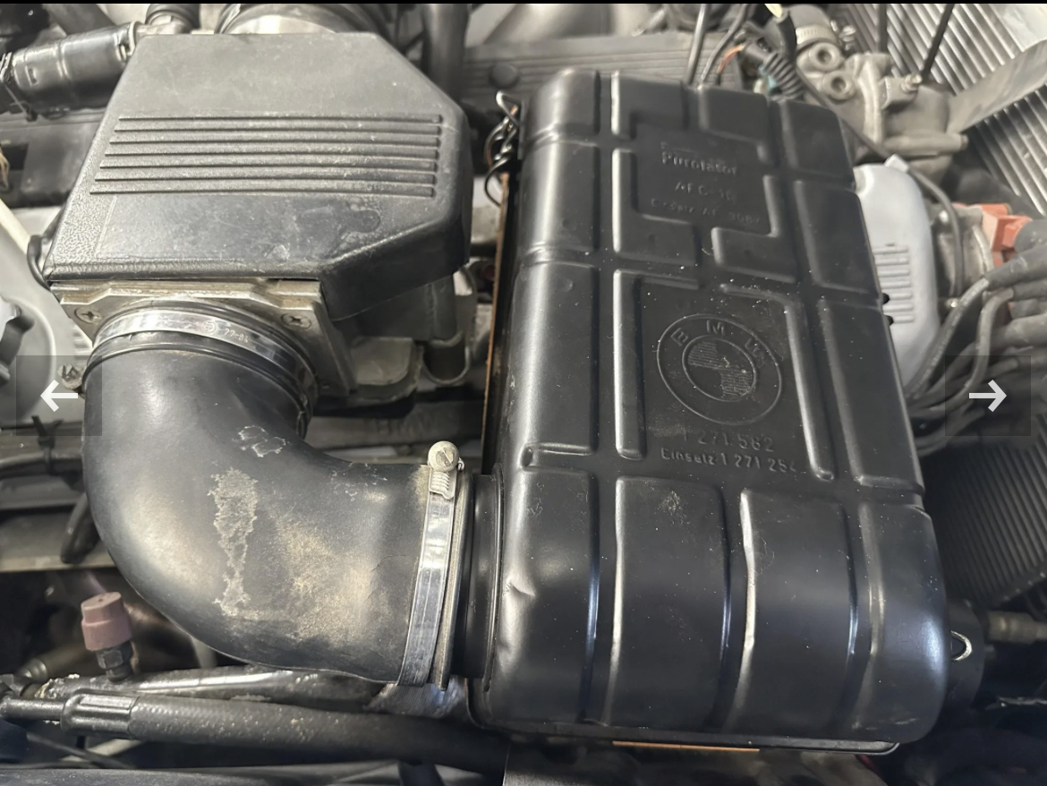

I guess they added an airbox. Tight shot doesn’t show how it’s mounted (likely isn’t). AFM attached to valve cover has the intake boot without the bellows so it should have the E24 B35 airbox to AFM elbow not the B32/B34 one (that’s one reason the box sits crooked). I can’t imagine it actually clears the hood either.
