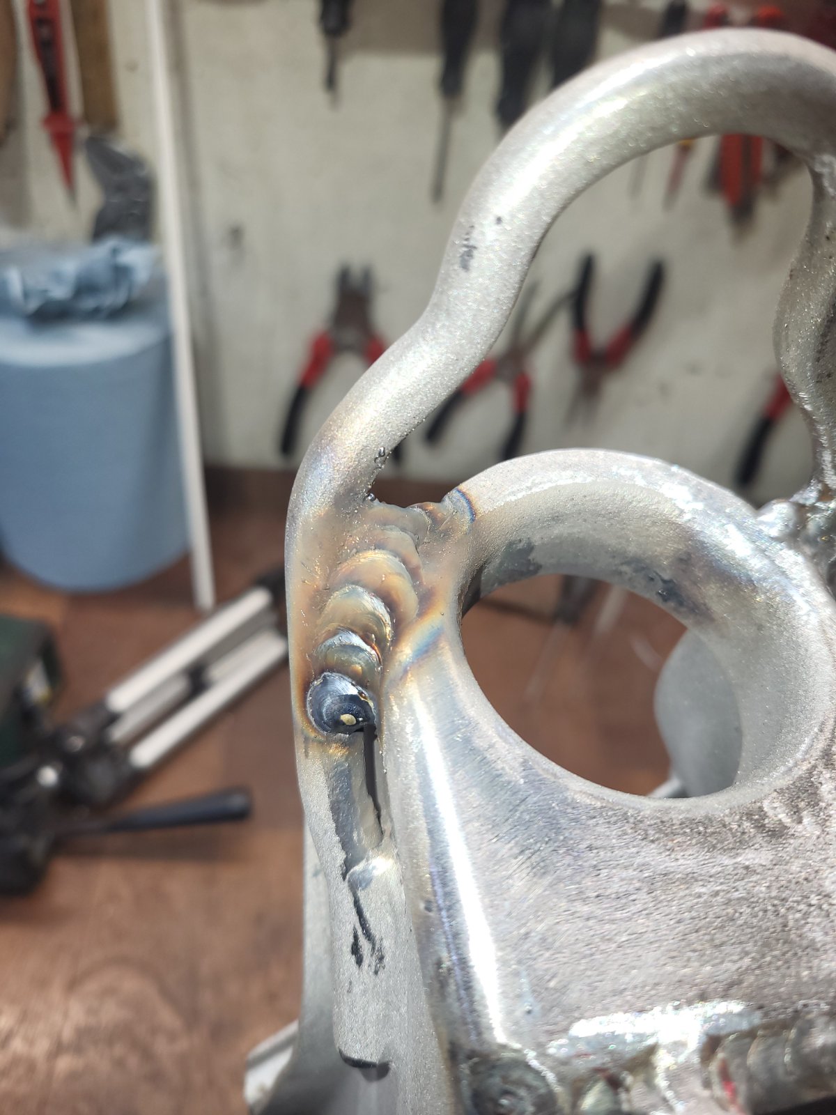

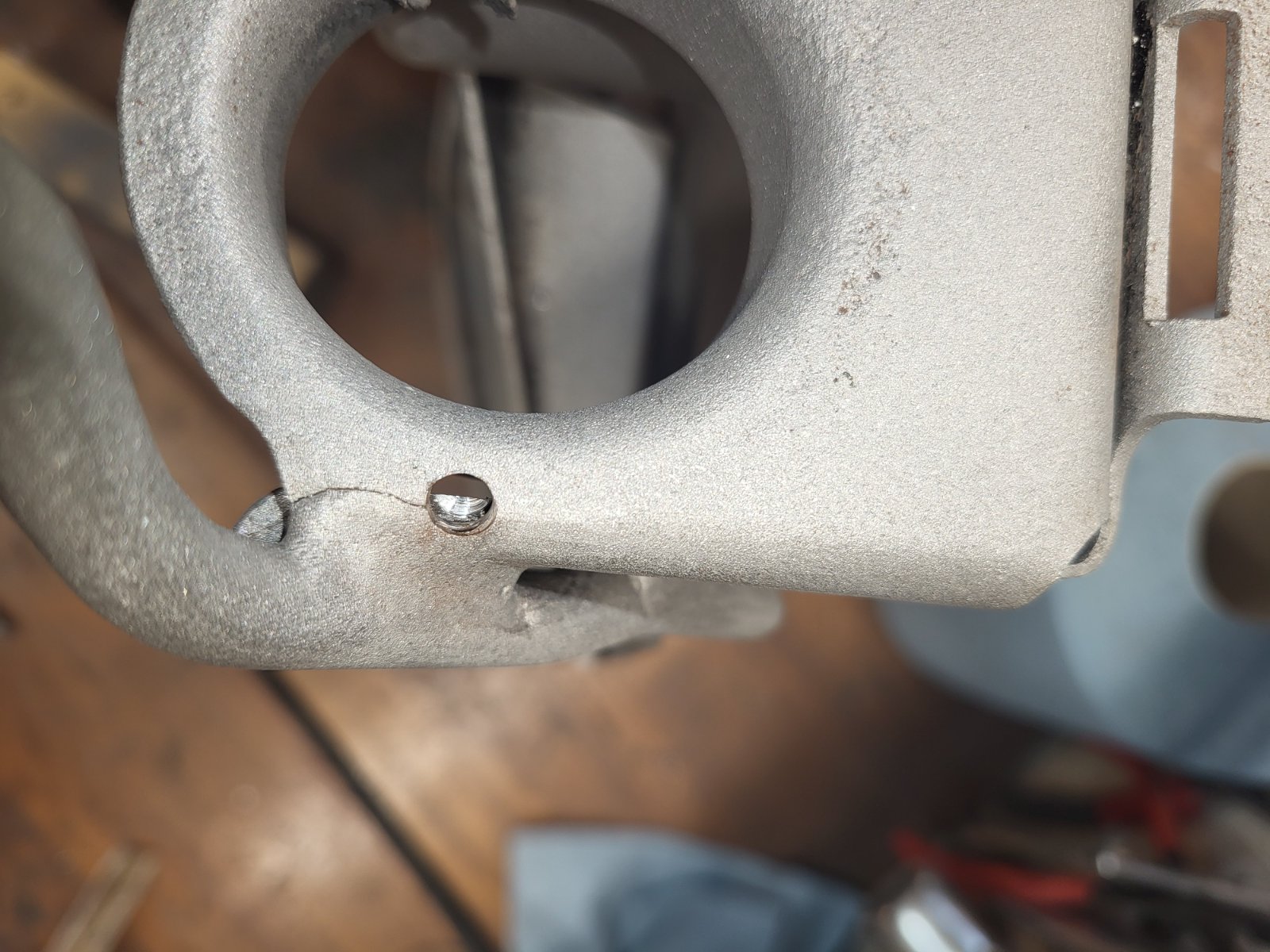

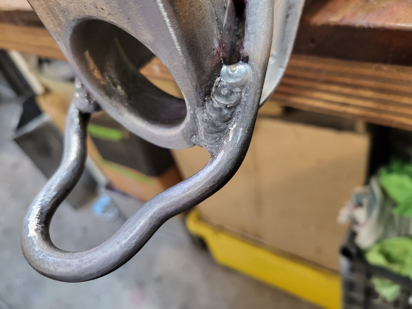

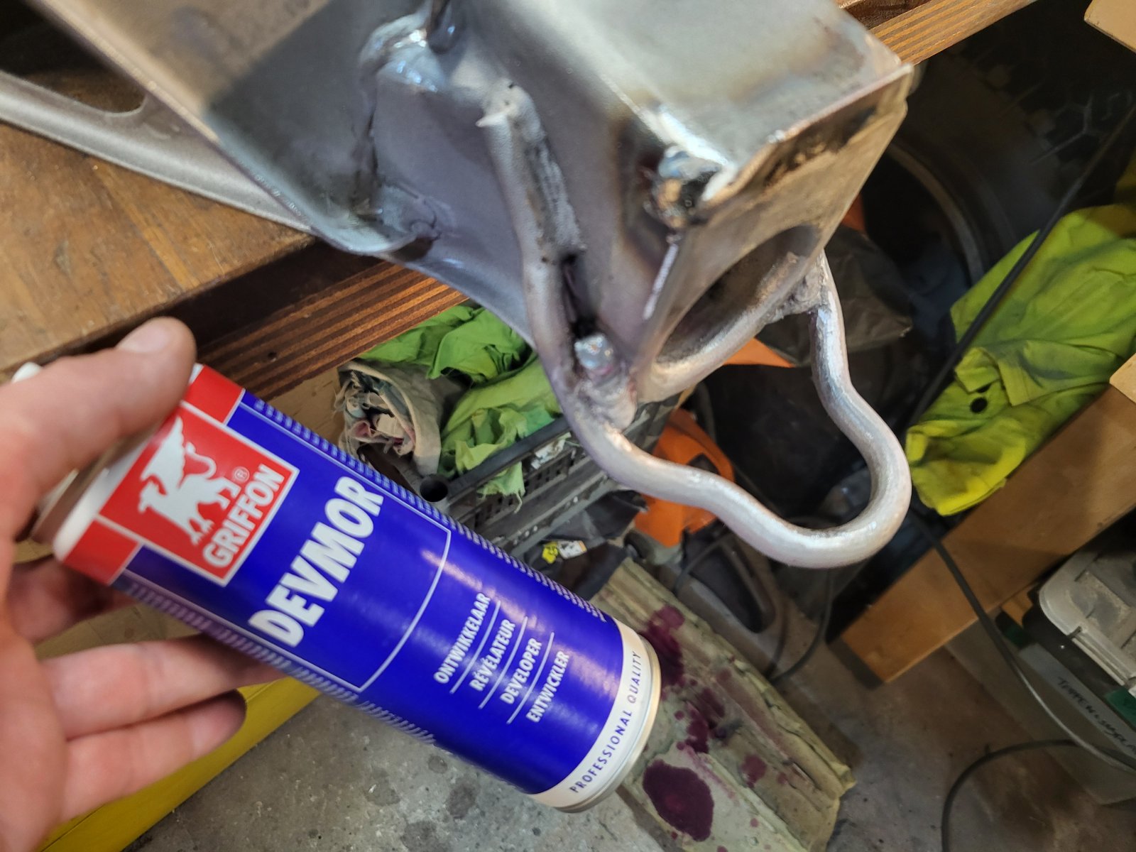

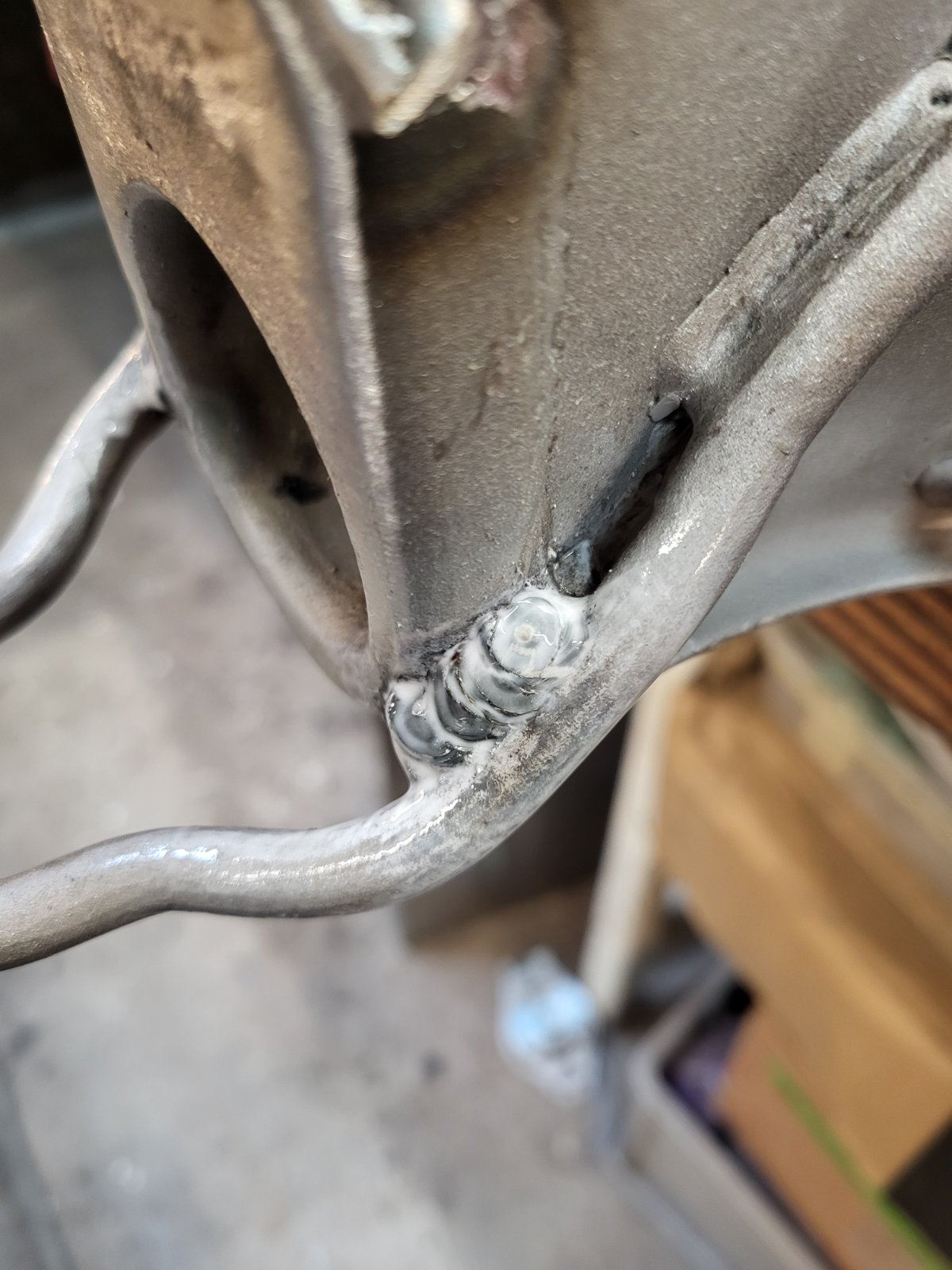

Then I also noticed cracks, the famous ones near the towhook, so I had it sandblasted to see if there were more. (None luckily!)
Drilled the end of the crack, grooved it, and welded them up. 20250901_221556.jpg20250903_132940.jpg

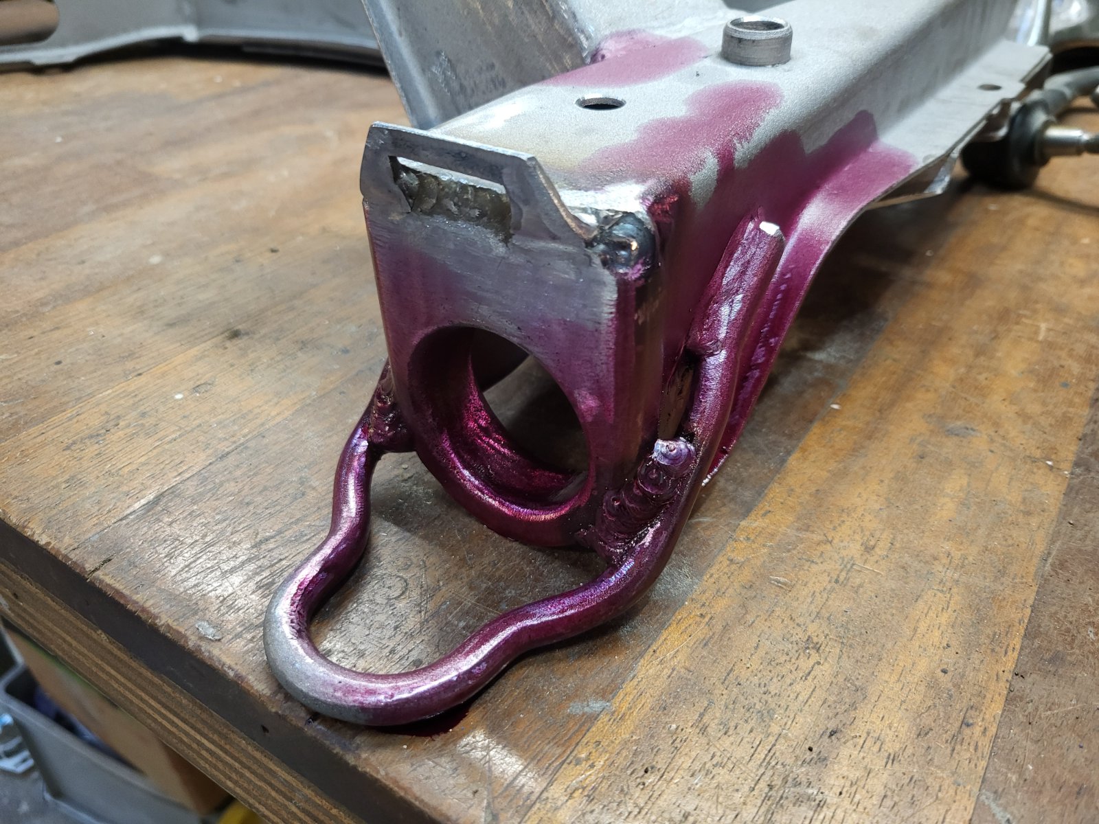

then checked with dye penetrant. My welds were good, but it's not easy to check as the dye just hides in the 1000 corners, dimples and ridges that are on and around the welds. Rest of the frame checked out fine.

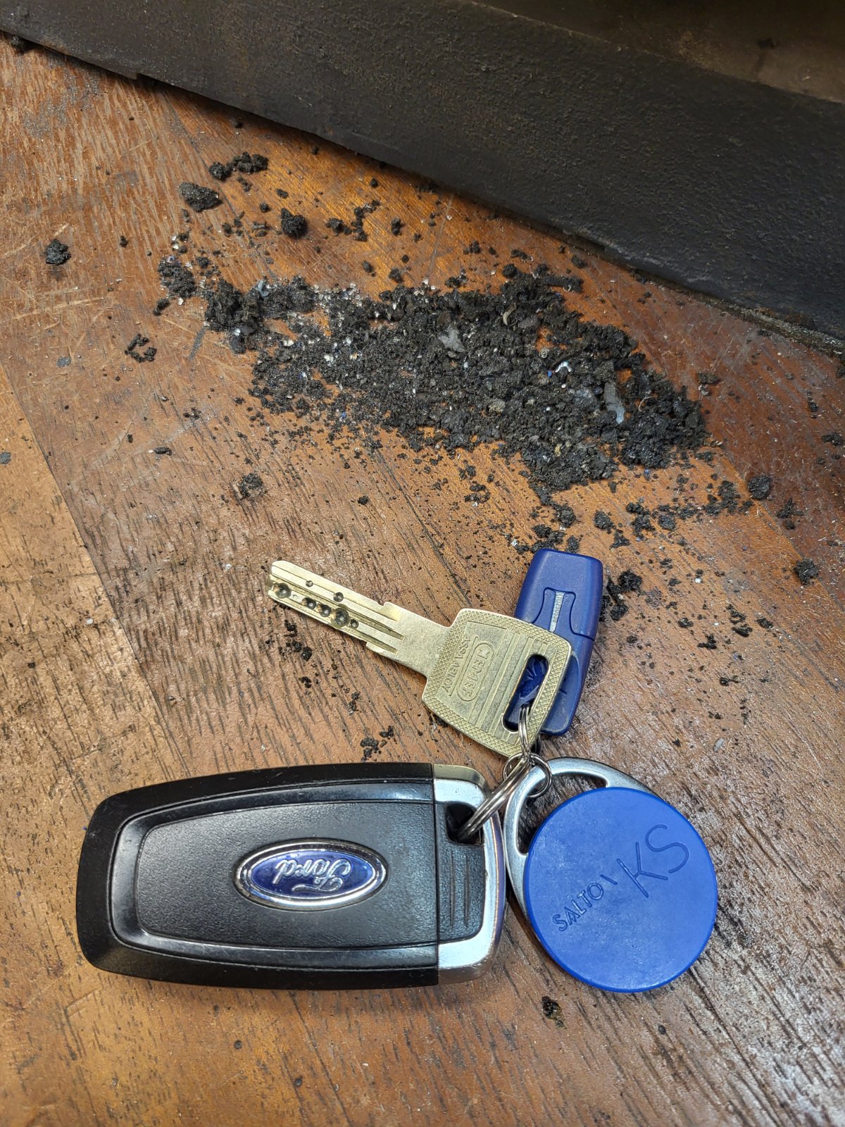

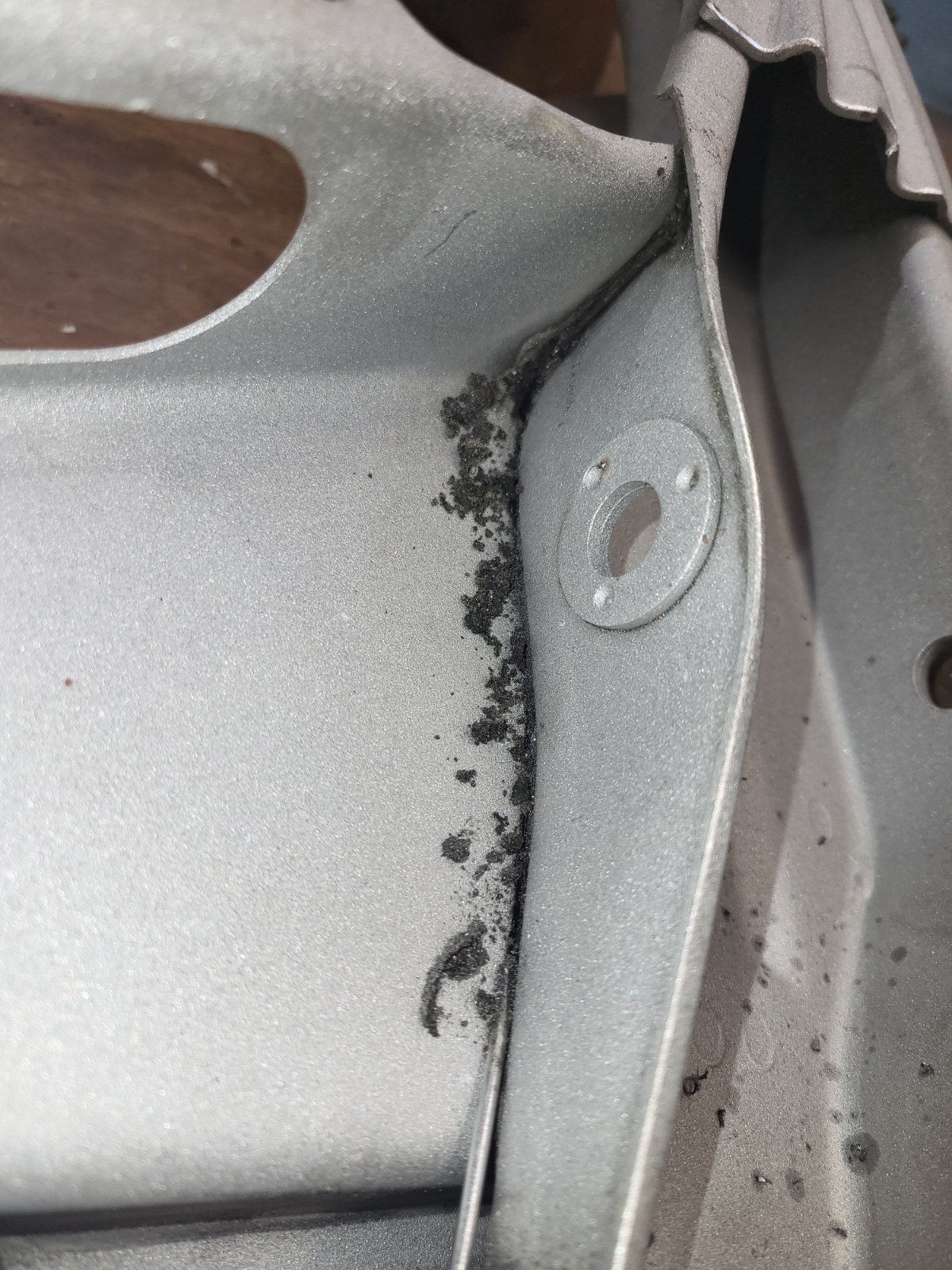

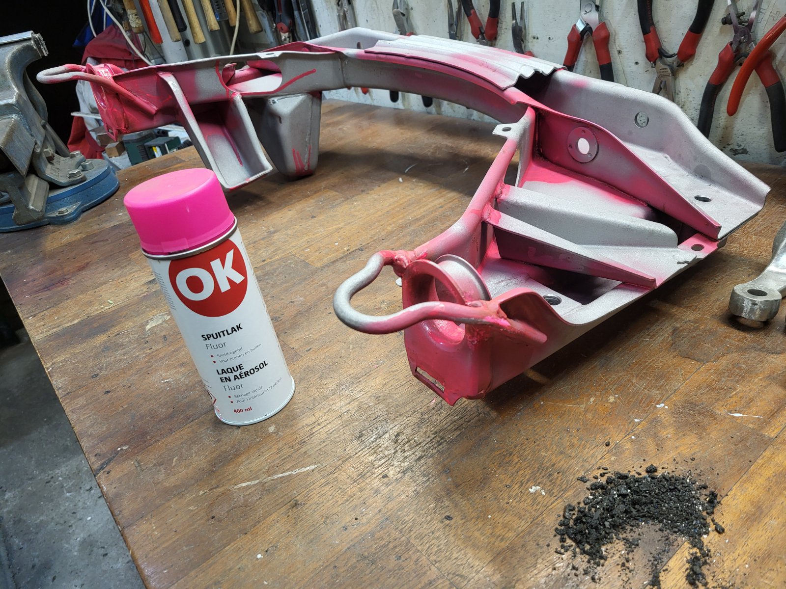

But what a sh*t job did my new sandblast shop do! I was hoping it would be clean enough to send it out for rustpreventative coating, but still a cup full of grease and sand and stones were stuck in corners. 20250905_203929.jpg20250903_151306.jpg
I'm sending it back for a rerun, let's see if the sandblasting shop gets the PINK clue...

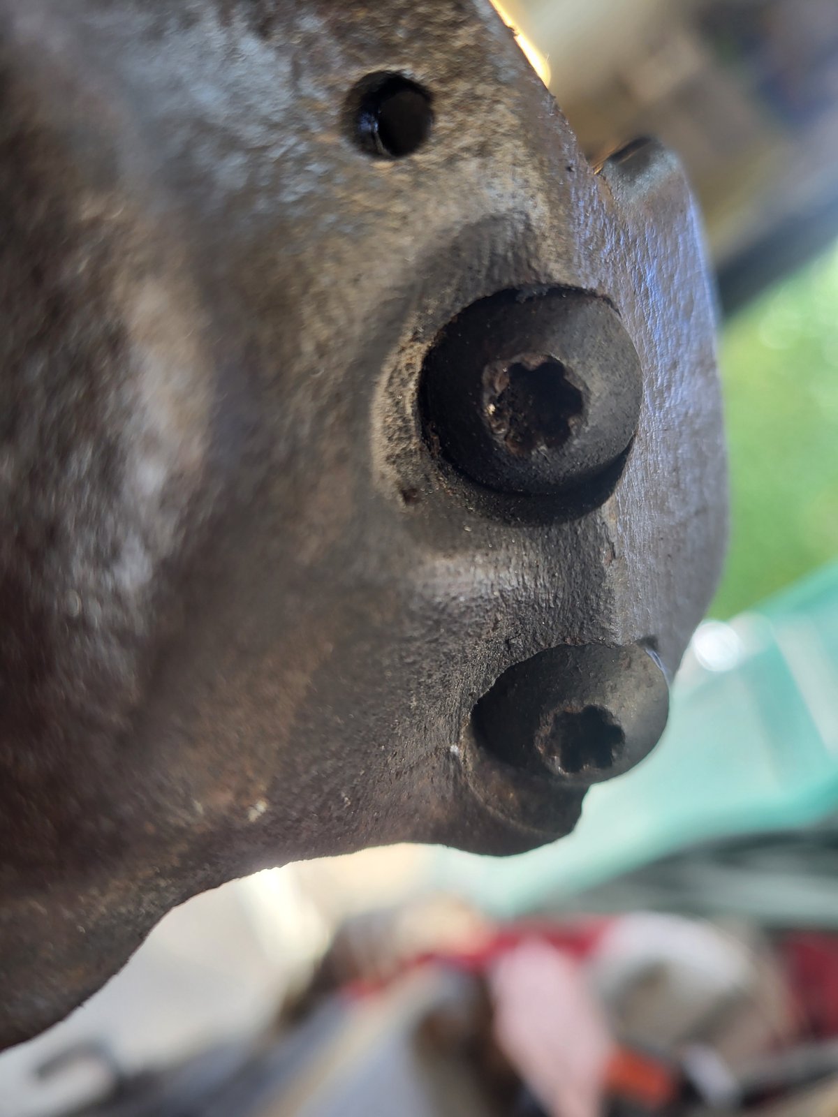

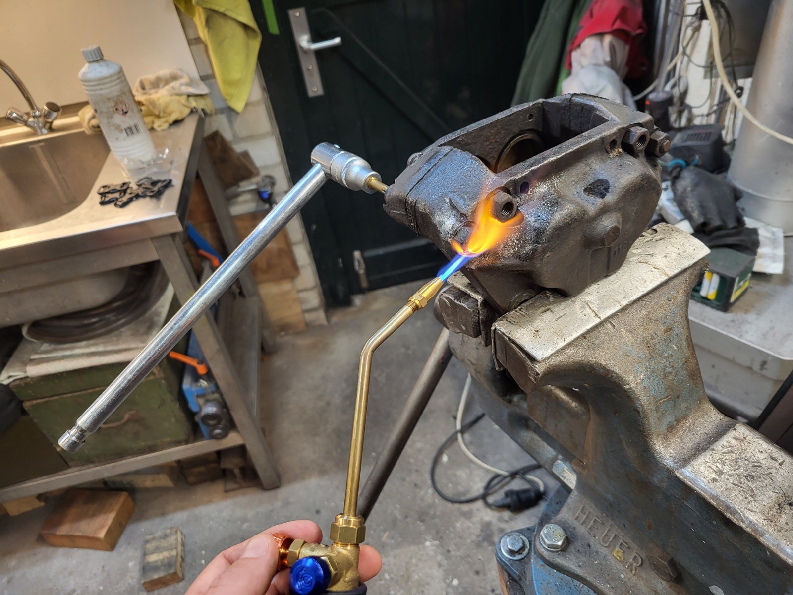

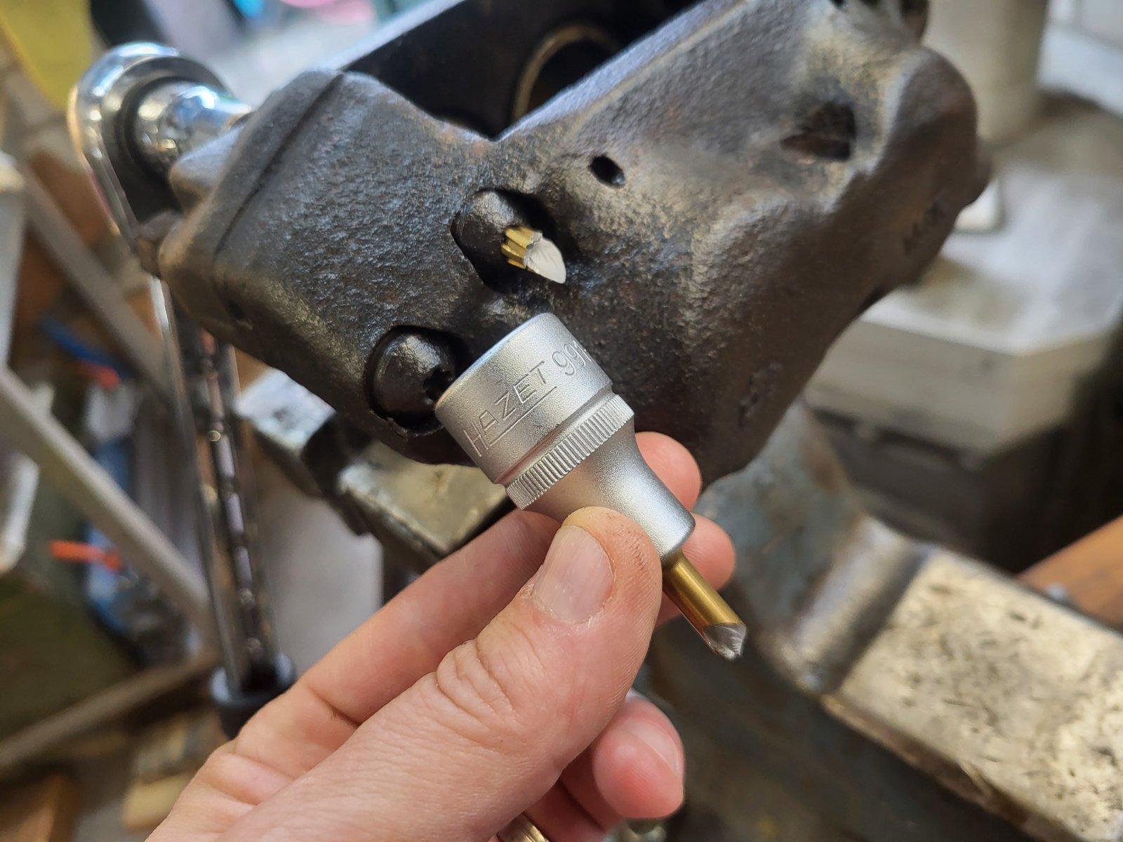

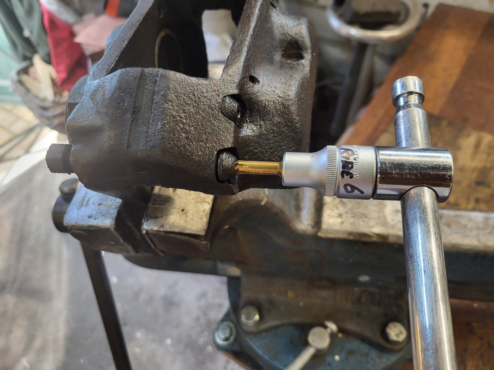

Ordered the correct Ribe bits for the front calipers, it's size 6 by the way.

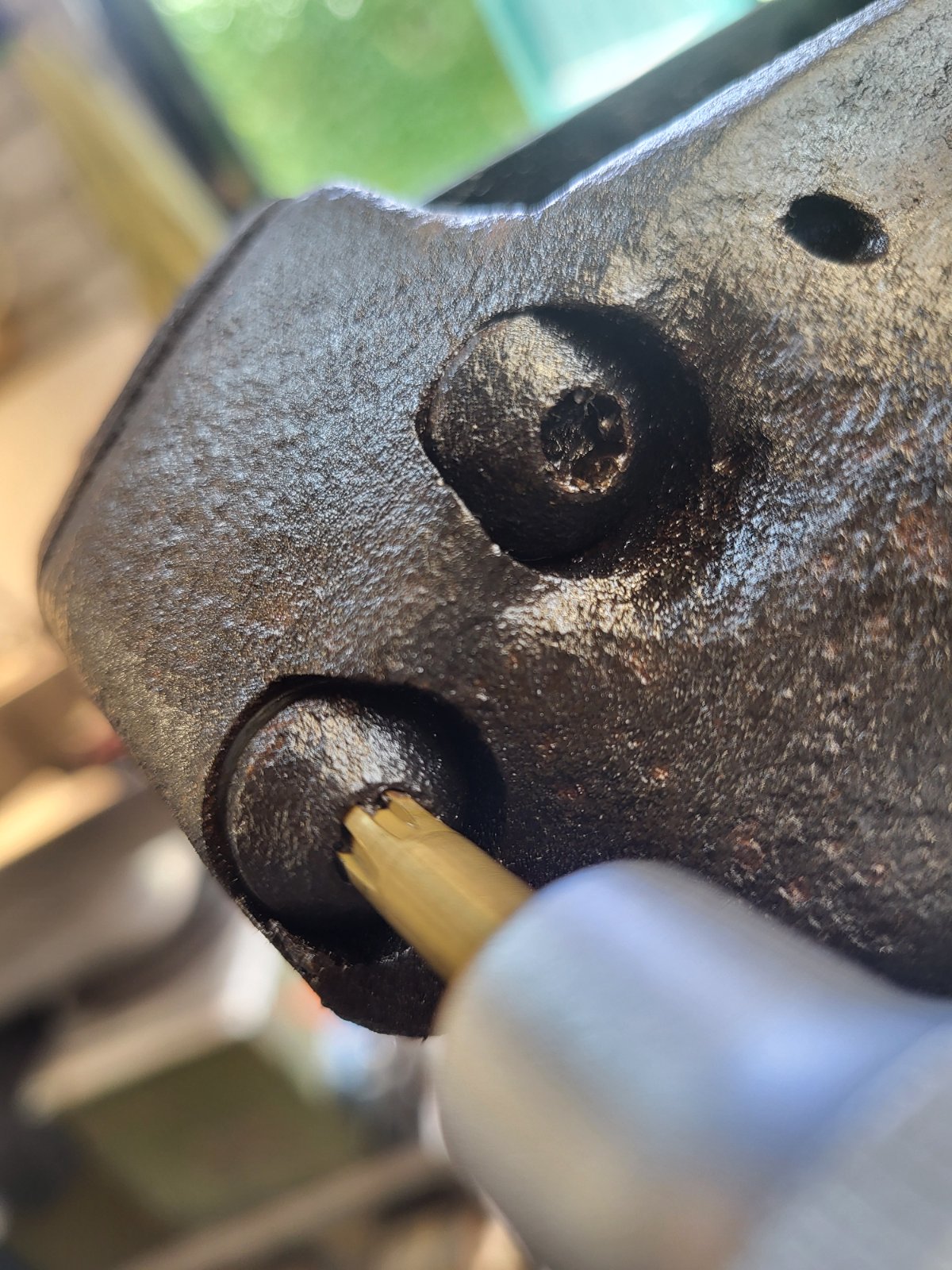

Choosen an A brand (Hazet, like snap-on), and gave it a go. It lasted one bolt, and snapped at the other.
I greased them up a day before, hit them with a low temp butane gas burner, got the bolt+nut spinning (still fused together) in the caliper, but still it wasn't enough to get the nut to spin off the bolt.
Buy a new one, perhaps 2 at the same time and try again?

At least the fastener did not get damaged. Maybe a touch more heat next time such that the expansion can break it free. Watching with interest!
I'm doubting if I can re-use the nuts (and bolts perhaps as well) after heating them up. In uni they tought me that heating them change their special molecular cristal-like structure that made them a high grade bolt (class in US terms). Heating them just degrades them to mild steel.
It will get them off all right, but i can't re-use em. Meaning I'd be forced to switch to allen head bolts from Walloth. Which is non-original.... but then again , it's a safety item; i should not be so stubborn
If you dont think you can re-use the fasteners, break out the welder and weld a nut to them. The heat sink will likely break them free and give you a strong surface to put a wrench on.
Well, they did let go this time. I invested in an Oxy Acetelyne burner that reaches 3300 Celsius - enough to get them nicely cherry red. Plus a new Hazet RIBE -6 bit drive.
250 euro's worth of equipment for 8 bolts... And they just popped off.
Now I just have to think about the re-use question.

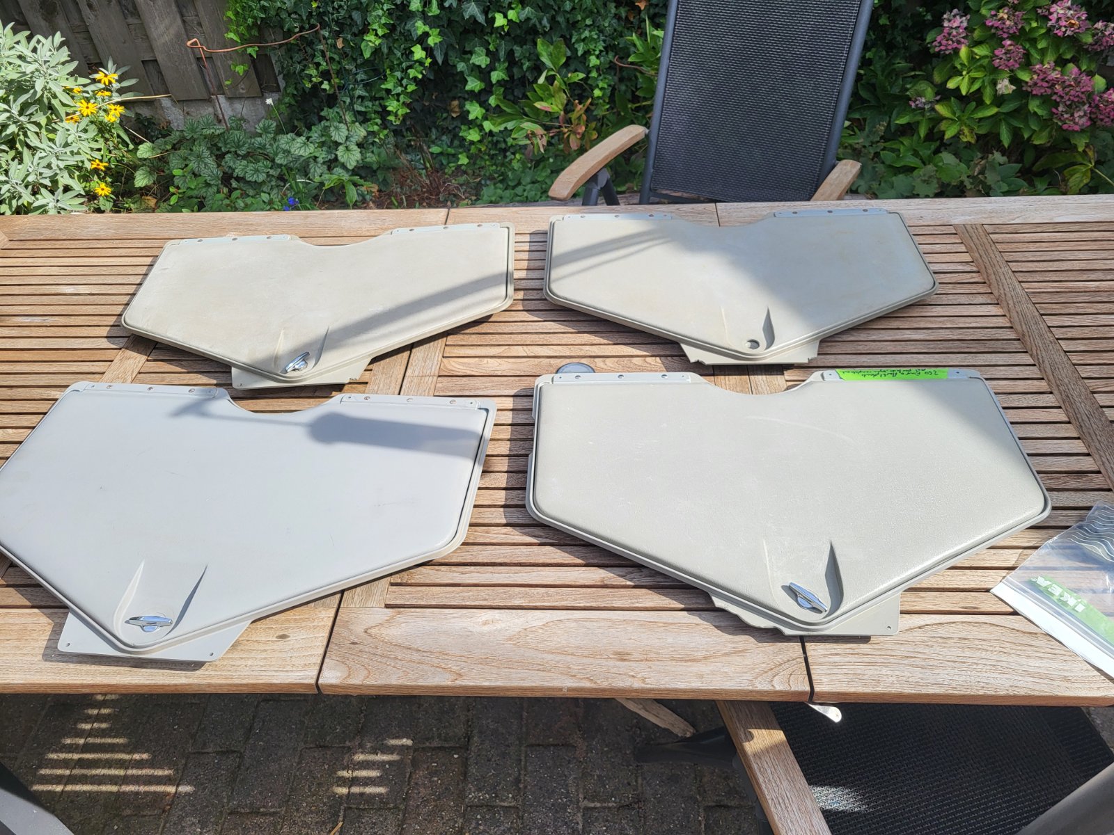

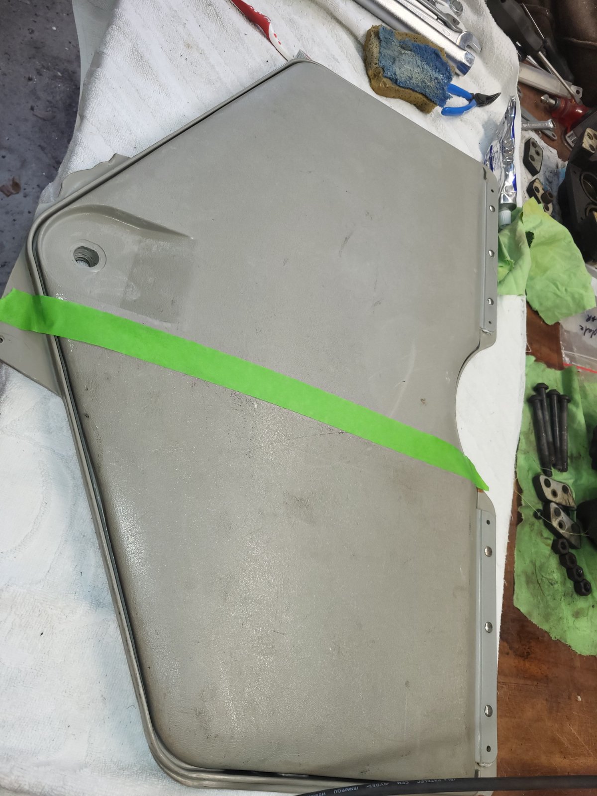

While waiting for some front axle parts to be refinished, I took it up to see what I could do with the 4 toolboxes I have collected over the years.
Goal is to make a good one, hopefully perfect for my own car. Keep one as a spare.
Then to make room, and pay for my upcoming motor revision, fix up another good 2 to sel with a near complete tool set.

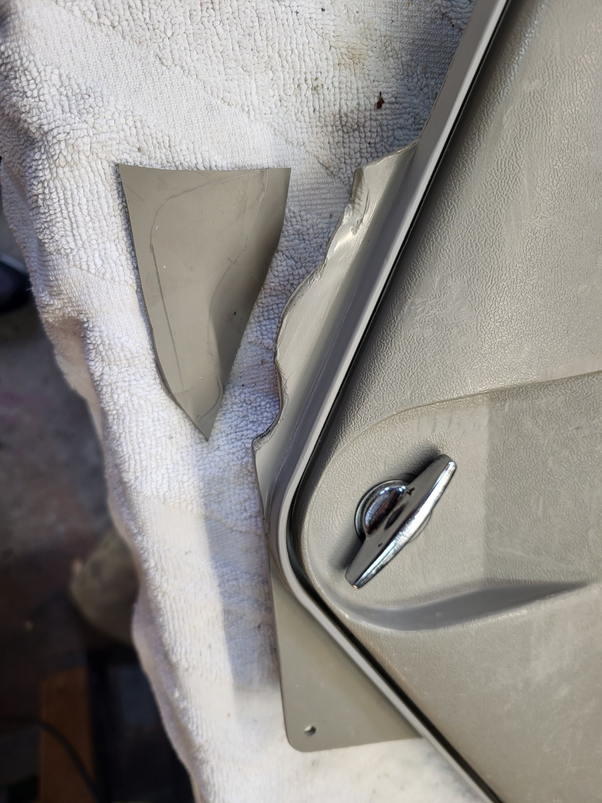

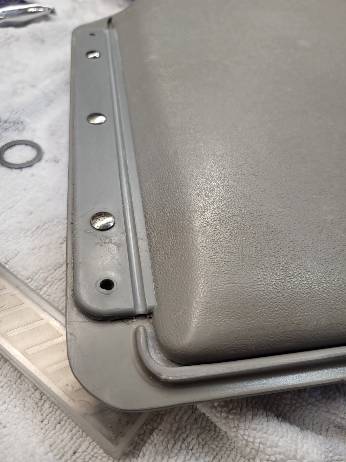

So I started out with the toolbox that I recently bought. It had a few ears snaped off where the screws mount, quite common, but interestingly enough the rivets and hinges are still shiny; not (partially) rusted as they are on the other 3.

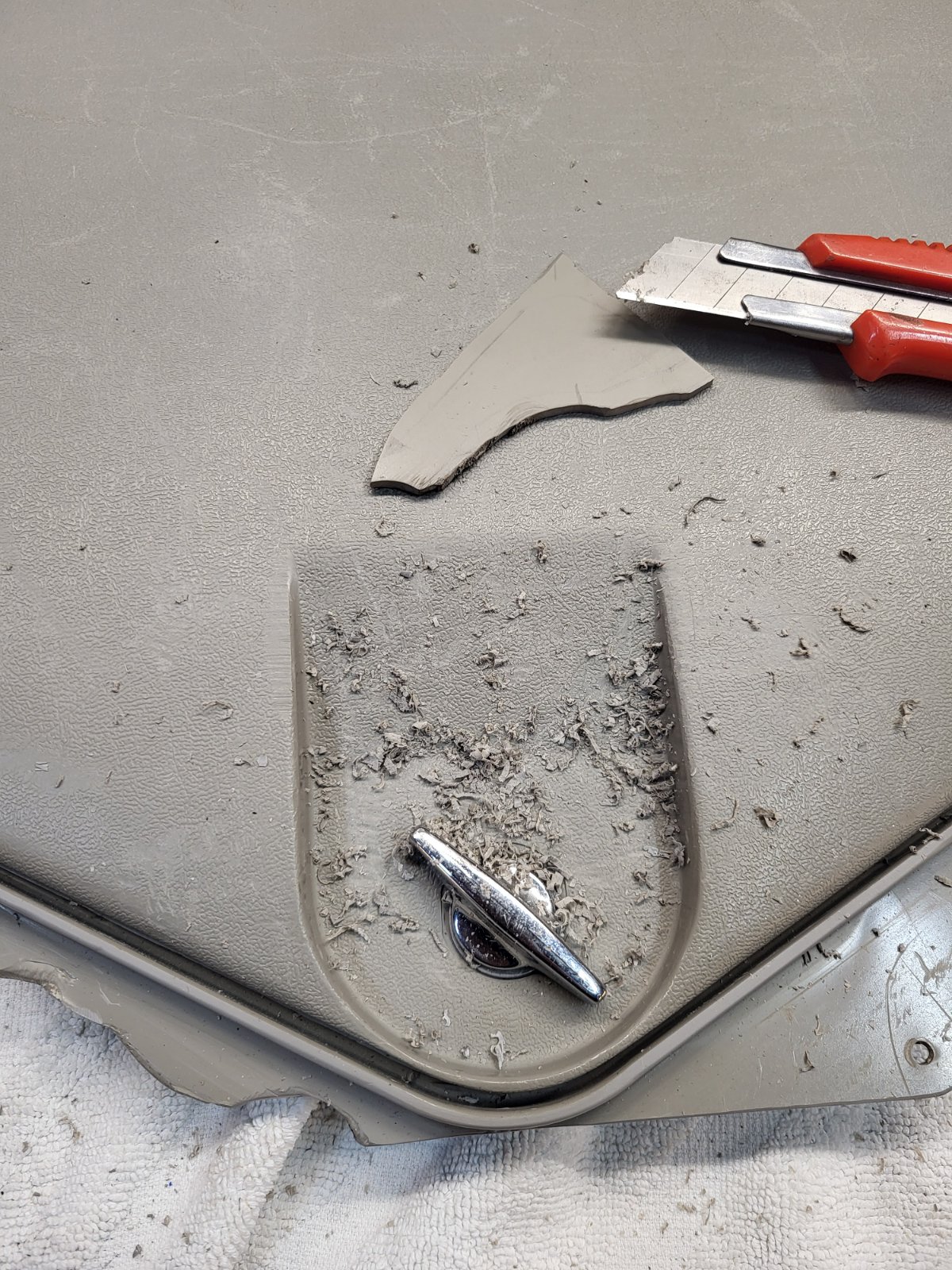

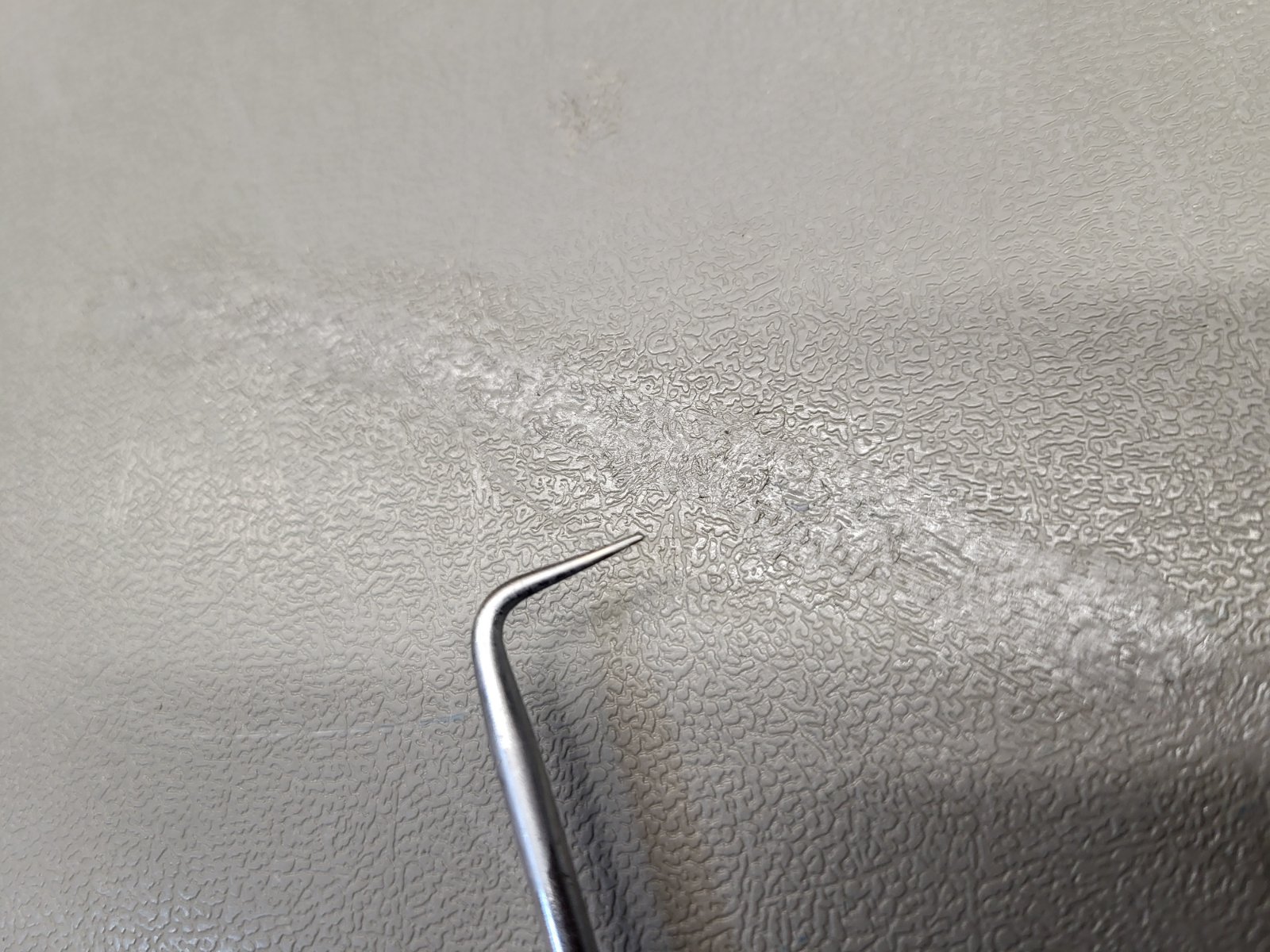

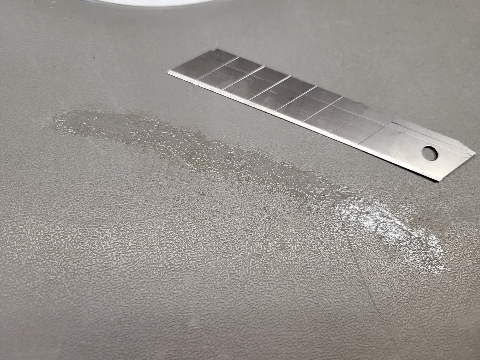

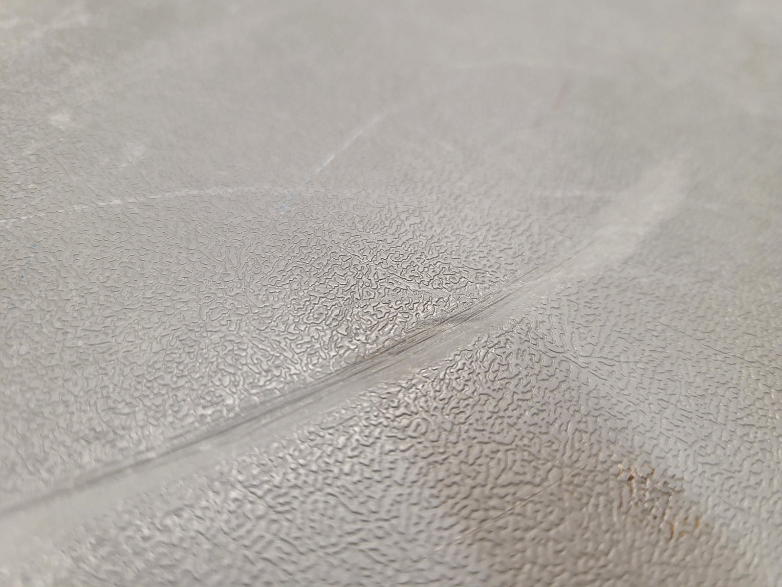

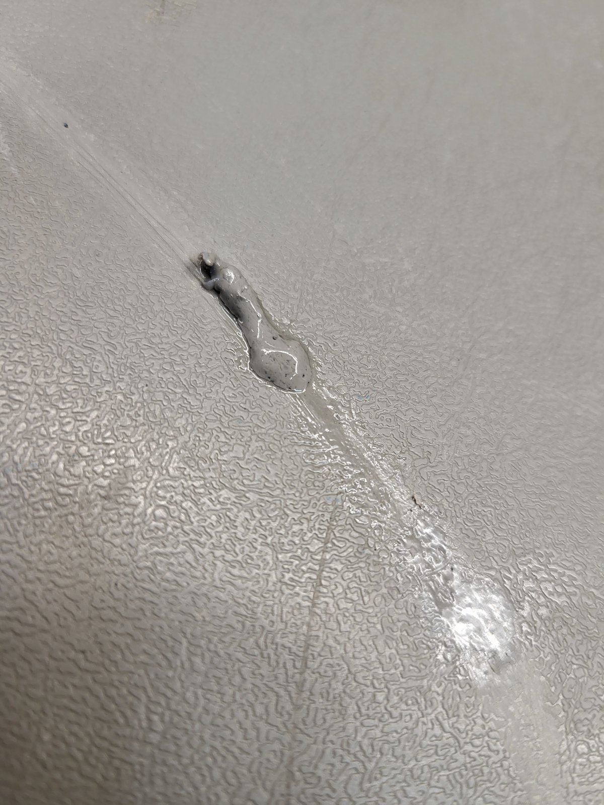

But it did have a massive gouge from where an angle grinder (or comparable) had a momentarily touching condition. 10 cm long - (4 inches)
I gave it a good clean with a metal polish, as it gently abrades some of the gunk that lies on top of the grain. The plastic is a polystyrene, and that's quite hard by itself. Besides being brittle by now, it also polishes quite well.

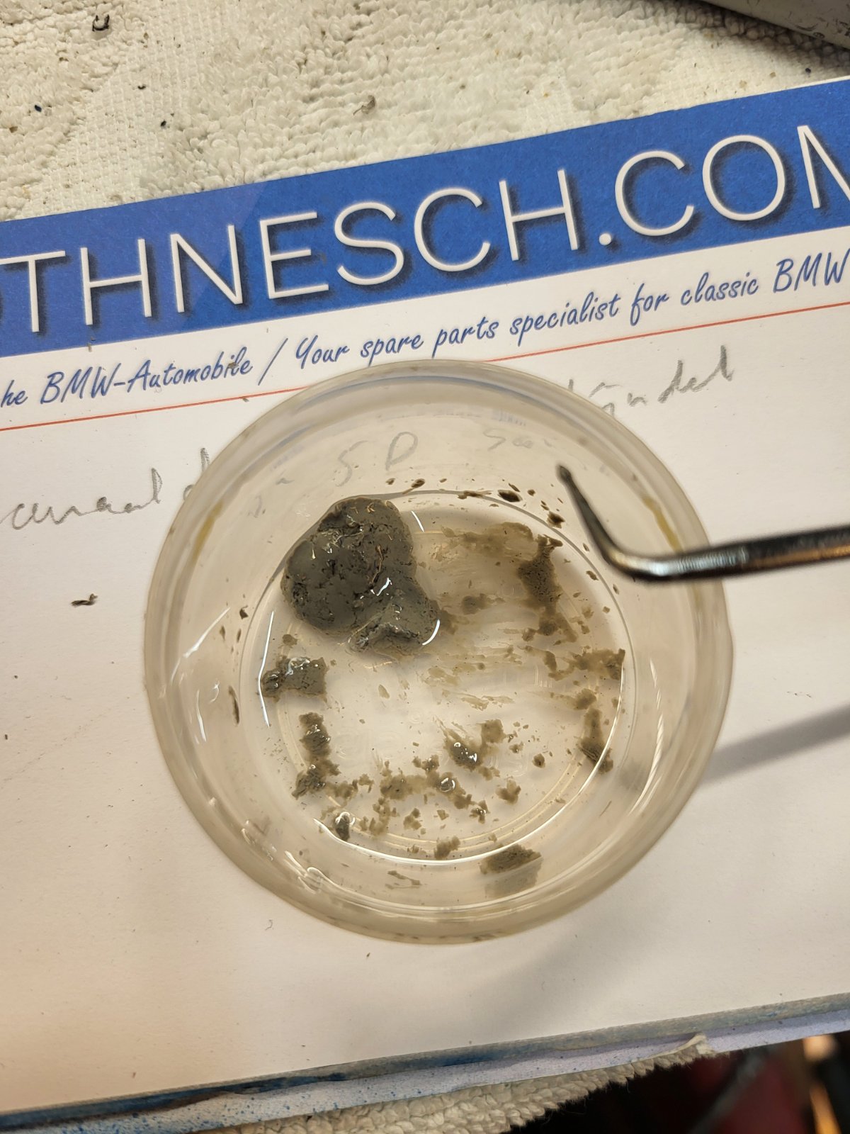

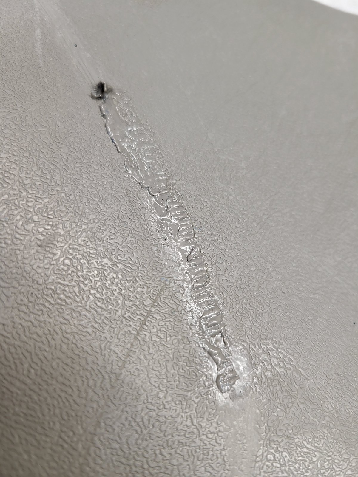

Then it was time to fix the battle scar. Now as it's a polystyrene, it means it dissolves in strong paint thinner.
Having some pieces left from a broken box, I made some shavings, and added some thinner.
I left it for a few minutes, and the magic happened: it turns into a moldable clay like texture.
Then smeared the lump in the trench, and spread it out to let the paint thinner also work it's way into the base material.

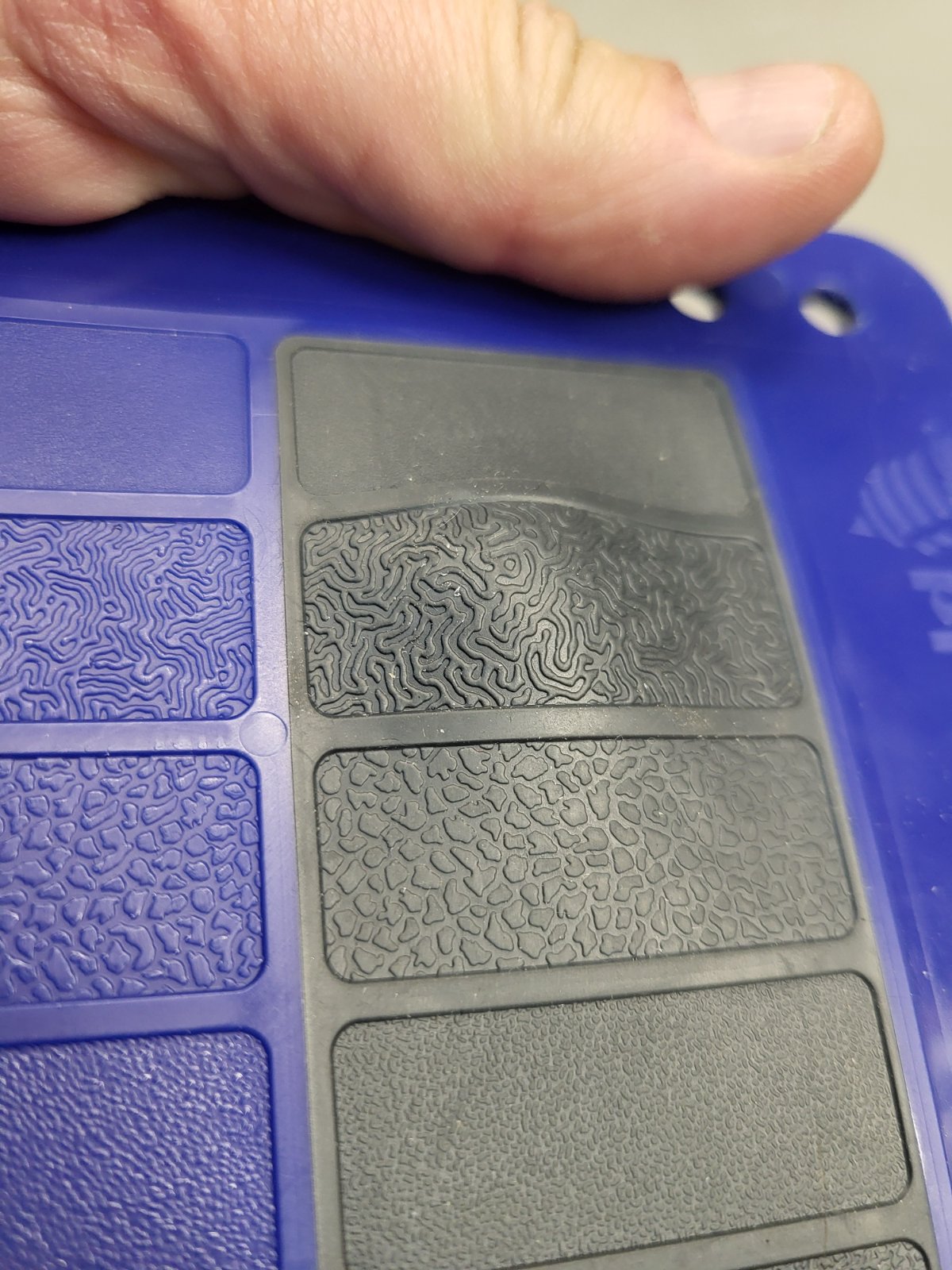

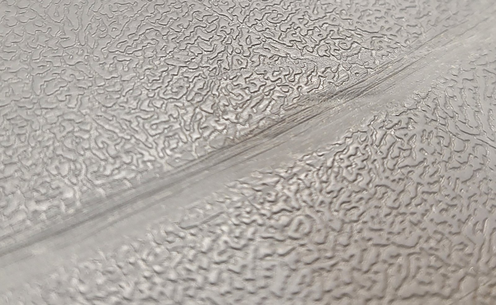

Then, after letting it sit for a few minutes to solidify a bit, I pushed a rubber piece which had a matching (enough) grain into the soft surface: it worked like magic.
Some high spots were flattened with a knife, and with some fresh thinner I repeated a second time to press in the grain.

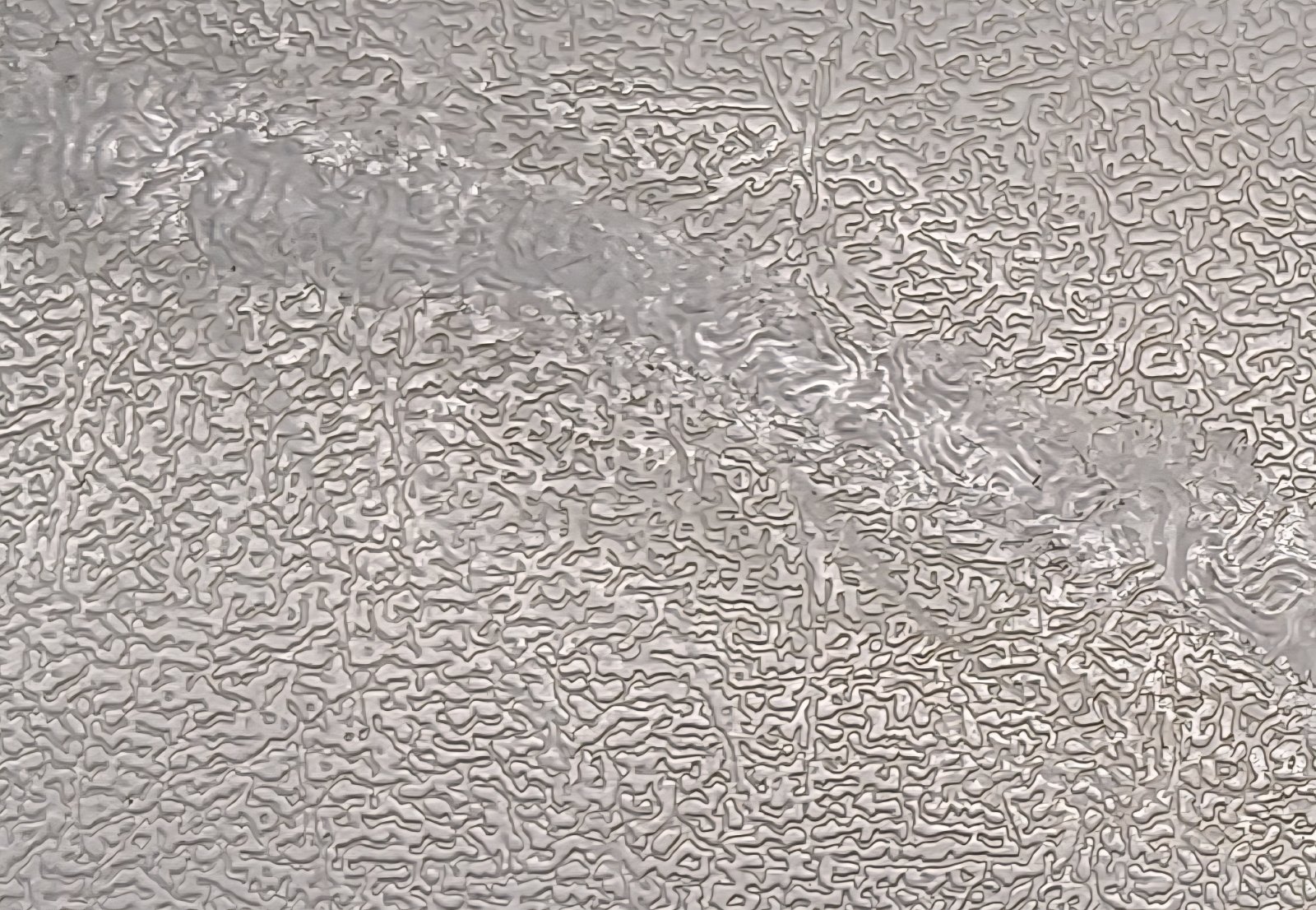

after the second attempt, it shows that I the grain isn't perfectly pressed in yet. It has some flat spots, so I may redo the last step again tomorrow, letting it soften a bit more (deeper).
Edit: next day I did a 3rd cycle of softening with paint thinner and a retry to get a better grain imprint. Comparing it to the start situation, I see a learning curve :-)
Apart from the gloss differences, which will disappear with a paint layer, the scar is well healed!
before vs after:

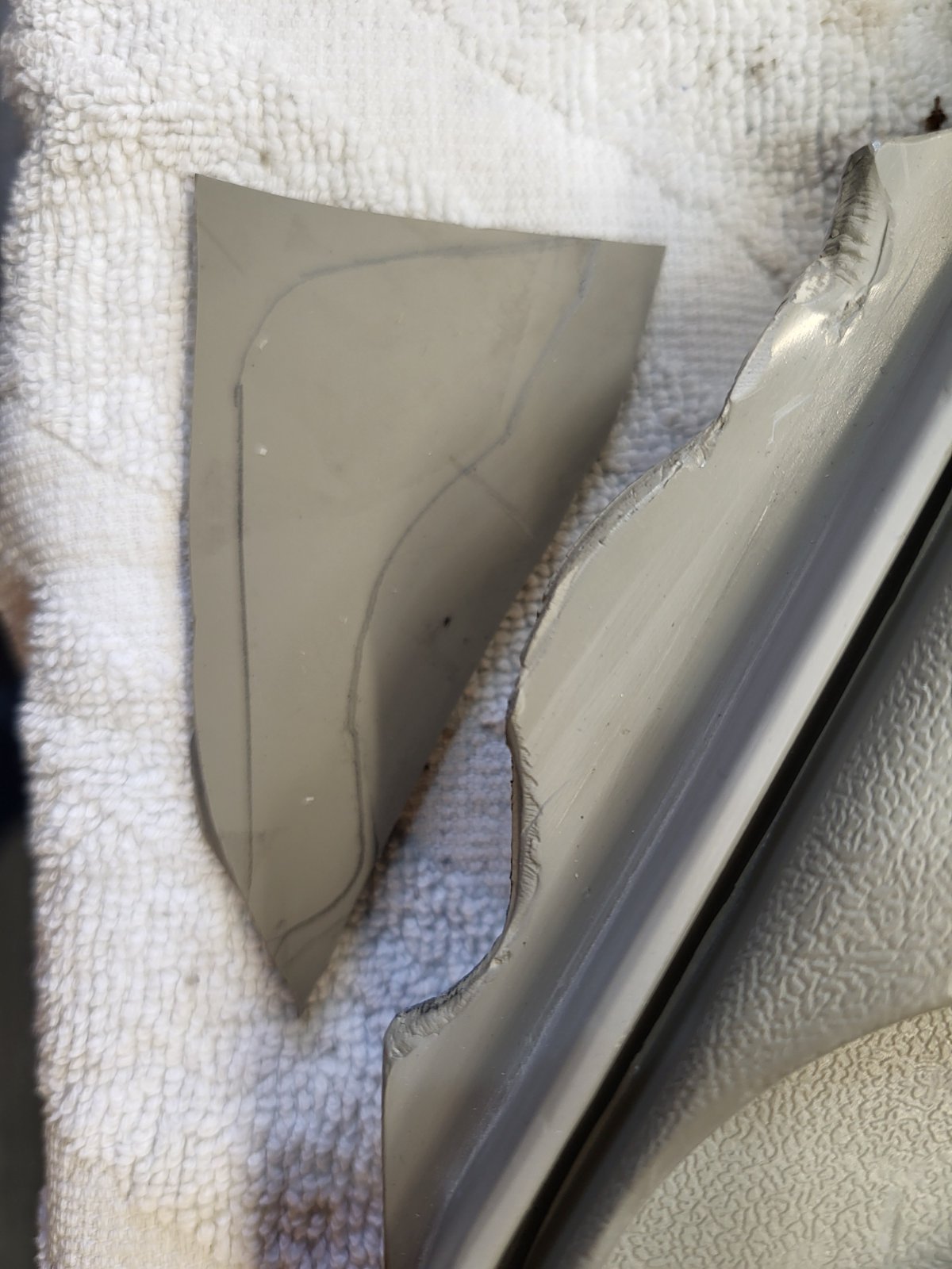

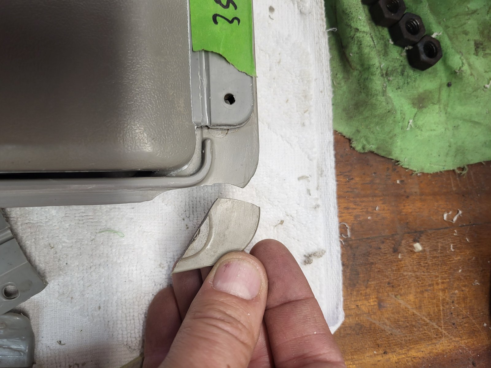

Next challenge is seeing if i can get the broken corners fixed to a visibly satisfactory level. I'll likely back them up with alu or stainless steel for strength.
Question: if anyone has broken pieces of tool tray remnants they are willing to part with, I'm in need of them!
