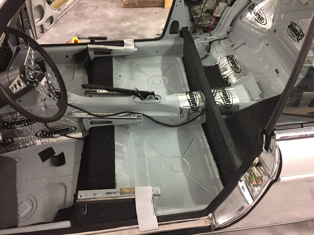

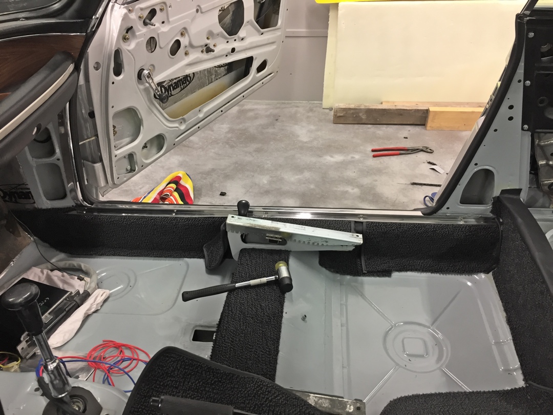

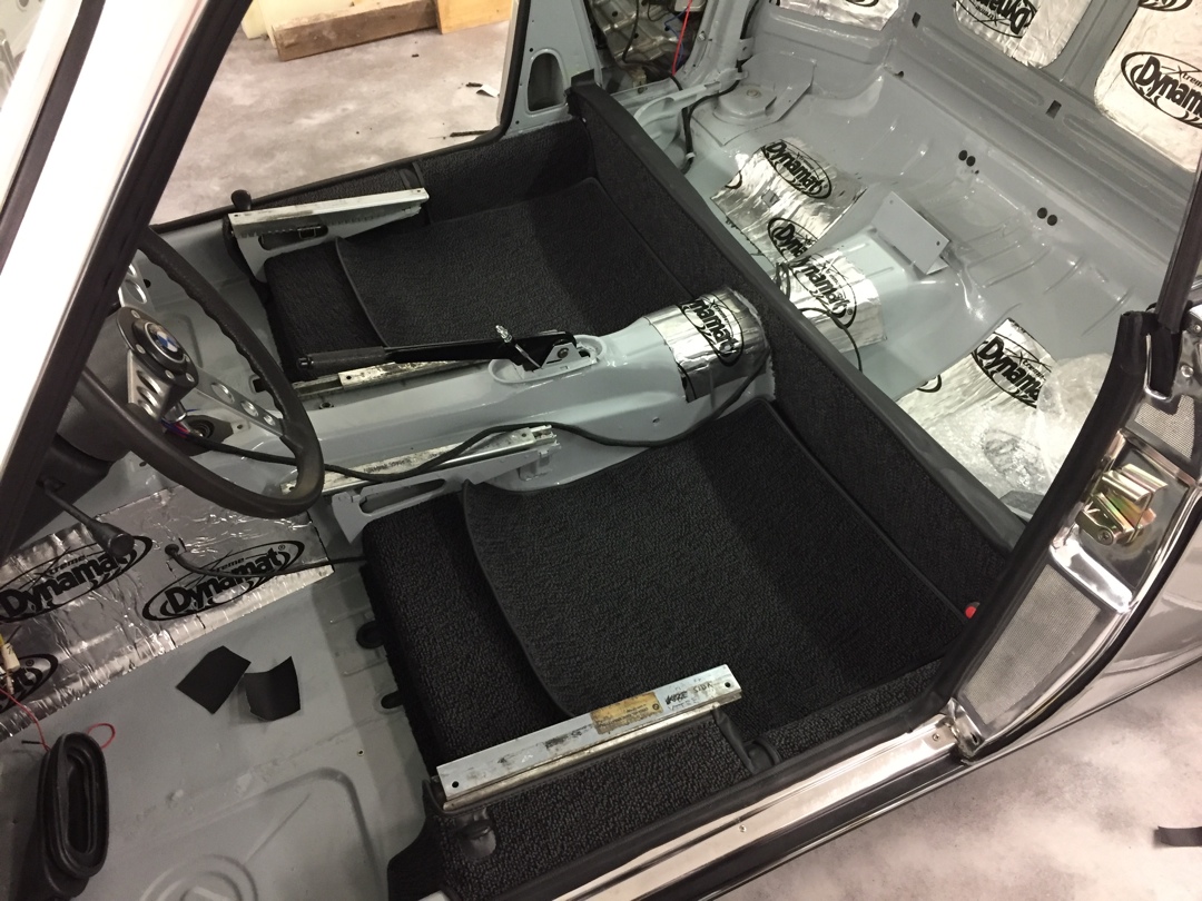

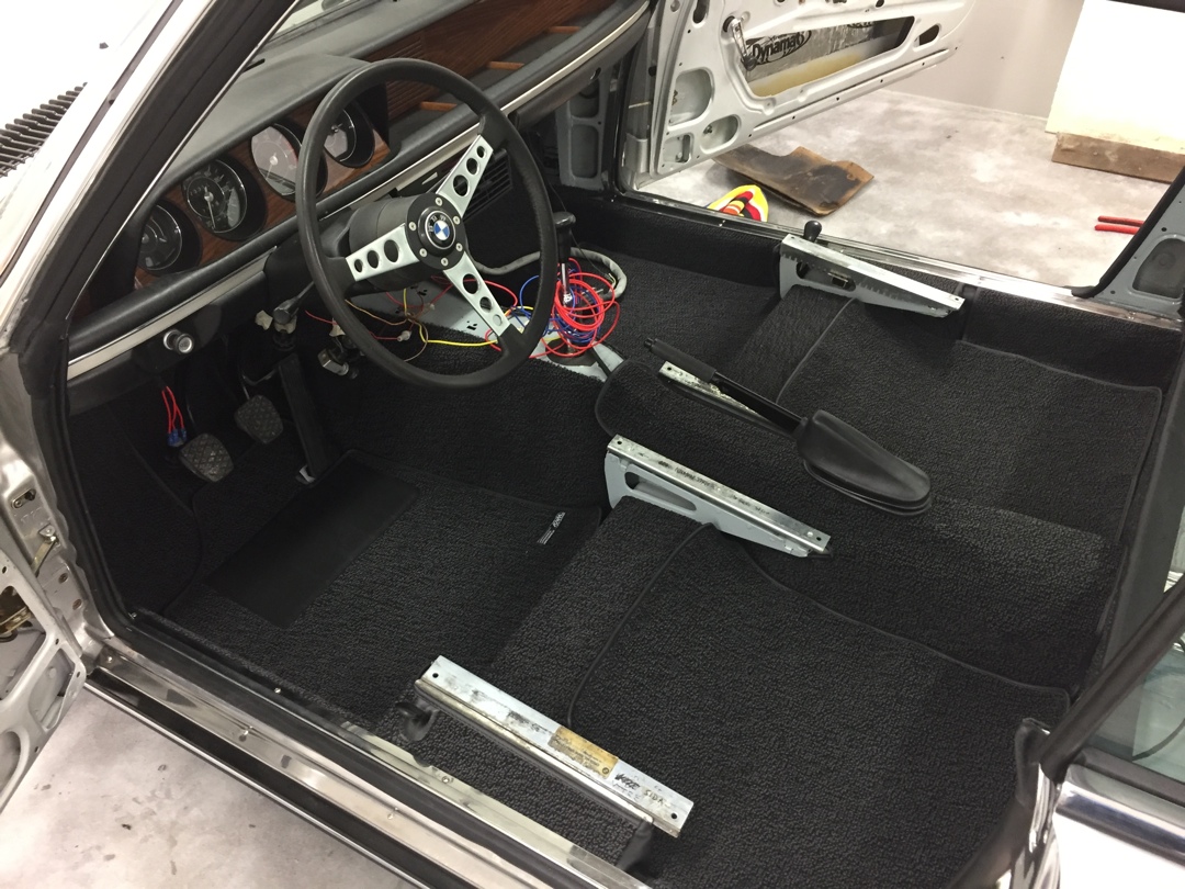

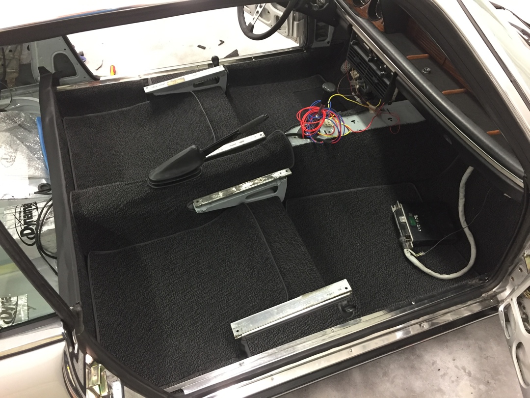

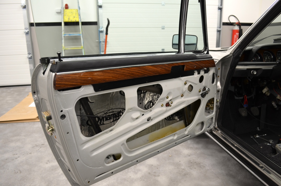

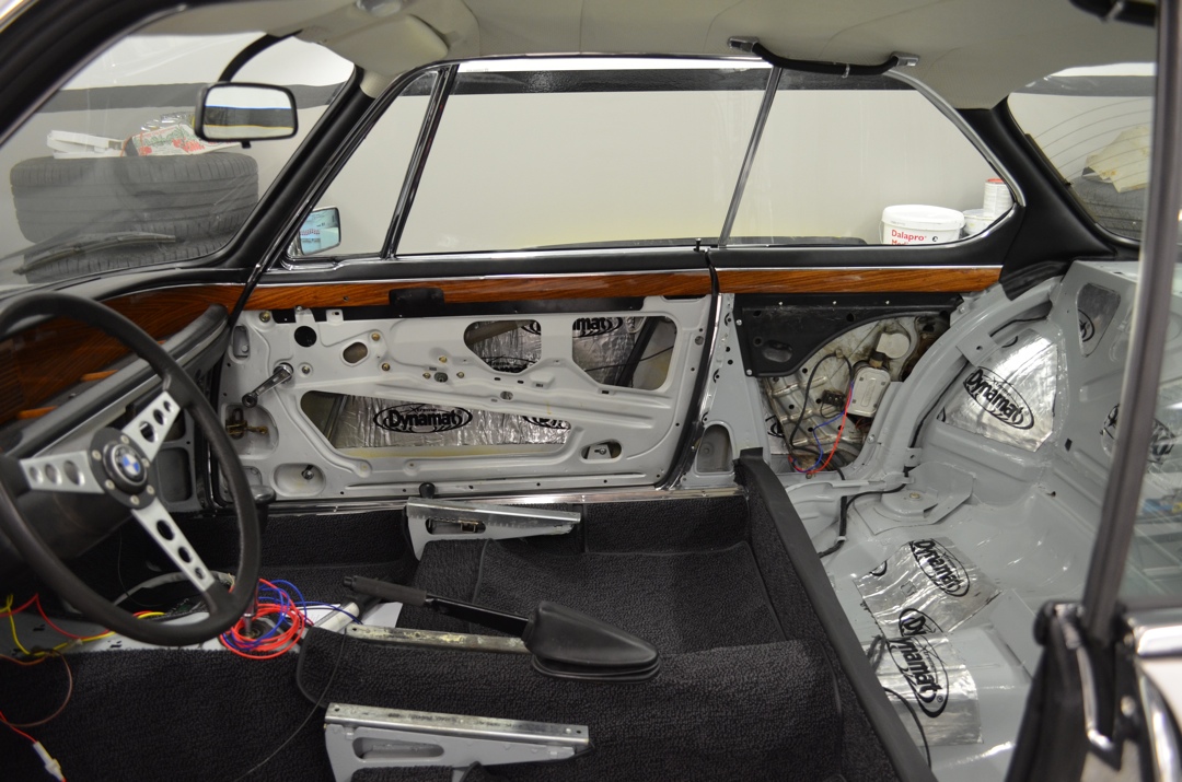

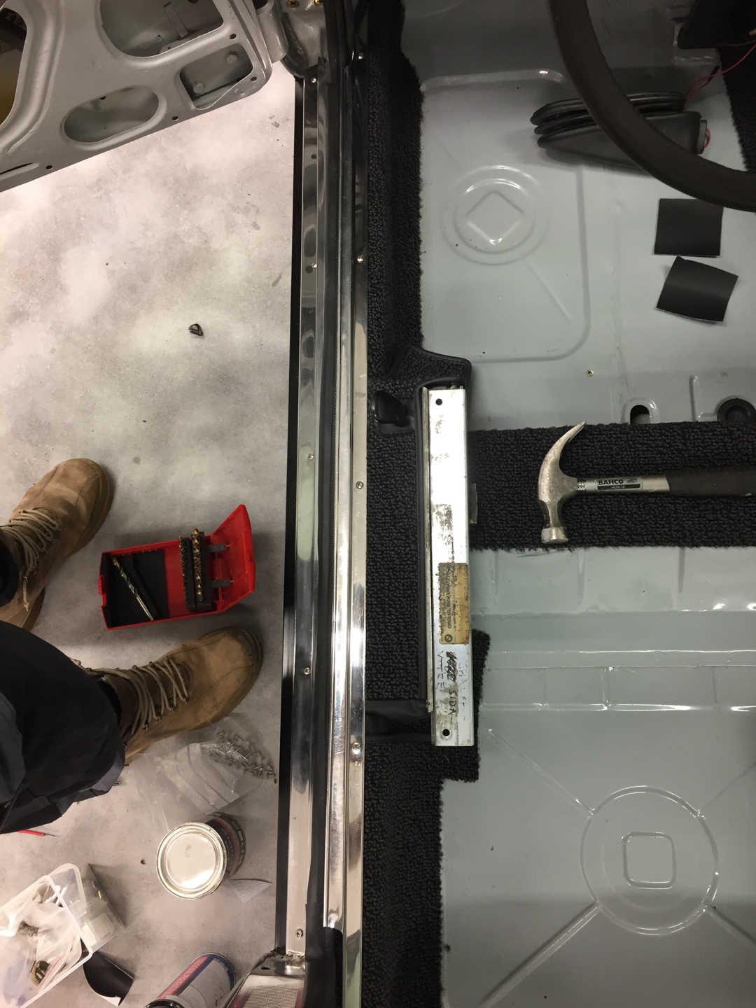

Door gaskets + rocker chrome panels and KHM 2-tone charcoal carpet installed:

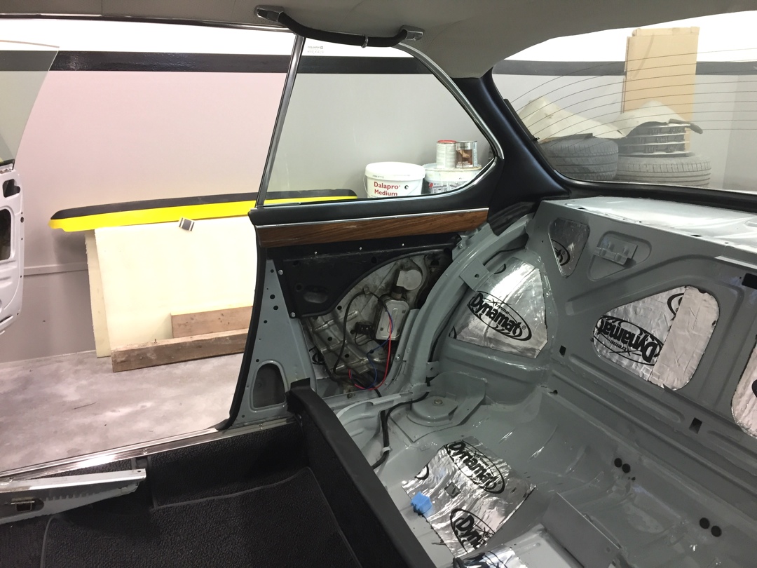

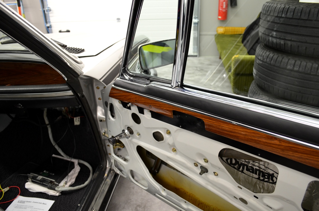

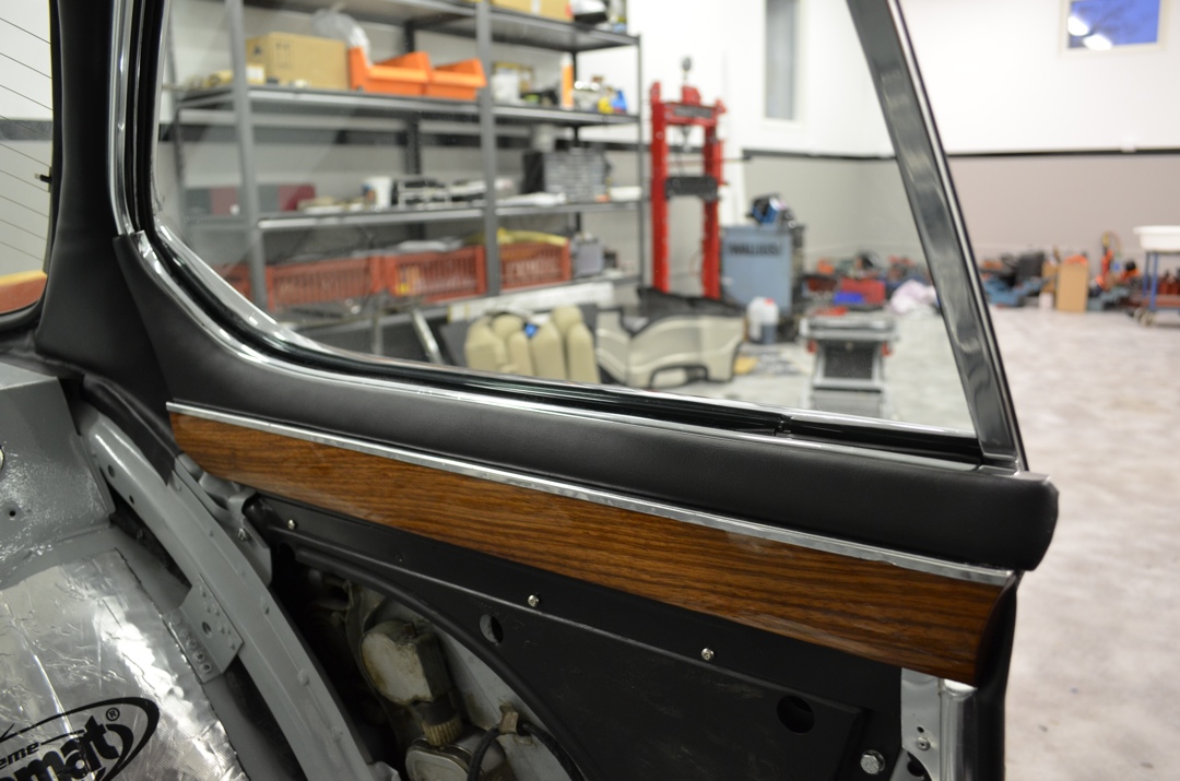

Then it was time for the side wood/chrome/leather panels to be installed, all gaskets, brushes + leather was replaced.

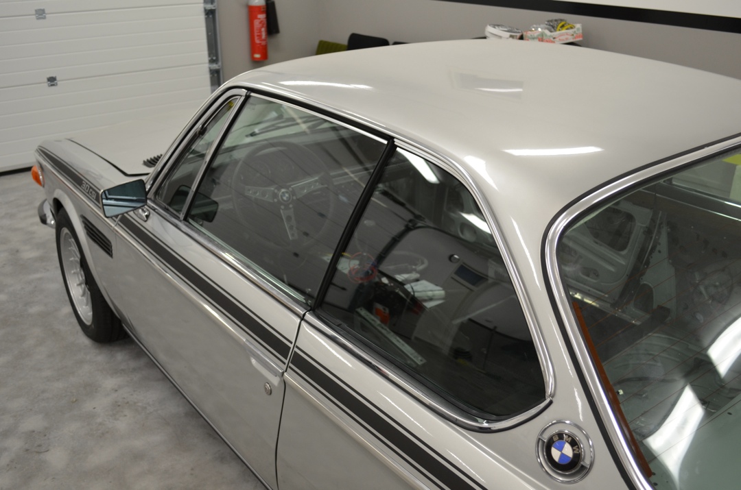

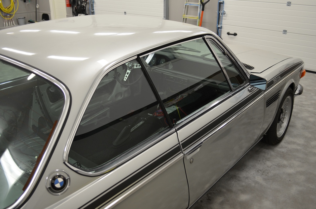

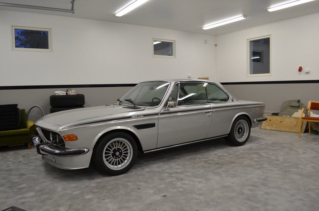

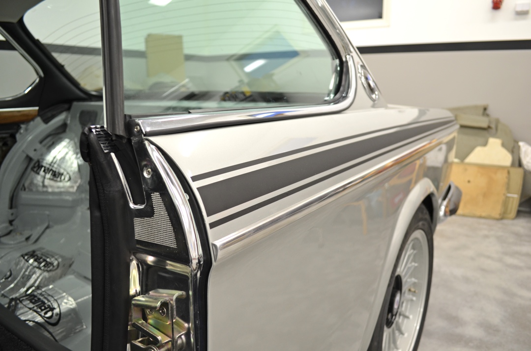

And as you maybe already saw in the previous pictures, I've also installed side stripes, all of the exterior trim, and had the doors + glass adjusted so that I can live with it. I didn't get it perfect, and will still do some small adjusting before the door panels go back on, incredible how much time it takes to fiddle with all the gaps.

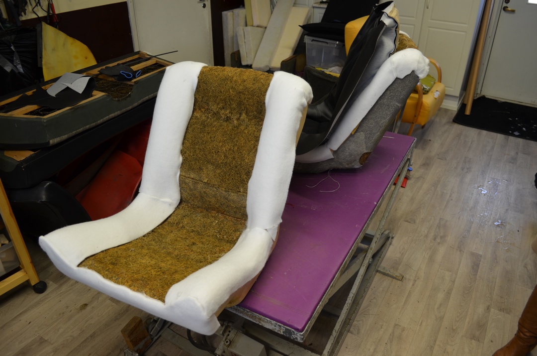

Here we have the rear seats getting recovered CSL-style, still not finished.

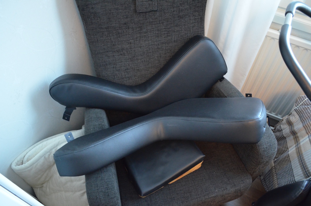

Rear armrests are done.

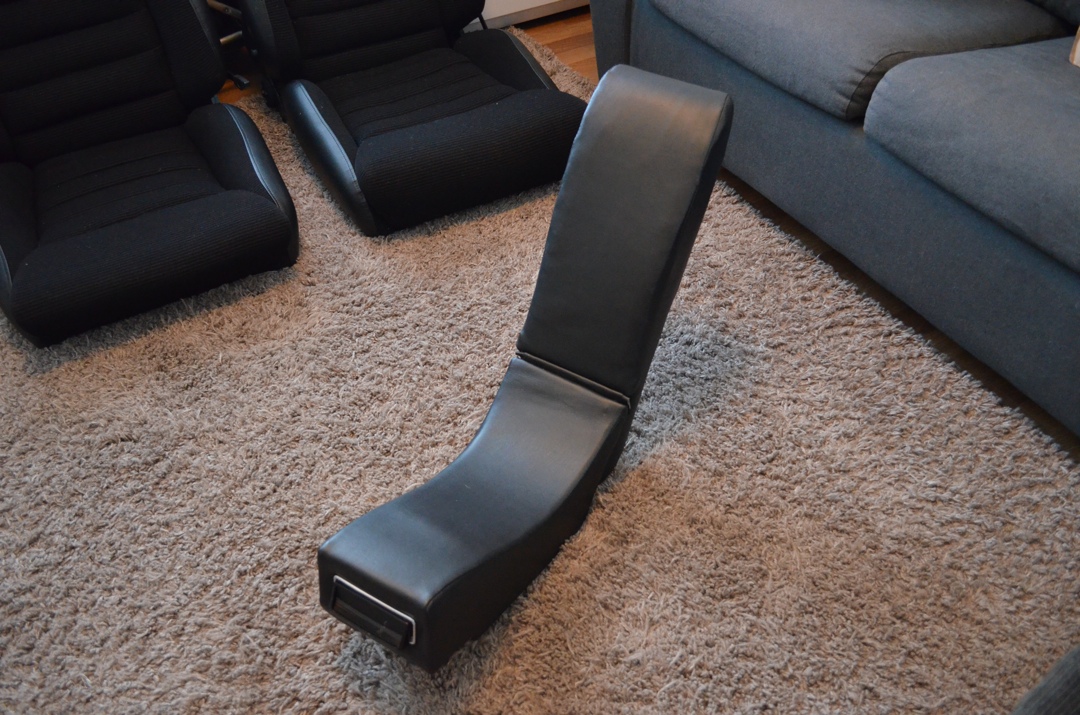

Center piece done.

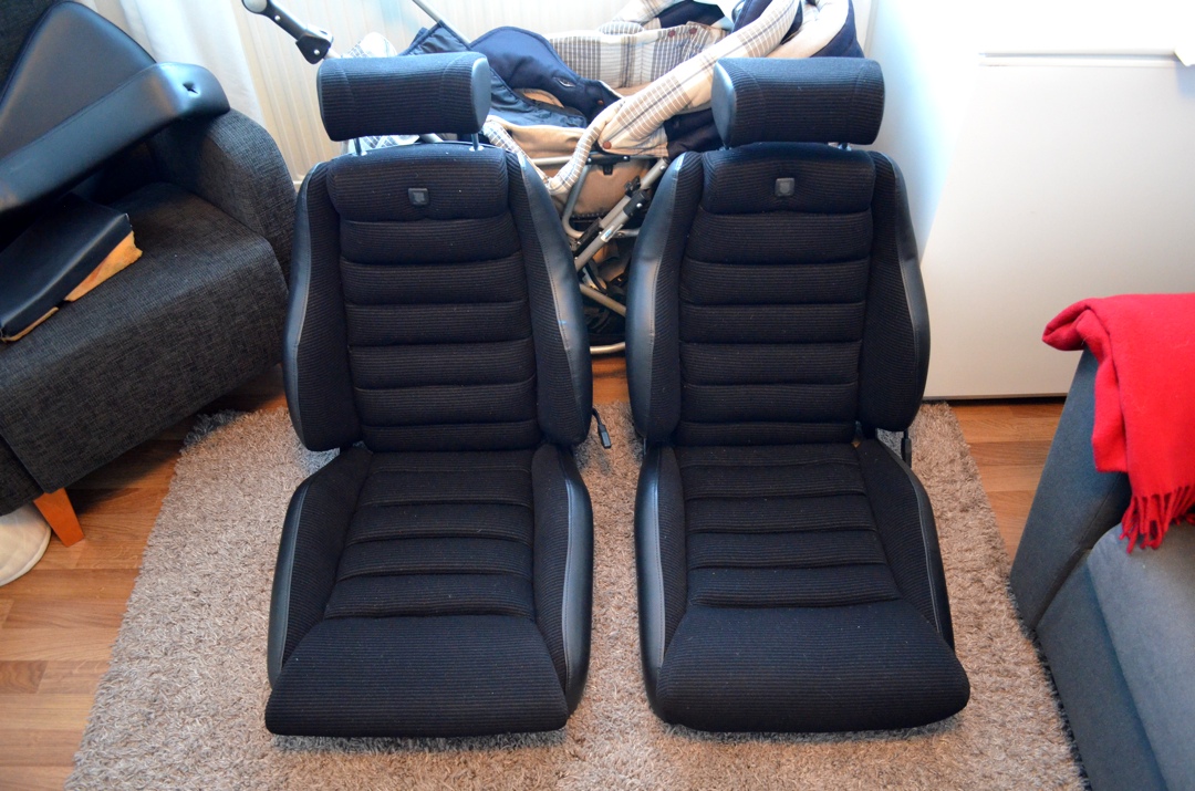

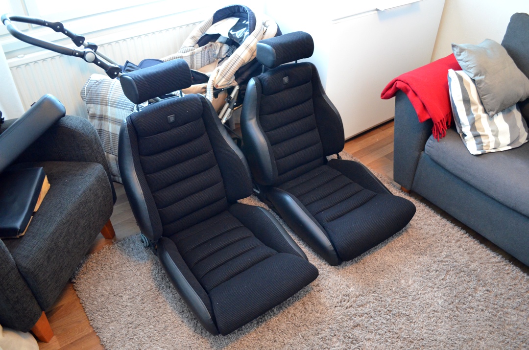

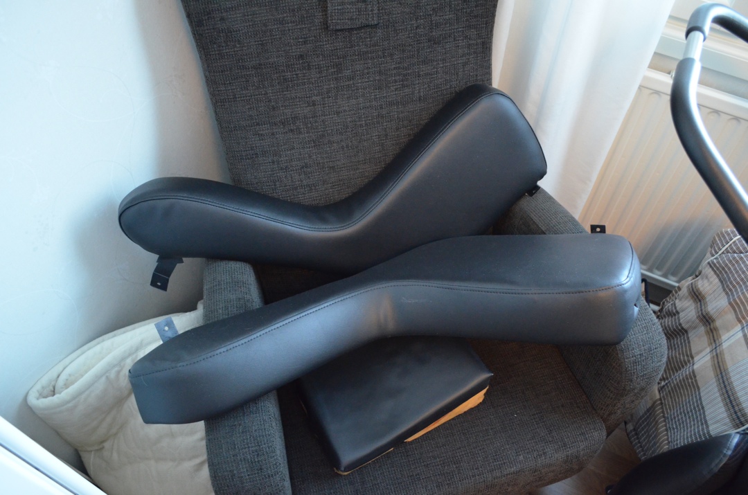

And the front Scheels are done, but they are still not put together as I have to make adapters and it's easier if you don't have to lift the whole seat in and out of the car.
