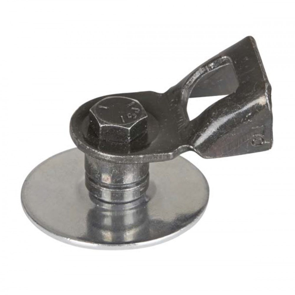

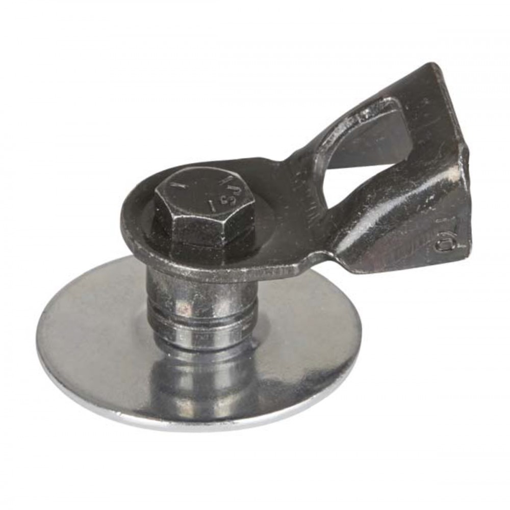

The way to gain some real estate with rear facing seats is to mount in the middle seat. Since couples don’t have one, you could have blue devil or someone make you a double male ended lap belt. Try staging the car seat in the middle and see if you gain any n see space. Another option for the middle spot is to bolt LATCH anchors to the spot where he female seat belt claps are secured.
The middle of the car is safer for side impacts and on a coupe, the area is more level. The child seat should be very difficult to move side to side. I’m not sure if it is offered in your country, but in the US your local fire station will show you how to properly install a car seat.
One last disclaimer. Car seat manufacturers will specify that you are not to straddle two latch systems. That generally means doing use latch for the middle seat if there is no specific system for that seat. I think they want you to avoided fanning out the latch straps to reach the anchors. Not that I had any accidents, but I ran our rear facing car seat in the middle spanning two latch systems for a few years. air fit well and gave is the needed space.
The coupe is narrow so latch anchors hooked up to the seatbelt points should keep the latch straps nice and square with the car seat.
