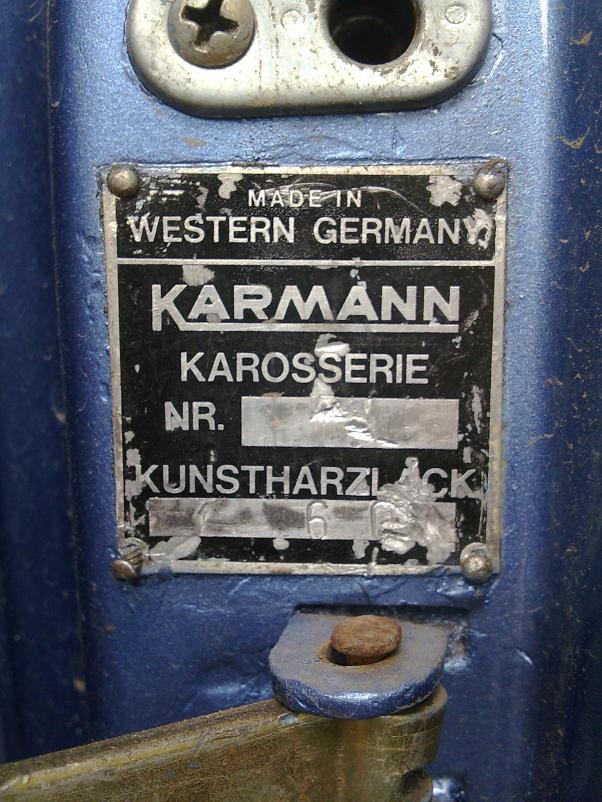

BTW paint code is on the driver door frame on the Karmann label (2 digits)
Also written under the right rear seat.

The Karman plate KUNSTHARZLACK code is 60. Is there a catalog or web page where I can see what color corresponds to this code???

I´m attaching picture of the KARMAN plate. According to the link DJSimca sent me, the original color of the car is POLARIS/IMOLA SILVER.
It seems I have to entirely paint it in order to make it look 100% original.
Truth can be cruel some times.

Murray meant that your center kidney grille is Black which was used on `74 and later coupes, other than perhaps CSLs.

Has anyone considered the significance of the Karman number stamped behind the alloy plate on the door shut? I have seen a lot of these & have a list of the numbers I have seen set against known buld dates of the cars. It seems to be possible to date a car within a few months this way.
Does anyone know if there is a relation between the Karman number & the actual chassis number ?
