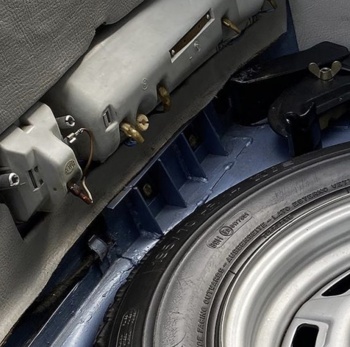

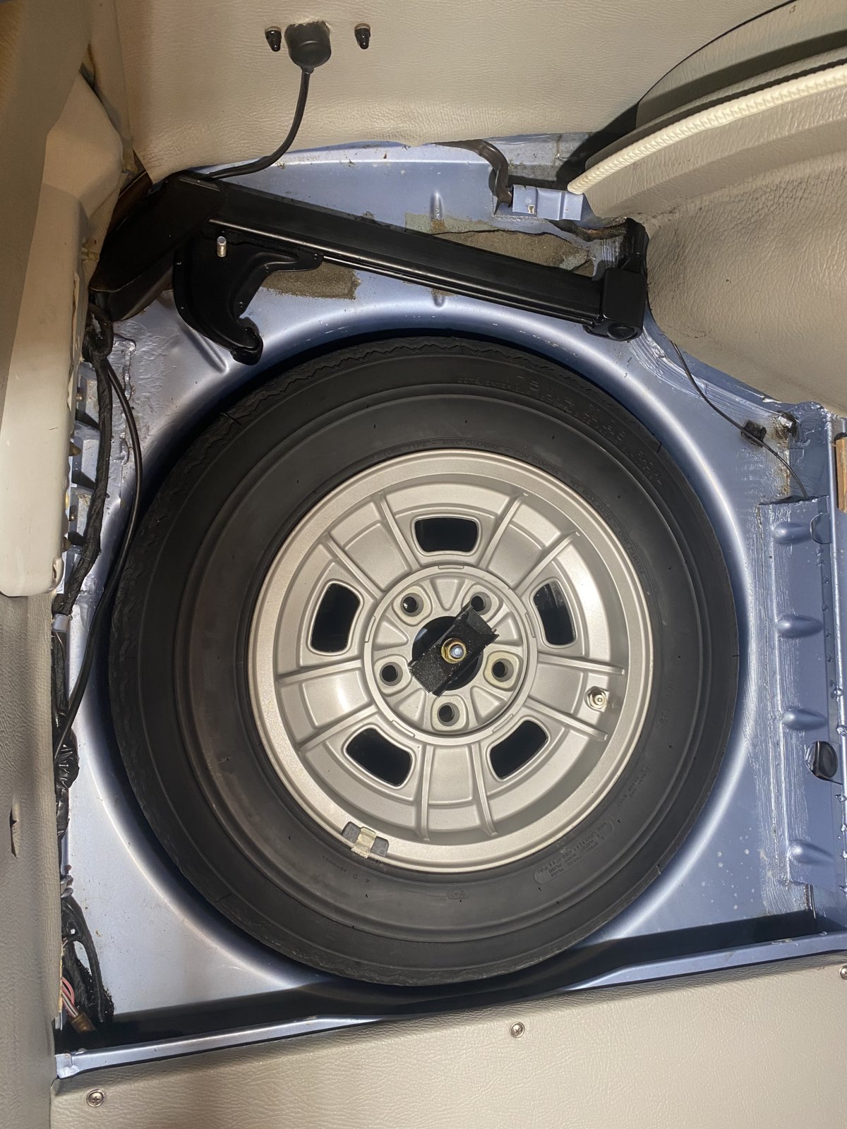

I was doing a toothbrush detail/clean up on my survivor US spec ‘73, and was surprised at how heavy duty all of the additional bracing was for those bumpers vs. the earlier cars. 3C1D5067-A65C-4662-84C3-4A20BD2FB3D0.jpeg

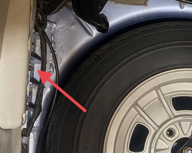

I’m not sure if you saw the posts on this a little bit further up, but the ‘73 doesn’t have extra chassis rigidity. All of that came for US MY74. 1973 only saw a seatbelt change and a 2.5mph bumper change. That bumper change was basically bigger/more rubber, collapsible steel bumper hoop mounts, and a bumper that sat further from the body.
With that said, the gussets below aren’t present on the pre-73 US cars or euro cars. This is the first time I have noticed these. They do nothing to make the chassis more rigid however.

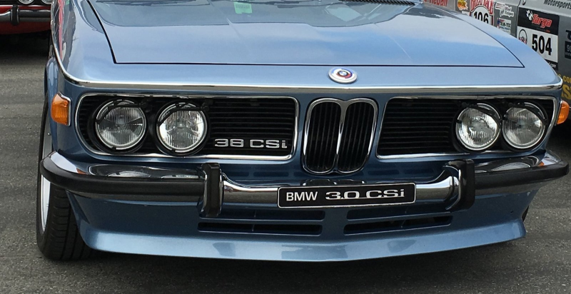

Here is a pic from the BaT 3.8CSI:

@Markos, yes - I was referring to those gussets. I was also unaware of these before scrutinizing my ‘73 during cleaning last week.
I figured as heavy duty/overbuilt as they are, they might add something appreciable to the chassis stiffness - I stand corrected by the forum experts!

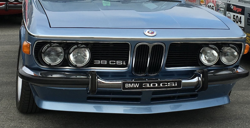

Is it just me or are the front bumperettes and/or bumper angled up slightly? At that angle it looks like it bumped something. Left side higher maybe? Maybe I'm hallucinating. I know I've never liked the strange angles of the CS bumperettes and rubber overlays.
Seems so. Usually you don't see those rivets on the airdam:

Well I’m a forum expert but not an e9 expert. :) I have taken apart one of these bad boys however. There is zero structure or support rear of the wheel wells. The wells are made of multiple layers of metal. The arch of the well is the strength and kind of serves as a spine. The rest of the tails just floats off of this with no semblance of a frame at all. Just sheetmetal. That’s why when you see an e9 completely apart, you can take the whole rear end off.
In ‘74 they added big gussets off of the wells, and frame tubes at each corner of the rear that the 74 bucket shocks fit into.

Based on Paul's comment below on BaT, my guess it has do with the air dam being bolted to the bumper.
"It bolts to the bottom of the bumper and does not touch the body. It was a substantial undertaking and one of the more difficult items to execute on this build."

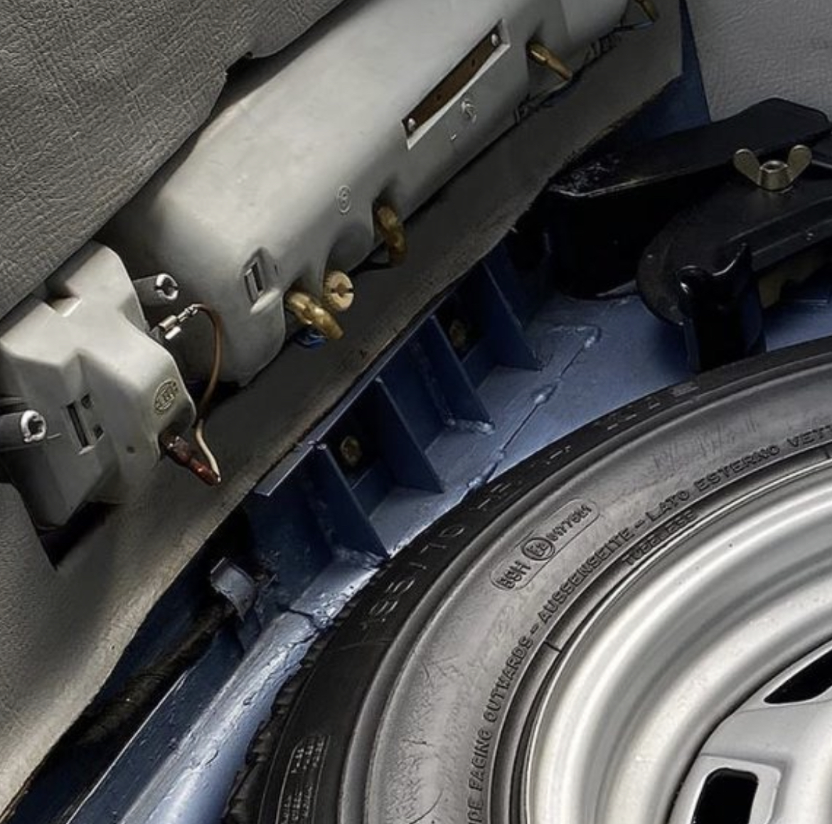

I am assuming he added the ribs for support of another layer of metal added parallel to the body to stiffen the mounting holes for the bumper bracket. I have played with that section of the E9 a lot since everyone of them had sort of damage from slow speed accidents. Aside from that I agree with Markos as I don’t believe they would do anything to straighten the chassis.
