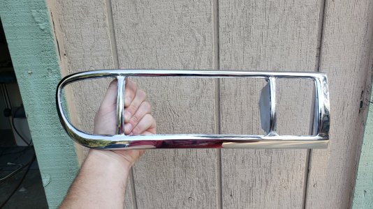

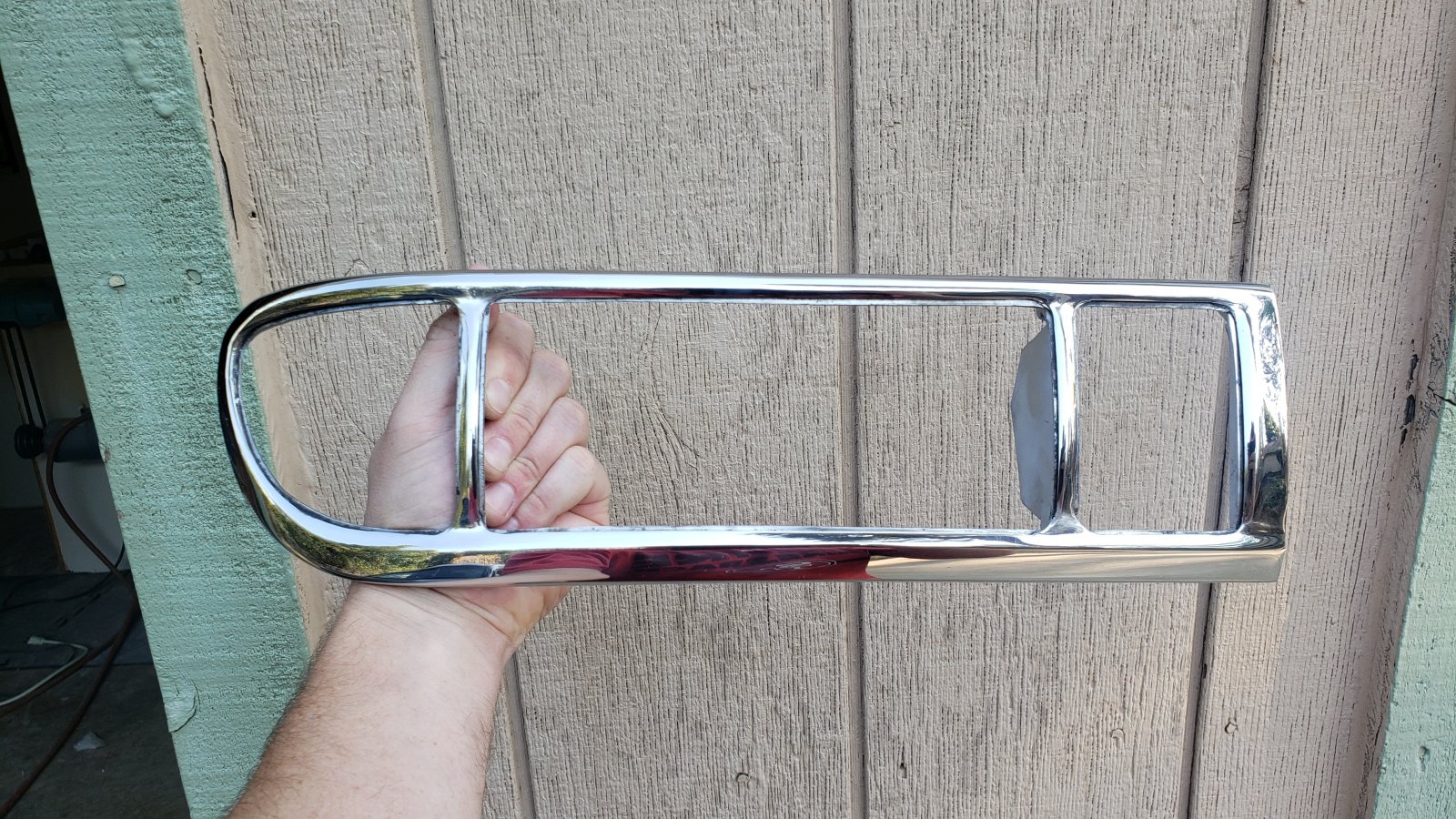

Since 2019, I have been developing a rear taillight frame with lenses for the 2800/3.0CS. It has been a slow process and delayed some years due to covid. But, ALAS! I just received my first sample of the taillight frame constructed out of stainless steel and my is it stunning!
Now for the logistics. I will be forming my plastic lenses to the frames this week and will need a 3.0/2800 to do a test fit. I am located in the foothills east of Sacramento, CA so the closer to this location the better. Basically i would assume it wouldn't take any longer than an hour to test fit. A discount on some production taillight frames would be included.
Is there anyone interested in helping?

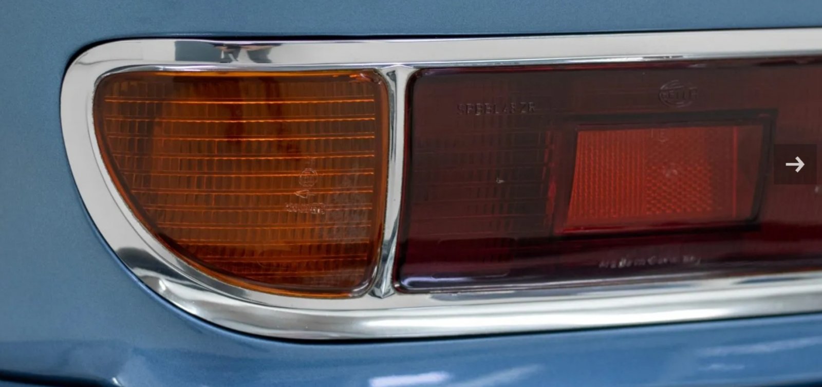

Here' s some examples; I've tried to cut the photo's so no car could be identified.
Wobbly left side. In some places it's under flush, some places over flush, and the gap between panel and chrome also seems to wonder from ~ 1 to 3 mm.

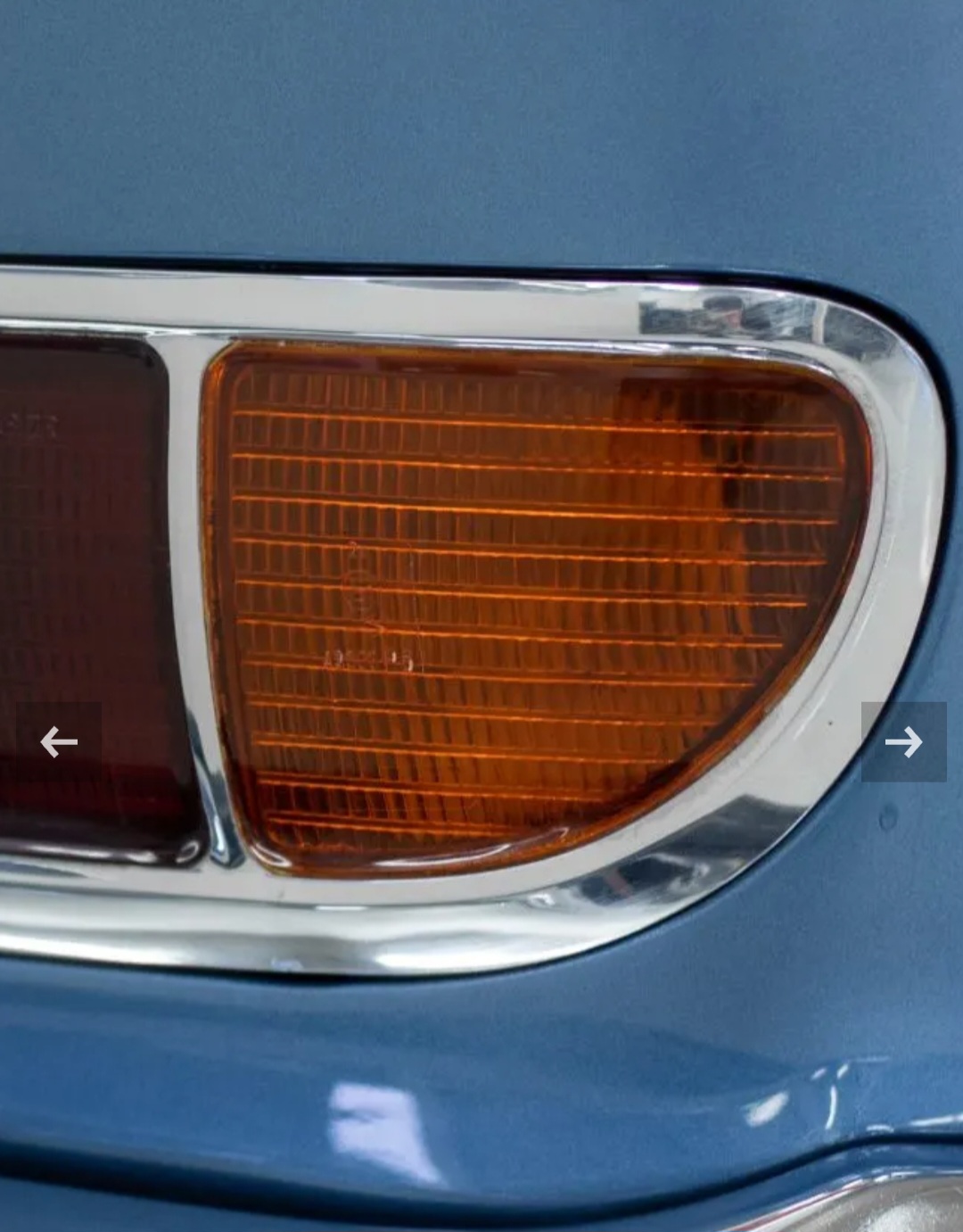

Uneven gap at bottom, just below the junction red-orange:

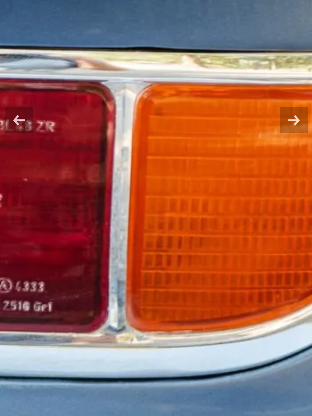

Uneven gap at top, just above the junction red-orange:
