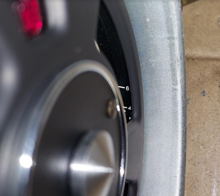

panel de instrumentos e instrumentos
una referencia de temperatura
la zona azul esta entre 40 y 65 grados, asi que 80 es proporcionalmente arriba

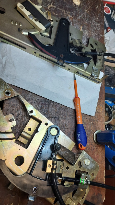

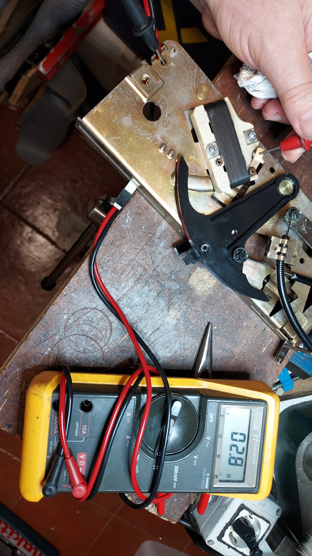

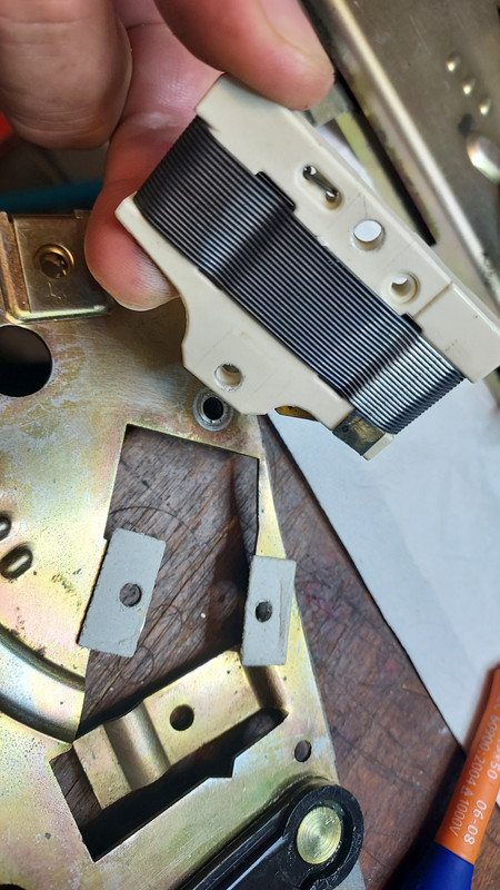

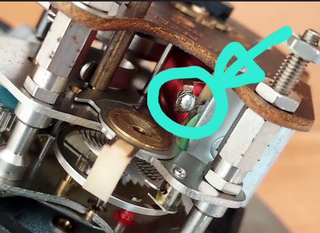

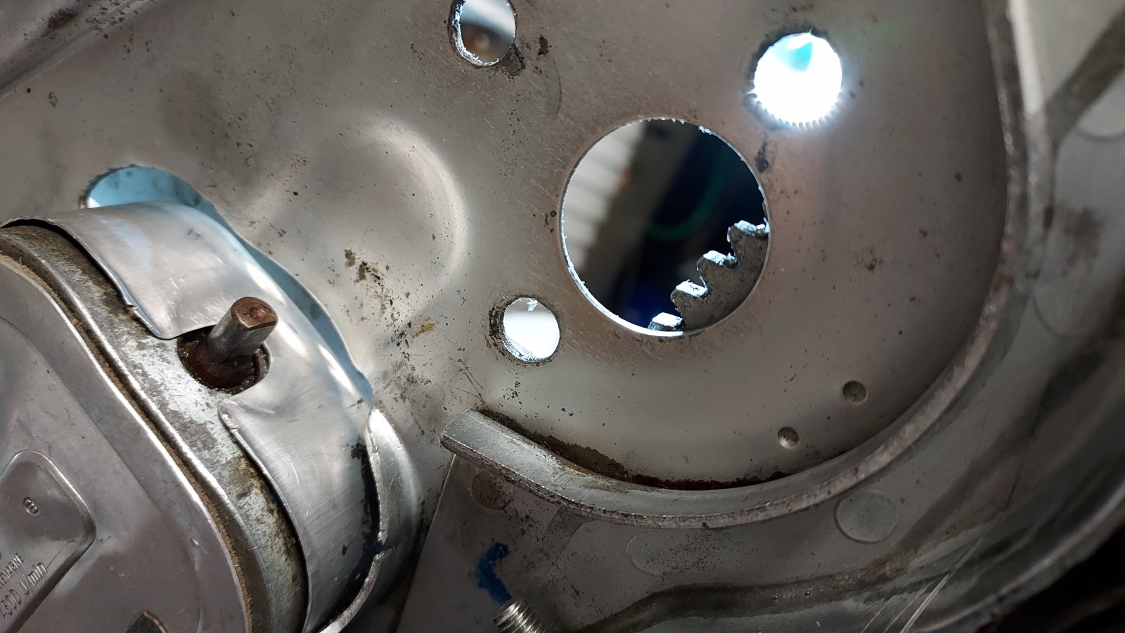

en verde remarcado el punto de fallo del reloj mecanico, suele soltarse (es un fusible termico para sobretensiones), es posible volver a soldarlo, y darle una segunda vida

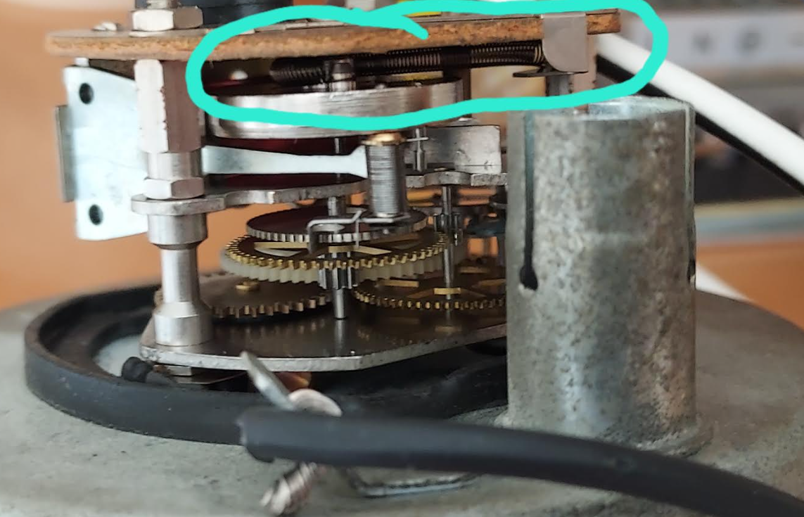

la marcha del reloj depende del muelle
un electroiman se encarga de remontarlo.
el reloj avanza hasta que se cierra el circuito y el electroiman carga
cargado

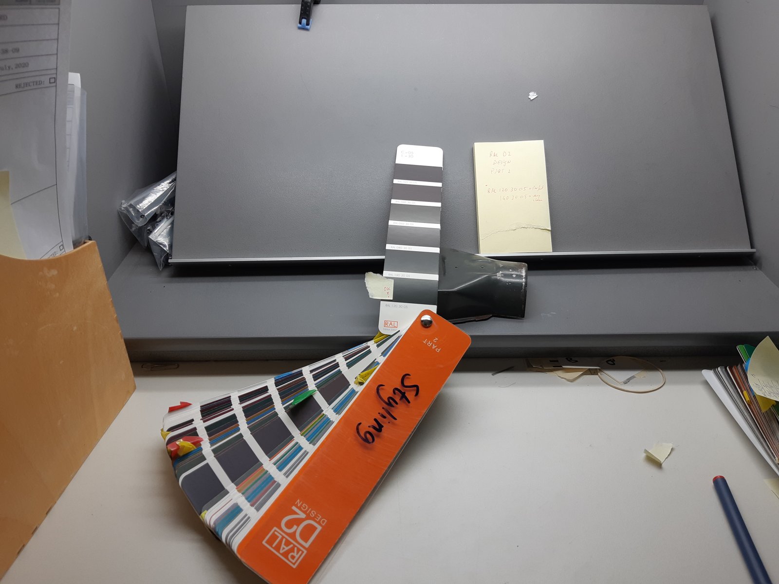

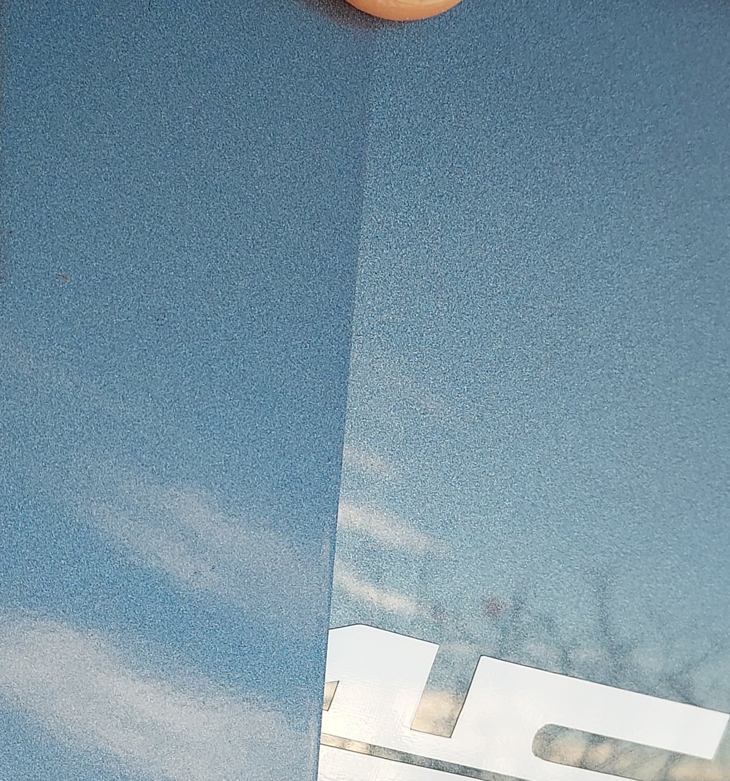

Best colour fit ws RAL 120 30 05.
Can't find the link, but here are the pictures:

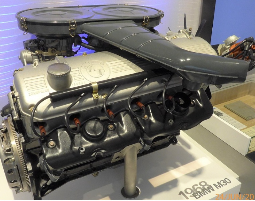

I started with the simple 4 digit RAL coded color swabs. They are easy to find, so I made a long list and short list. But non of the RAL colors turned out to be a perfect match to my air cleaner (may 73 CS, but non original engine, so who knows what build year my aircleaner actually is...).
So in a second step I moved to the more elaborate RAL D2 colour set, which a good paint shop should also be able to make (at least they do here in NL).
long list, showing all RAL colours considered inside an industry calibrated lighting booth, with a list of RAL's considerd:
best RAL fit for me was RAL 6015; close but not yet good enough for my taste:
The more complex RAL D2 coding system offers an even better fit with the RAL 120 30 05 being even better then RAL 6015.
Best match: RAL 120 30 05
Runner up, RAL 140 30 05:
hope this helps!
The color reference is here.
