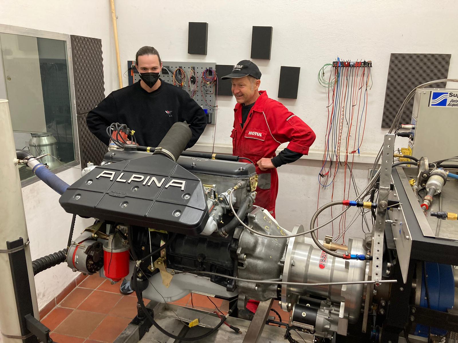

This photo is so quintessentially German right down to the tile workshop floor and the jumpsuit. Very few BMW tuners are running engine dynos, which is the biggest giveaway.

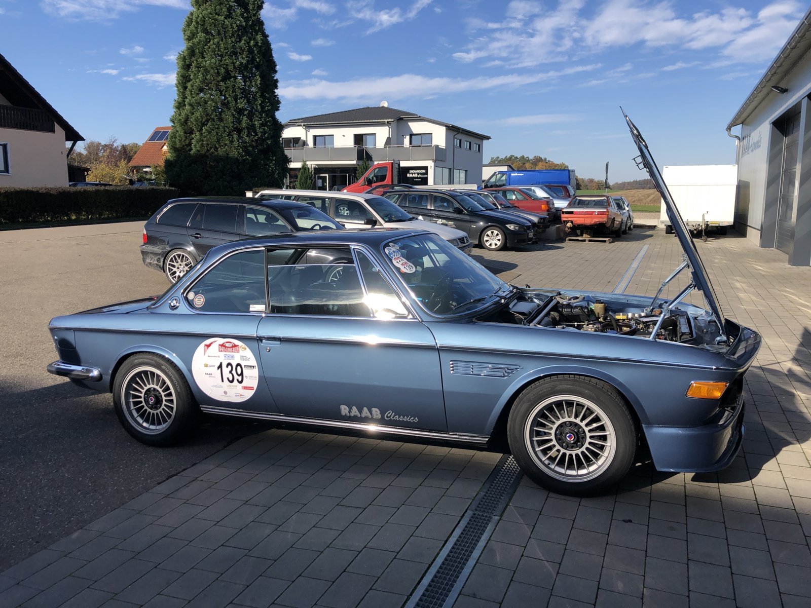

Long time no real updates, but there will be some progress soon!

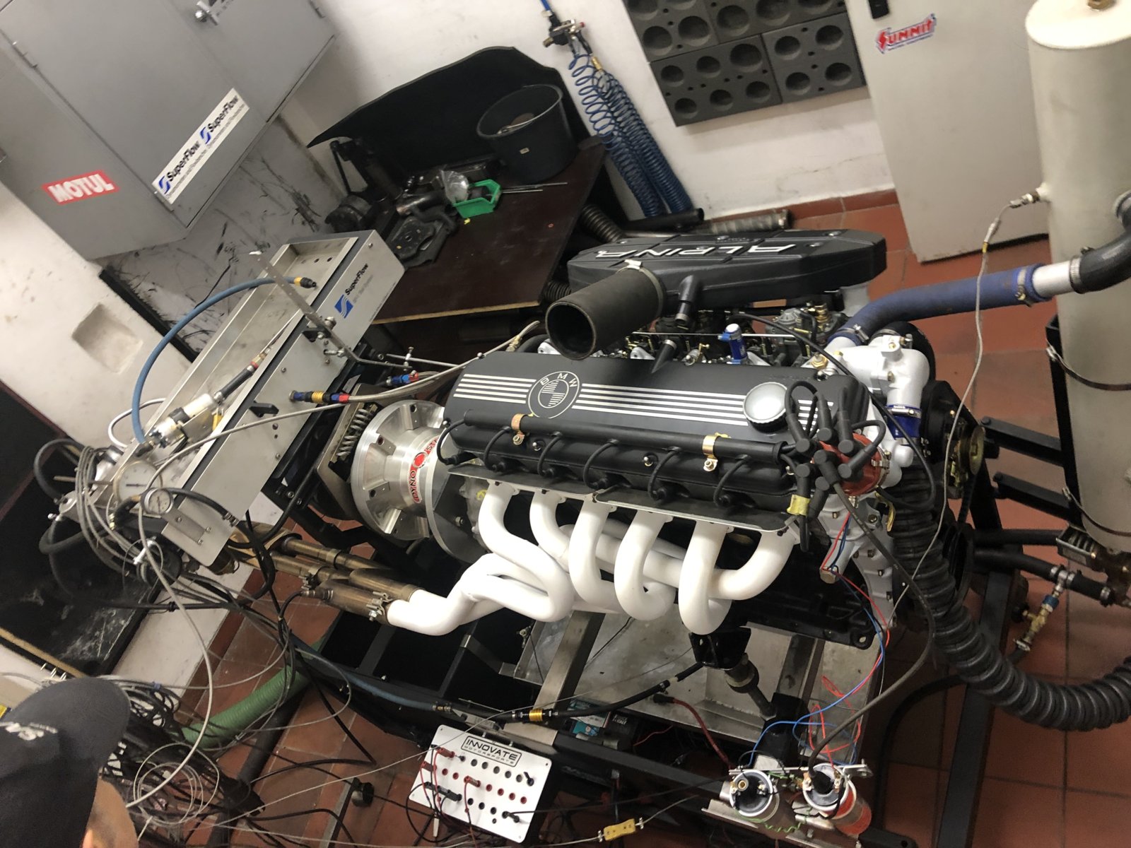

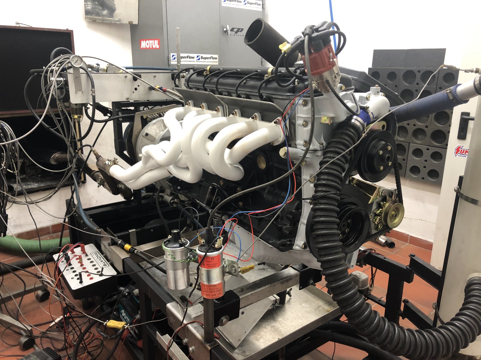

Almost one year after finishing the complete engine rebuild, there was time to have it tuned and started for the first time!
I’m pleased to say that so far everything went perfectly and the engine is running great!

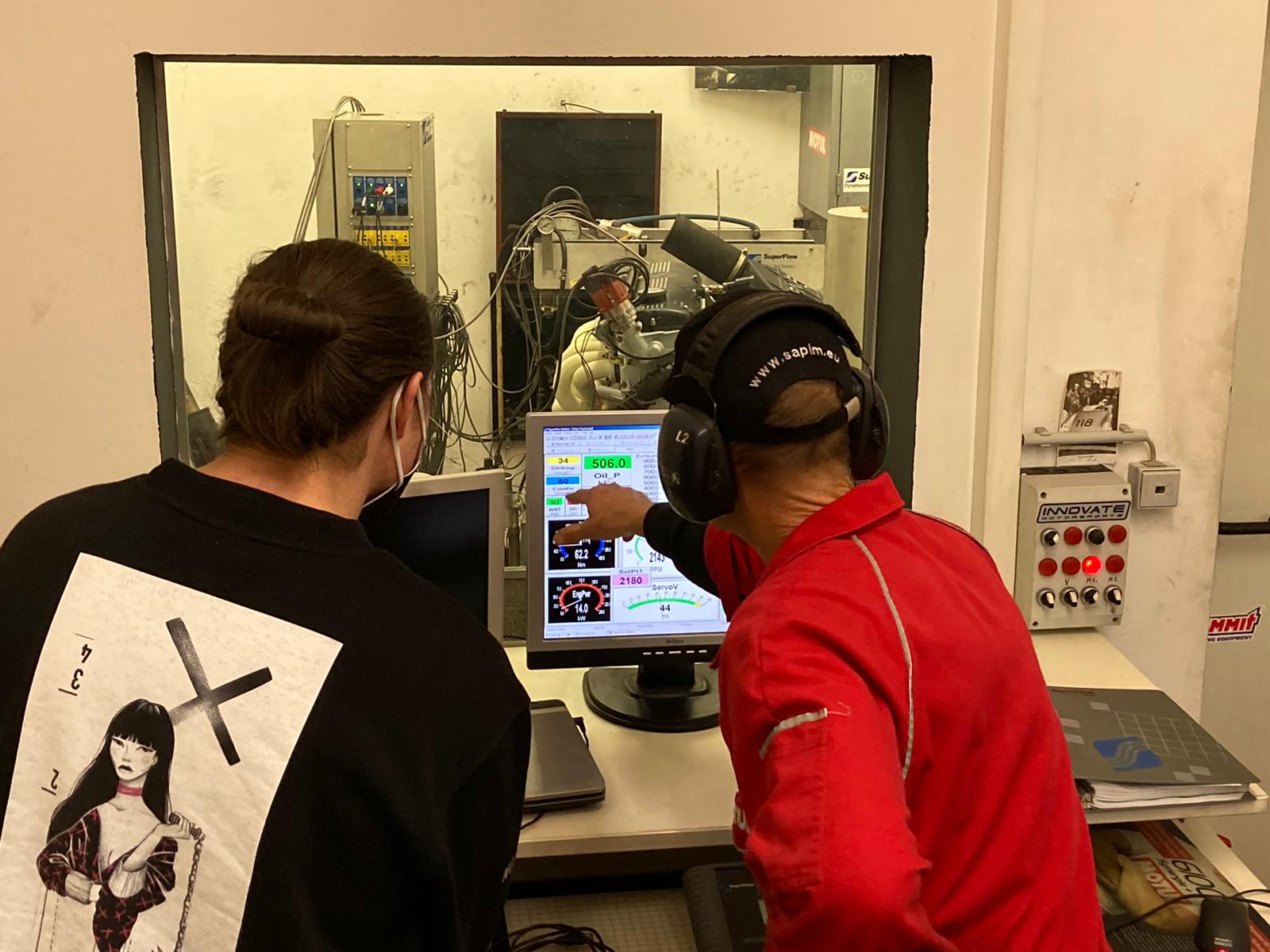

The tuner (Uli from Ital Auto) said the carbs are very sensitive but he has them dialed in now and sounding great! The engine has about 2 hours of running in time so far and will remain at these settings until its completed its run in time in the car. Final tuning will be done on the rolling road.
Super happy to see and hear it, and very pleased that everything went so well! :p

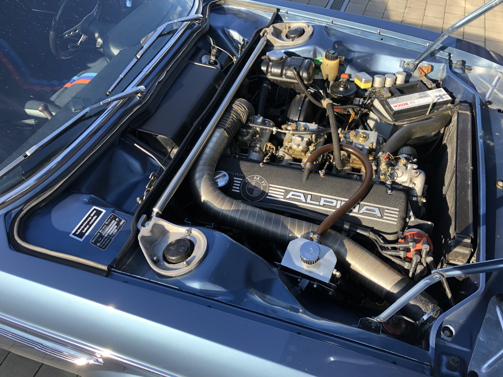

Hi, It's an Alpina B2 rebuilt to original spec.
Pinao top pistons
300* Alpina camshaft
Solex 40DDHT carburettors

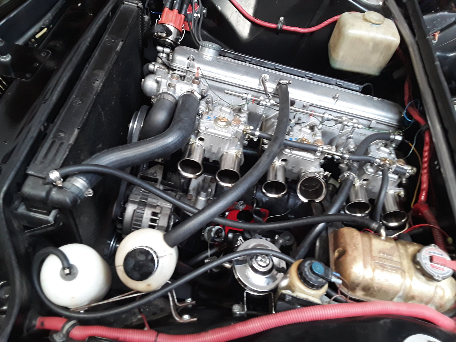

Our motors are very similar with the piano top pistons and 300* Alpina cam. I am running the 45DCOES and just had to do the funky single trumpet/velocity stack as per the 1970 SPA car.

I did buy the exhaust as a complete system, it’s made by classicexhaust.de in south of Germany. I had just the manifold ceramic coated which helped a lot with the heat but I guess we’ll see how the plastic tank survives.

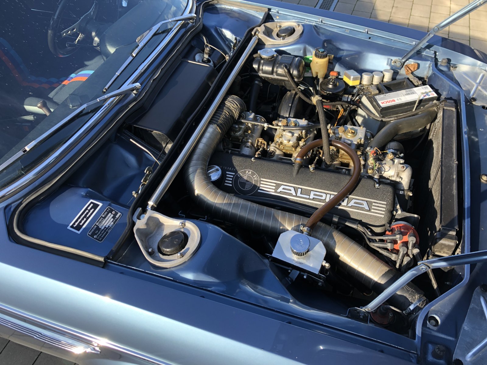

Sounds great, I’d love to see some pics!

A pic as requested James.
I also ceramic coated my headers (Jet-Hot) many years ago. Very pleased i did. My 50 year old wiper fluid container has fared well and heat in bay is definetely reduced.
The container's issues have not been heat, it has been where it mounts to fender well. I has developed a hair line fissure crack at mount point. It weeps to a certain point then stops. So it runs around a 1/3 full until I put some more goo/sealant on it.

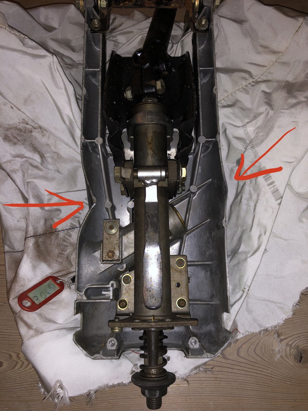

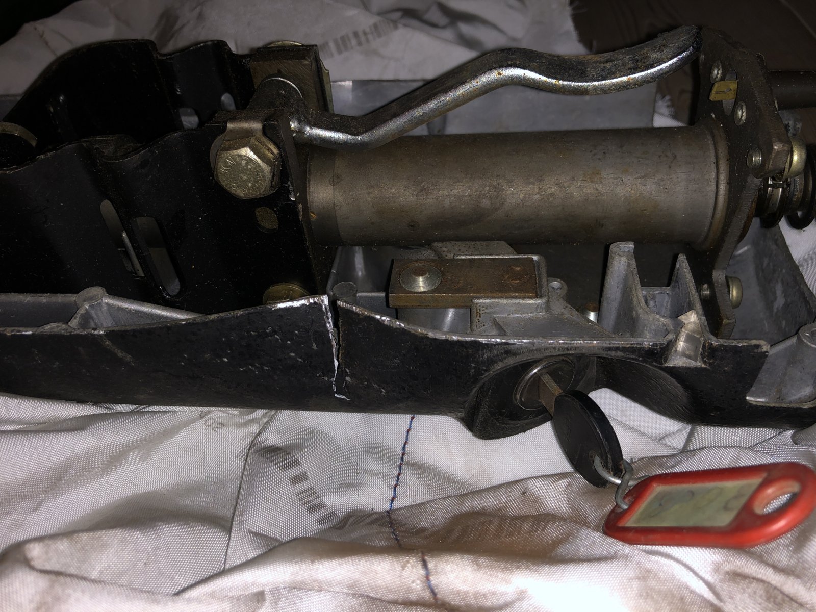

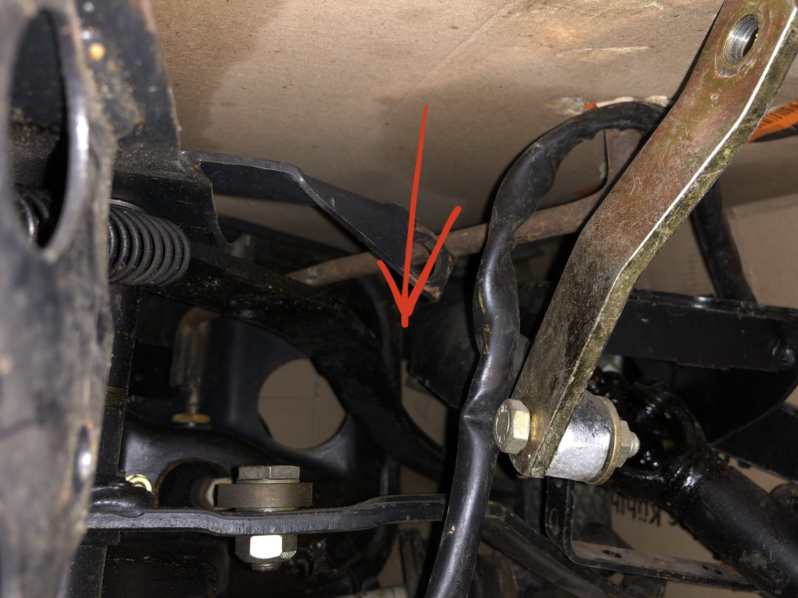

In December I bought a replacement steering column from a forum member in the states and unfortunately it never arrived and is still lost in transit.
2 weeks ago I got lucky and found another one in Germany. It was complete and in good condition with all the bits I needed so I bought it.. well it just arrived and disappointingly it was not packed well. The soft metal housing was packed right up against the hard metal pedal box and pressed into it like a tin can :(
Anyone had luck welding or soldering this pot metal? Hoping I can bend out the dents and repair it.
I wish people would take more care packing things, it’s such needless destruction. Feeling very annoyed!
Oh Man! FWIW, I think it is cast aluminum. Should be able to tap it back into shape and TIG it. May be better off procuring another.
Hmm.. I have a feeling it’s not just aluminium, it seems so brittle..
My original one is cracked in several places (hence replacing it) maybe I will try TIGing that and see if it works..
Don’t really fancy buying another one. This is already the second replacement I’ve bought and it’s not easy (or cheap) to find telescopic columns in good condition :(
