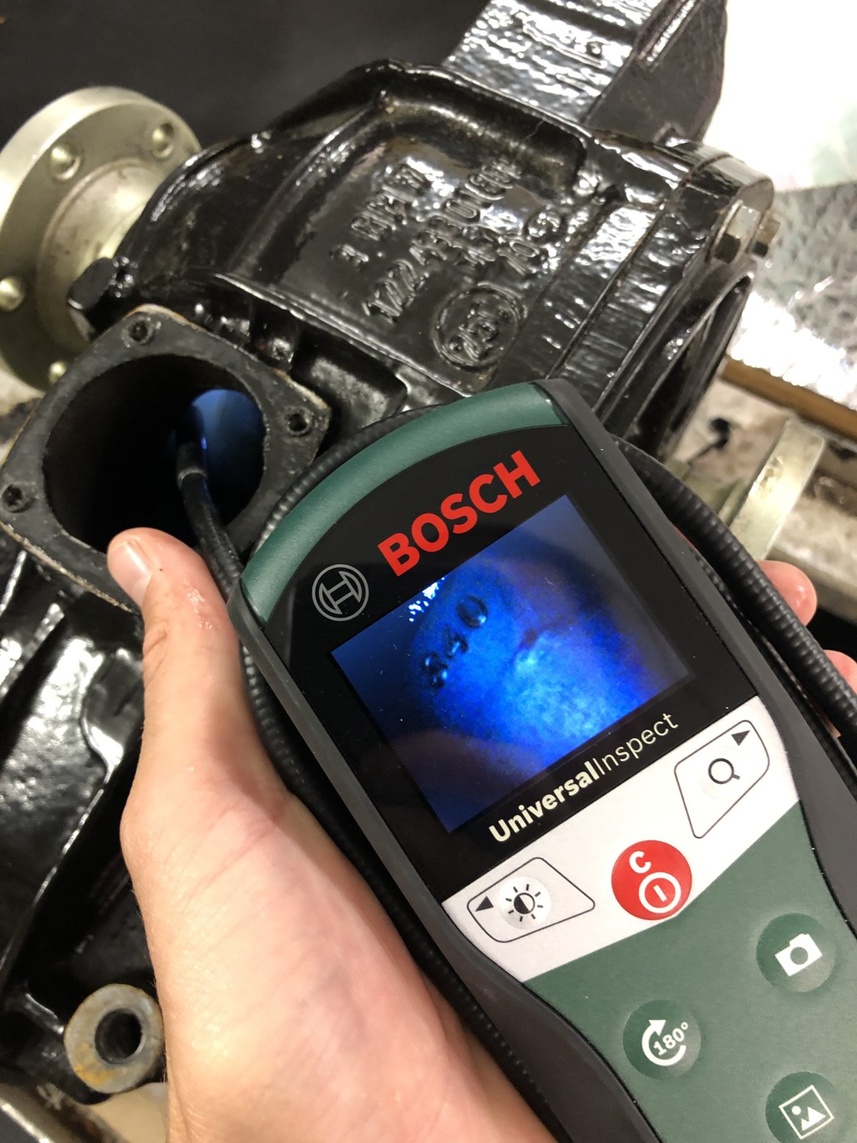

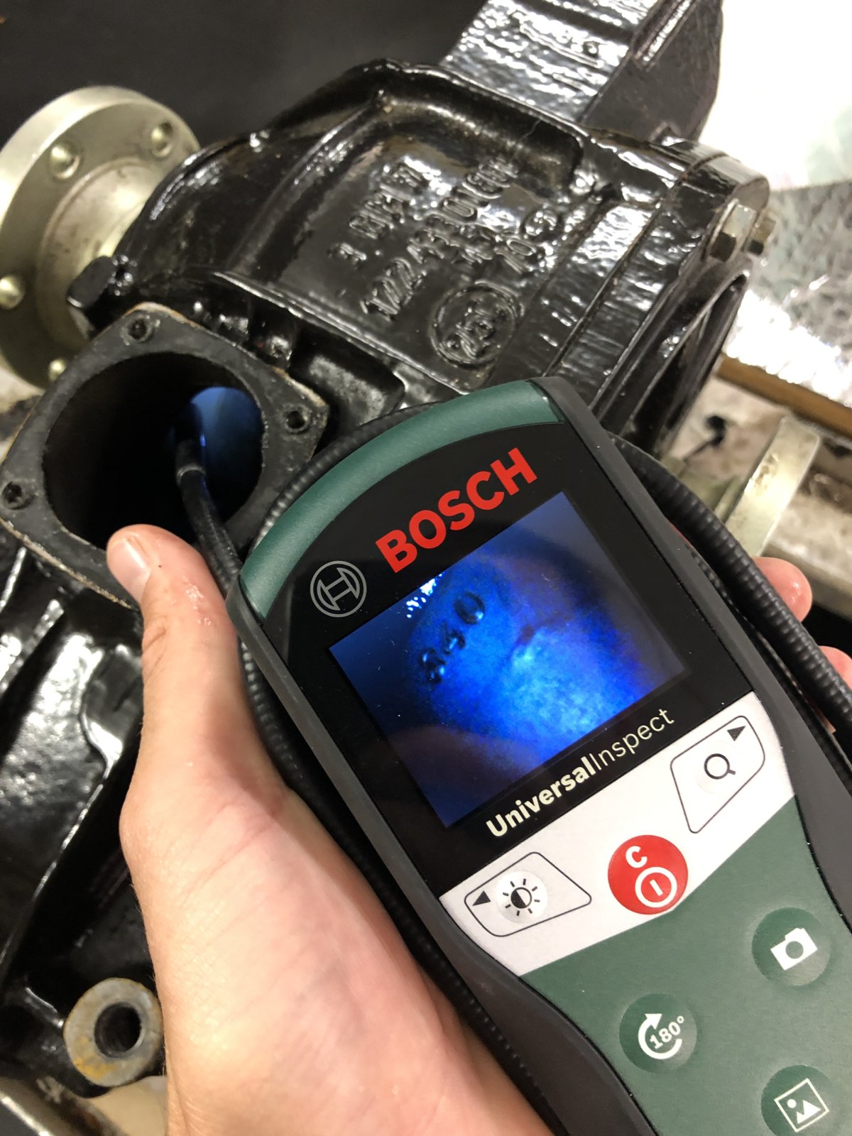

I picked up a 3.45 S diff a couple of years ago. Now I need to figure out if it is a 25% or 40%. Add it to my list...
You should be able to see if the diff has S25 or S40 stamped into the housing if you open the vent on top of the case + use a flashlight.

Thanks guys, it’s 40%
you can actually just see it without an endoscope, but it’s not easy to take a picture haha
Sorry to dilute your thread. Just wanted to share the alternative. I checked mine thanks to @Gransin method. Unfortunately I found that mine is a 25% model.

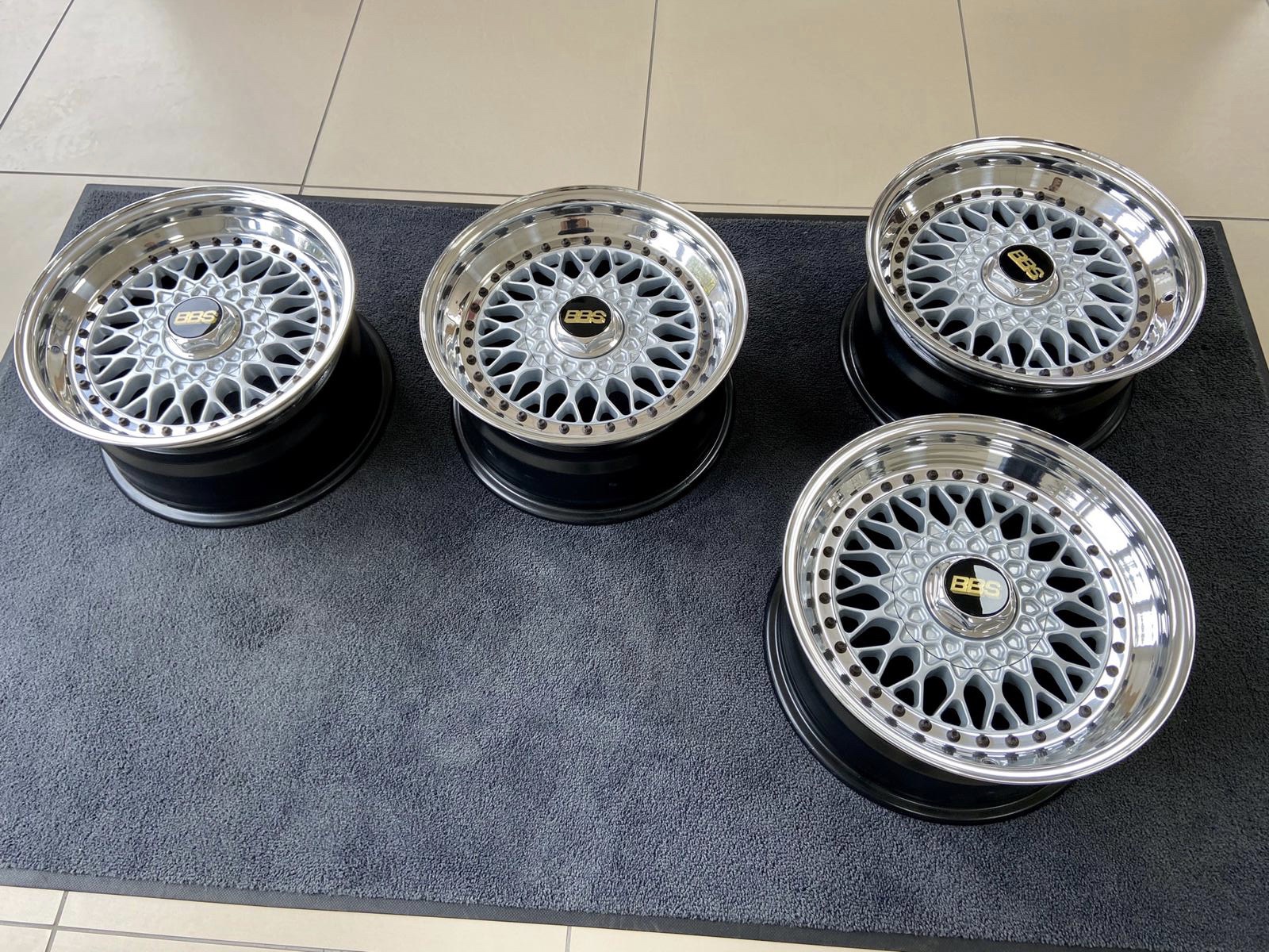

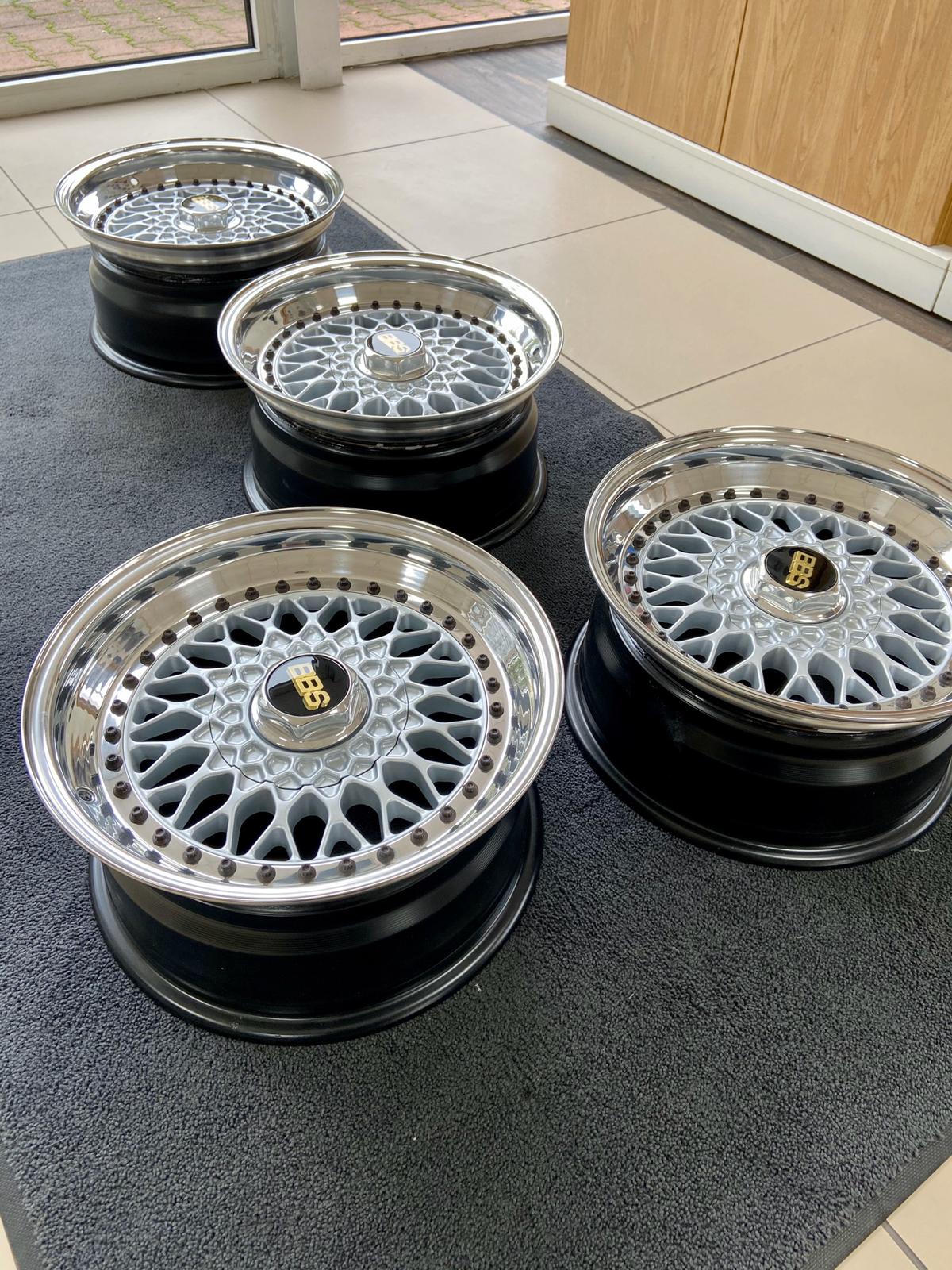

I also picked up these original 16x7 and 16x8 Alpina B7 wheels locally
I have been planning to find another set/pair and run 4 x 16x8 Alpinas.

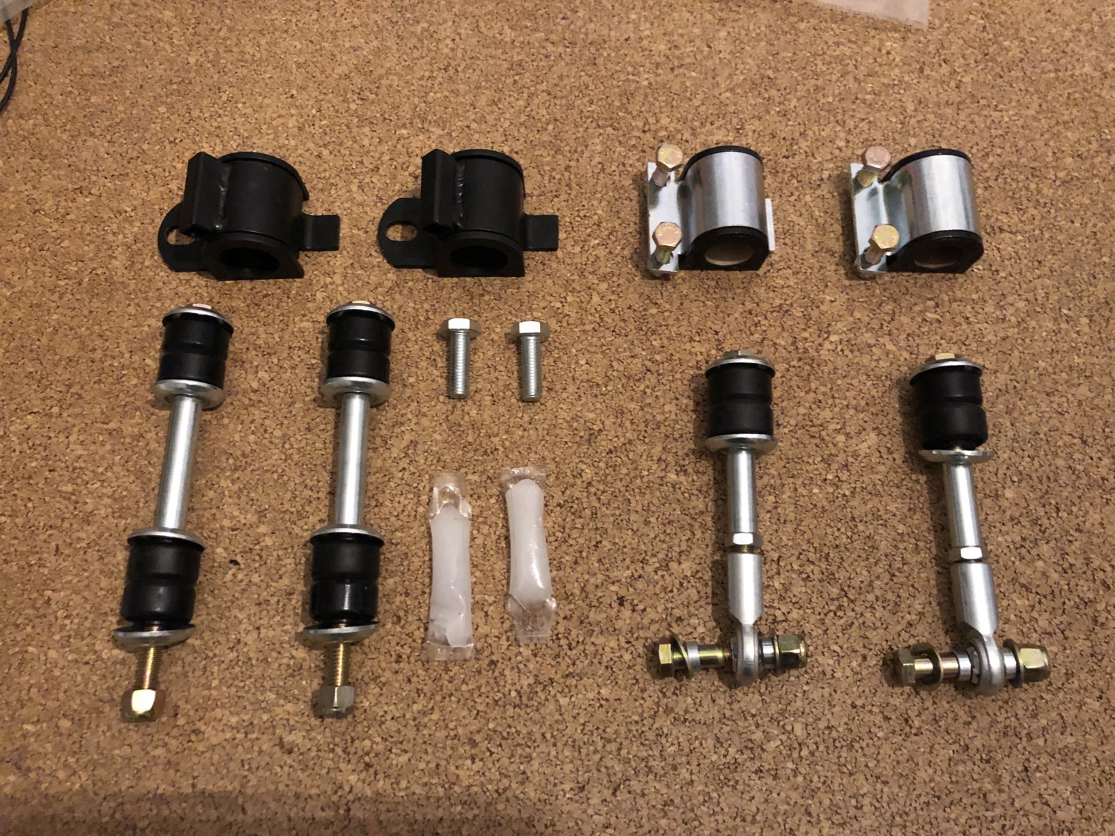

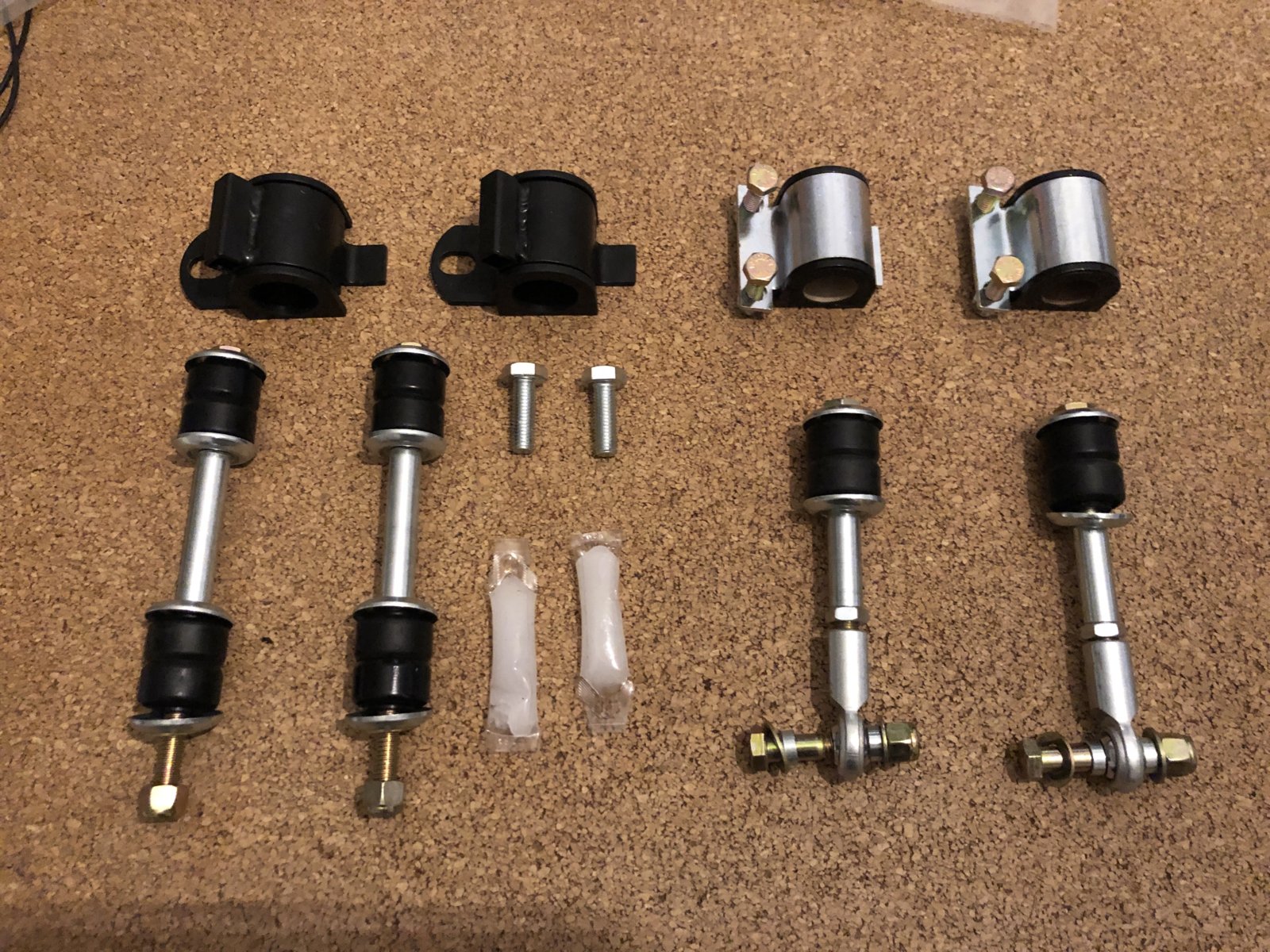

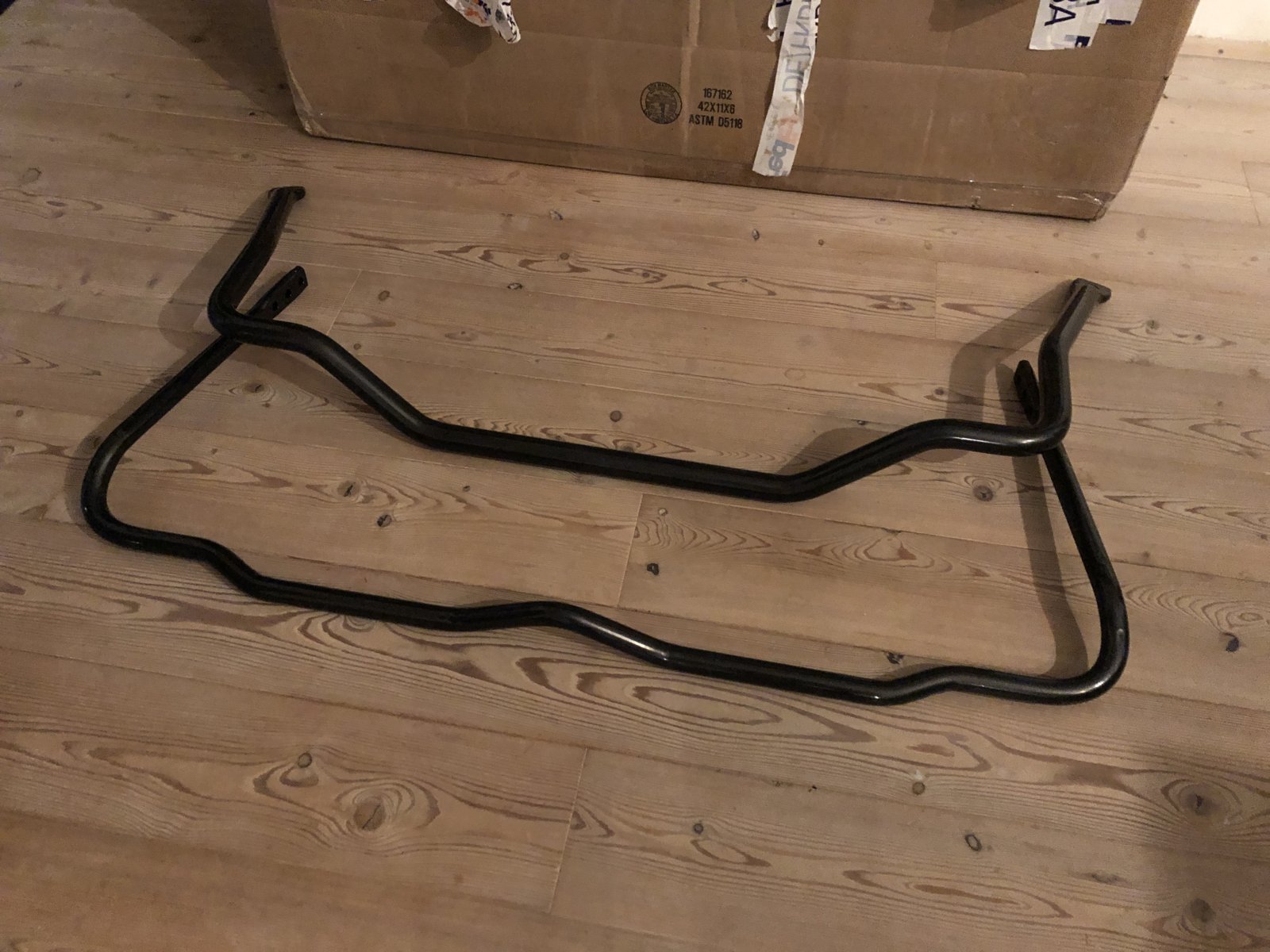

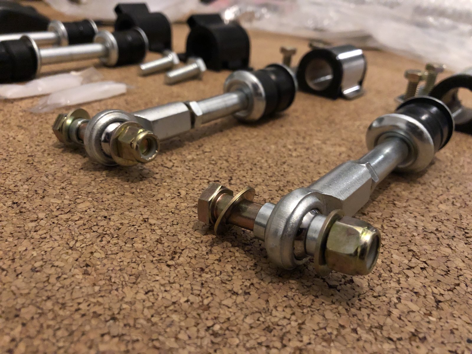

The adjustable suspension techniques sway bars finally arrived from ie Motorsport after almost 4 months waiting... they look great though. Looking forward to installing those one day..
James--I just had the restoration shop install both of these anti-sway bars in my Coupe. The square tubes on the front bushing holders must be cut off to clear the subframe. That's why they are not listed on the ST website as fitting the E9. They will fit once those tubes are removed.
Awesome, thanks for the tip!
