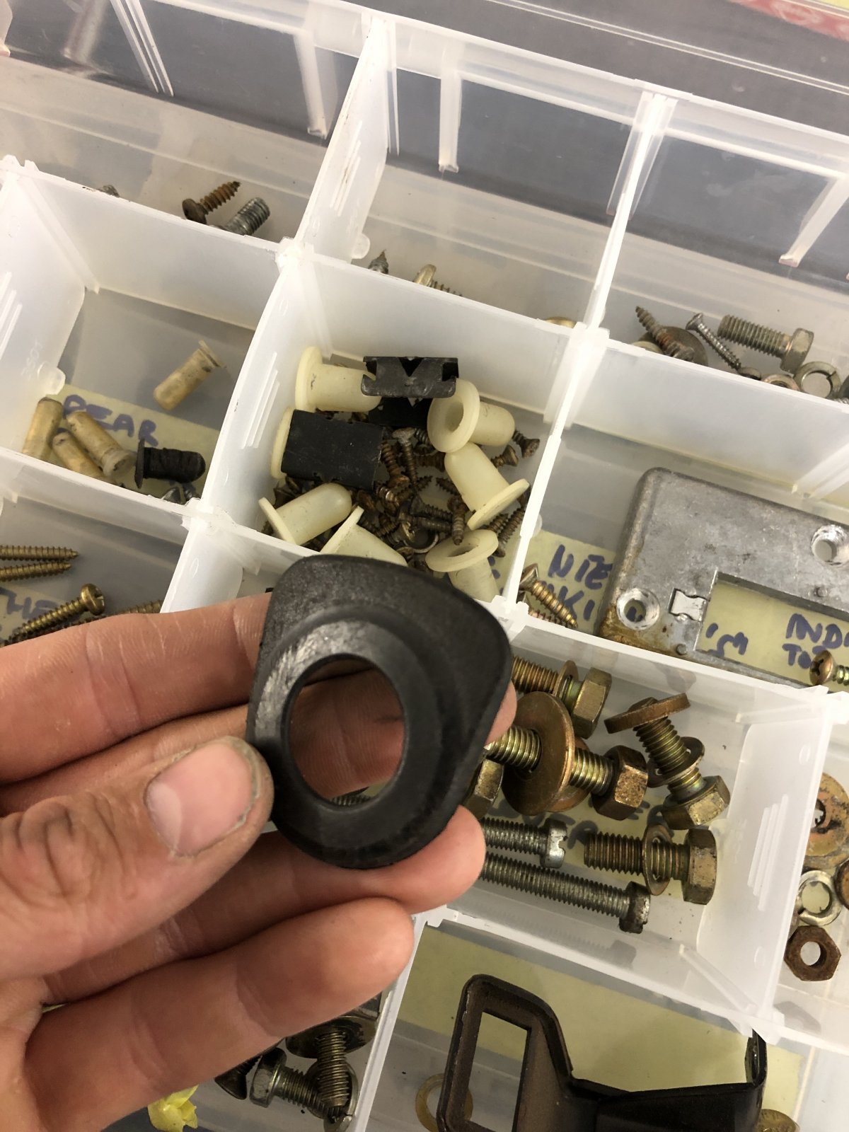

I’ve been digging through my boxes and boxes of hardware checking which little fasteners and screws I’m still missing and realised I do actually have the original key surround! Haha
Of course it’s not in perfect condition but I’ll see what I can do about that..

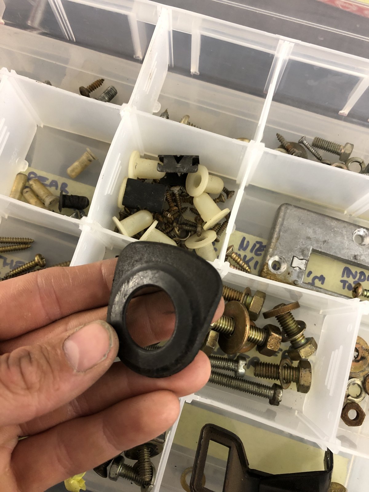

That key surround is from an e12. It fits but not perfect.
Hmm.. Ok thanks. So the e9 always has the “fahrt” text? Do you have any good detail shots of the original?
I’m happy to make do with the e12 unit until I can find or make a better fitting replacement. I actually prefer the look without the text..

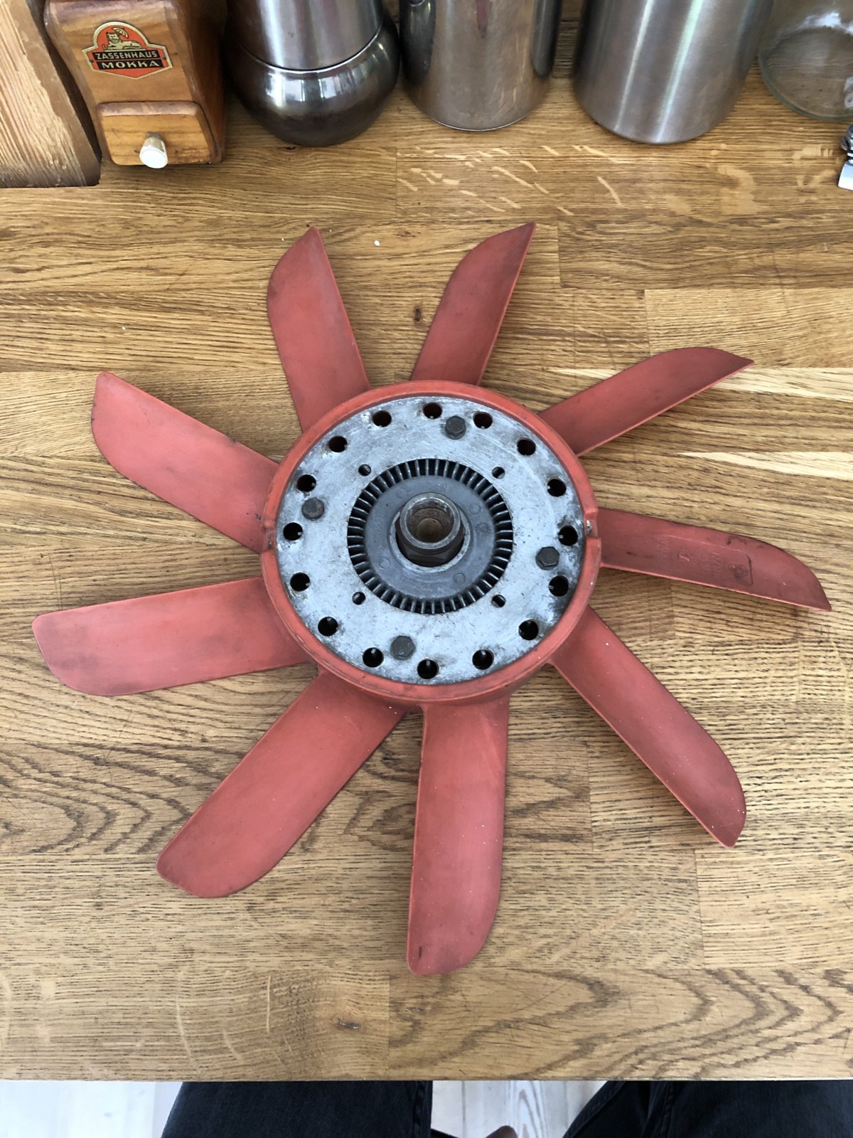

Bought myself a red 9 blade fan. (Payed way too much haha ) It’s in really good condition though, just a bit dirty and dull.
Any tips to bring the red out and make it look as good as possible?
I’ve read about people sanding and polishing faded plastic, and also hitting it with a heat gun or blow torch which produces amazing colour results however reportedly only lasting a limited time.
I’m leaning more towards the sanding and polishing, but I’m aware there is only so much you can do..

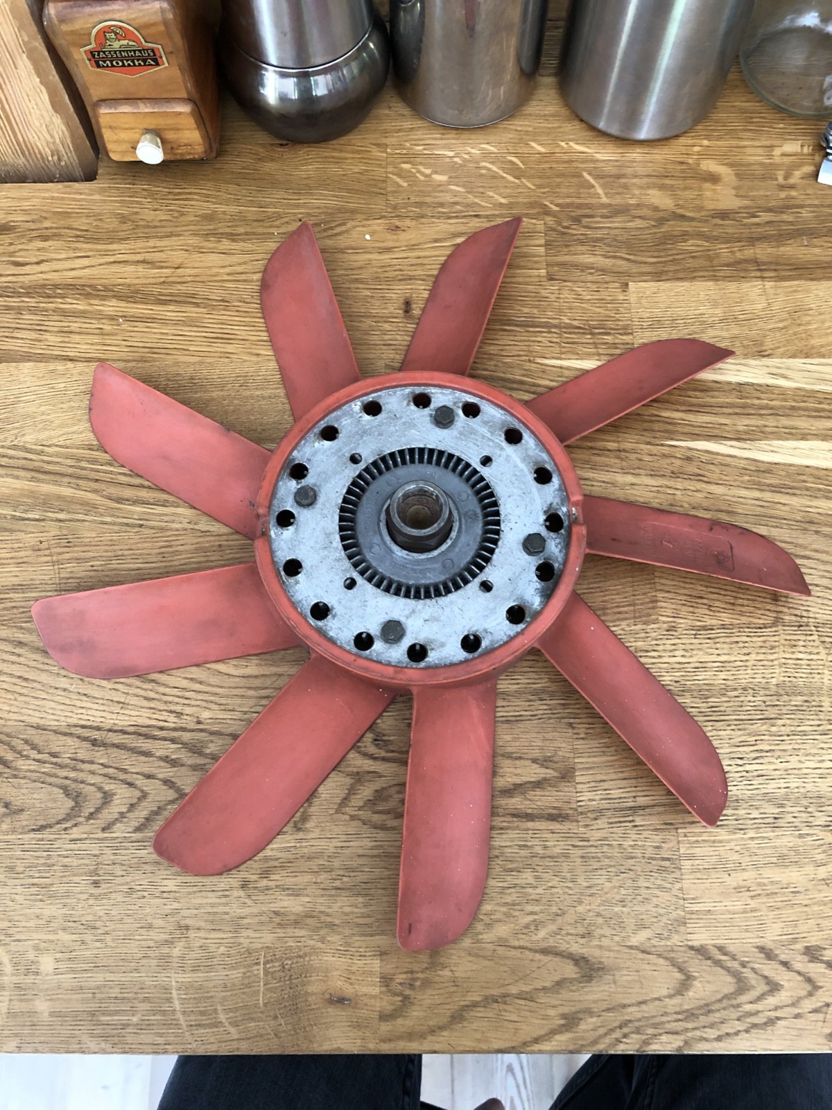

I cleaned mine with WD-40 and #0000 steel
wool. I think the 9 blade plastic is somewhat different from the five blade. The five blade cleans up very well.
You could try a headlight polishing kit.
Thanks, yeah it’s definitely different to the 5 blade. The 5 is a deeper glossier red, very nice. This one is definitely more chalky and pink. Oh well I’ll see what I can do.

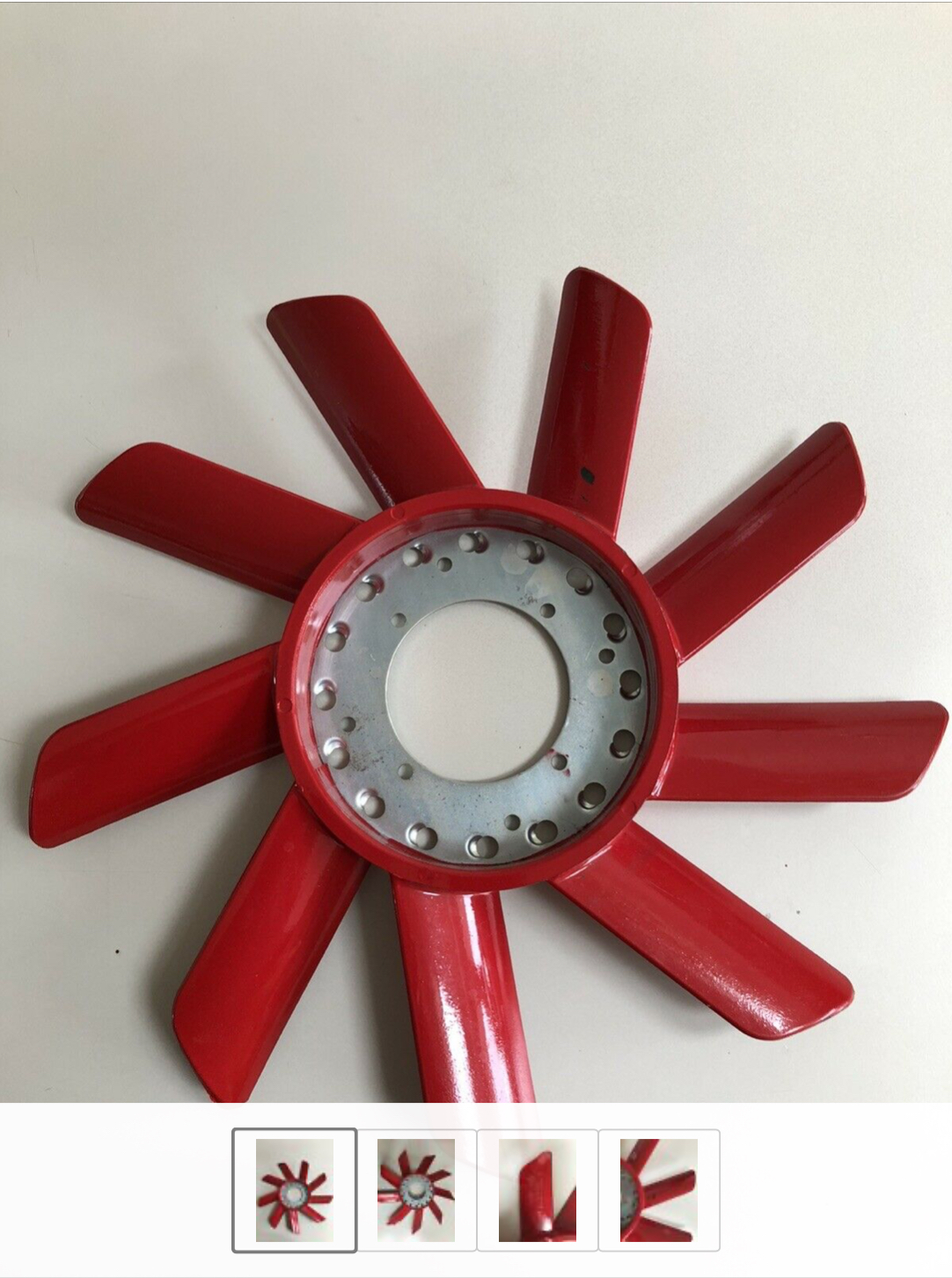

This is apparently been painted (Ferrari fire red) .....found on eBay.
I just don’t see a painted fan lasting very long, it takes quite a lot of abuse from heat, oil vapor, and debris. I clean mine when I polish the valve cover - every few weeks - in order to keep the stains off.

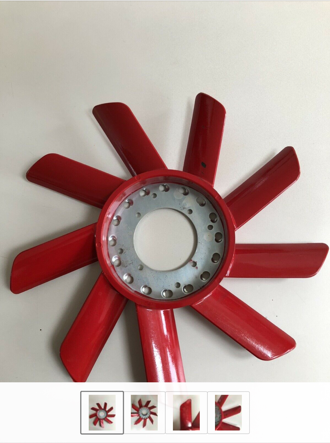

View attachment 97212View attachment 97212
Yes, that paint job looks a bit heavy handed. Not was I was gently pondering. I agree this is a tough element that gets beat up from several elements. The whitish chalkiness is presumably the plastic's lack of perfect resistance to UV. That is a hard thing to reverse.
Thanks for the suggestions, I think I’ll try sanding/steel wool and some products to bring the colour out rather than painting it. I can alway paint my black fan if I wanted to go the route, I have seen it done before with good results (better than the Ferrari fan above) but still longevity is a question. Would have been ok for a temporary solution though.

Scotch brite and silicone cleaner first, then Wd40 and steel wool, followed by polishing with a cutting compound.
I also repainted the steel centre plate with silver zinc spray. I think this is as good as it’s going to look. Pretty happy with the outcome.
It’s still an orange hue, the plastic was never truly red to begin with. You can see the comparison with the original 5 blade below.
