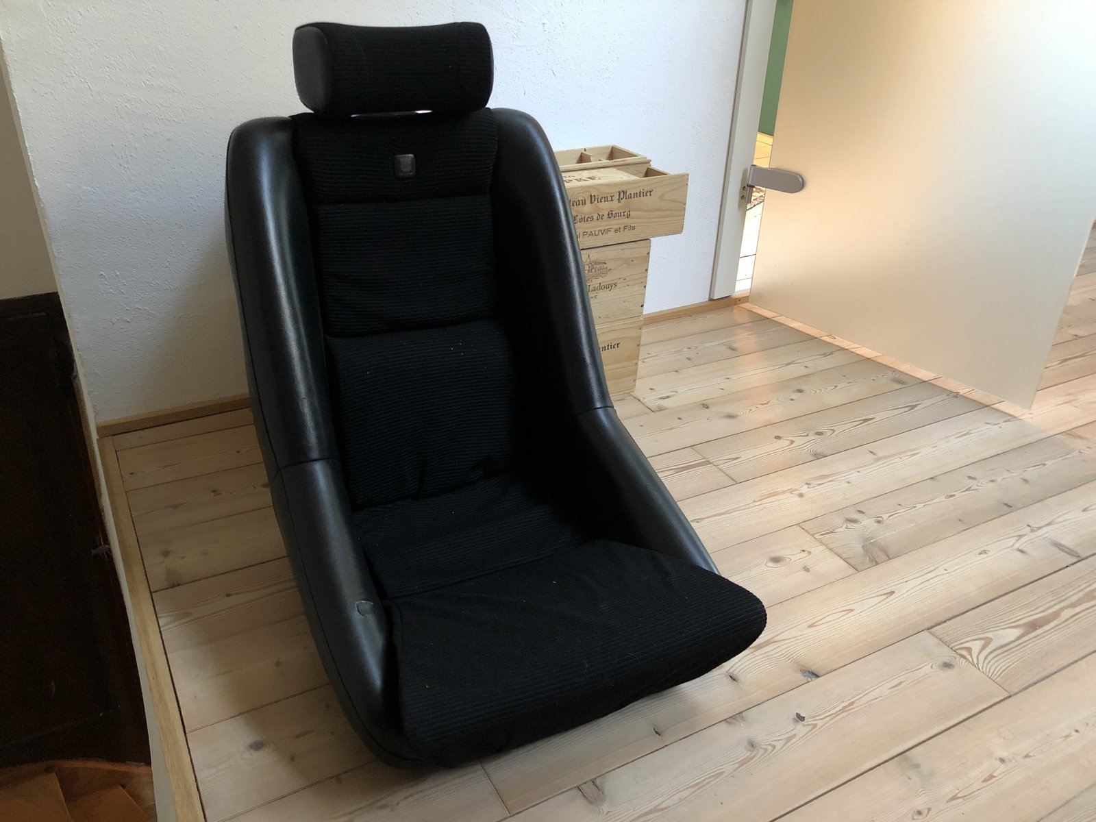

This guy on the left could be a match. Get some decent pics. Very good price and you can unload the ASS seat on the right.
Thanks Markos, I Actually already messaged him but that price is for one seat only, with no headrest and the wrong rails, badge on the bottom is missing too. Looking for a better deal than that. I still have time so happy to wait for a better one. Singles do pop up here and there.
Interesting. Gerrit makes headrests. The sliders aren’t super difficult to find, but factor in several hundred euros more for a set. I’m curious though, what bottom badge are you referring to?
I believe there was a metal plaque on the bottom of the backrest stating the model/part number. (?)
I’m not looking for a perfect specimen, complete interior will be retrimmed anyway.
The point was just that €1500 is too much for 1 incomplete, average condition seat.
Thanks anyway for the link, for the pair it would indeed be a reasonable deal. But singles do occasionally come up for sale for far less than that (hence why I now have one haha) and I’m in no rush so I’ll keep searching a while
