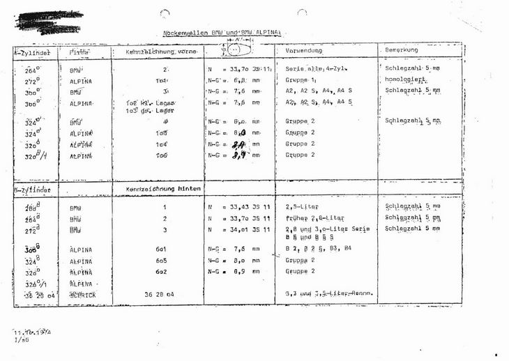

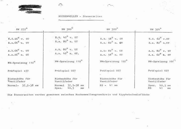

Here is a very bad copy of an Alpina document from 1974, with the specs of their camshafts.
Our 300° camshafts should have "601" engraved on the rear end.
My camshaft also has 2582701.
They are very likely identical.
300° was the standard camshaft for all 3.0 engines.
348 and 351 could be references to the production runs.
