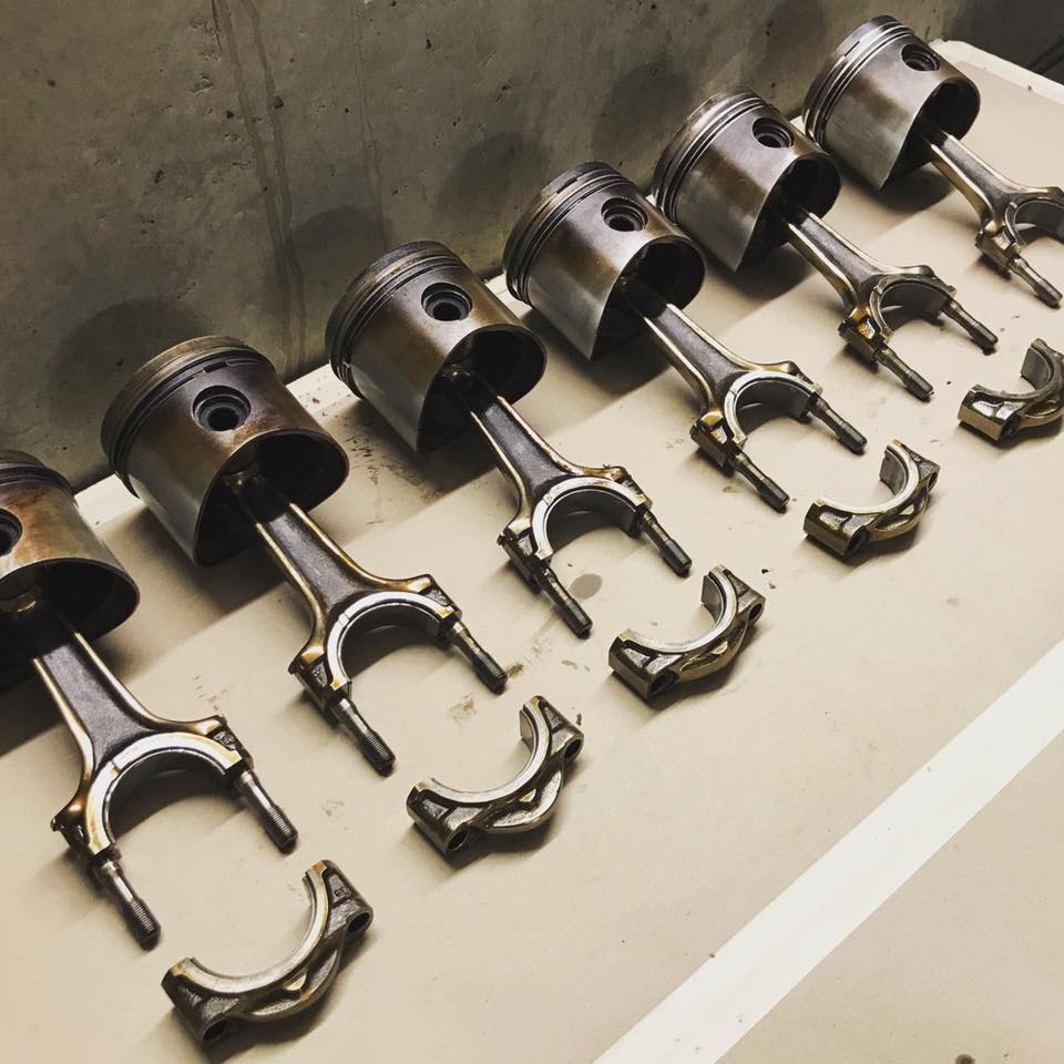

My engine is currently completely disassembled with various bits at the workshop and a load more parts in my garage, here you can see here the nice polished conrods:

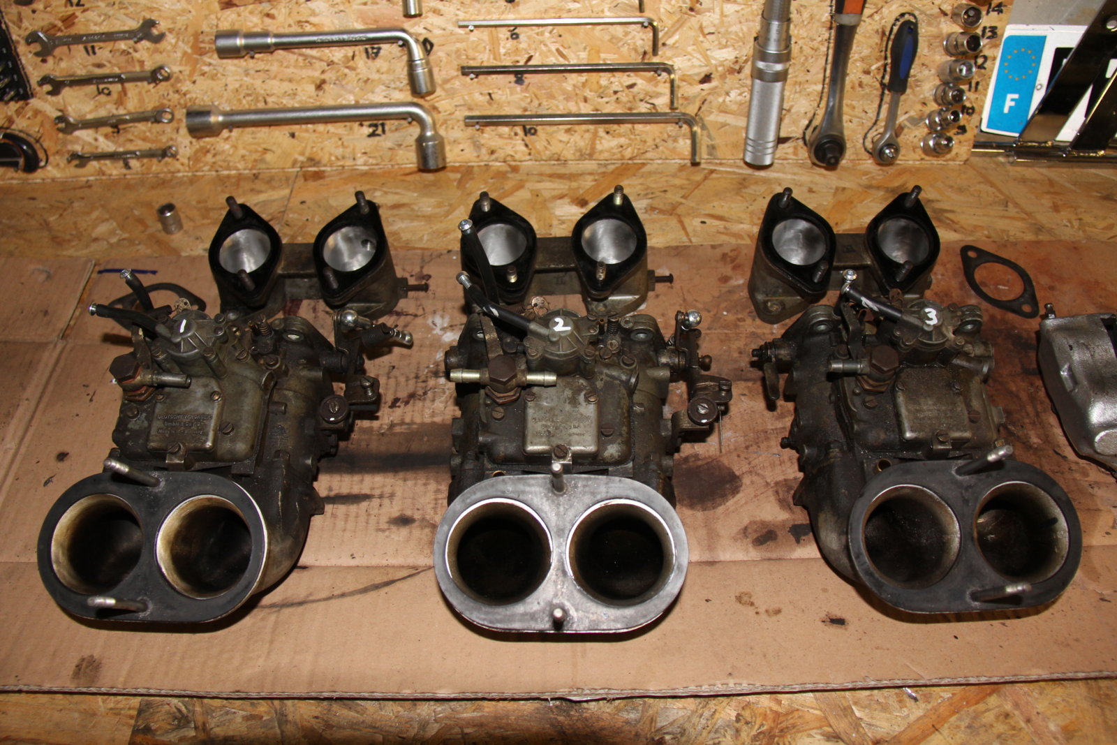

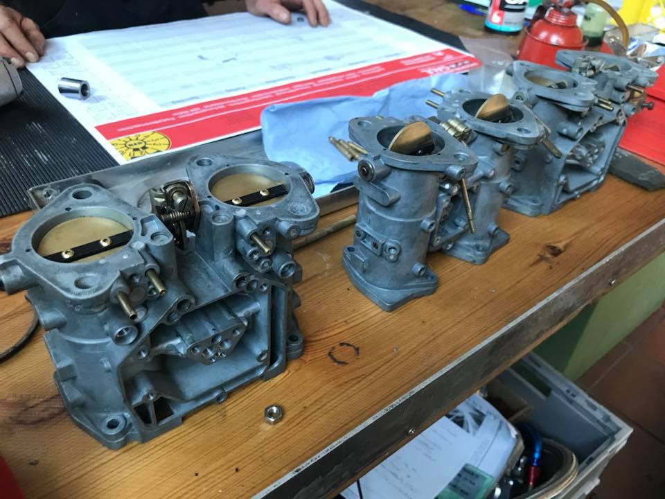

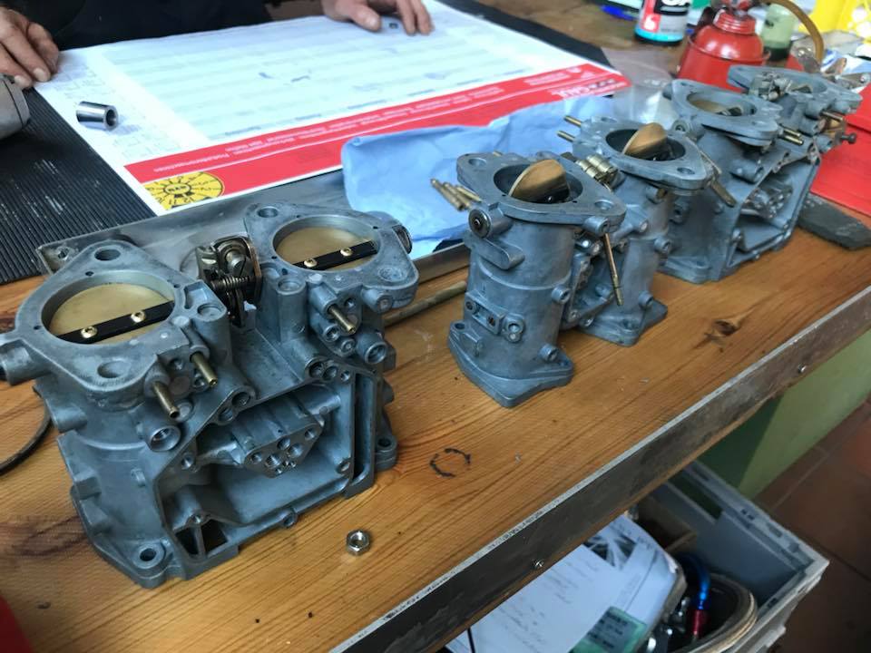

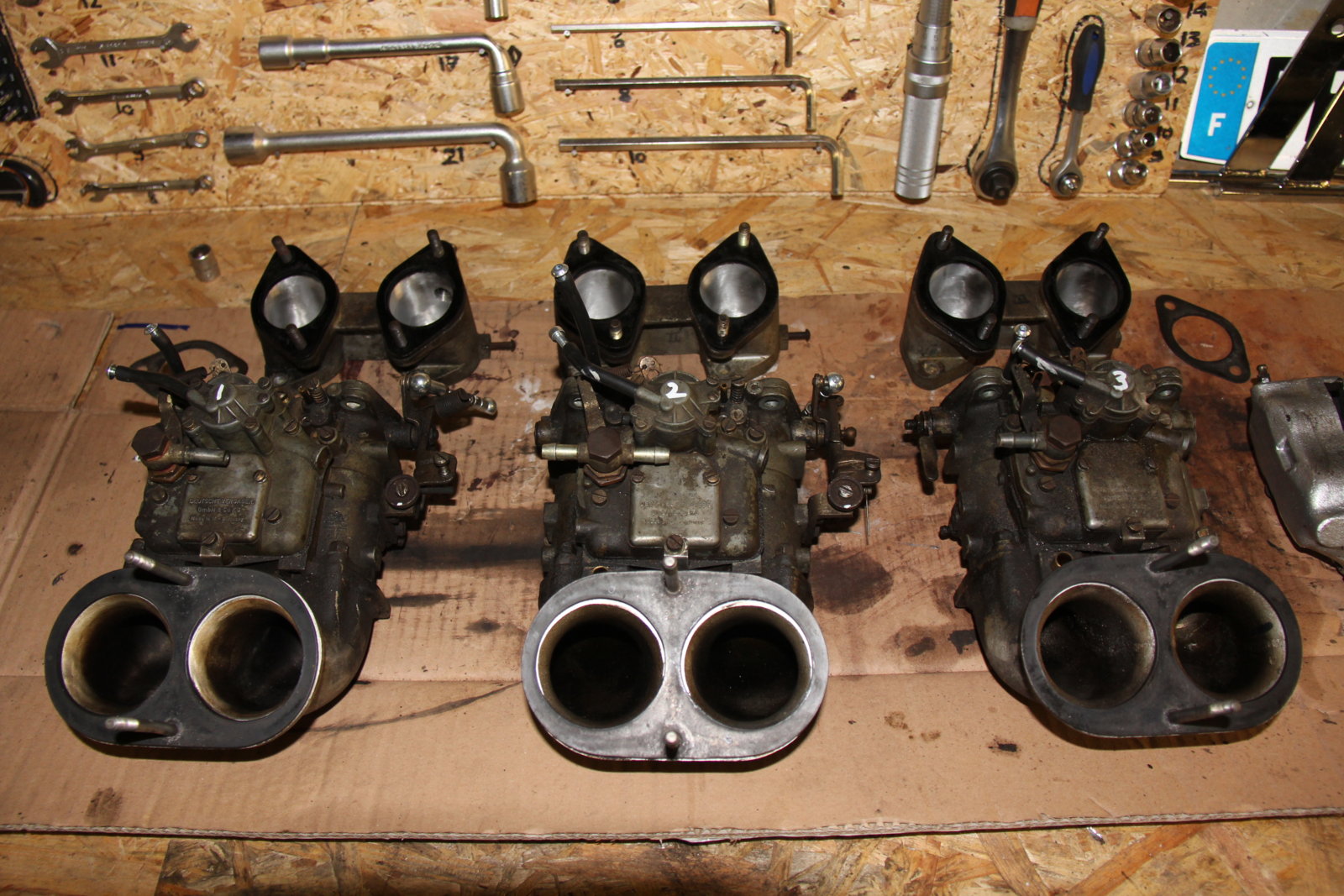

and then the triple solex DDHT carbs, here are mine removed from the engine and in the process of being rebuilt.

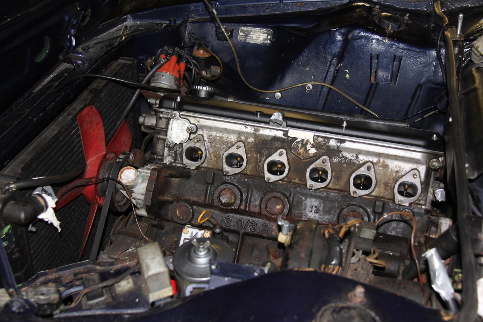

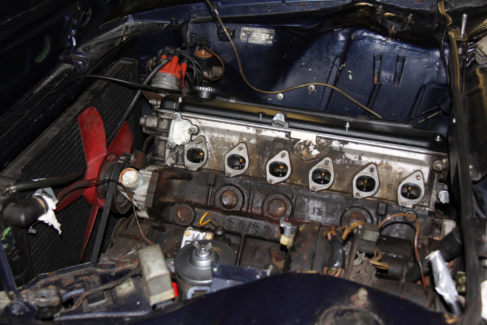

You can see the porting on the intake side of the cylinder head here, there is also no provision for the mechanical fuel pump as the original 3.0CS had.
If anyone notices anything interesting or different in my pictures or info please let me know, Im still learning a lot about this car!
I am surprised that a 300 degree cam, ported head and triple cars only netted a 30 hp increase from stock. I would have thought a bit more???
The head in my car has clearly been replaced, build date is 1980, it appears everything else has been kept together with the b2 block. Will hope for around 230, but won’t have a clue how much power it’s making until it eventually hits the dyno for tuning.

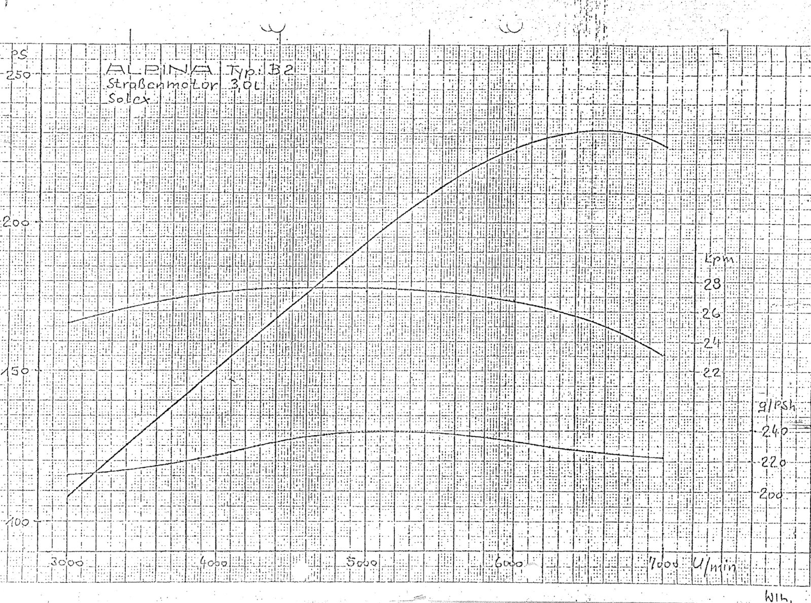

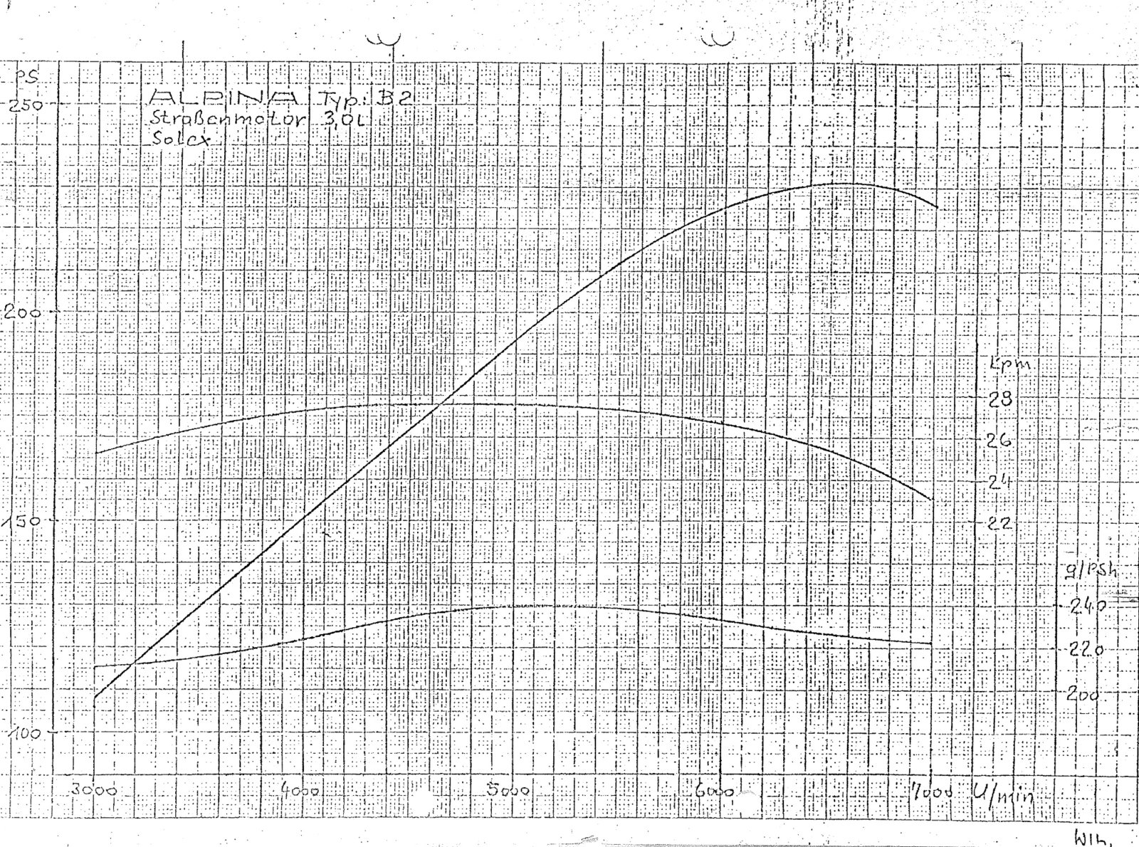

Regarding the specs of the B2 and B2S here is an answer I got from Alpina some time ago :
B2 and B2 S both had a compression 10.0 :1.
The piston of the B2 is the standard piston of the 3,0 CSI.
The B2 S had a special ALPINA piston (with valve pockets), which is unfortunately not available anymore, since many years.
The cylinder head of the B2 is the standard BMW cylinder head and the cylinder head of the B2 S is a special ALPINA cylinder head.
When they say a standard BMW cylinder head for the B2, they mean that it was not hemispherical like in a B2S.
But it was ported, I believe. This is why the period documents mention a "special Alpina cylinder head".
My B2 from 1974 had CSi pistons, but they were modified with valve pockets.
Attached :
- general specs for the B6 and B2 in the E12
- data sheet for a B2 engine in a 1977 E12
- power and torque curves

Thanks for the info.....thinking about it it wasn't a 30 hp increase because the carburettor cars only made 180 hp from the factory so that makes it a 50 hp increase which isn't an insignificant increase. I wonder how much a fuel injected car on itbs would make with a 300 degree cam? Have any members gone down this route?
