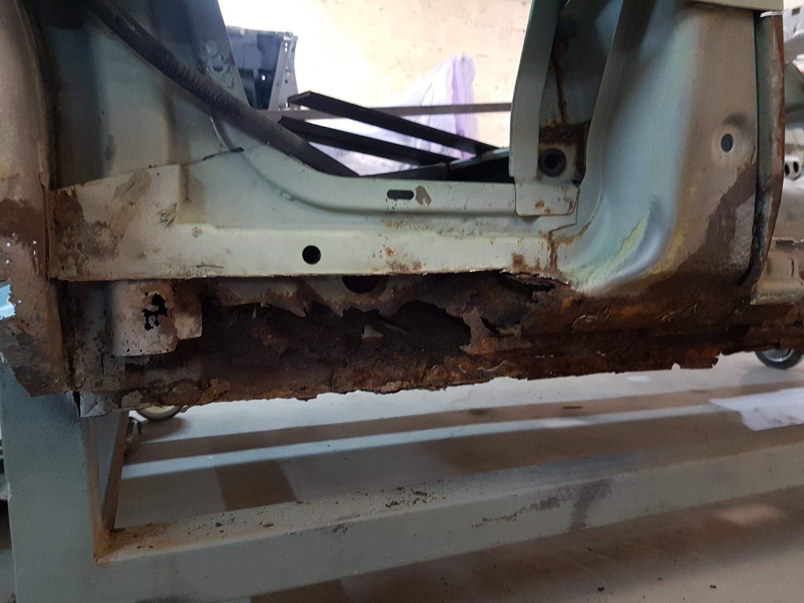

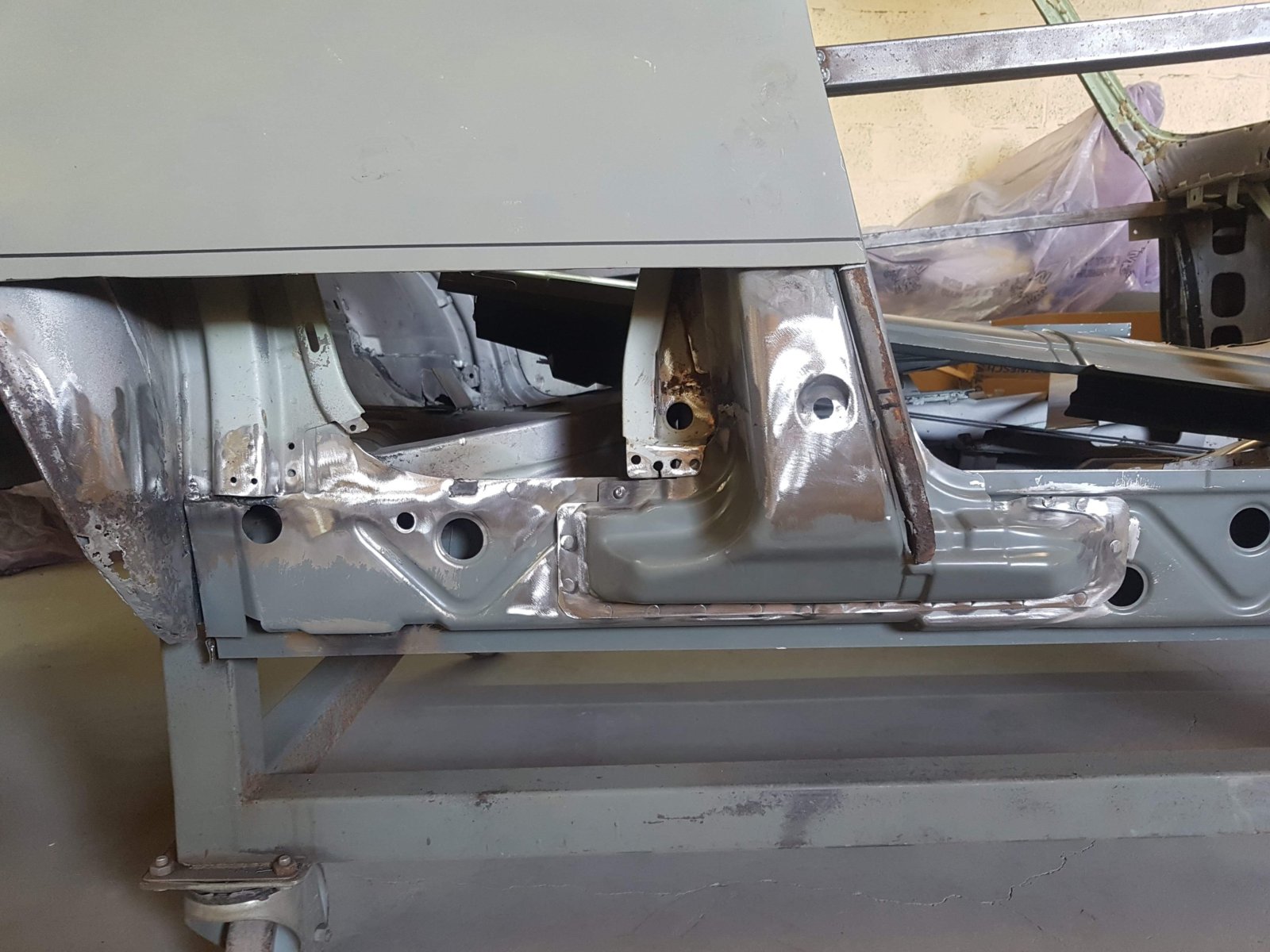

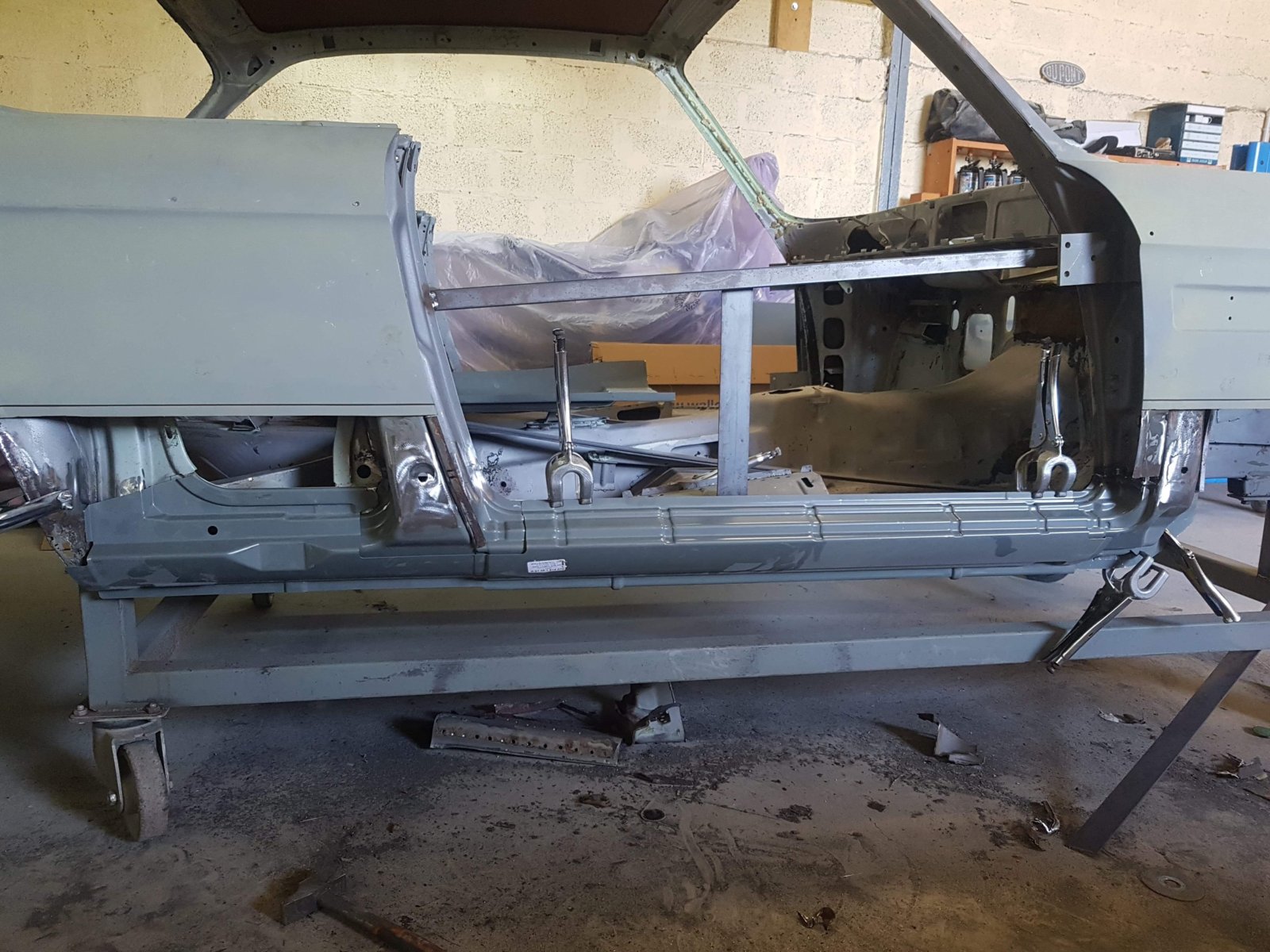

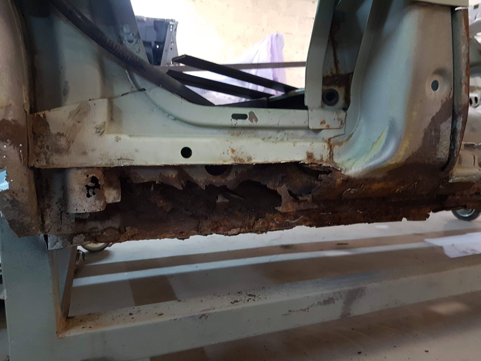

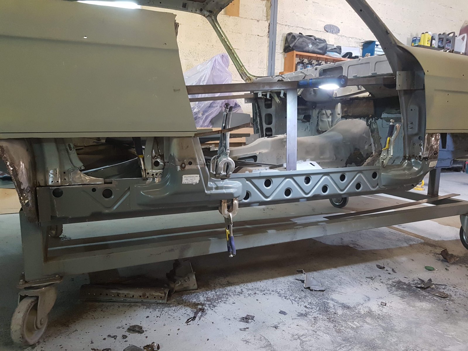

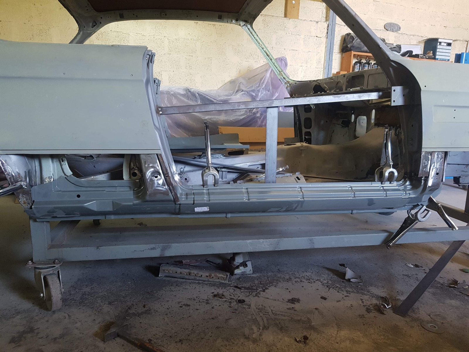

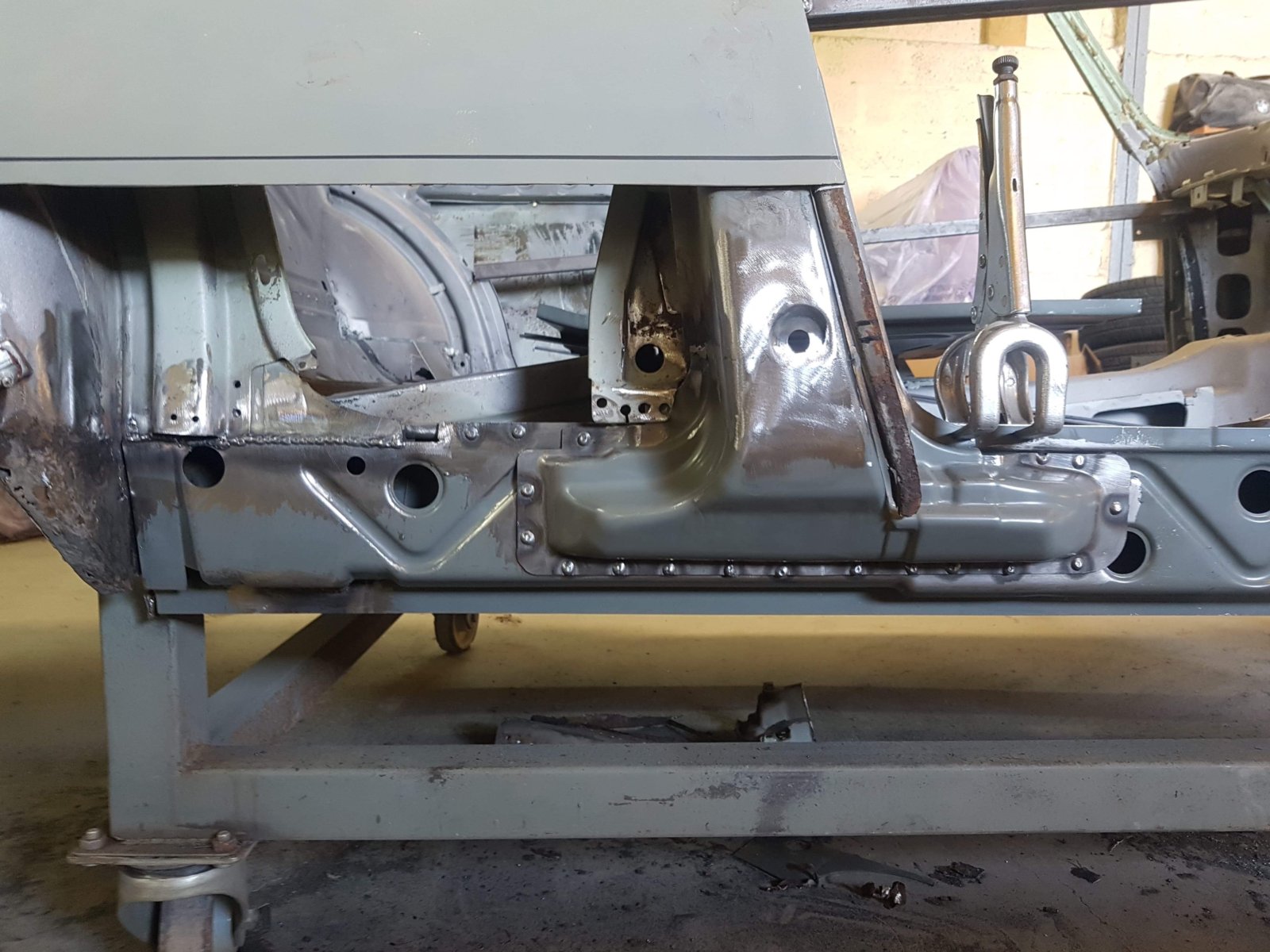

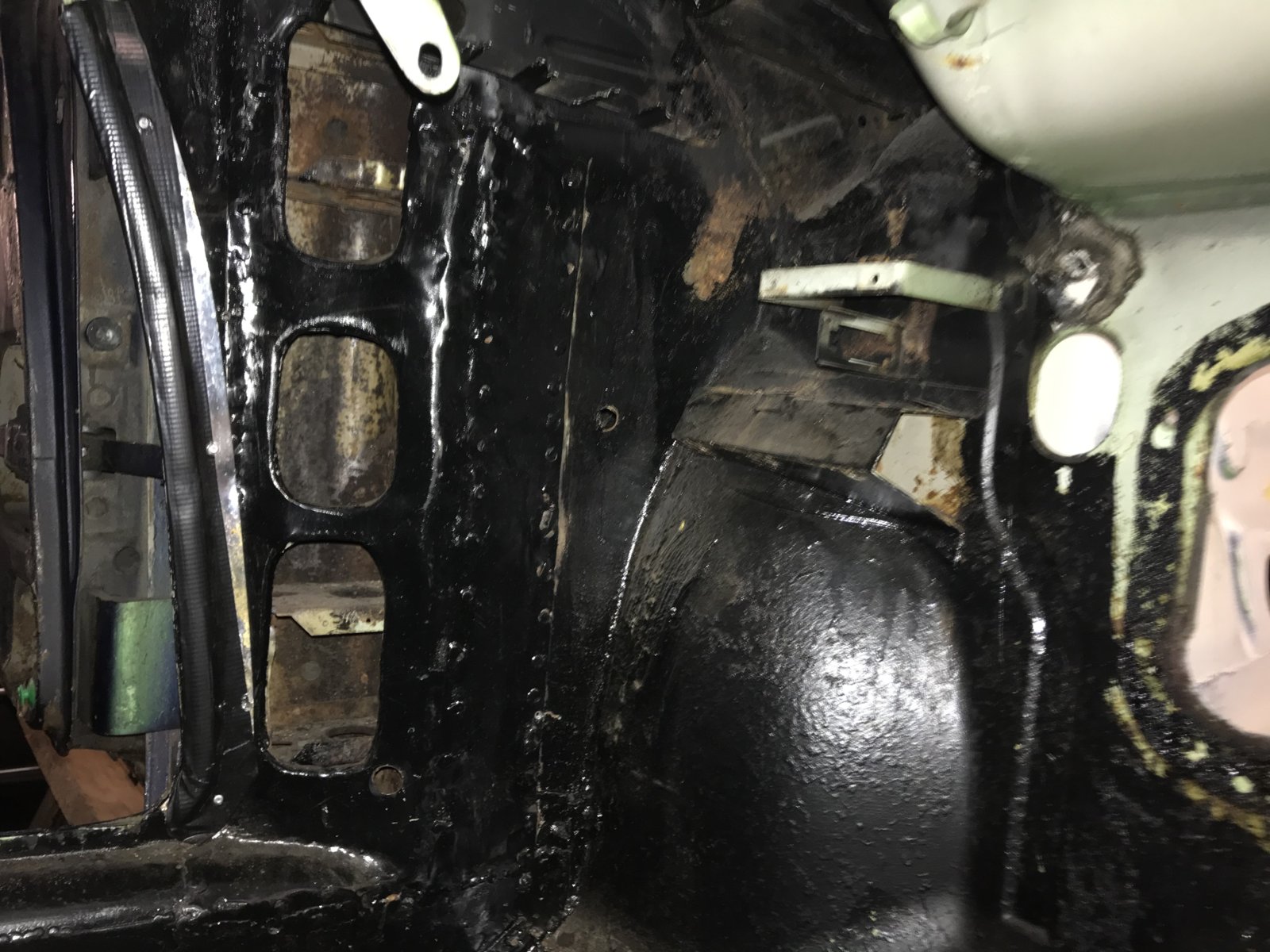

Got some updates from the body shop!
View attachment 64537 View attachment 64538 View attachment 64536 View attachment 64540
View attachment 64541 View attachment 64539
These are the posts that inspire me the most. Seeing the corrosion (that I personally feel lurks in all of our original cars), and watching it be transformed/fabricated into a "better than new" condition - to be enjoyed for decades to come. Love it - looks great!!!

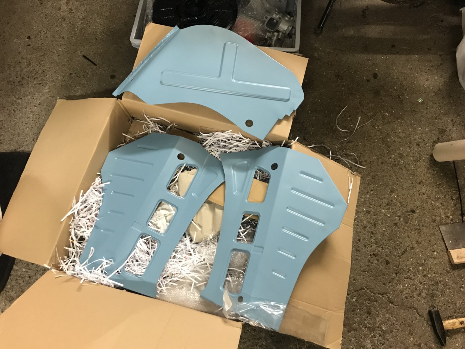

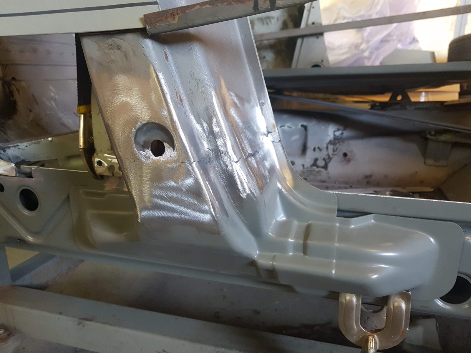

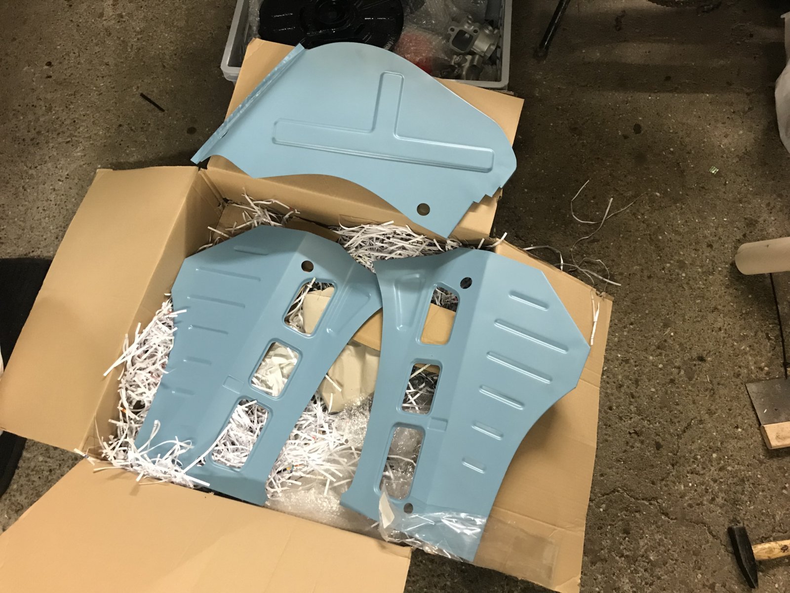

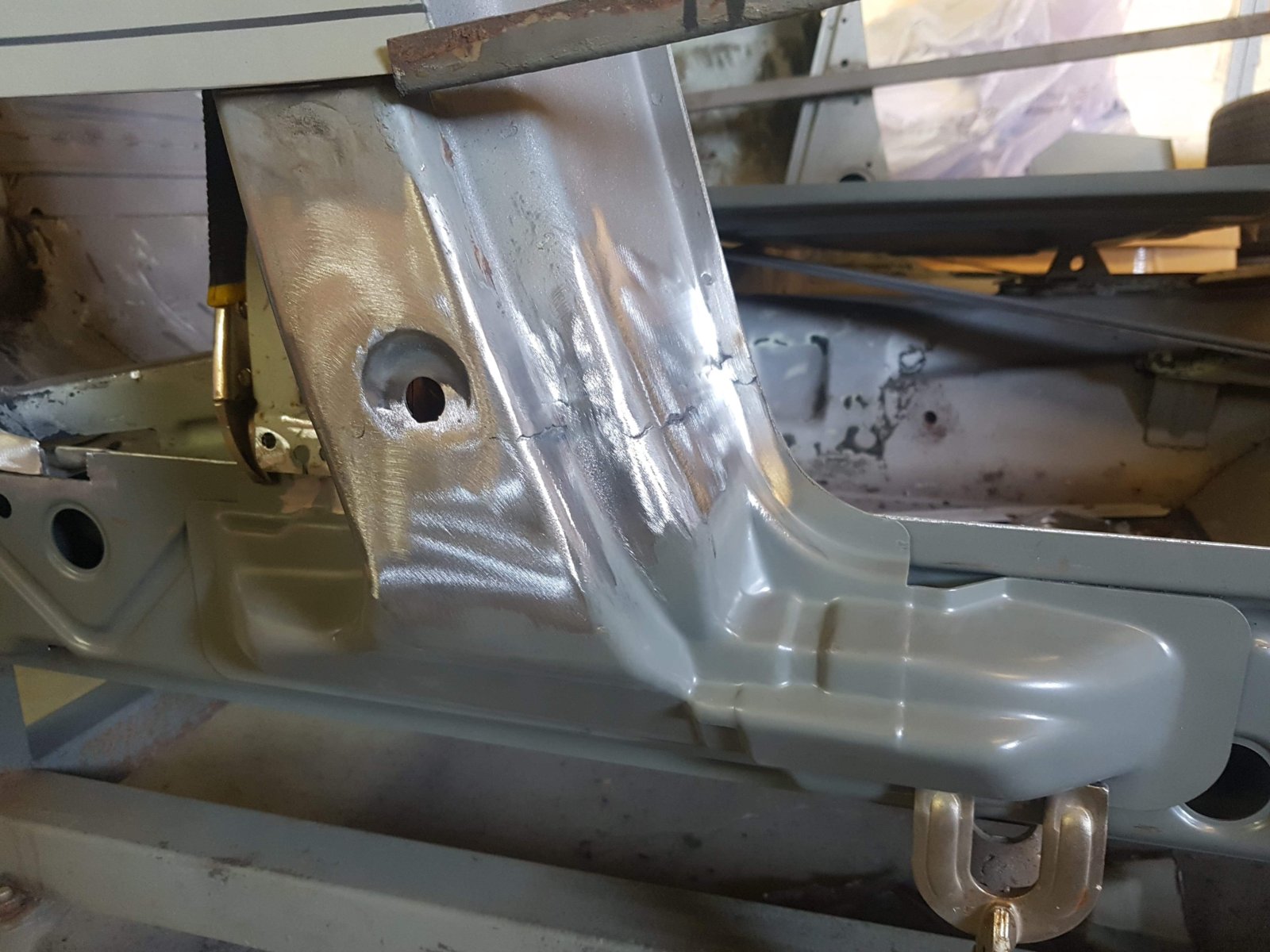

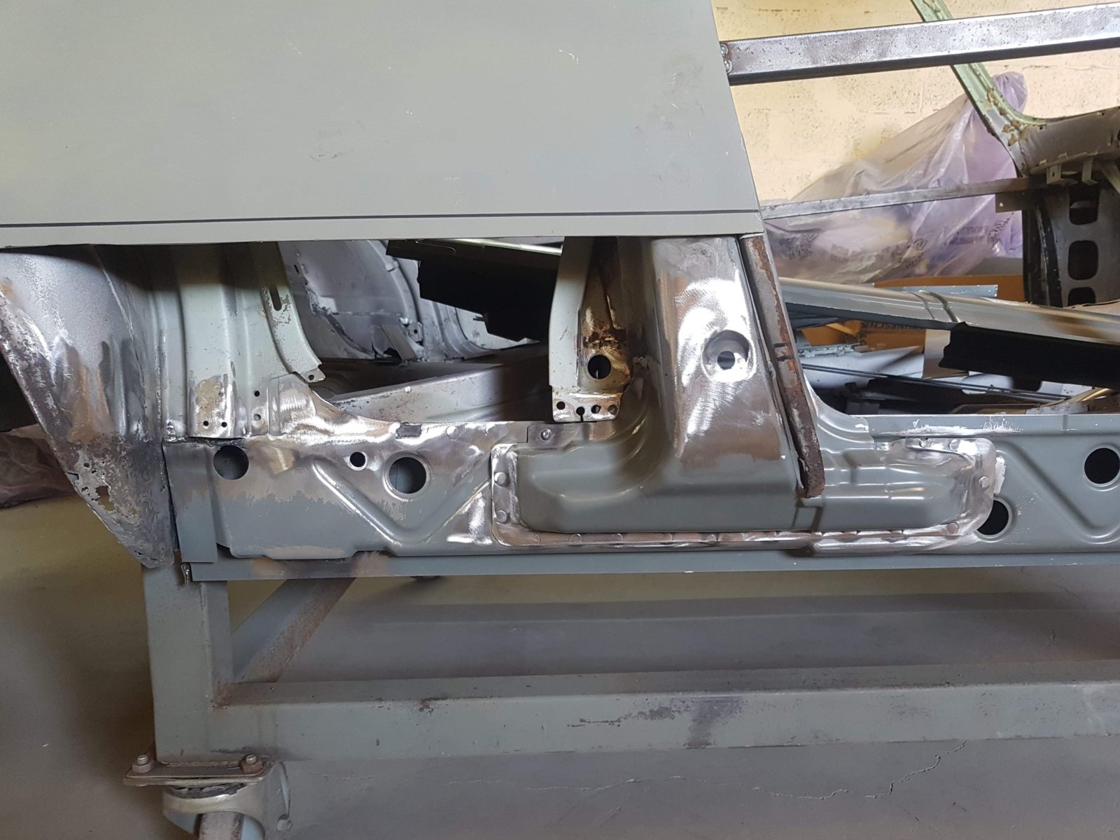

A couple more much needed panels arrived. Check out the drivers side patch job from before!
View attachment 55019 View attachment 55022

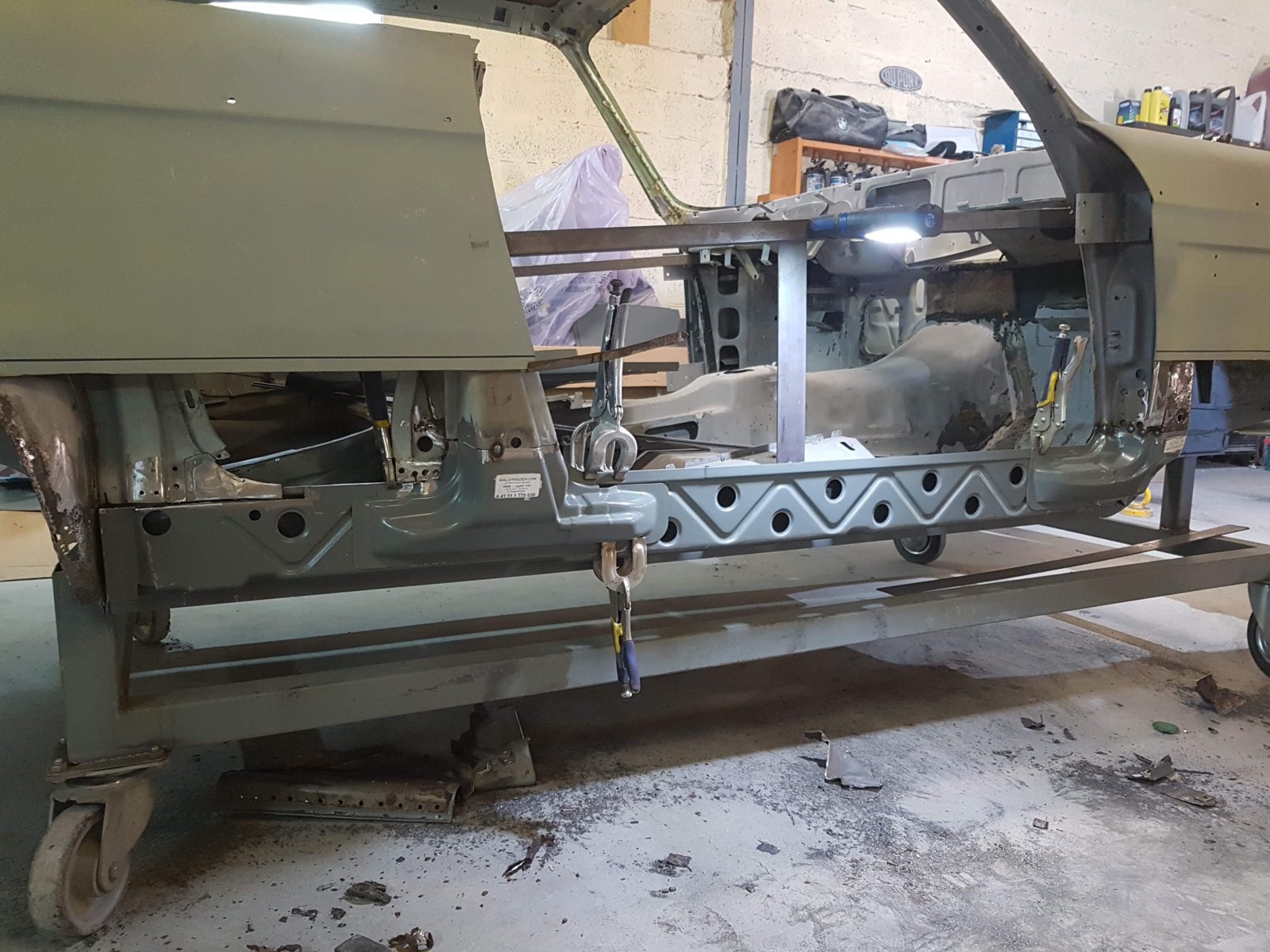

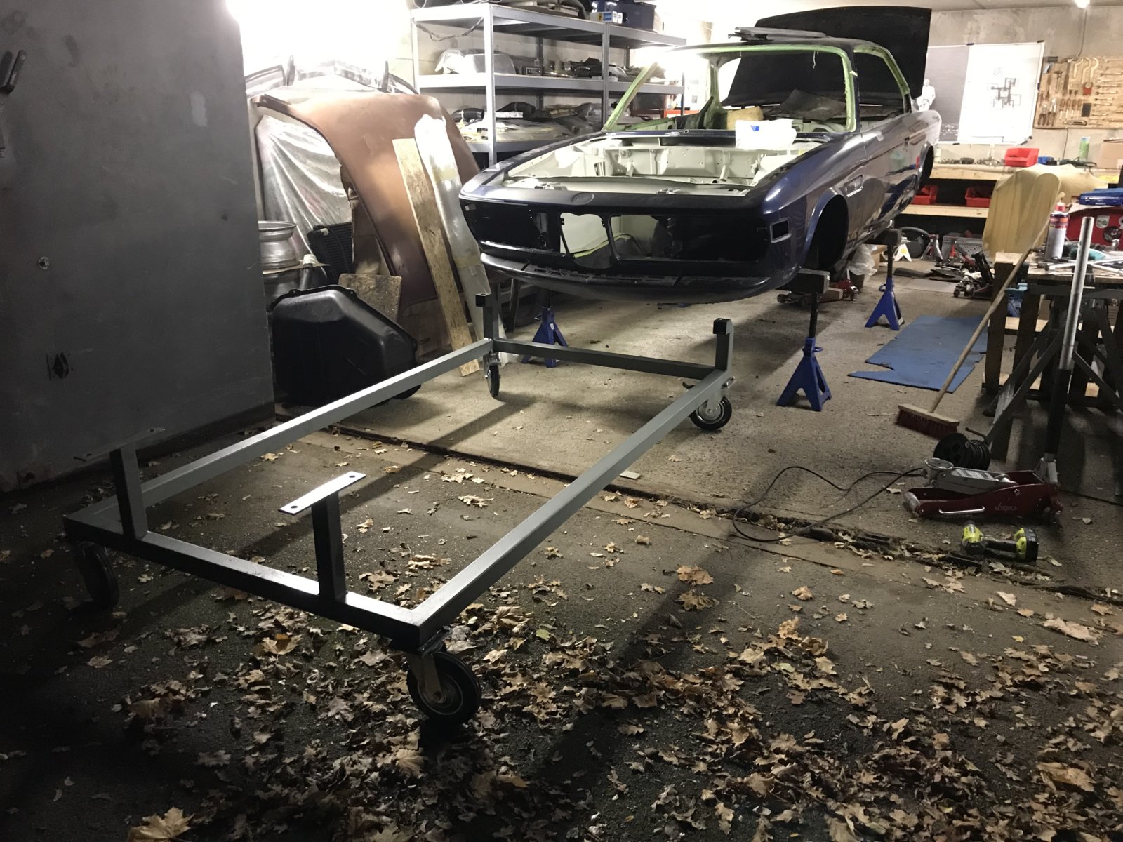

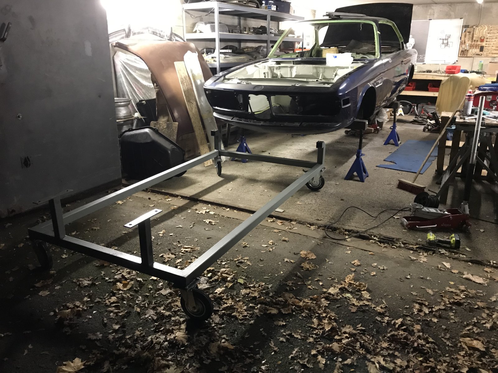

Also my friend finished welding the dolly together from some drawings I made, just need to shorten the front legs due to a typo on my final drawing... ugh
Should hopefully have the car back on the ground tonight.

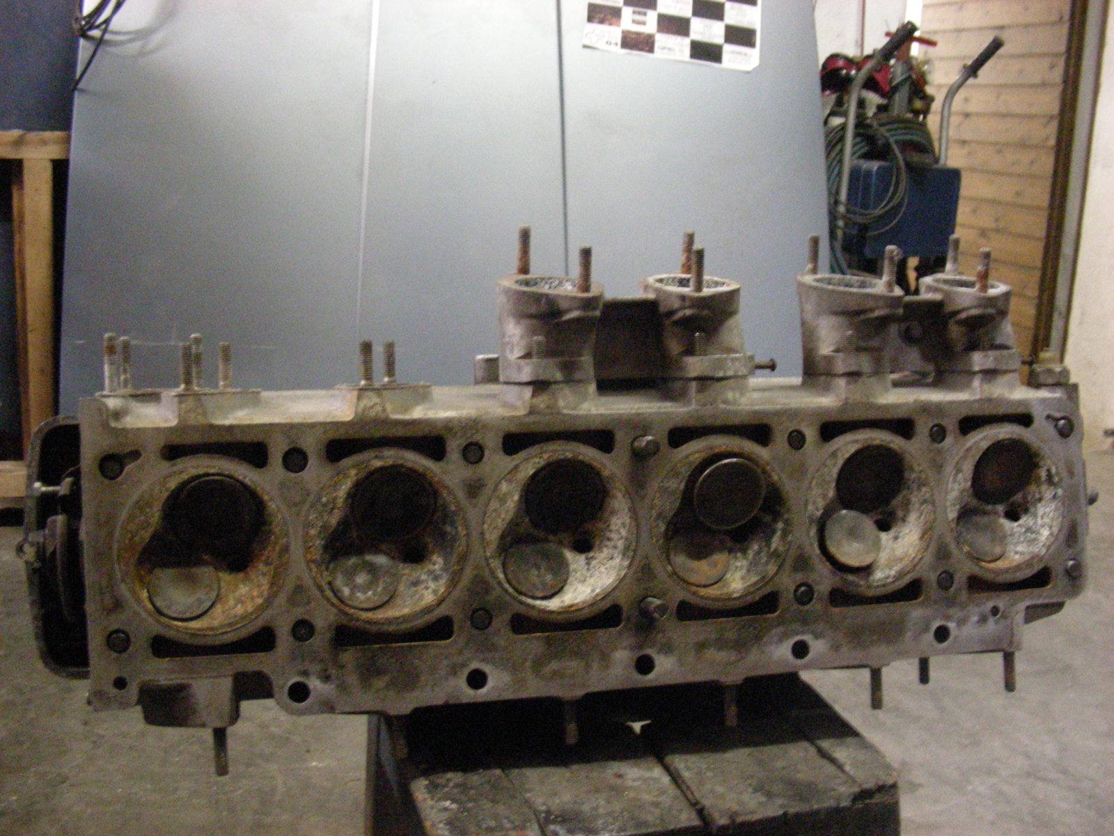

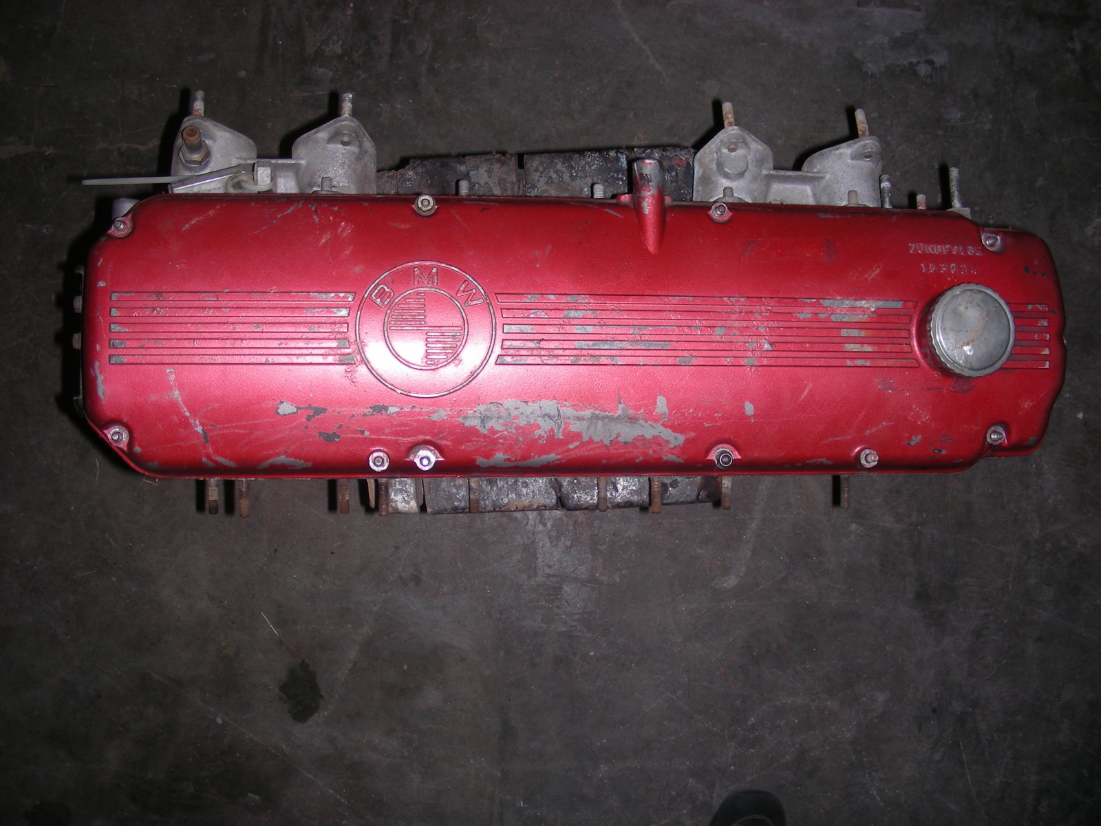

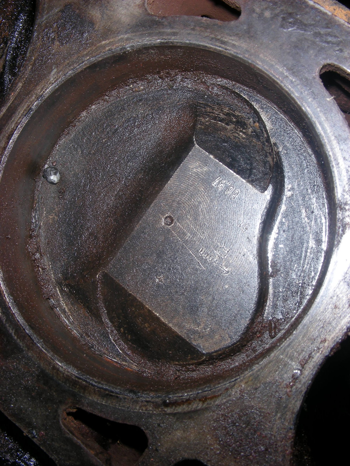

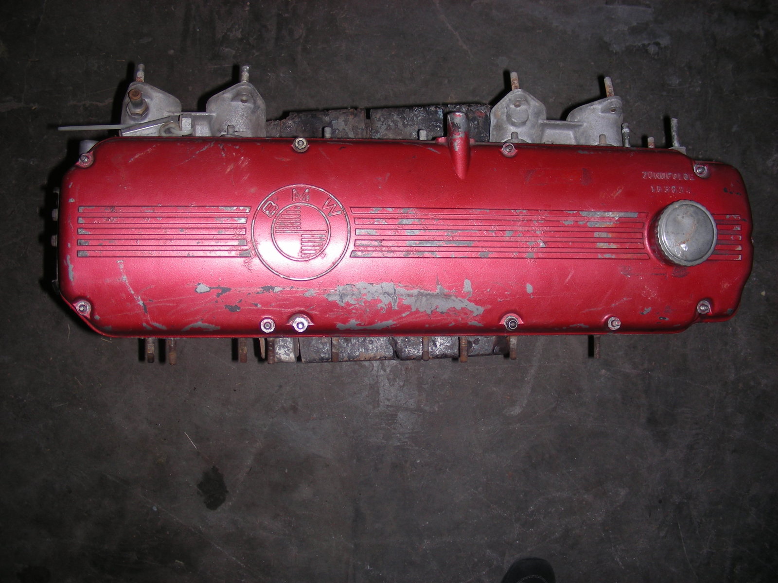

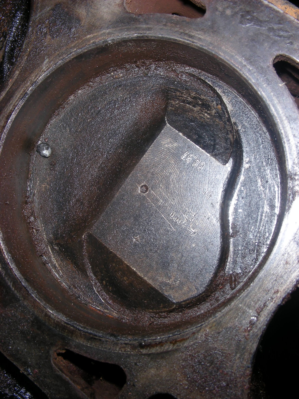

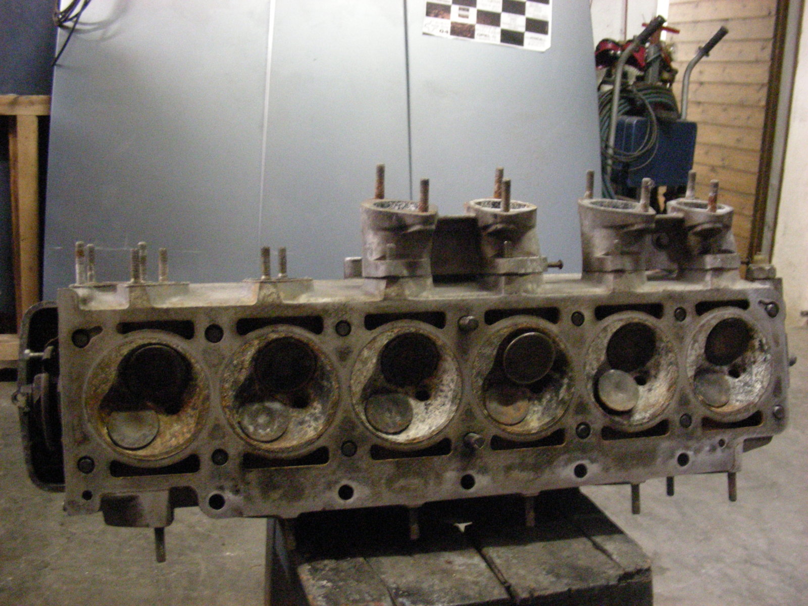

I dont know where you're getting your info from, but Alpina would not put a hemi head on stock piano top pistons. Makes no sense, since the pistons would not match the chambers, and that is an Alpina trademark. I have a B2 3.0 with hemi pistons, like it's supposed to with rods exacly like pictured above with the cap lightened and polished. The pistons are the same profile as the later 92mm E24/28 B9 and B10 pistons, with a very proud rise all the way around from the outer edge sloping inward, then flattening across the surface, with valve reliefs cut.If your engine is a 230ps B2 it should not have hemispherical combustion chambers and the pistons should be stock Si/CSi pistons.
These engines "only" have the Alpina 300 degree camshaft, Alpina triple carb setup -normally Solex - and Alpina special exhaust.
Not sure if they were blueprinted, but they were certainly assembled with great care.
could you possibly share those drawings/specs for the dolly you've made? I am getting close to the point I will have to weld one together soon, would be great if you've already written some information down. Thanks!
hi James, I am interested in your wheels, can you tell me what size and make they are...??
This is B2 engine nº1545, built in 1975.
Alpina confirmed that the head (which has its own identification number) was the correct one for this block.

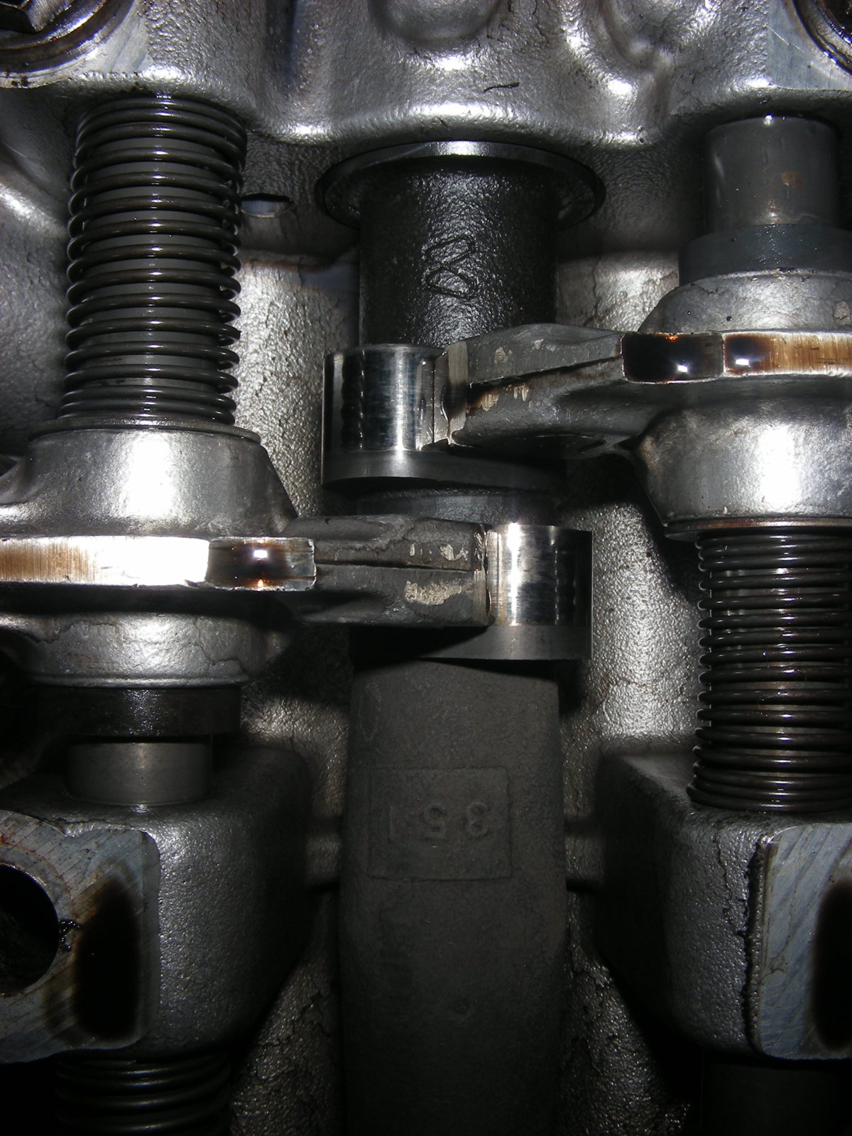

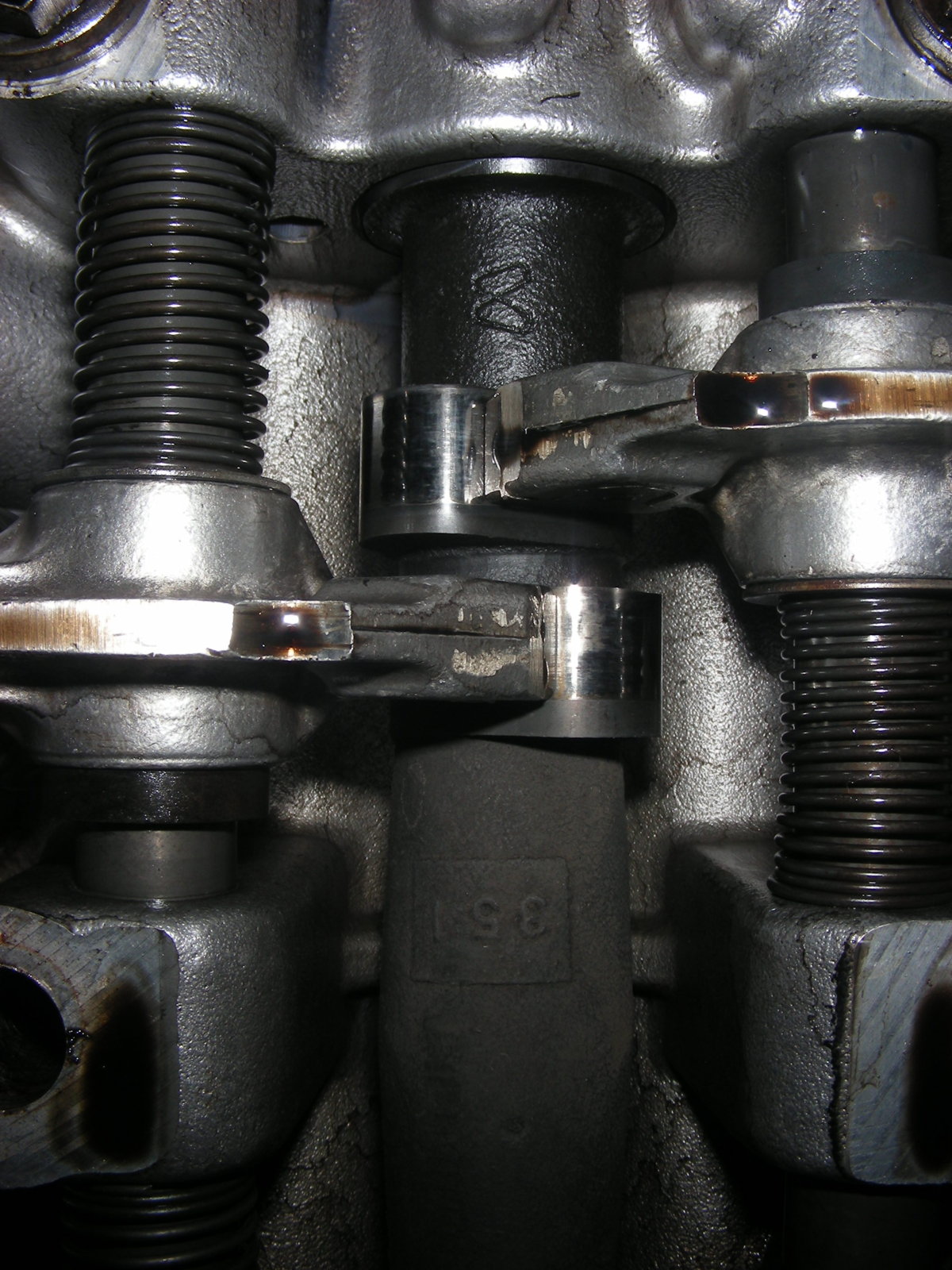

On the last picture you can recognize the Schleicher logo on the 300° Alpina camshaft.
