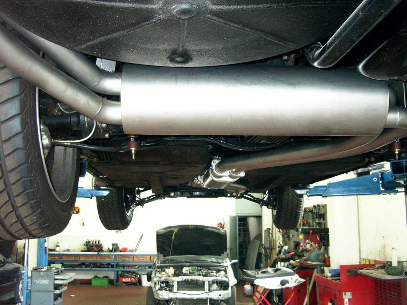

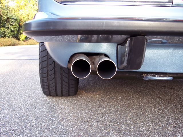

As an addition to the two tip exhaust discussion. The fjord coupé comes maybe with a rather rare and not less expensive exhaust system from Rochhausen (german manufacturer). I'm not sure if this is still available (don't think so).
Pictures show the car of a friend, who mentioned the costs with 3500,- €
Good for a performance engine, just waste of money for a stock machine. And imo not good looking, especially from the side, where you can see the second tube sitting under the regular single tube, because there's simply not enough space between the lower part of the left rear quarter panel and the spare tire well.
Another exhaust system with a double tube rear muffler was distributed from SIMA in Munich (not longer existing), back in the days. This muffler had the two tubes sitting under each other, looked even worse (sry couldn't find a picture of that), but I can remember the sound was great.
Personally I went another way with my purchased B10 Alpina engine and fitting exhaust system from a donor car of the e28 series. Moved the spare tire well as much as possible to the outside to gain enough space for the rear muffler just straight in the center of the car. As a result the two tubes came out of the rear valance right in the middle (like it is for the e24 series ie.). Looked pretty nice for my taste 20 years ago ...
Within the complete restauration of this car I changed this back to stock with my self made exhaust system, with the exception, that I used a 70 mm diameter for the end tube. This suits that much better for my taste nowadays.

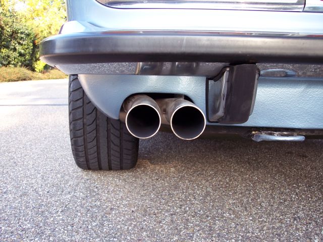

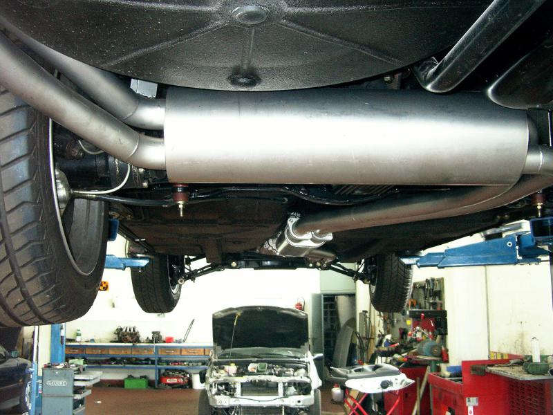

Beautiful pics and good information. I think one of the key differences in the car you are showing is that it has a dual exhaust "system" - two pipes from front to back. It is a true performance option that is fairly involved and, as you pointed out, not worthwhile if your engine wouldn't benefit from this solution. Whereas, the idea of placing a twin tip on a single pipe system is just an aesthetic accessory. Another key detail is that, if adding a twin tip of some sort, the original pipe needs to be cut down in order for the new, longer tip to fit the car without creating a large extension that projects beyond the bumper. :eek:
Related, the Coupe King exhaust is a single pipe system but the pipe diameter is larger than many single pipe systems. So the breathability is there to a large extent even with one pipe. At least that's my take on it. :)
