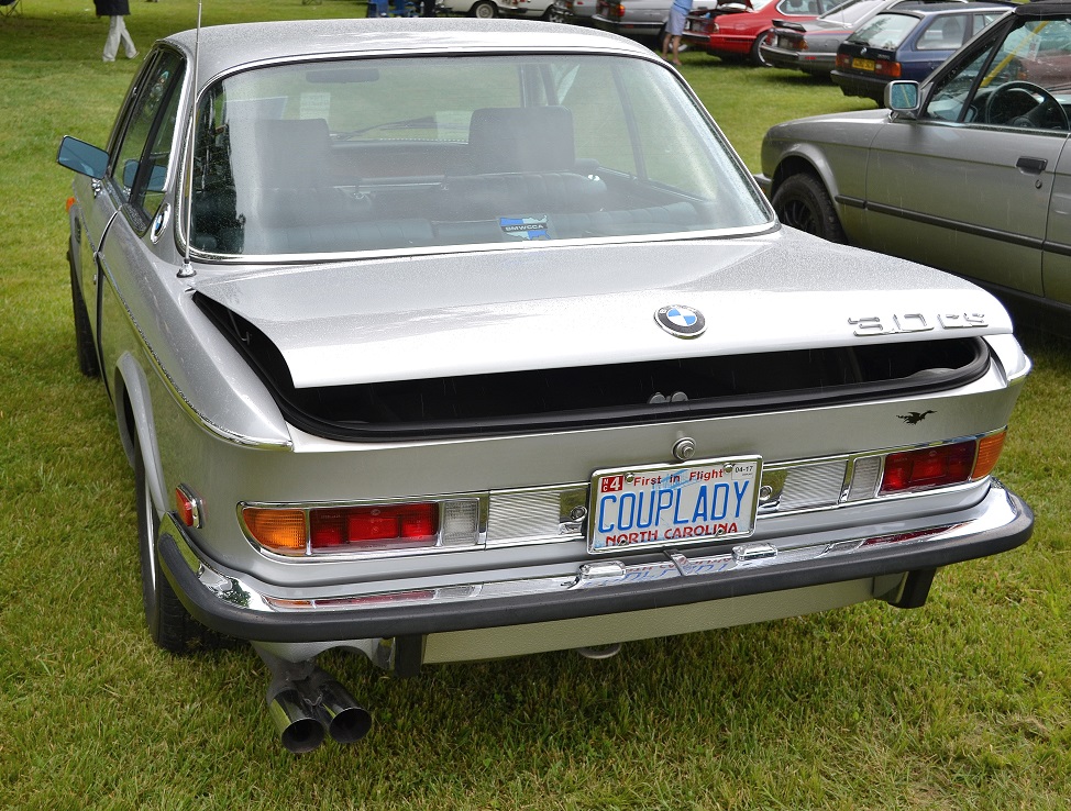

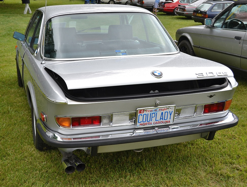

I would love to get a dual head exhaust tip like this. I know it is not. Period Correct or correct to the vehicle but any thoughts are appreciated. If not this, what do you recommend? Going to search for exhaust tips to see if there is a thread on show us your version of those.

I like dual tip exhausts on '60's and 70's cars
But I do like the look of a single tip on our E9's. I've personally only seen one car that had one.
Don't know if it is easy to get one fitted on...

Regarding the twin tipped exhaust, my opinion is that it looks very unfortunate on the e9 (sorry, NC COUPLADY - just my opinion).
I feel like an idiot for thinking that you would have to remove the dashboard to change a lightbulb. Hopefully Benny and Gary will be able to sort out the alternator and I can return the new one to the eBay seller. I will deal with conversion to LED lights at a later date. I just want to get it on the road. The dual tip really looks bad imo

Oh, no doubt. I thought long and hard about expressing my opinion before doing so. But I thought that we could all stomach one opinion in the open forum. :D I am sure there will be 7 or 8 things that I do to my car that some don't like. I'm prepared to face that head on. :)

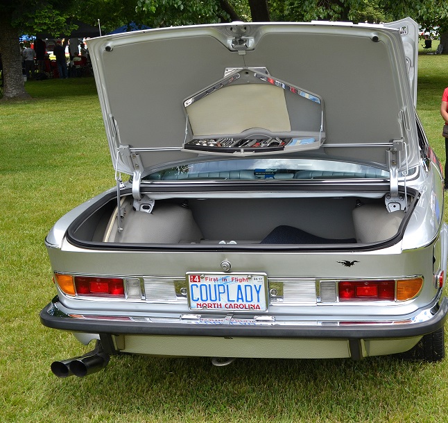

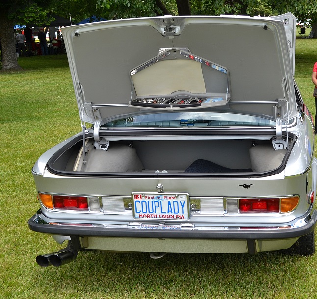

Talking about twin tips, if I'm not wrong this is Paul C's car, this looks better since the body is modified to accept two tips, but would be even better if they came up 1 - 1½" more.
Agree - these seem to be fitted nicely to the rear valence and they do not project out and up as much. Perhaps that is what was catching my eye above. :eek: Thanks for the additional pics...
