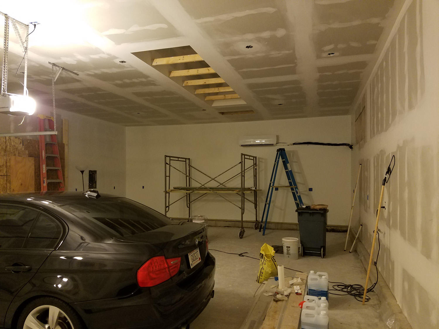

Here's a shot from just now (apparently I do requests). I've started to prime and paint in order to install the heat pump unit. The unit is installed, wired, and piped. I still need to evacuate the line set and interior coil before charging/releasing the refrigerant and firing it up. It is supposed to get down to 8 degrees tonight, and 13 the following night. My plan is to evacuate on Saturday and hopefully everything will be good to go. I might install some exterior light fixtures while the pump is running, too. The drywall is not perfect, but the guy did a pretty nice job. And my painting is impeccable. I like to paint. :cool:

So, I've been wondering about the 2x4's in the raised section where your lift will go. Are they just bracing and will be removed, or will they serve some purpose?

As for the 2x4s, it is something that will most definitely make sense once you see it finished. But I will try to explain it in my next post - stay tuned...

The 2x4s are the bottom chord of the roof trusses. Which is to say, they are integral to the structure and are not going anywhere. I will be painting them, though. Here is a photo of the trusses from a couple of months ago, right after they were installed.
I built the garage as tall as I could (as allowed by the applicable zoning ordinance). And although the ceiling is pretty tall, it is not as tall as most 2-post lifts. I had originally contemplated using a lift with the cross member at the floor. These tend to be a bit shorter and I could have fit the lift under the ceiling. But then I'd have to roll everything over that ridge between the posts. So I am using a full size lift with the cross member at the top, as depicted in this image from the internet:
