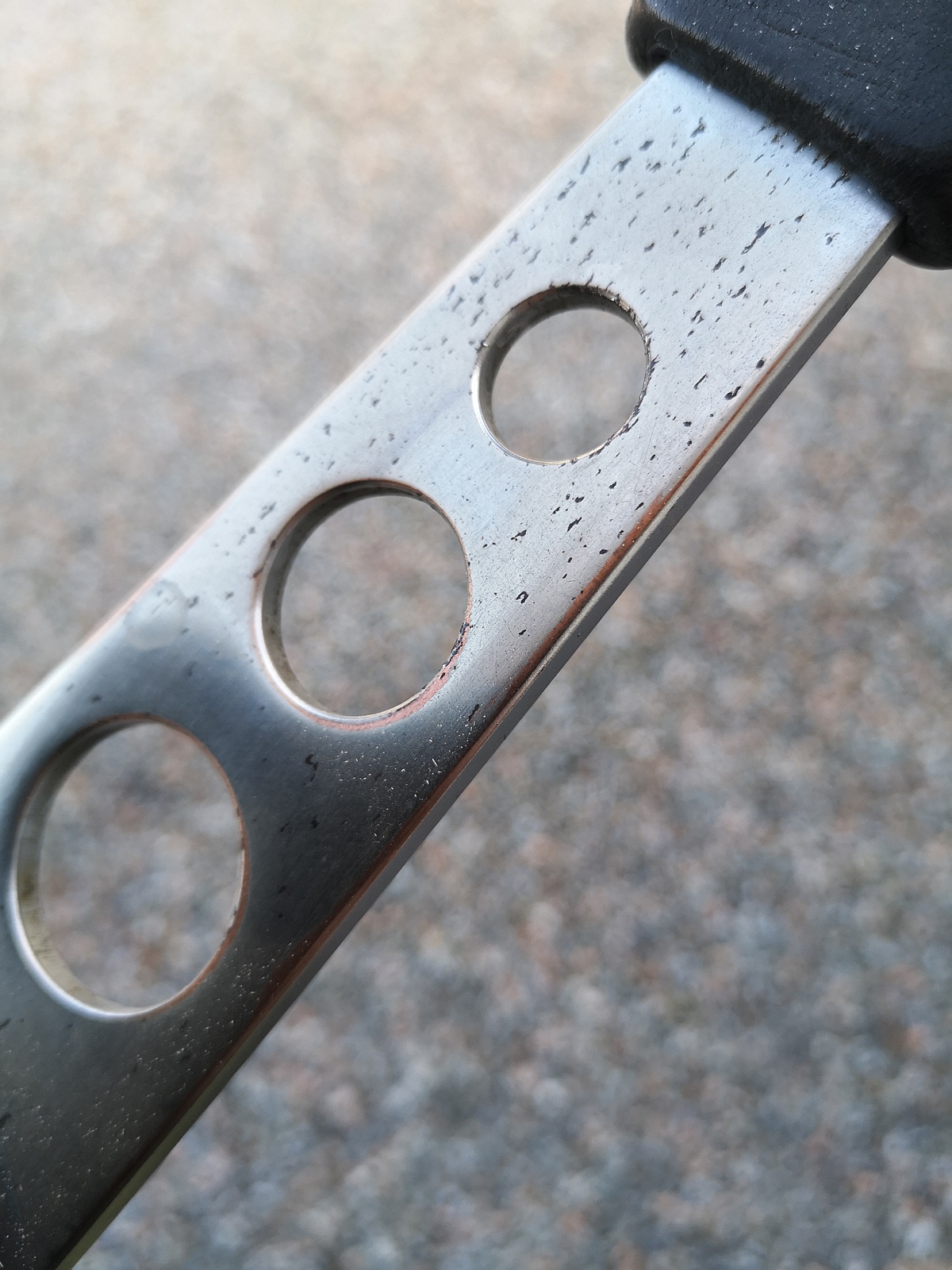

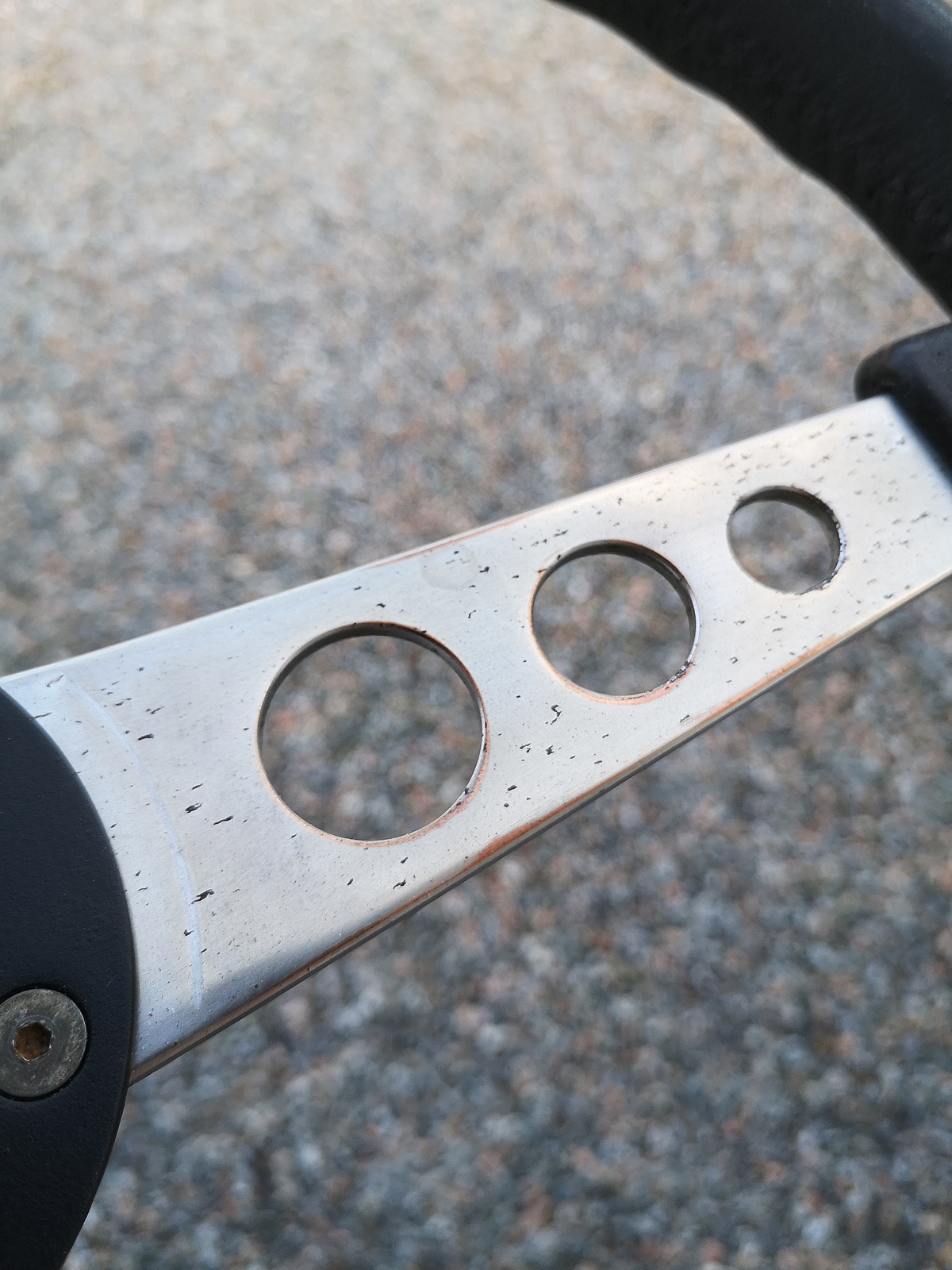

Here's what mine looks like. Nickel plated? @Markos what do you think? Chrome or Nickel plated?
If nickel plated, the question still remains…how best to tidy up nickel plated spokes? I don't want to make things worse obviously!

If you take the wheel to get chromed, it
will definitely be worse. I asked for satin chrome, which a show chrome shop can’t do. Mine was bead blasted after which gives it a satin look but leaves it “sparkly”.
I can’t say one way or the other. As the article below mentions, take it to a firearms specialist and have them tell you. Note that I said “hard chrome” above, not “chrome”. I mentioned handguns because it is a common finish for firearms and industrial finishes. I have enough nickel plated stuff in my house to know that the Petri doesn’t look like pre-brushed nickel to me. You would have good results nickel plating it, but I still don’t think it is nickel.
Looks at the blue as pink reflections that you get off the back of a Petri wheel (including the puck above), and tell me if you have ever seen nickel do that? Attached below is a hard chrome example, I’ll leave the pic at the bottom.

If you have your wheel plated, it is the job of the plated to tidy up the spokes. They have to chemically strip the old chrome. That may be enough. Good chrome shops then coat
the part in copper. Copper is soft and works just like body filler. It fills all of the imperfections and the plate shop then sands and polished the copper. Most of the finish work with plating happens before you do the last coat. With nickel you can brush it after (they actually manually scratch the finish).
A hard chrome finish is done almost entirely on the underlying metal. So if you want it smooth you need to smooth the metal first. Same goes for anodized aluminum.

I think that both are a good resource on the subject. @Keshav has cleaned up a number of Petri wheels, and @Wladek plated his. You can polish out the pits on existing chrome to a degree, but it will get shiny if you work it too hard. I don't recommend refinishing the wheel unless you are all-in for a leather top coat. One can surely locate a hard chrome or nickel plating service in the UK. The firearm references are helpful because it is consumer grade with consumer-friendly finishes. They do small batch jobs which is helpful for hard chrome. The issue with that process is that many of the hard chrome outfits are for huge industrial outfits.

My experience with cleaning up an old Petri is this, I had (still have) a Petri 40 with badly pitted spokes, and without doing any research, I took some autosol and went for it.
My goal was to remove some of the visible pitting, at the cost of removing the satin finish at the same time as I thought that shiny spokes wouldn't be so bad as long as the pitting went away.
However, the pitting remains, and I went through the -whatever- metal finish the spokes are made of, and the copper? base underneath was revealed.
Whatever the top finish is, it's pretty soft as it didn't take long to get through it with autosol chrome polish.
That's why I doubt it's chrome or hard chrome, it seems way too soft for that.

Michael bought his wheel from Hans and I’m pretty sure Hans did all that was doable before he sold it. He is a professional Petri guy. ONLY very superficial ‘dirt’ can be cleaned off but most of the imperfections are below the surface and can’t be removed without scrubbing the top layer and leaving a chrome look underneath.
Therefore, if the Petri isn’t near ‘perfect’ to begin with, there’s not much that can be done in its favor other than a whole repleting as done by Wladek and Markos. That’s a long drawn job and has to be completed with a leather wrap.

Also I am still curious as to what metal the Petri is actually made from and what finish was applied to the spokes.
Do you, or anyone else here, have a definitive answer to this.

You can also clean the wheel with alcohol. Spray the wheel with “chrome” (aka silver) spray paint and wipe it clean. The paint will only be left in the dark pits.
Thanks Michael
Petri wheels are mild steel. That is why they weigh 3x as much as a momo.
