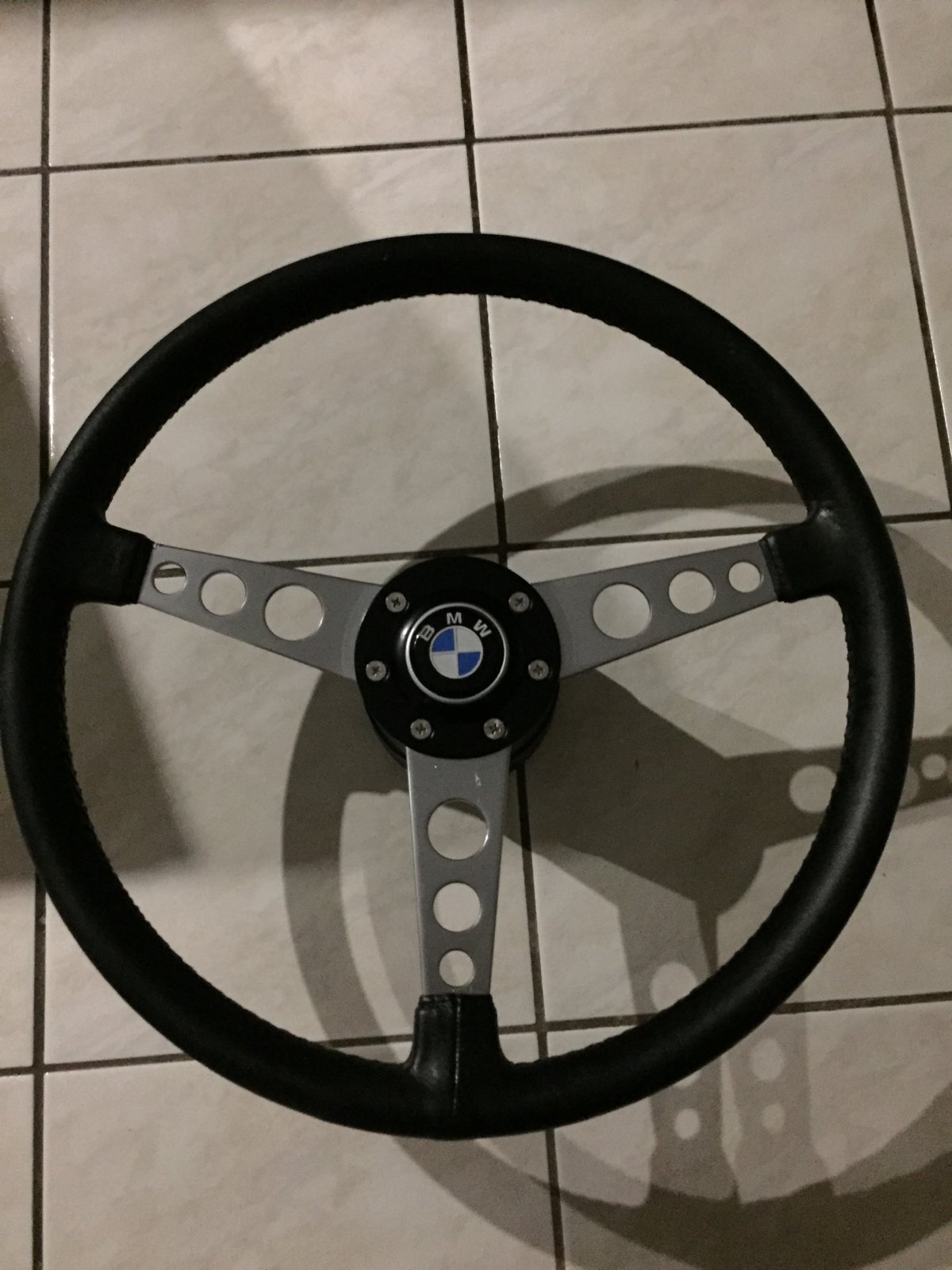

Another thing that you will notice about Petri wheels is that the face of the wheel is not brushed. The rear of the wheel has a grain in the steel, but it is not post plating brush marks. It is common to see brushed nickel plated Petri restorations, but the original wheels have no brush marks at all.

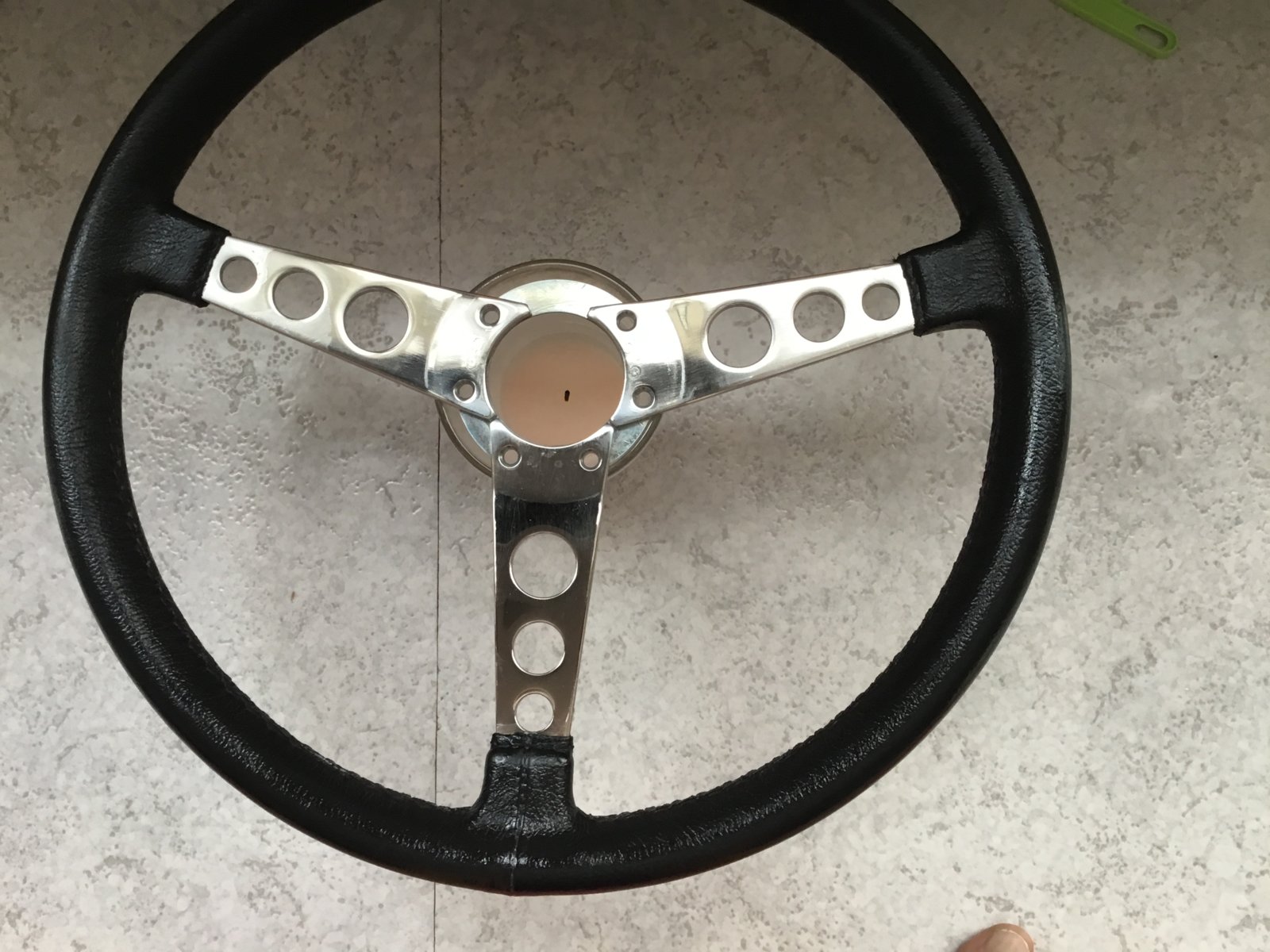

Here’s what a Petri will look like when the top matt silver coating is removed. Lots of bling. Although a personal preference, if it means saving a Csl Petri which this one is, even this shiny look is worth it. Pitted Petri’s hurt the eye.
Michael bought his wheel from Hans and I’m pretty sure Hans did all that was doable before he sold it. He is a professional Petri guy. ONLY very superficial ‘dirt’ can be cleaned off but most of the imperfections are below the surface and can’t be removed without scrubbing the top layer and leaving a chrome look underneath.
So just a flat/matt finish with no brush marks. Ok perfect. Thanks.
Very interesting to see it more “bling”. Not so bad as you say and better saved than not.
