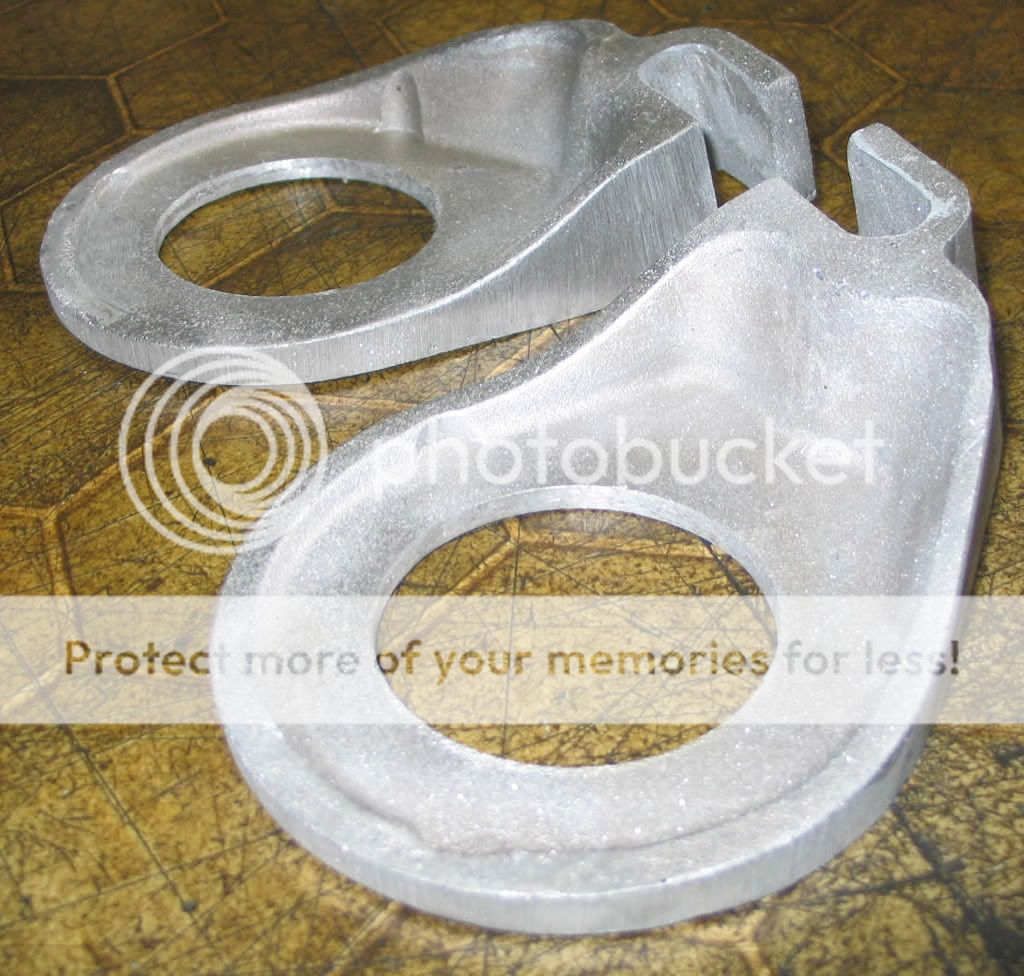

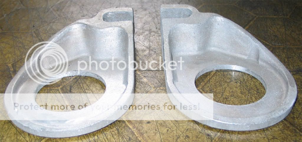

Beautiful part!

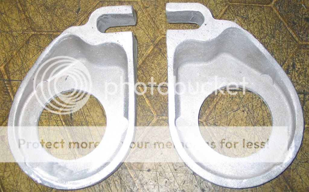

Have you considered shot peening or bead blasting to give the right surface finish texture? Could be followed up with a clear hard anodize to give longevity to the finish.
Great work.
Today i gave the parts to the guy from the foundry.He estimate the price for maximum 50€ each, rather cheaper.He will need both to make the pattern, after that it is unemployable for use !
So we all will have the same. :)
The parts will have a much rougher surface than now, they get sand blasted after casting.I have to do a postprocessing, all holes will be closed, and the notch for the swivelheads will get a measurements of quantity.For the swivelheads i payed 15€ each, so below 200€ for the set will be an achievable price(except shipping).
In 1 weeks he can give me an exact price, for the setup he will need 2-3 weeks.
Total 1 month.
As my father always said: Do not get out of patience.The perfect christmas-gift :twisted:
Andi, you are a magician! :mrgreen:
With this strut bar and new feeler gauges what more could a coupe owner want?

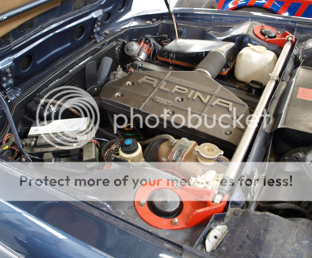

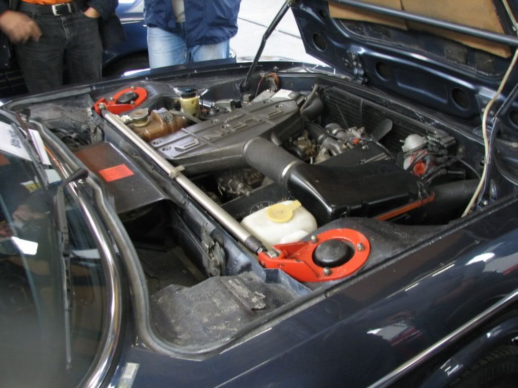

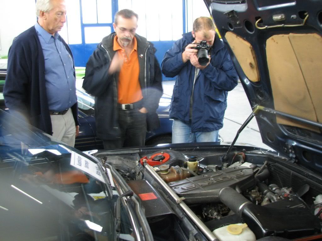

On todays excursion to a great car-collection i took those pictures of a welded strut bar :
btw : nice air filter housing, am i right ? :mrgreen:
This is very interesting. I have a strut bar from Werner Hand in Germany, and it looks very , very similar BUT the holes don´t match the holes of the screws from the top part of the struts.....
Instead the top of the isoceles triangle points towards the bonnet locks rather than straight into the engine bay and to the opposite mounting point.
I haven´t mounted it and will talk to Werner about this.
Believe the car you photographed is the Alpina engine car discussed at length, on the Alpina forum pages last month...
where I stood up for the owner and actually (at it's most demonstative) virtual food was thrown around the thread?

:-D You can read his mind (the guy on the right)
The left one is the owner, but my beard dont itch !

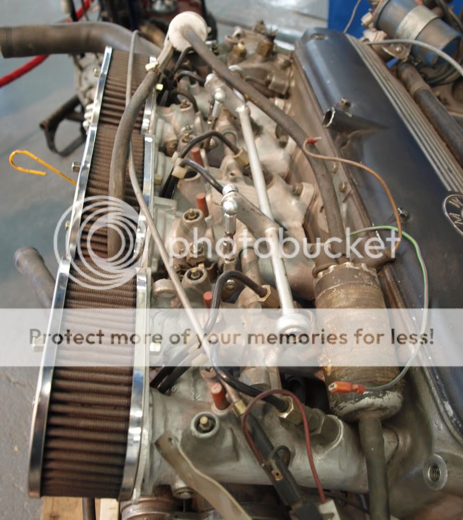

I was only wondering, because underneath this airhousing there were no carburators !
We say Einzeldrosselanlage (dont know the corrct english word), still the same injection like on this motor, even from the same collection :
BTW, its not a Alpina B2S, its "only" an E9 with Alpina-parts
