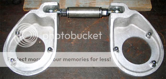

The heat-treatment is done, the plates are back!
But there´s another little problem for a delay:

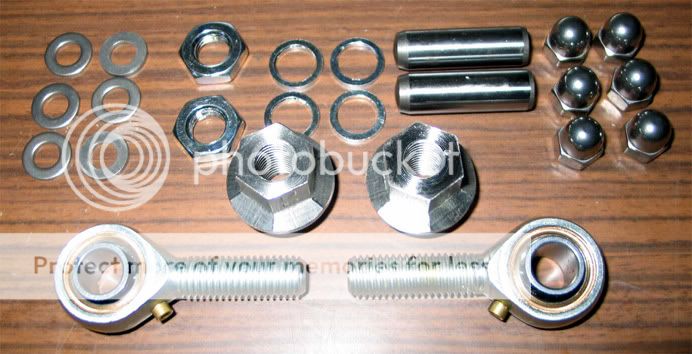

The flat locknuts were only available in "steel", no stainless.
I have to galvanize them, also the 30 small spacer rings beside the swivelheads.
In at least 1 week i should have all parts completed !

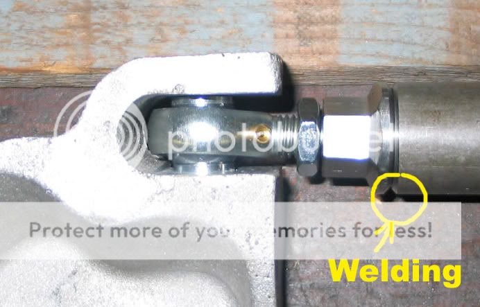

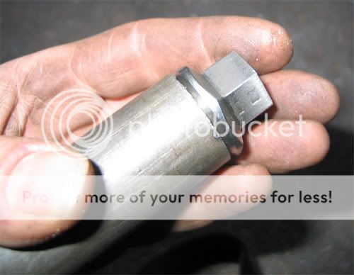

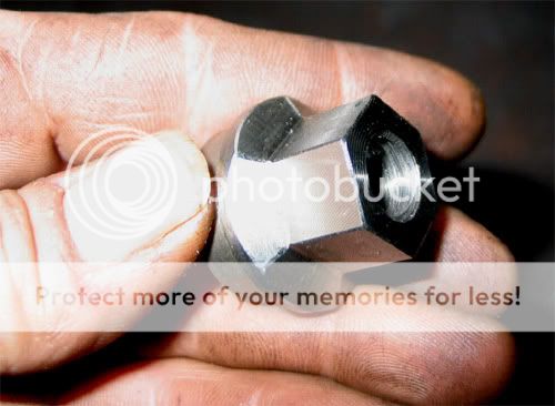

Yesterday I have made 15 left and 15 right M12 bushings, that will be welded into the tube.
For the european customers this will be done by a professionel welder, the guys "over the pond" will only receive the set with the "naked" bushings, without the tube.
Reason is, the shipping for such a long part is more expensive than the part itself. I should not be a big problem for you, to find a welder in your neighborhood........
The pipe dimension is Ø 30mm / 2mm thickness, that looks very solid.
