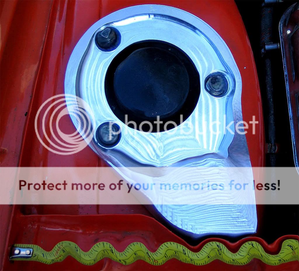

Today i tried to install my strutbar on Günters Golf CSL!
@ iconoclast6 , tomorrow I try to do the same on Kurt´s 2800CS with stock air filter, i will let you know the result :
Clickable thumbnails:
As you can see, on the passengers side no problem, but on the drivers side....no chance !
The wall between engine bay and ventilation/heating/wiper motor was not welded true-to-original !

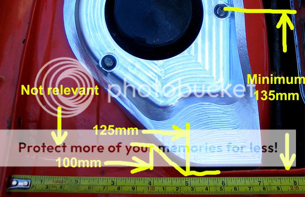

For all of you, who are on my list, the measurement 135mm is very important :
BTW : fast3.0csi I still miss your receipt of payment ! Your parts are on the way with notice "Item distributed"
You can see, every car is different, on Kurts 2800Cs the wall has the bend in the other direction...........:
He has a stock air filter an no problems.
He has installed a strutbar with pipe Ø 35mm, my tube has Ø 30mm :

A problem results from use of the adaptors which mount the air box to the REAR of the original position about 1/2" (maybe 13mm), thus severely limiting the space for a strut bar.
Not wishing to butt-in here but mIght not this be the easiest 125mm solution Andi
leaving 10mm clearance for the 1/2 discrepancy created by da Weber carb conversion?
