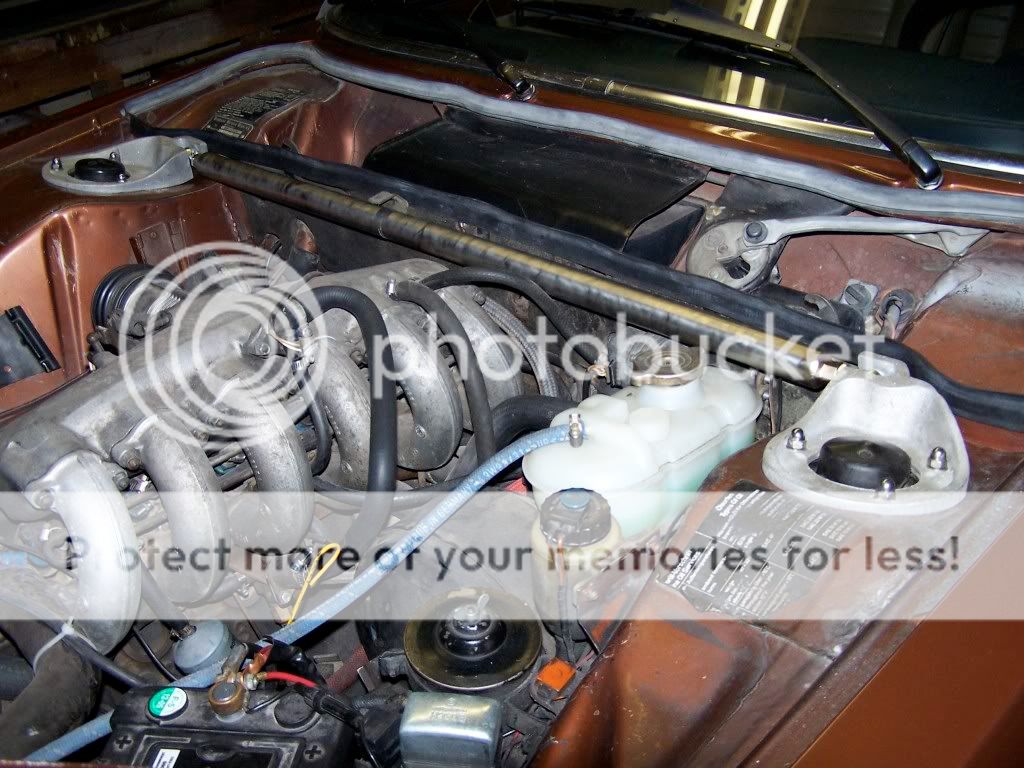

The bar

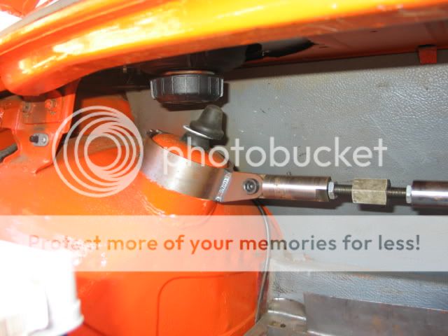

This was the rough install of the bar in case someone missed this. (finish to follow) Carbs? No idea, yet the bar sits quite snug towards the firewall, with clearance a plenty. I cannot imagine why it would not work with the carbs / air cleaners. Do not know...
So I guess no strut bar for stock air cleaner with 38/38 Weber carbs?

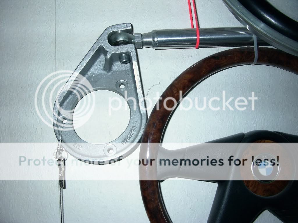

The tubes are allready welded, I got them back this afternoon from the shop !
Sorry to all of you for the delay, my welder was absent for at least 5 weeks !

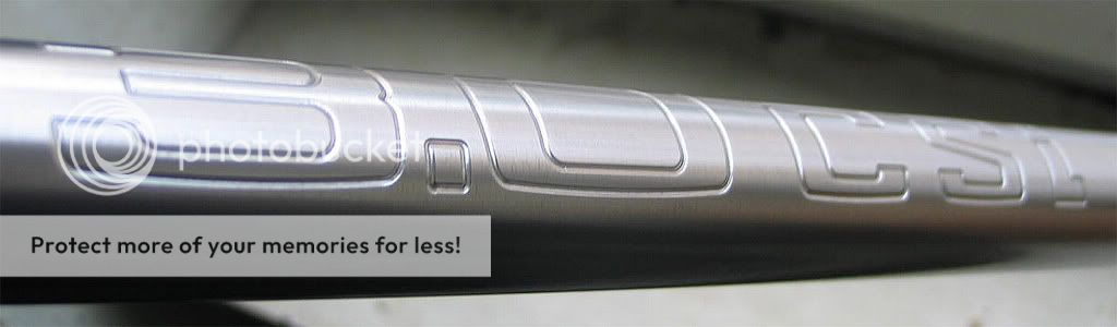

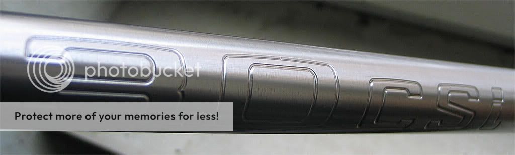

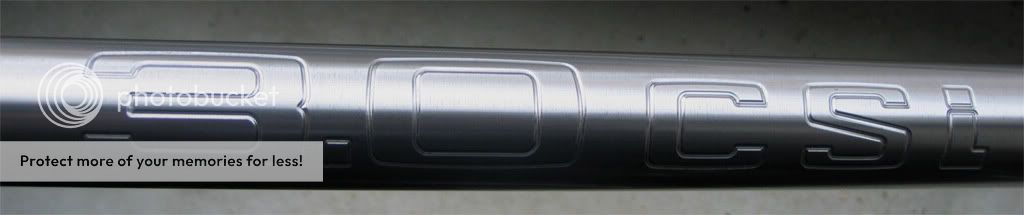

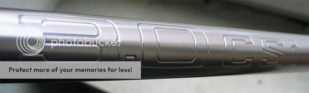

Before i do the shipping, there is also a possibility to make an engraving!
Here you can see the 3,0csi-logo I did for my own strut-bar.
I can engrave what you want, as long i have a pattern, tell me your wishes via PM !
Costs for engraving : +50€ !
BTW: Strutbar price is 300€ + shipping, to GB it is 30€, to Germany 17€ !

Today i tried to install my strutbar on Günters Golf CSL!
@ iconoclast6 , tomorrow I try to do the same on Kurt´s 2800CS with stock air filter, i will let you know the result :
Clickable thumbnails:
As you can see, on the passengers side no problem, but on the drivers side....no chance !
The wall between engine bay and ventilation/heating/wiper motor was not welded true-to-original !
For all of you, who are on my list, the measurement 135mm is very important :

Not clear if it was determined if the bar did fit the 2800 CS without modification.
It did fit to the 2800 and 3,0cs , but only when you use the stock carbs !
If you have installed the 2 38-38 Webers like iconoclast6, there´s not enough space between airfilter housing and bulkhead.
Are there other supplier alternatives
Yes, there are other suppliers for similar strutbars:
Werner Hand Germany offered them on his HP, fabricated by Mangold, but you have to drill 3 new holes (distort for exact 45 degrees) for the bolts of the upper shock-absorber-bearing :
Another supplier is W&N / http://www.wallothnesch.com
They have only rigid strutbars, mine and the Mangold are adjustable.

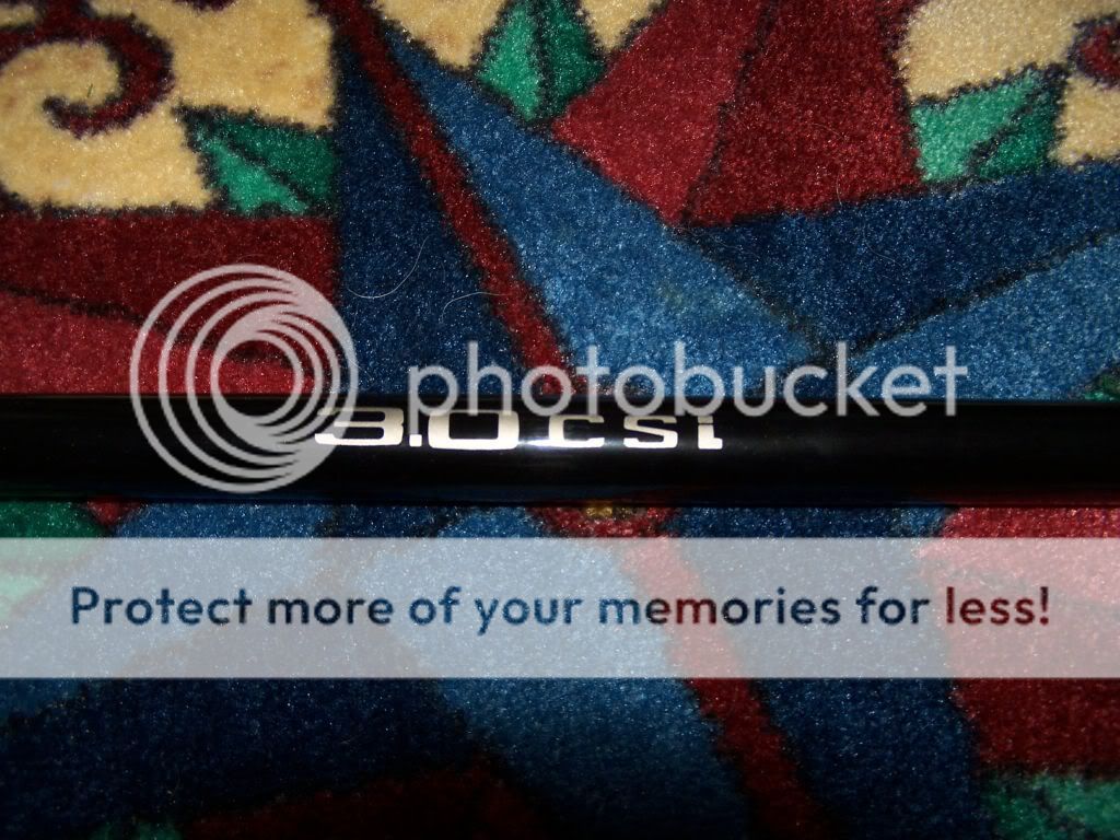

The Gruber Bar
The latest...powder coat then laser etched. Thanks to Andi!
Oh, the proper length 36 1/4''

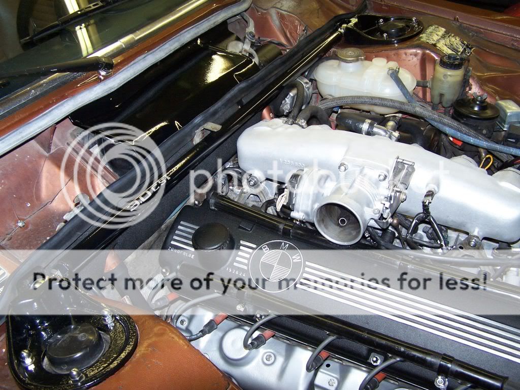

Strut Bar
The latest part 2...Bar installed. Plenty left to do in the engine bay yet one has to stop somewhere, never perfect it seems. Time to start driving!!!
