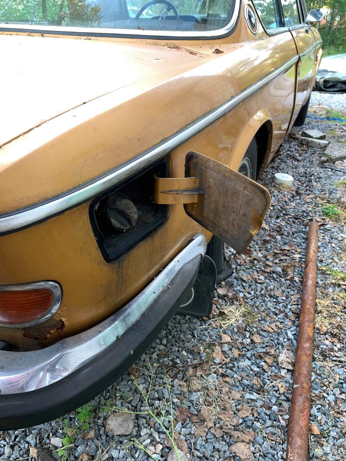

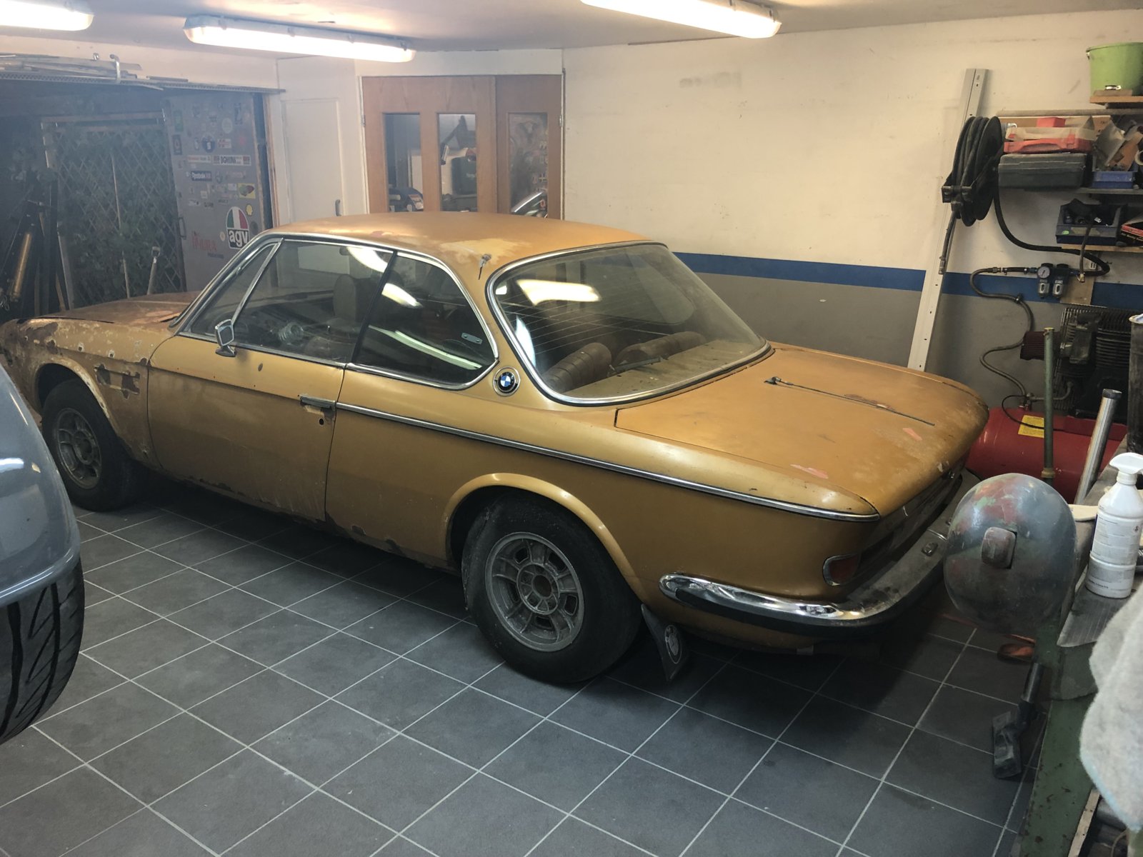

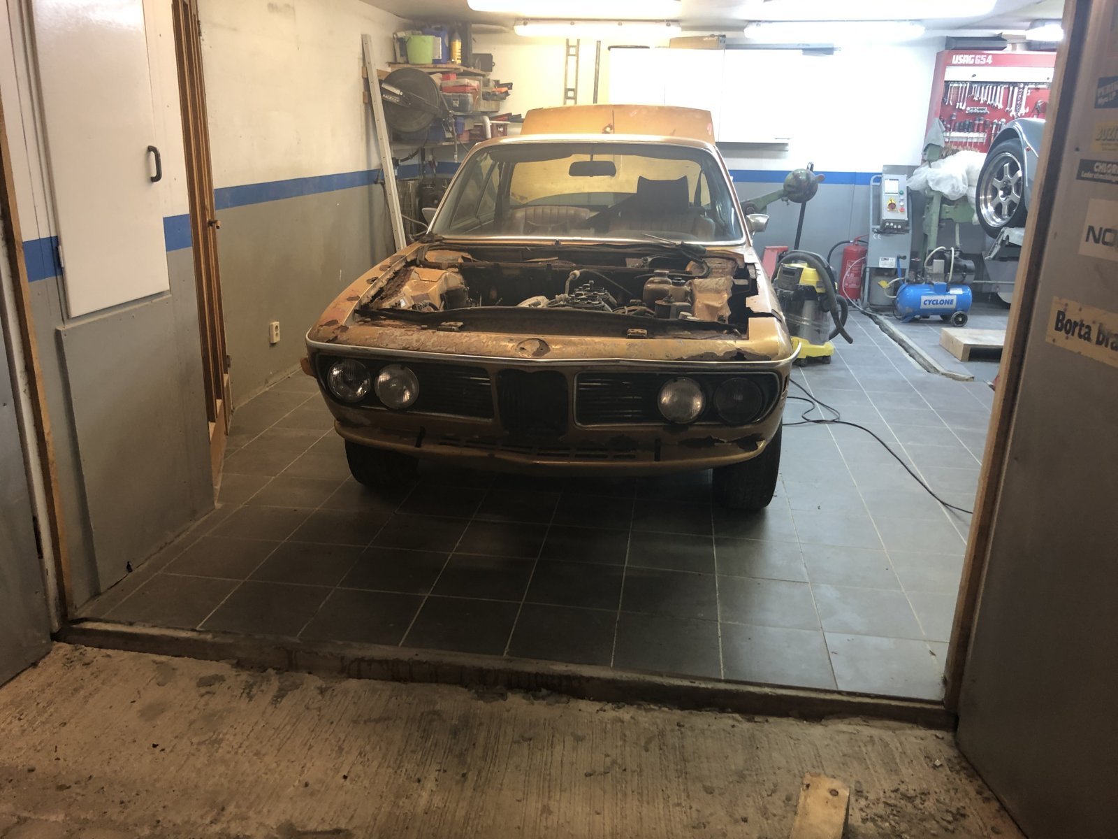

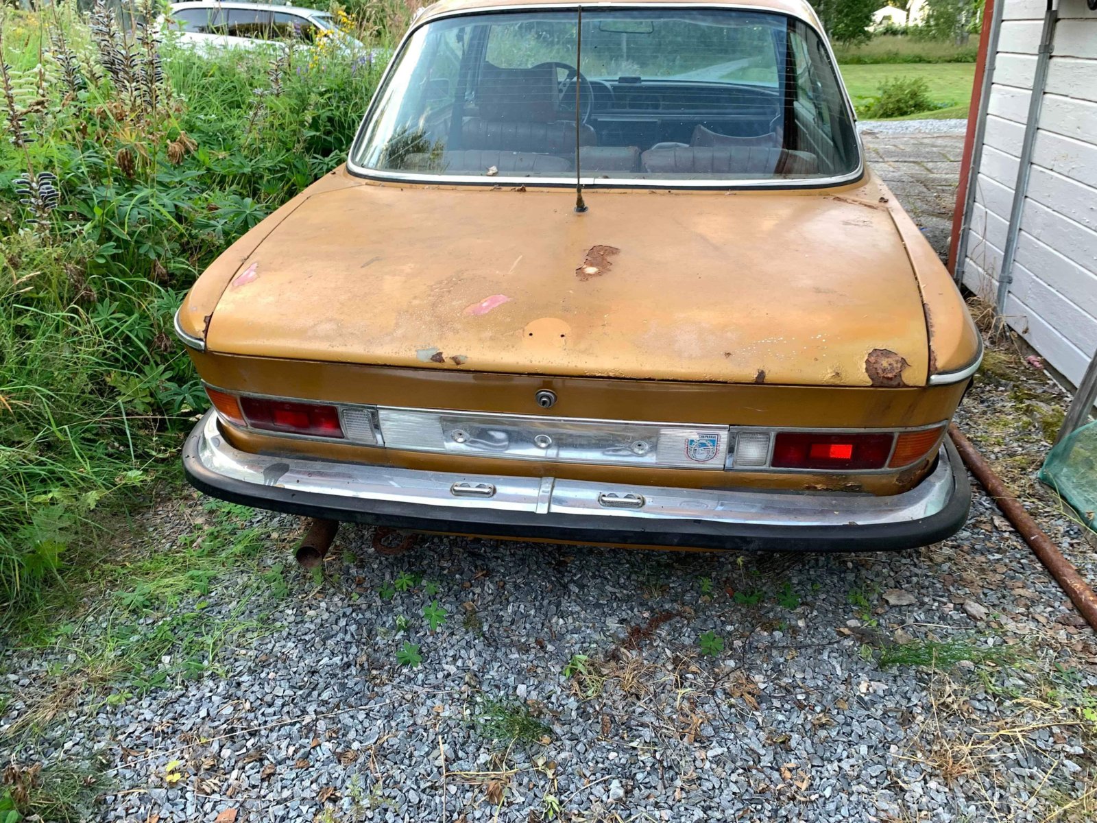

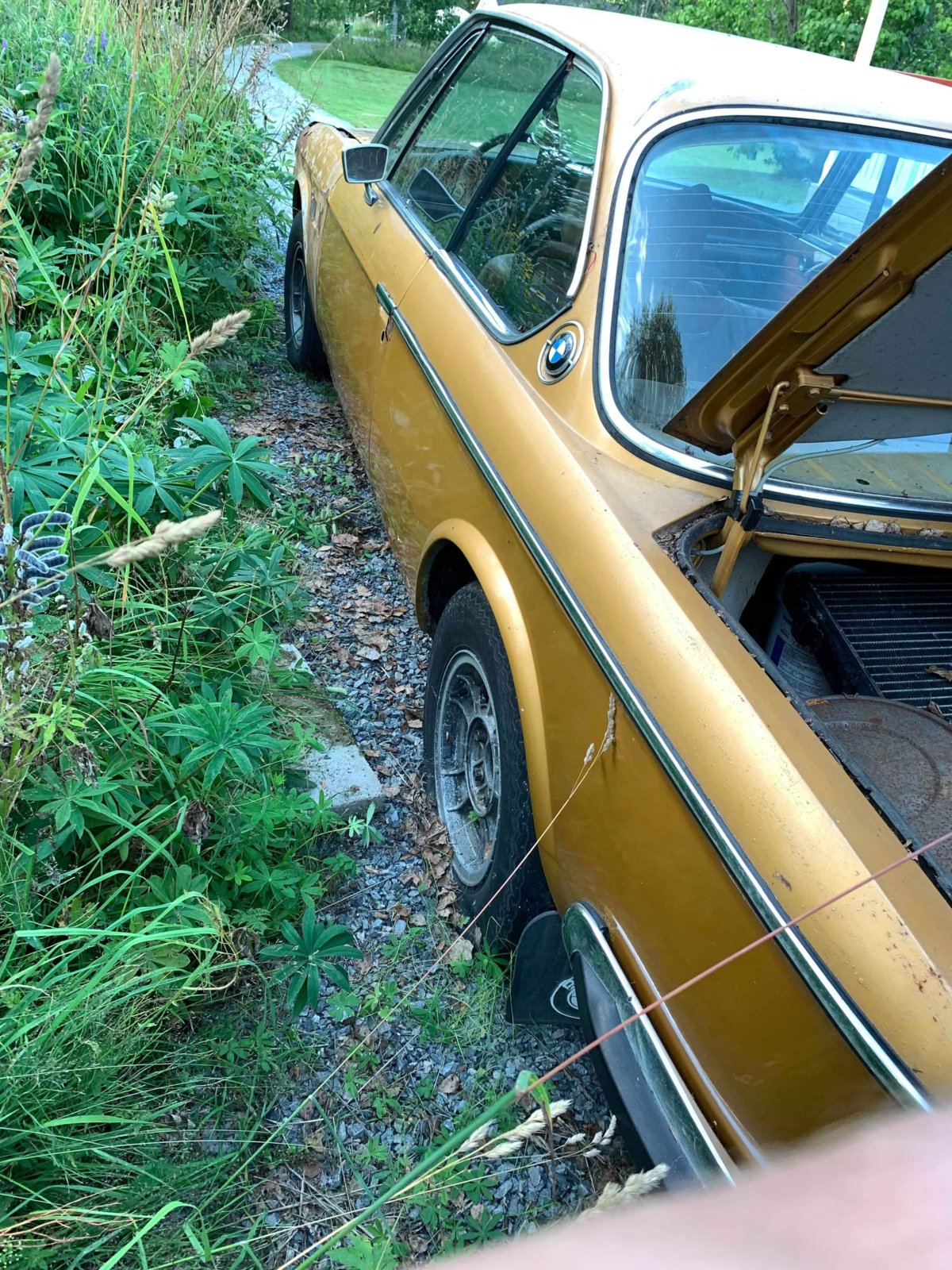

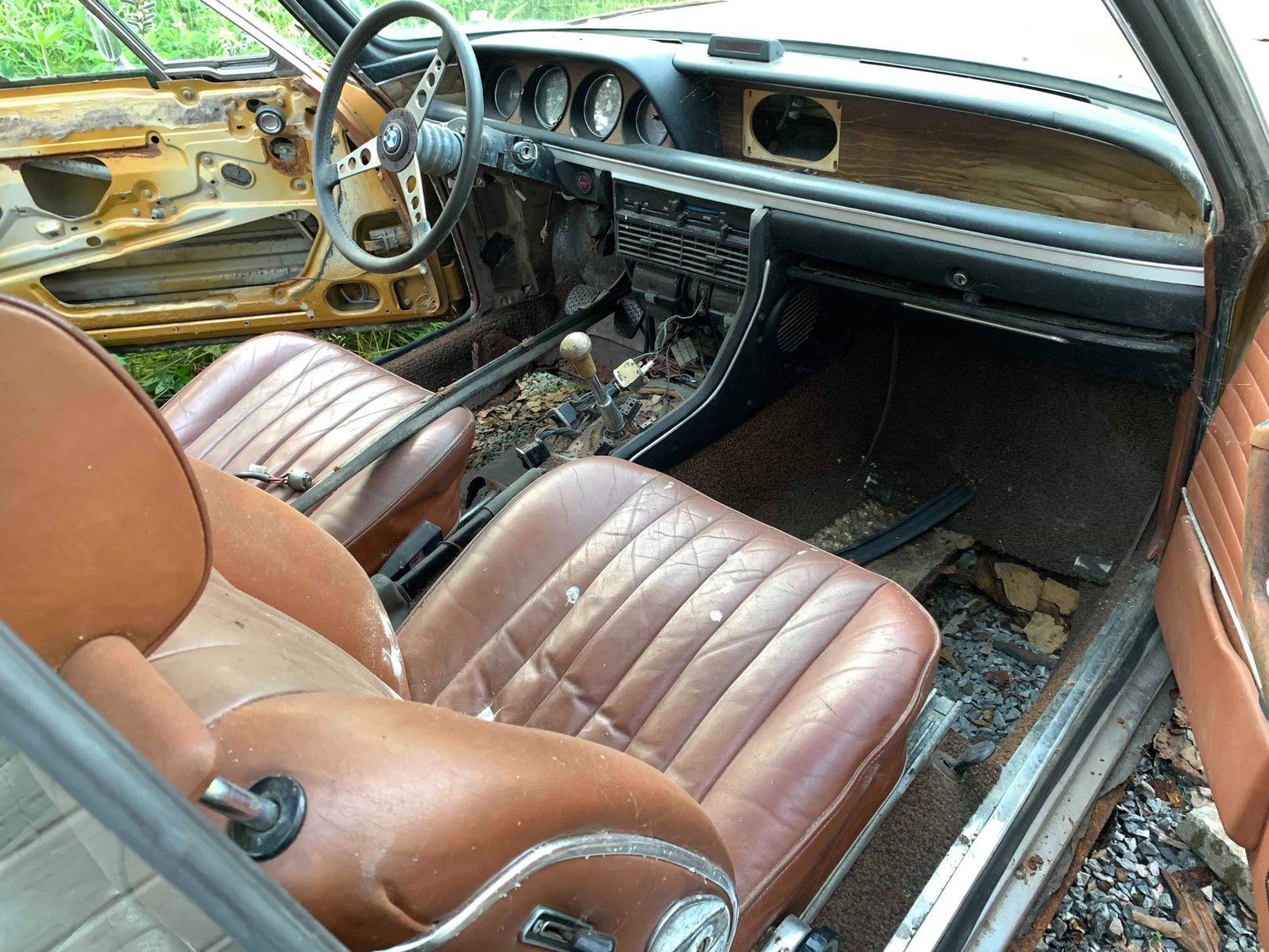

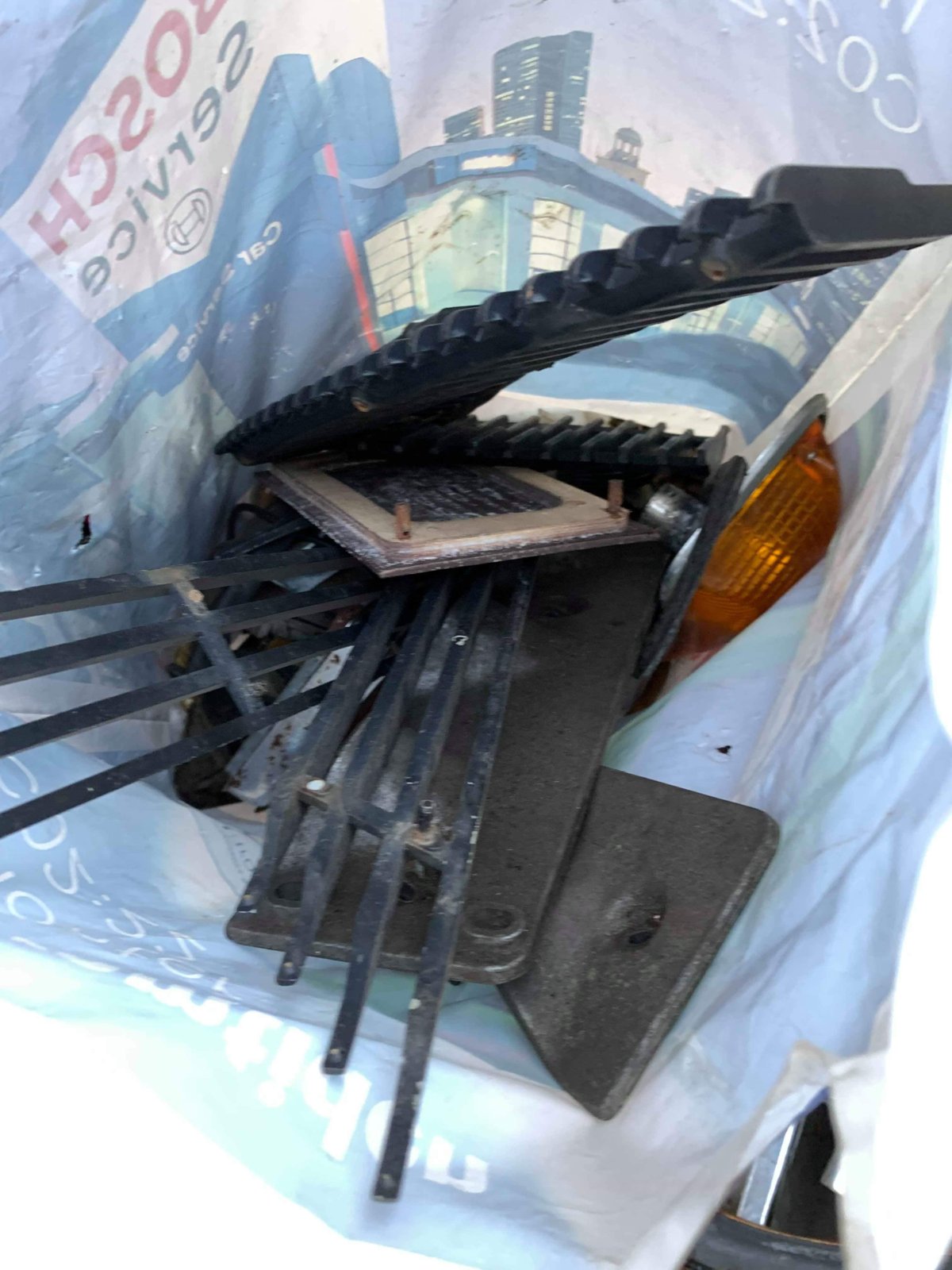

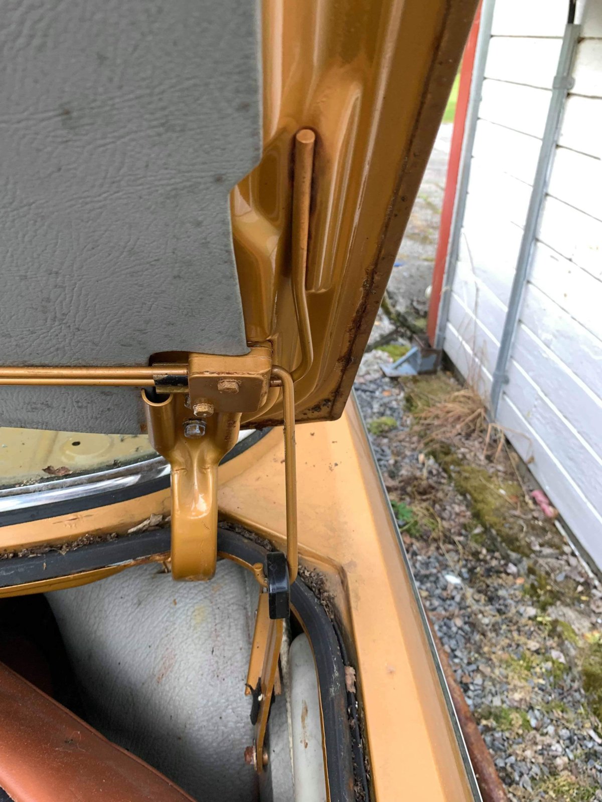

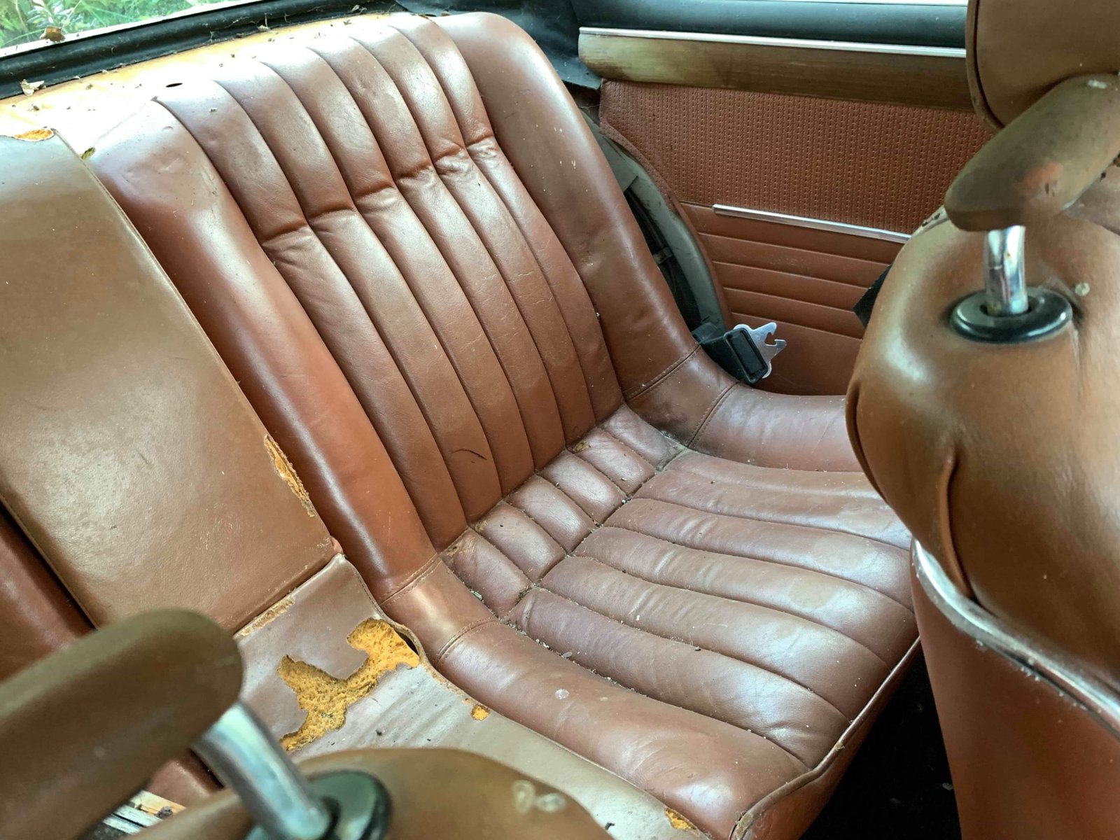

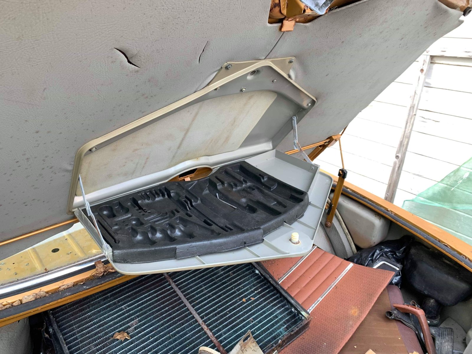

First post to the forum but I have been reading for a few years . This thread is a restoration of my 1973 3.0 CS , a US-spec car that never sold to the US , instead delivererd as new to BMW Italy S.p.a on the 14th of August 1973 .
Originally Ceylon with brown leather and AC which I think is a really nice option. Wheater the color will remain Ceylon is still undecided..

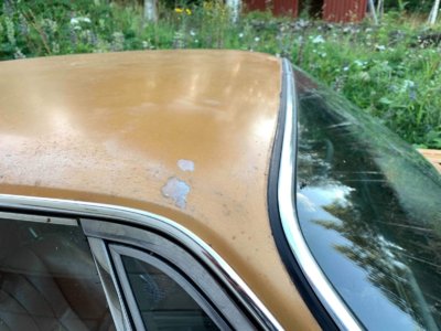

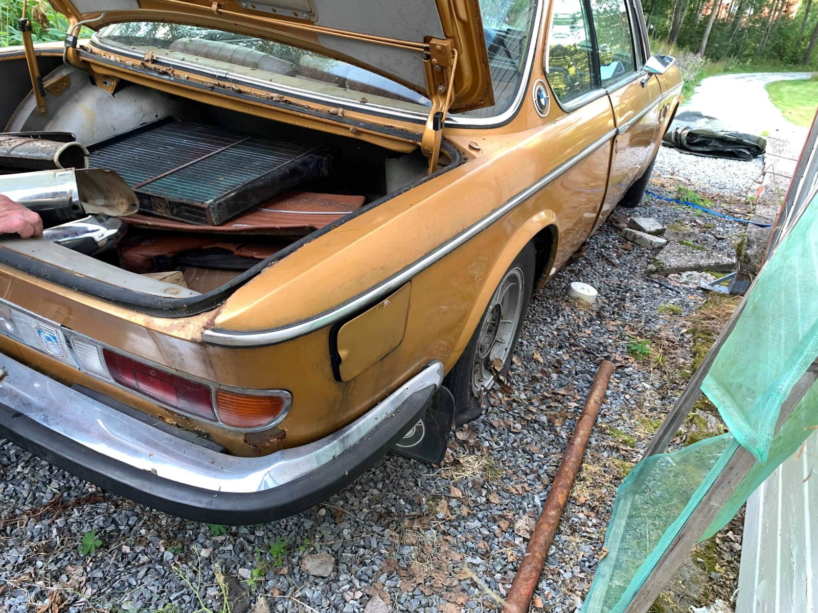

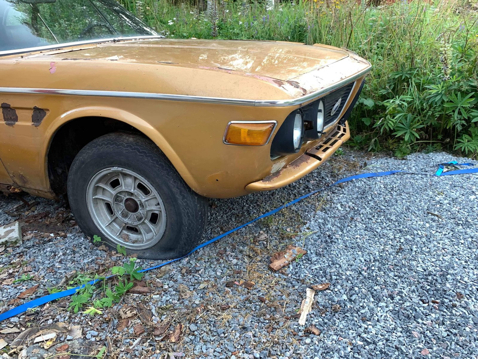

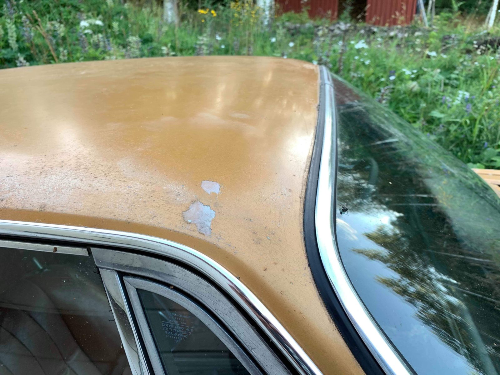

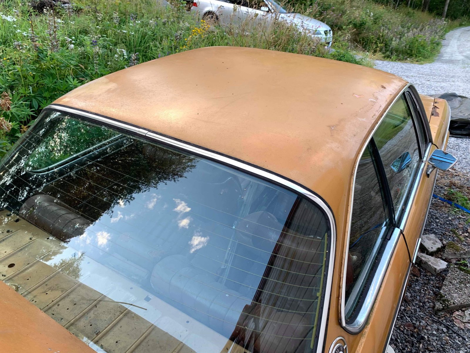

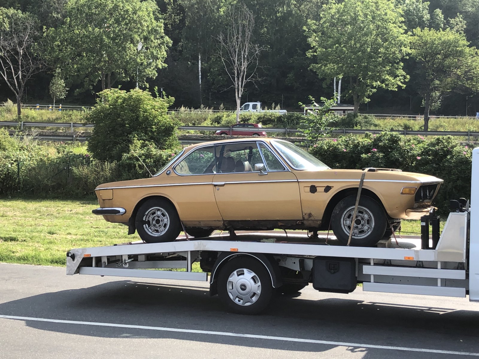

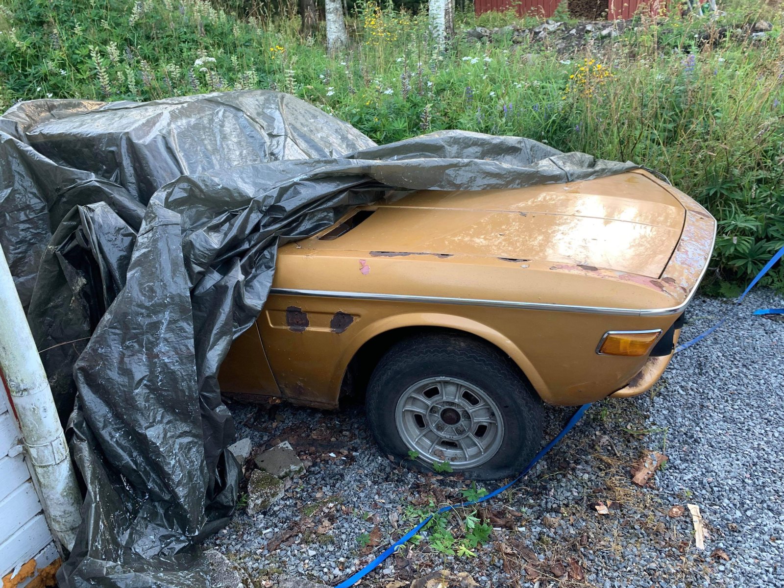

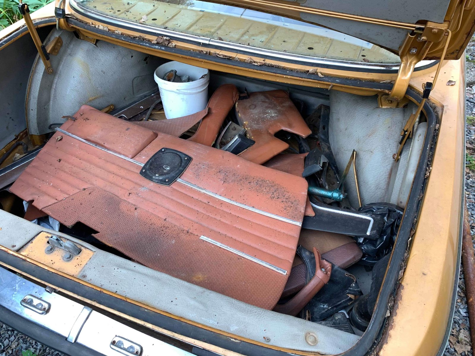

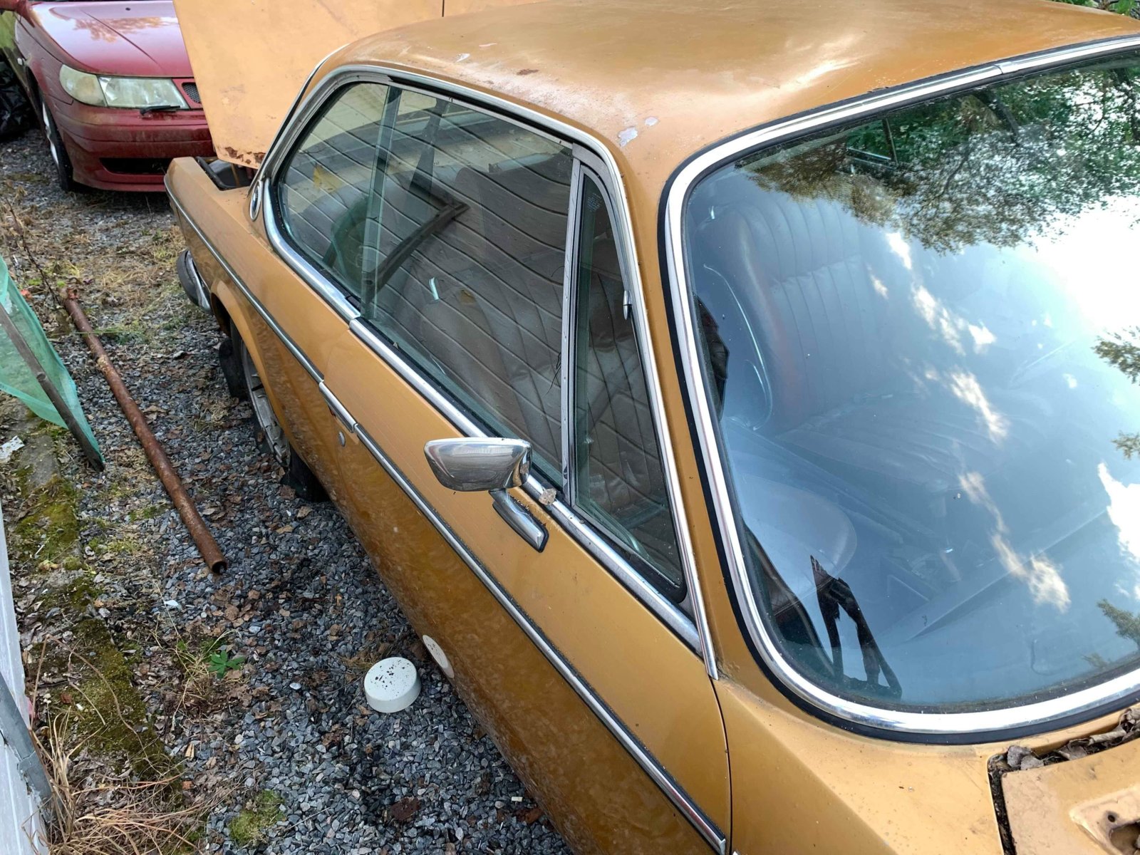

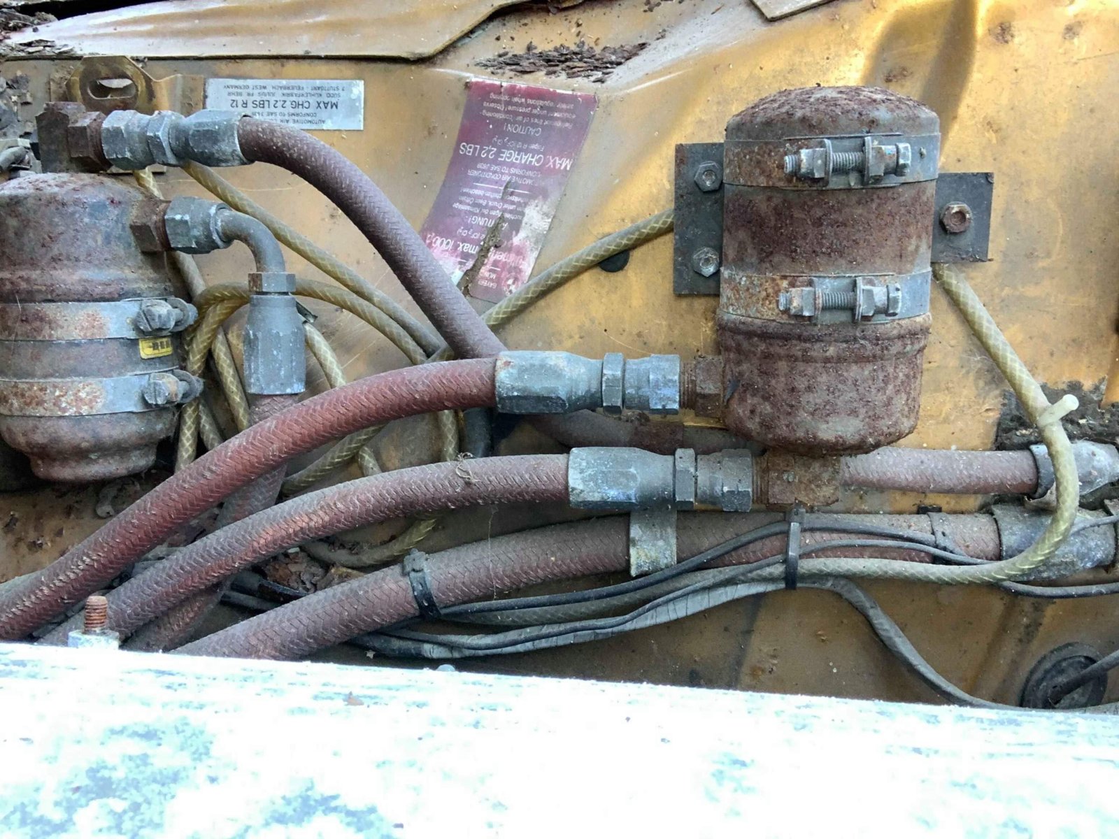

I started the restoration in November 2019 , the car had then been of the road for at least 25 years and spent a number of years outside on a lawn.

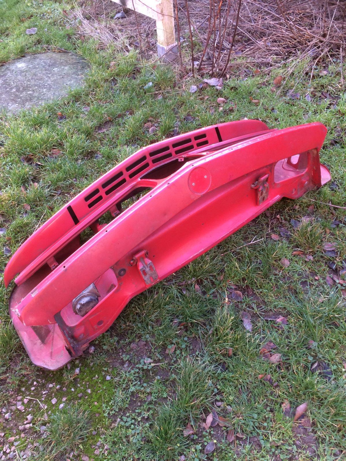

First pictures before collecting .

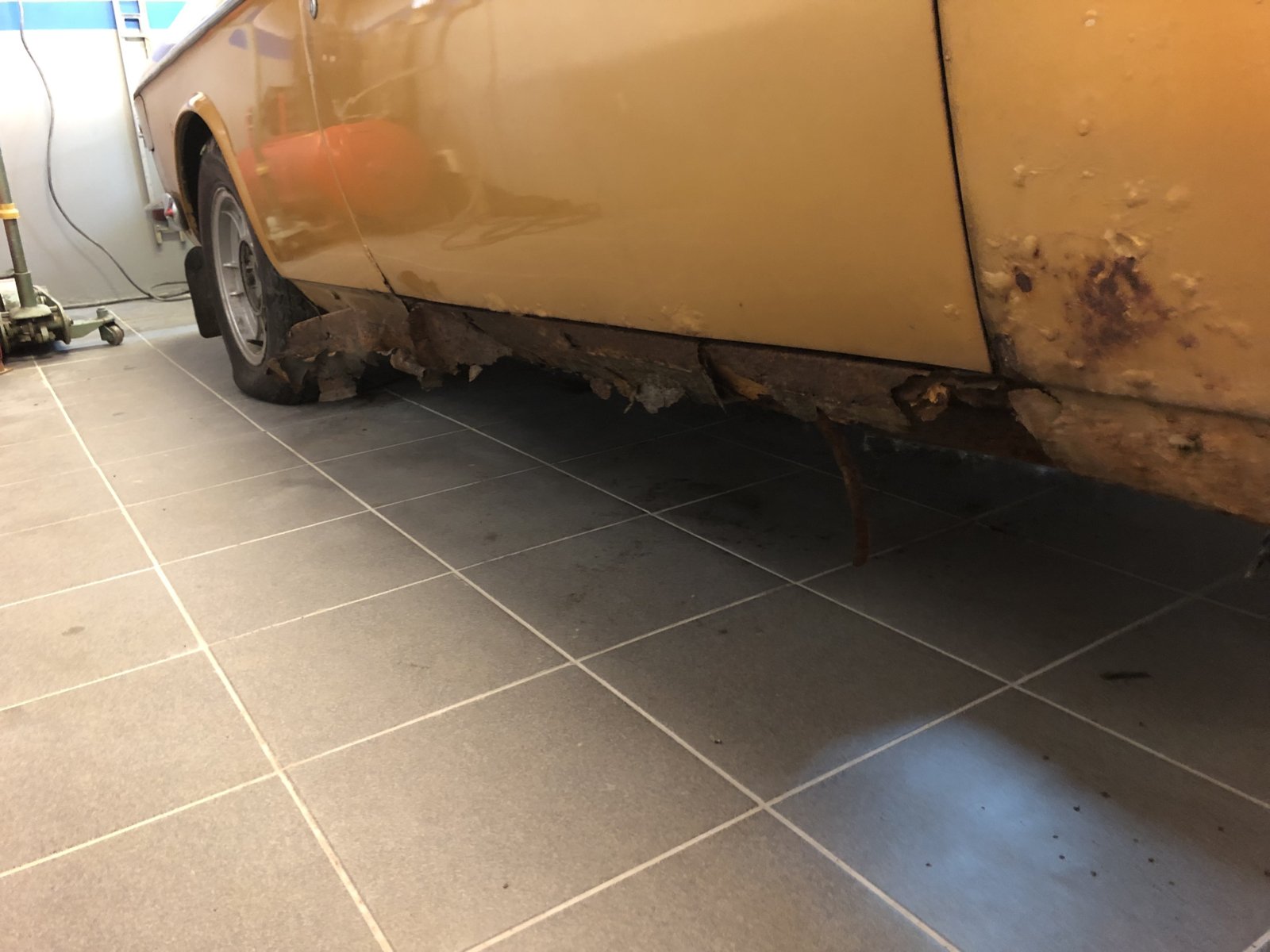

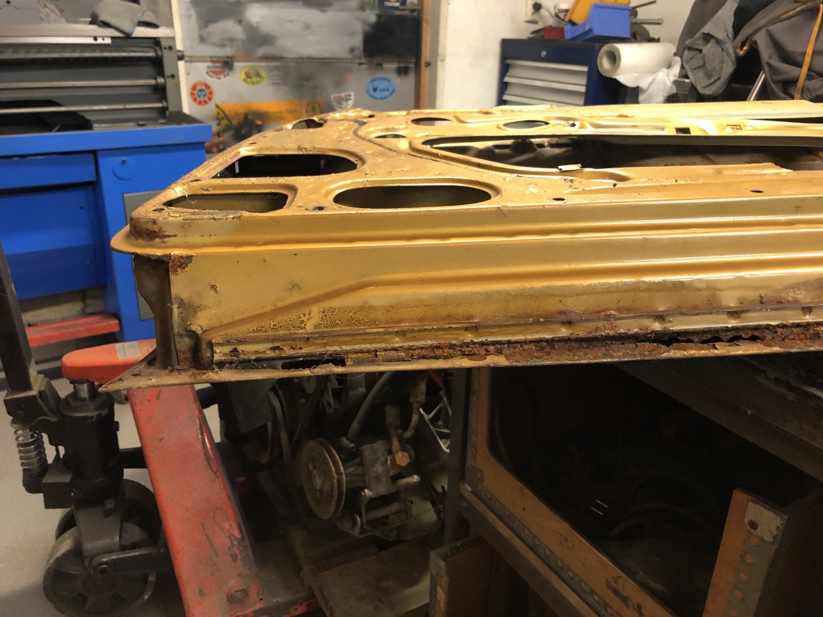

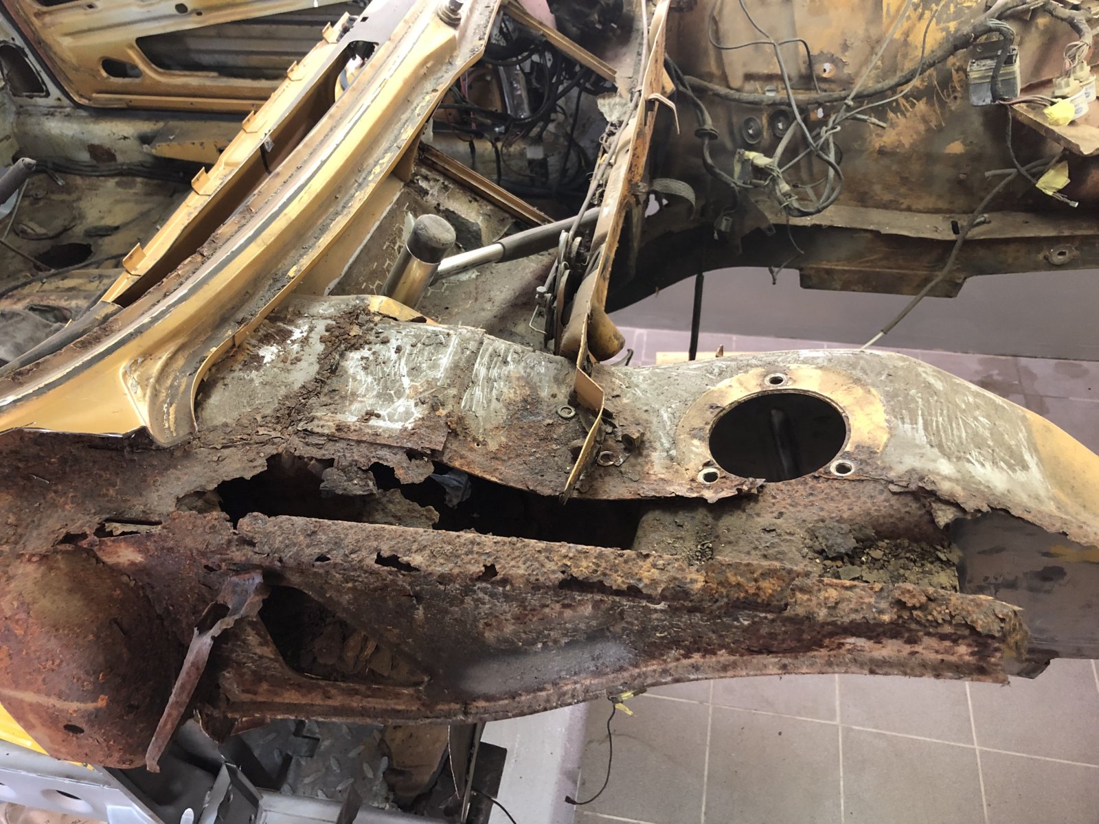

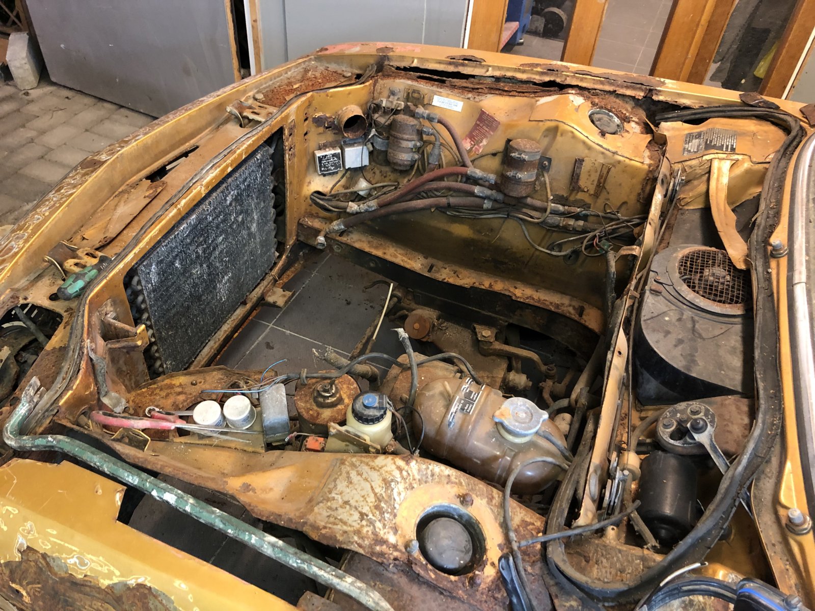

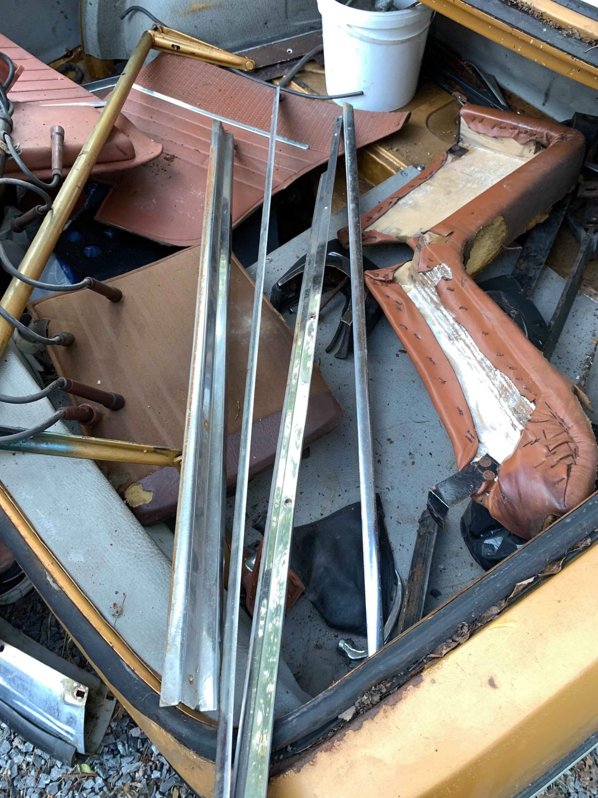

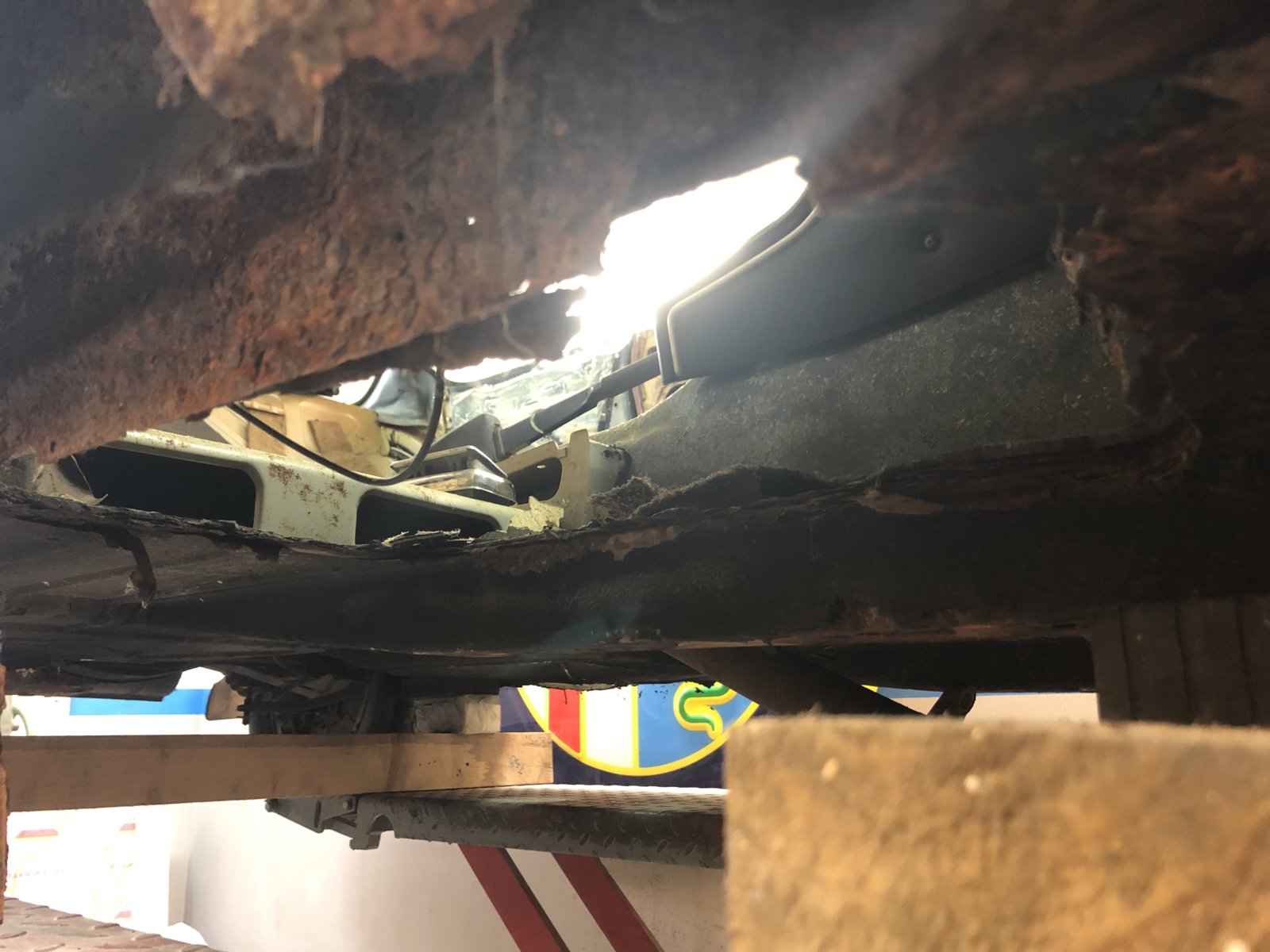

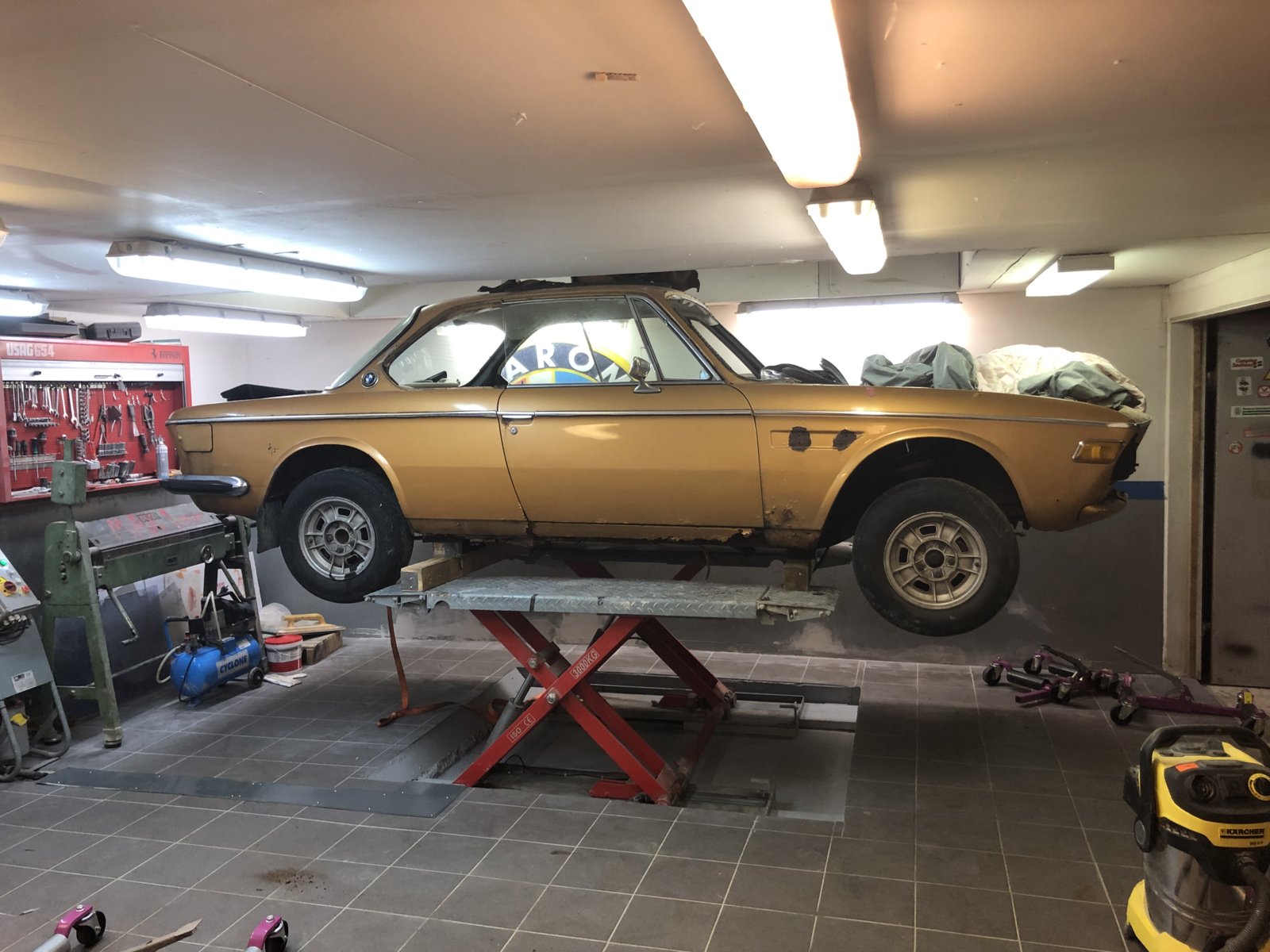

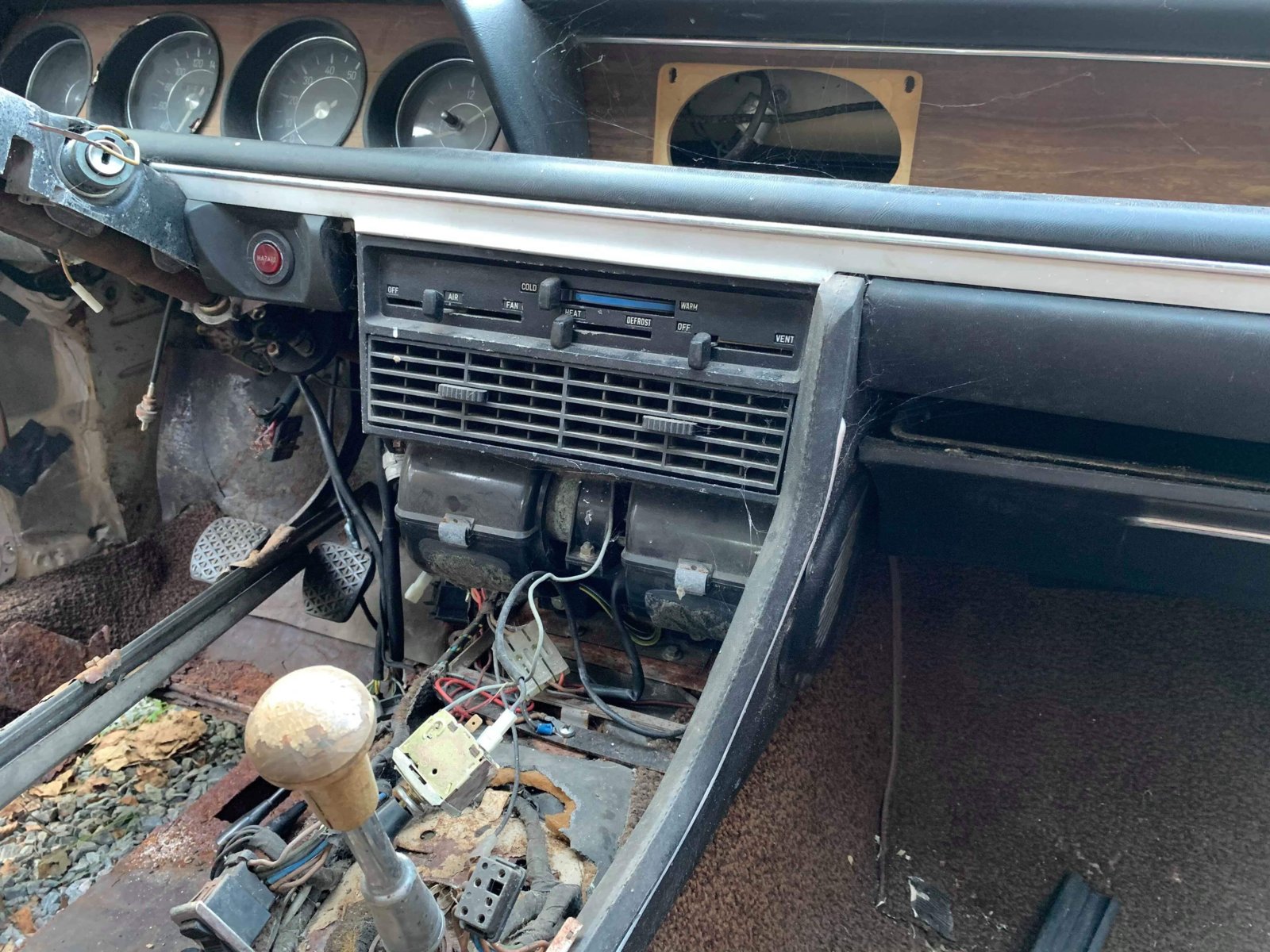

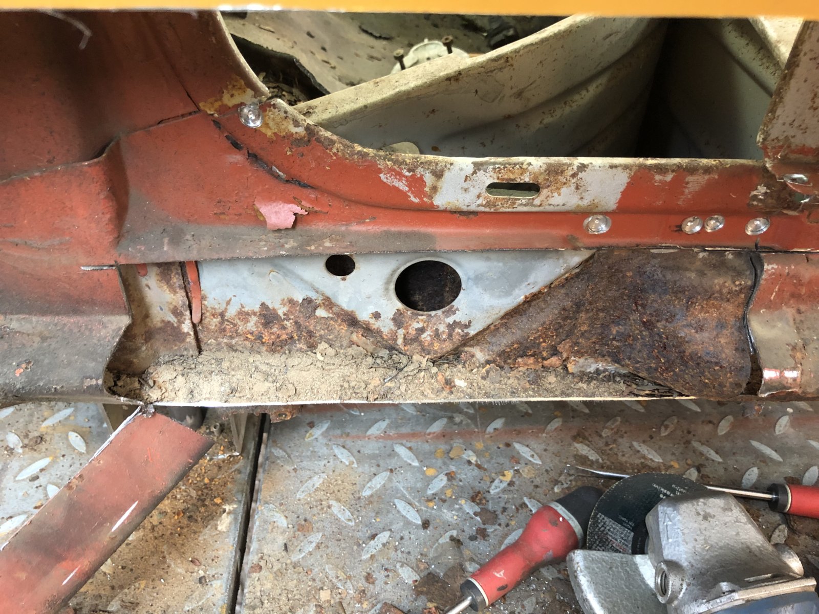

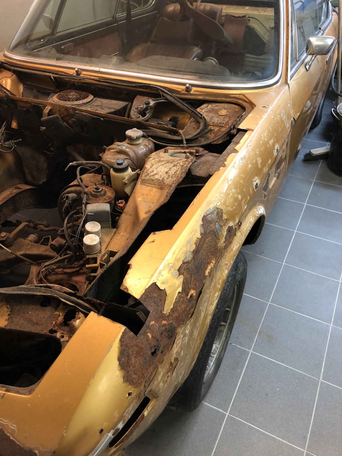

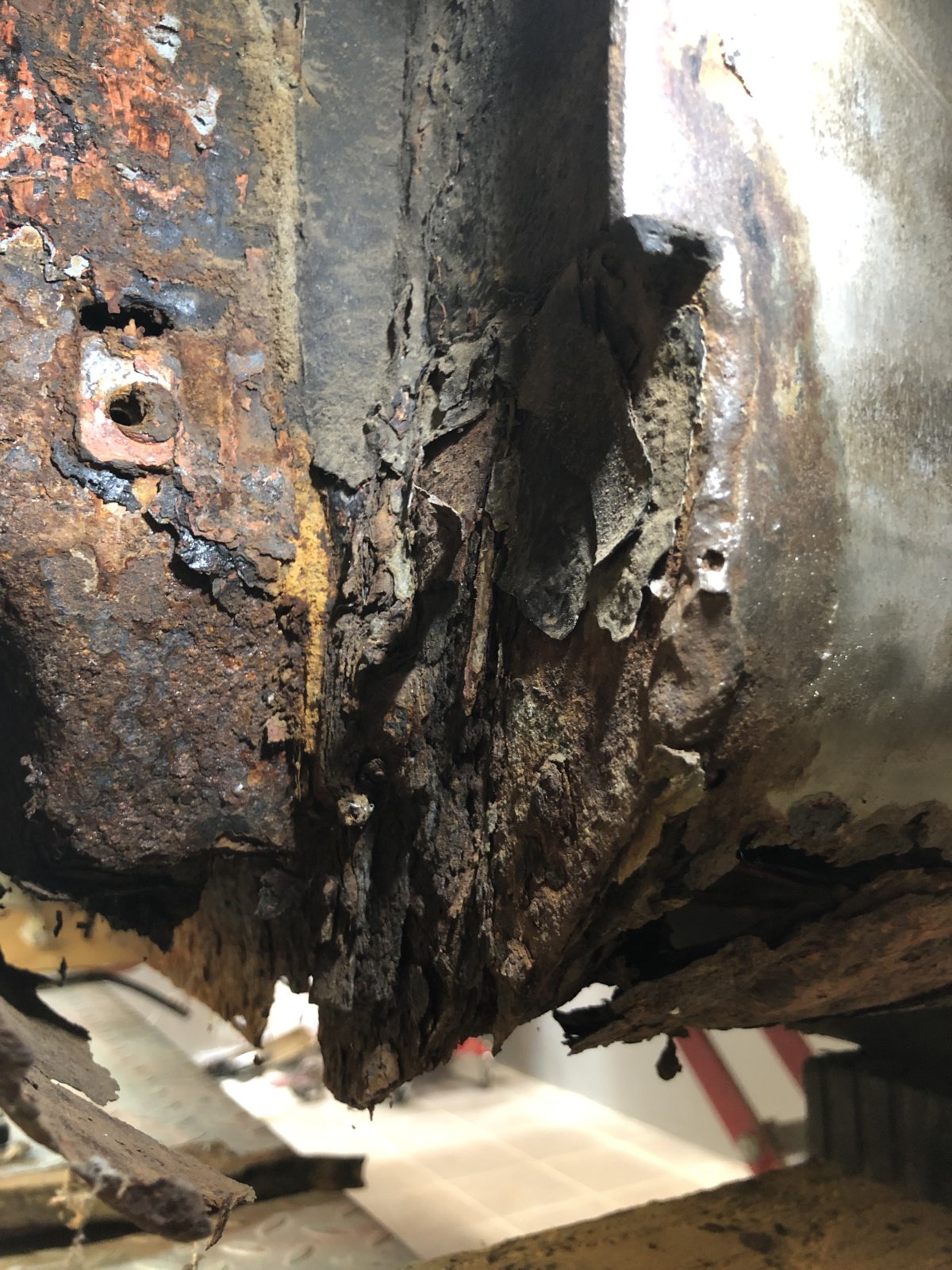

After getting it home , finishing some other project and making some room in the garage it was time for some inspection.

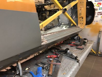

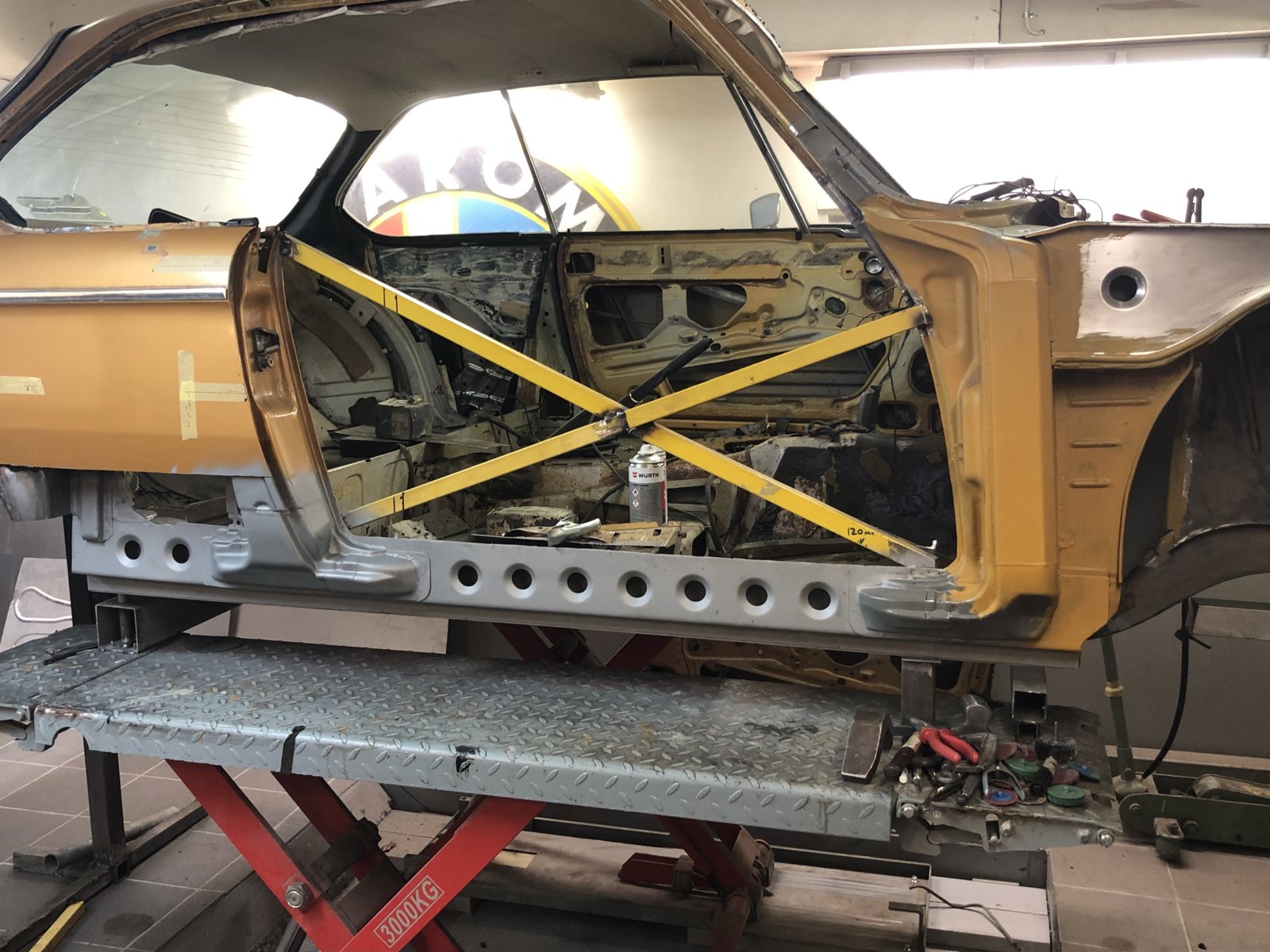

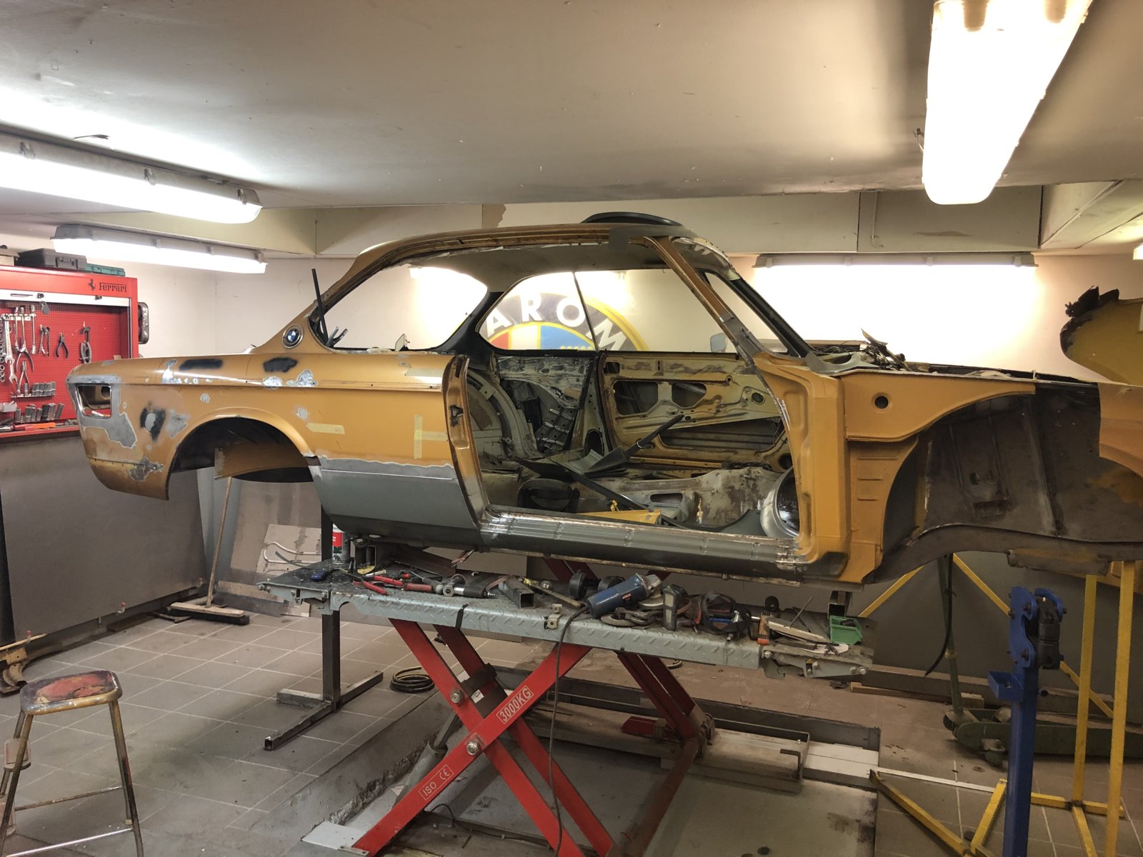

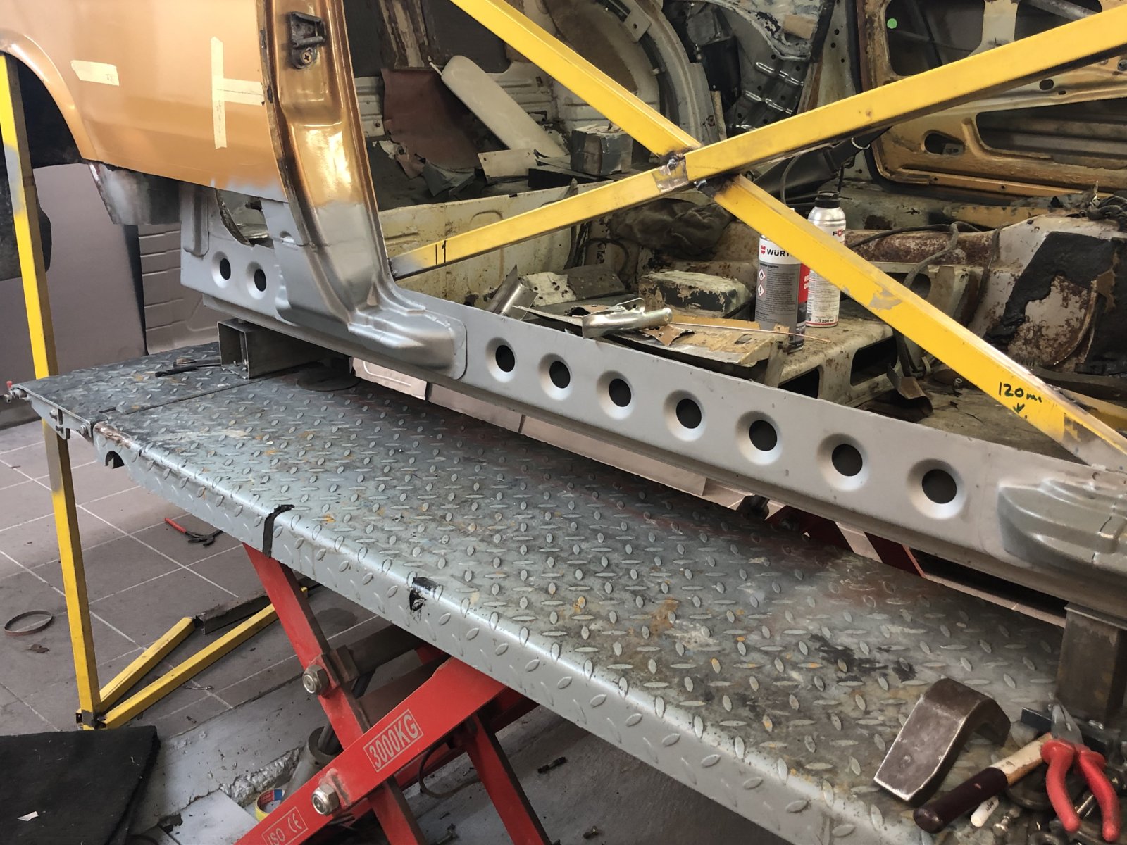

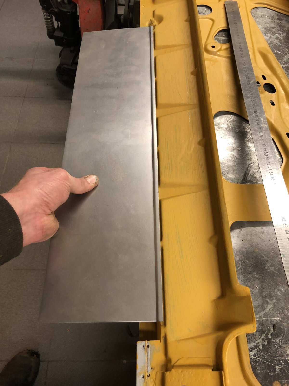

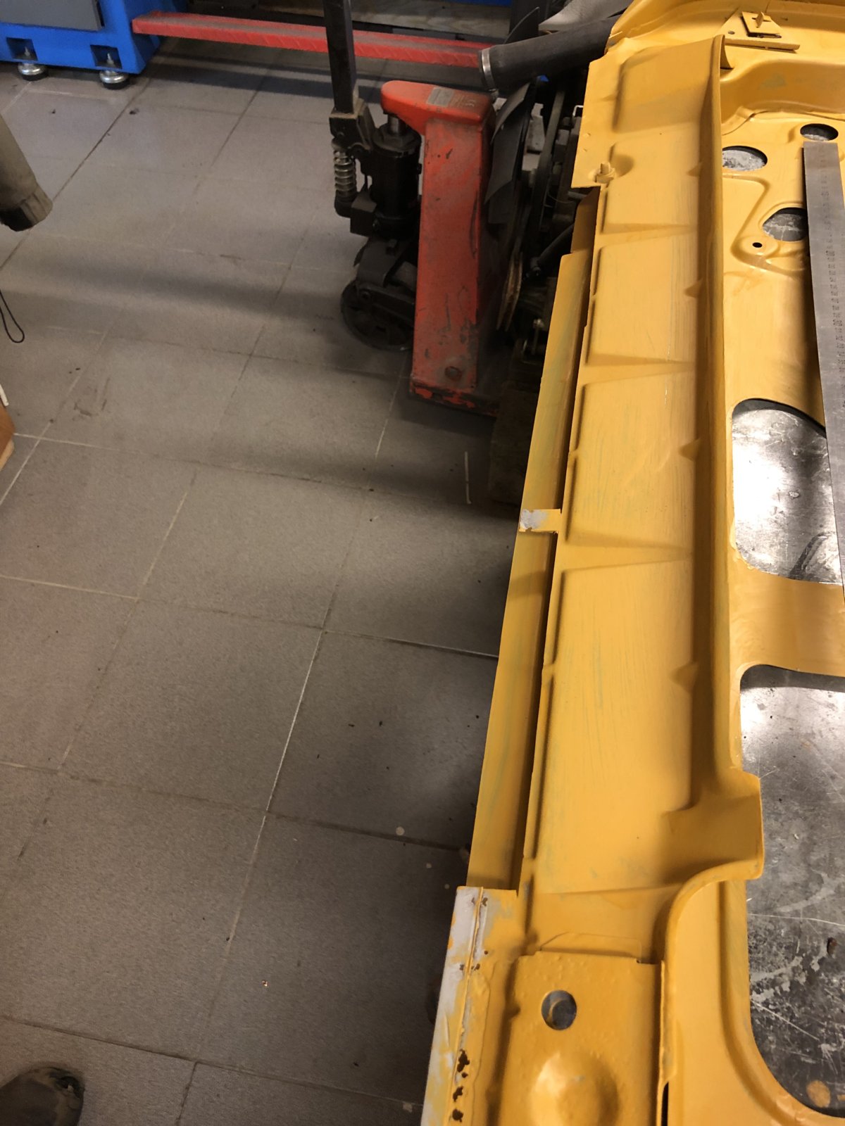

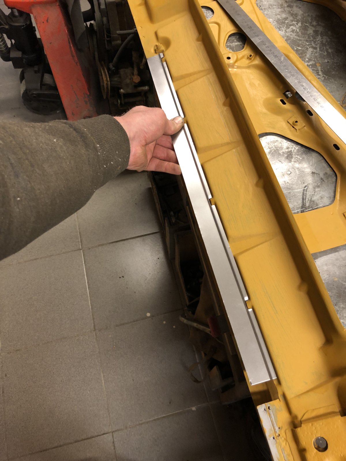

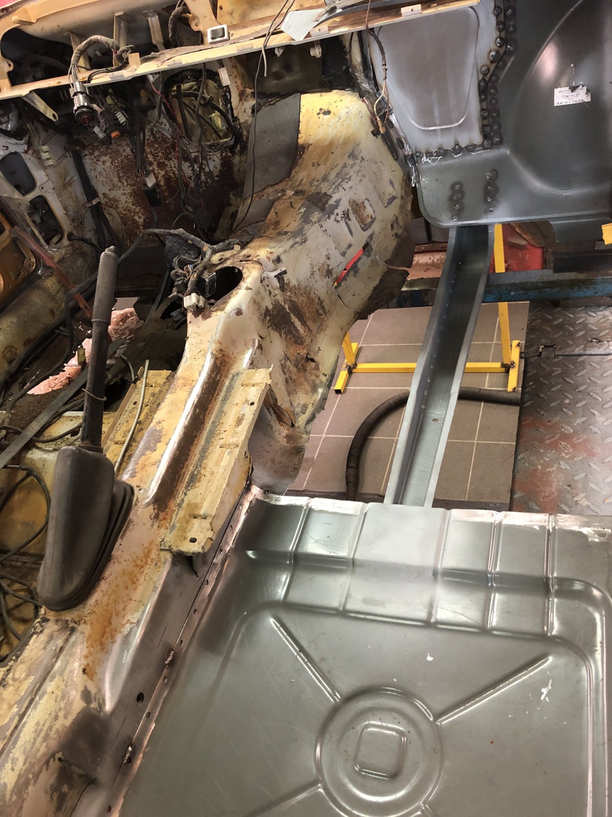

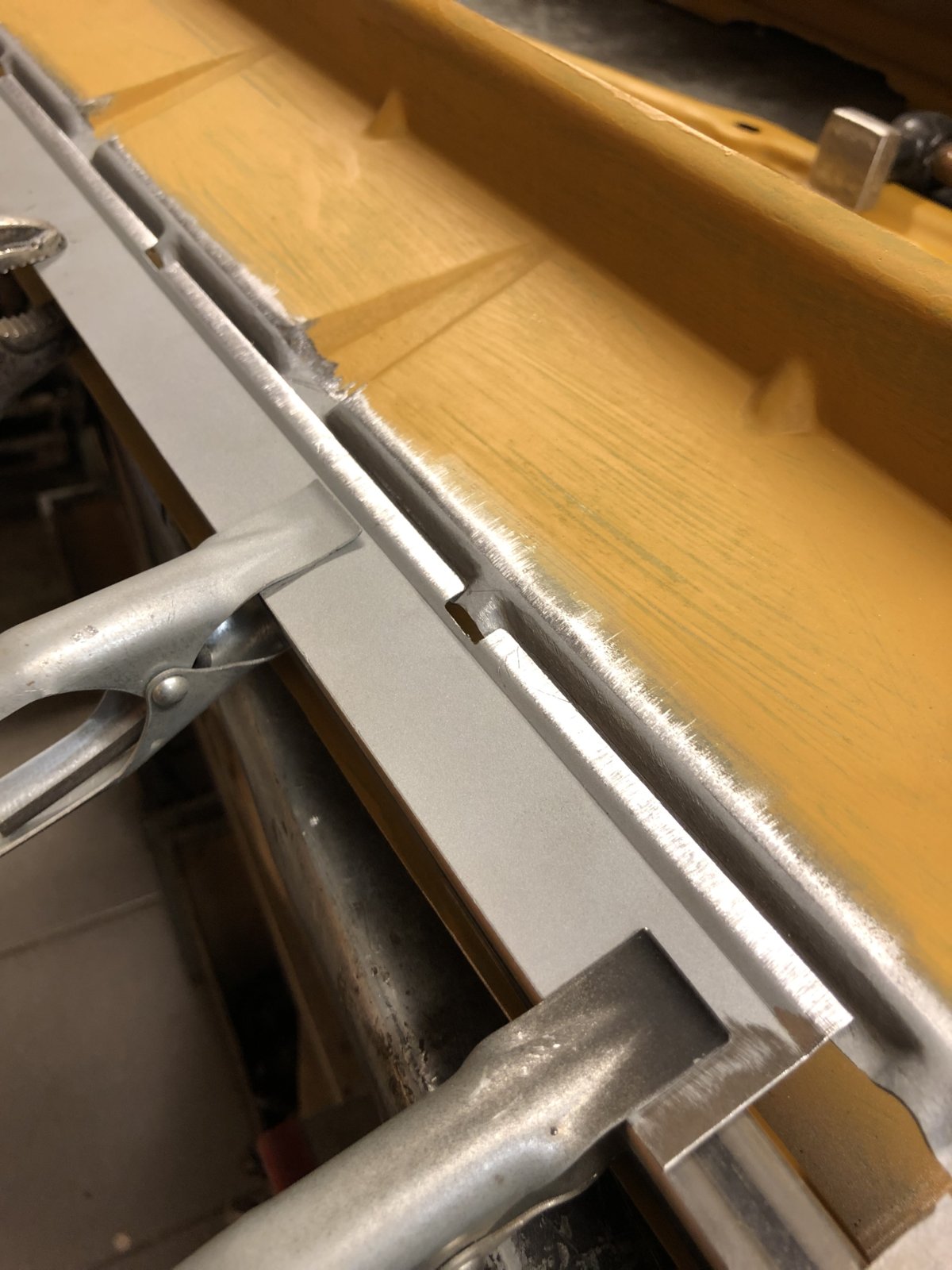

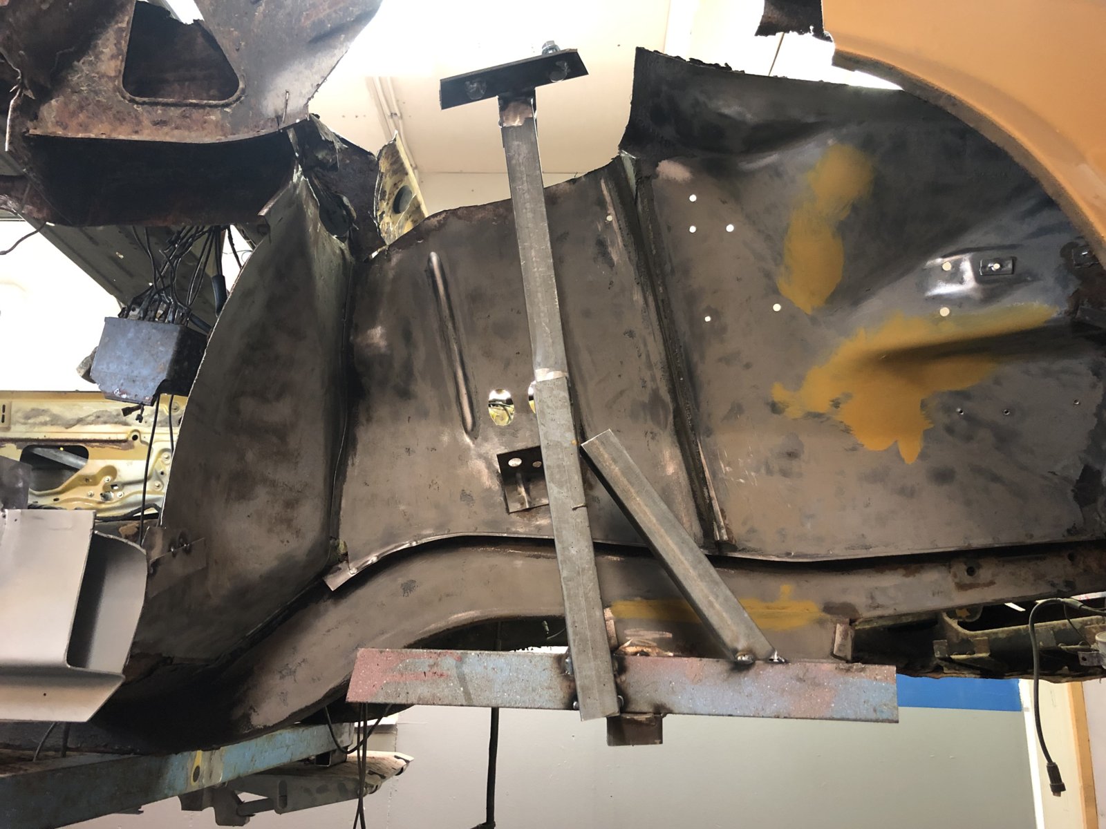

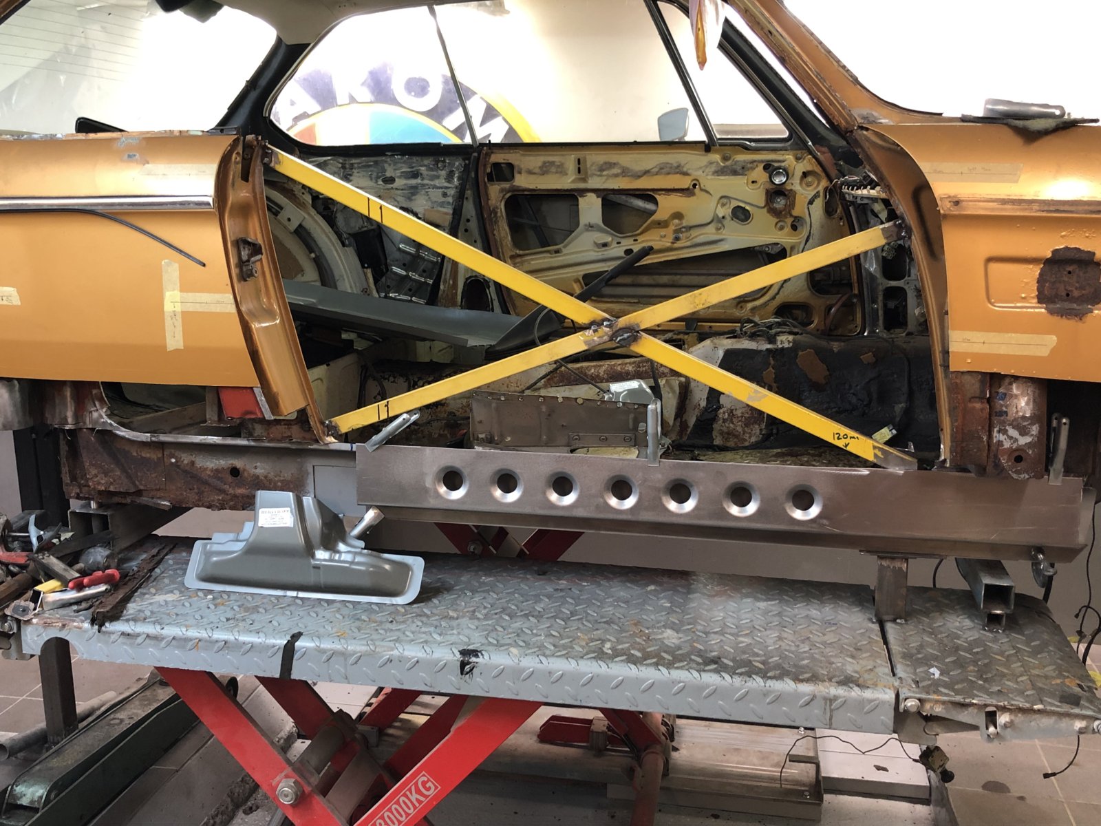

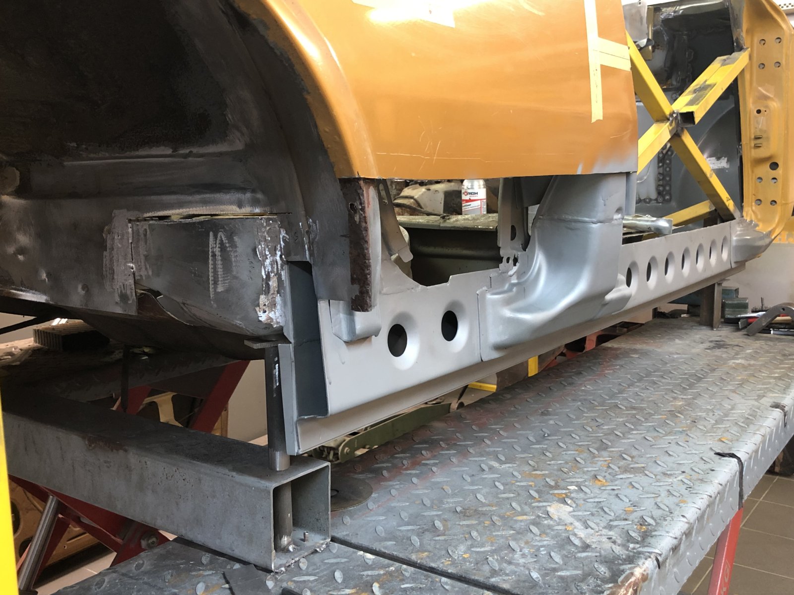

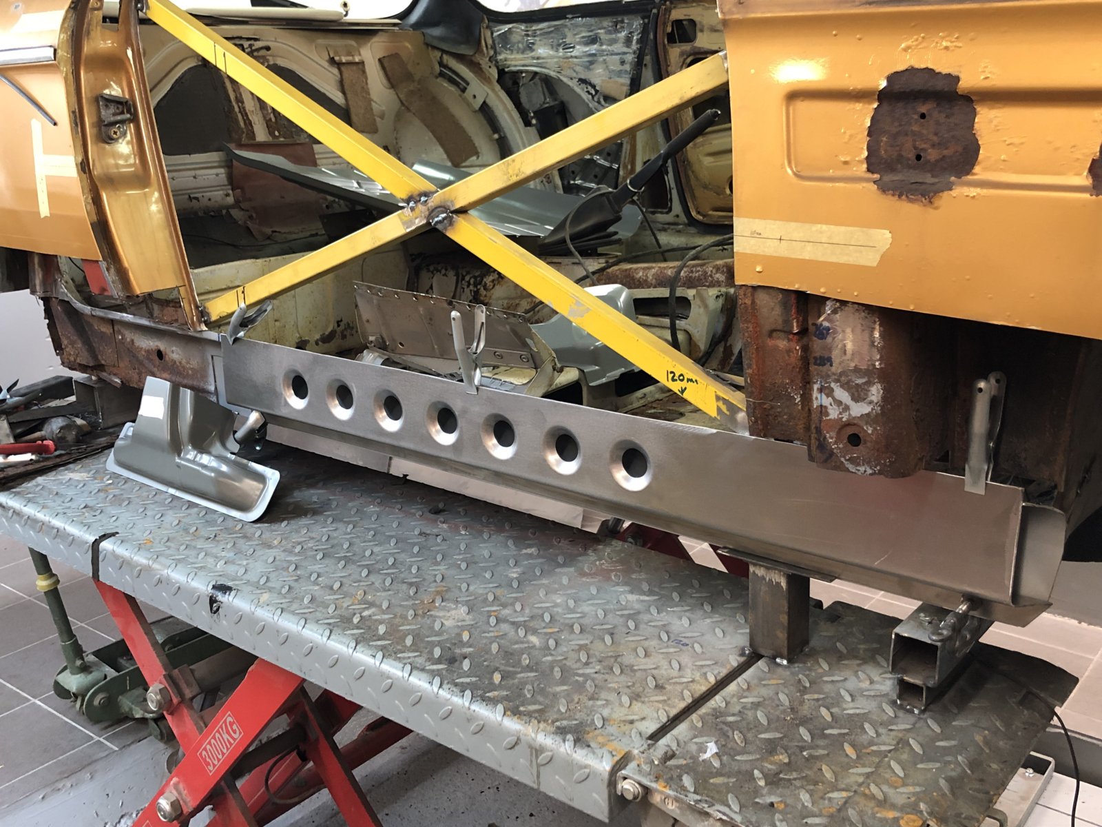

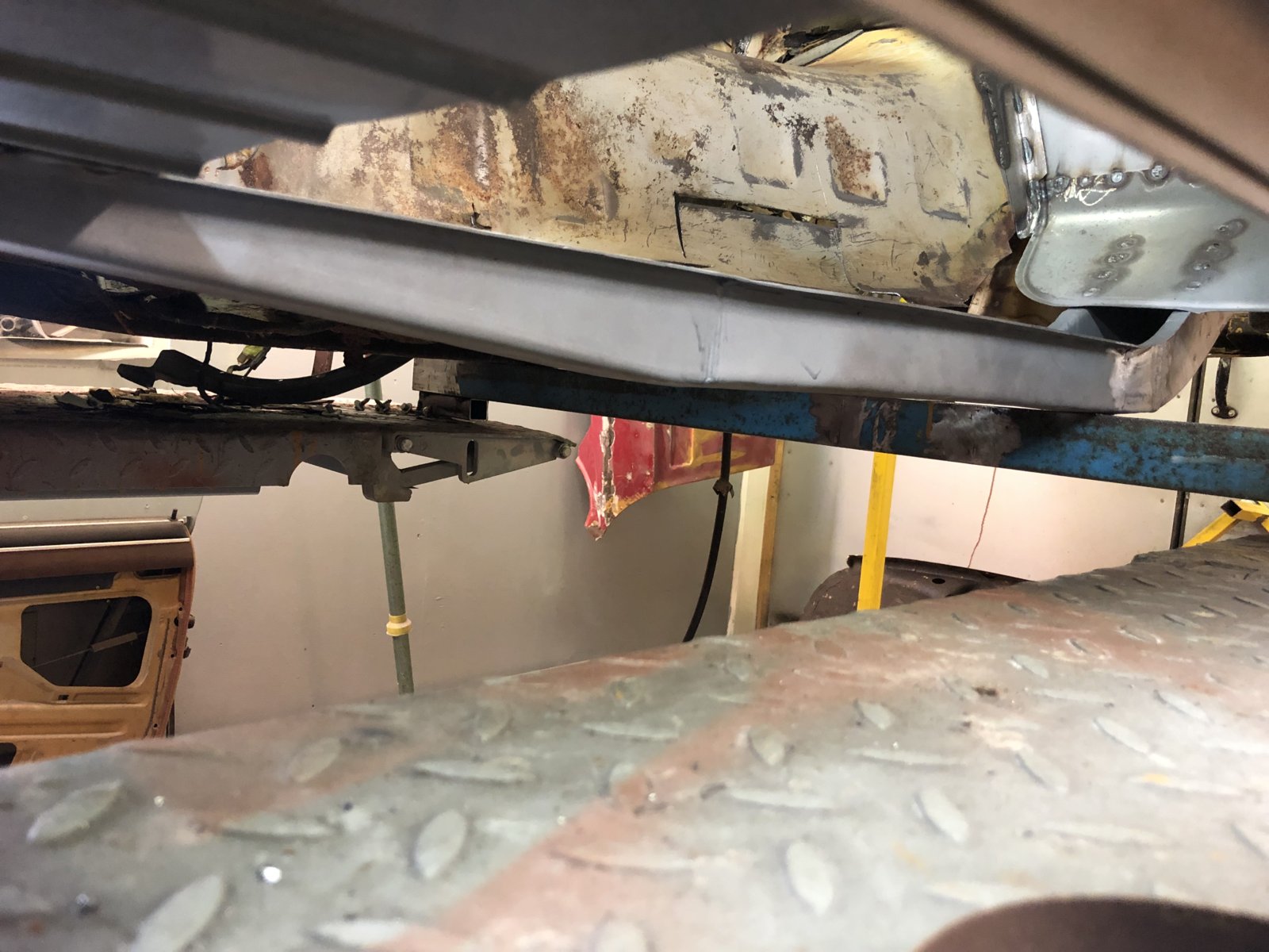

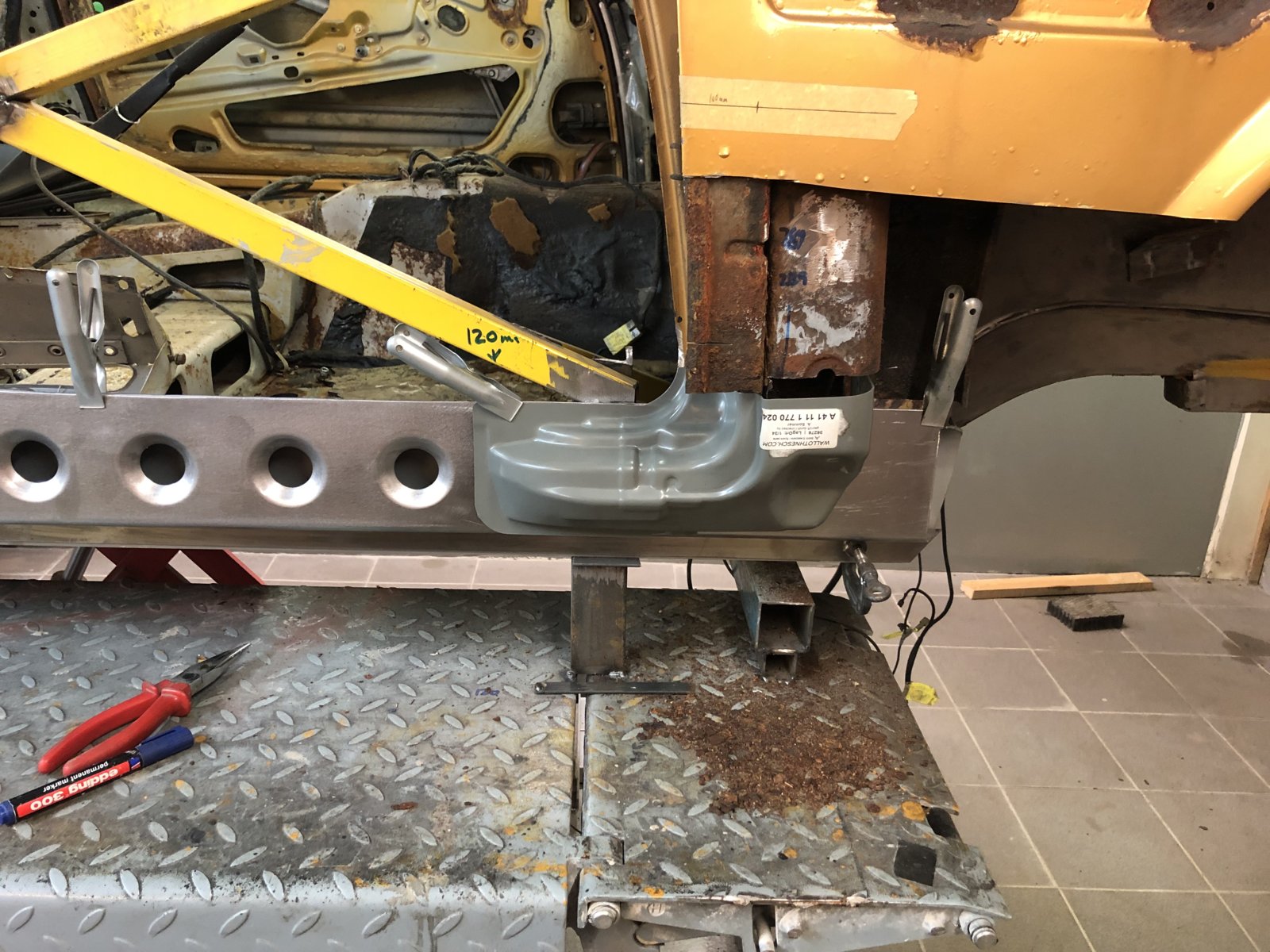

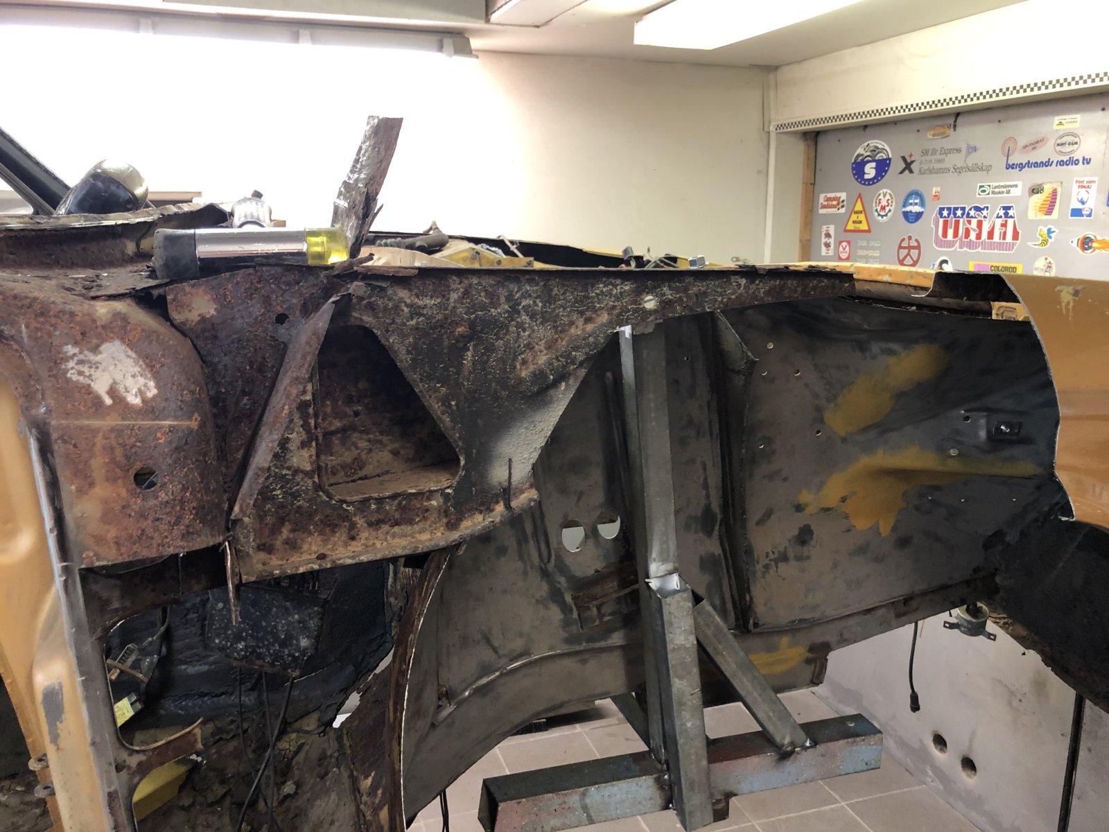

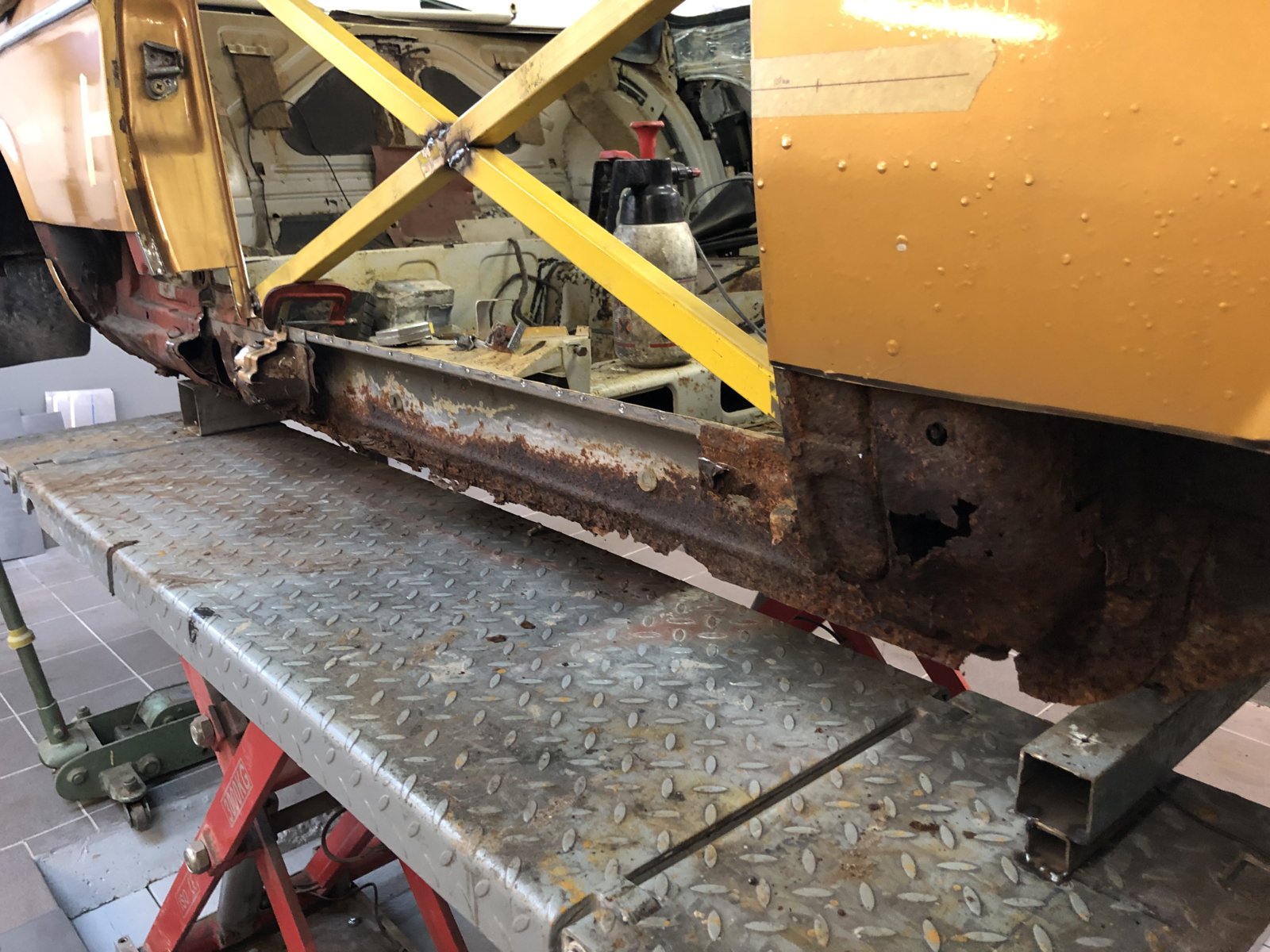

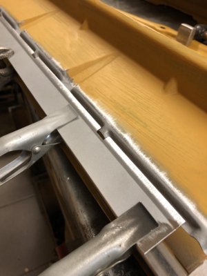

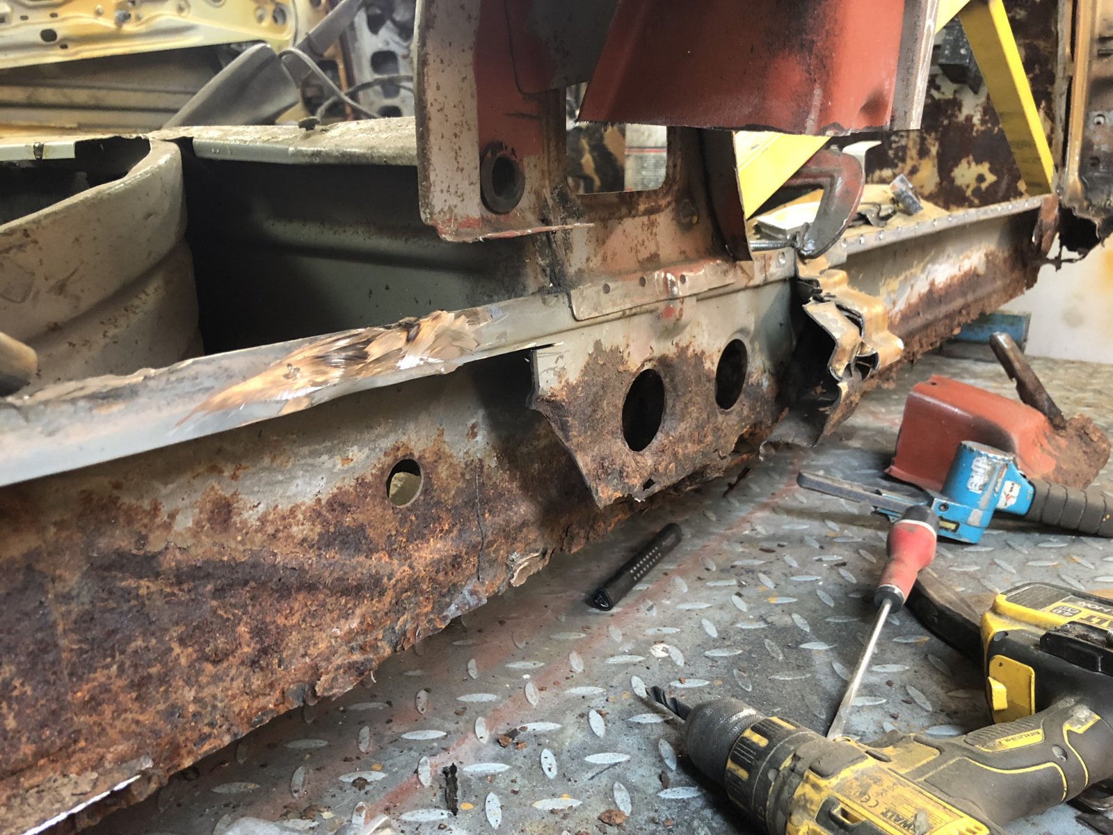

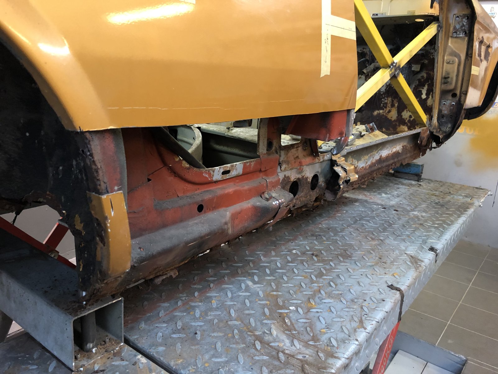

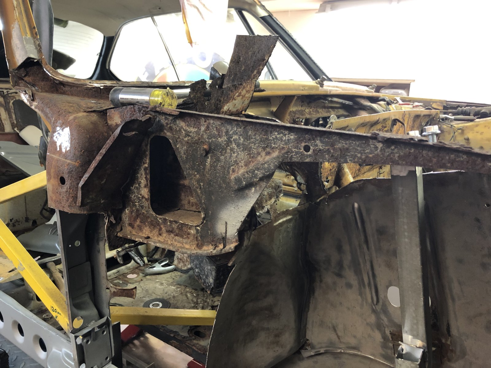

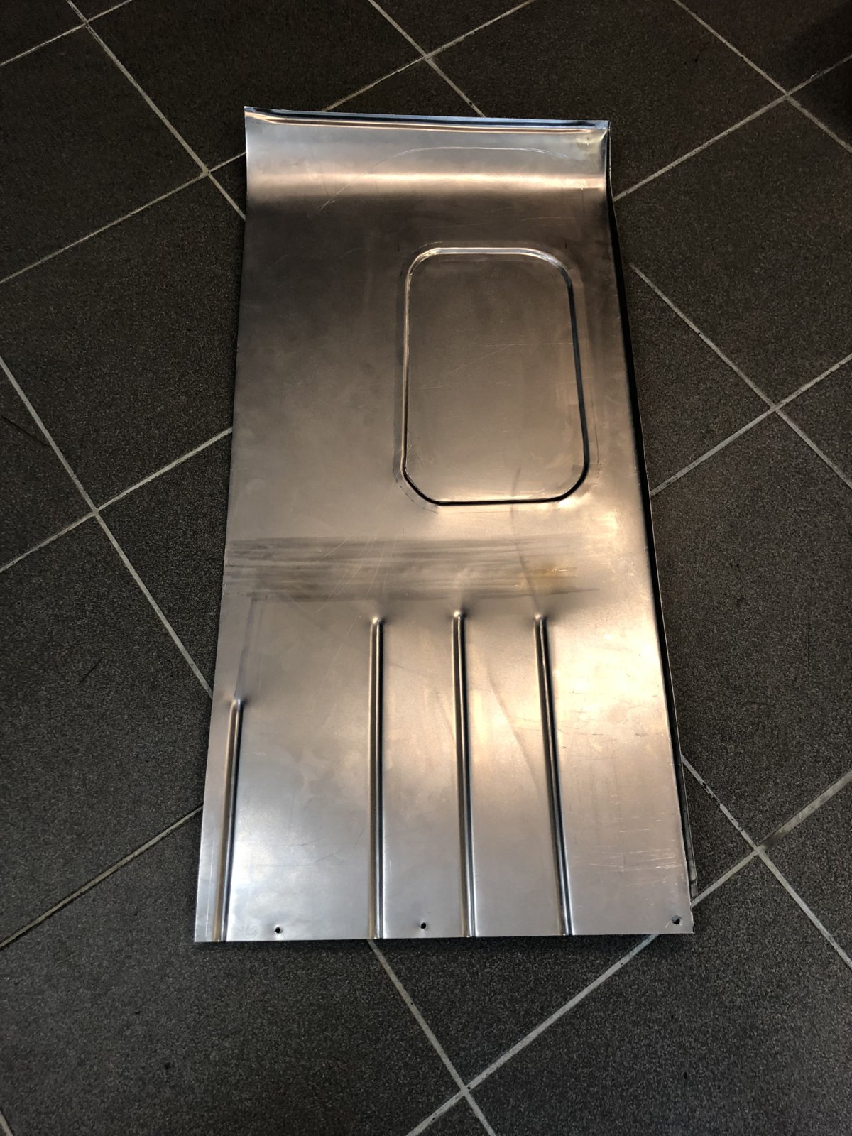

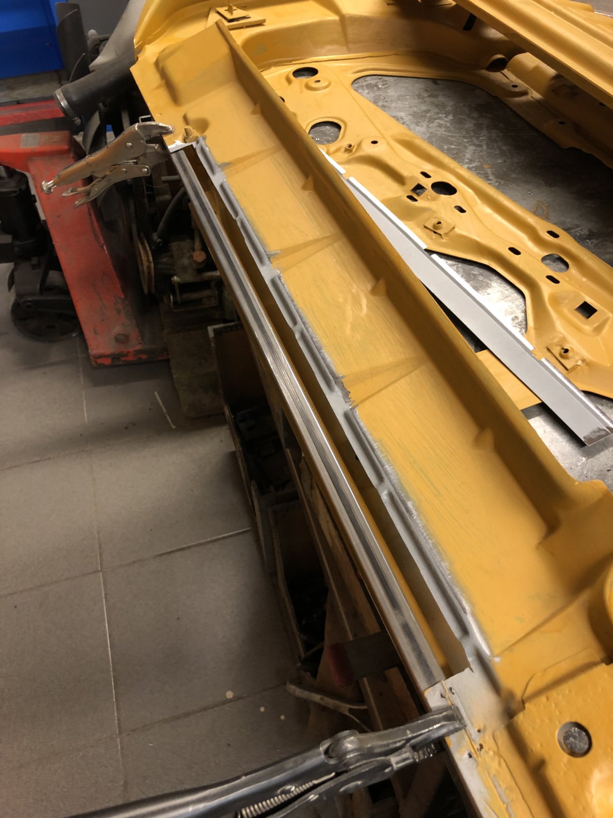

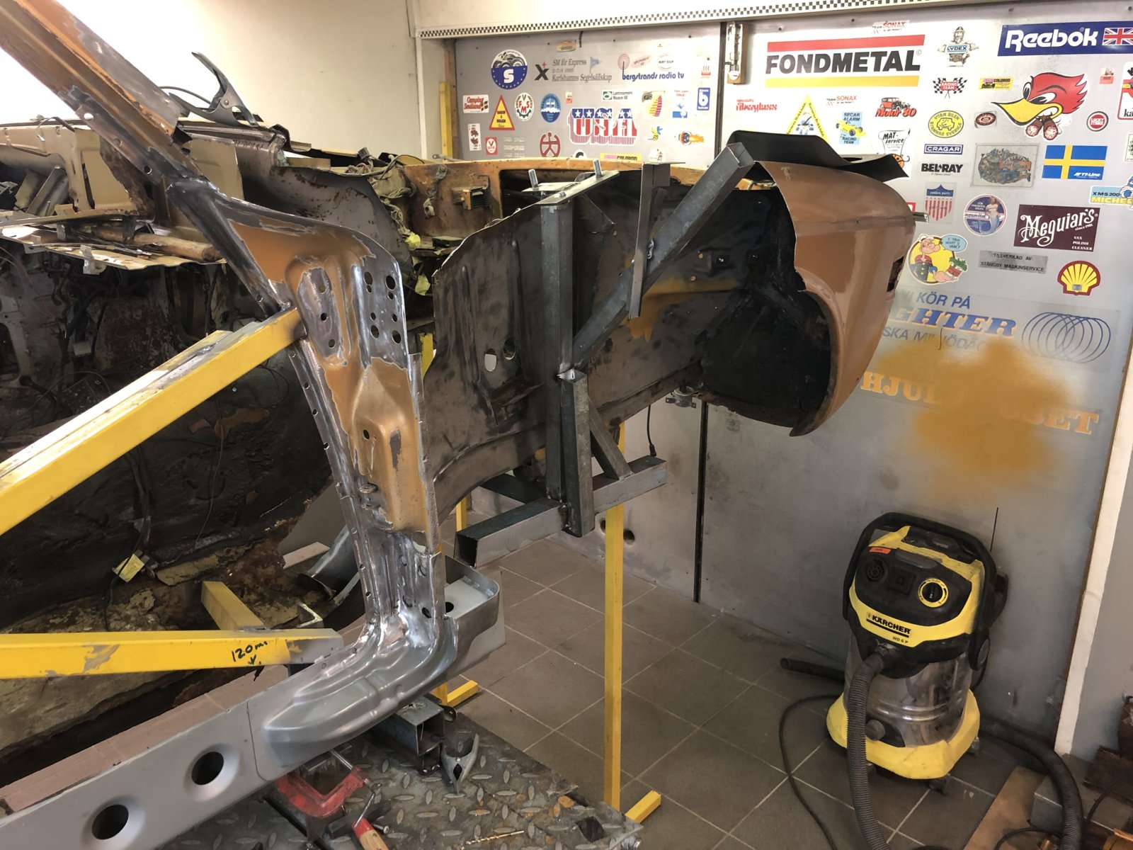

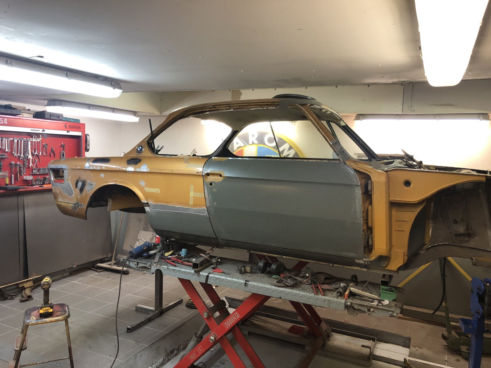

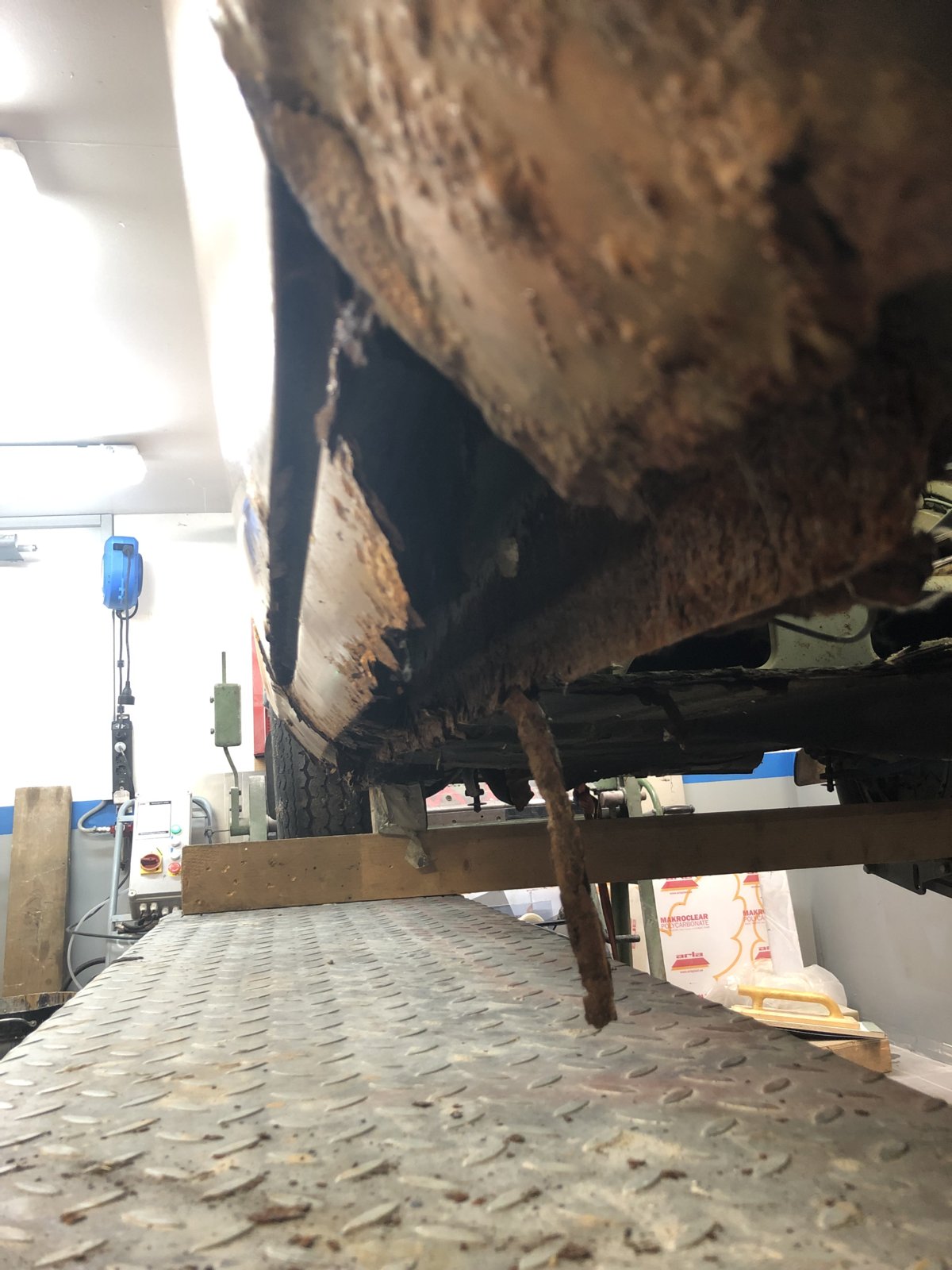

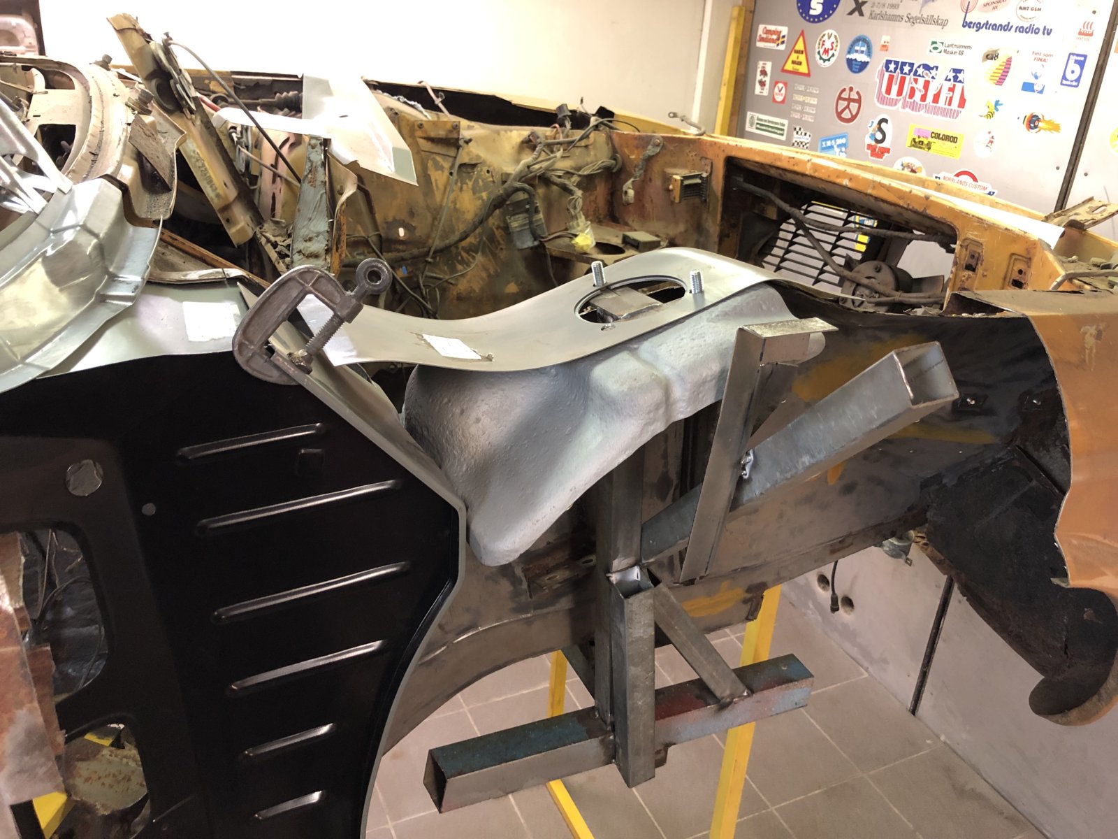

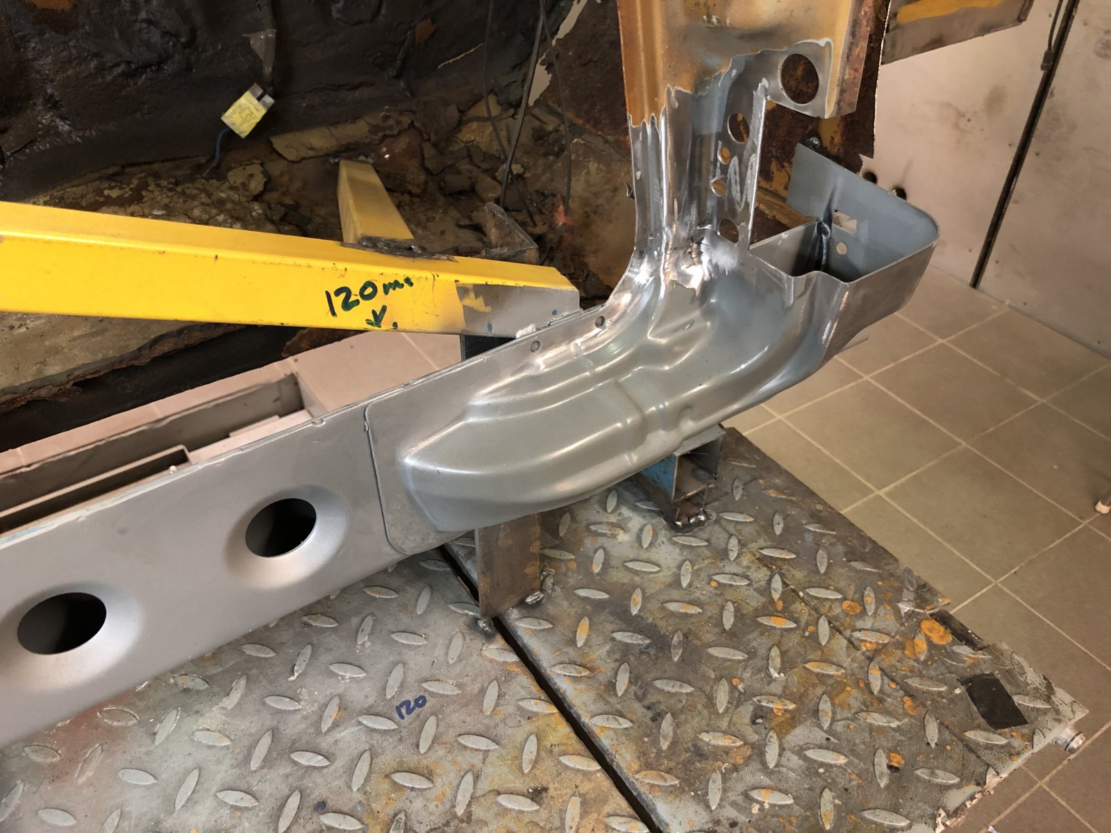

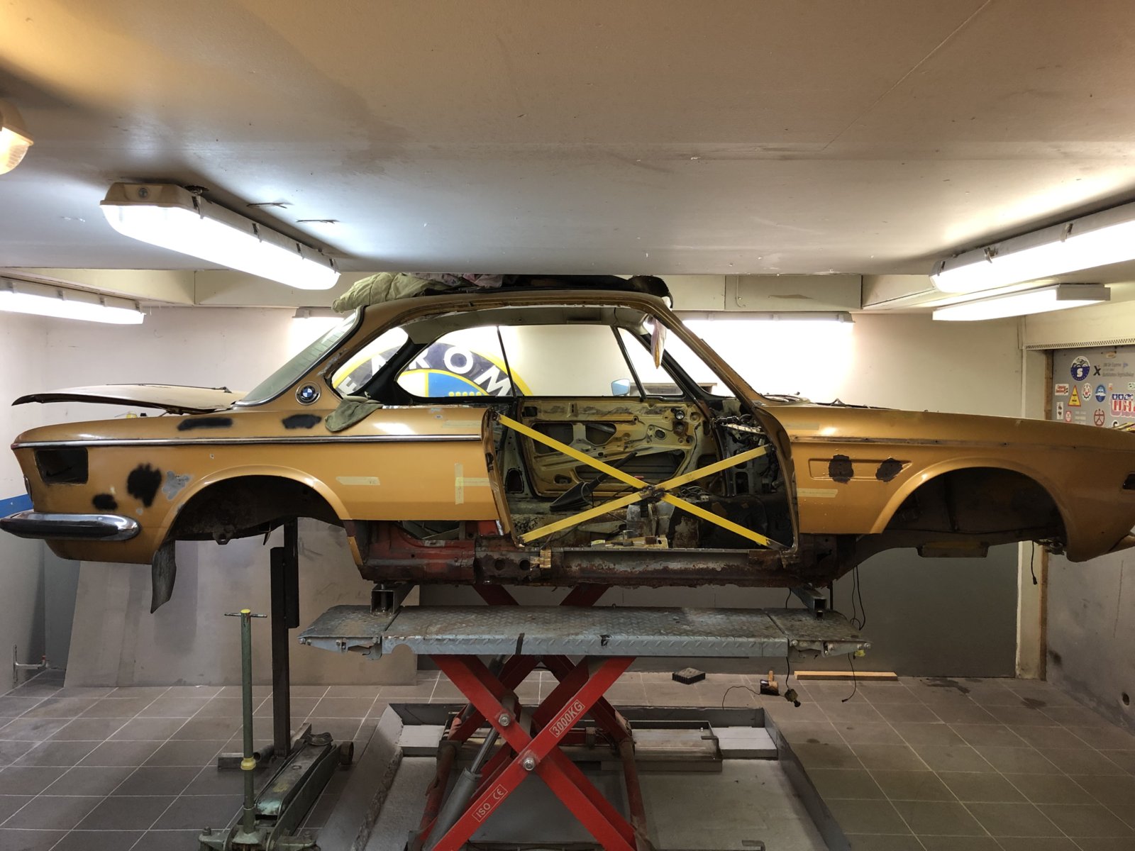

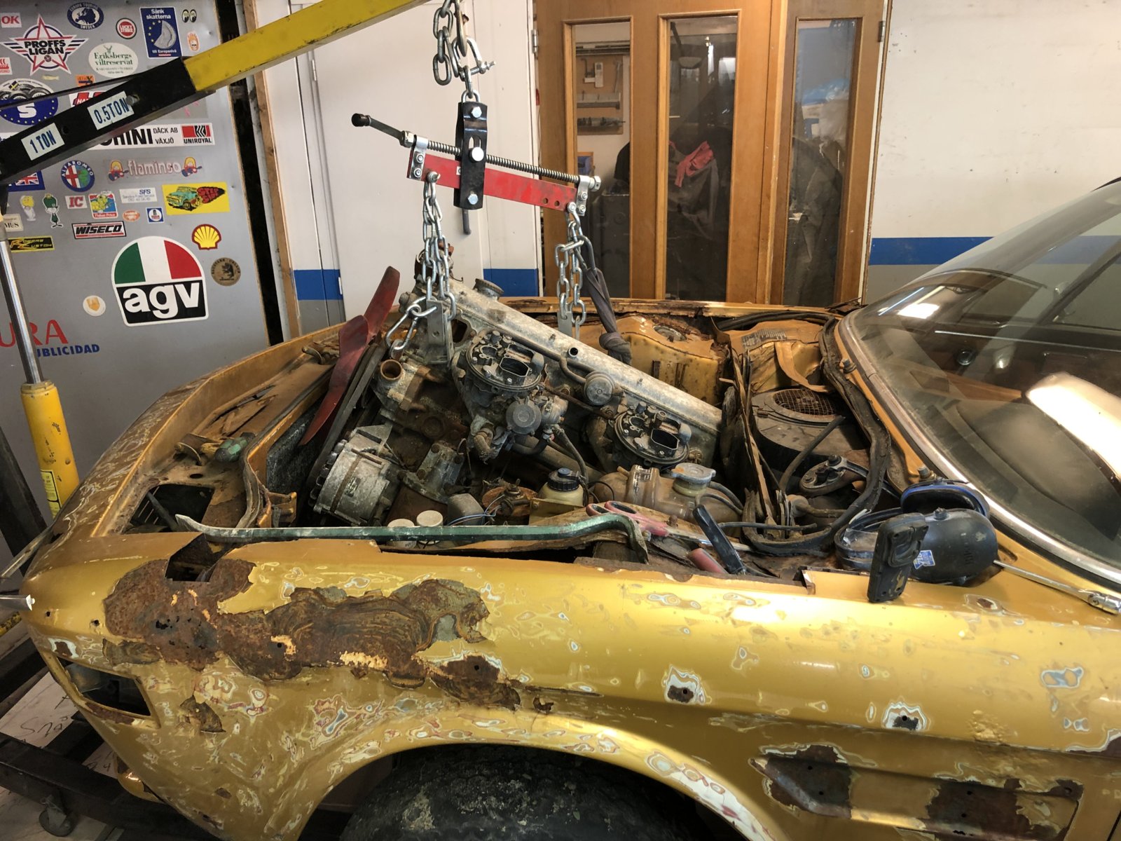

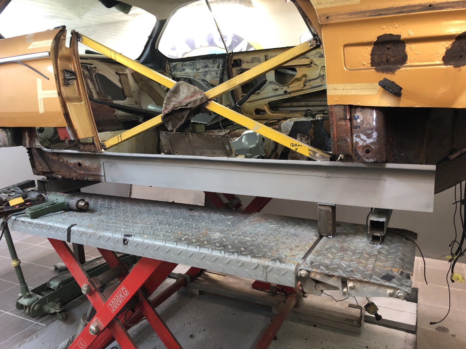

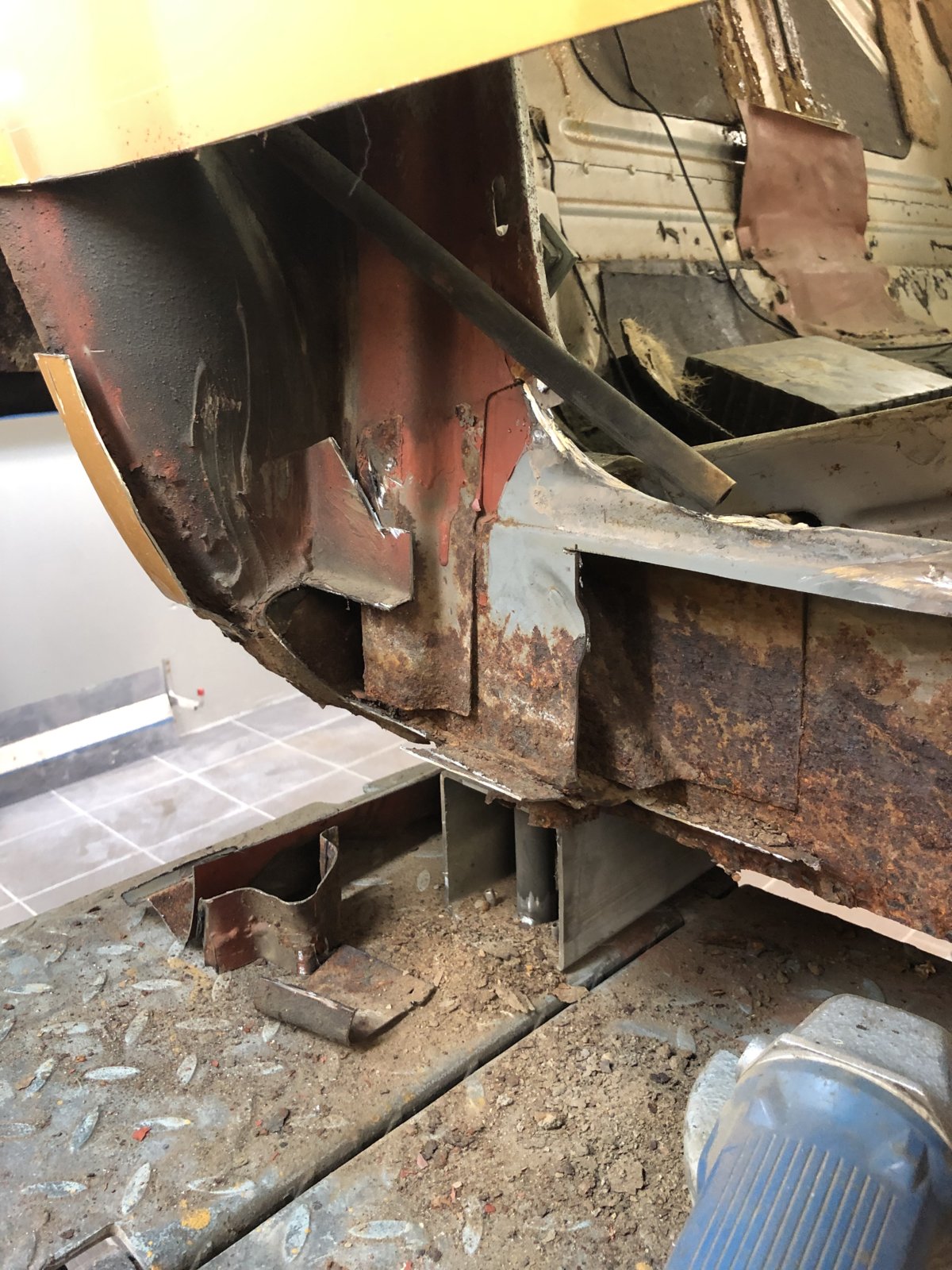

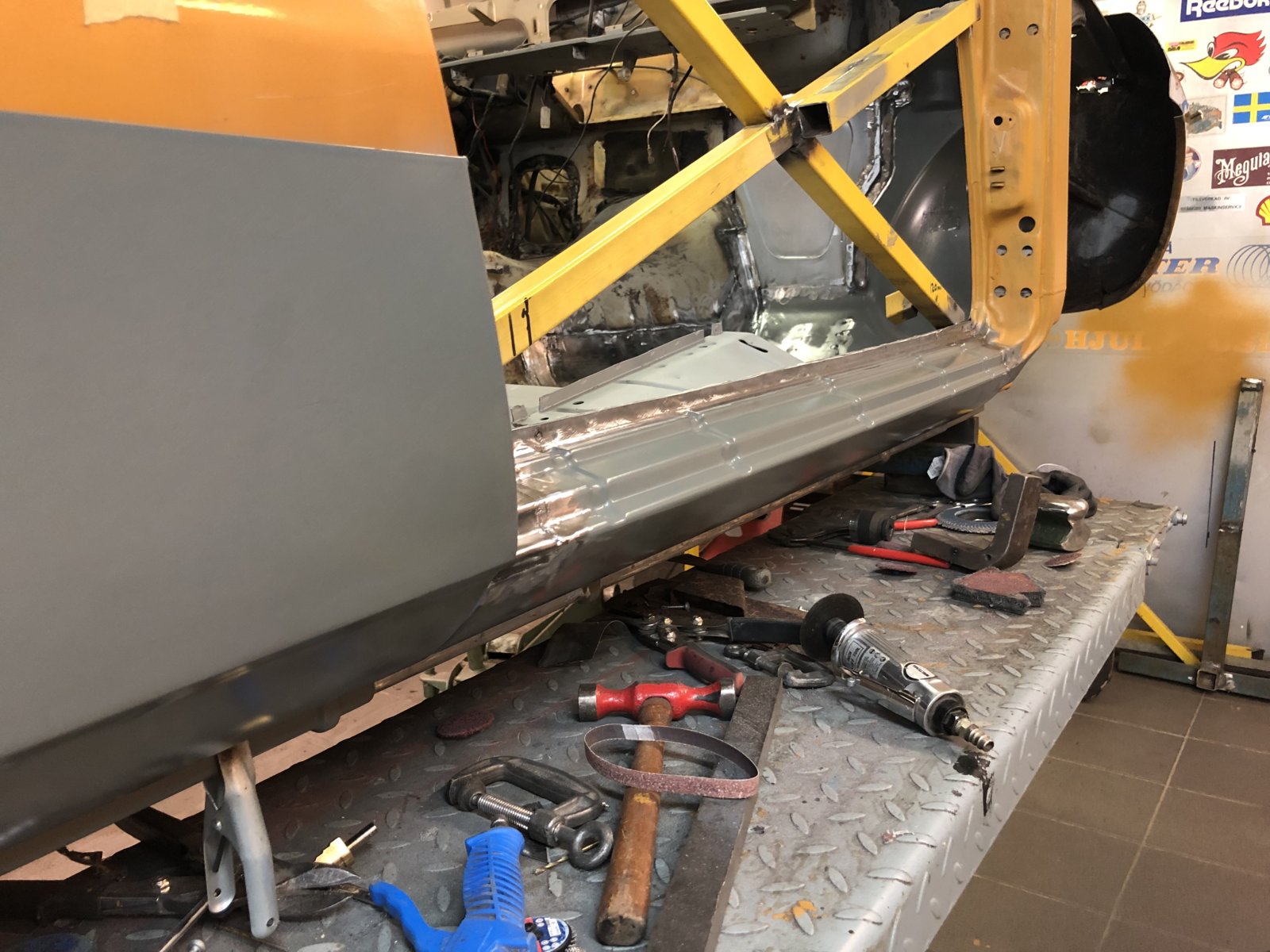

After dismantling of interior , engine , gearbox , front and rear axle etc I locked my lift in top position and leveled with shims to have it perfectly straight . With some heavy steeltubing I thereafter welded a simple jig to the car to prevent it from moving / flexing.

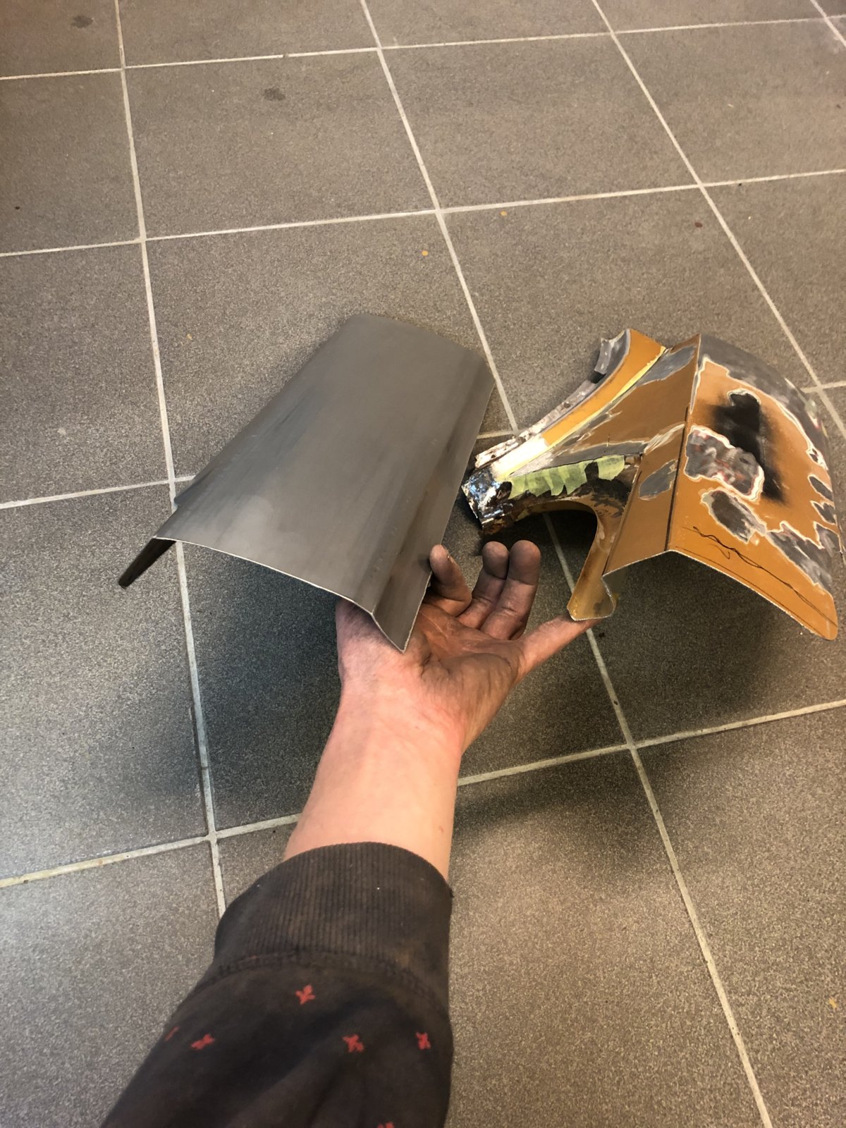

I made inner and middle sills from 2 mm steel and pressed some flared holes .

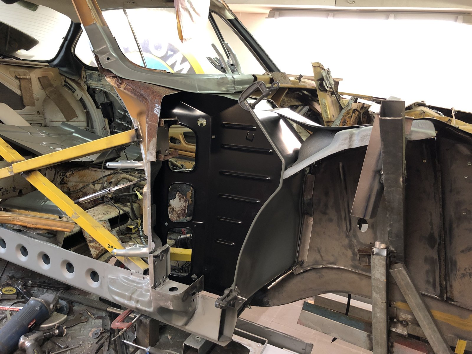

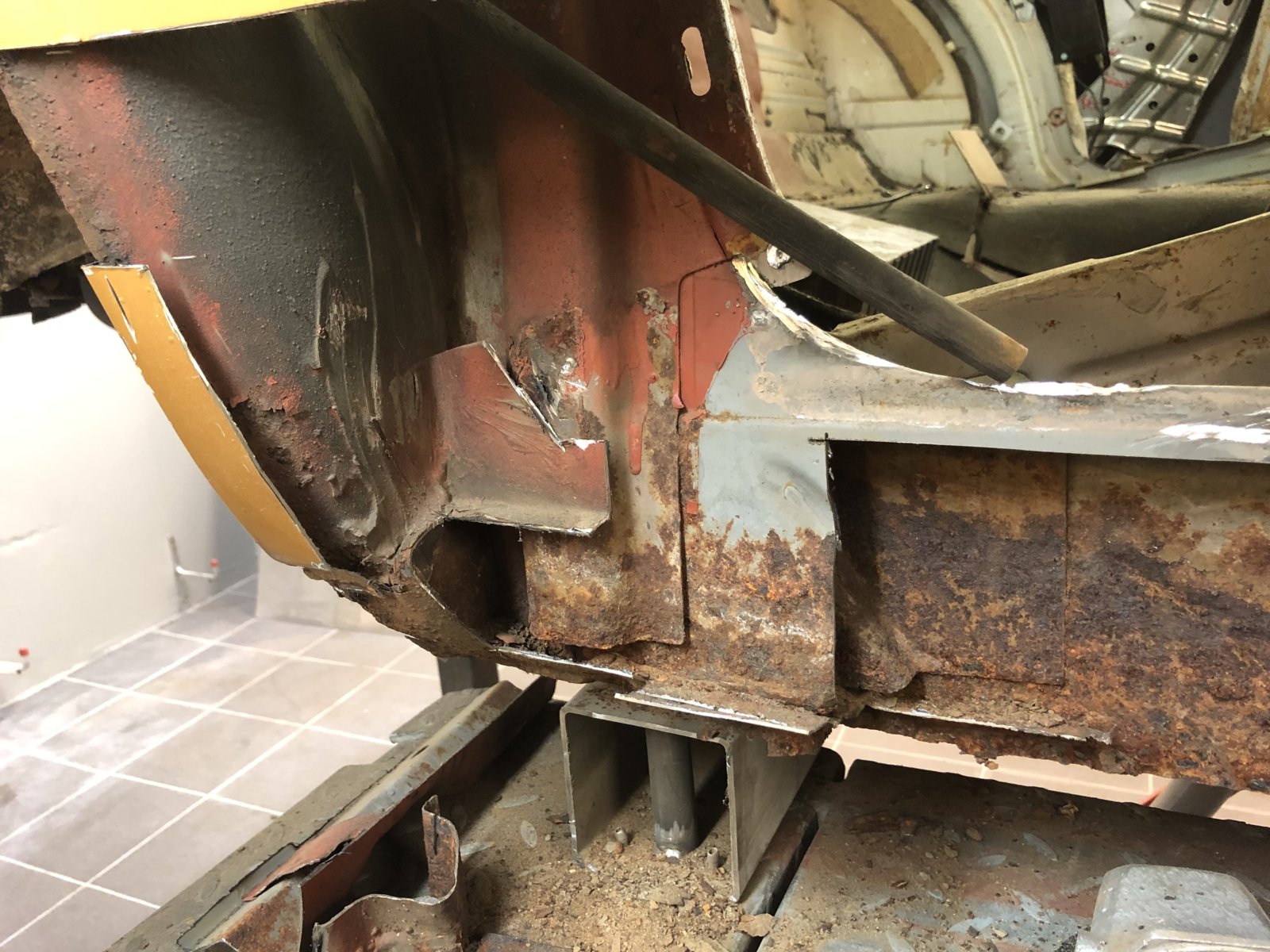

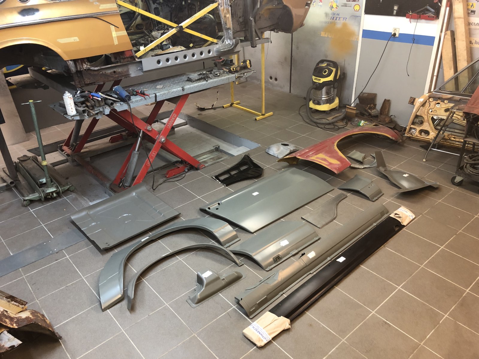

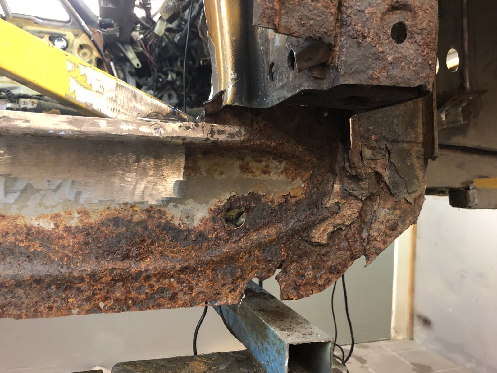

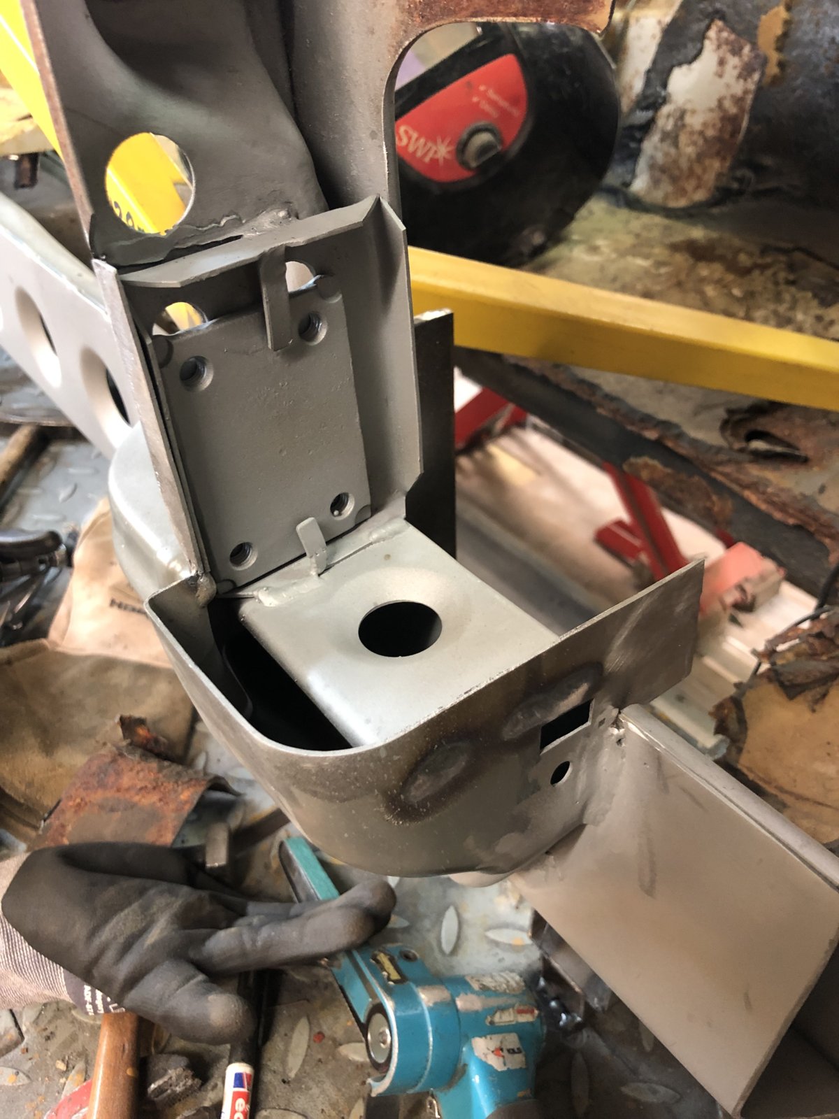

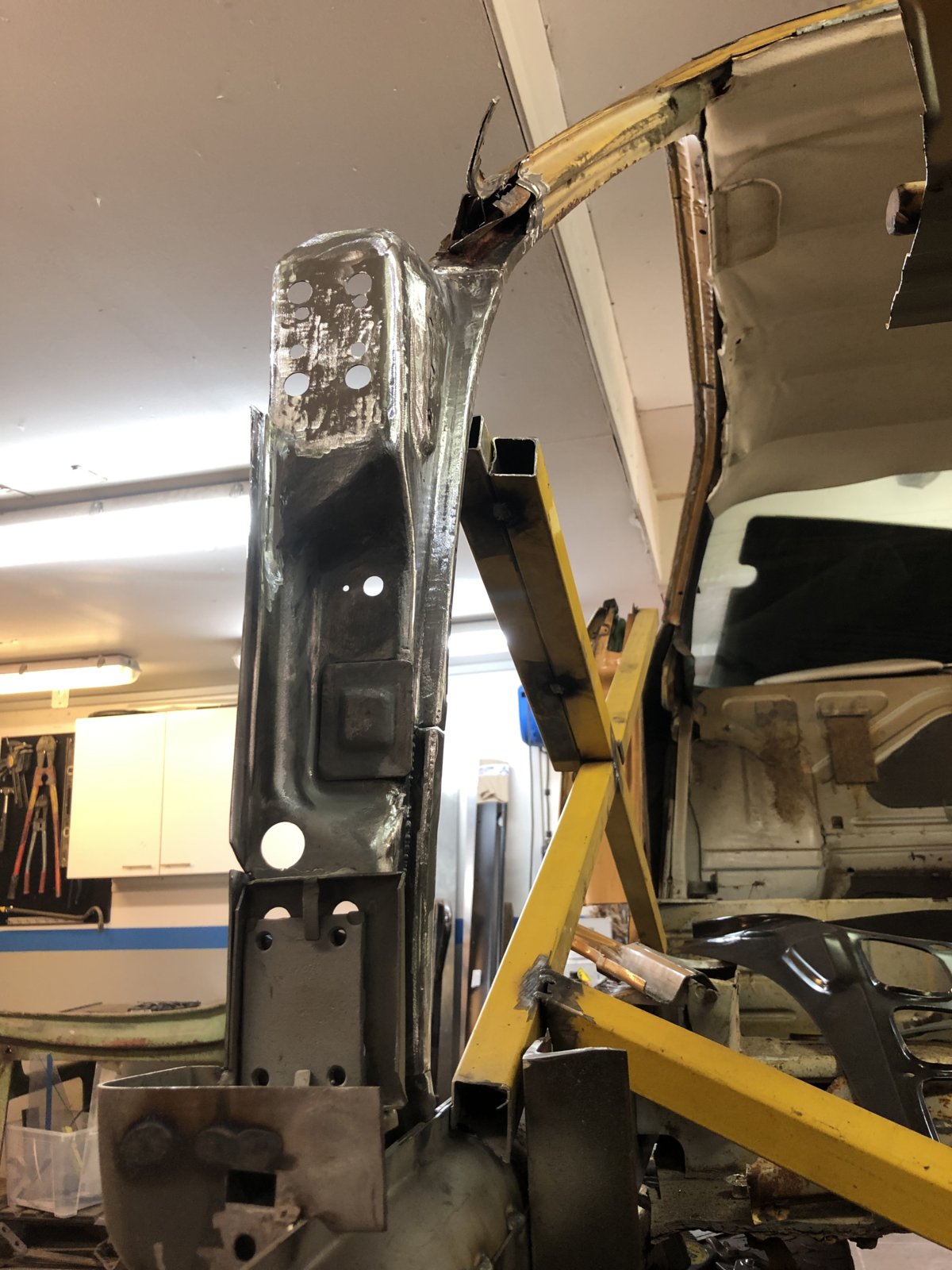

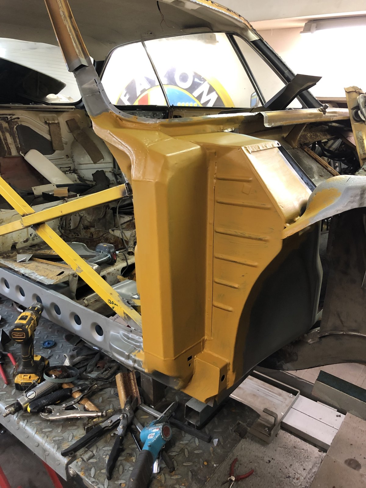

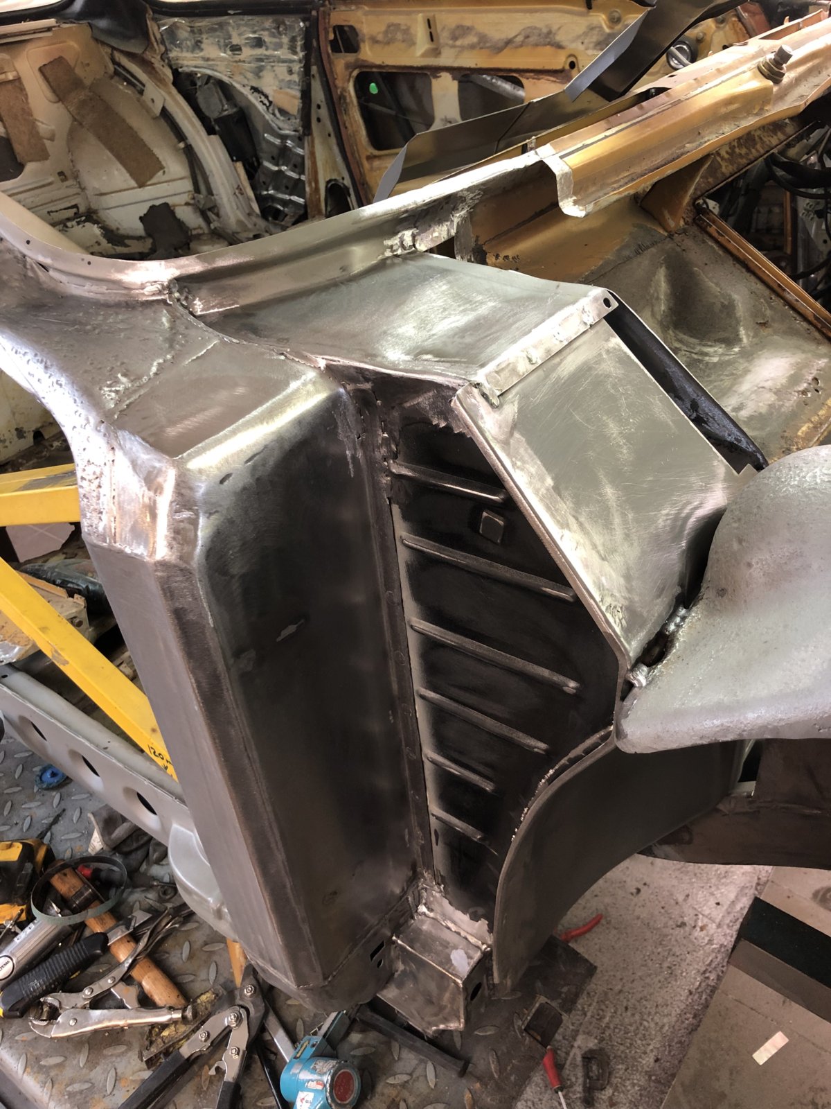

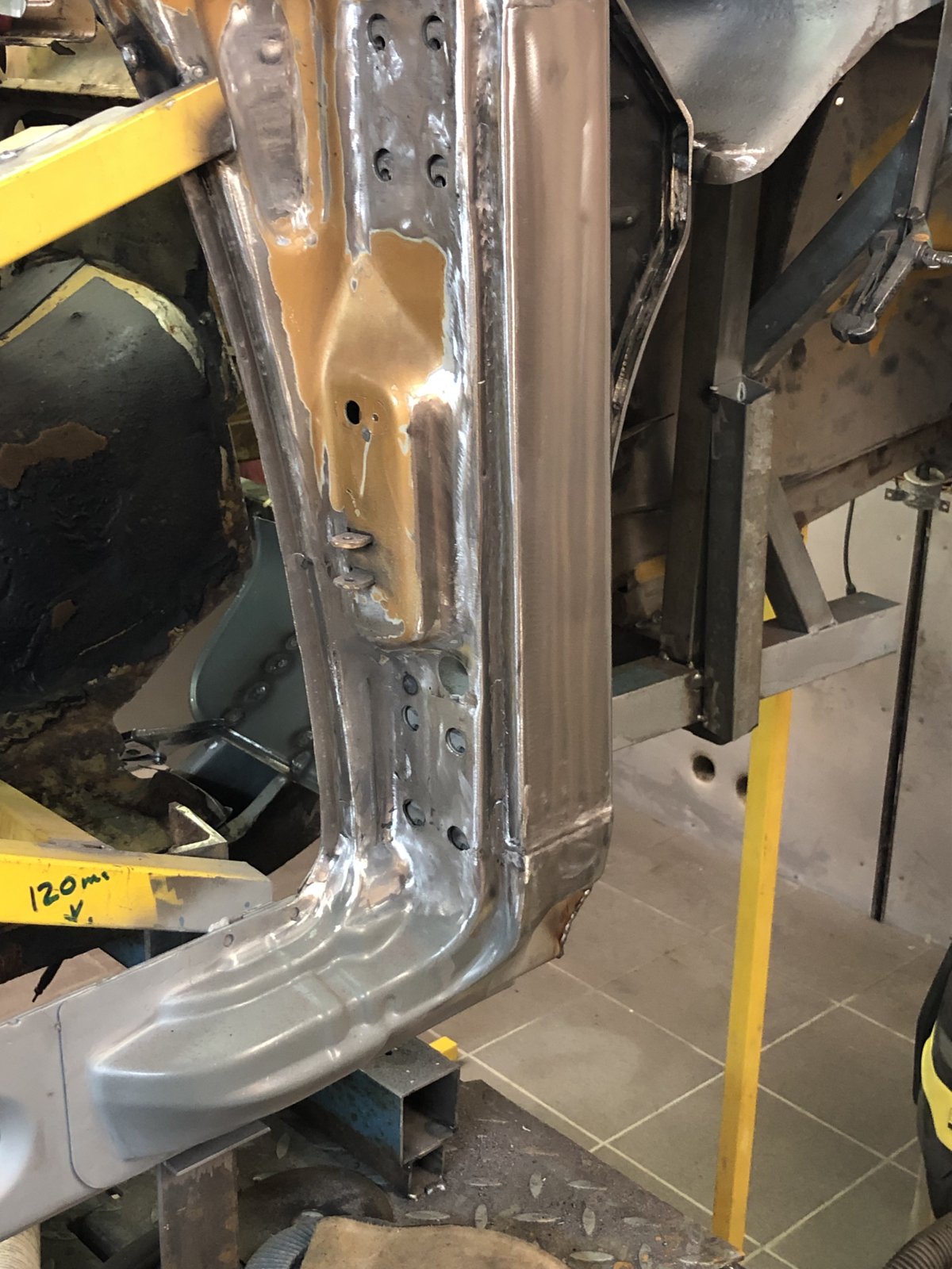

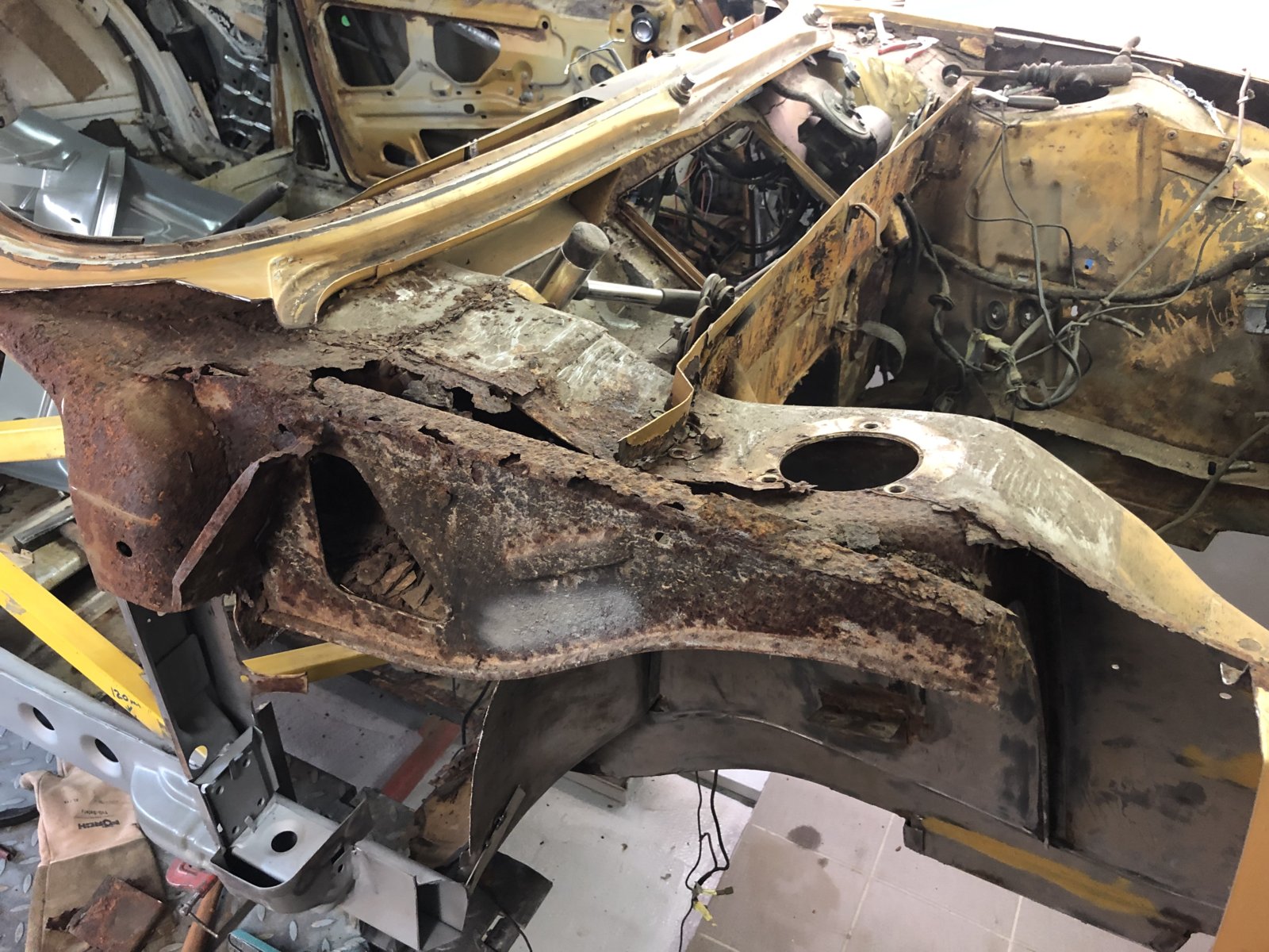

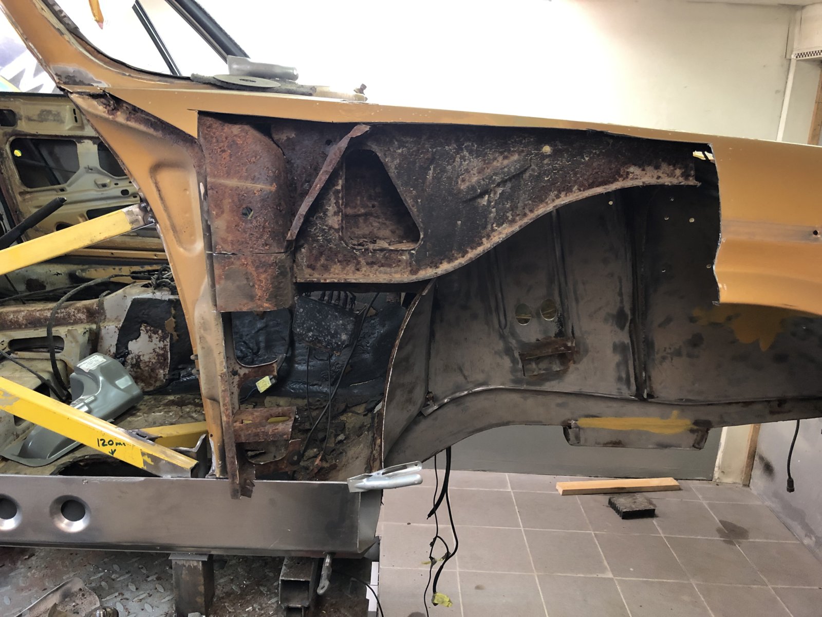

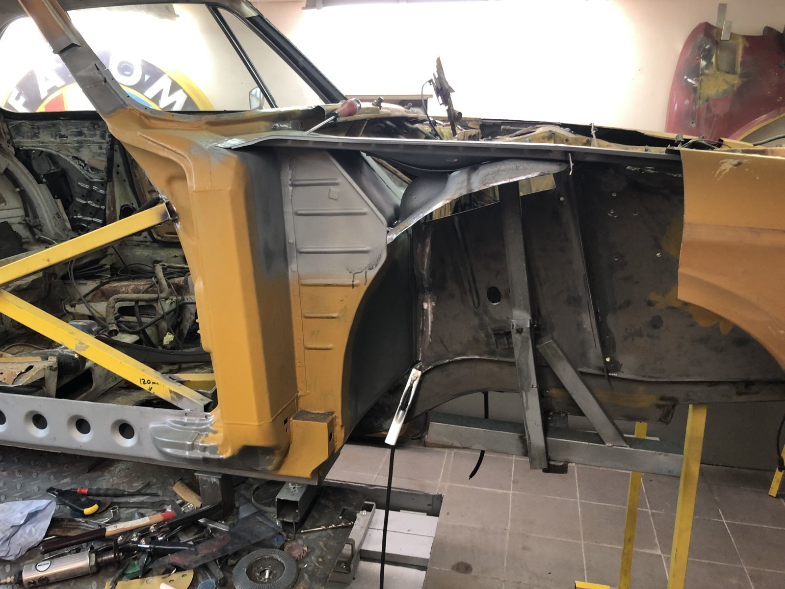

The "A"-post and struttower was not very nice.. I made a simple jig to make sure the struttower went back in the same place as intened.
Since my budget is quite moderate I try to make as many panels that I can by myself but I chucky order from wallot was requiered anyway.

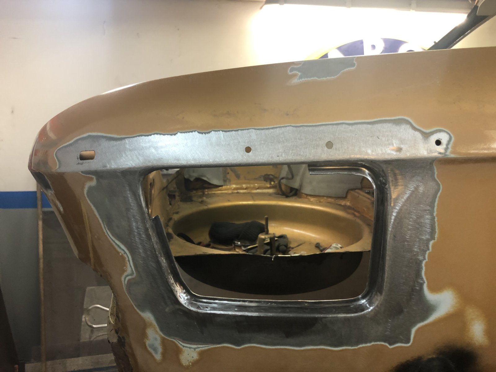

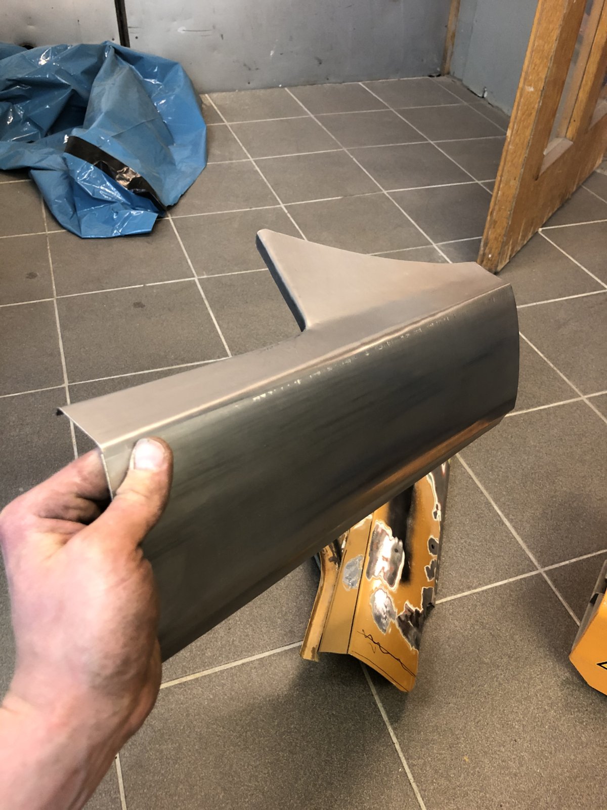

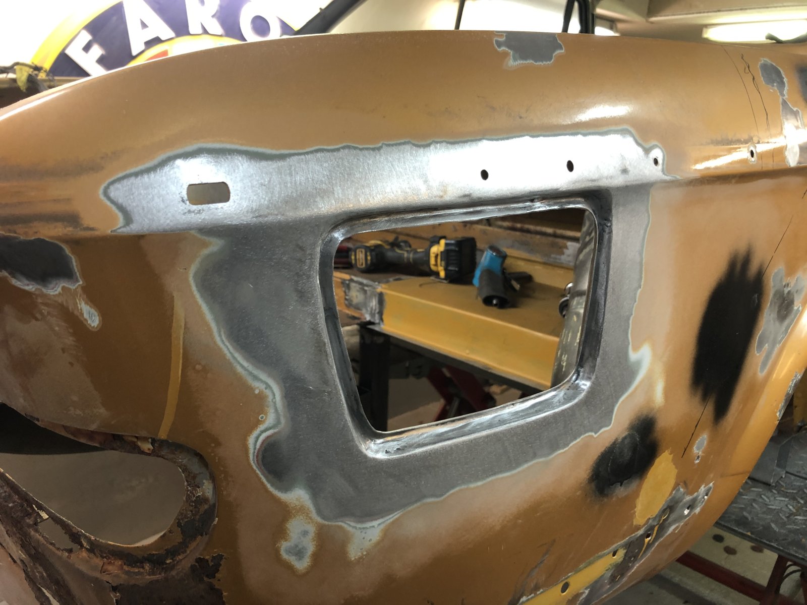

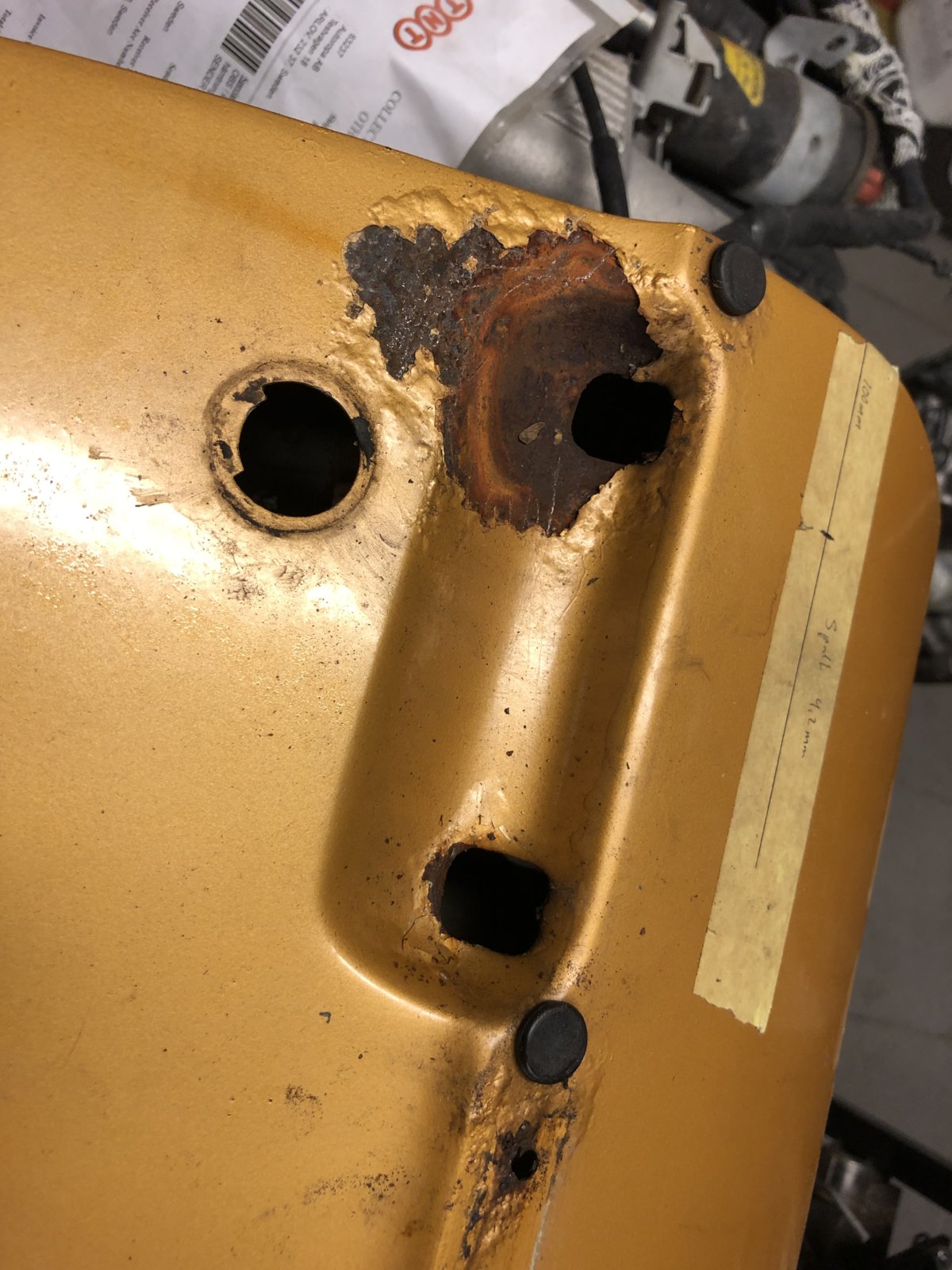

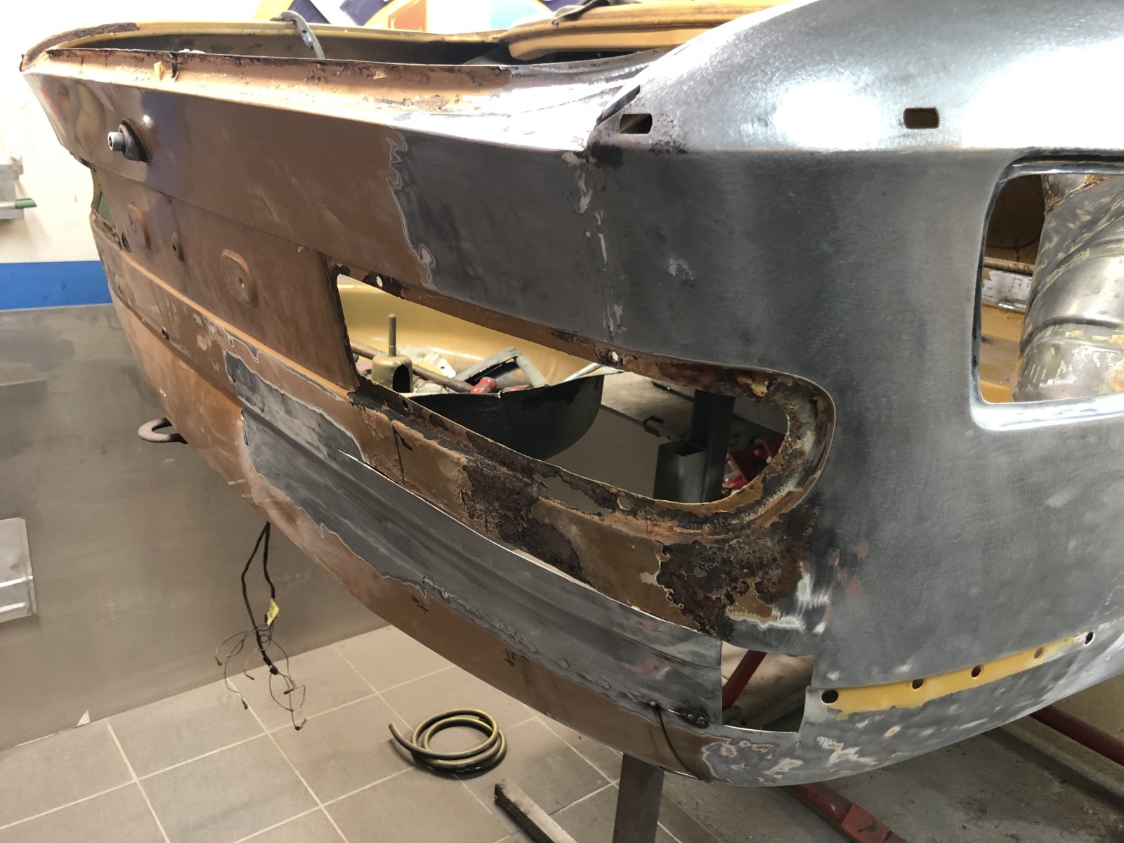

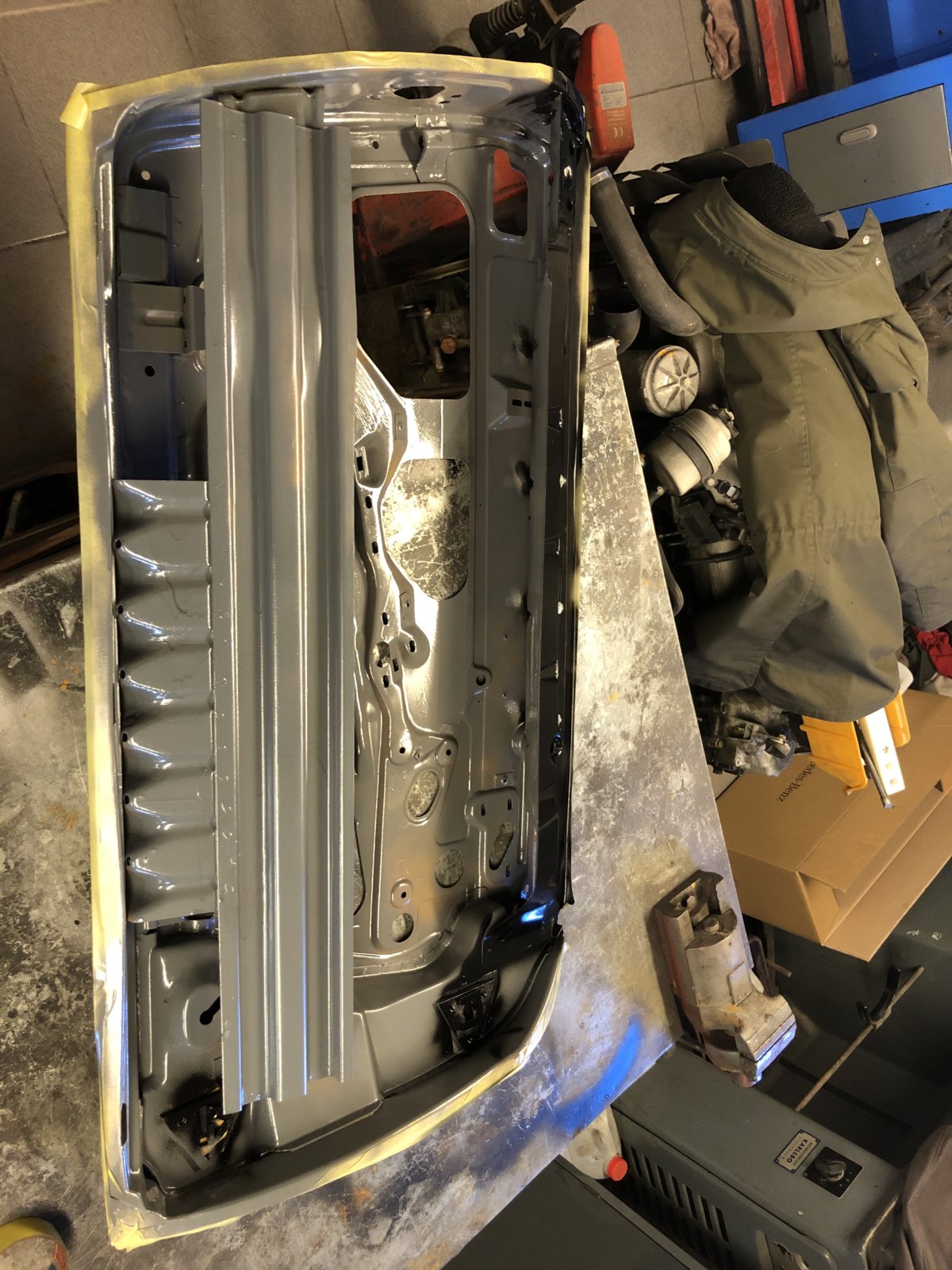

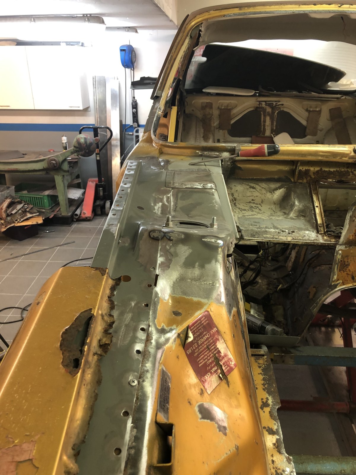

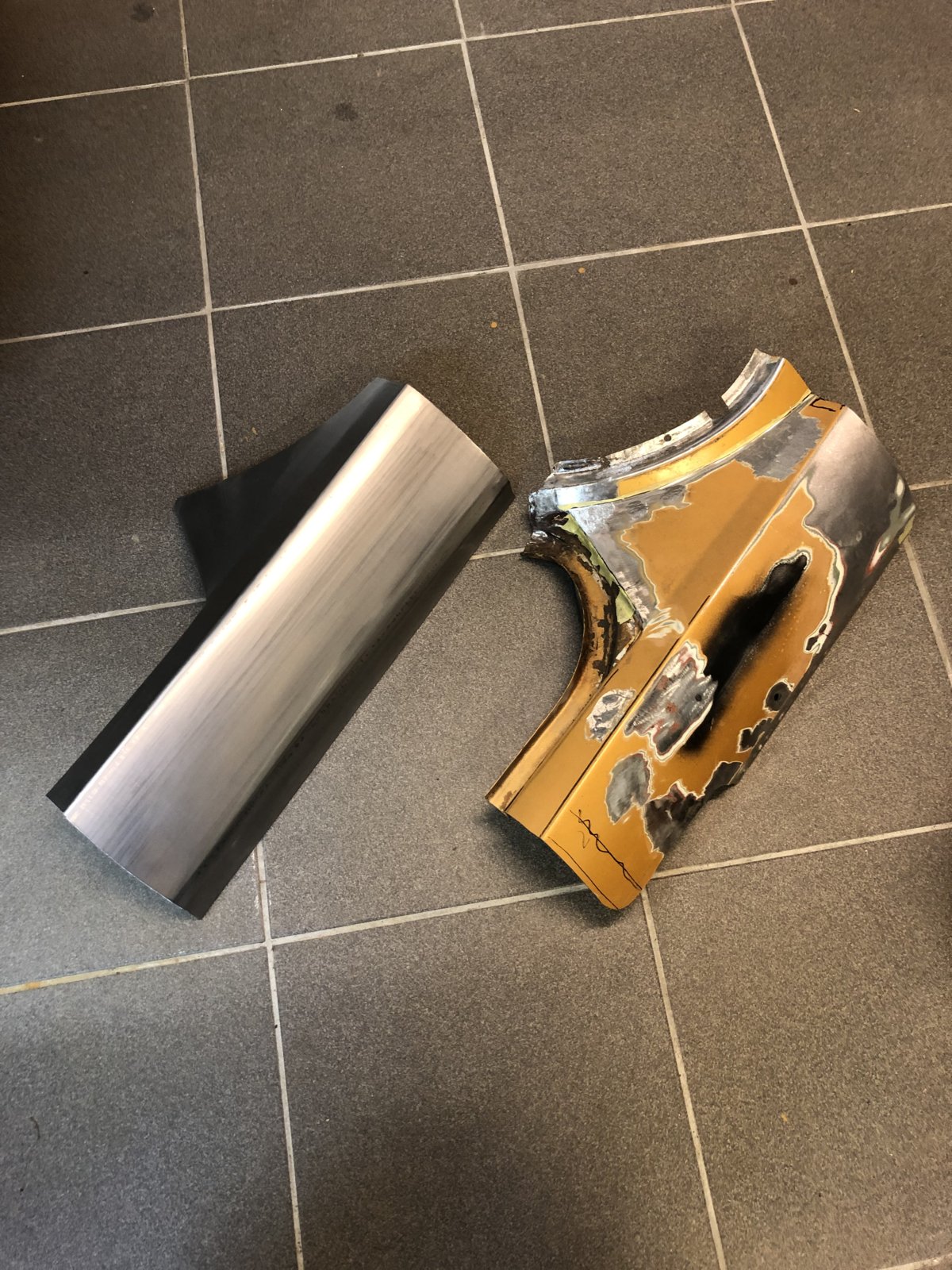

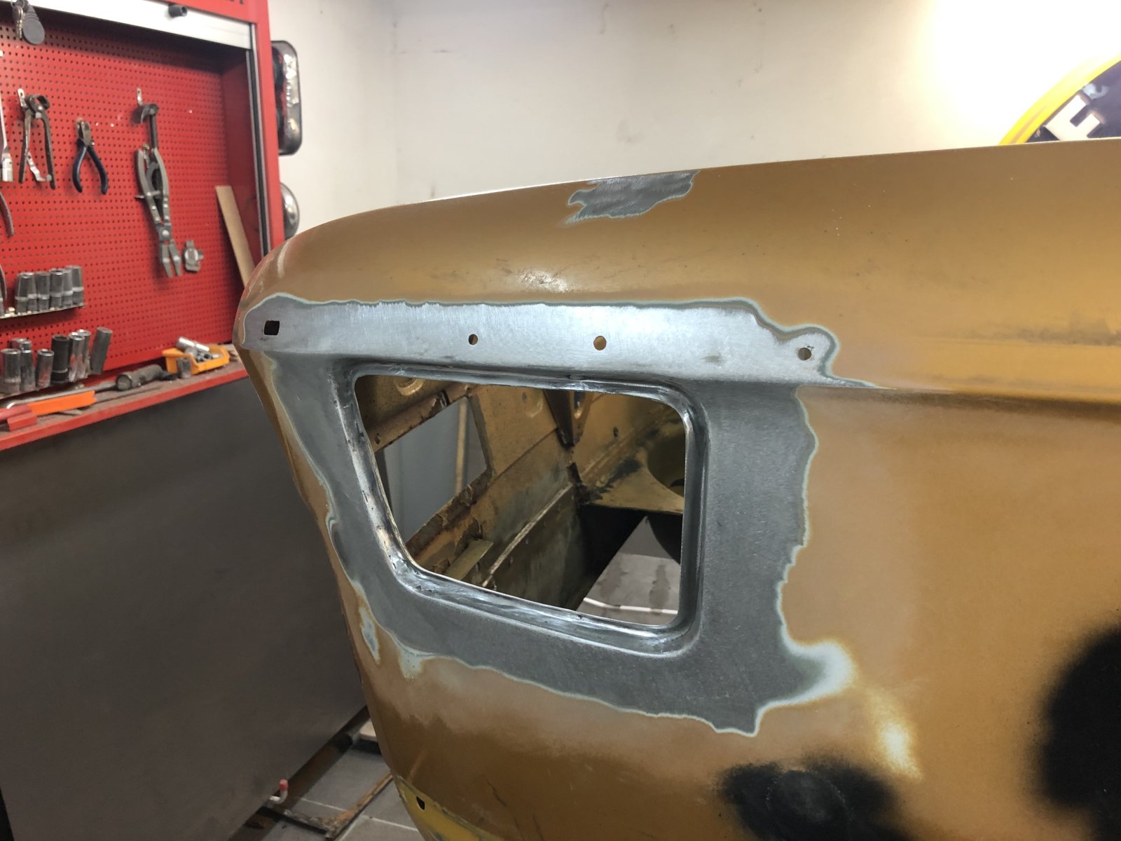

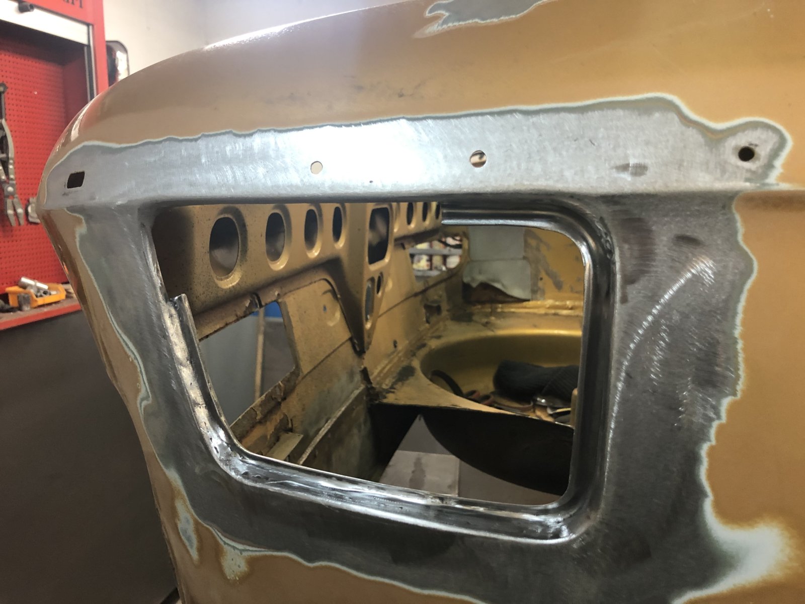

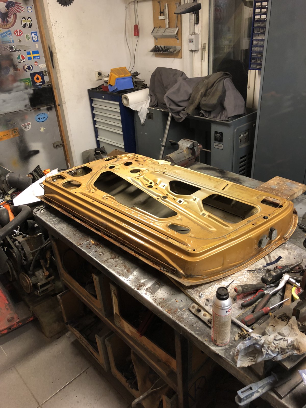

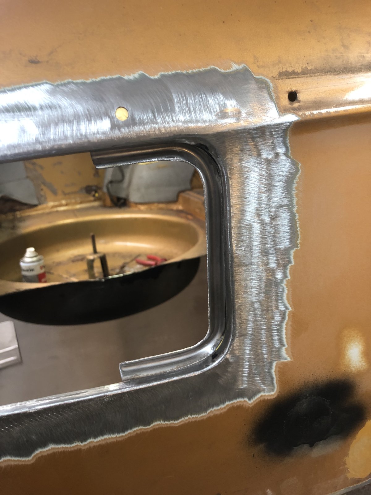

Rustrepairs continue , doing some repairs on the door , changing the bottom and a new skin. The fuel lid surrunding was rust damaged so I had to fabricate a new lip / edge around the hole.

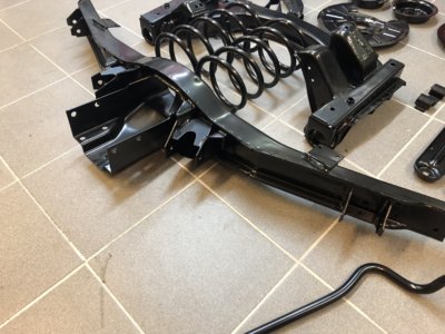

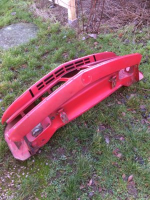

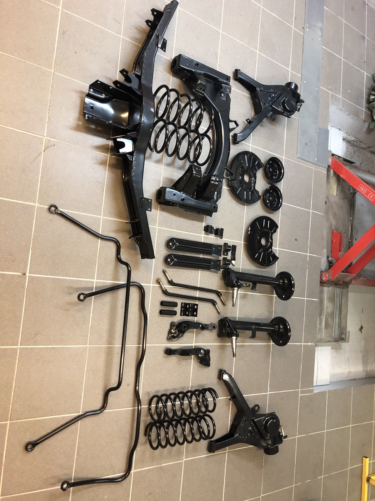

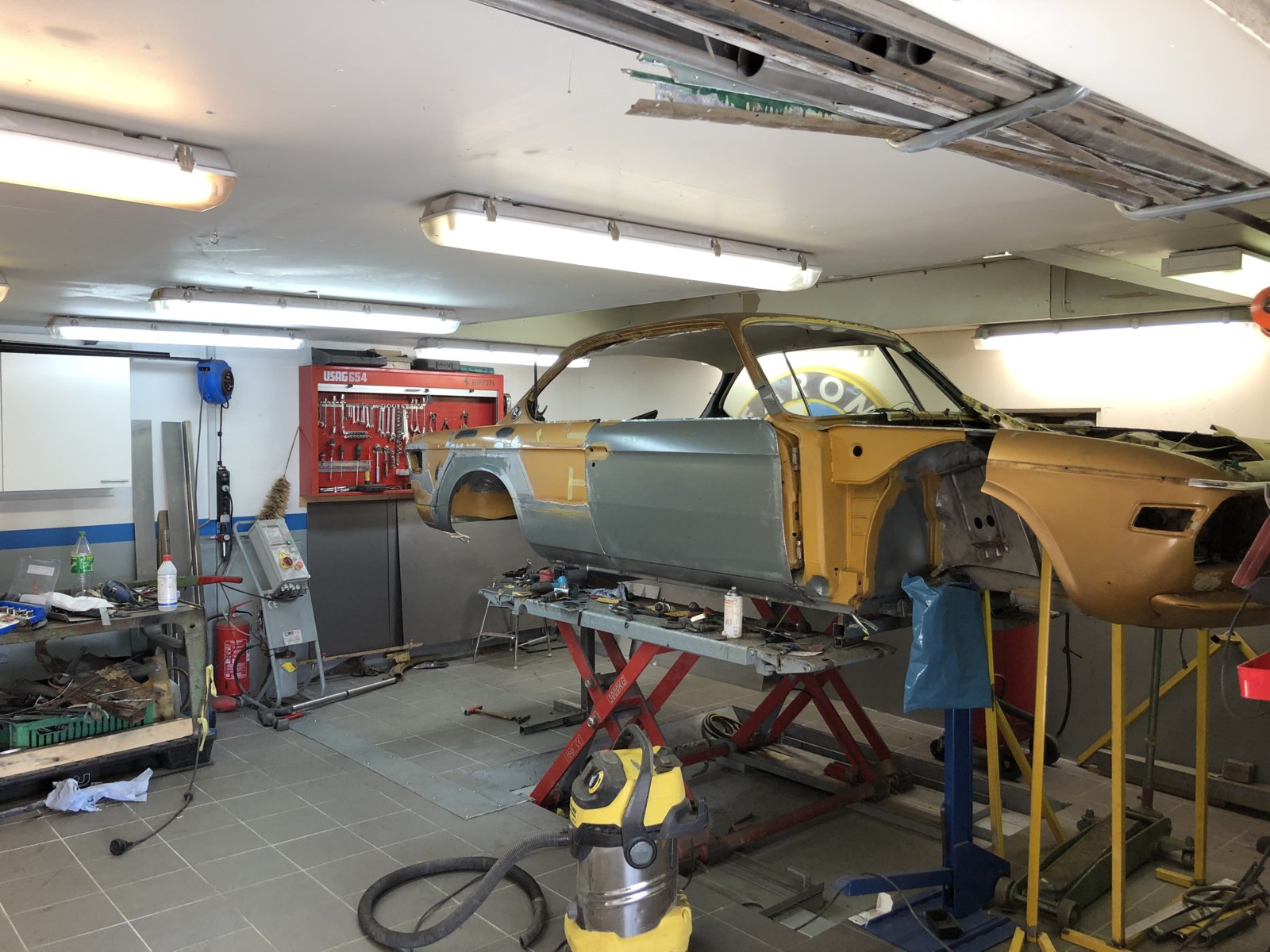

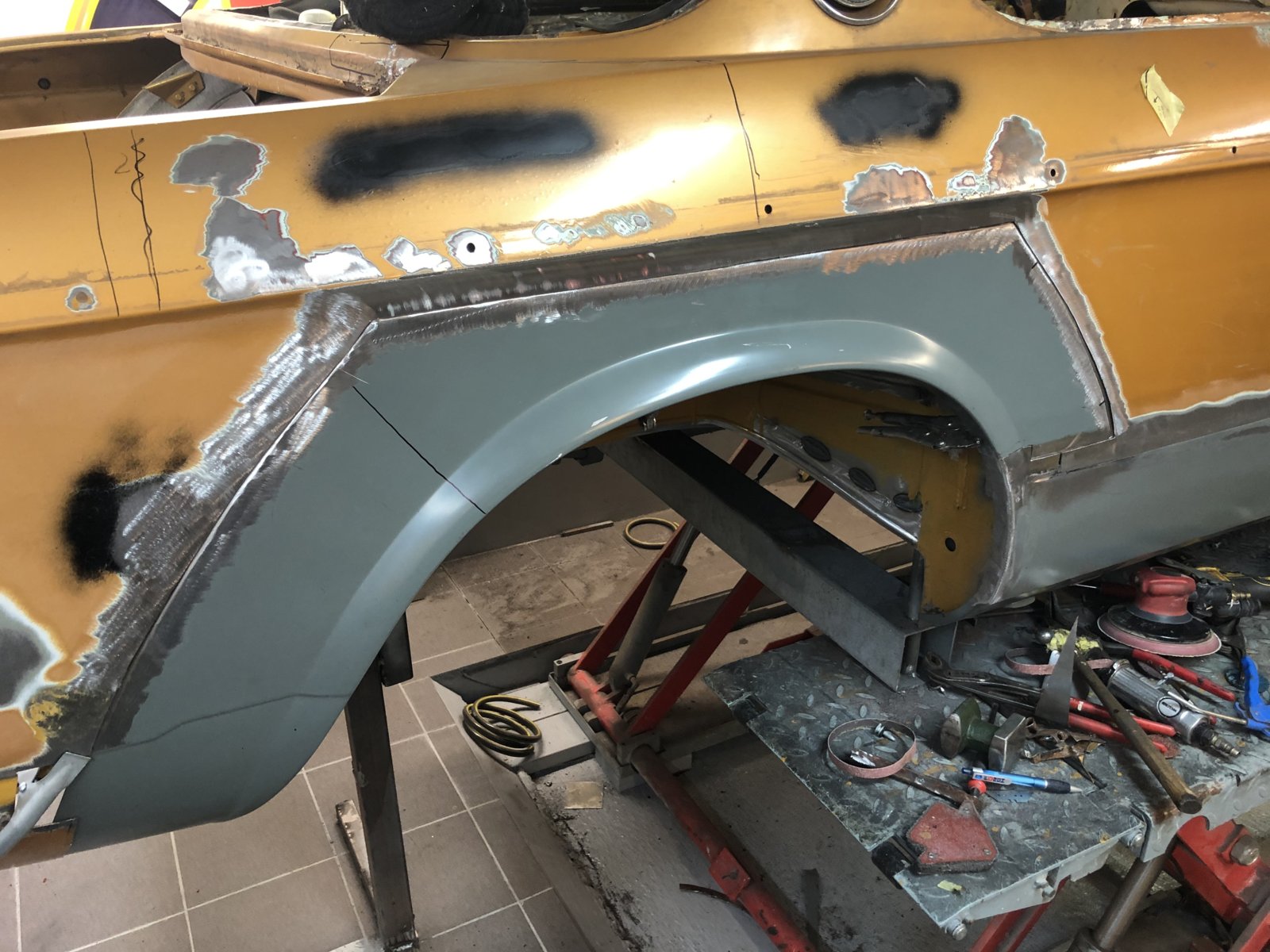

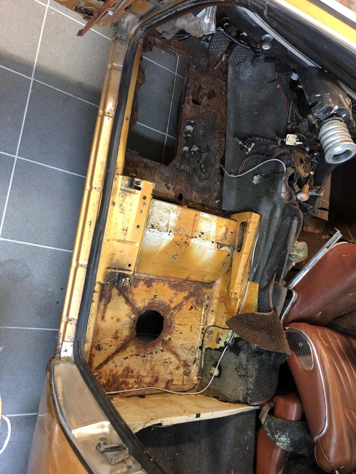

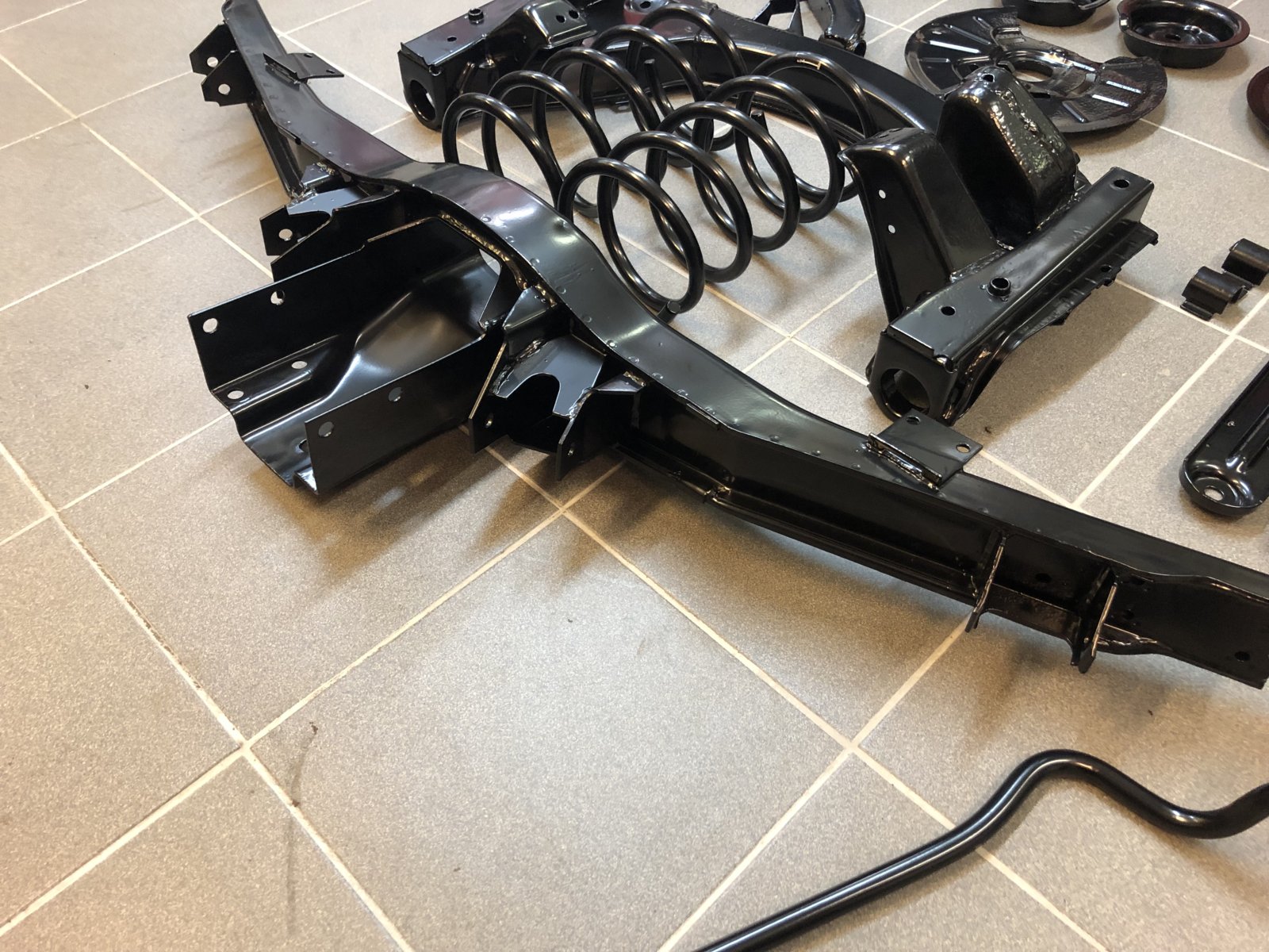

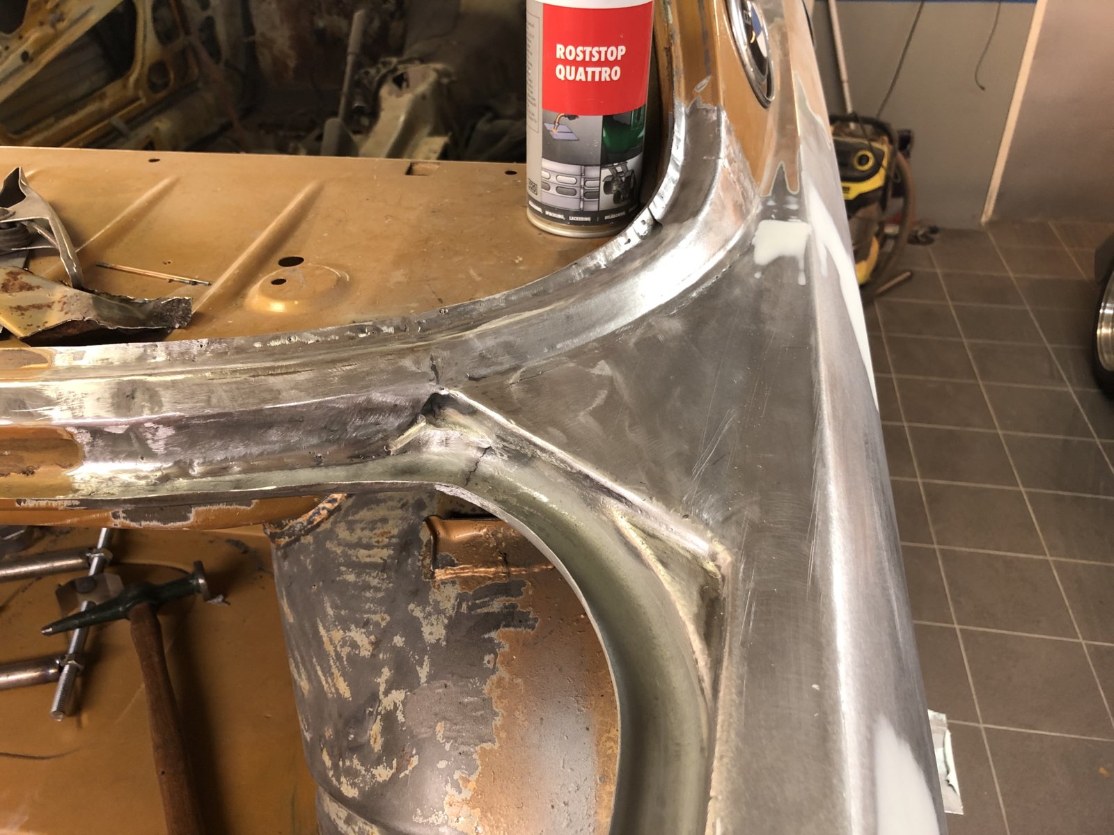

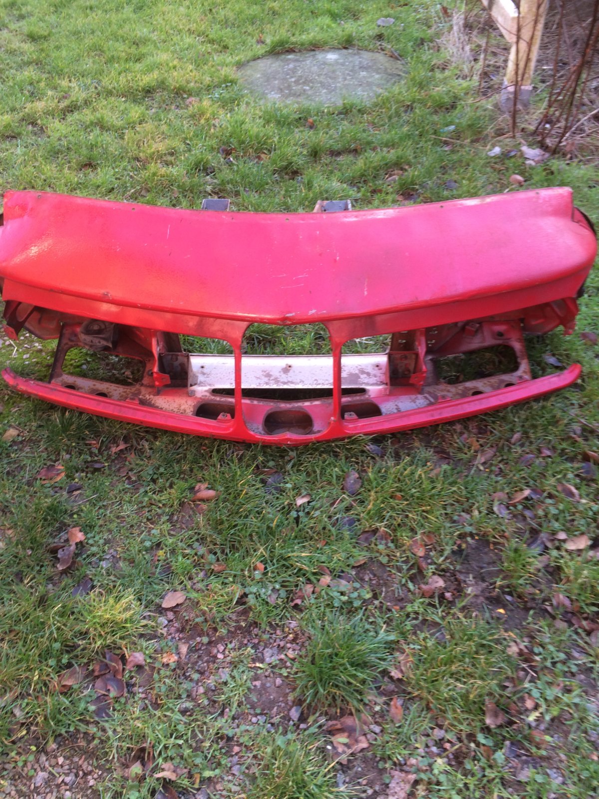

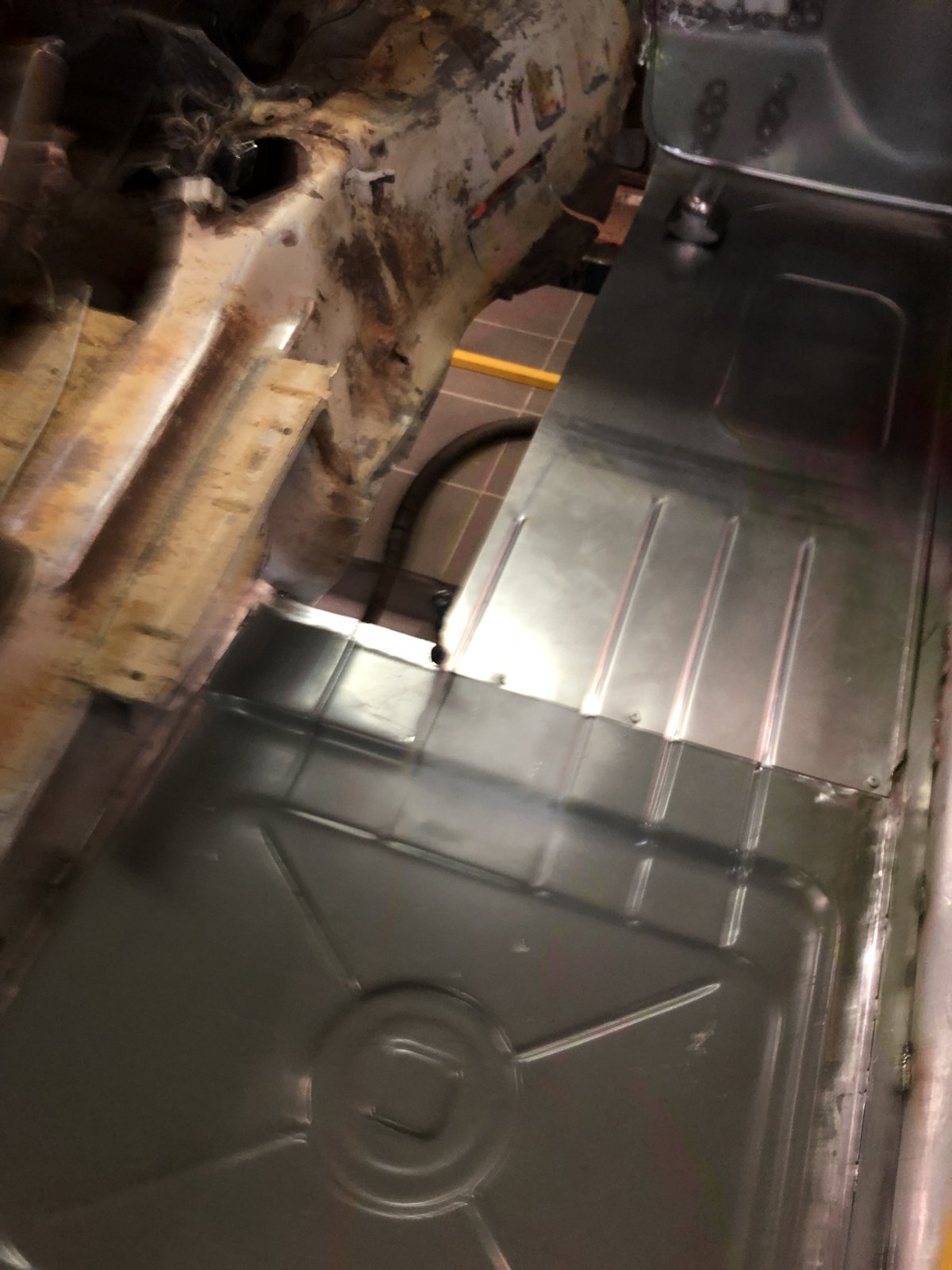

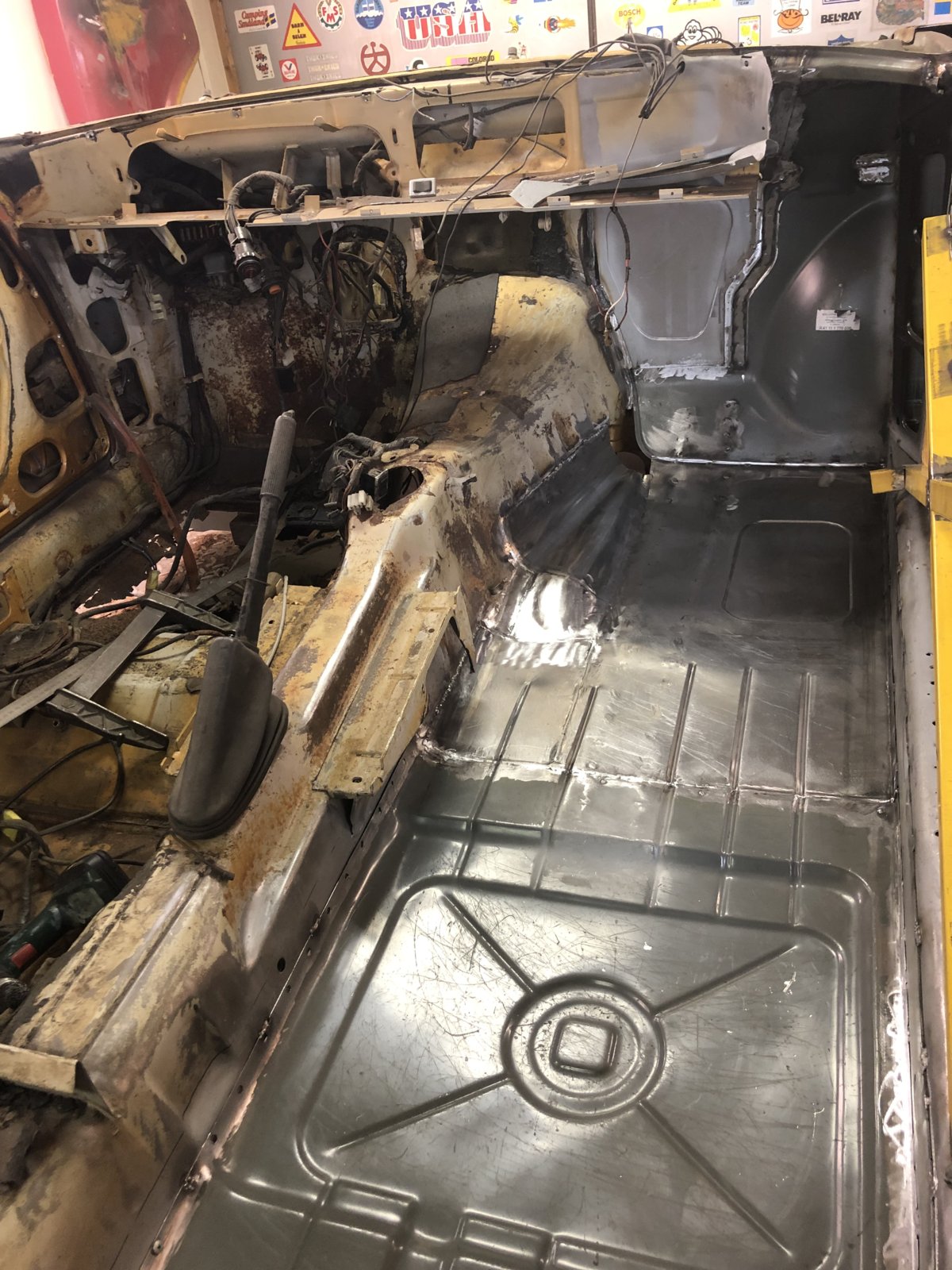

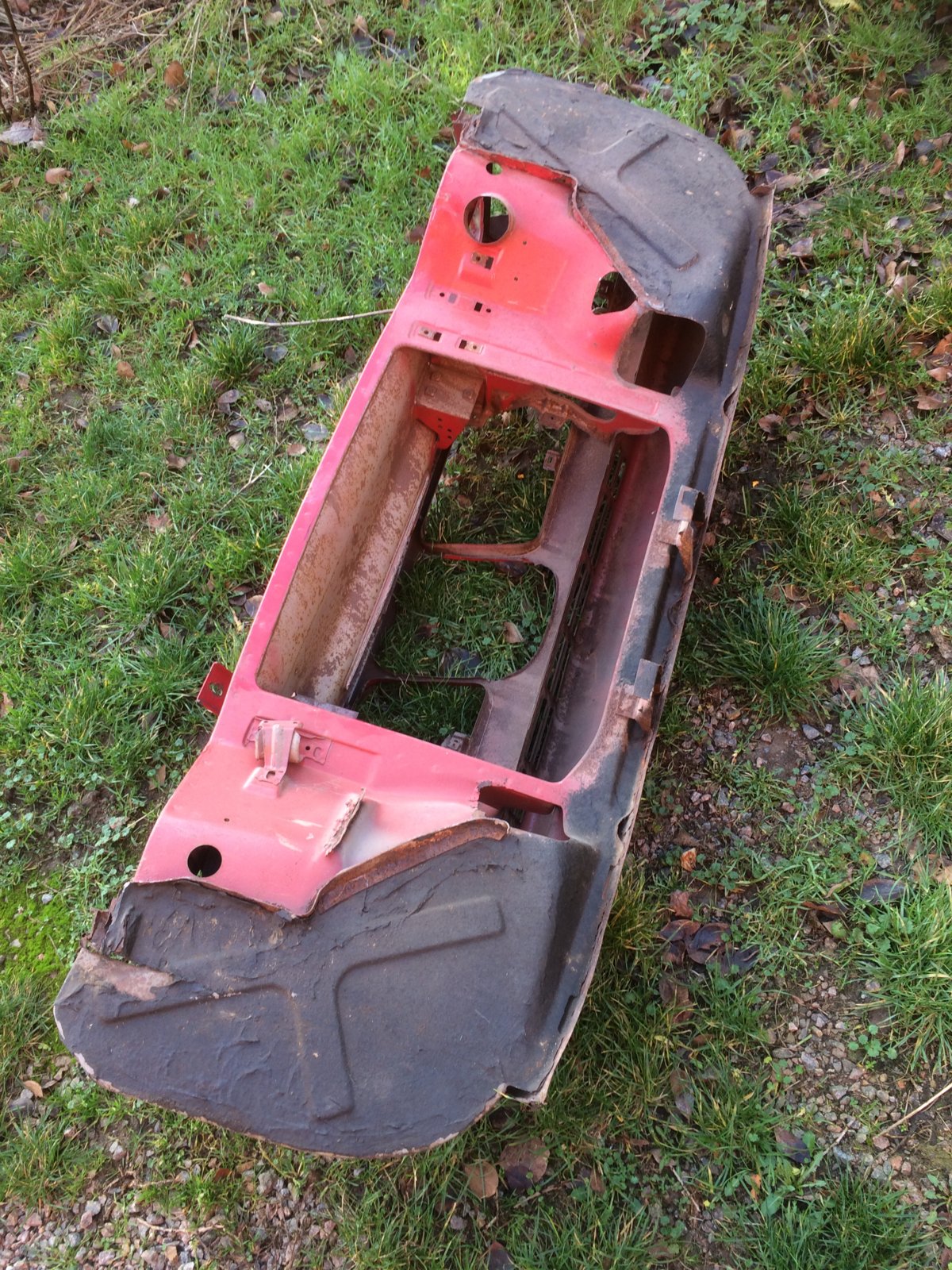

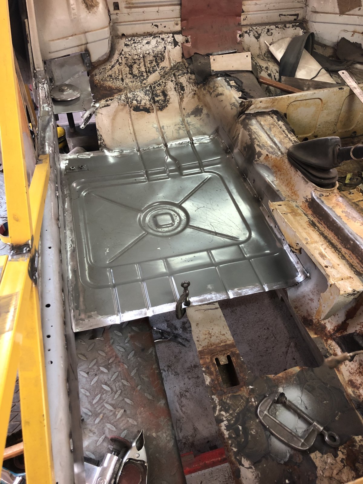

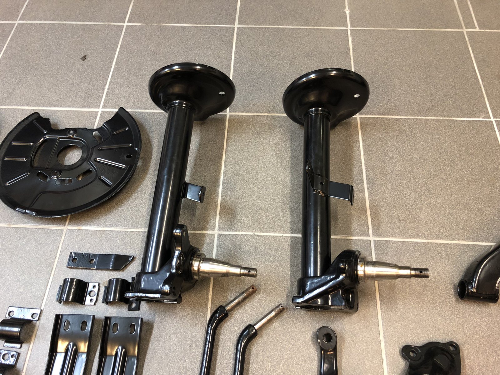

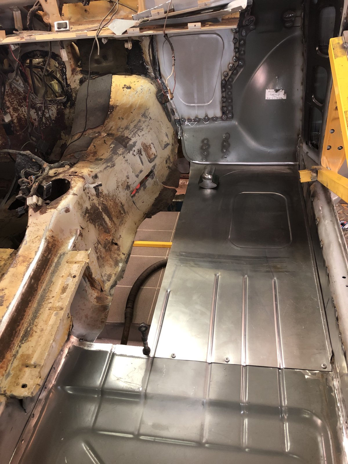

Had the suspension components blasted and powdercoated. Was lucky and finding a used frontend in good condition. Started welding and fabricating new floors . Made a new frame-railsextension and started testfitting some panels.

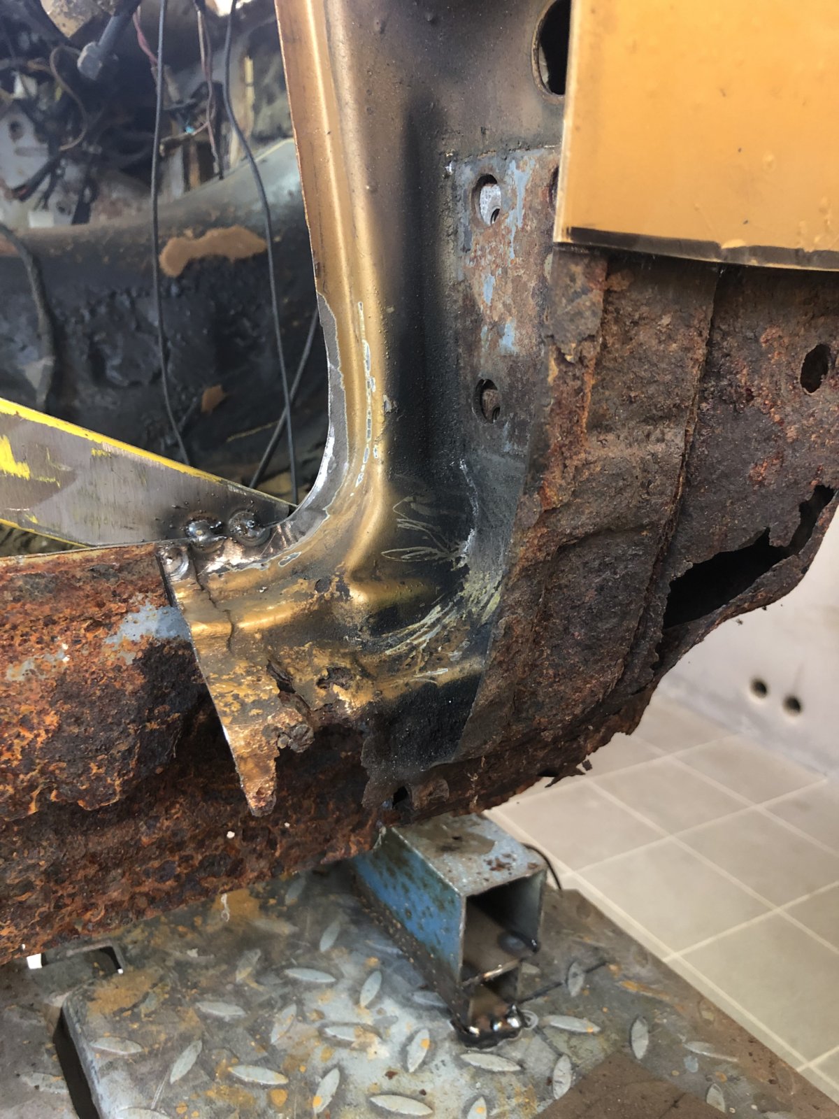

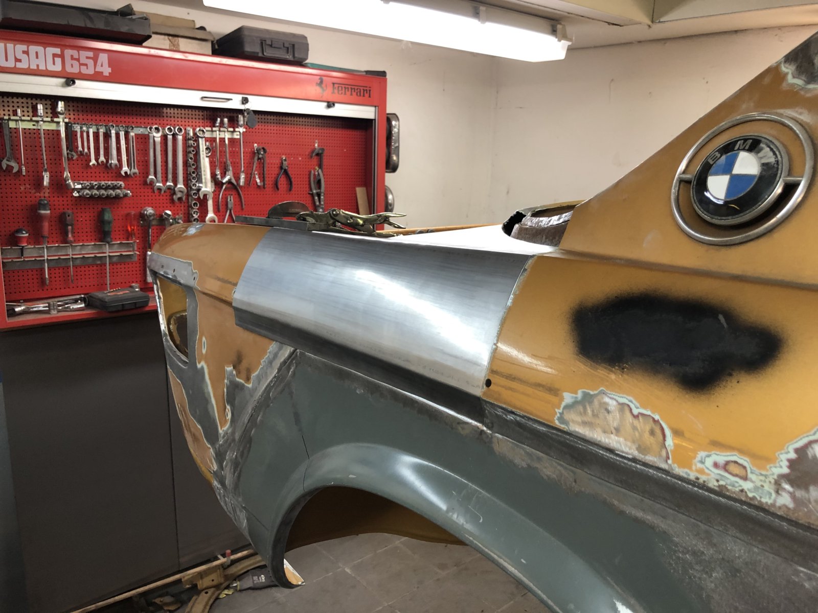

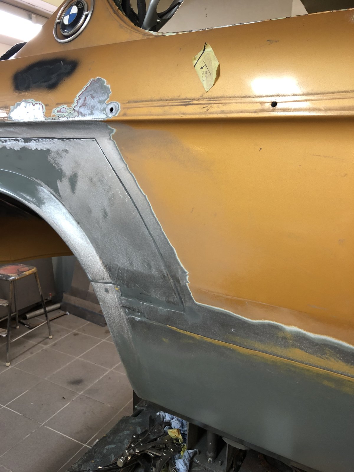

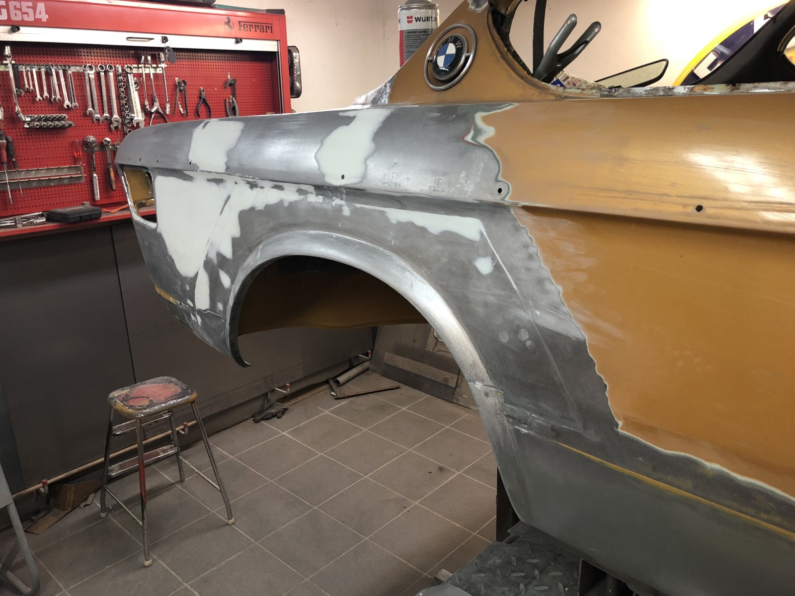

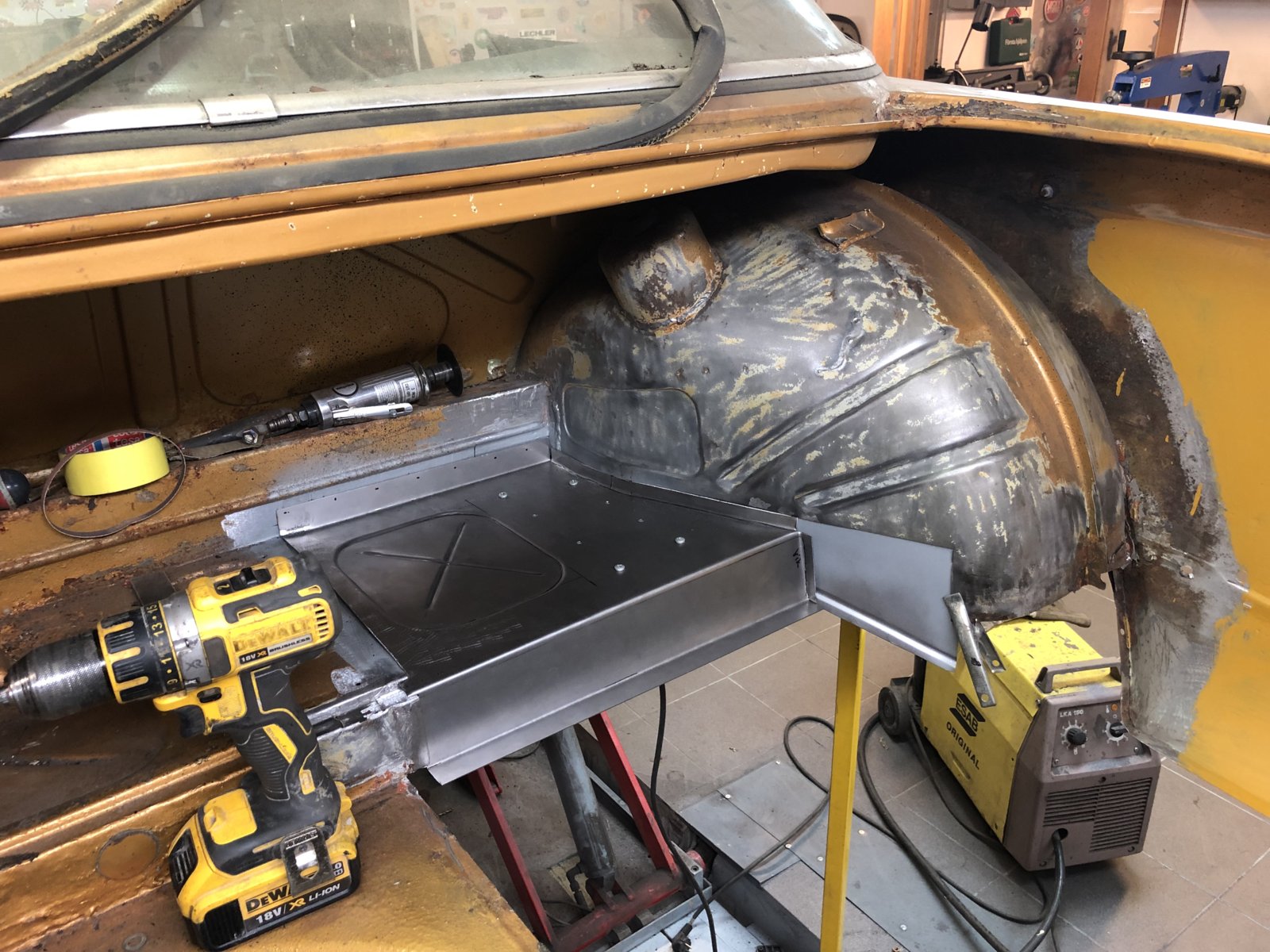

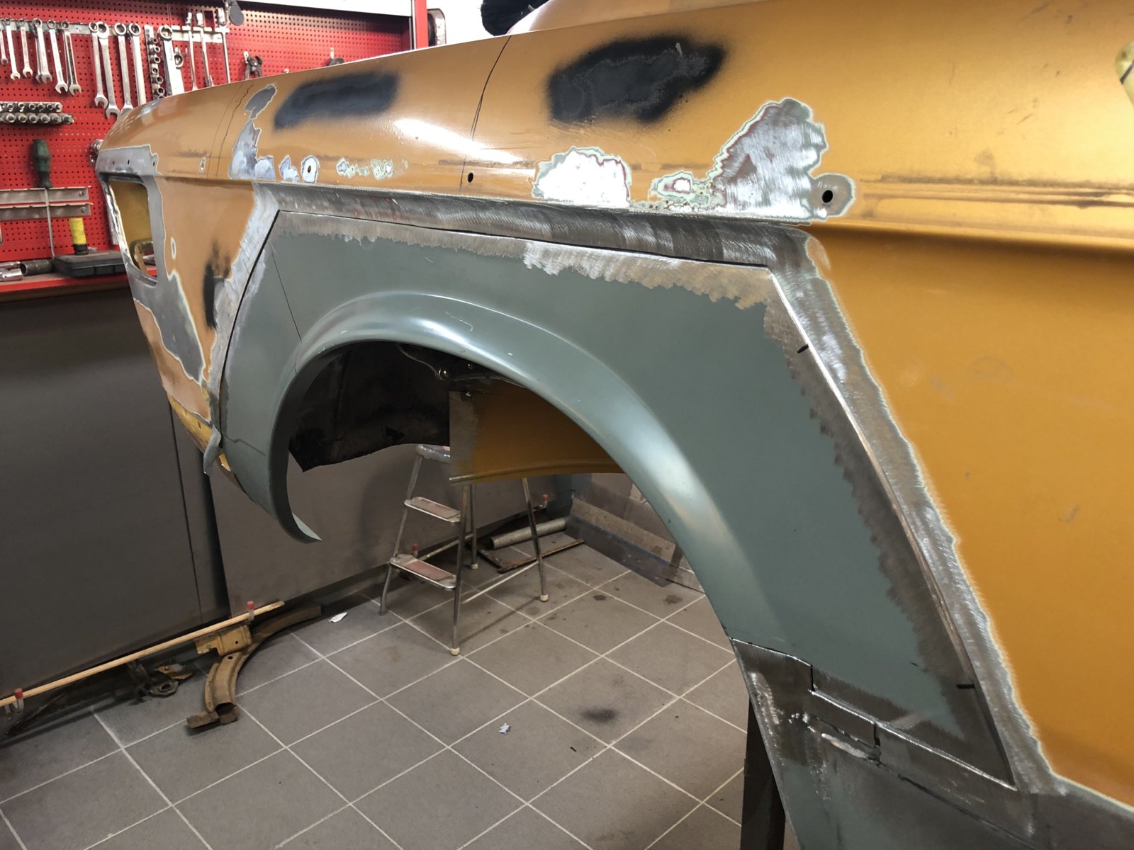

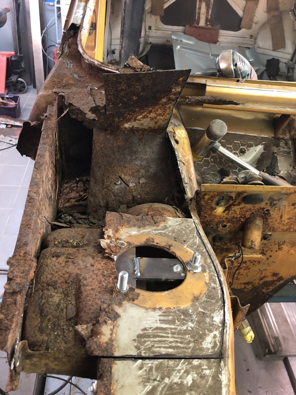

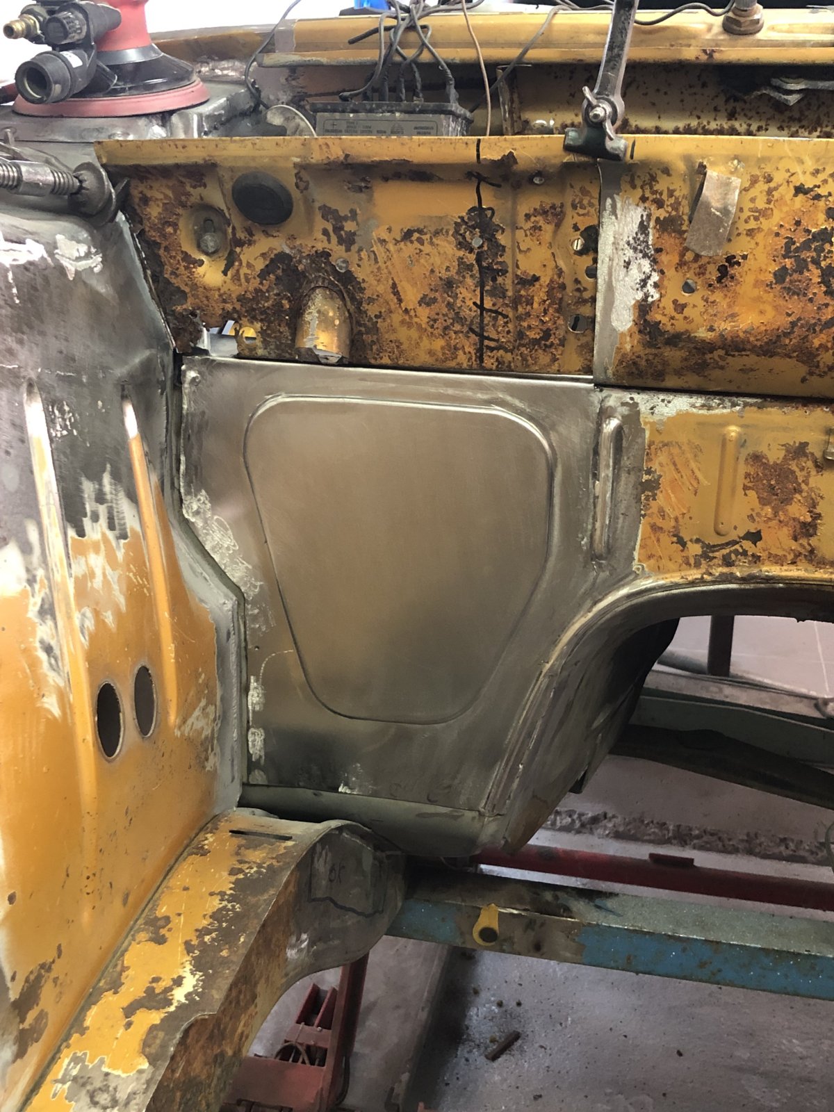

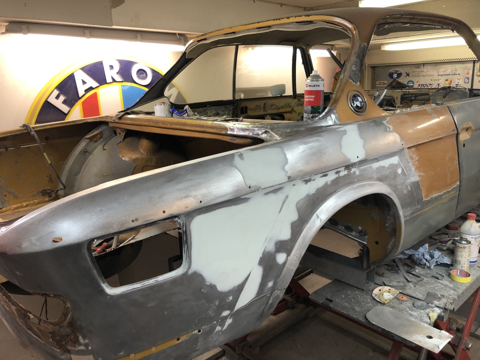

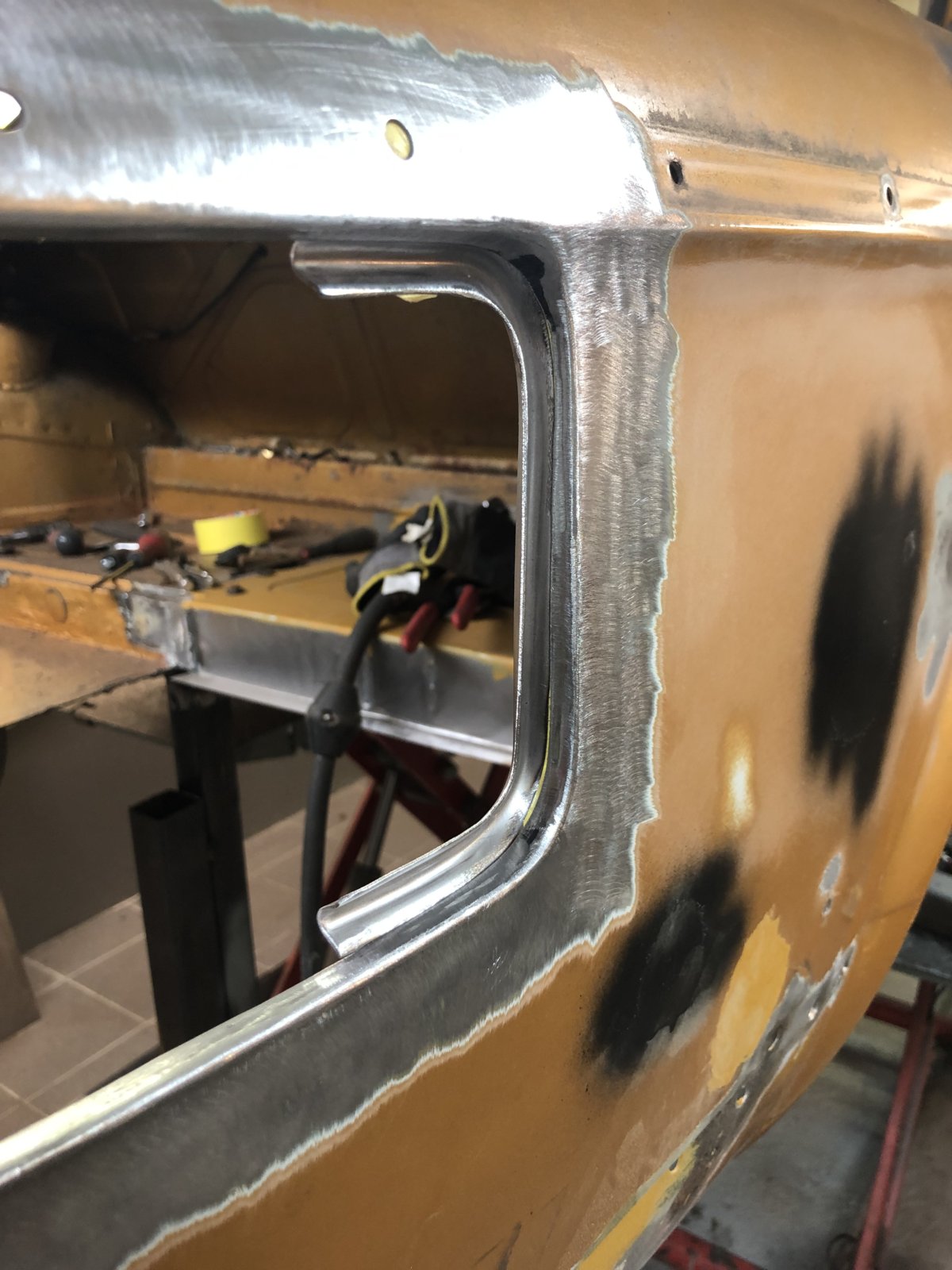

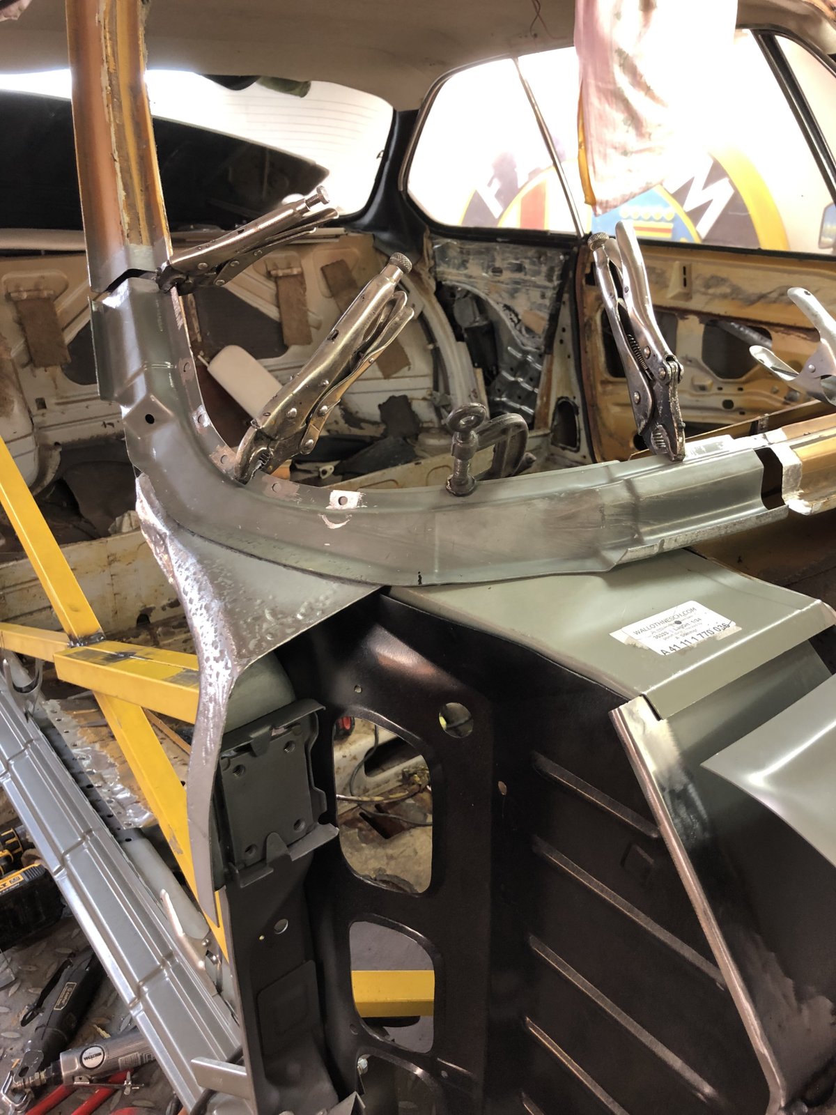

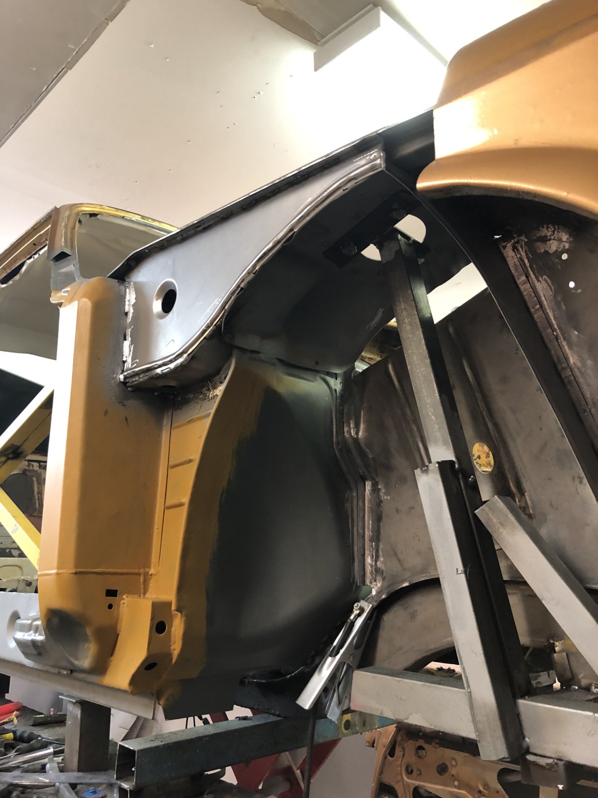

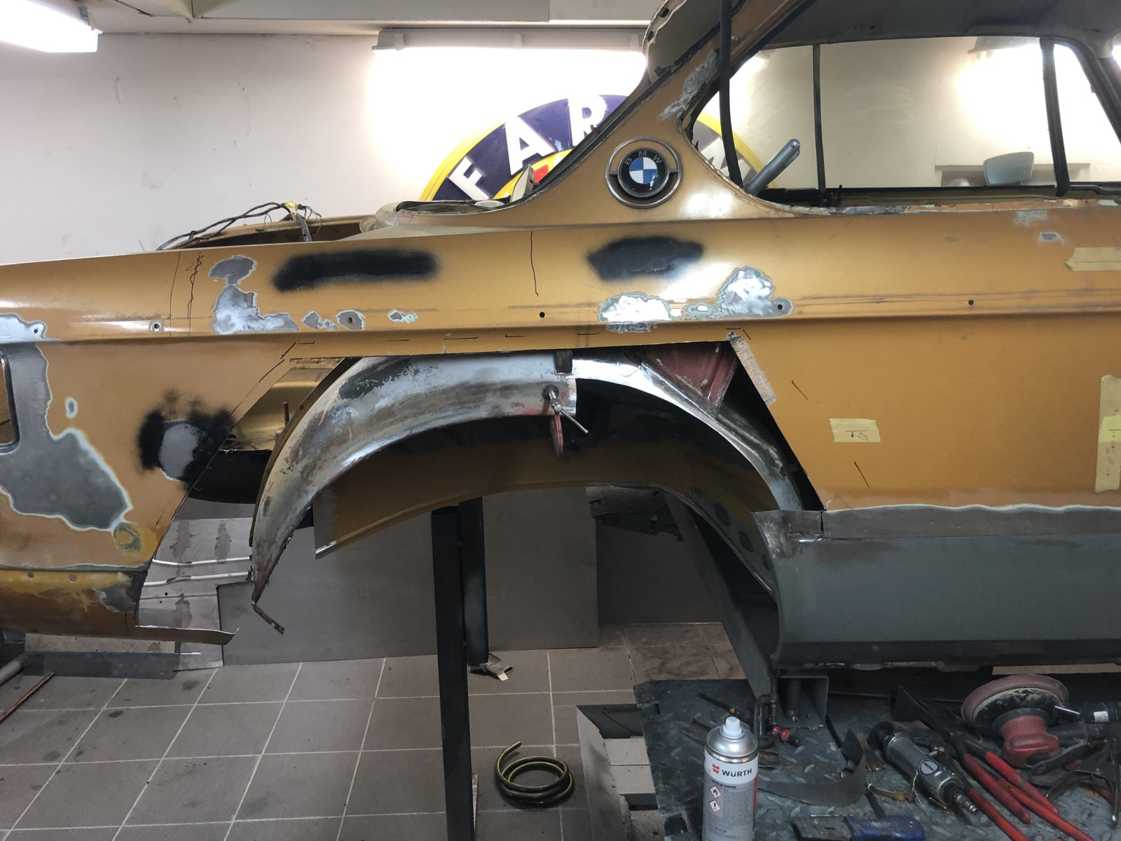

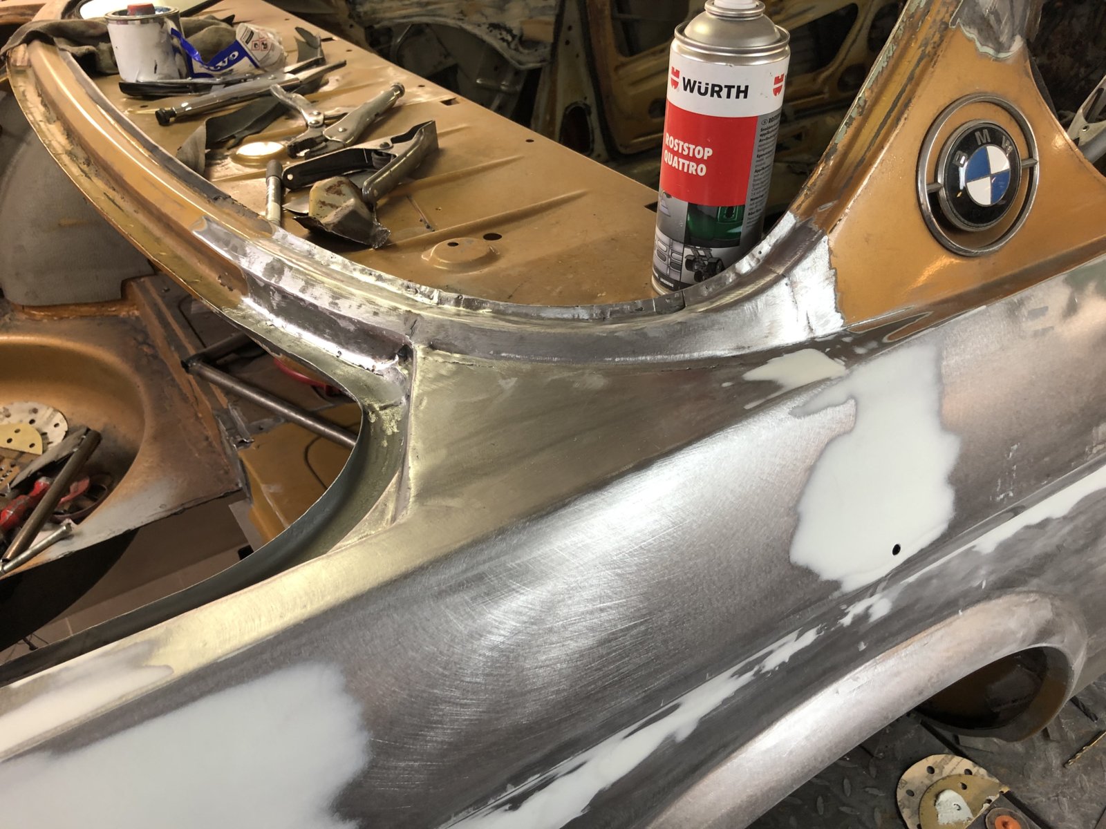

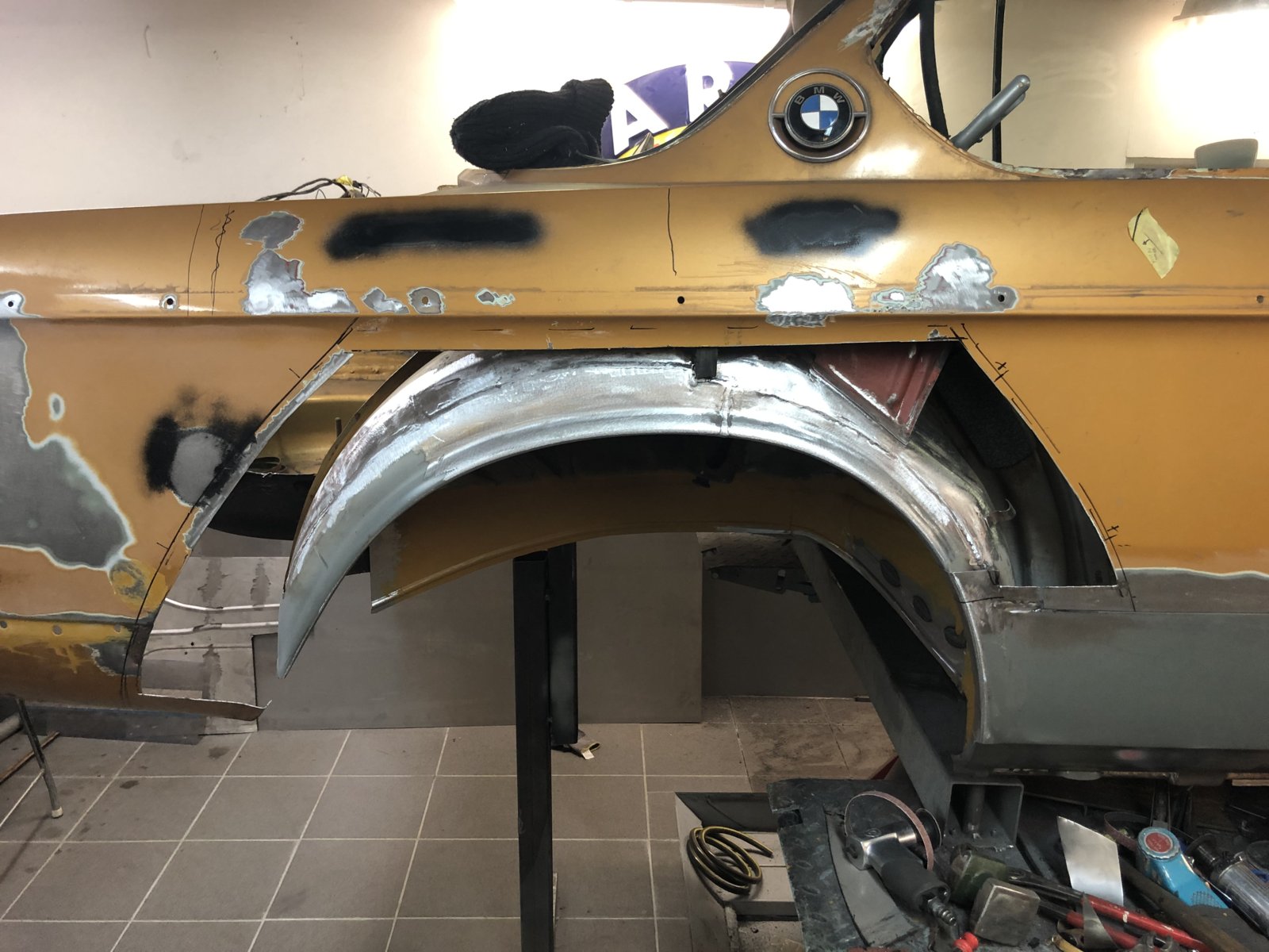

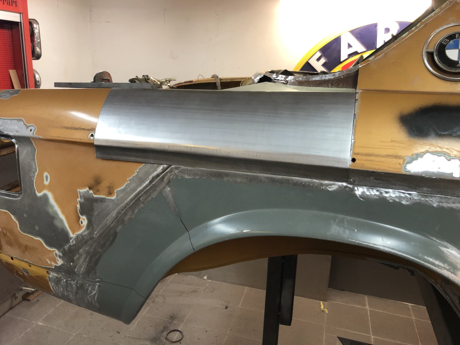

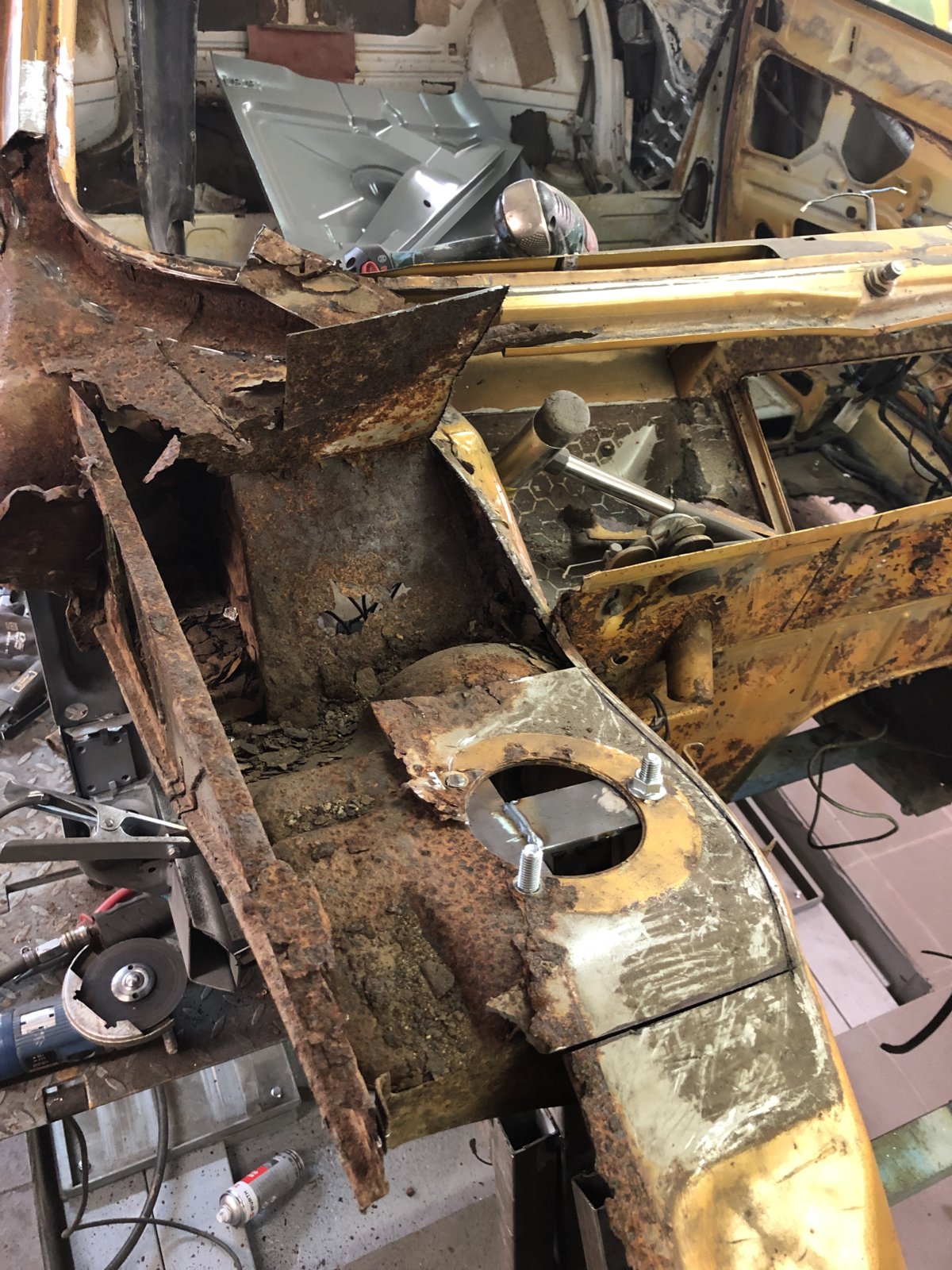

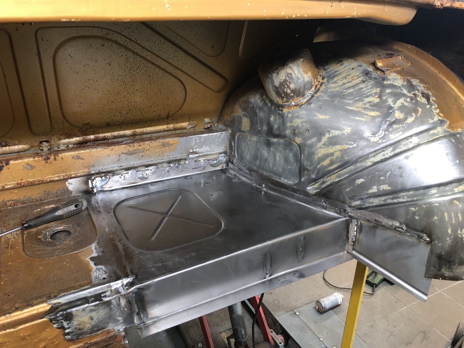

Started rustrepair in the boot , doing the inner and outer rear wheelhouse . Fabricating a patchpanel for the rear fender and doing repairs on the c-pillar.

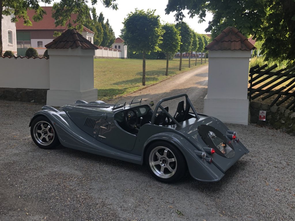

Thanks , but I am no pro, I spend my days behind a desk , this is only hobby. I have done a few cars before, for thoose interested :
Alpina B3 : https://www.m5board.com/threads/alpina-b3-3-0-e36-94-restoration.141429/
Alfa Gtam "replica" : https://rejsa.nu/forum/viewtopic.php?t=83873
Range Rover Classic : https://rejsa.nu/forum/viewtopic.php?t=97740&postdays=0&postorder=asc&start=0
Morgan / Lotus : https://rejsa.nu/forum/viewtopic.ph...tart=168&sid=409e59990dfe230a770e208cb7227c3e

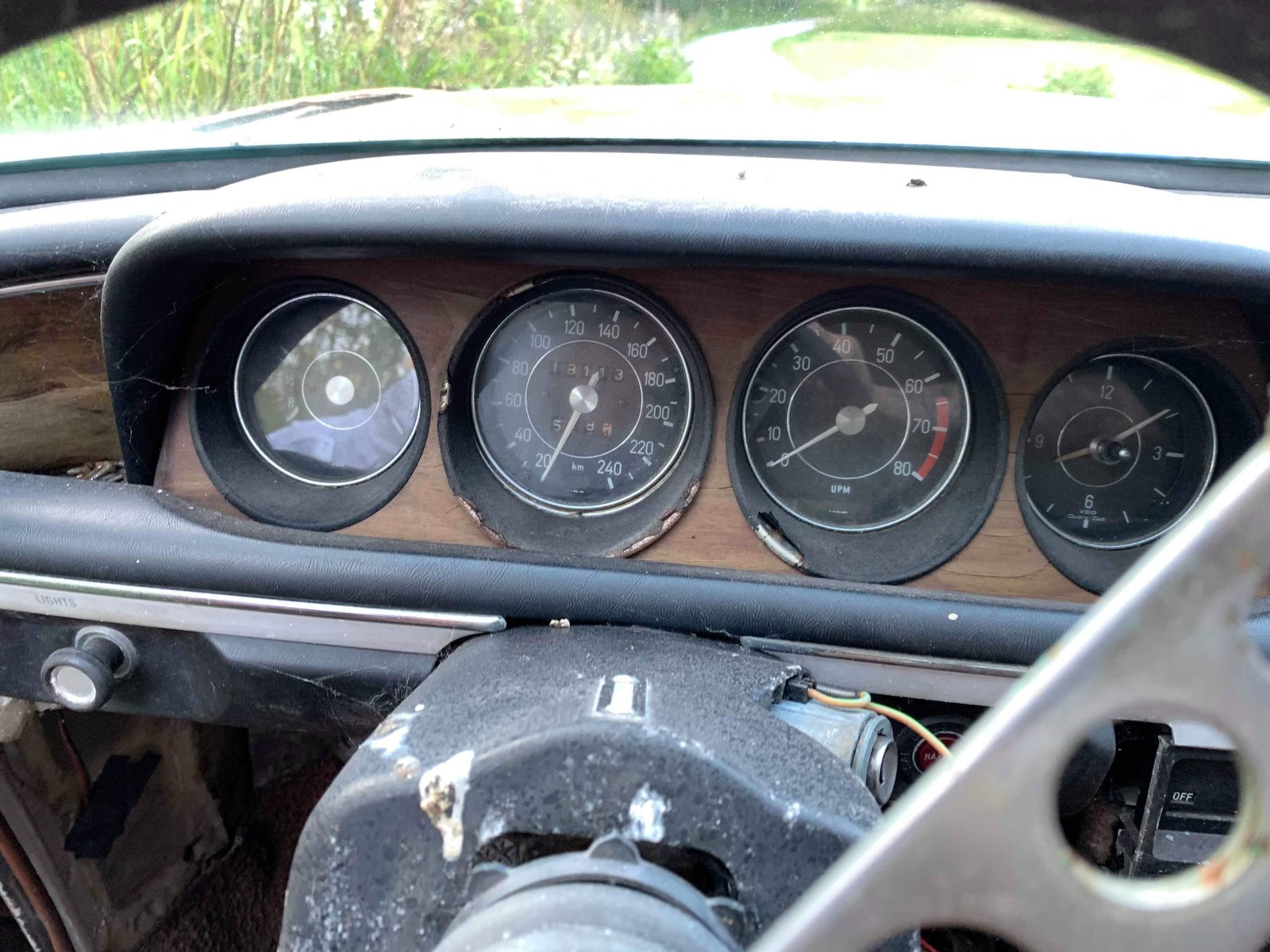

@ellac you possibly haven’t noticed the piece of jewelry in your car, the Csl leather wrapped Petri steering wheel with the 4 ring Csl hub.
Take good care of it, it’s a rare and valuable part. A cover you’ll find fairly easily.
Keshav
Yup, in the state that you found the car, the wheel may have been 50% of the value of the total car.
