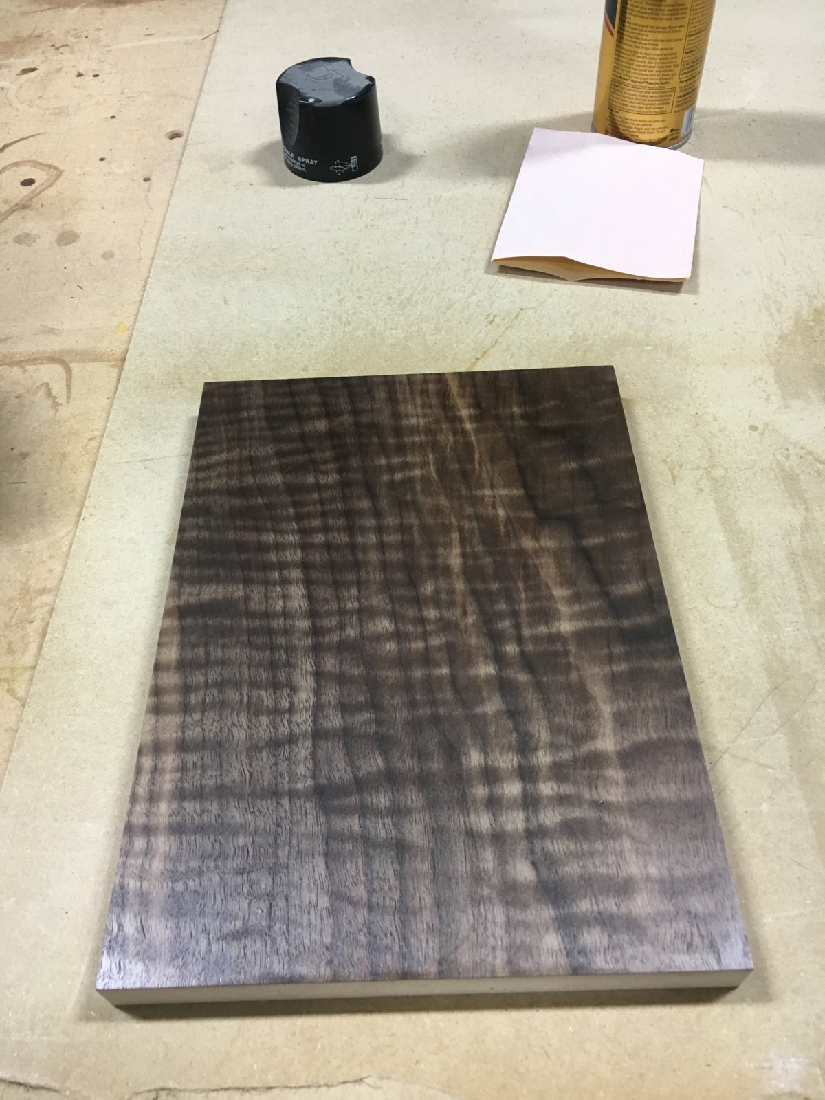

here are the finish test samples for my dash - the first one has a few coats of a sanding sealer, a little stain on 1/2 of it and a finish coat of clear satin on top of it ... you can hardly tell what has stain and what doesn't. if you like this, you can get the veneer on ebay from jimswoodoregon
the second version is raw veneer, no sanding sealer, minwax special walnut stain (wiped on - very light) and the clear satin finish. i think this version would go quite well with the red / brown nardi version. if you go this route, i would stain it lightly, then fill the pores with sanding sealer, then finish in clear satin.
I vote satin. I think shiny will bother you on bright days. I'd match the wheel to the dash not vice versa.
i totally agree with you Steve. high gloss also shows every imperfection ... and trust me, there will be a few that transmit through the veneer. satin looks rich in the coupe.
