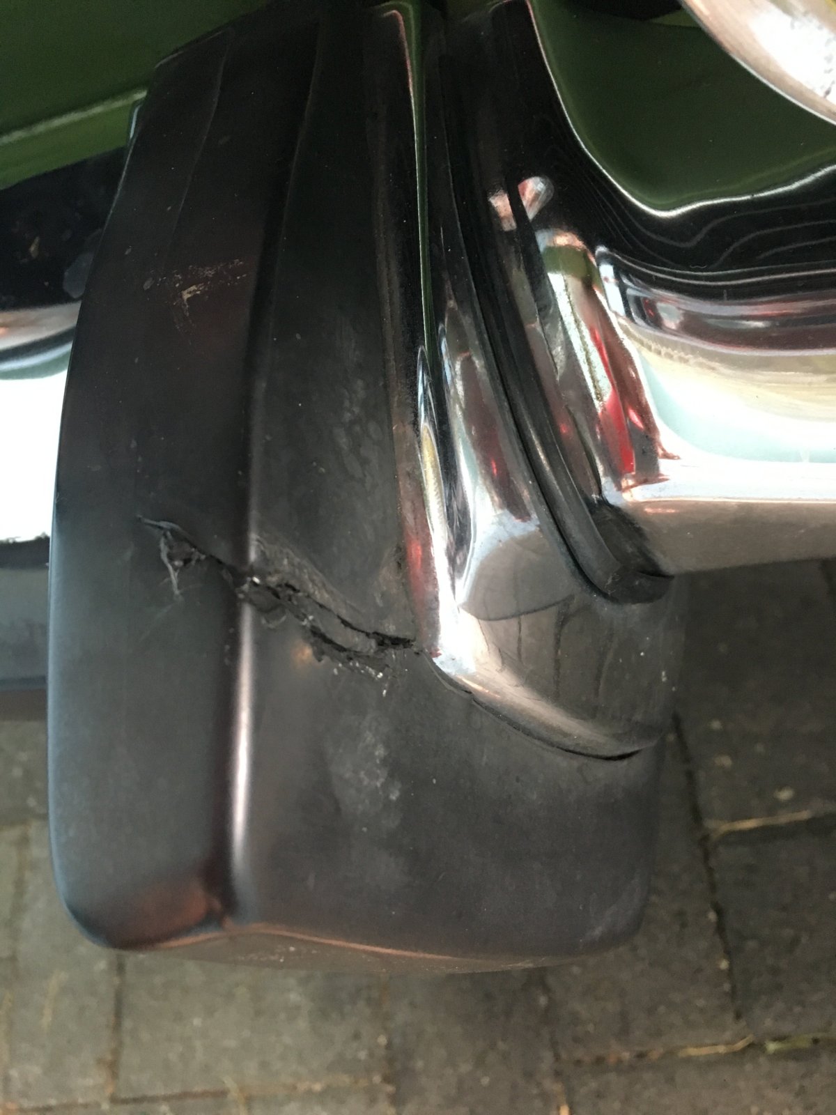

Someone backed into mine in the parking garage at work. The overrider was cockeyed and the left bumper rubber was hanging down (along with rusted bits of the attachment strip on the ground). Replaced the gouged rubber and riveted new strips (both sides). I accept the risks of occasional damage that comes with the rewards of daily driving but it would have been a lot worse without a bumper.
