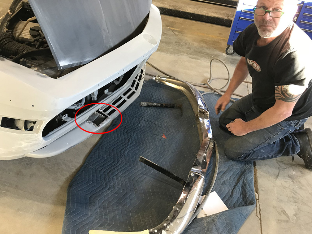

My comments related to two topics. The easy one is the front bumper conversion. Not sure if this is a current photo or not, but it looks as if the large, gaping holes from the later bumper supports have not been patched/welded to result in thin slots for your new (old) bumper brackets. The other comment is harder to describe. But I would assume that the car will be fully primed (after several iterations of blocking and sanding). What I suspect they would ask you to sign off on is the fairness of the resulting surface that they are about to paint. Sorry, that is a boat building term, but that is all I know for this. The pics above seem to show some spot patching, but there is not yet evidence of those patched areas being faired into the rest of the metal work. Hard to tell from photos, though...
Thank you for the clear explanation. I will talk about all of this with Benny this morning and will not proceed until these things are addressed. Spent too much time and money to get this far without making sure that everything else is right
Sent this to Benny and just talked to him. He said all below is contemplated and will be addressed properly. Note that the interior of engine will be painted but not intended for concourse level. It will be an added about $600 for engine compartment painting. I think there will be some added work needed on bumper issues, but he knows it. They said they worked late last night. Stay tuned for video later today, then a break from videos for a week or so while I am on vacation in Tucson. Any members in Tucson that want to say hi? Again, thanks.
"Looking forward to coming down this afternoon and approve things before I go out of town. My forum had a few comments that I want to raise if ok. Thanks for dealing with the "peanut gallery." Since I have never done this before, not sure what all this means but wanted to communicate to you. Reprinted comments below as they appear. Also, can you let me know the added cost for painting the engine compartment now? Thanks SO much.
  • Not sure if I am looking at the latest photos of the car above, but it looks like more than a day away from "sign off". Looks like there is still welding to do on the nose related to the bumper conversion, and more feathering and blocking.
  • What about the areas on the inner fender that require fixing/painting? Last I remember these areas were still pretty rough?
  • My comments related to two topics. The easy one is the front bumper conversion. Not sure if this is a current photo or not, but it looks as if the large, gaping holes from the later bumper supports have not been patched/welded to result in thin slots for your new (old) bumper brackets. The other comment is harder to describe. But I would assume that the car will be fully primed (after several iterations of blocking and sanding). What I suspect they would ask you to sign off on is the fairness of the resulting surface that they are about to paint. Sorry, that is a boat building term, but that is all I know for this. The pics above seem to show some spot patching, but there is not yet evidence of those patched areas being faired into the rest of the metal work. Hard to tell from photos, though... "

So, did final sign off on paint with Benny just now. Here's the video. I think it is pretty boring. Looking good to me. Please let me know if I missed anything at all and I will let him know. FYI: the front bumper area needs attention. @bfeng not sure what you mean by "inner fender that require fixing/painting," but if that is for inside of engine compartment, that will be dealt with separately. I am slightly concerned my May 15 date may not happen, but not sure. I get the feeling that Benny has way more hours in this than anticipated initially and would have charged more if he had a change to rebid it.
