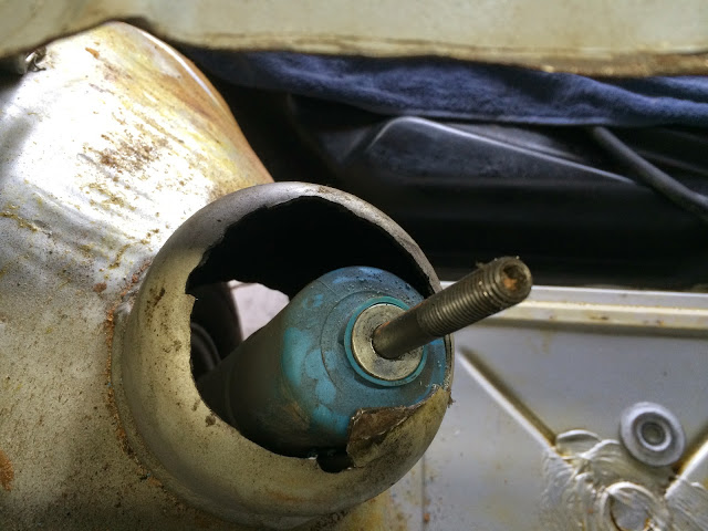

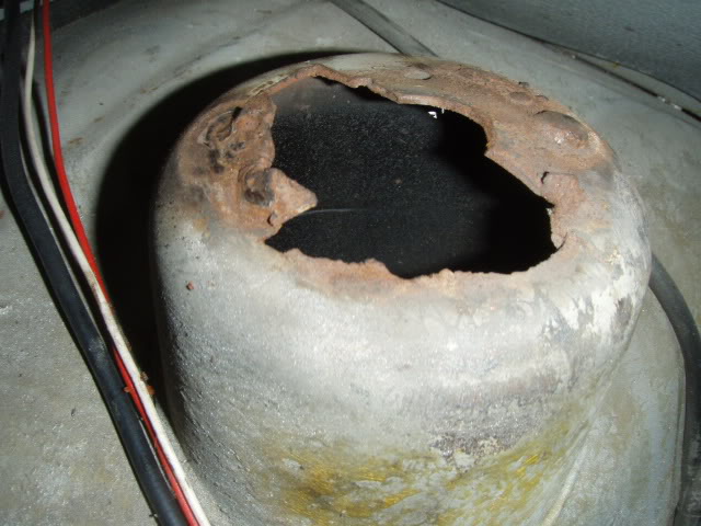

It is my understanding (or perhaps conjecture?) that the failure point of the rear towers is not the top, flatter part. Rather, it lies in the stresses and hardening that is developed in the curved part that has been stretched into shape originally, and has transferred impact loads for 40 some years since. To Rob's point, the milled cap solution replaces this stressed section and connects down lower to the cylindrical section where the load is almost purely tensile and in the direction of the metal - thus much less likely to be fatigued like the top (regardless of whether it is glued or welded - that is another debate). I like the proposed advantages of gluing if the parts fit up nicely. But if the car is completely apart (bare chassis) and not painted yet (I am thinking of my car eventually), I'd likely weld a solution in.

Mark, I interpret those two images as (1) with a failure at the curved transition, and (1) more on the flat part. Essentially everywhere except the cylindrical shaft (which we're all talking about welding/gluing to). Am I interpreting the images as you'd intended?
It appears to me that if you get a disc that is large enough to reach the edge of the curve, that should cover the problem area. It makes sense that the flat part fails and the curve doesn't. Tying into the walls would be ideal, which is my plan.
On a tower that has NOT yet blown through, I don't know how putting a flat washer on top (even a "big ass" one) would reach the rounded edge of the tower since there kind of already is a washer there:
Right. And to cut the tower down to the bottom of the curved transition for a flat washer means shortening your strut attachment by about an inch. This is why I think a domed or dished solution that attaches directly to the cylindrical part is the only true "reinforcement".
I disagree. It appears that the curved part is the weakness but instead the inner piece with the thin washer with the crappy spot welds eventually gives way to the pounding then tears away towards the curved part. The old CS Registry is full of refernces to this and the fix was (even in the 80's) to weld a reinforcement washer over this area (later than this article which only suggests more welds). From 1980:
Thanks fpr digging that up, Steve - I love reading the history!!! This has re-shaped my understanding of this area. And it clarifies for me the discussed difference between "reinforcing" a still intact tower with the "big ass washer" solution and "repairing" an already failed and torn top section with a domed/cup solution. And it simplifies the step that Scott would want to take to have Benny and crew reinforce his towers. :)
