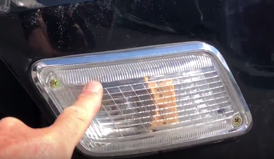

While they're in there replacing bulbs, have them paint the yellow reflector in silver so it wont be visible through the lens.

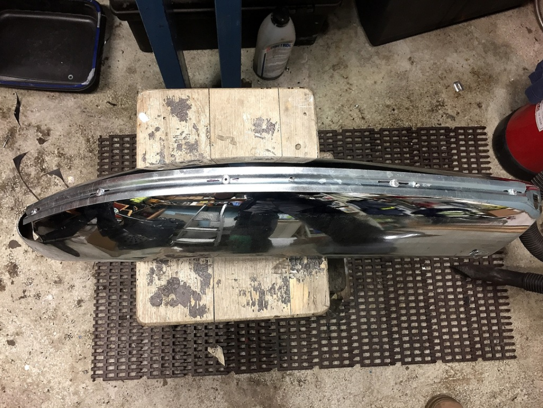

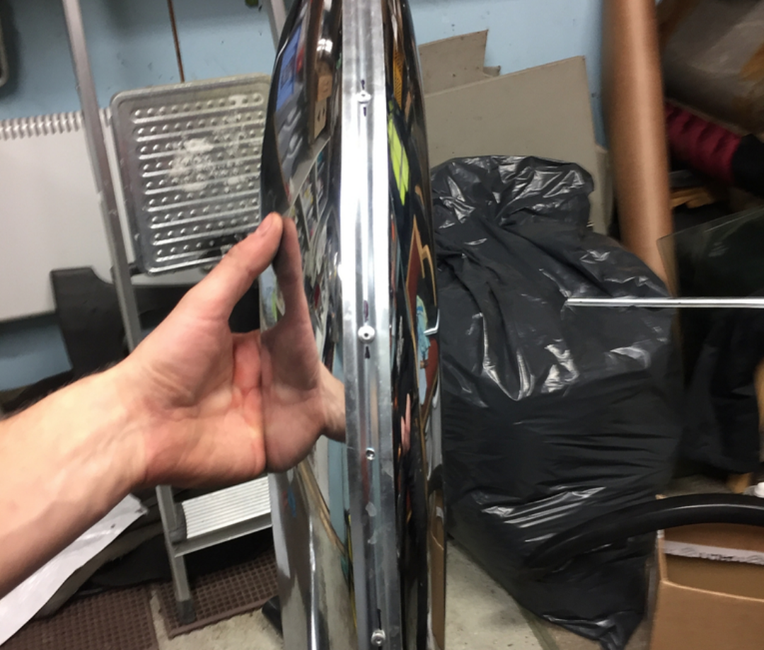

This is how the metal rails for the bumper rubber are installed, pop rivet the rails to the bumper, then slide the rubber on from one side/end. Use some kind of lube to make the rubber slip on easier.
It's a good idea to paint them before installing, but I didn't do it.
Thx soooo much!!!! I love this forum
The bumper rubber is pretty easy. Find the midpoint of the rubber and bend it back so the rear slits fan out. Slide it over the bumper piece. Then keeping it bent feed it onto the bumper from center to ends. Keeping it bent will allow the rubber to fit over the metal. Then tuck in the ends.

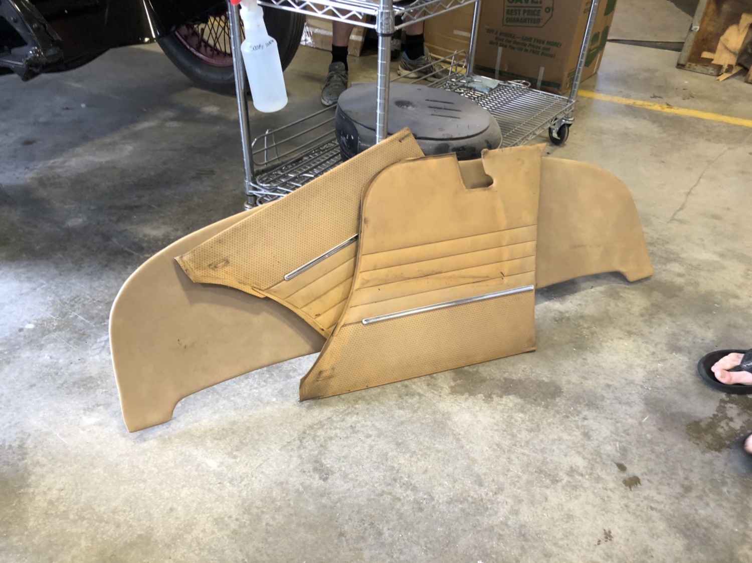

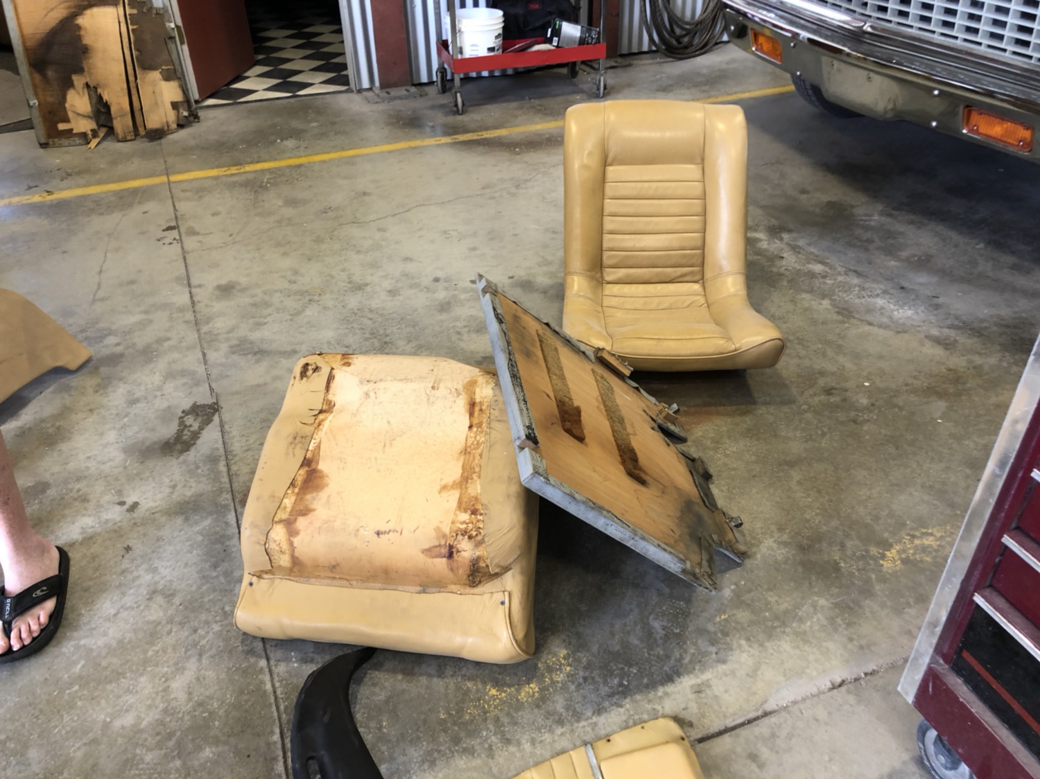

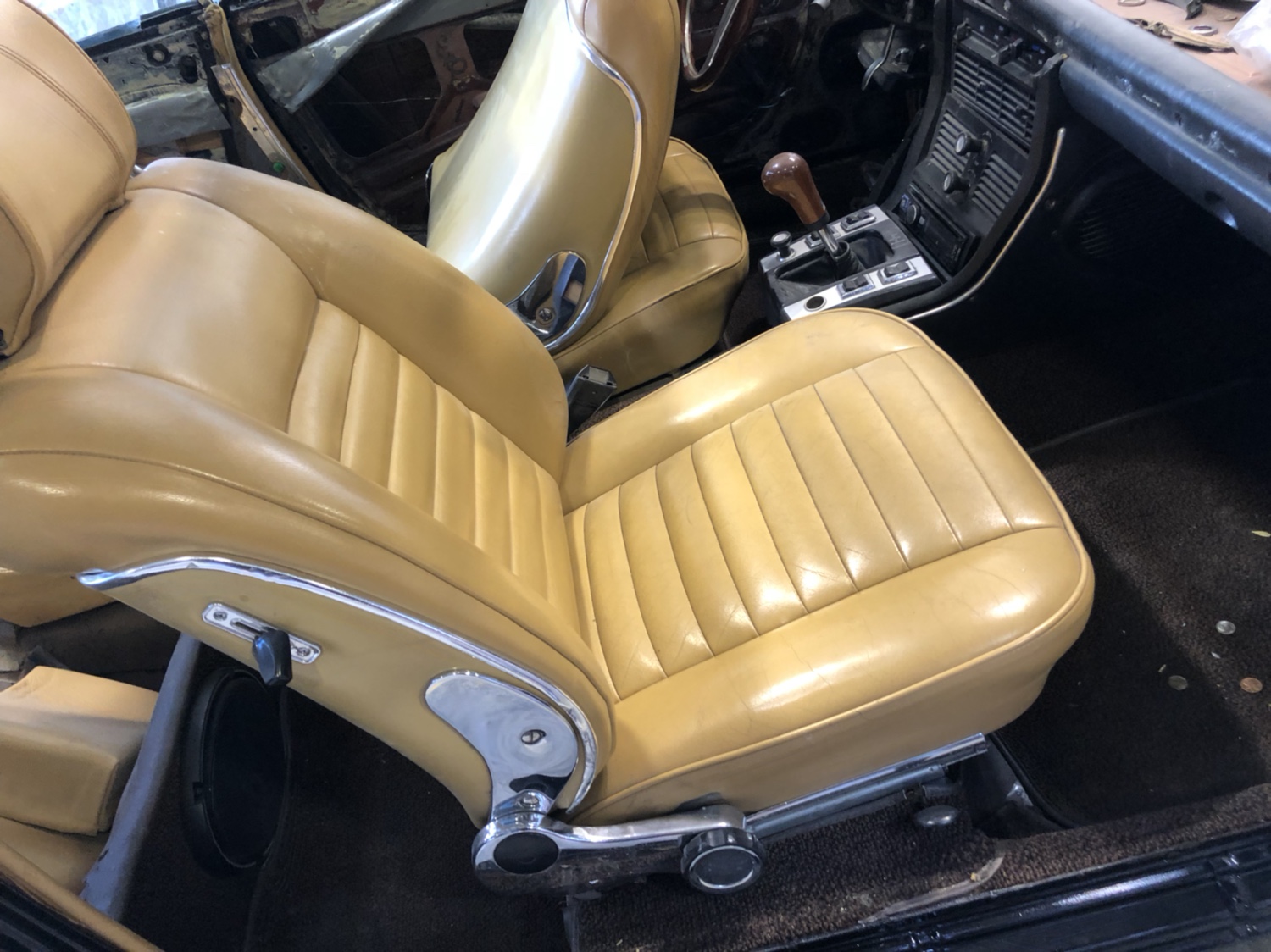

Meeting now at the shop with an upholstery guy and decided to go ahead and get the interior done this winter. Does anyone know a good source for the interior leather sets etc.?
Short video with upholstery guy. Ideally, I could buy the parts so he can just install.
Just got an email from Benny. Apparently, he wants to send out all of the aluminum to be shined by someone else. I really wish she had thought of this earlier as it was suggested several times. Looking less and less likely that I will meet the deadline. Such is life…
Is it just me or do your seats and panels not look too bad? A little elbow grease and some matching carpet and you might be all set... unless of course you are wanting to change the color of your interior...
