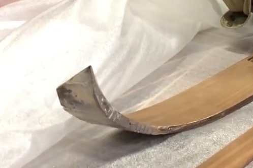

On that note, I suggest that you get going on the wood test fit. Perhaps it is distortion from the camera, but your wood repair looks pretty dang thick. It should be about 12mm with the veneer. The wood fits into an aluminum top plate. Find out if you have interference and if it matters.

Per my wood guy: What parts are they talking about? After removing previous layers applied to your components I put less back on than came off so in reality you’re components are probably closer to the original thicknesses they were when new than when I picked them up
Measure the long dash piece, particularly around the bend. Once again, 12mm.

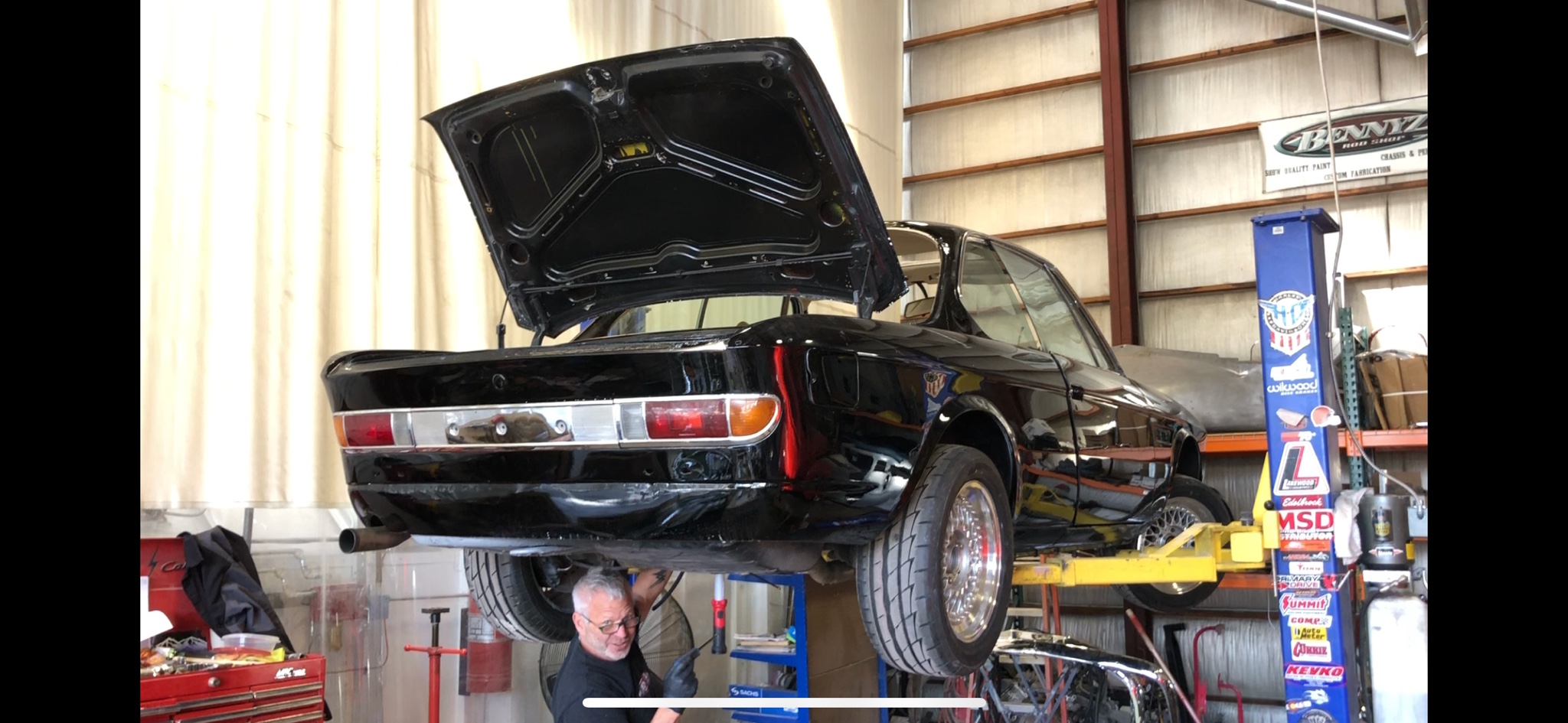

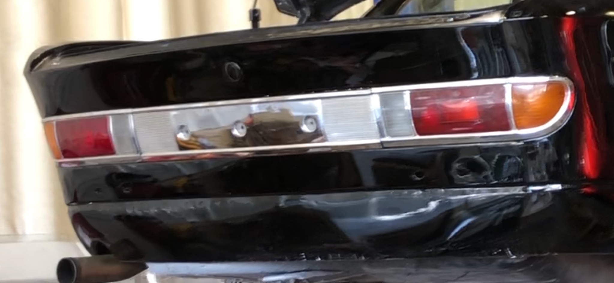

Making some more progress today. Tail lights are in. Starting to look like a car again. I will be back on Thursday to see what is done.
I can’t get over how nice fresh clean unhazed/ unswirly balck looks on an E9!
I agree. It looks like Benny and company have done beautiful paint work.

I was in Vegas for the past 2 days, so on my way back into town I stopped off. Short video, about 4 minutes.
Key take-aways:
  • NEED Parts, broken bits that make it too hard to re-attach
    • Hood Roundel
    • 3.0 CS insignia/letters for trunk
    • side chrome fender grills
  • Gary is having a tough time with rubber attachment to rear bumper
  • Wood is looking good
  • I see no way this will be done next week at this rate. Not a huge deal
If you know best place to source these pieces and/or have thoughts on the rubber for rear bumper, please let me know.
Thanks.
