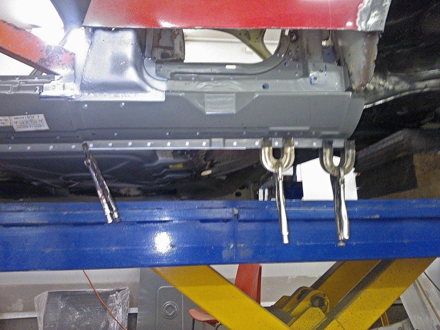

With all due respect, an experienced fab shop can replace the outer and inner rockers in less than 36 hours.
You certainly aren’t hurting my feelings. I’m curious
though, are you basing this off of experience? I ask because a very competent shop on the east
coast spent significantly more than 36 hours on a member’s rockers. I’m not sure if the inner rockers were done. I’m talking about the real inner
portion of the three section rockers, not the structural center section that everyone keeps referring to as the inners. I was taken aback
by the figure, but looking at @‘69 2800 cs ‘s rocker
thread, I see at least 15 - 20 hours of work on each side.
Totally depends on how far gone/in what shape everything around the rockers themself are. If there is rust creeping up the bottom of the A-pillar, bottom of B-pillar and up the front of the rear wheelhousing, I have a strong feeling that it’ll be very hard to do it ”the right way” in less than 36h.
